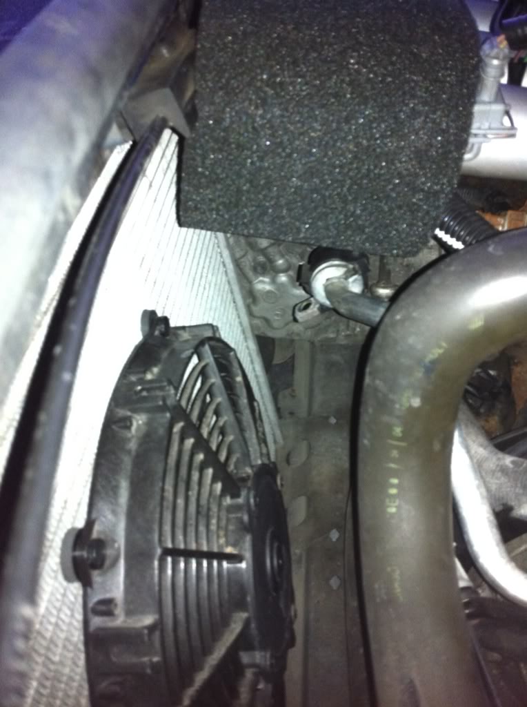

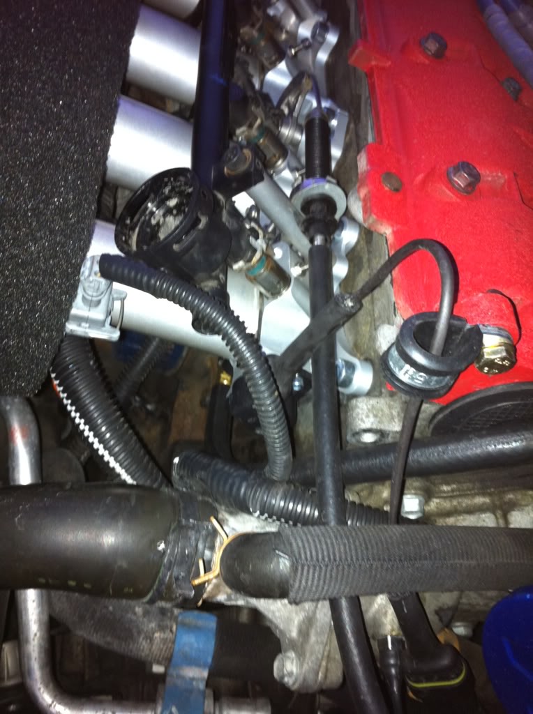

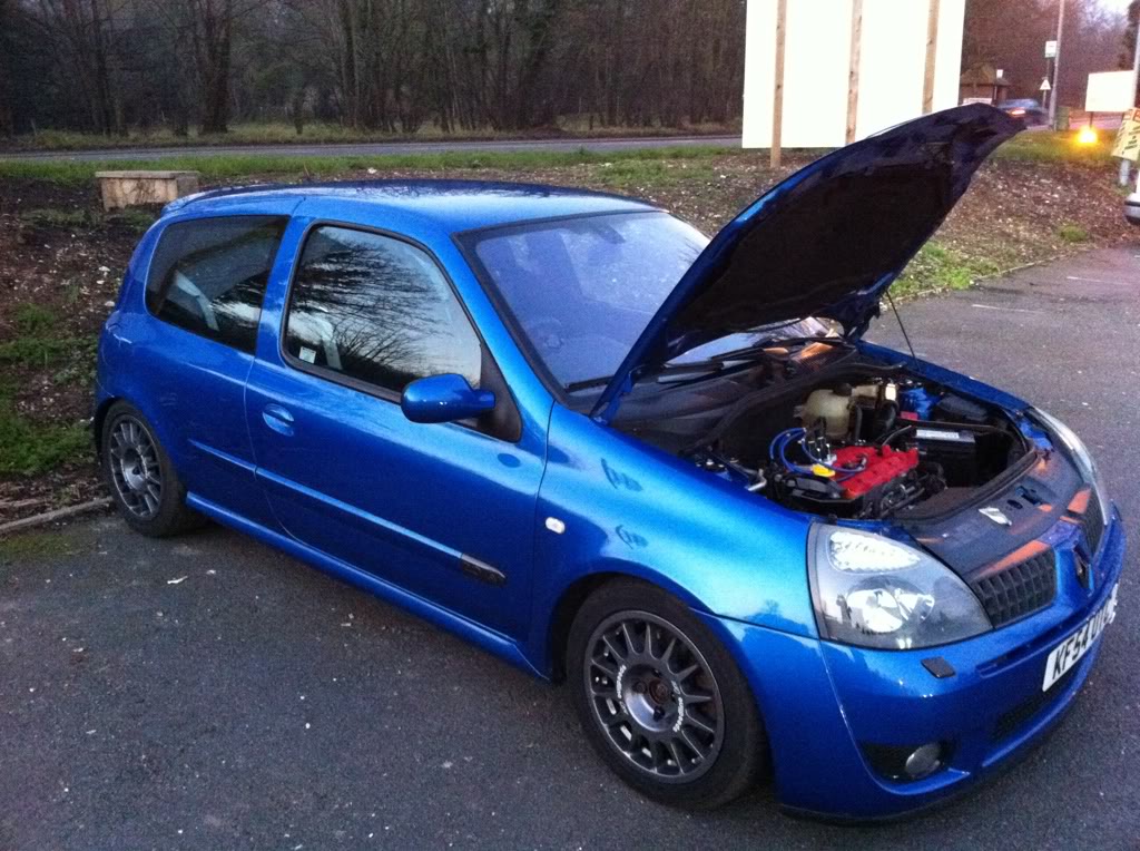

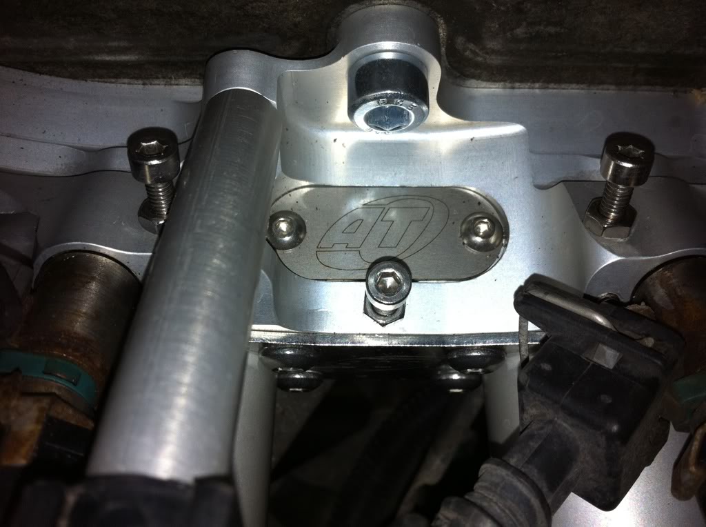

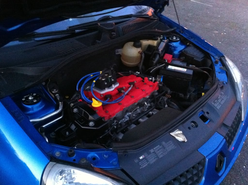

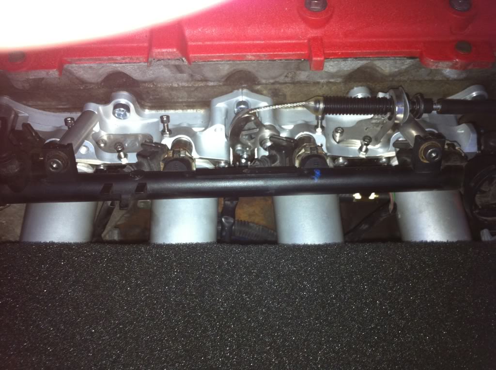

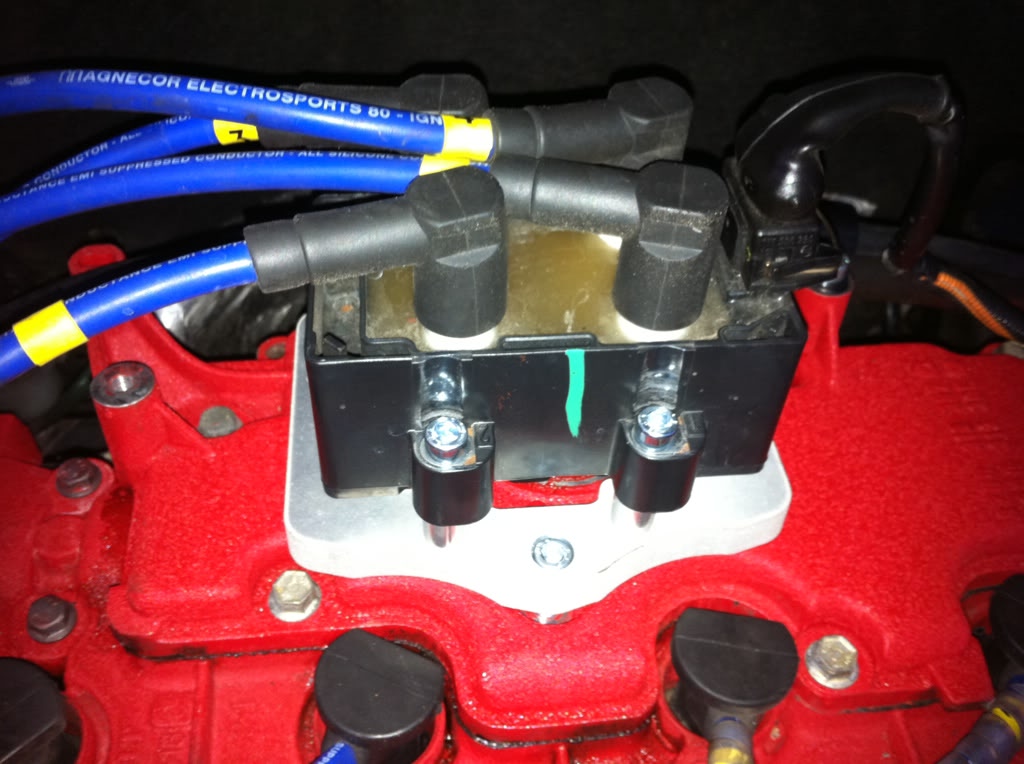

Moar photos of ITB's, Dave ;)
As requested :D

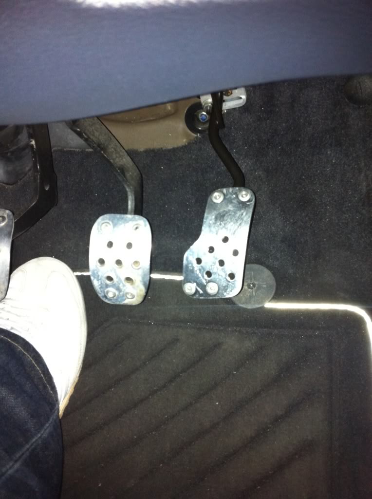

The new cable throttle is adjustable, this is so much better, can heel and toe easily now, throttle pedal was a little to high and to the right previously
Also the cars actually not too bad on fuel, it's done 110 miles to £20 of V Power so easily liveable. It's been cal'd to run closed loop under 30% throttle and 4.5k so economy is spot on really :)

Schweet.
Tell me my internet friend, how much of a pain was it to paint your rocker cover. Mine is desperate for some paintage.

Great stuff; looks a very neat install, as expected! :)

really is a tidy install, very good job indeed
Matt I'm bloody loving the almost constant little pops and gurgles!! My car is so much better and I grin ear to ear when driving!!
Owen the rocker was painted when it was removed for the cams mate so was easy, other wise it's a b**ch of a job!

ahhh this`ll be the car i was talking to Matt about @ TDF the other weekend... the AT bodies do look a nice package strapped on there...
