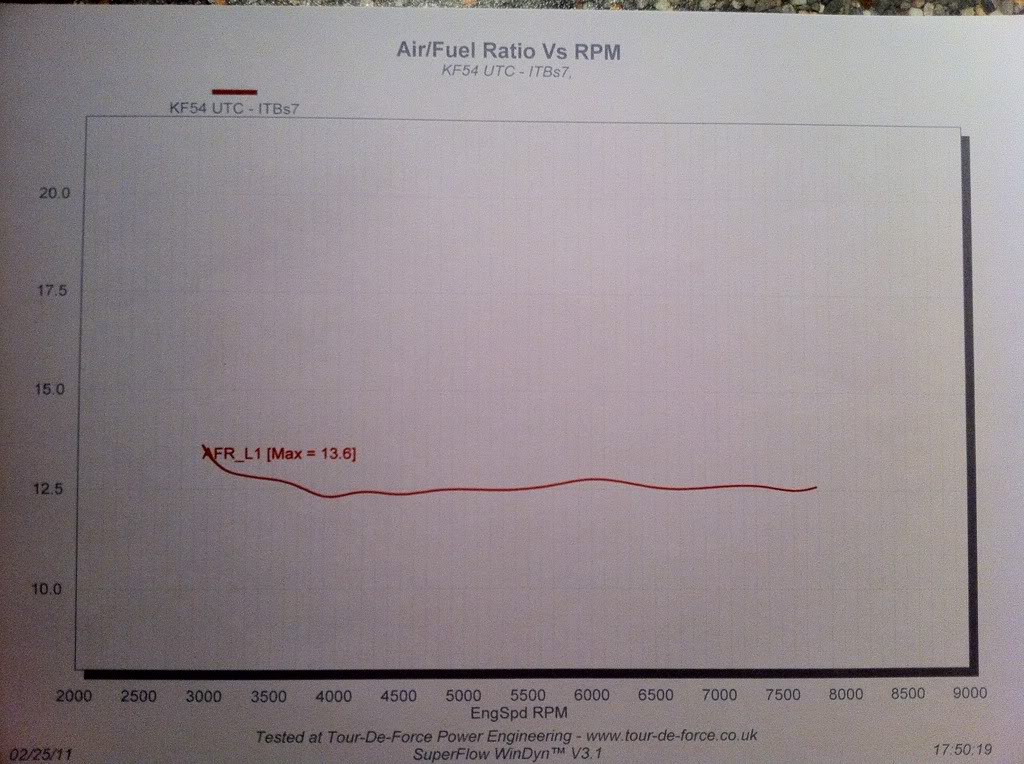

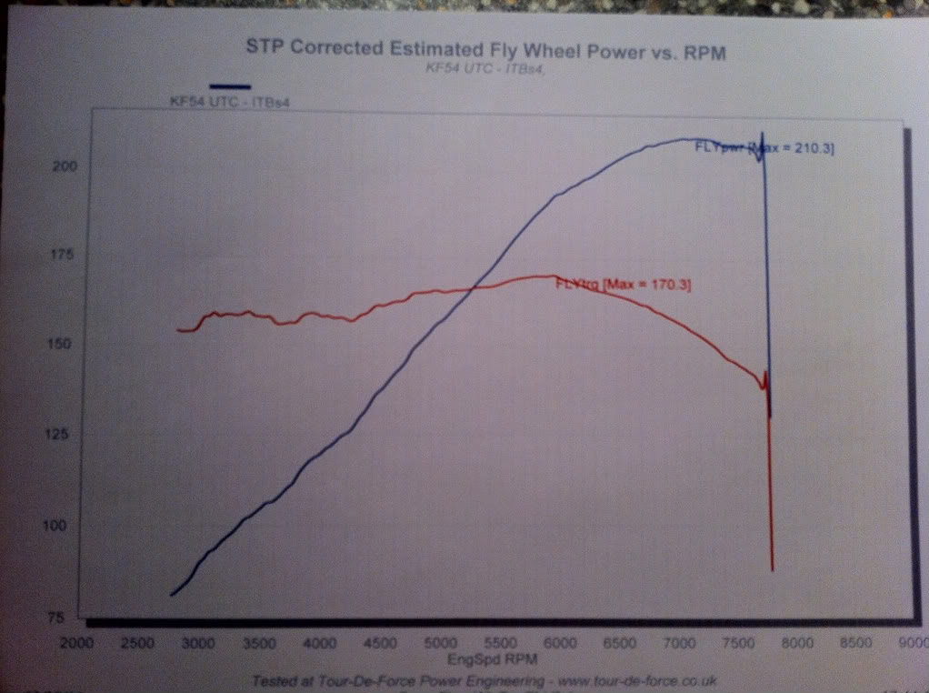

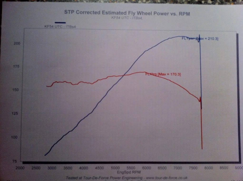

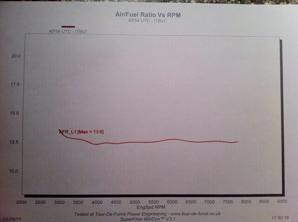

As requested!
The figures... The peak figures mean nothing, it pulls so well!
AFR is almost flat

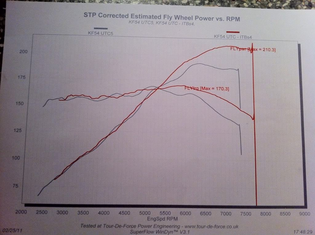

And before and after...

Thanks for putting the graphs up mate. From 5200 rpm it just comes into its own! Must really pull! :cool:

:S I expected you to have gained more torques/power low down? Looks like you actually lost a bit at £4.5k

It is intersting to see that power graph and how the power excels after 5000rpm, but i think id be left a little disapointed with no gain below that?
Re: Dave.'s Trumpeted Engine Spec, Cammed Up Gunit, 2118'd Carbon Vagina Boob obsessi
Longer trumpets will show a gain at lower RPM but then you're into fitting a short rad, loosing the aircon, fitting bonnet pins etc. etc.
You can't have your cake and eat it unfortunately so this package is the best solution if you want to use the car every day, keep the aircon and so on. If you want to get into chopping metal etc. then you can find circa 15 ftlbs at 3500RPM - entirely up to the customer if they want to go down this route but for a daily driver it's a bit much IMHO.

The extra long trumpets will show pretty similar torque peak wise, but from 3.5 k Jay & Tonys car will be at peak torque I should imagine, and will hold it to the limiter.
But comparing a race car and track cars a bit silly really!
The peak torque / power higher up the rev range will be good on track, as that's where it will be the vast majority of the time, higher rpm

You can definitely notice the difference that the cams make in your car Dave when I compare our respective graphs, even though the peak torque isn't miles apart, you have soooo much more lower down the rev range. Oh and the small matter of an extra 12bhp. Show off.
