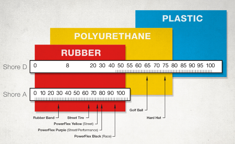

only thing between them is shore hardness of the rubber
Bushings are produced in one of three durometers – Yellow (70A, approximately 25% stiffer than stock), Purple (80A, approximately 30% stiffer than stock), and Black (95A, approximately 80% stiffer than stock)
