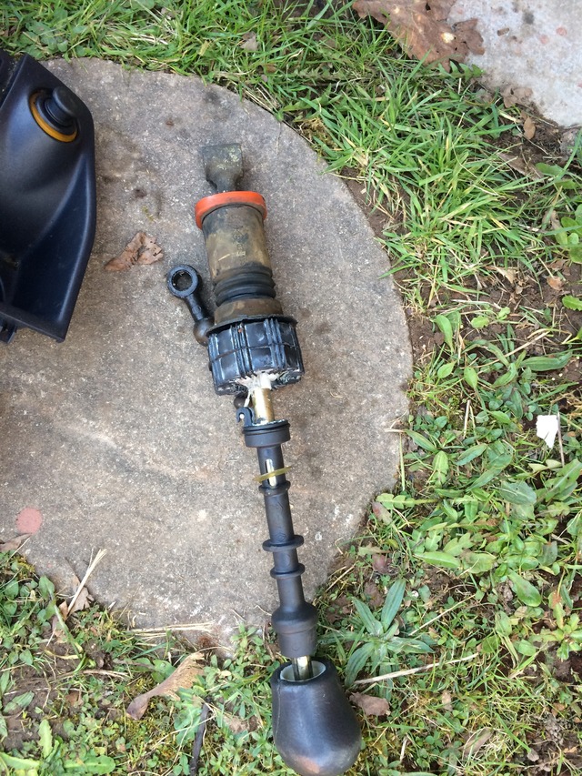

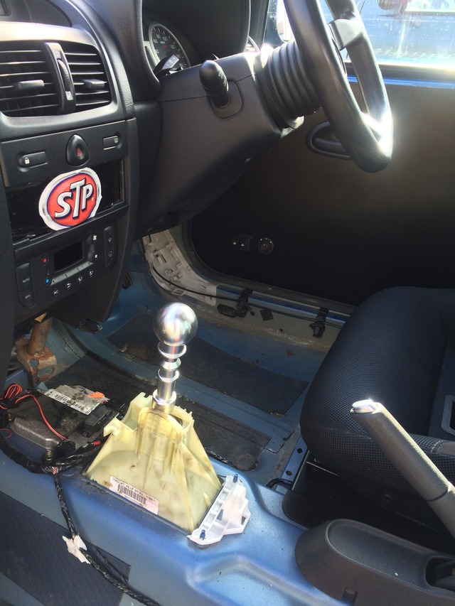

So as a treat I've fitted a short shift to it so see if it makes any difference,
Old one out....
The new guy!!..
Yet to road test and see how it goes but will update and let you's know.

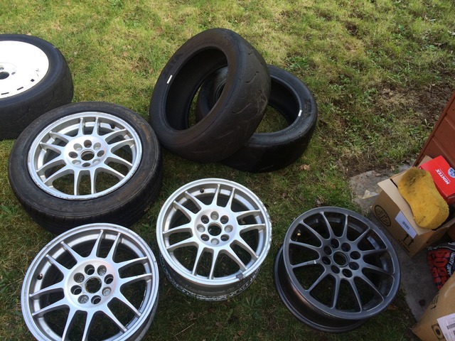

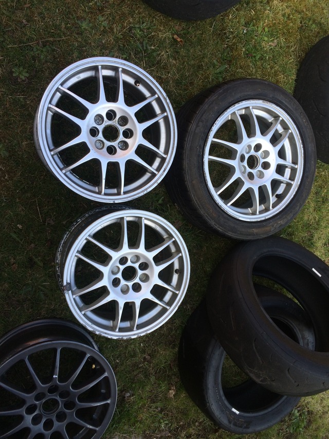

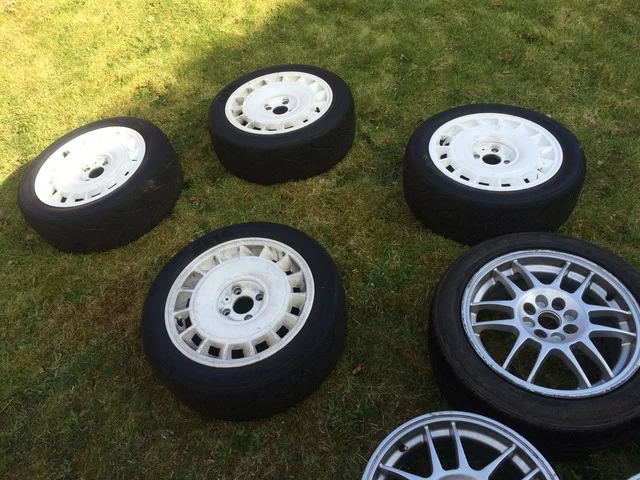

Also manged to now have a full set of OZ F1's Got too many wheels now lol
Going to have these at the road/wet tyres. And just get shot of the ones I have on already (anthracite one)
Getting the track wheels out and checked.. Once the tyres are done will get these refurbed thinking keeping them white still.

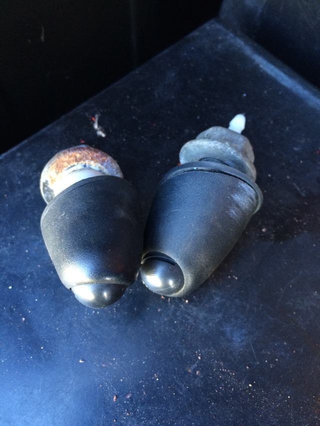

Preping the car and the gear linkage dropped out from underneath the car 😞 so waiting for a hand to show up to adjust but while I'm waiting I'm take on some extreme weight saving.. 10 points to who can spot it :wink:
Found the issue to the linkage dropping out the bottom, circlip wasn't on correctly so back on after finding the right one and gear selecting is now a lot smoother so hoping that's he end if it there!

The short shift held up after having issues fitting it at first. And yeah the shift is shorter and going by the videos I take 4th if not the same time just a little earlier, maybe not as noticeable as I had thought but happy to leave it in there :up:.

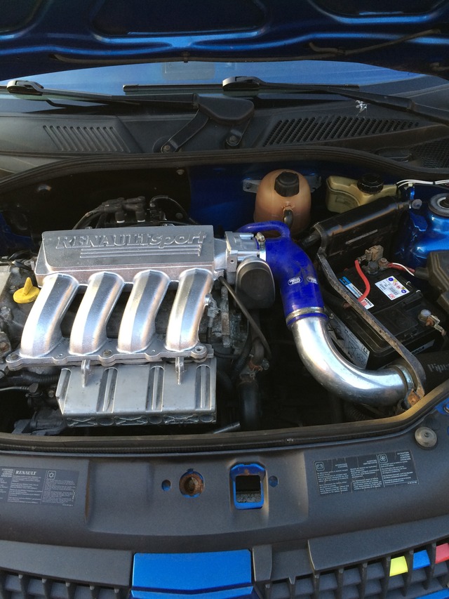

was looking through my receipts from me and previous owners and it fairly adds up ... near the 7k mark :openmouth:, putting that down to being a looked after one until i got it 😂
thought id do a spec list see what yous think,

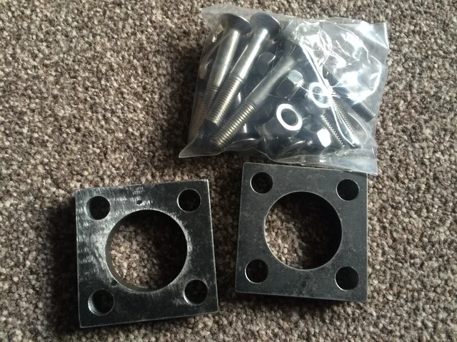

Update of some new arrivals:

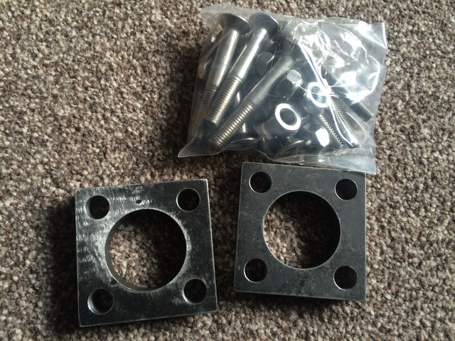

.... and this first thing I take arrival of today is...
Yip rear camber shims -1.5degree... and not even on the to do list :laughing:

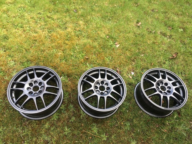

but as a bonus I did also get my wheels sorted and they look pretty good now just needing to swap over my tyre's from the other wheels.
going to re-do my turbine wheels when the tyre's are shot in the same colour i think but maybe with a wee twist :grin:

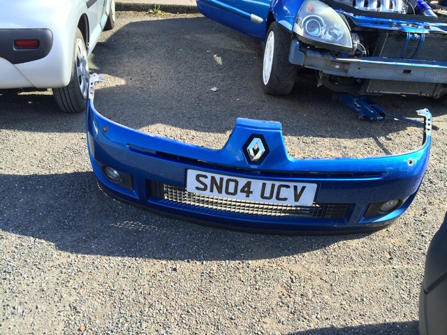

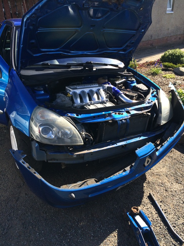

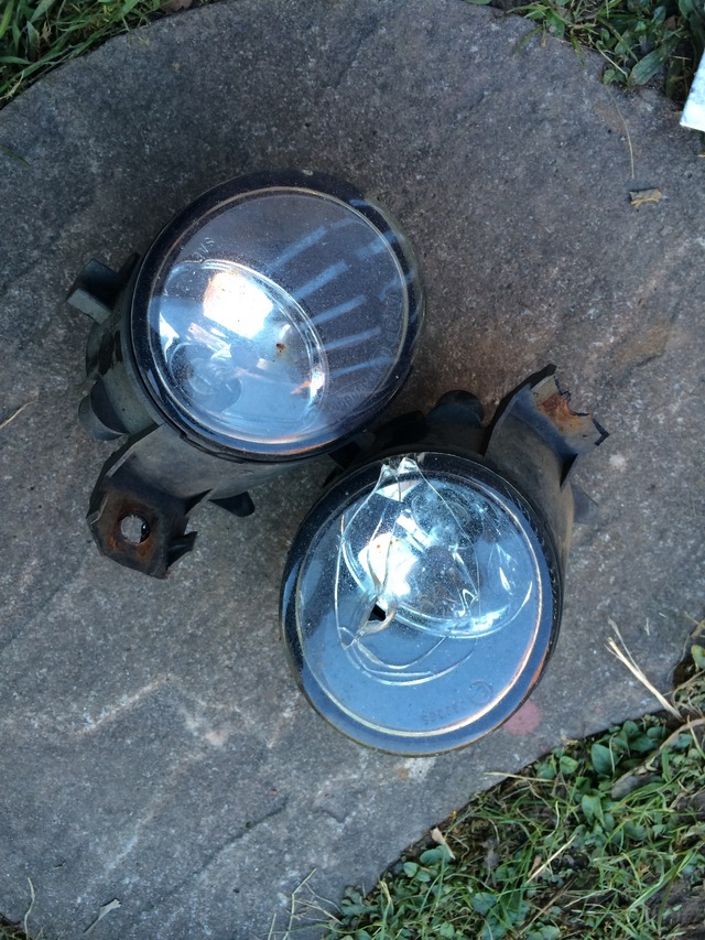

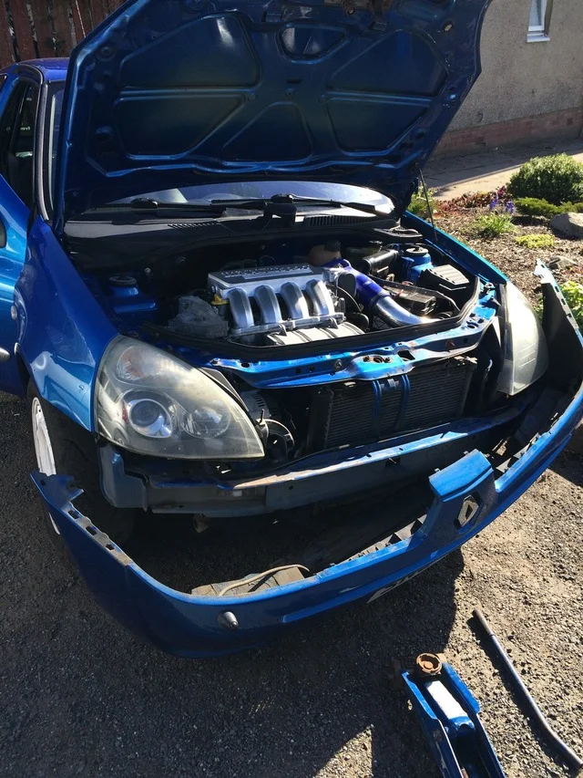

So tonight was a good night and I made a start on a few jobs needing done..

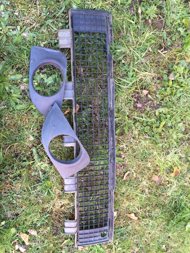

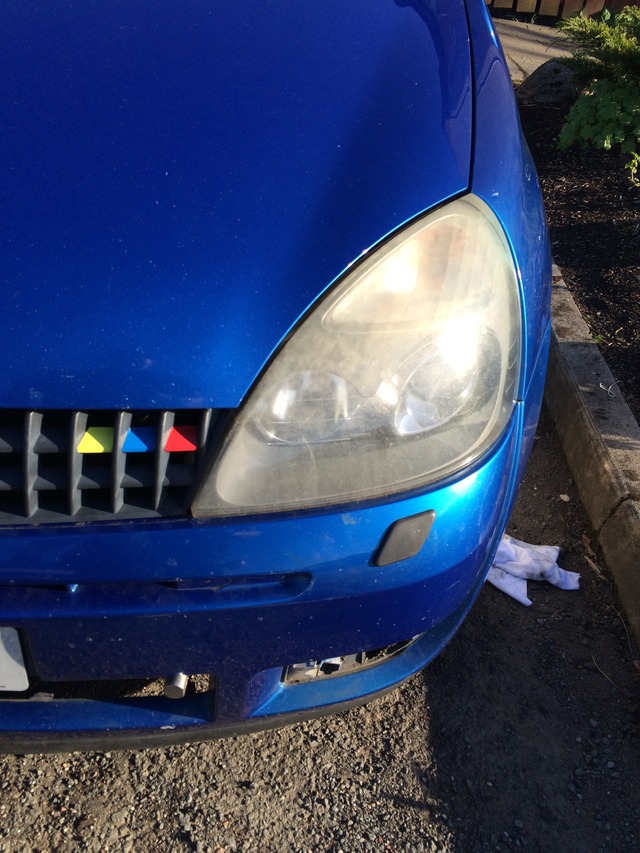

Off with the bumper to remove washer jets and fit blanks. Also grills off to give a paint and remove fog lights.
Off!!....
Cheerie!!...
As it sits the now..
Awaiting painting-

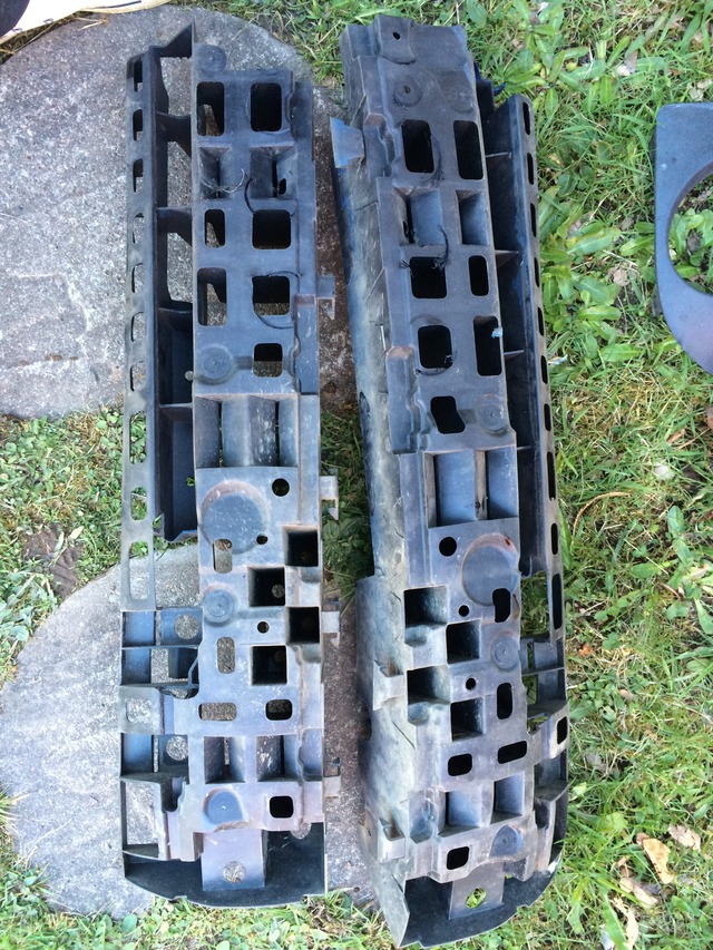

Then I made a mistake and removed these and tried fitting the bumper only to have it sitting like a bag a s***

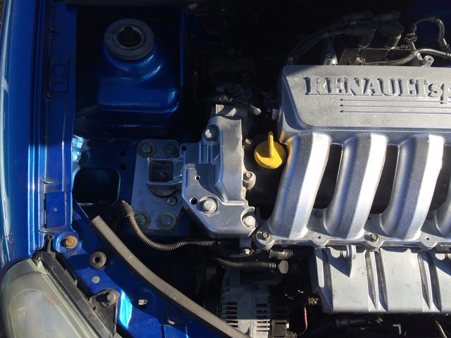

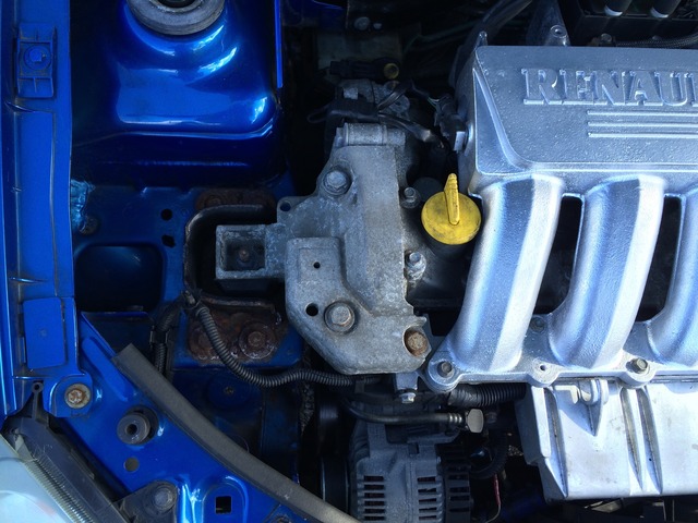

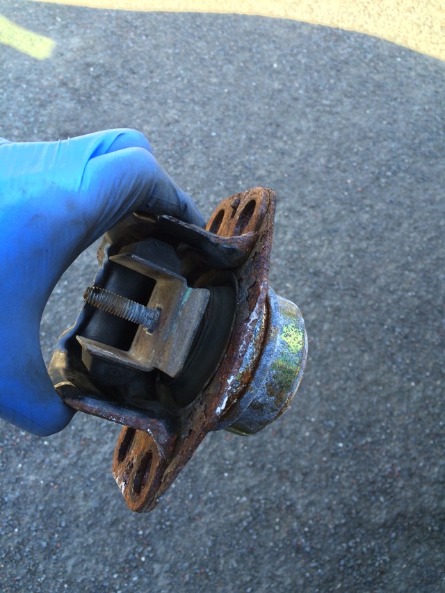

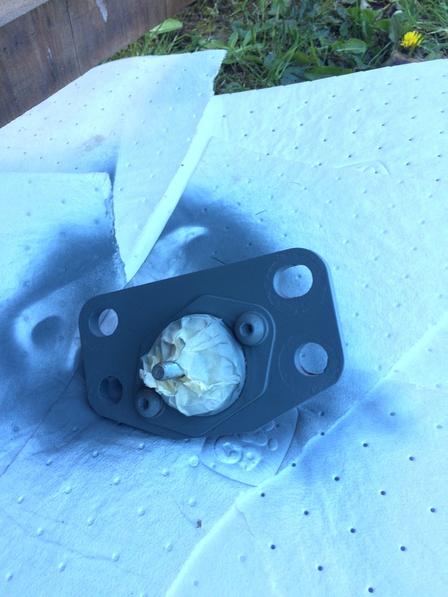

Other job needing done was to start fitting the engine mounts
Before:-
During:-
Fee too a good home if interested :wink:
After:-
And that's really where I am at the now... So the TO DO list as it stands

- fit washer blanks - DONE!
- remove fogs - DONE! + fit ducts to brakes

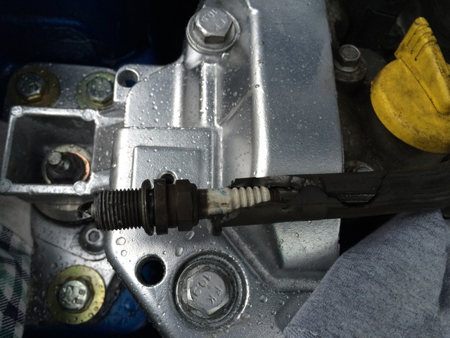

So all going well after fitting the new parts I decided to take it out a run (some squeaky noise comes of the rear strut brace..) and it decided to shoot a plug out of cyclinder one 😞

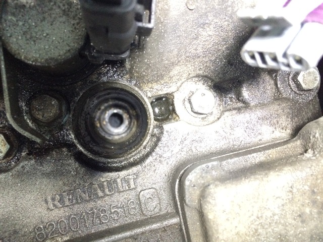

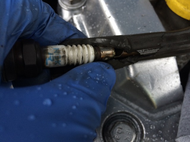

Deciding what's the best option to take, repair the thread for the plug in place or remove the head and new head gasket, and give it a good all over clean up??

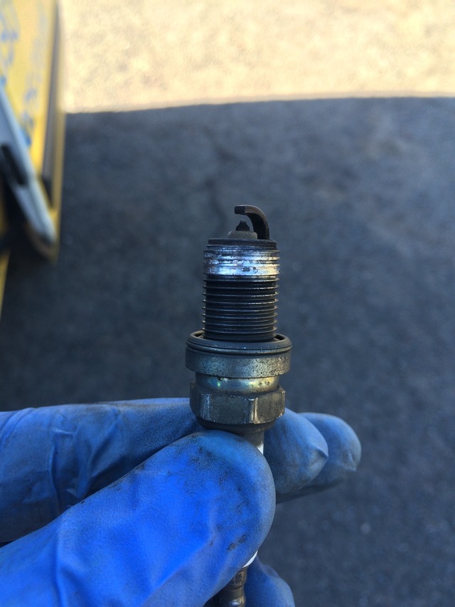

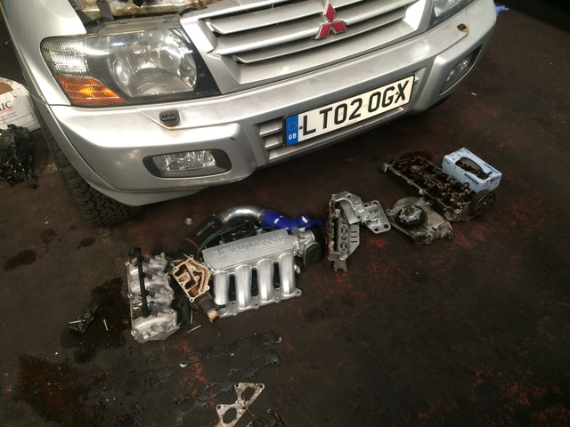

So this happened today...
After blowing a plug a few weeks ago decided to take a look at the other plugs and see how they looked.
The idea was to do that, change oil and filter give it a polish up then get it ready for the next track day... Looks like that won't be happening now.

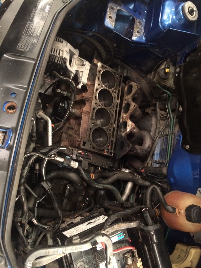

So the plan of action is cylinder head off and get the plug holes re-tapped and clean up/remove any shaving in there. Was going to do the repair treads on it but as its two plug holes now just get them all seen to and I'll feel for confident with it done.
Head gasket is on order, so once that arrives then get it done, recently had a new belt so that doesn't need replaced. hopefully get it back on the road soon.
Bit of a set back to be honest, car runs a treat when on the track but seem to break on me when its at the house not doing anything haha.. Just my luck I guess :down:

Just a quick one, when you fitted your stiff shift how did you remove the old assembly with the gear knob intact? I have removed the circlip underneath but cant fit it through the gap.
Cheers.

Work in progress....
Cylinder head is already away to get the spark plug holes sorted and also cleaned up.
Awaiting arrival of a head set and the job should be done for tomorrow night.
And if all going well and weather is good it'll be out on the Saturday :cool:

I bought one of those shifters for my Renault 5 GT Turbo - had to shave a few mm off the alloy bushing to be able to get the circlip properly relocated in the housing.
The guy that fitted it for me said he had to drill a bush aswell to make it fit.
