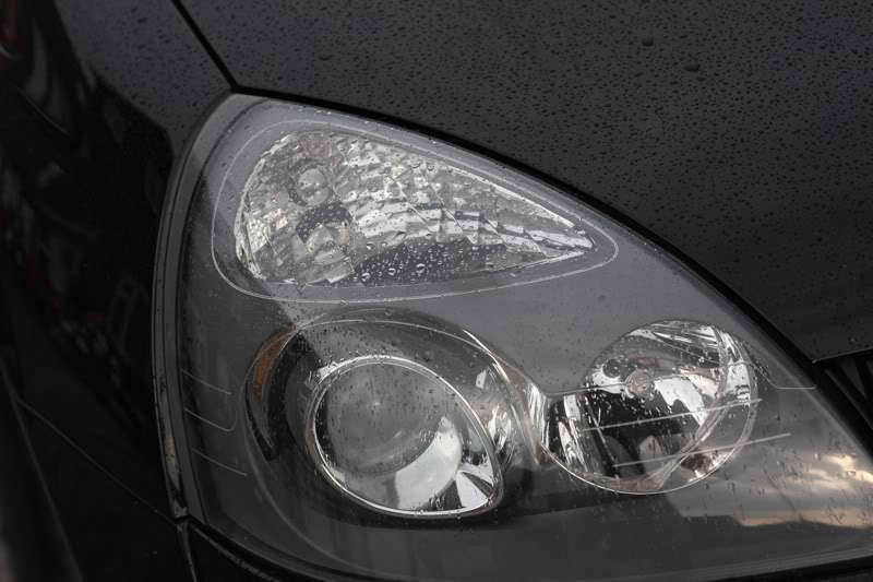

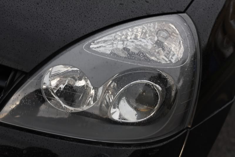

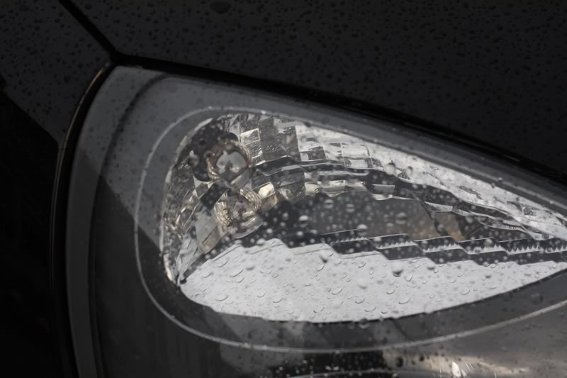

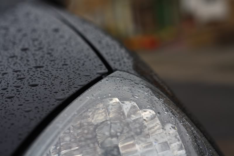

Pics as requested of my results. We've had rain here tonight so nothing special, just ran out with the camera between showers!
