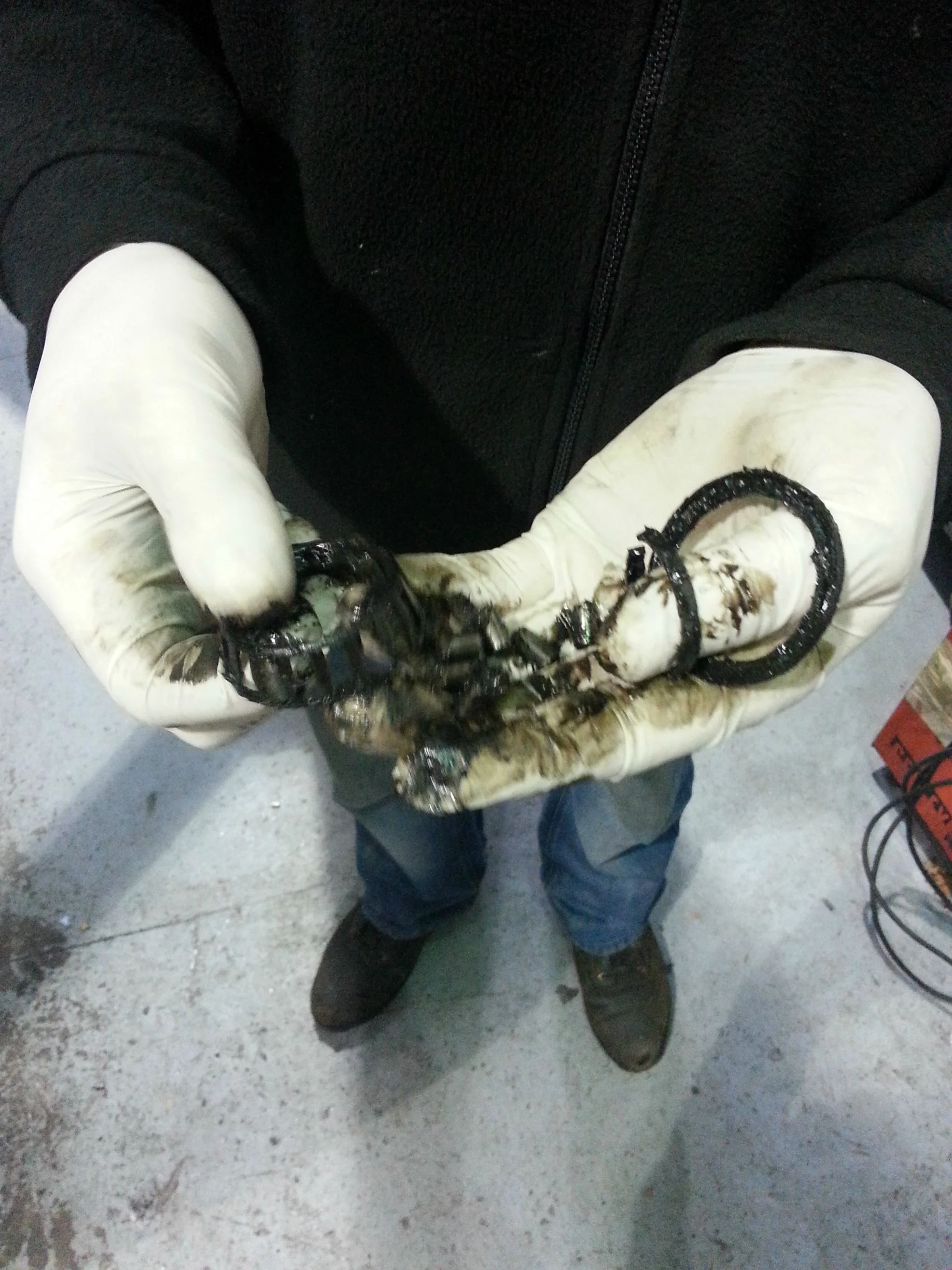

My rear o/s wheel was seized and upon inspection of the drum brakes, it was found that it had seized on and was overly adjusted and completely worn away.

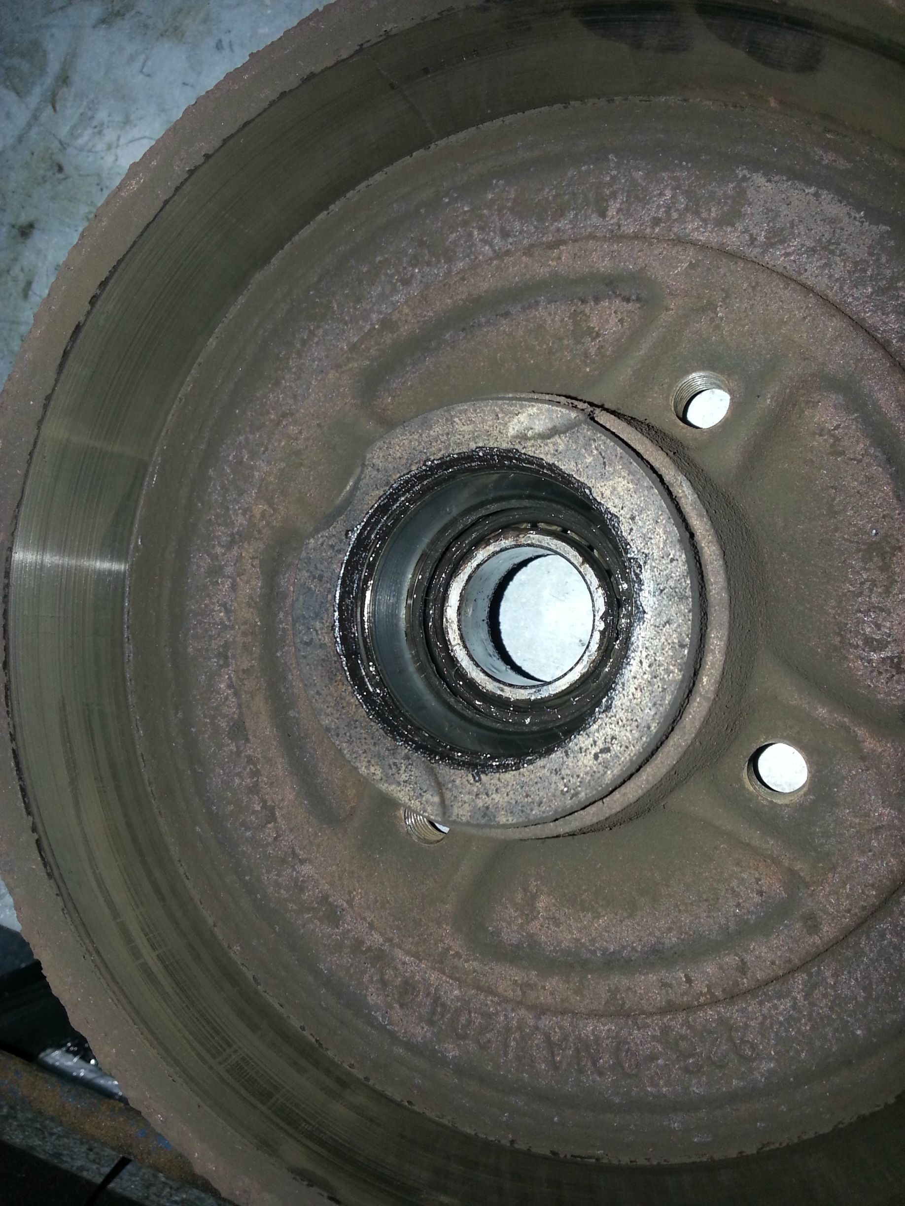

Got the drum removed, and when we pulled it off, half of the bearing was seized onto the axle and half of it was still stuck in the drum:

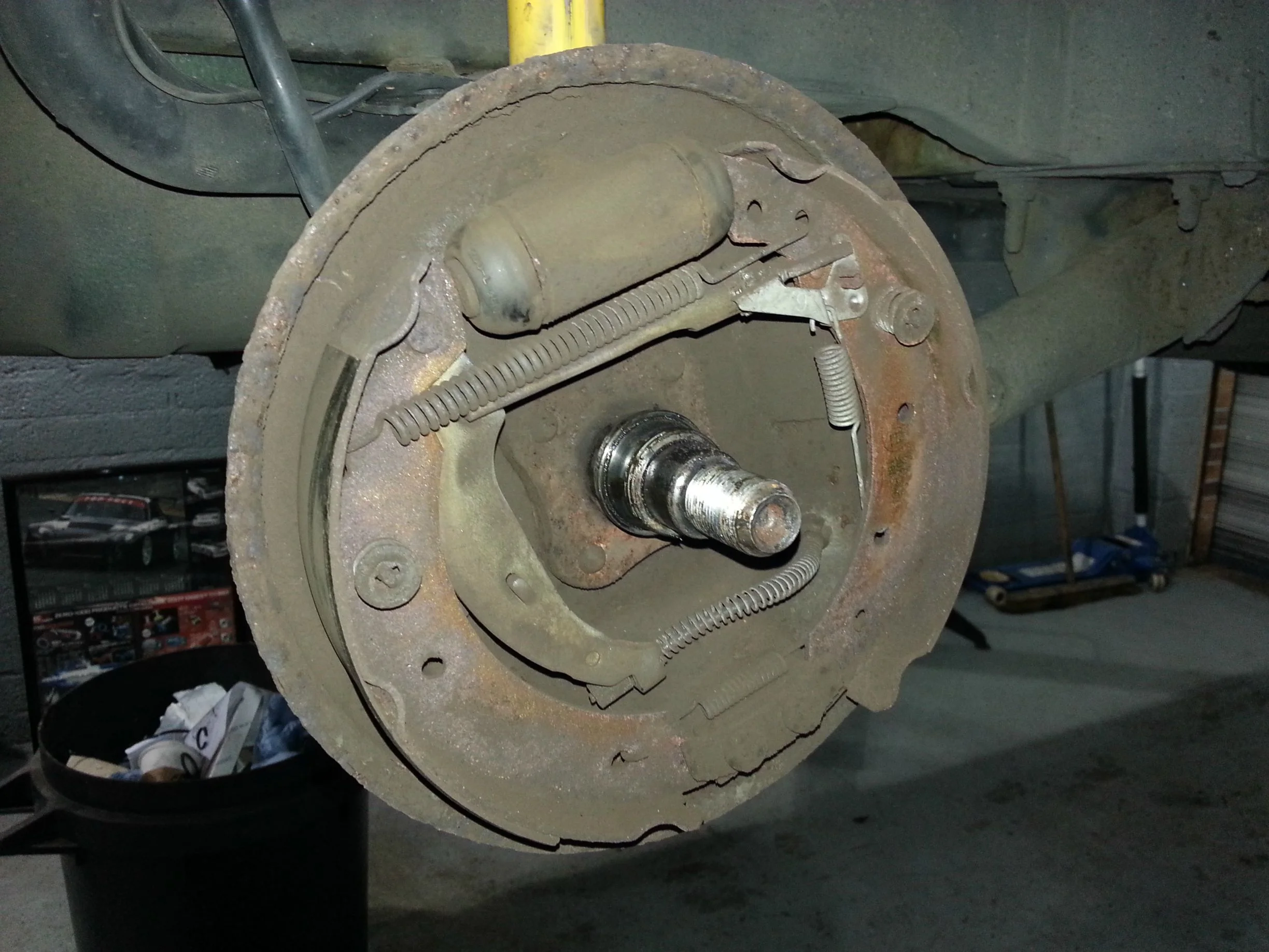

We then went to grab the rest off it off the axle and it just fell to piece in his hands like it was made of wet paper!

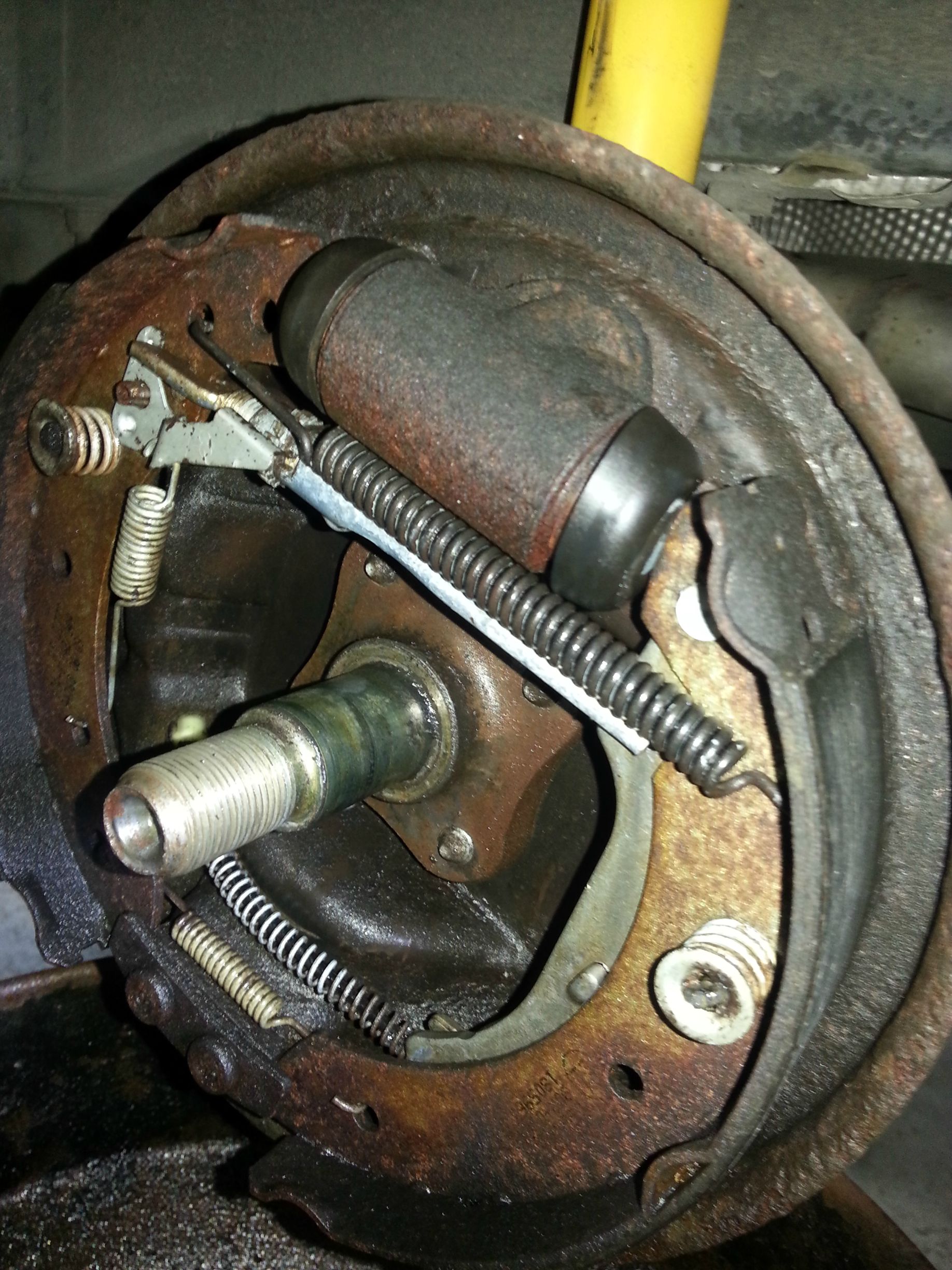

The old shoes were completely worn away on one side, and half worn away on the other. The arm that moves the brake on and off had completely seized.
The other one was cleaned up and checked and was found to be the same, the cylinder on the n/s was wrecked and needed replaced too.

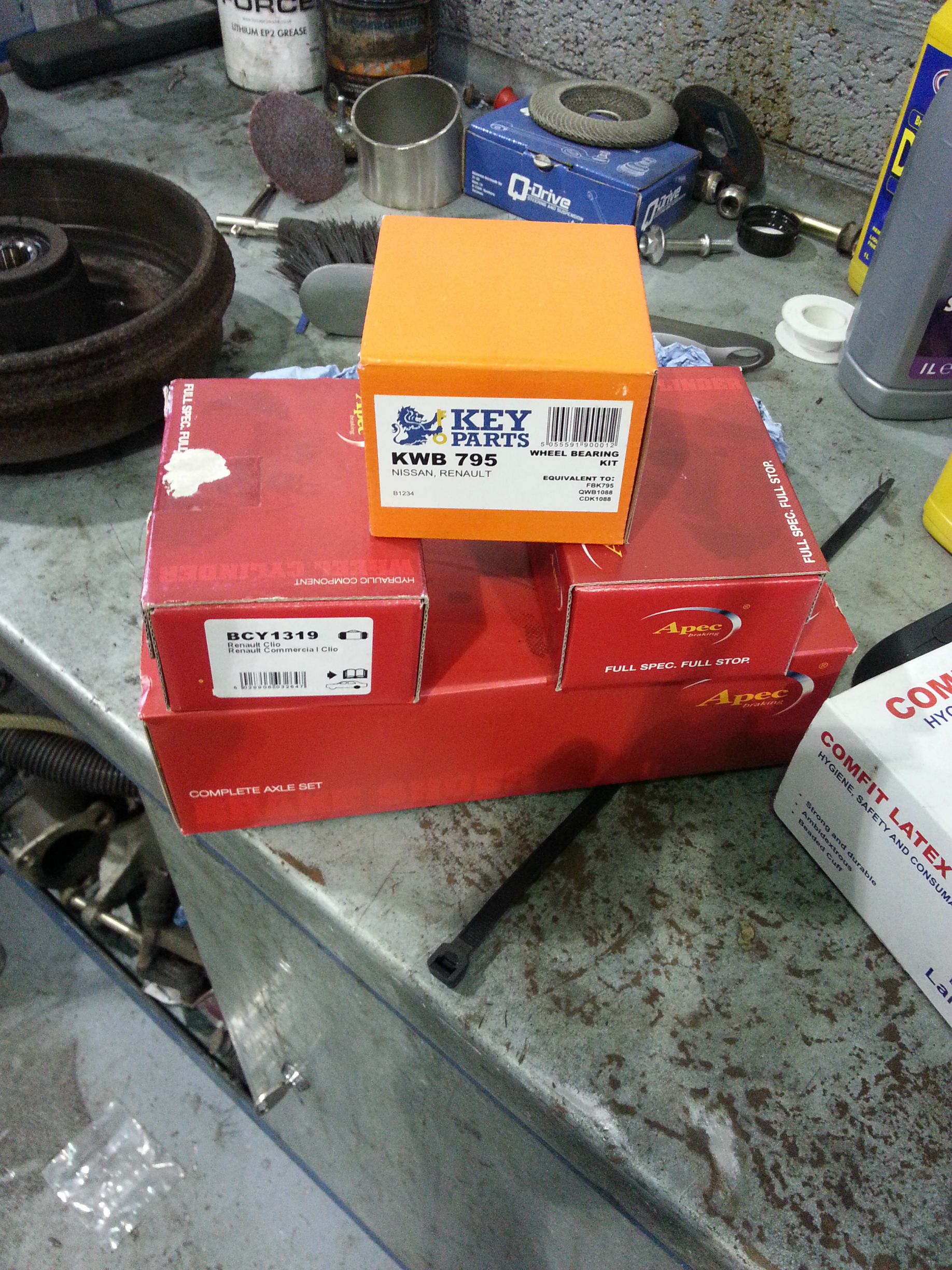

New parts were gotten from the local motorfactors! 4x new shoes, 2x cylinders and 1x bearing.

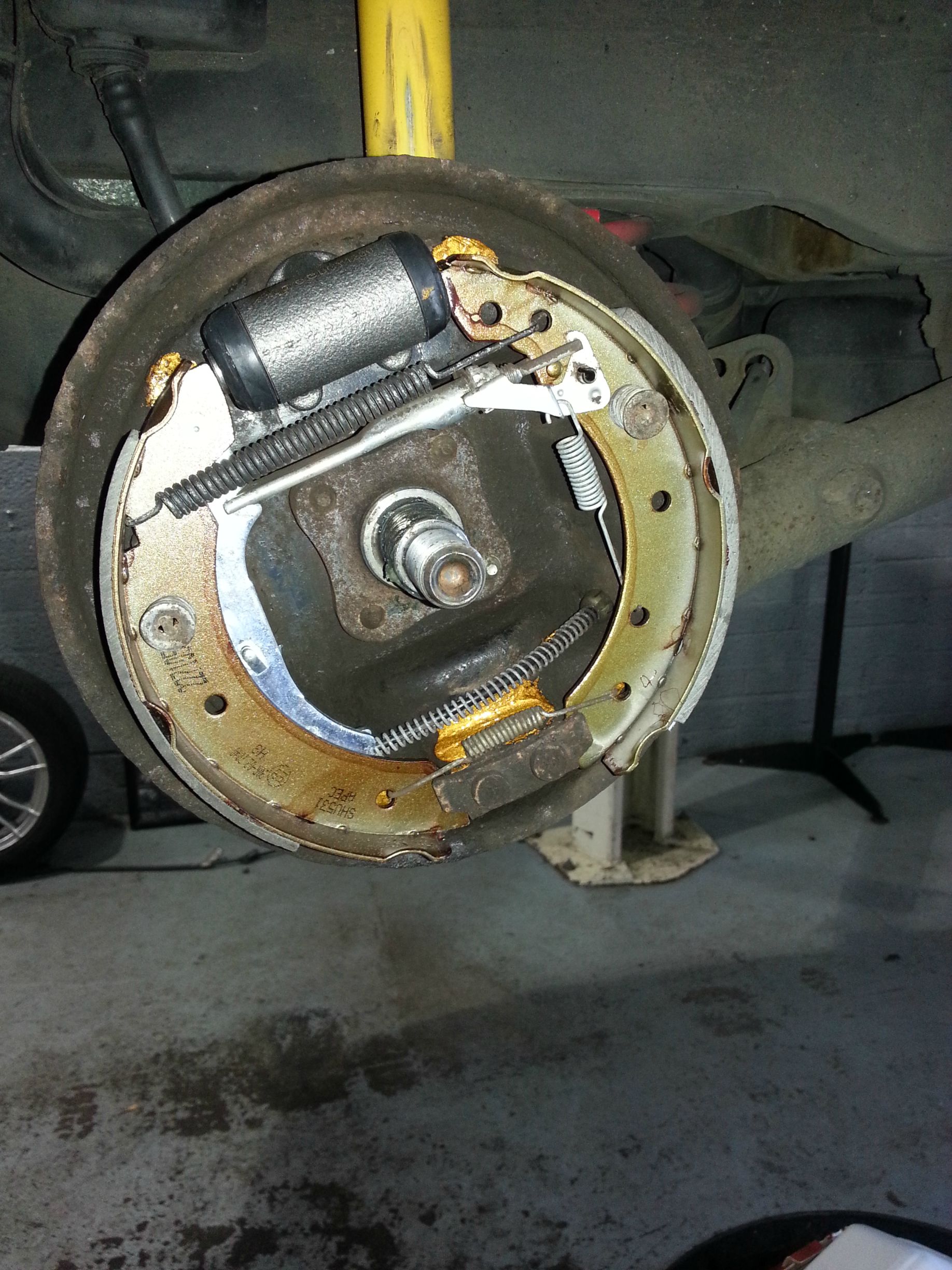

New brakes all put together!
