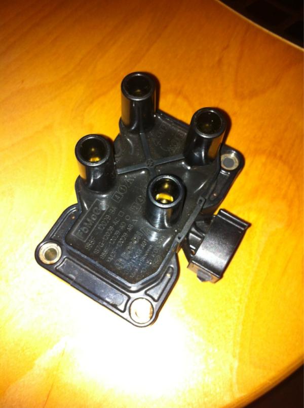

I've just checked mine and the Renault leads fit spot on. The part number off my coil pack is: 988F-12029-AB 9309BA. Worse case scenario is either find one with that part number (you can just make out the number on jays as well in the picture) or just buy some new boots and connectors and crimp them on. You can buy them from vehicle wiring products.
This is the one I have and same design as Fiesta ST coil:

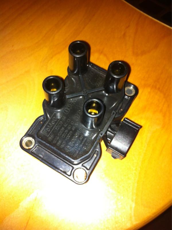

Thats the later one, thats no good. yes the one I pictured is the type we use. We have a Beru one from EuroCarParts.
Fits Ka, Focus, Fiesta, Mondeo around years 1998 to 2006
