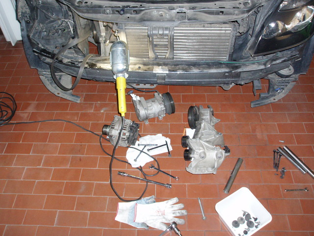

here's some pics of what i'm doing...
Removed alternator from bracket and some AC pipes...
Removed also the AC condenser....and accumulator..
and at last (?) removed AC compressor... bracket... upper pulley etc.. but.. wait!! i need to remove evaporator etc....
so...
some time later...
what a mess!!! :D then was lunch time...so.. here we are!
