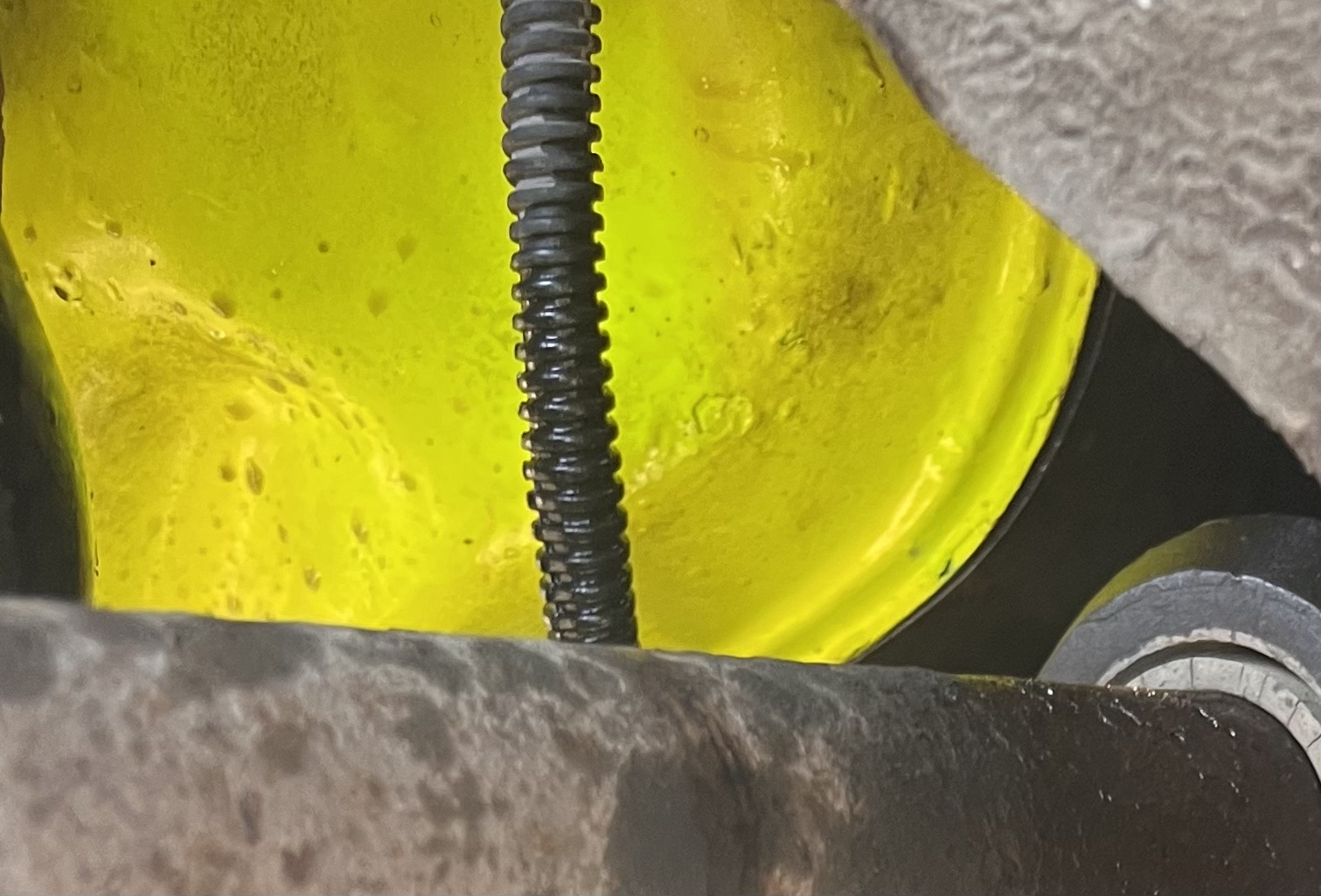

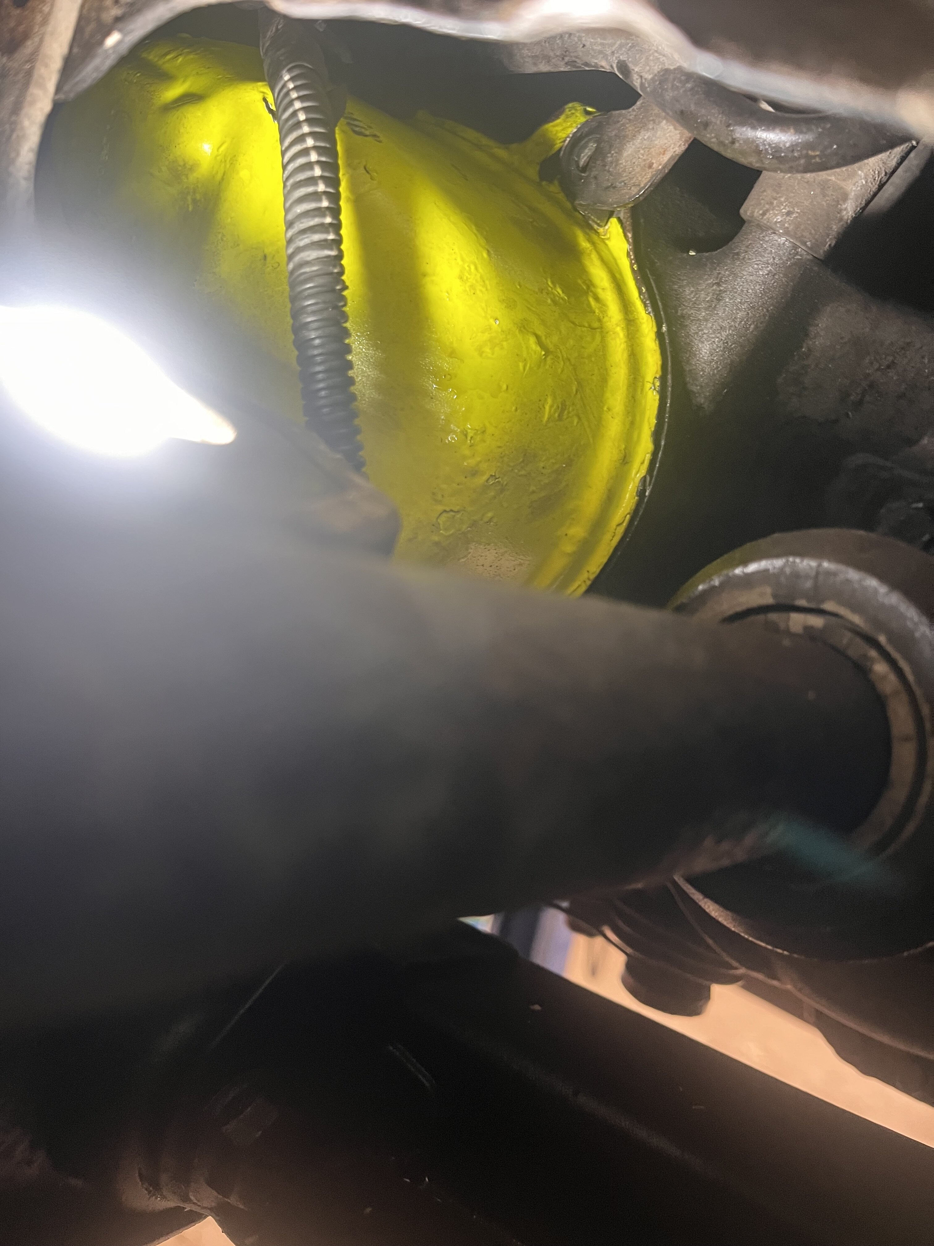

When I did my pads I noticed that the dust seal on the offside caliper appeared to have suffered heat damage and was now holier than Swiss cheese so I had been looking for somewhere to get them refurbed when I came across a set with Dss11.1 pads and HEL lines for good money so though I’d just buy these as a second set and swap them out.

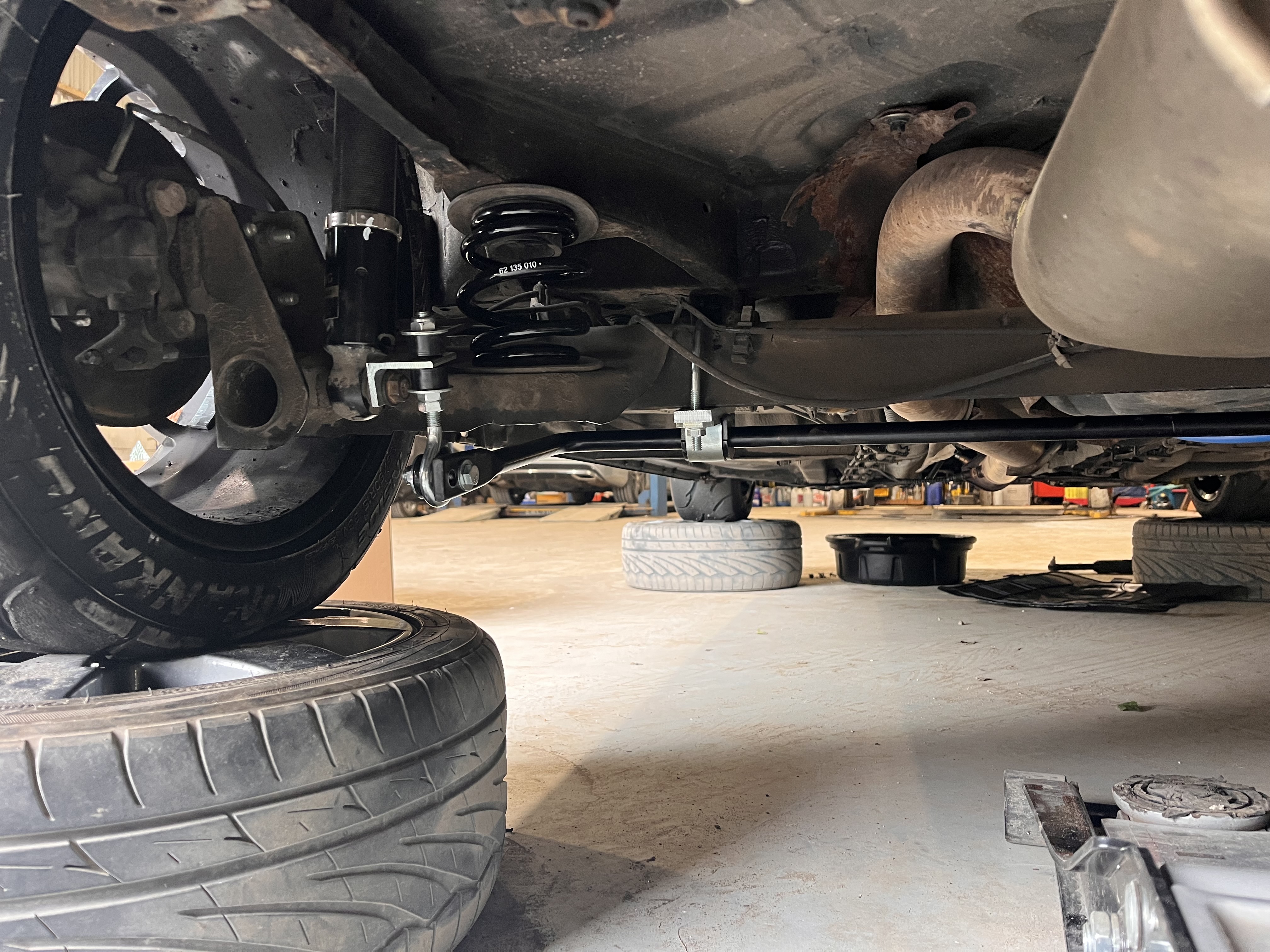

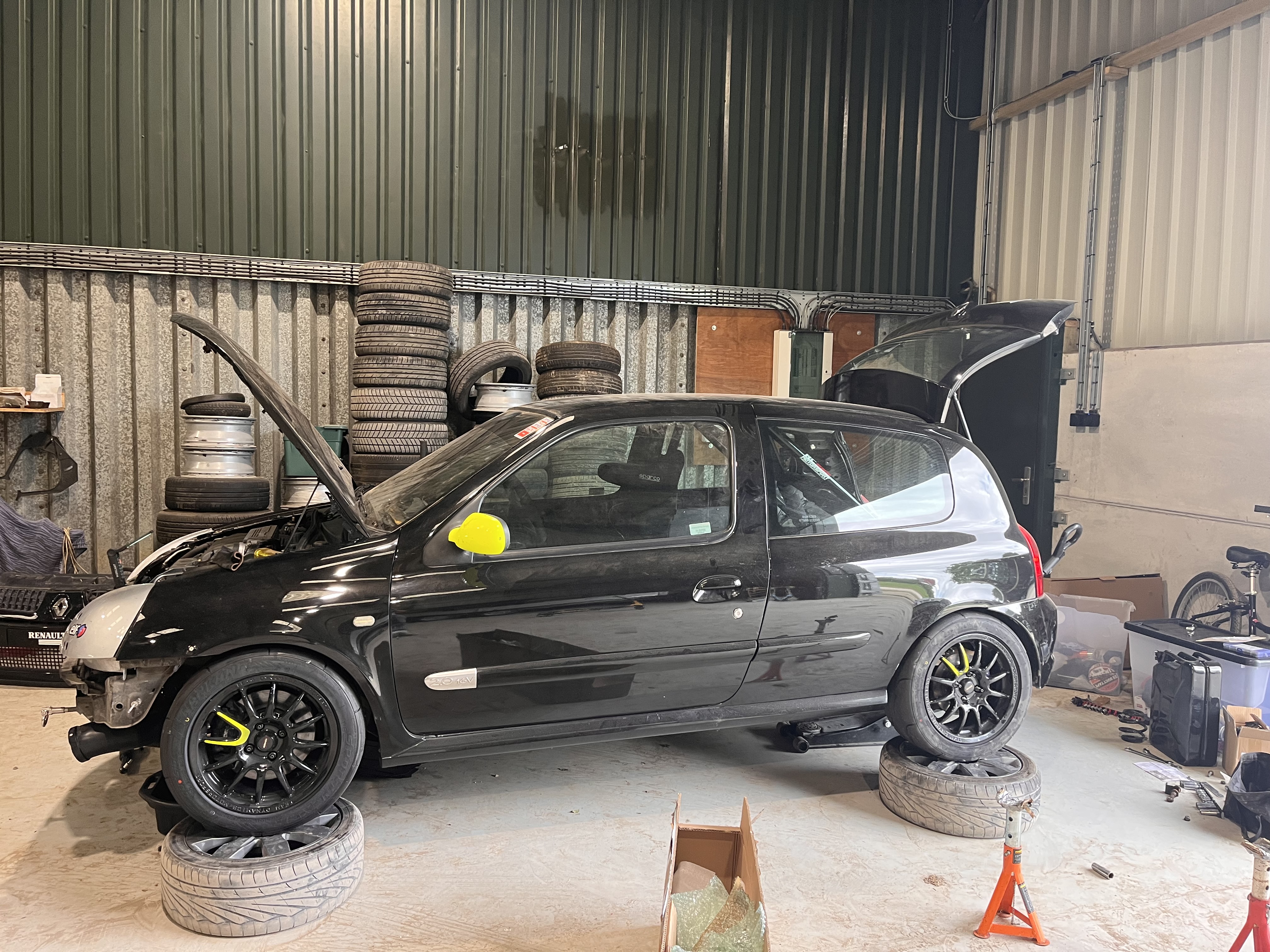

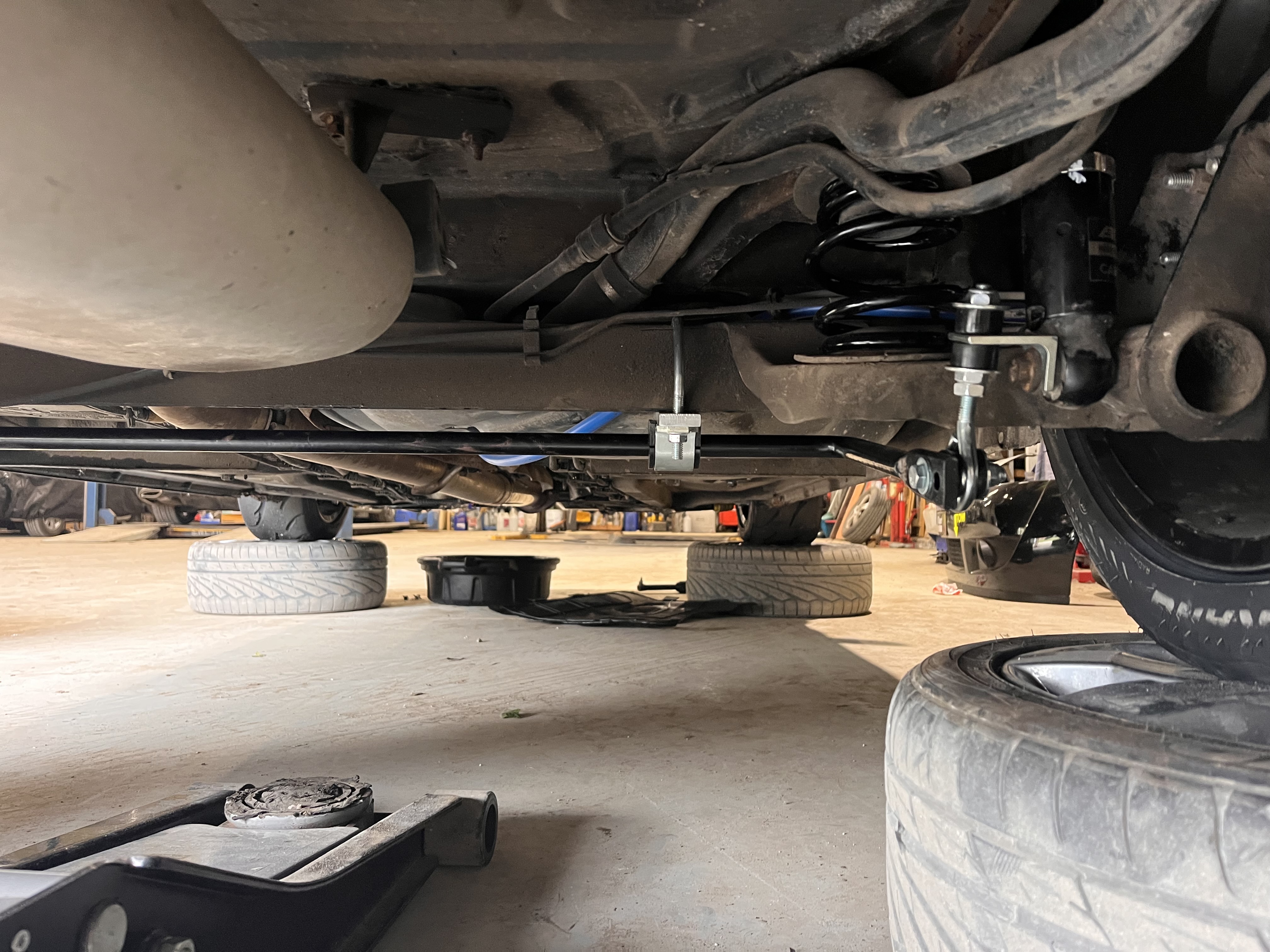

Had some time before the F1 so headed over tot the barn, jobs were
- gearbox oil
- RARB
- Rear Springs
The 4 post had a car stuck on it so had to improvise.
Drained the gearbox oil, well over 2 litres left so maybe 500ml lost when the end cap came loose so happy that no damage will have been done, just refilled it and checked for leaks. All good.
Then set about the RARB and springs? Nice easy jobs and all done, had to adjust the rear ride height as well so all done in a couple of hours.
Not got anything booked in before CSF but might do a cheeky Blyton to see how the car is with a few changes.
something I did notice was a horrible knocking from the rear when I drove it down my mates drive, was worried I’d somehow managed to break the car, but it went away when I added weight (spare wheels and the like) so pretty sure it’s just the rebound needs adjusting after adding the heavier springs. Think it’s springing back up a bit aggressively.
Make sure you've properly tightened the bolts through the shocks
I find it takes a bit of fanangling to get the mounts right but the correct torque on the bolt (5 ugga duggas)
They’re right, 5-7 ugga duggas. Getting thr mount right was a bit of a pig as you say but double checked the torques on the bolts. Think it’s its springing back a bit quick with the heavier springs.
