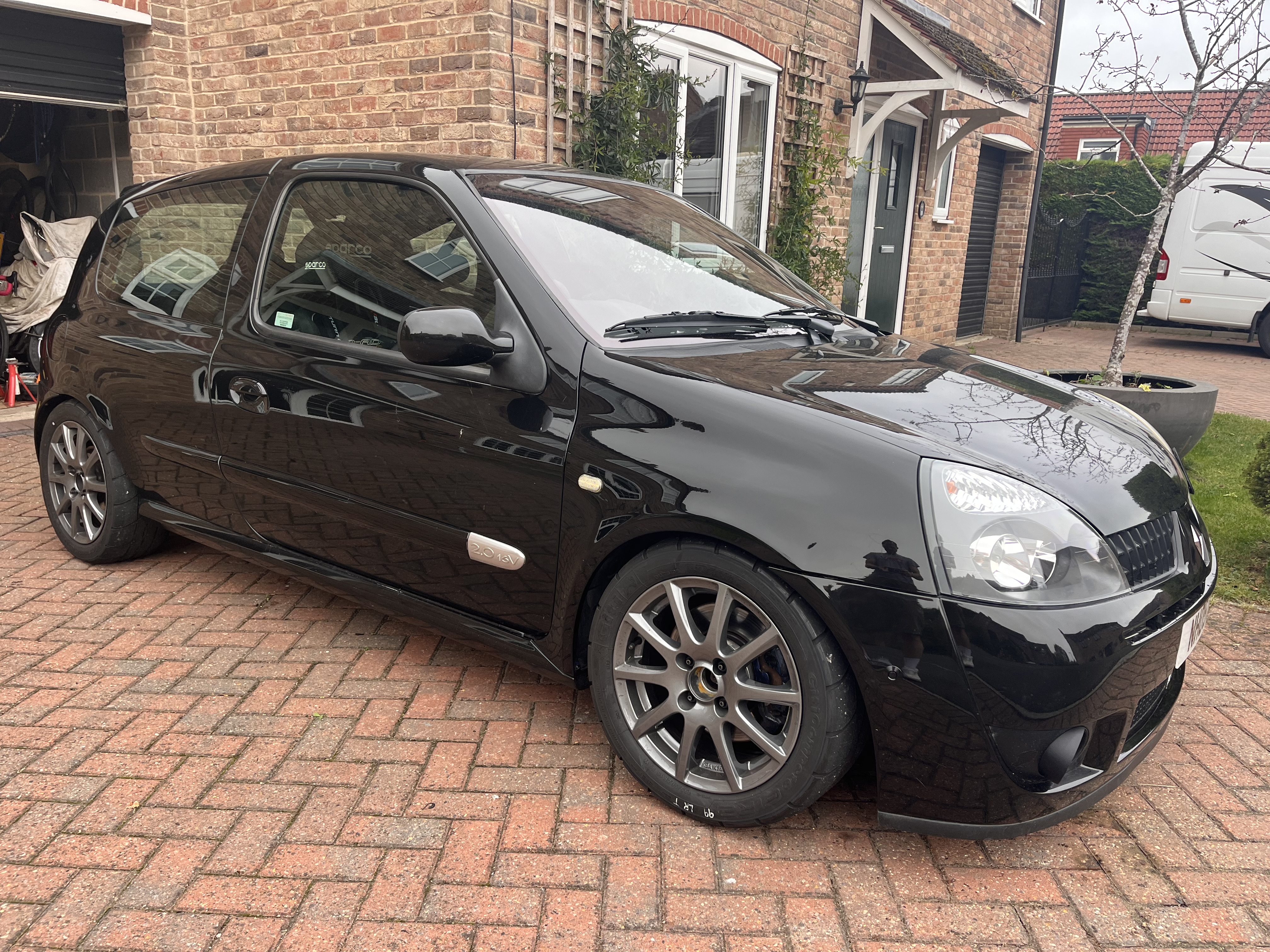

At last some pics and the start of my (probably slow) project thread.

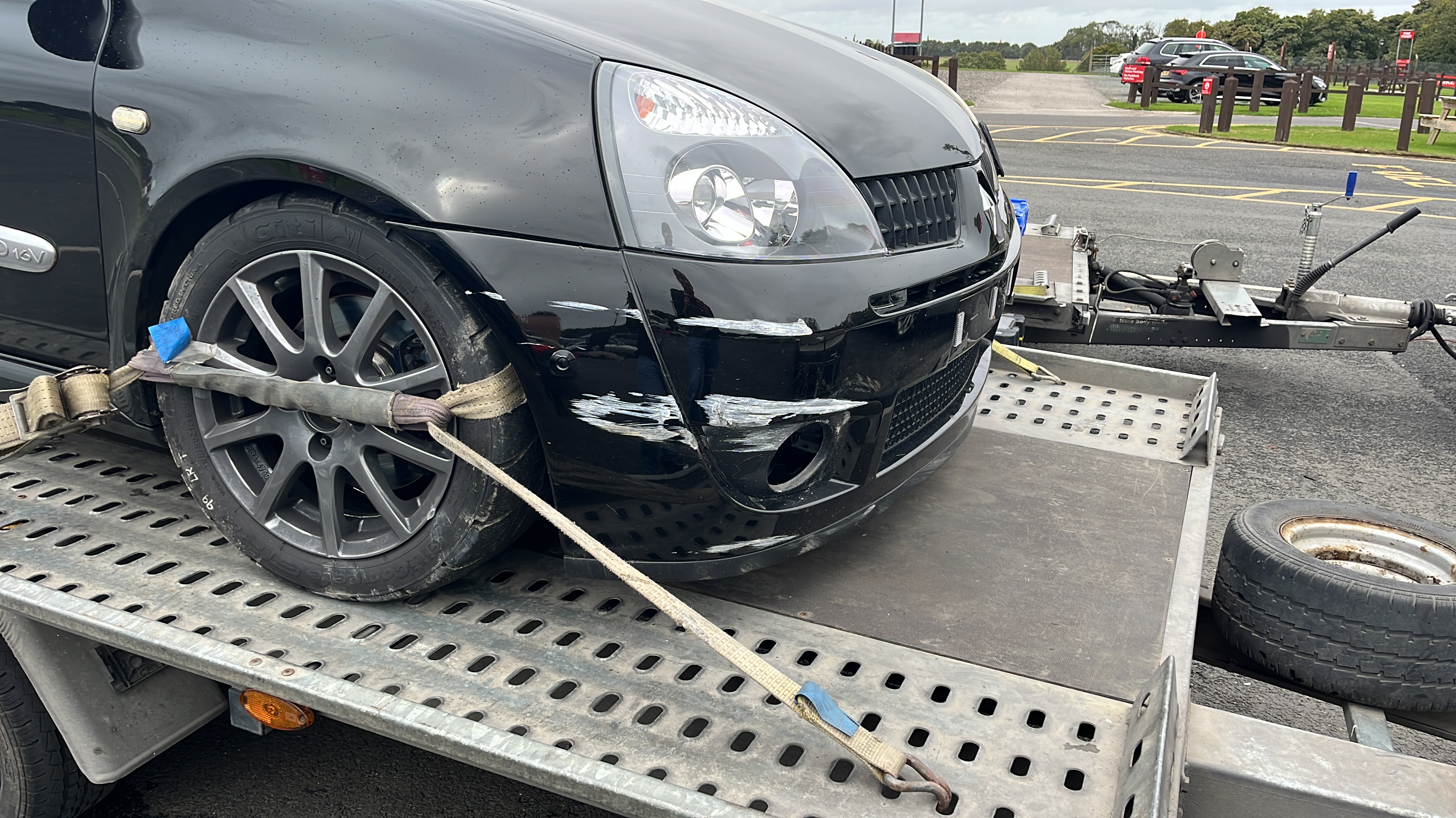

Picked up with limited history but from a friend who’s spent £1400 on lots of new bits like brakes, calipers, clutch, exhaust etc etc only to get a mk3 and sell this one.
I got it at a fair price but it needs some love as you’ll see. My intention is to not modify it but maintain it as stock as possible with some minor mods that I think really benefit the overall car.
I’ve done this before and termed it Stock+.
To first part will be to get and fit the missing bits, like the 182 steering wheel and gear knob, then sort out some odds and sods that are broken as well and deep clean it, as it’s pretty grubby.
Having been over it with my paint depth gauge it’s all original it would seems which is good, there’s some age related marks on the Bodywork that I’ll fix and the interior is, in places disgusting, but more on that to follow.
Here’s some pics to start with,

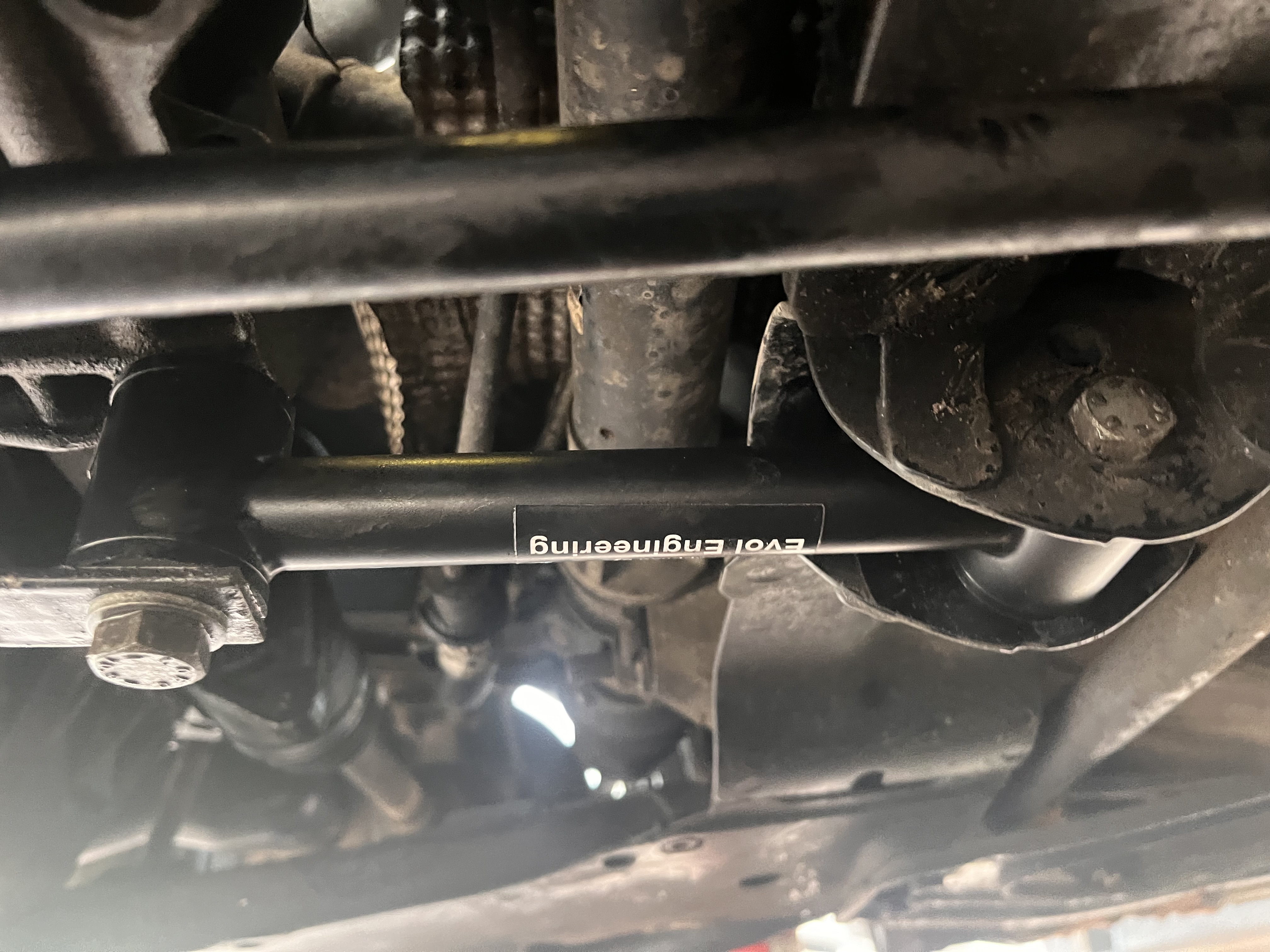

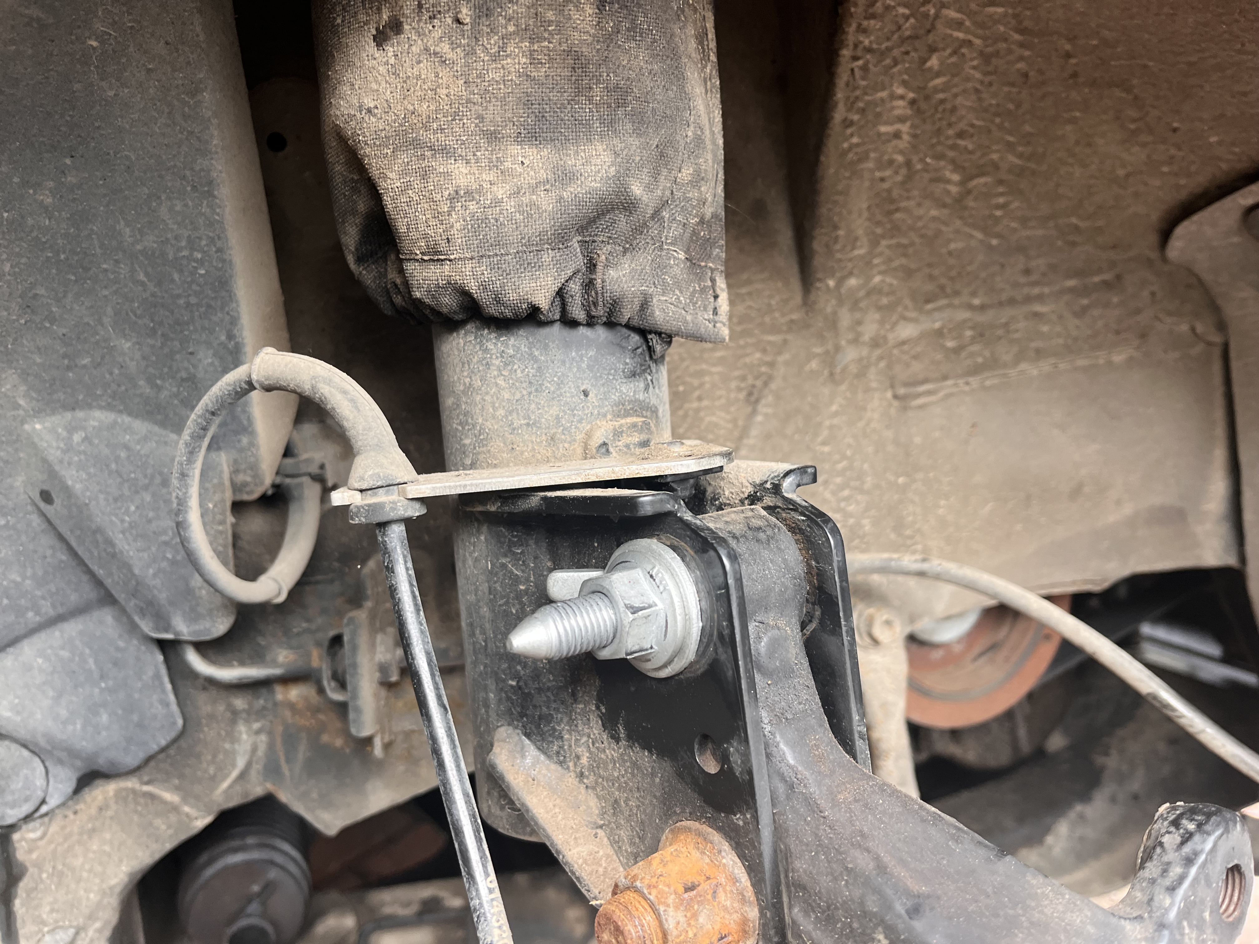

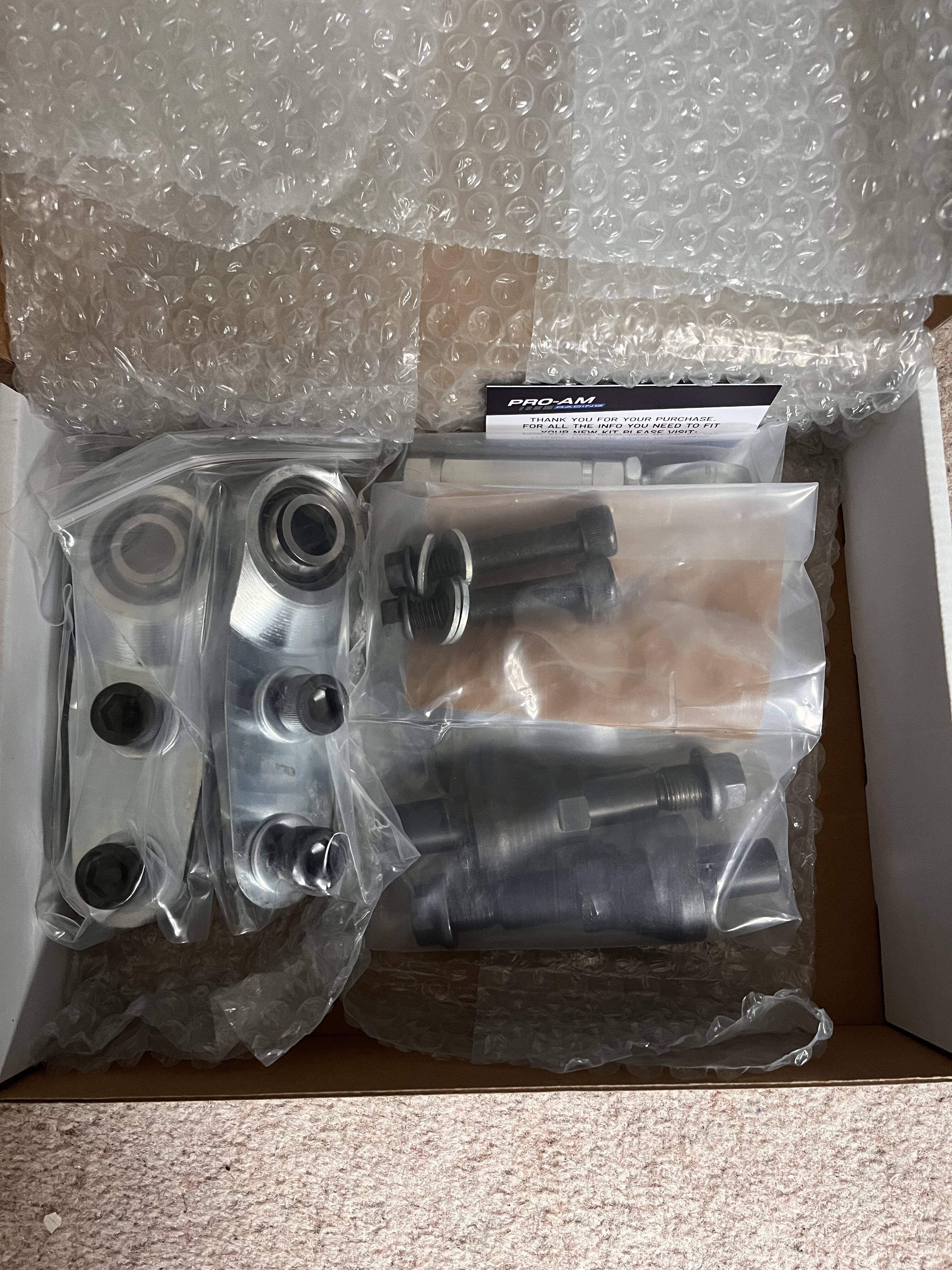

Before being ‘that guy’ have Proam sorted the issues out with their bump steer kits?
I know of one example involving a particularly rusty Clio. The hubs on this car were in such poor condition that they seemed barely capable of handling a standard ball joint, let alone a roll centre correction kit.
Shortly after that, Pro-am updated their roll centre pins and sent me a new set. I used the original pins for two years, spanning around ten track days, without a single issue.
When I sold my Clio 182 to someone participating in 750MC events, I included the new mark 2 pins and explained the history of the initial versions.
About six months later, the new owner contacted me, saying the pins had snapped during a track day. From what I gathered, he had hit a speed bump on his way to the circuit, and I’m not sure if he ever installed the mark 2 pins.
My new track car now has the latest MK3 pins, which appear very robust.
I keep up with Pro-am's progress and occasionally meet with them at race circuits. They use their own kits and, to my knowledge, have never had one fail.
I mentioned to the OP about the Pro-Am kit and made him aware of the history but also passed him Allan at Bridgecraft's email address.
Should have got a Bridgecraft kit
I based it on the a few comments made either way.
I could send this back as I’ve not opened anything if the consensus is the Bridgecraft kit it better but I did raise an eye brow when. You said he hadn’t contracted you back as I’ve had enough of bad comms. The ProAm guys seemed fast to respond when I asked them about the kits.
Following this with interest, I've always said I wouldn't get a kit because of the wear of the bearings, doing 3000 road miles a year, but reviews on handling are so overwhelmingly positive I might budge..
I’ll let you know if they snap and I spear off into a cornfield somewhere
I hope not for you! Rather hear it's not worth it though because it'll save me £600 😂
I’m not sure I’d fit one on a road car, well I know I wouldn’t, but for circuit use it’s one of the best bits of kits you can fit. Even better when used in conjunction with an LSD/Gripper.

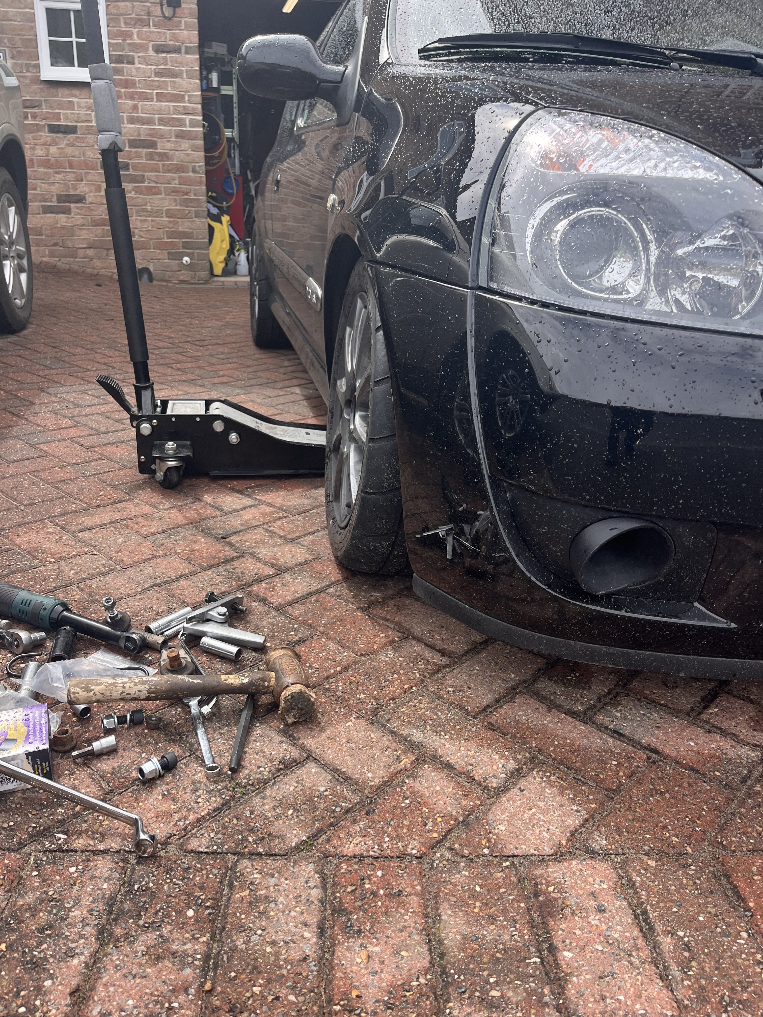

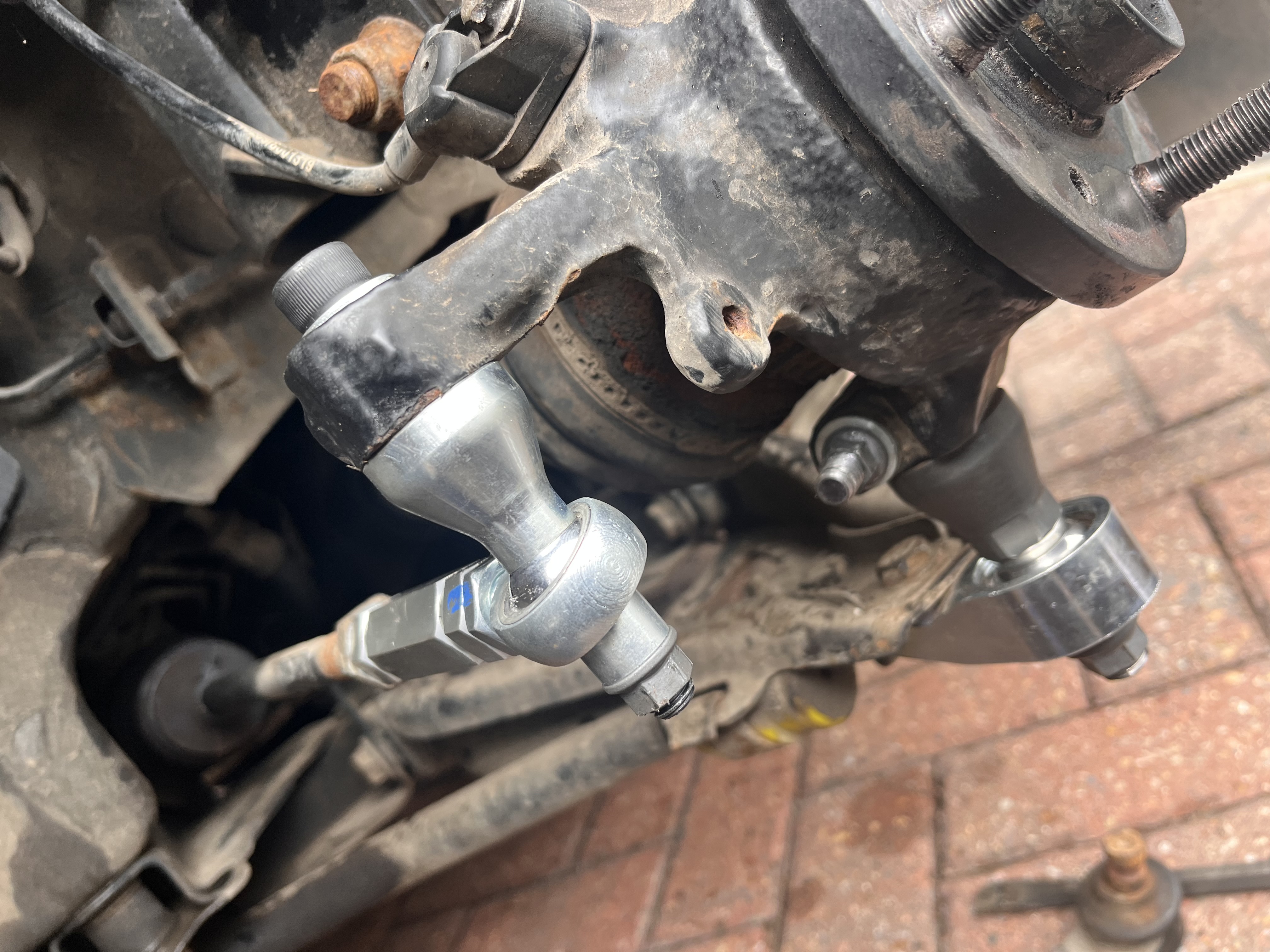

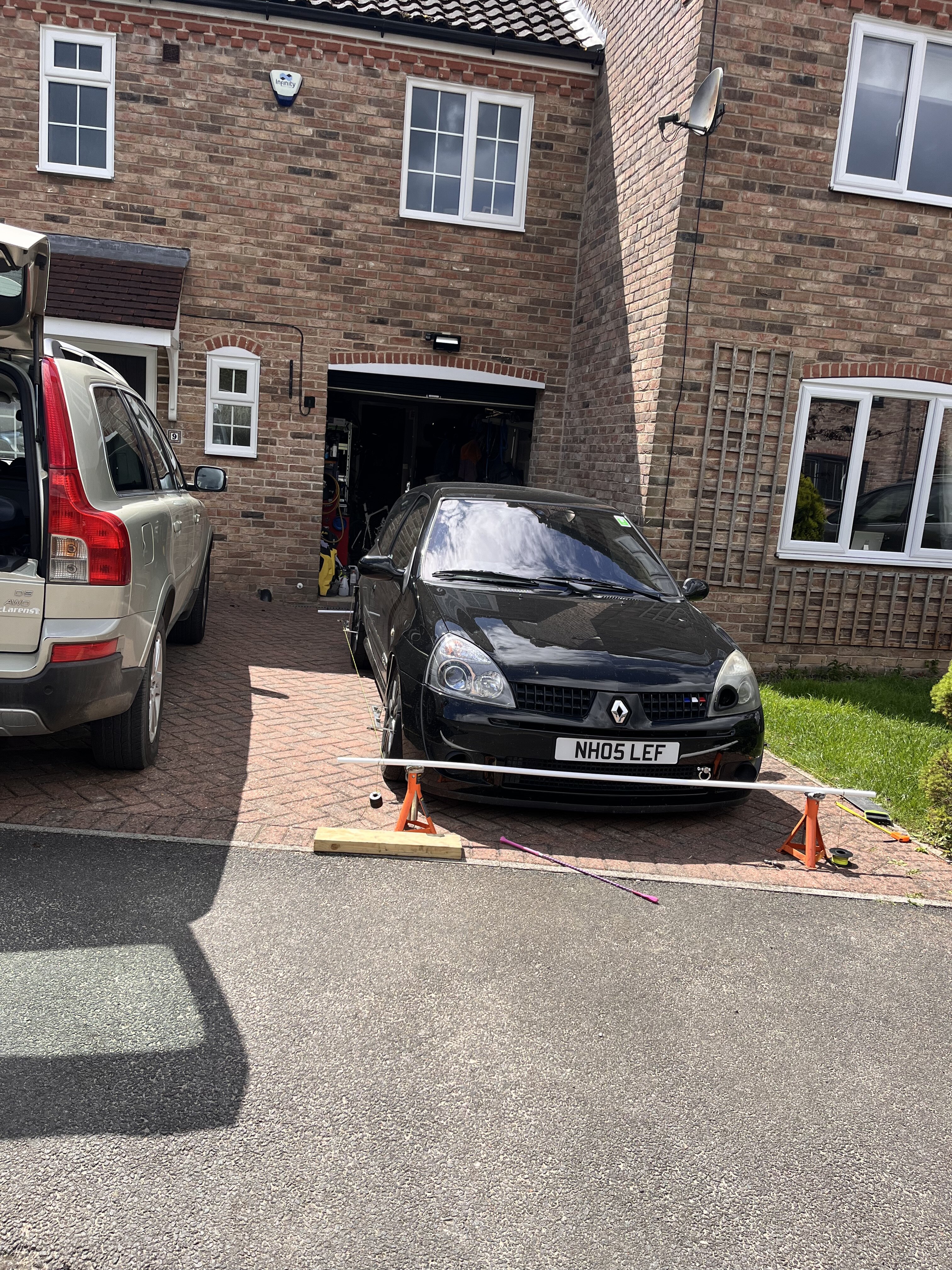

Roll centre and bump steer kit fitted, waiting on a 22mm crowd foot to do the final torque settings but all good to go. The camber bolt added as well.
Totally pointless and inaccurate measurement of the camber is not at 6.5 degs so I’ll need to pull it back in a bit I think.
Some of the worst photos, but it was raining on and off so just wanted to get it done.

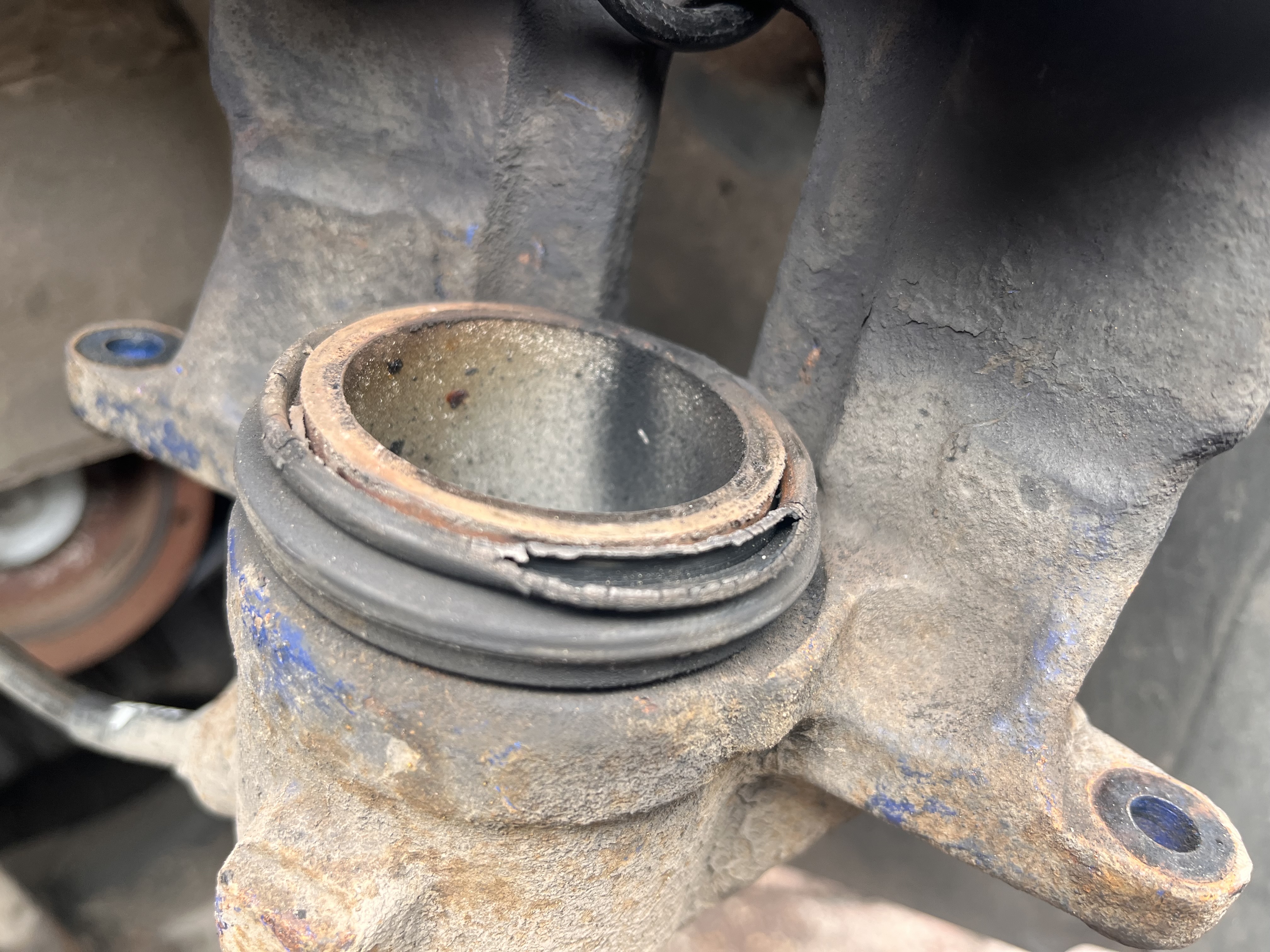

Also found a split / melted boot on the caliper piston so I’ll need to sort that at some point. I’ve got another set of these calipers that I might refurb and just swap over.

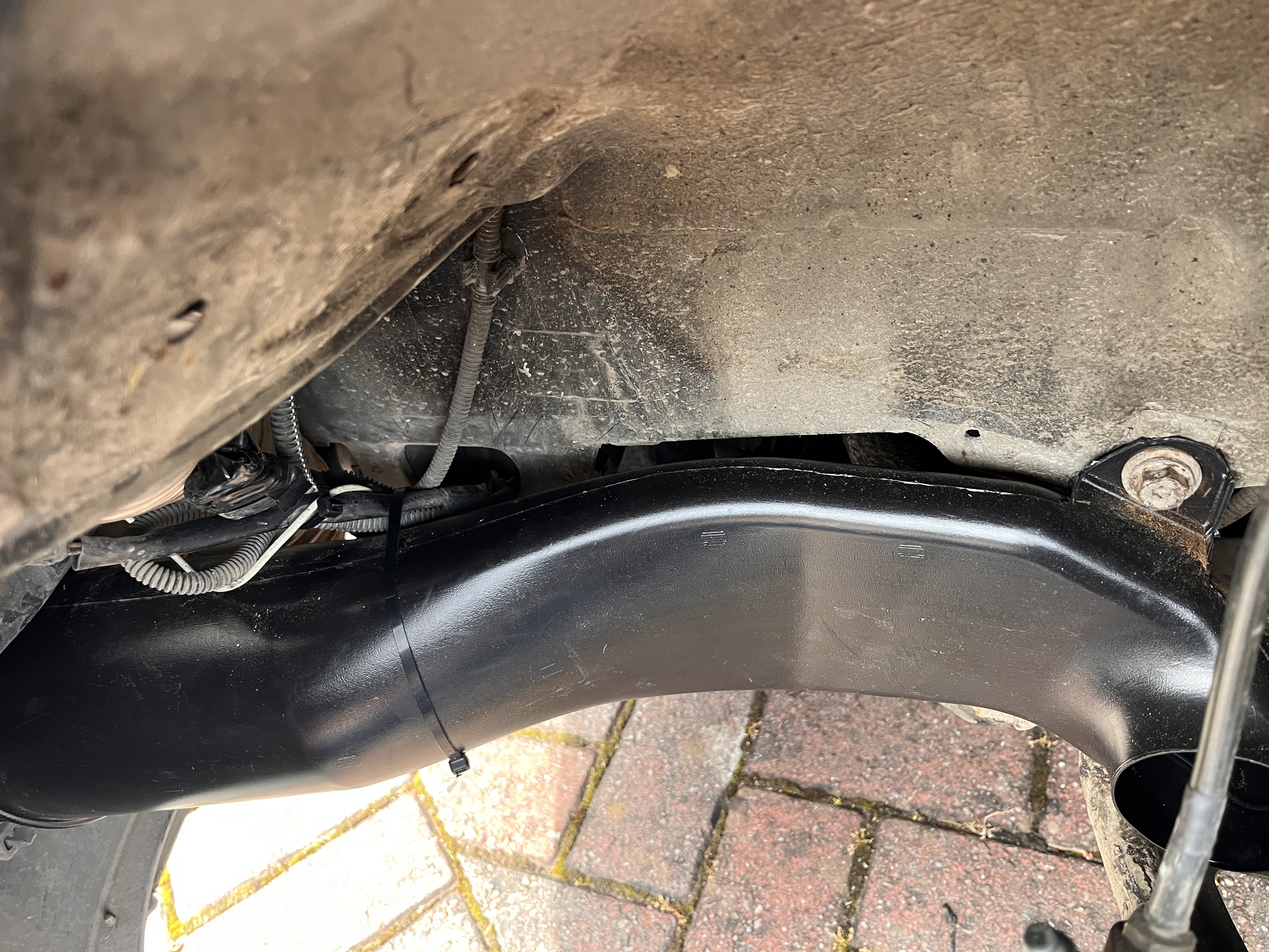

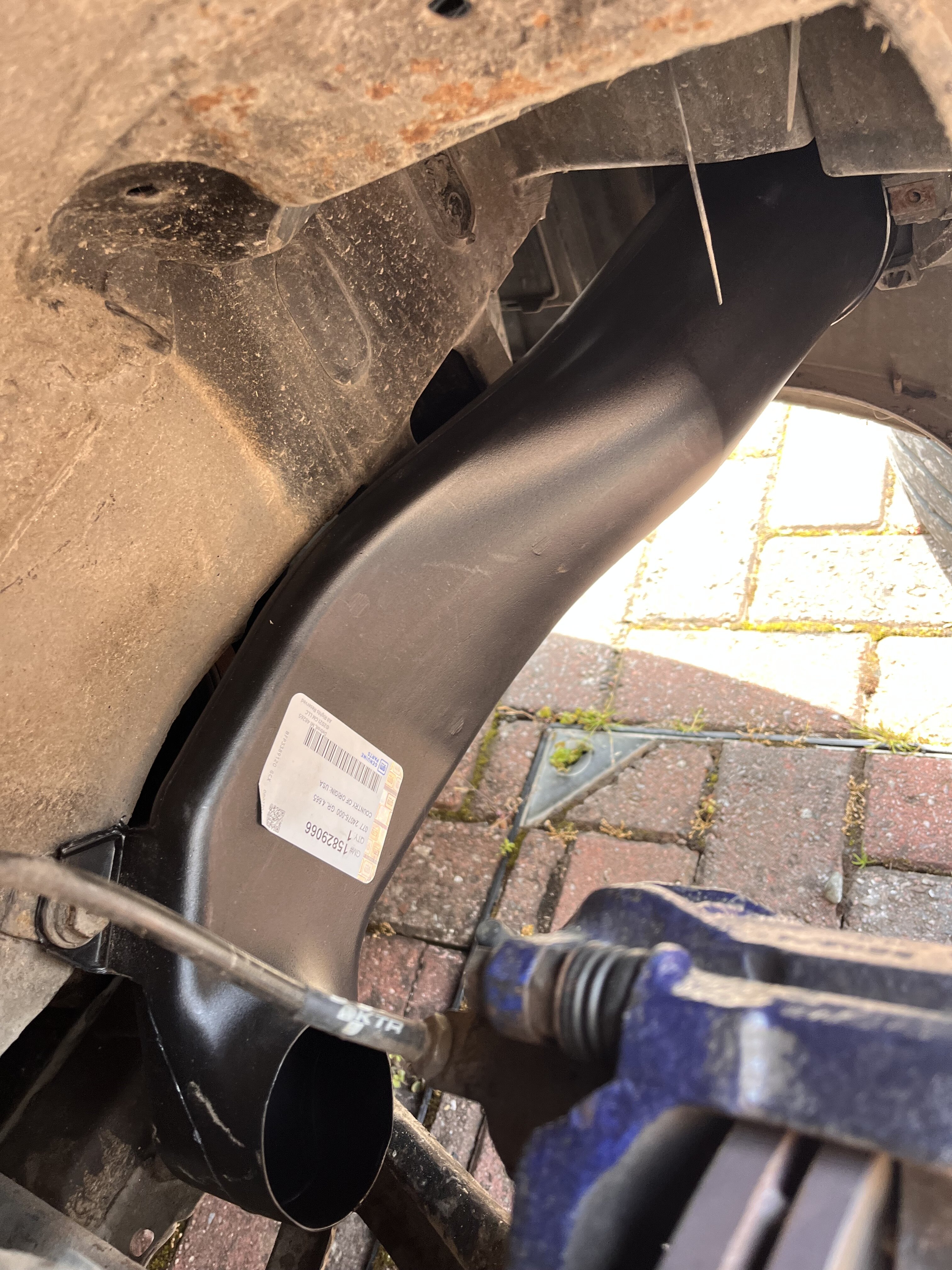

Blyton yesterday. Car was great again, although towards the end I was getting some clutch slip going from 3rd to 4th so I’ll keep an eye on that.
The changes I made really helped the car and given how hot it was the @FrogJam Motorsport corvette ducts worked well with PBS brake pads and I never suffered any fade.

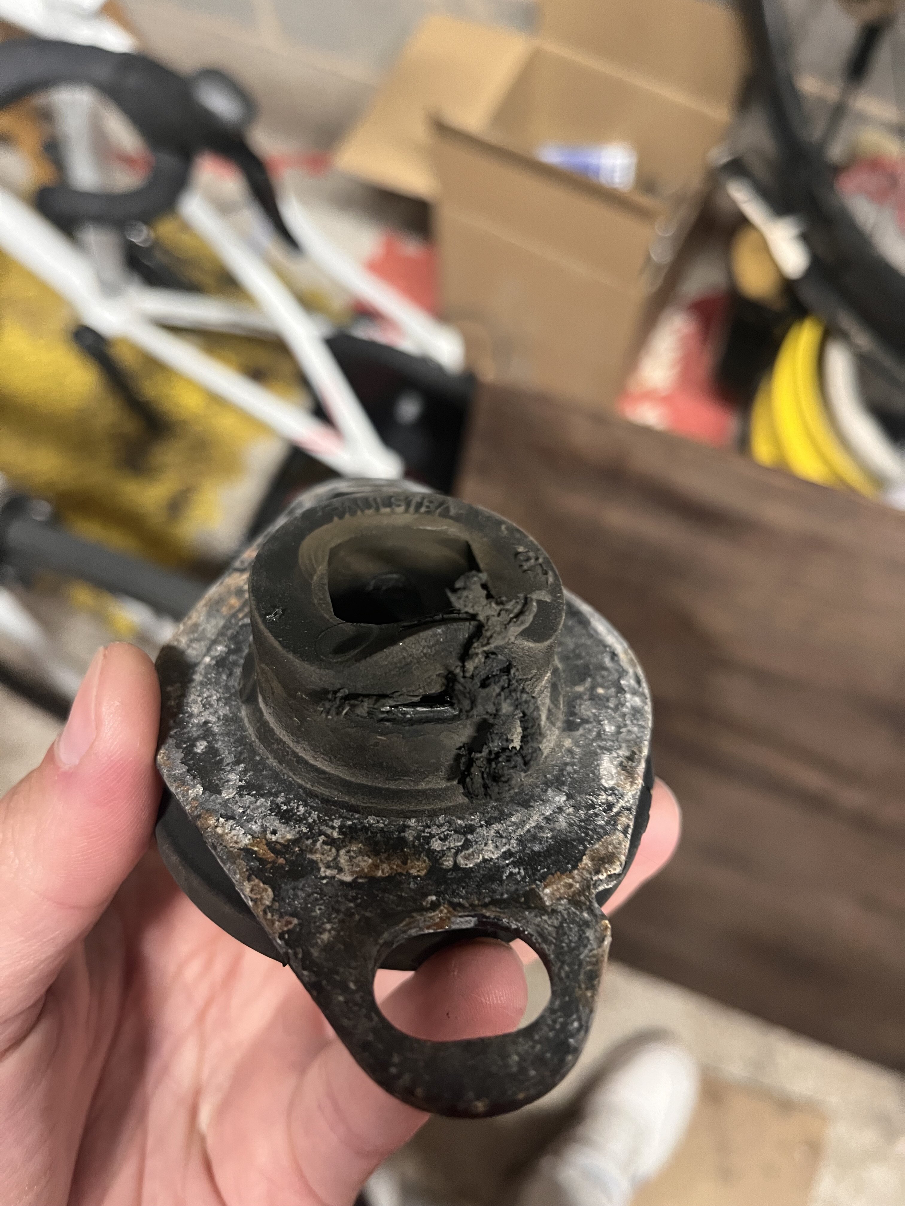

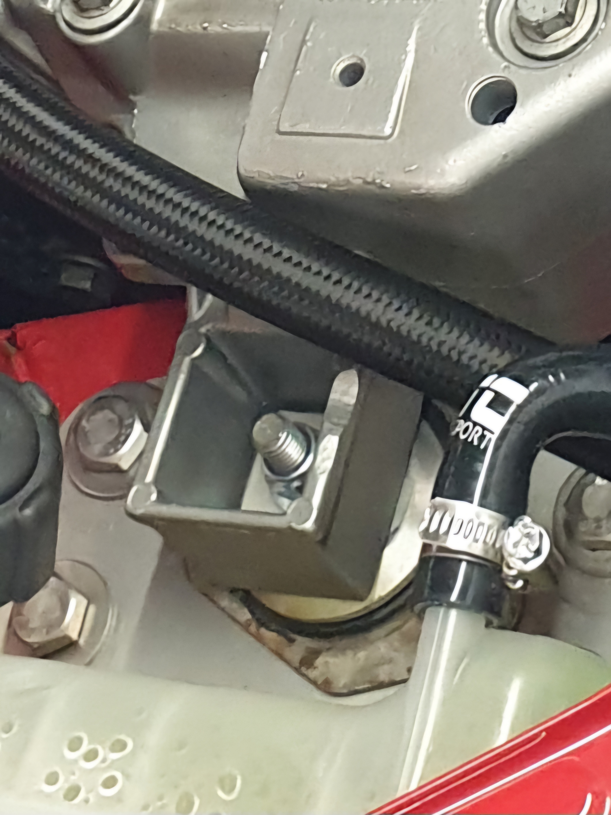

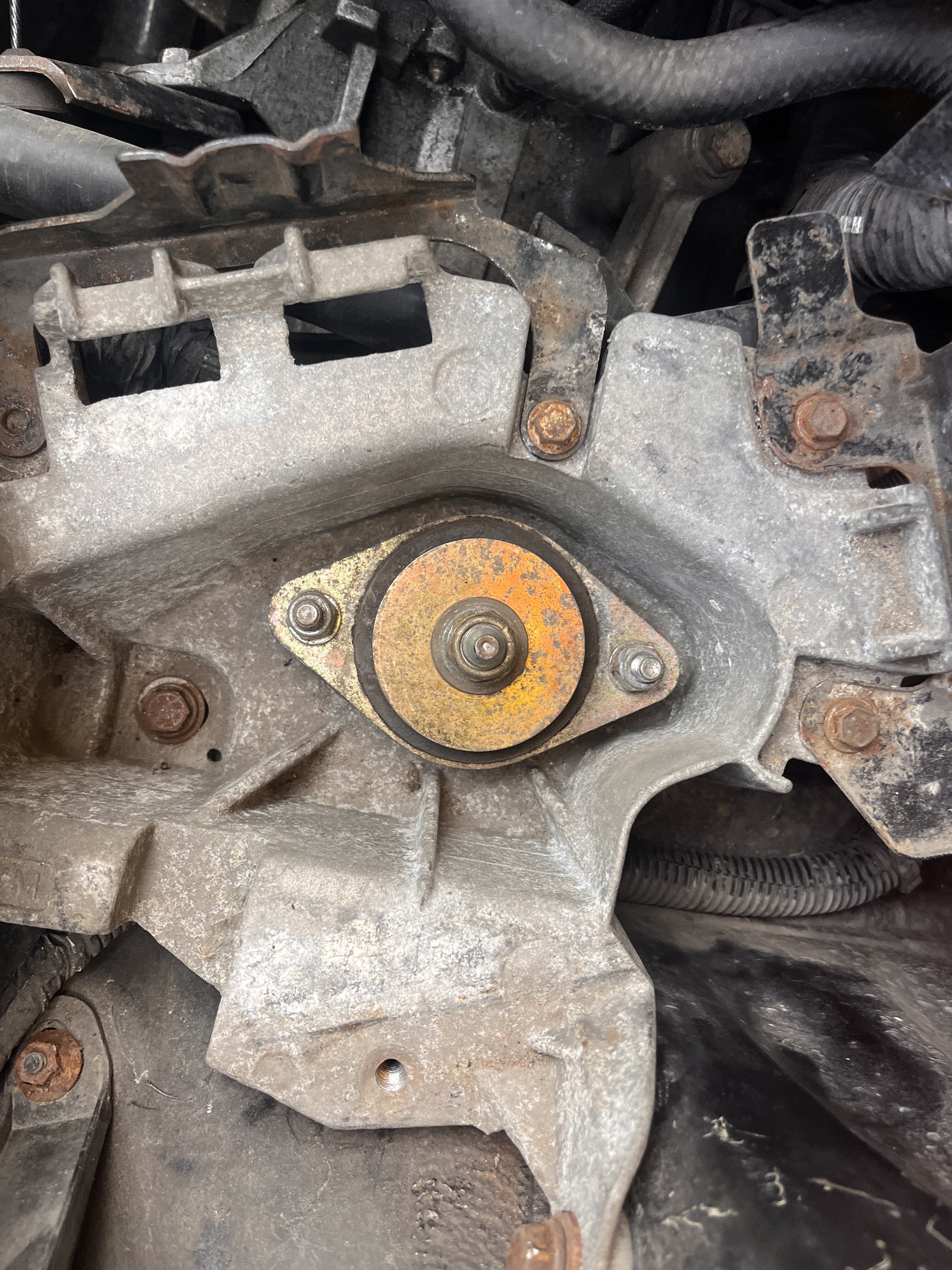

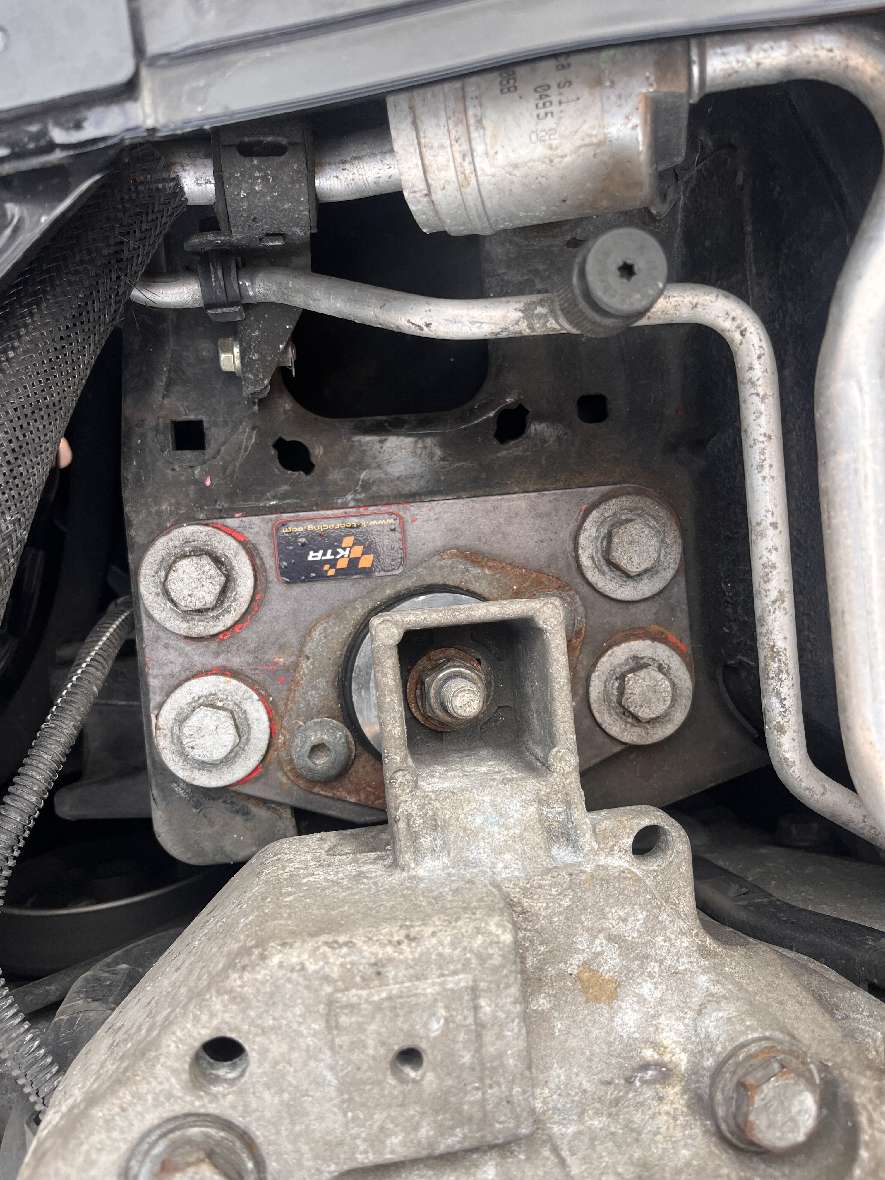

- Replace all the engine mounts with "solid" mounts, having read about the gearbox one im a little apprehensive about doing it in case I snap the bolt - advice gratefully received.
- Add some toe out to the rear axle
- Tracking (again)
- Might take the passenger seat out as no one ever used it.
Edit - Also hard wire my GoPros

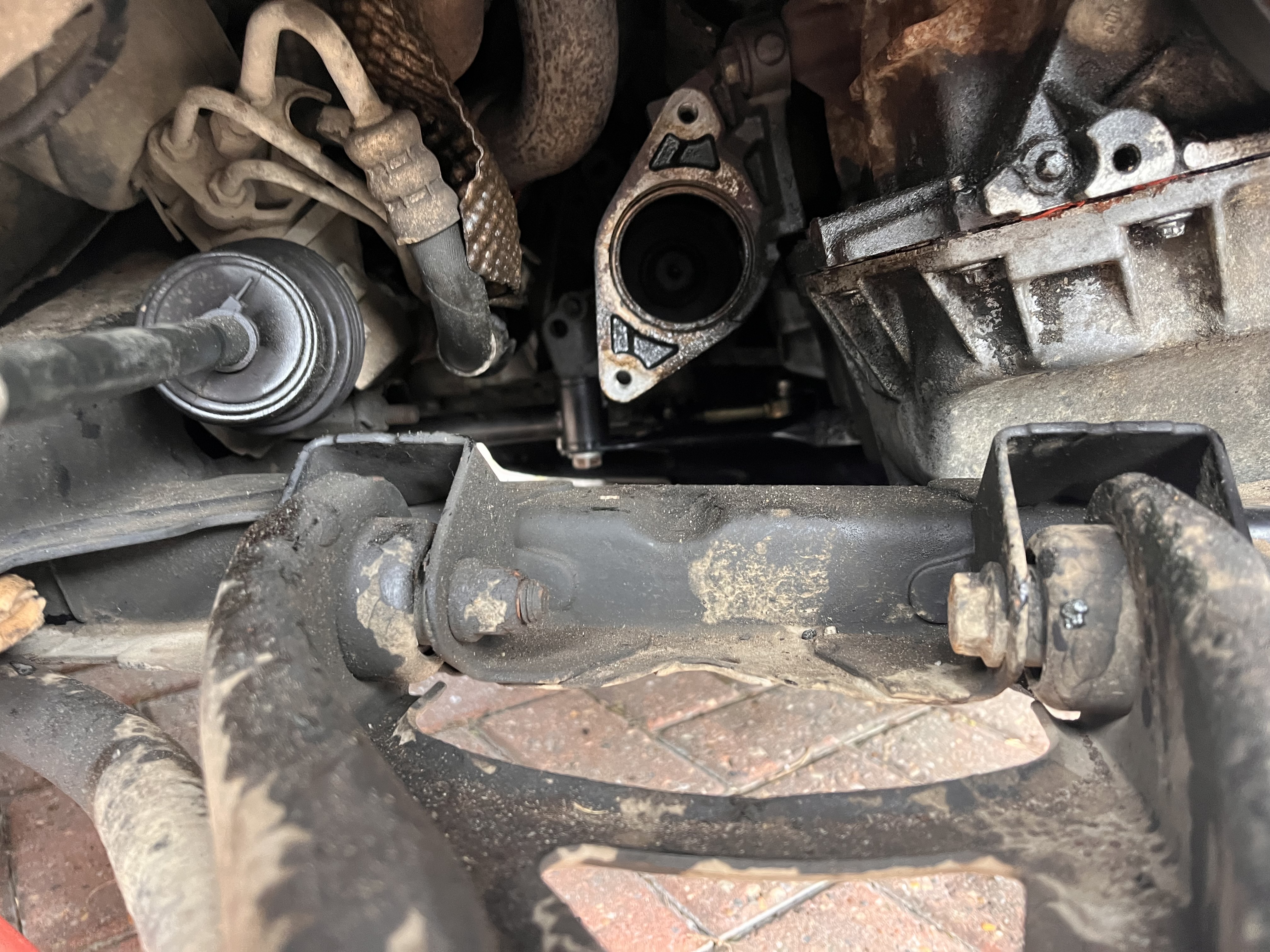

Engine mounts are an easy swap, nothing to worry about regarding snapped bolts.
This is true! I was really easy, biggest pain was the rear gearbox mount bolt won’t come out without removing the whole spider thingy so just wasted some time doing that.
So all solid mounts now, I’ll probably tidy up the engine one as it’s not very pretty to look at, but that can wait for another time.
The gearbox mount wasn’t in the greatest shape, so probably timely

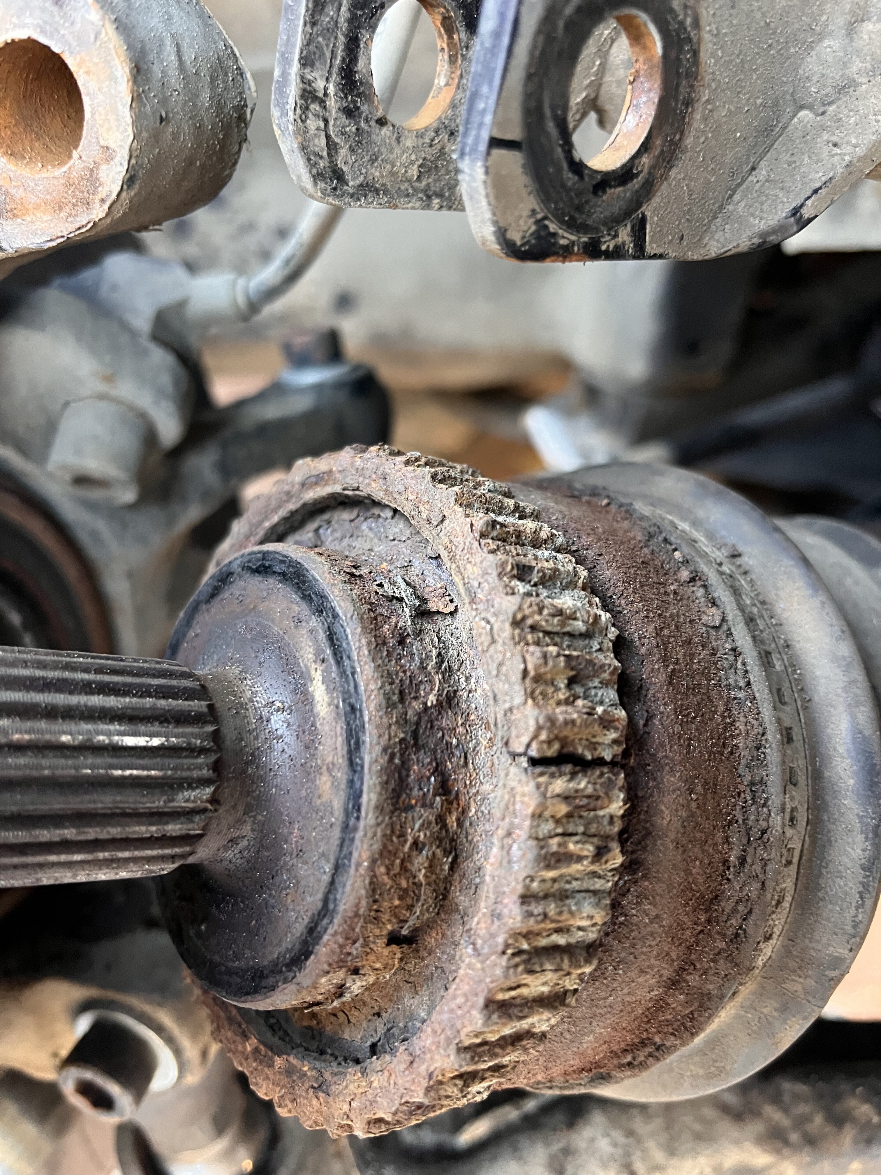

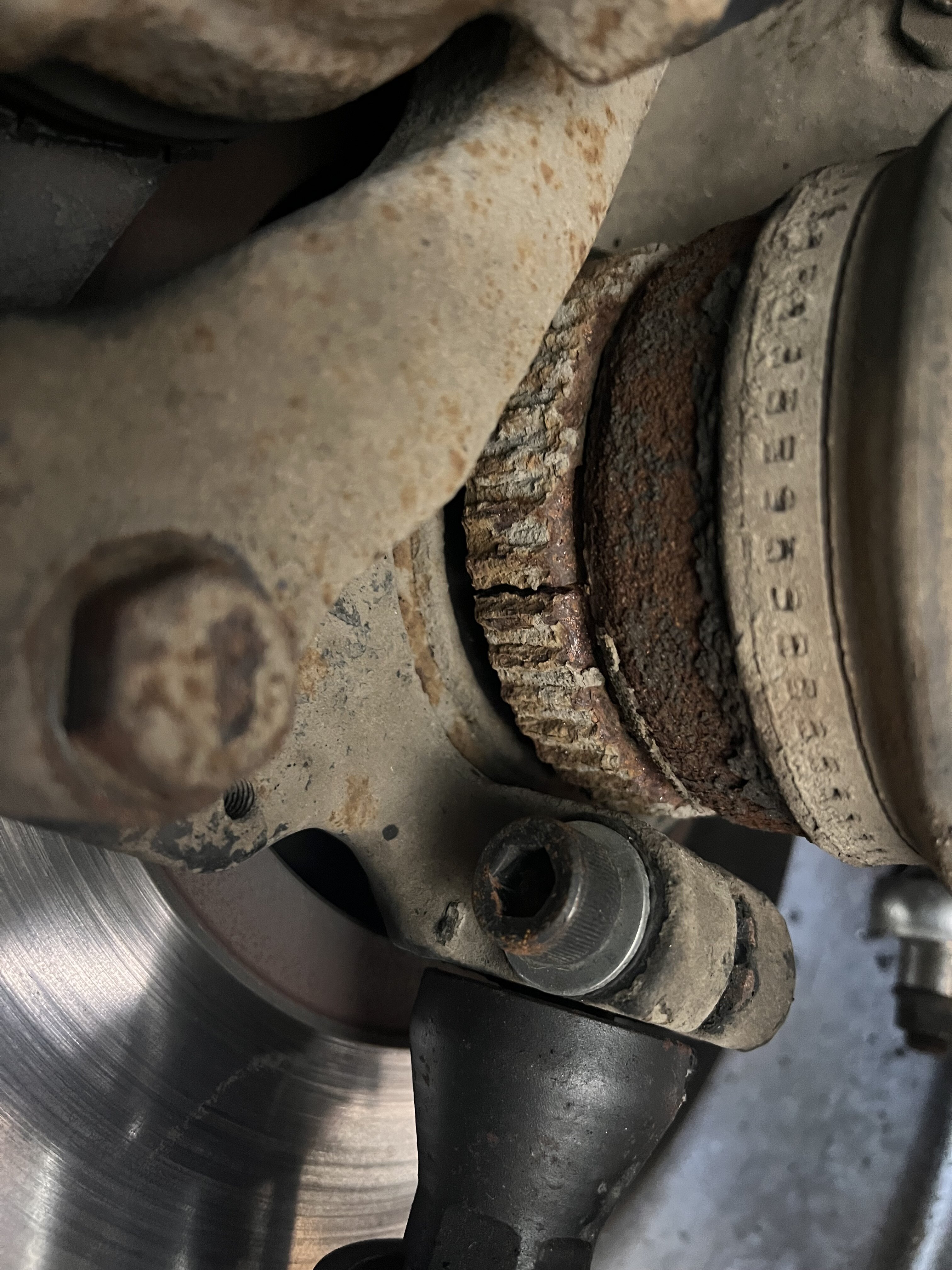

I’ve had an intermittent abs warning… I did a quick check and the cause was pretty obvious. Something to fix after Cadwell as I don’t have time before

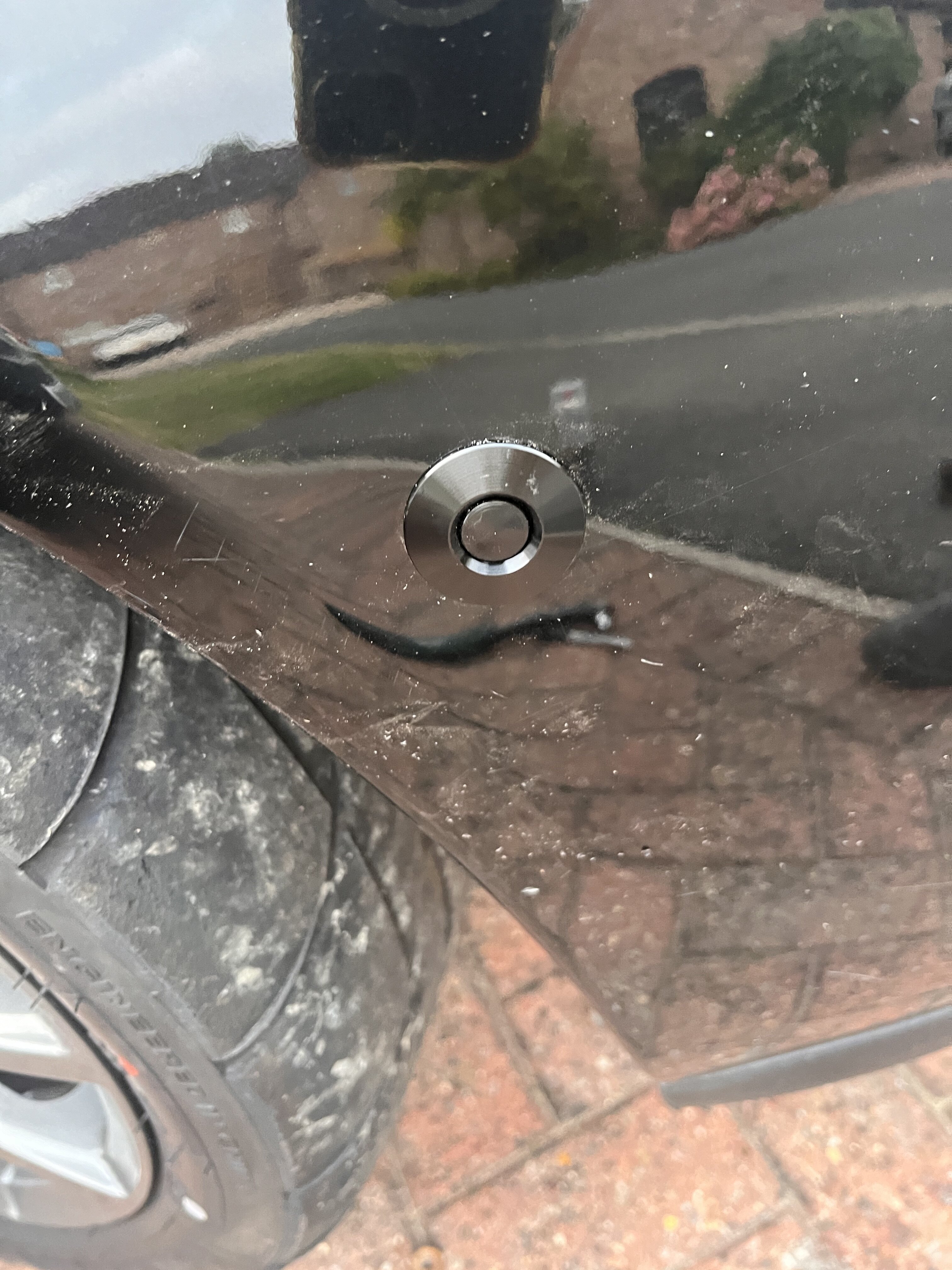

Also added some quick release buttons for the bumper, just saves a small amount of hassle
Spot on didnt think the mounts would give you any issues.
If it vibrates on idle loosen off the mounts slightly, start engine up let it settle into happy position and retorque the mounts.
@plees made a nice fitted washer for the upper mount too, might be worth fitting. Can just about see it in this pic on my trophy.
@plees made a nice fitted washer for the upper mount too, might be worth fitting. Can just about see it in this pic on my trophy.View attachment 1709205
I started it and it seemed very quiet so I may have got lucky and managed to get them placed perfectly first time. 🤣

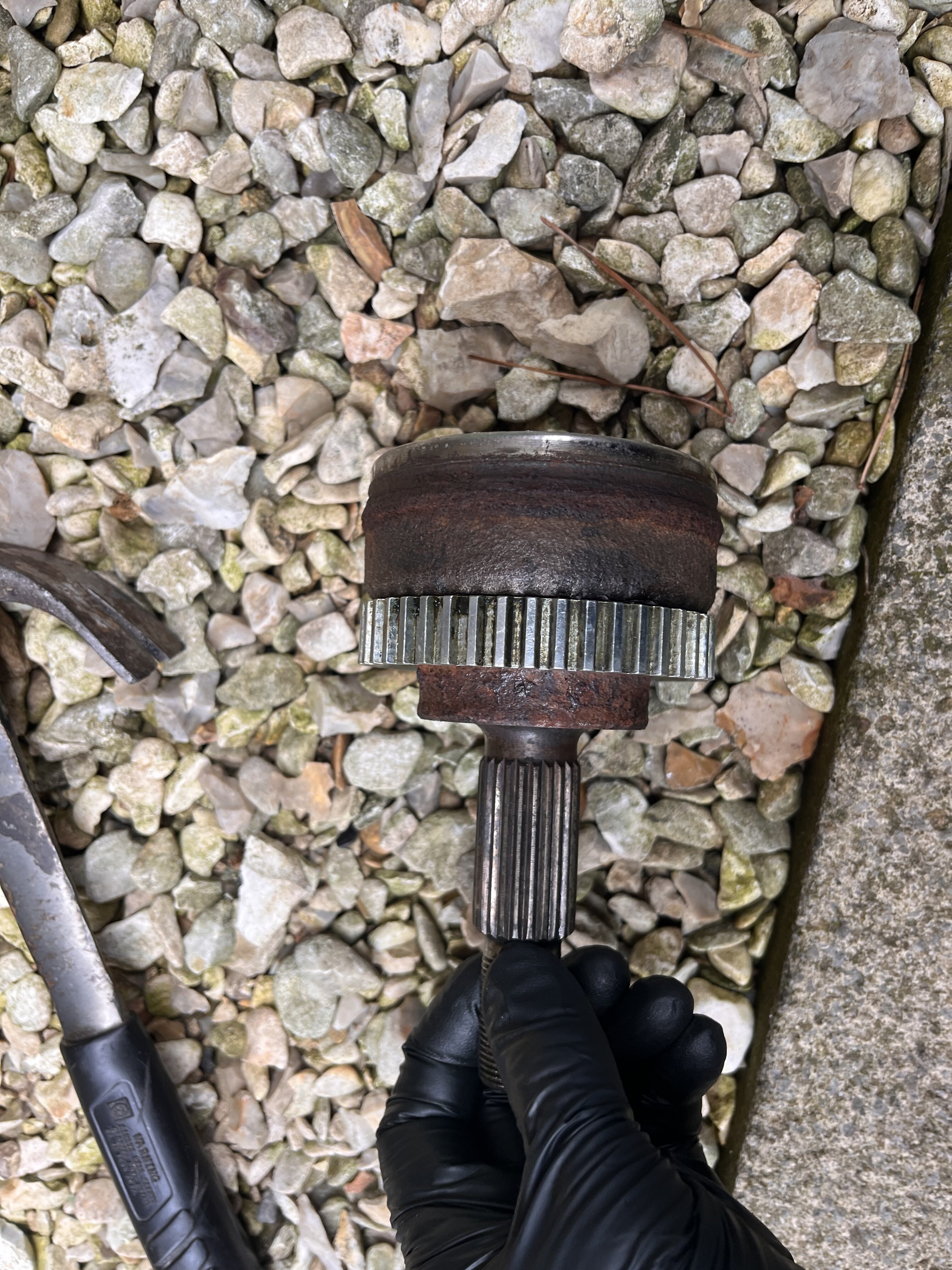

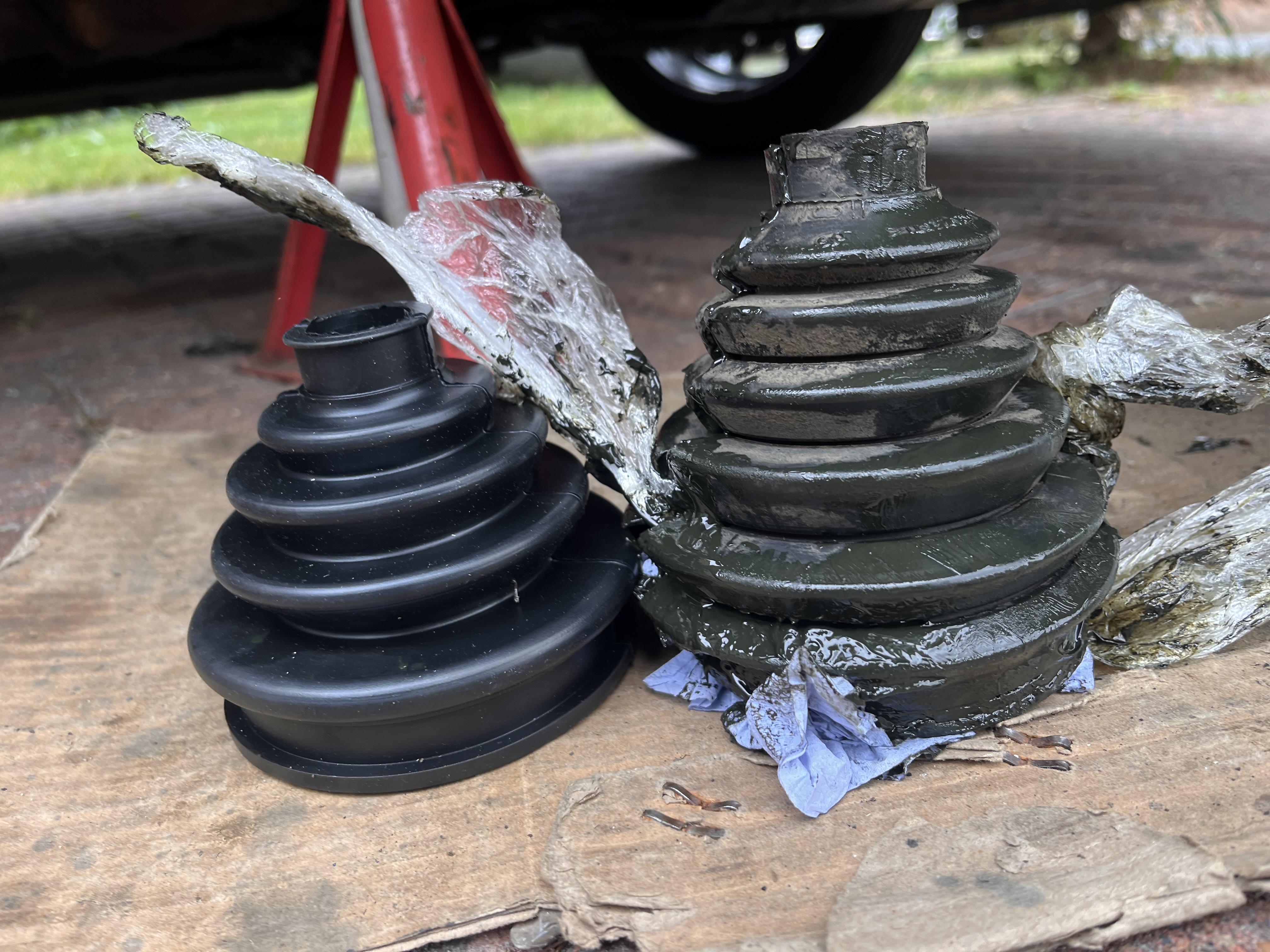

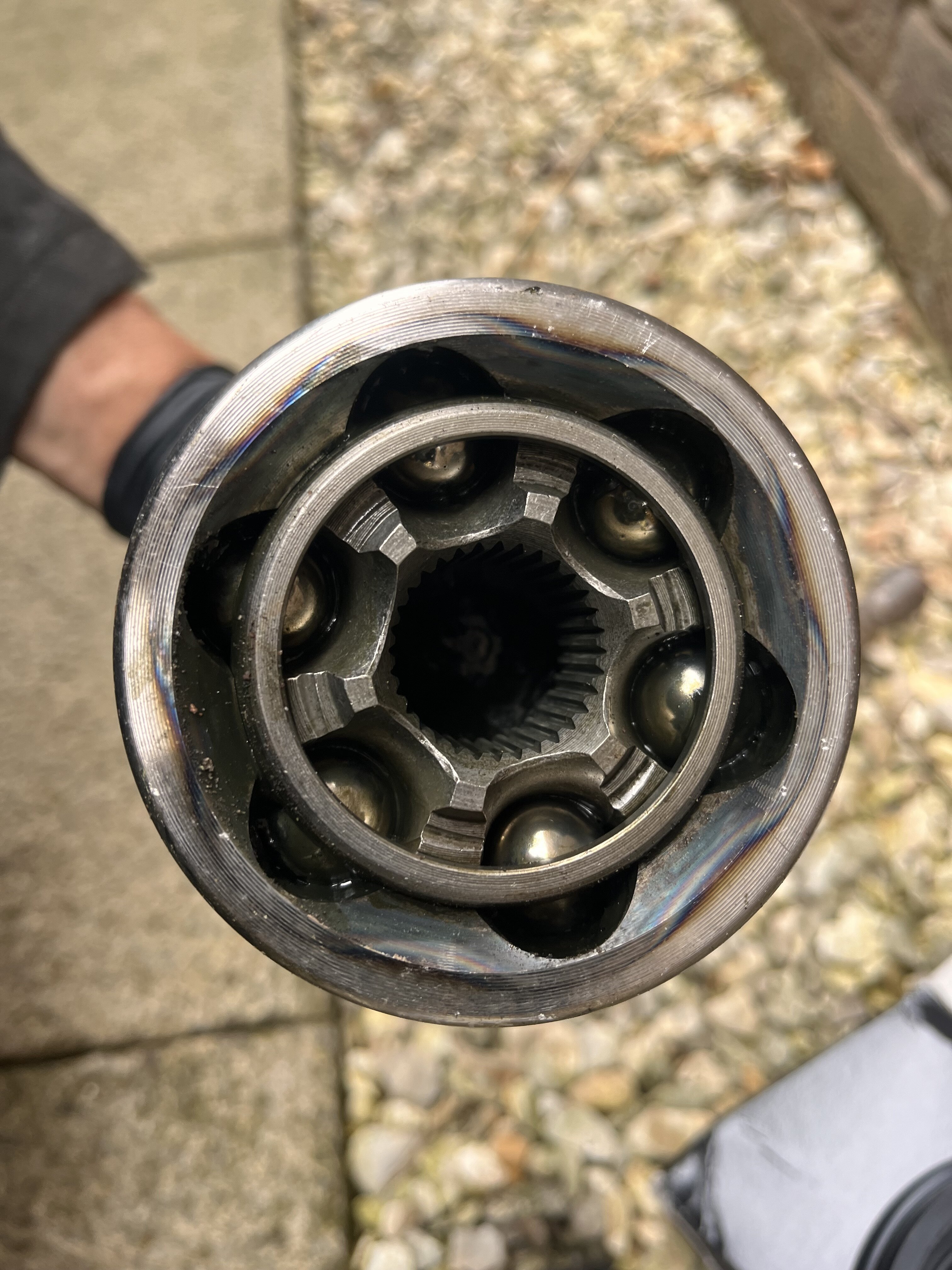

Those that are paying attention will see that I decided to change the ABS ring as the other jobs had gone so well… 😬

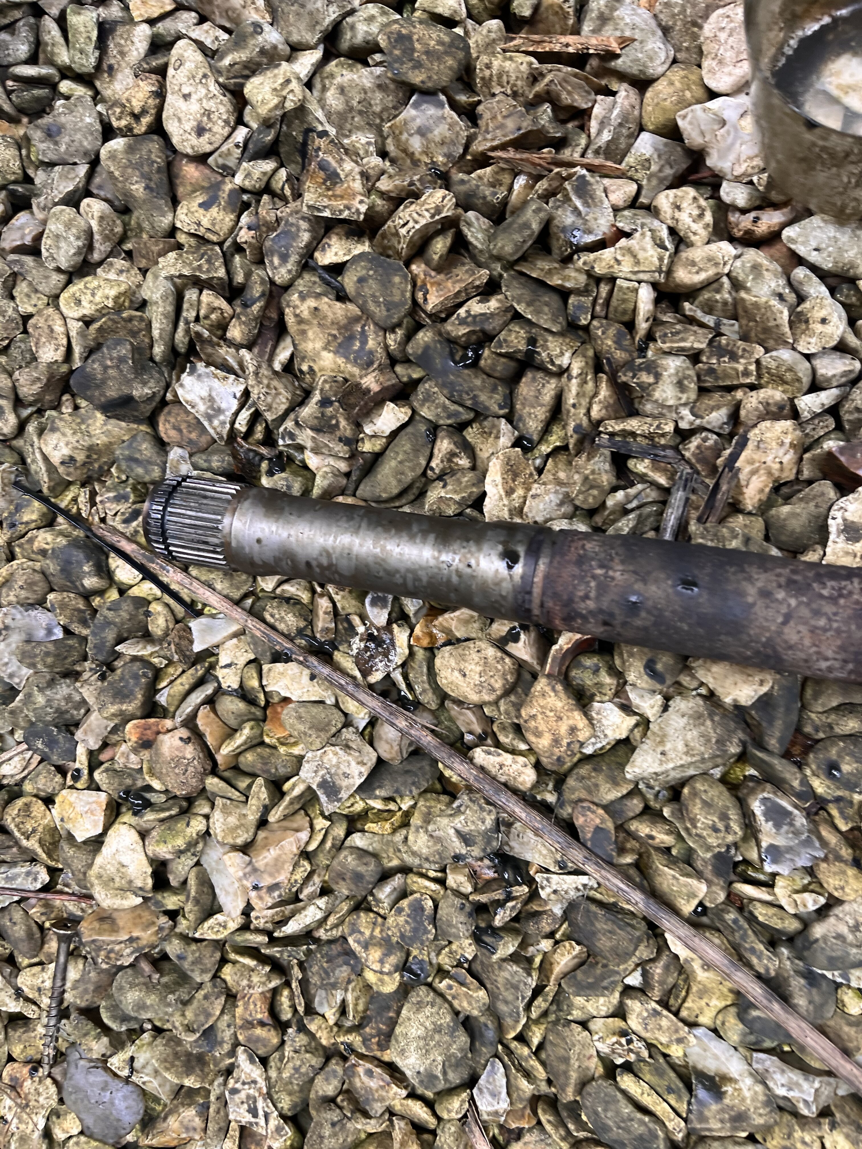

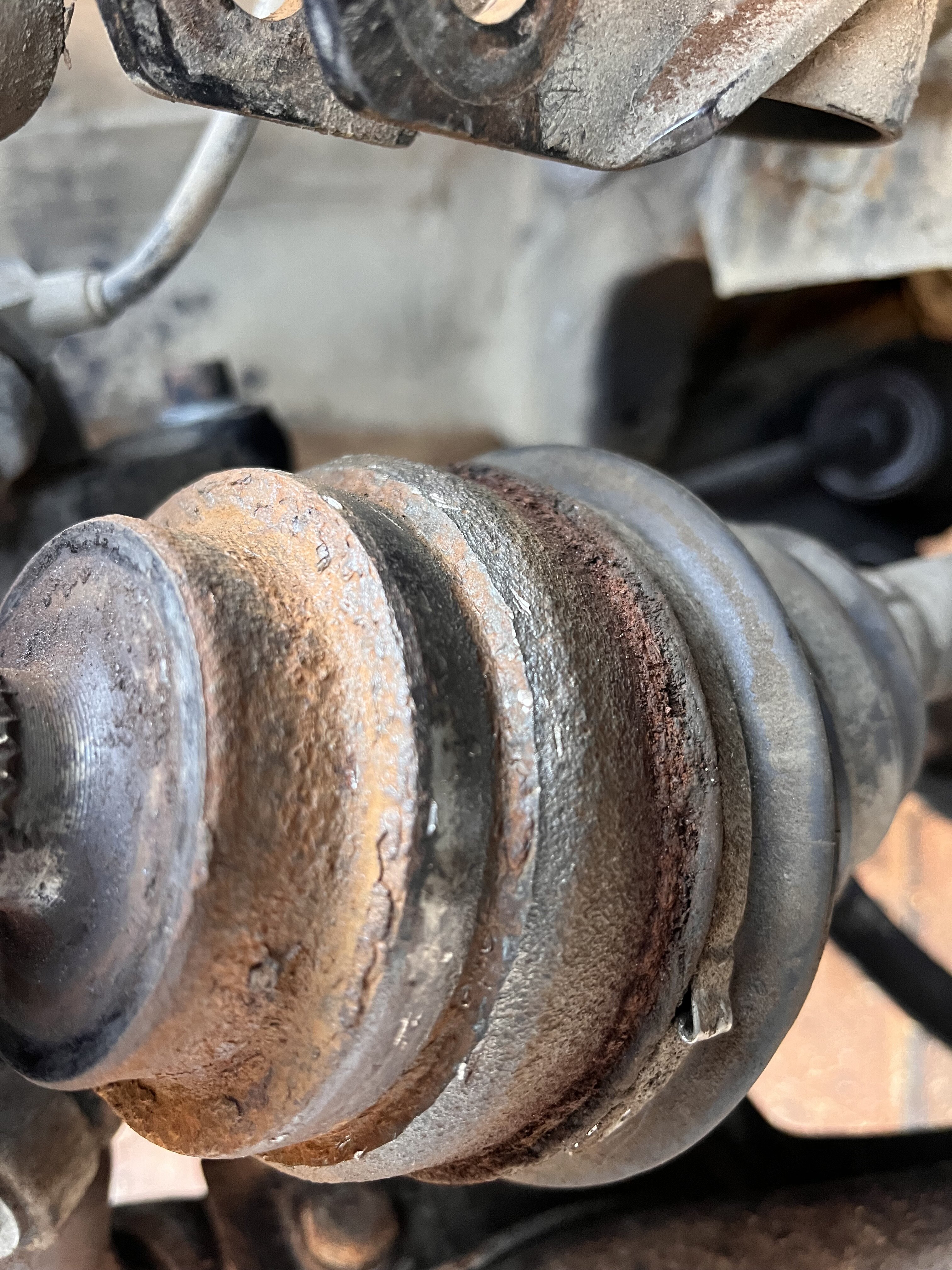

So in doing so I failed to get the new ring seated and also badly split the CV boot, after the excellent support from the forum and advice from @Brigsy i pulled the drive shaft, knocked of the CV joint and then tapped home the ABS ring.
However I’m not sure the replacement boot will work as it’s too short, thoughts?
So I’ve cleaned out the grease and I’m pretty much ready to put it back together but going to wait for the second CV boot I bought to see which will be better.
It won't stretch over it?
I've had quite stretchy aftermarket boots that were so stretchy they'd hit the bottom of the shock and split again within 50 miles. I just ended up replacing the shaft with a Borg and Beck (BDS1319) shaft.
Getting it on is not an issue as the CV joint is off the shaft and the shaft out of the car, its more the overall height being less than the one I took off.
Short boot would work OK if your stuck, but the longer one will be better. Ive used a short one as outer on my blue dci, lasted about 30 thousand miles.
Large jubilee clip is good if you have hassle with the proper clip.
Cheers - The place I got this have the longer boot in stock so I shall take this back and get that tomorrow morning. I did figure I could just use the short one for now if needed. So with any luck the old girl should be back on four wheels tomorrow / Friday and then I just need t remove the passenger seat and harness and I am ready for Cadwell.
Meant to say I have the proper tool to do the clips - makes it a breeze.

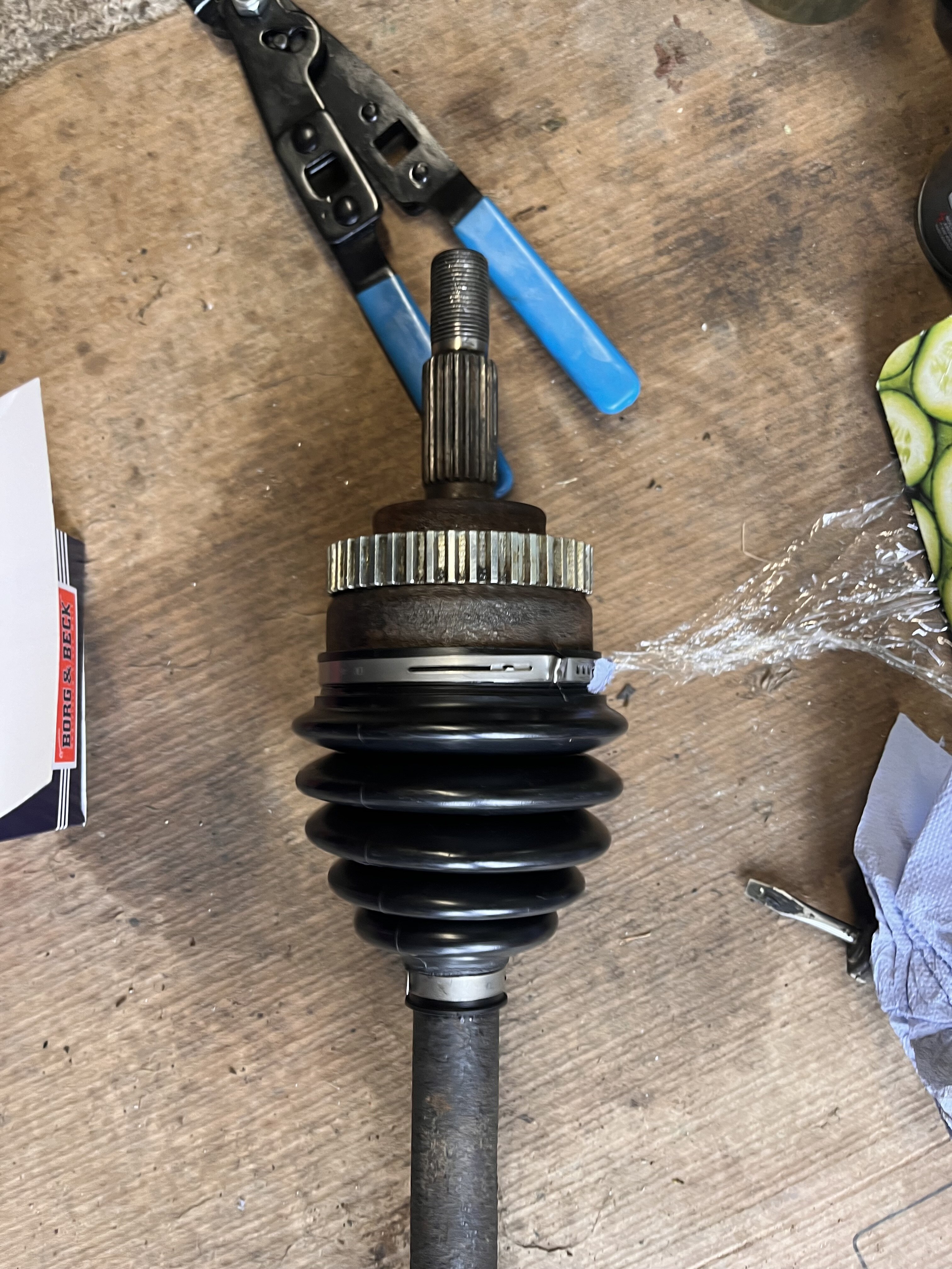

Got a different CV boot this morning (Borg and beck) and it’s much better so all sorted.
So it’s all back together and drives which is nice.

Yeah much better.
They hold up better to the heat compared to rubber ones.
Only use rubber/neoprene ones for inner boots on tripode joints tbh.
Glad I waited the extra day and swapped it. Happy with how its all worked out. Nothing like having 3 months to do these jobs and then doing them all in a week before the next trackday. FML.
