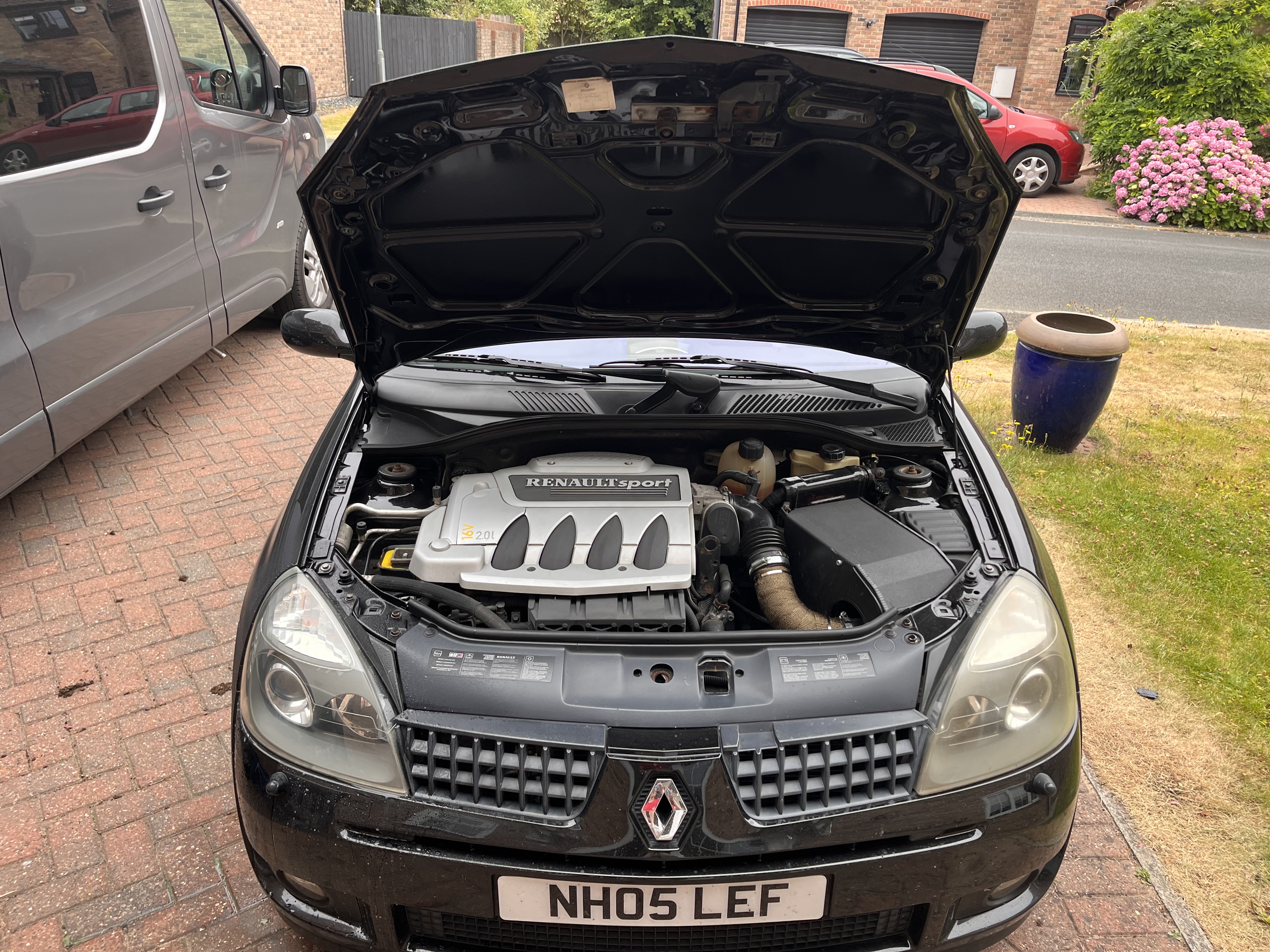

At last some pics and the start of my (probably slow) project thread.
Picked up with limited history but from a friend who’s spent £1400 on lots of new bits like brakes, calipers, clutch, exhaust etc etc only to get a mk3 and sell this one.
I got it at a fair price but it needs some love as you’ll see. My intention is to not modify it but maintain it as stock as possible with some minor mods that I think really benefit the overall car.
I’ve done this before and termed it Stock+.
To first part will be to get and fit the missing bits, like the 182 steering wheel and gear knob, then sort out some odds and sods that are broken as well and deep clean it, as it’s pretty grubby.
Having been over it with my paint depth gauge it’s all original it would seems which is good, there’s some age related marks on the Bodywork that I’ll fix and the interior is, in places disgusting, but more on that to follow.
Here’s some pics to start with,

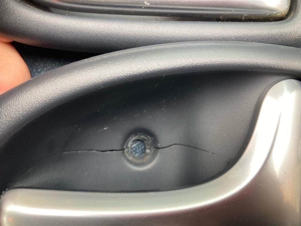

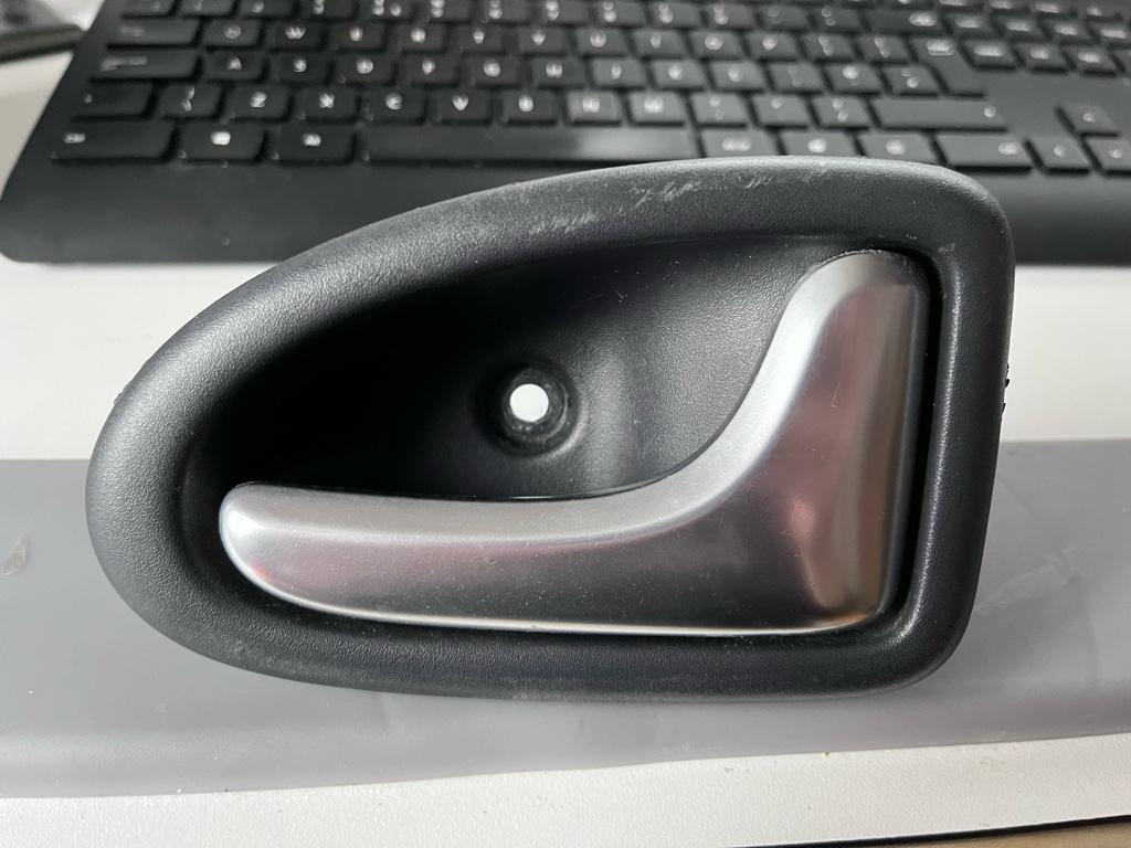

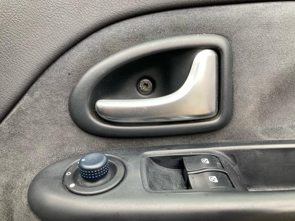

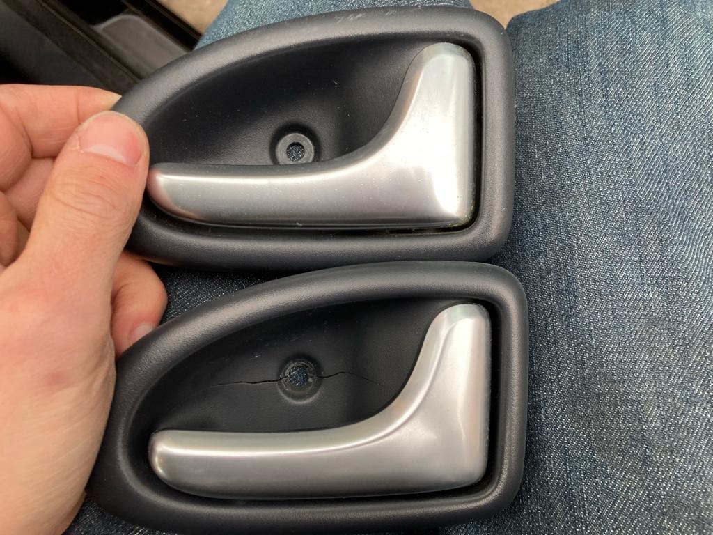

The drivers door release arrived… took ages. This is a super small thing that most people have oils t even notice but I saw it straight away and for the sake of £5 thought I’d just get it sorted.

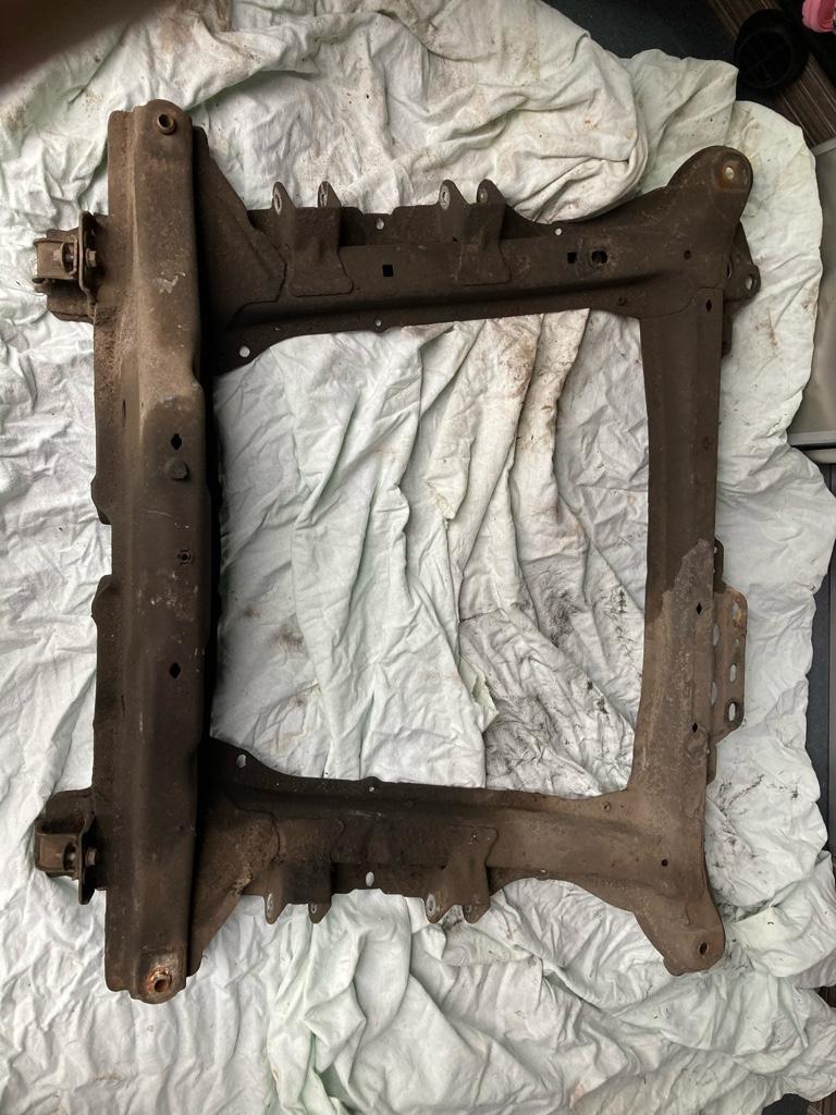

Also picked up a subframe, seen these going for over £100 so happy enough to pay £30 for this. Looks tidy enough, but it’ll be off to get blasted and coated at some point anyway.

- Subframe - get blasted and powder coated

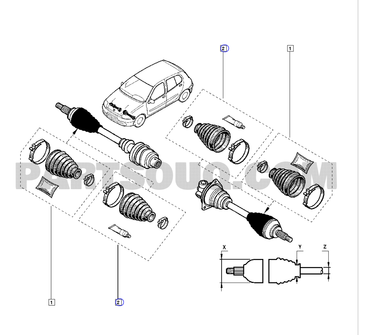

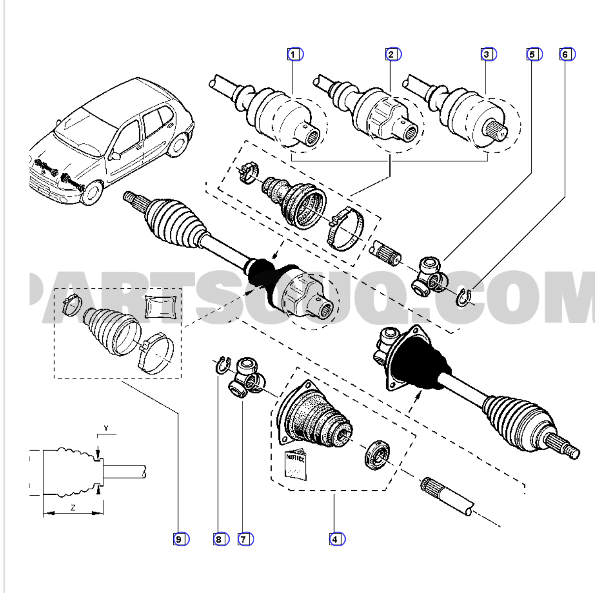

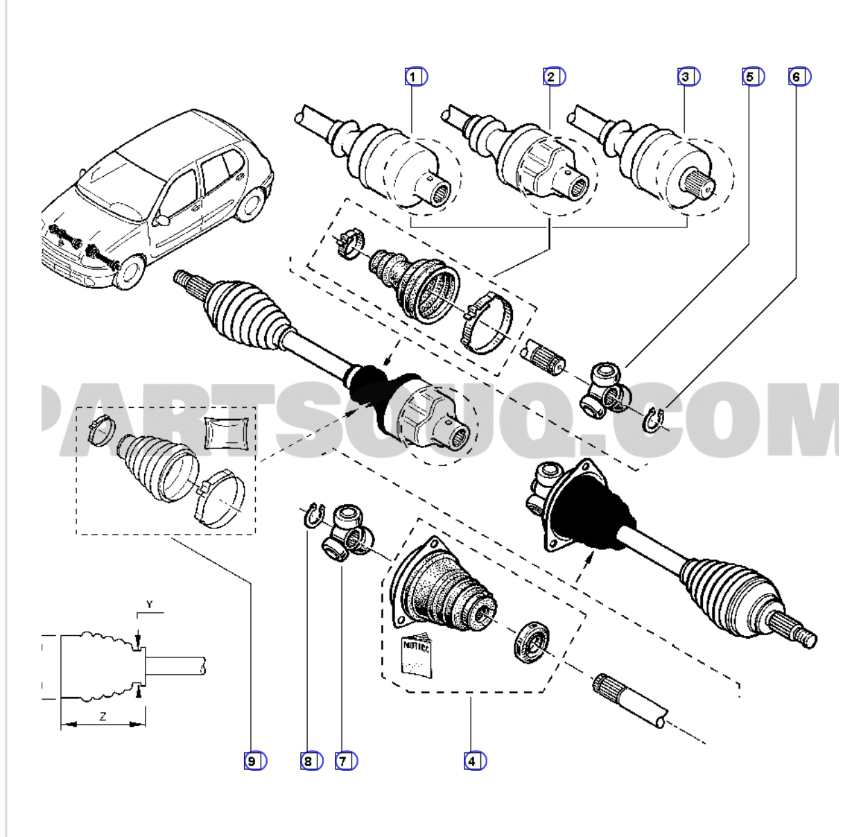

I intend to refurb the CV joints rather than replace the whole shaft with a replacement... but how on earth do you know what CV joint you need!
Did you find out which cv joint you need and where from? I think one of mine is knackered. It's going to the garage tomorrow to check it out. Any info would be good.
Not entirely no. I’m still working on it. Basically from what I understand it need to have the wider ABS ring but the cv joints are the same across the range. The shafts differ but if you’re just doing the joint it seems as long as you be the right abs ring it should work.
Although I’m not 100% confident it that information.
I'm 100% sure it is the cv joint. The boots off, which it failed the MOT on last September and was put back on and a new clip.

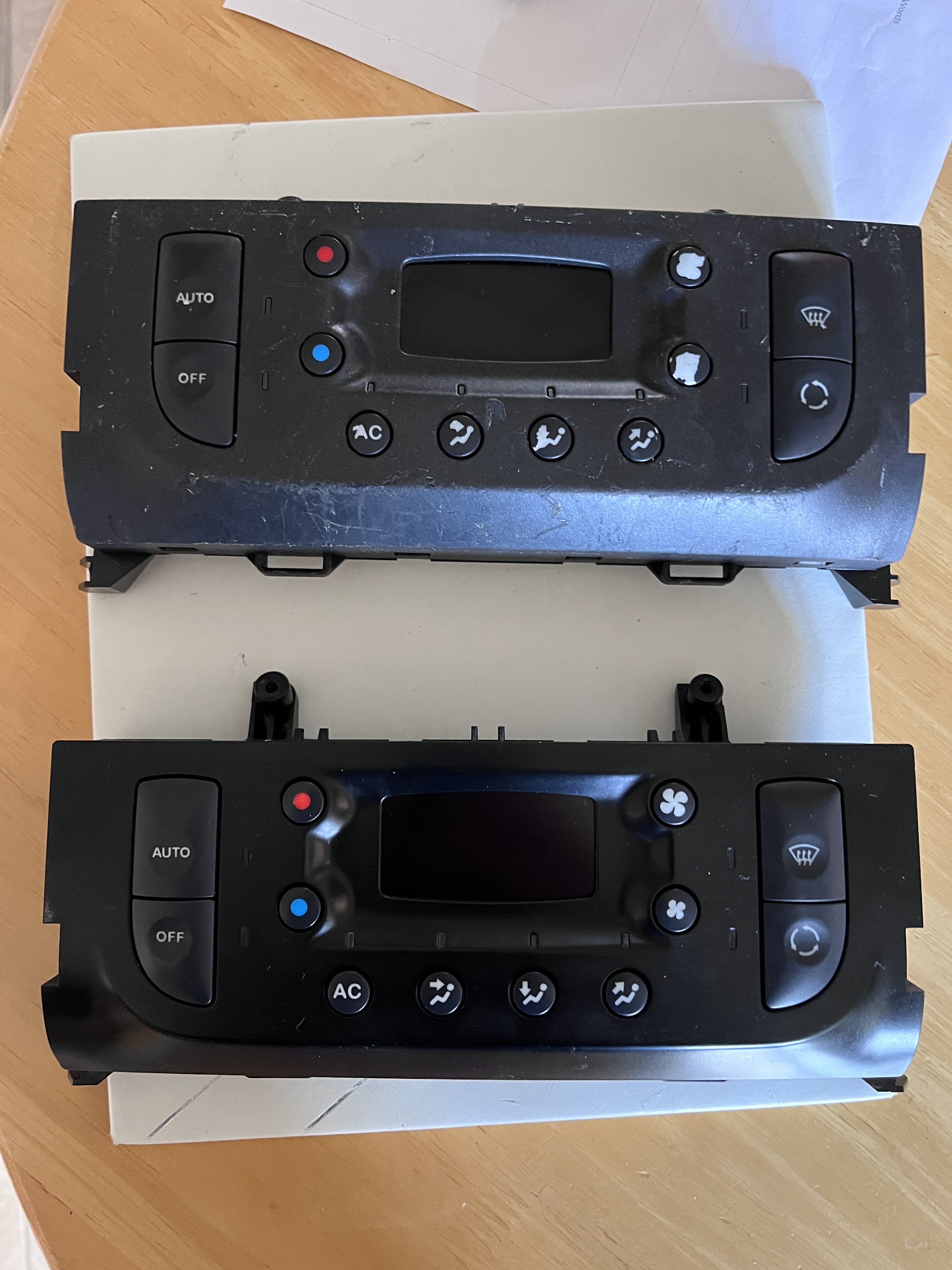

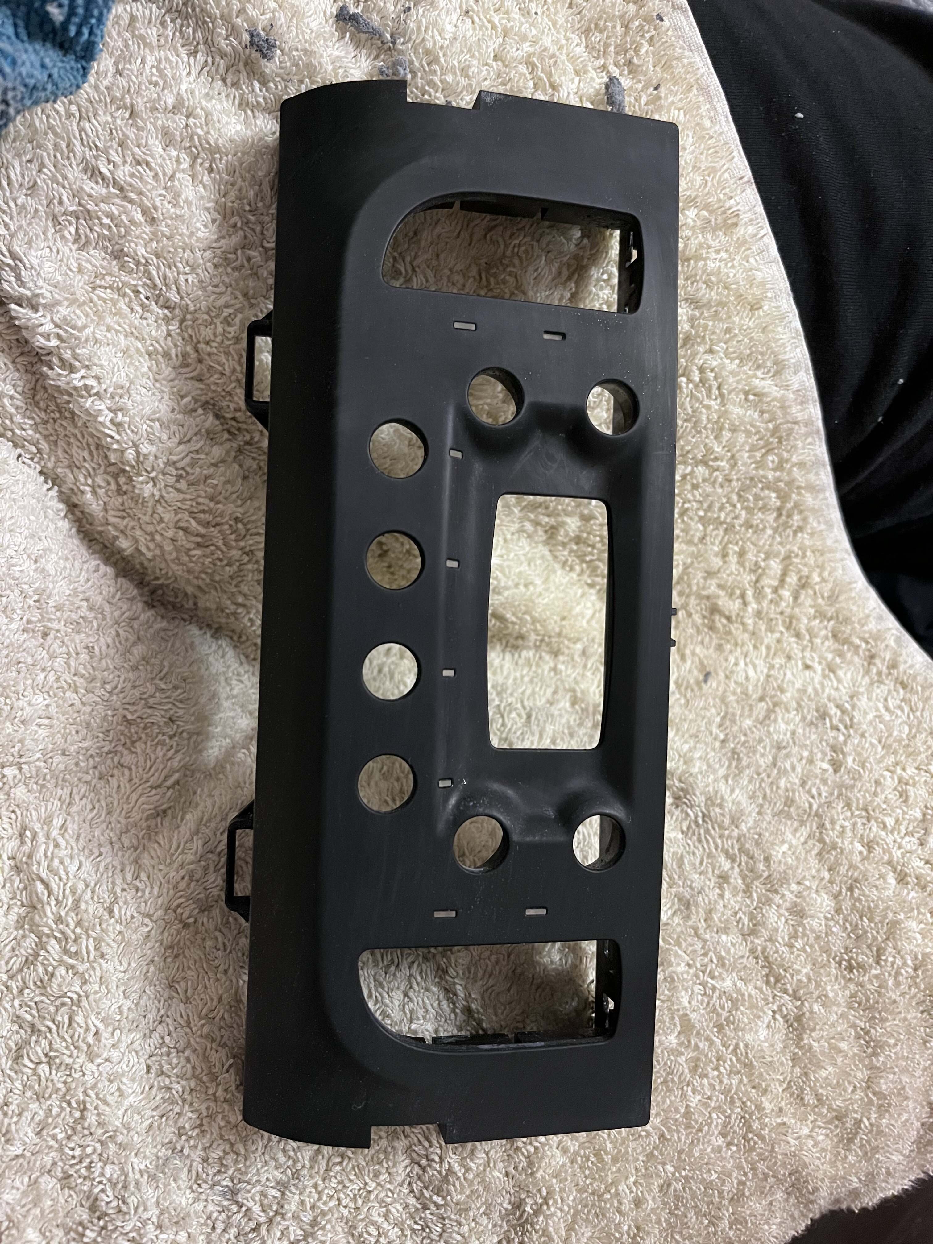

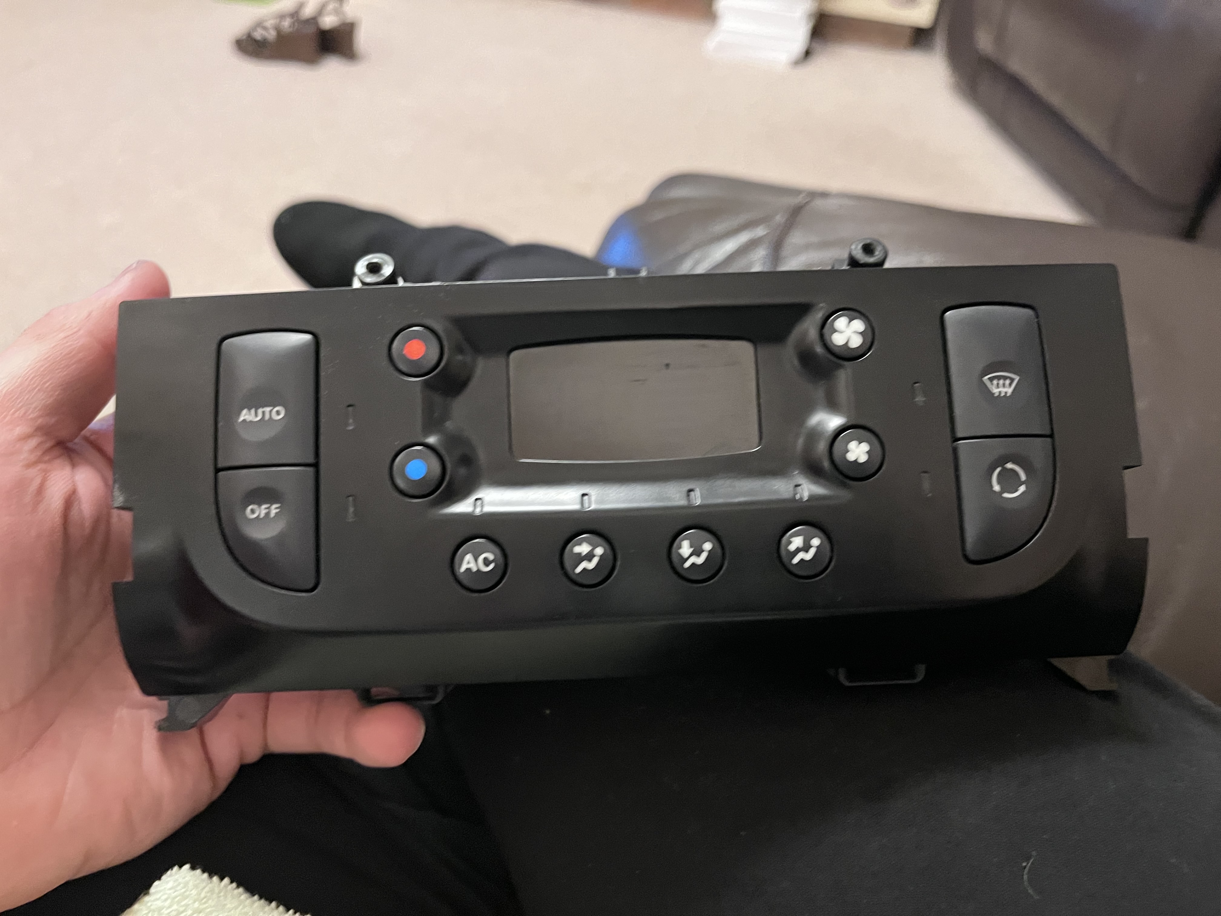

Quick update,

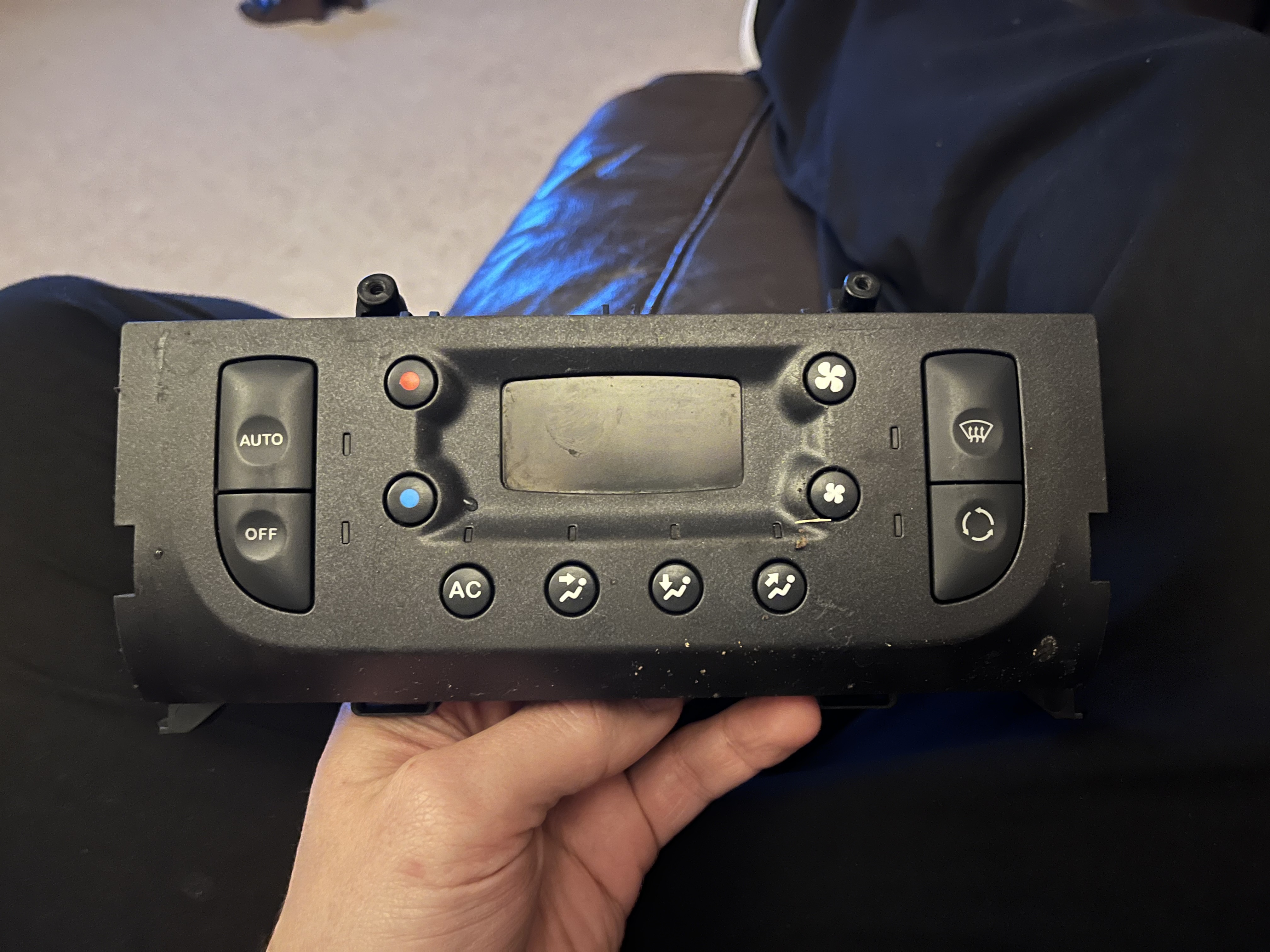

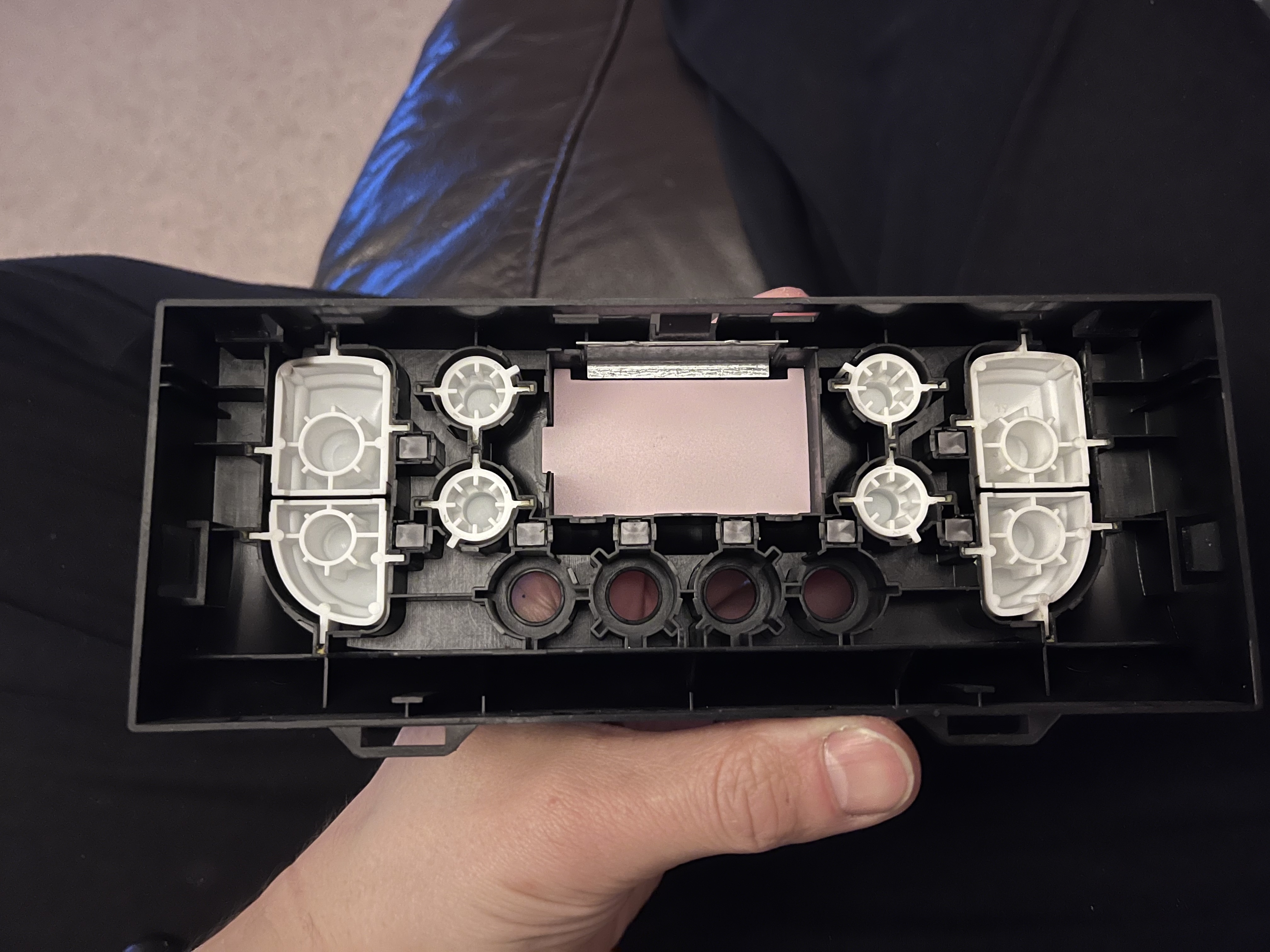

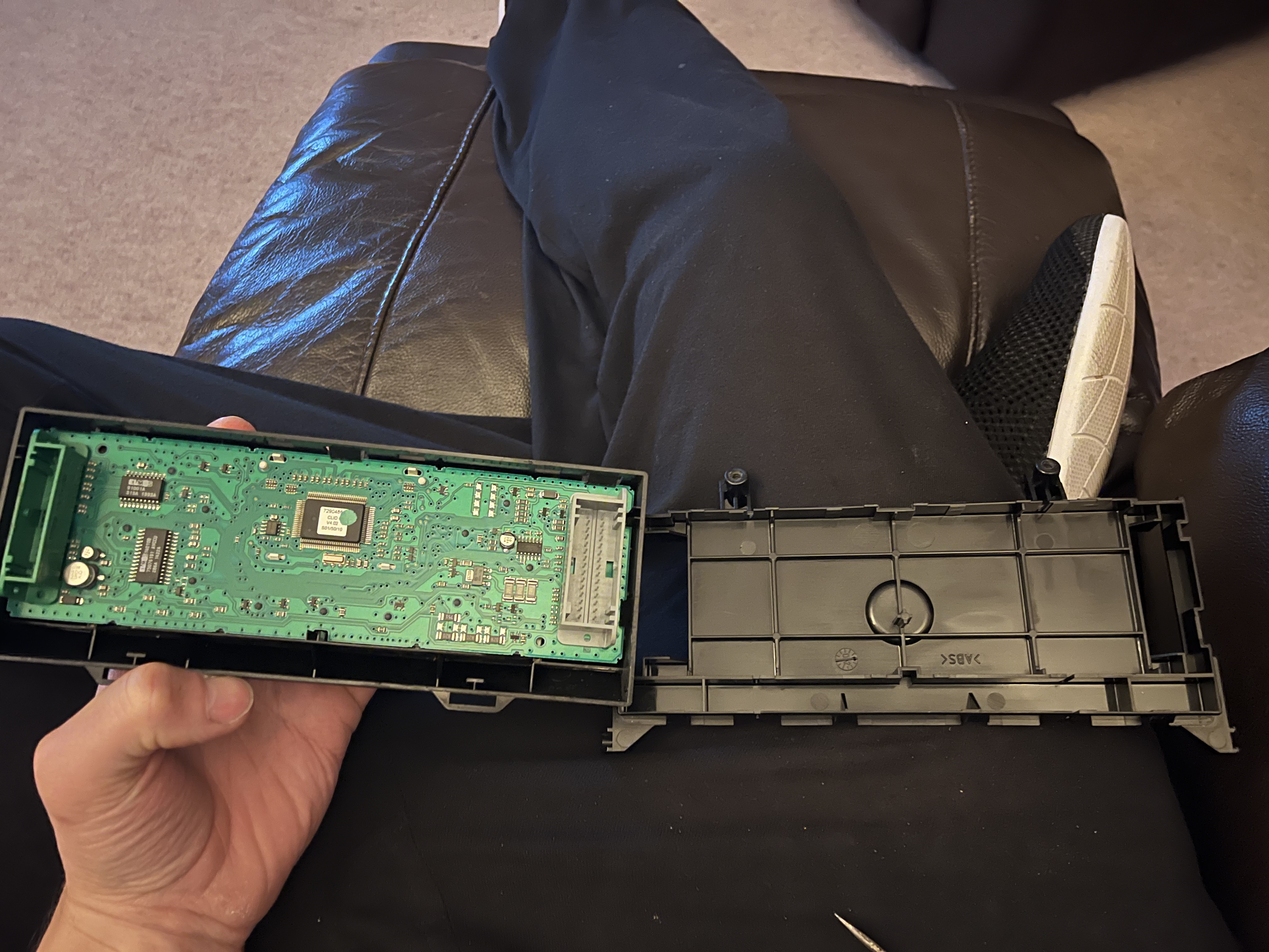

cleaned and fitted the new climate control panel just to make sure that wasn’t the cause of the heating / cooling issue, it was not but the buttons are now not all worn out which is nice.

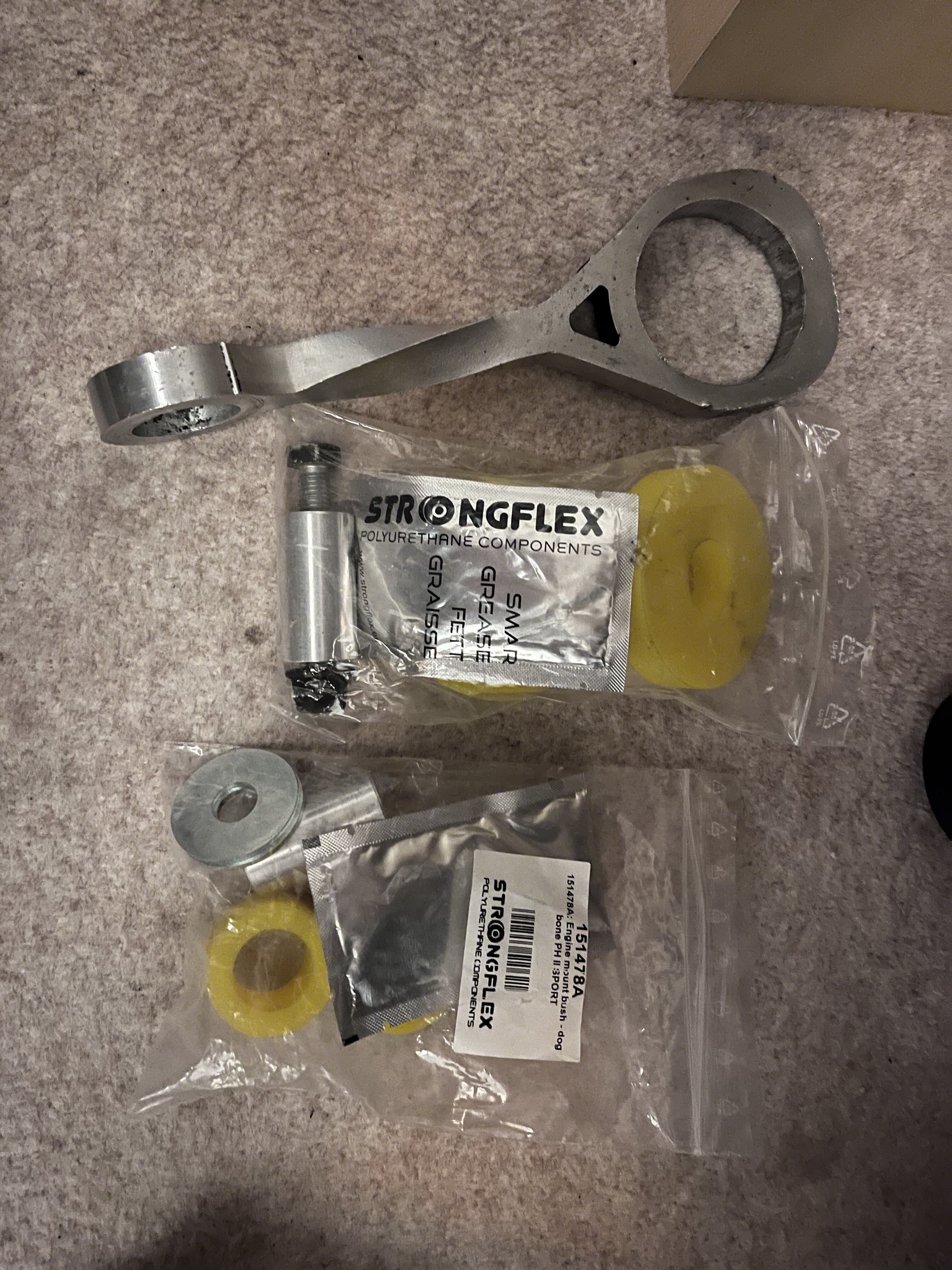

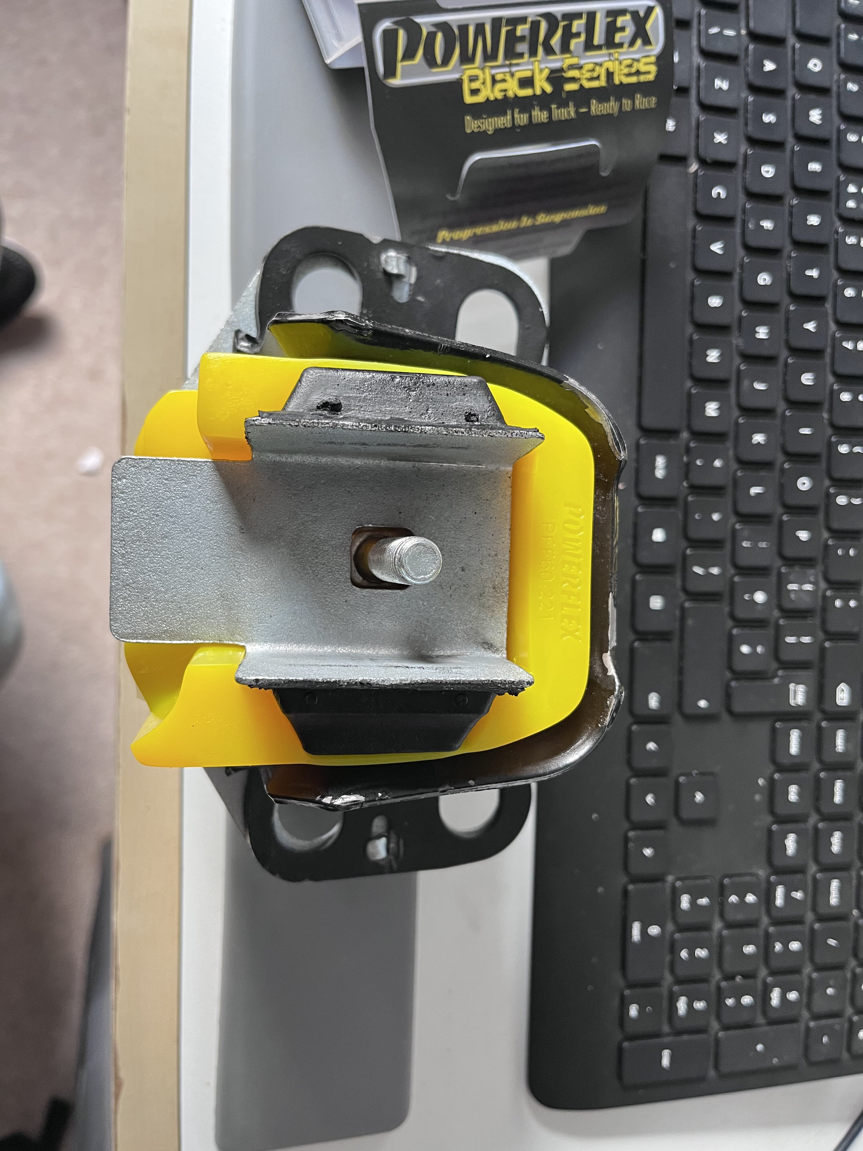

My new engine mount and dog bone poly bushes turned up, should reduce some of the vibration from the black edition ones that are in there now.

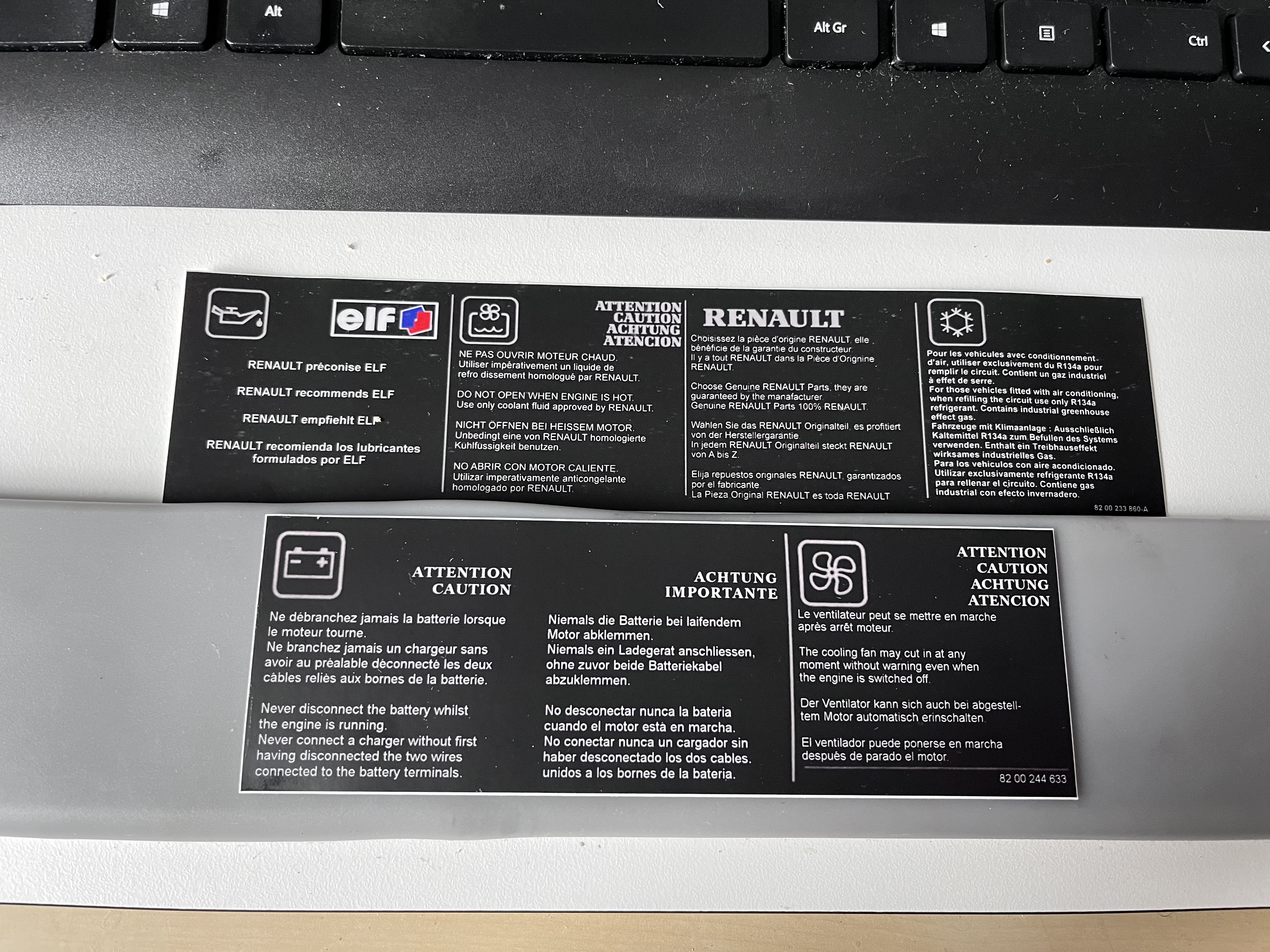

Some new slam panel stickers, look really nice quality, I think they came via eBay from a member on here?

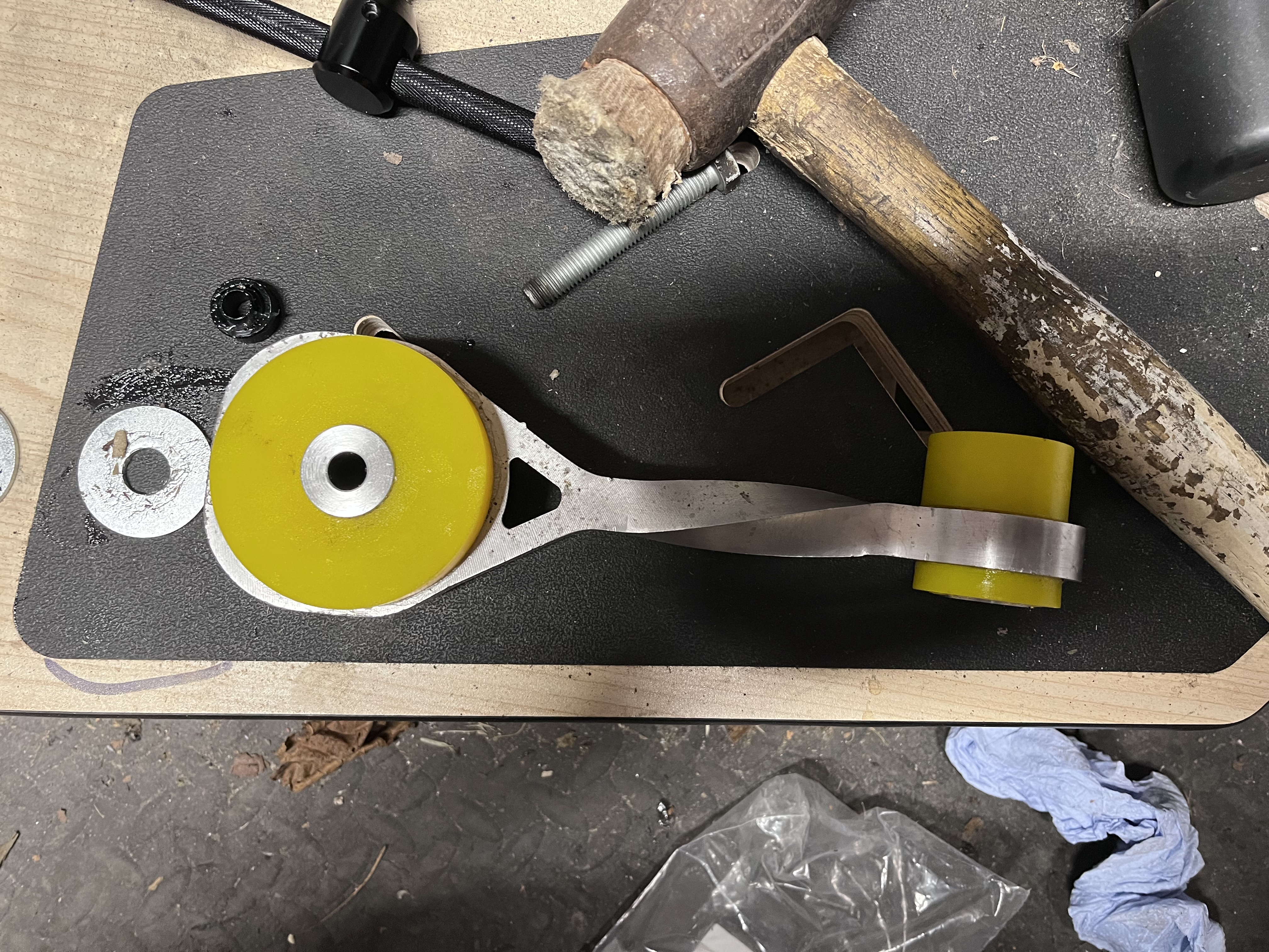

spent a few minutes sorting the dogbone mount as well hoping the road mounts will be a bit more forgiving than the track ones that are on at the moment

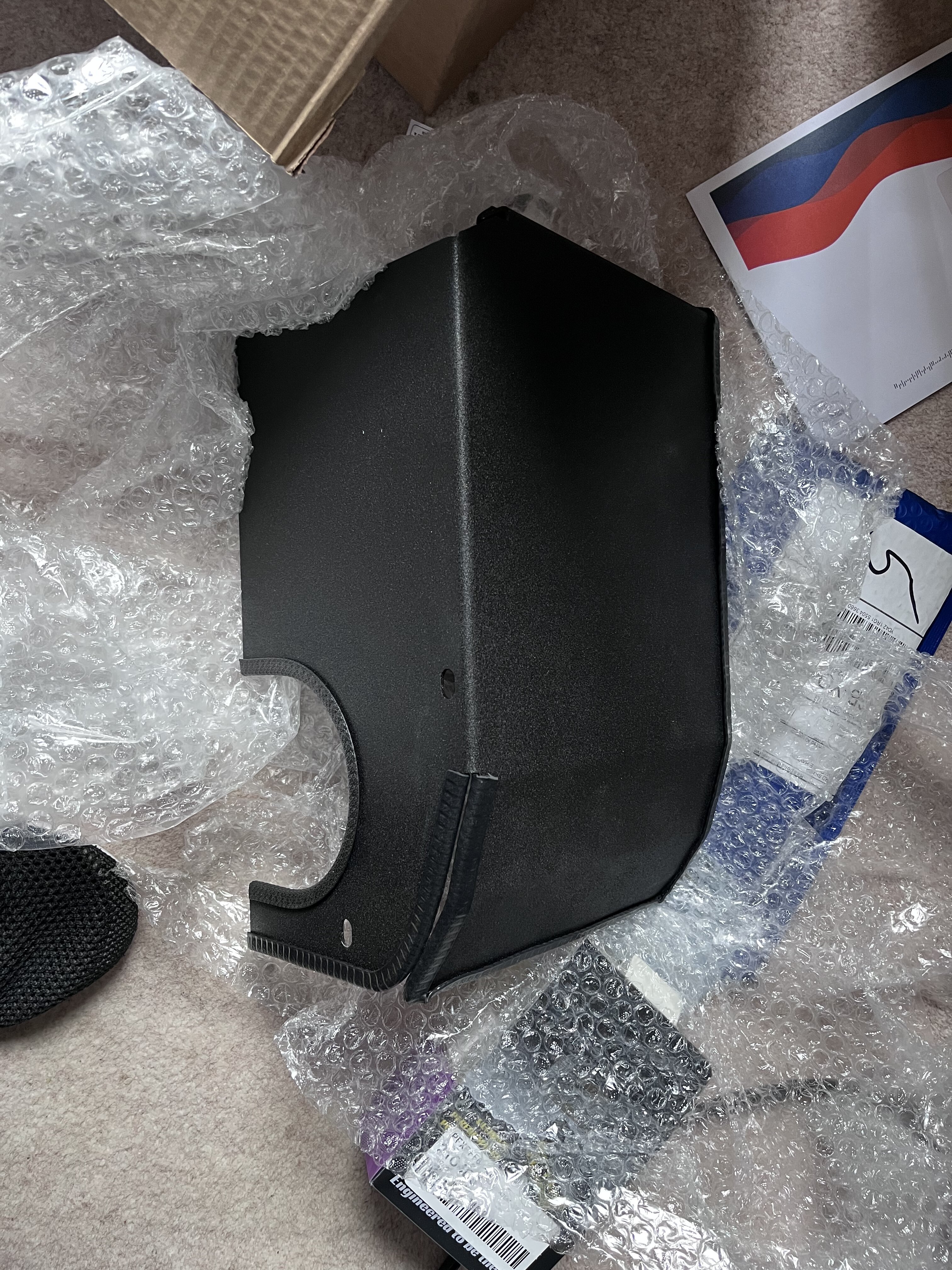

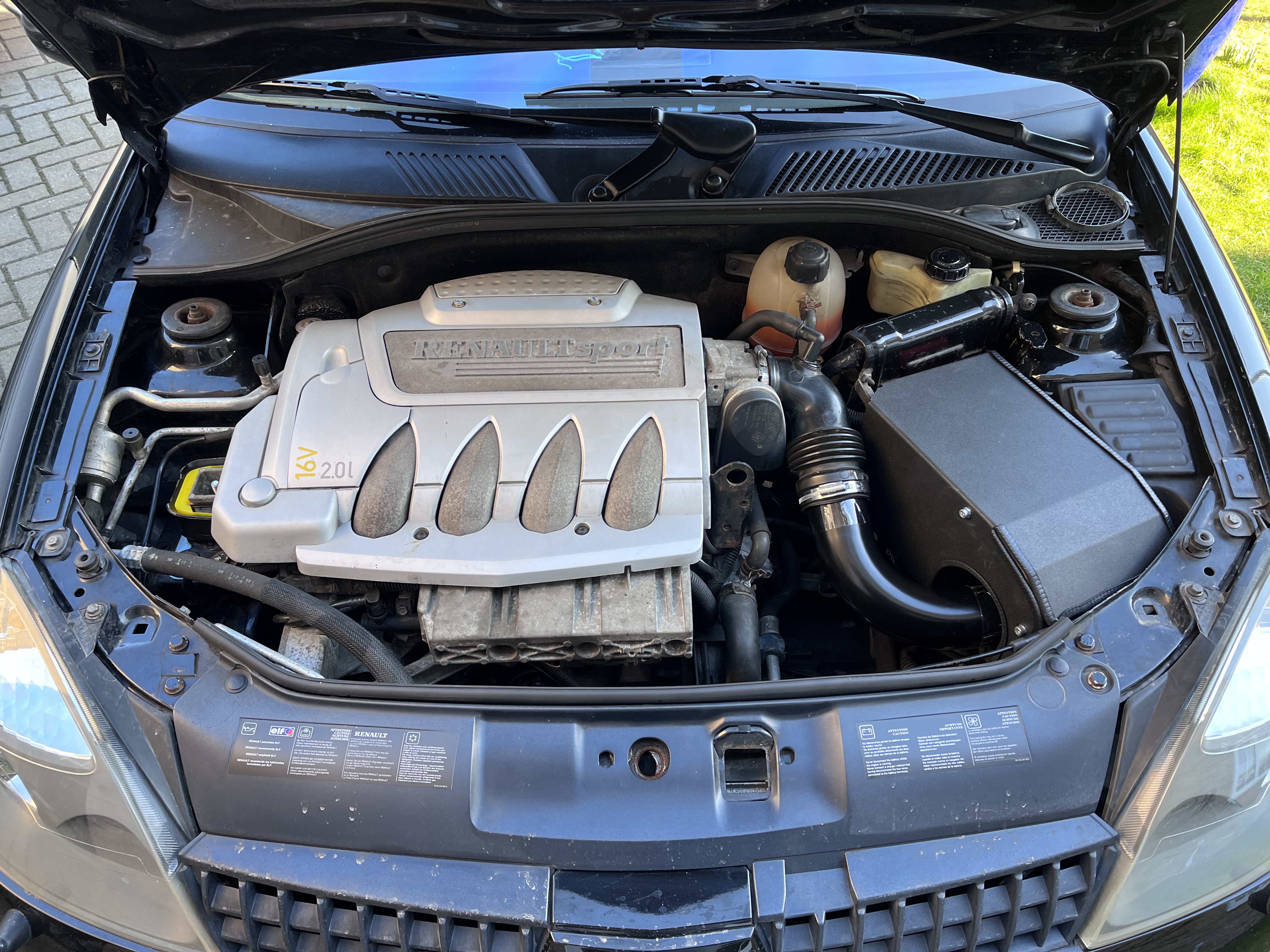

also got the battery / air box cover, got the pipe just need the filter, but should look tidy.
New number plates and new slam panel rubber and upper engine mount bolts and washers
Should help to tidy up under the bonnet, next steps will be to repaint the ECU cover and the intakes etc.

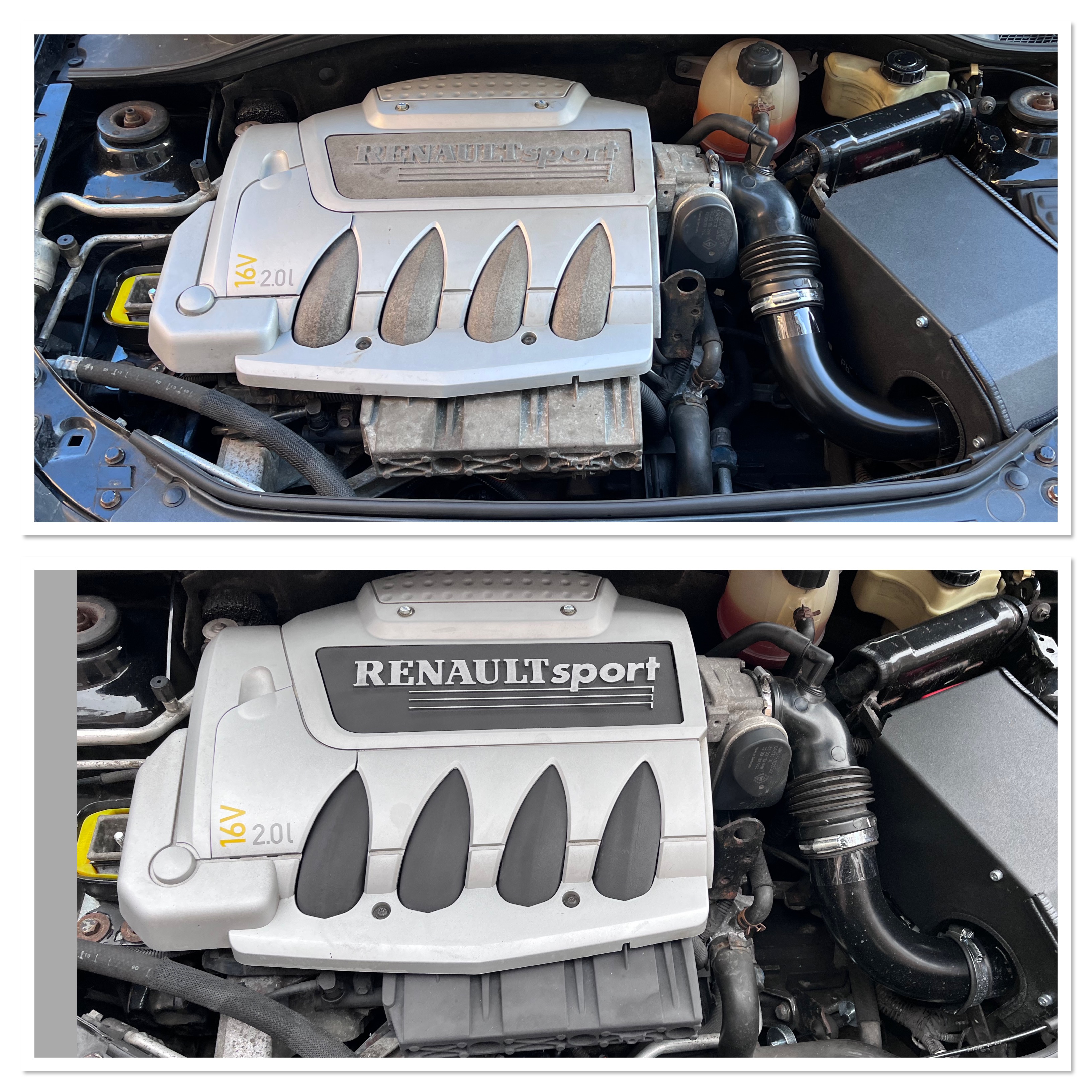

Quick game of spot the difference
Happier with the overall look now, just need to tidy up a few things like the écu cover and inlets but getting there.

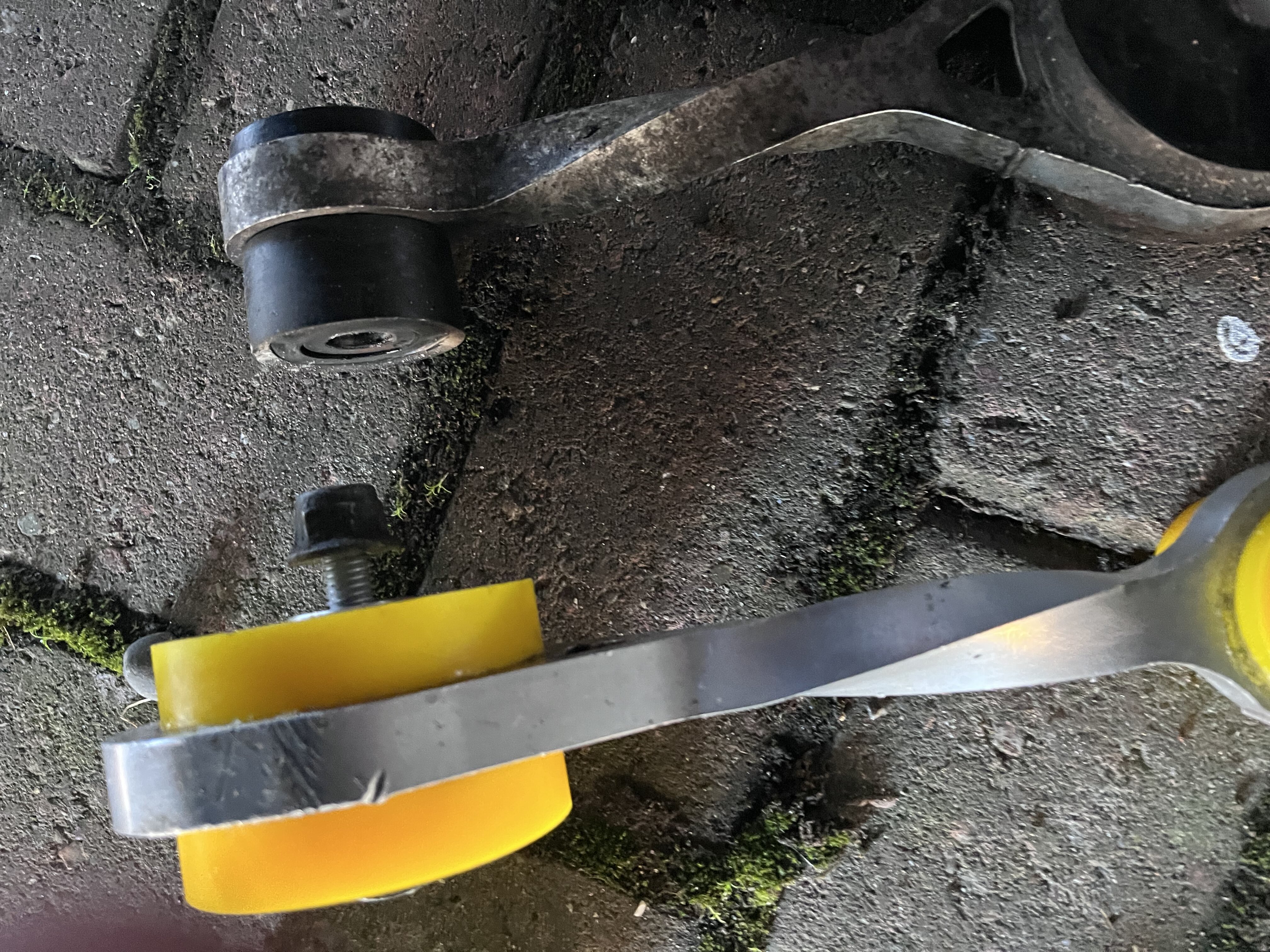

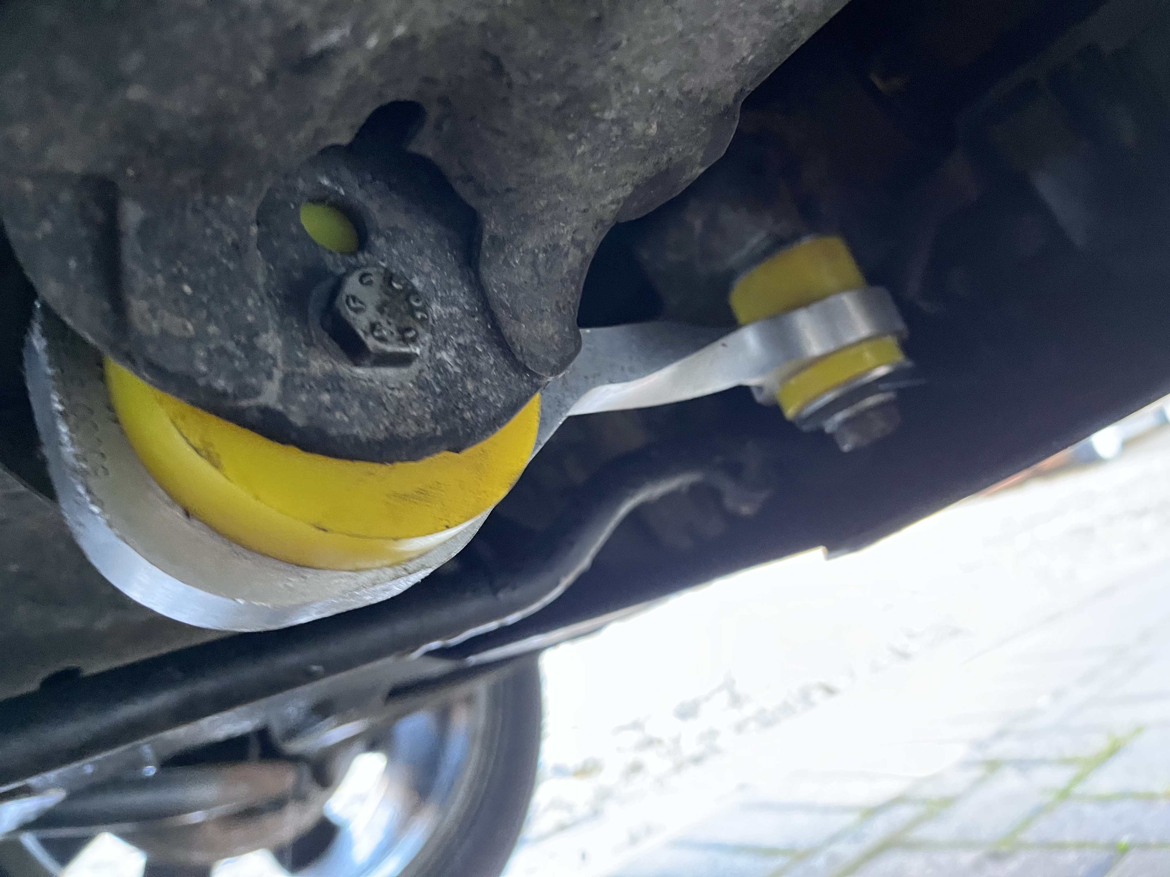

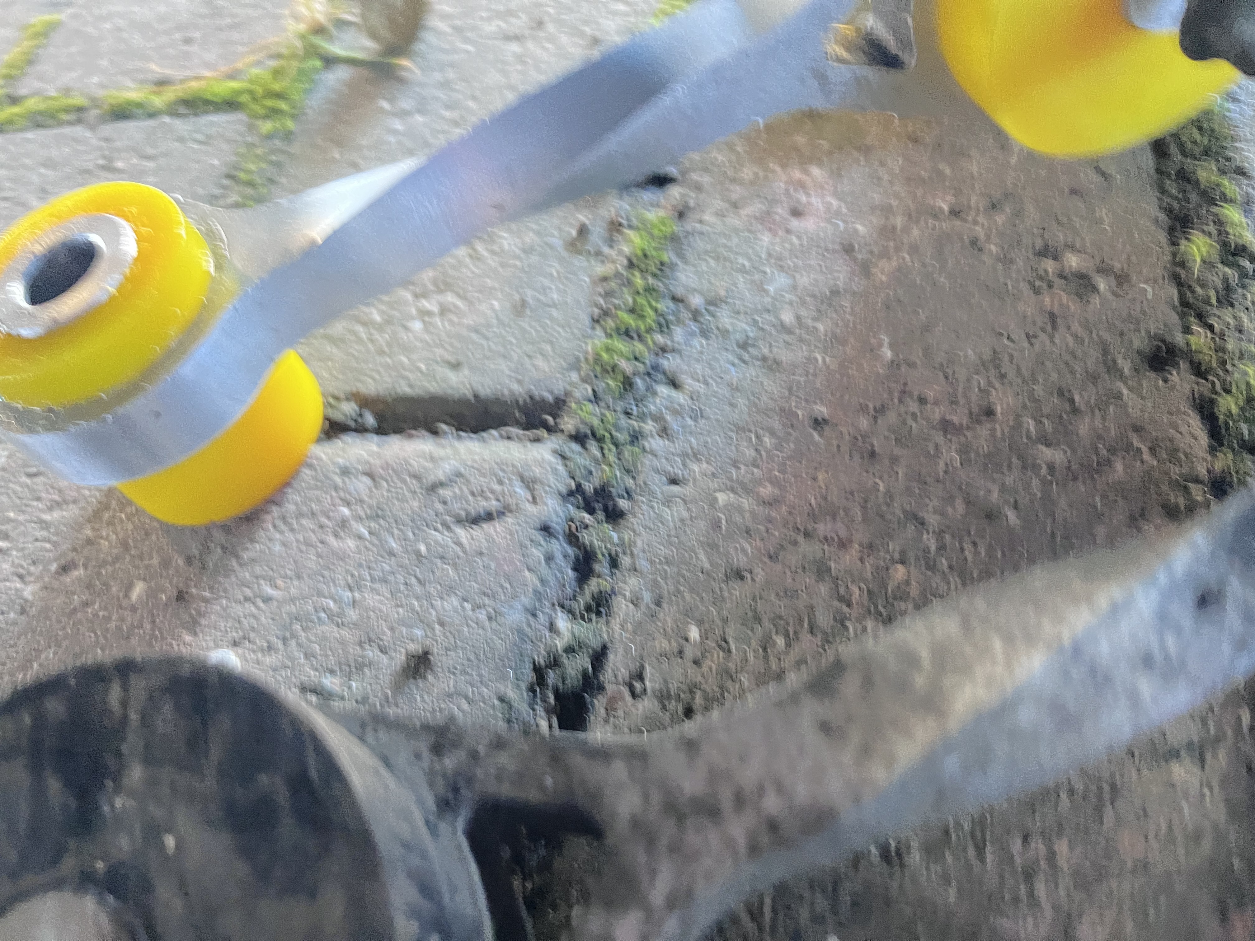

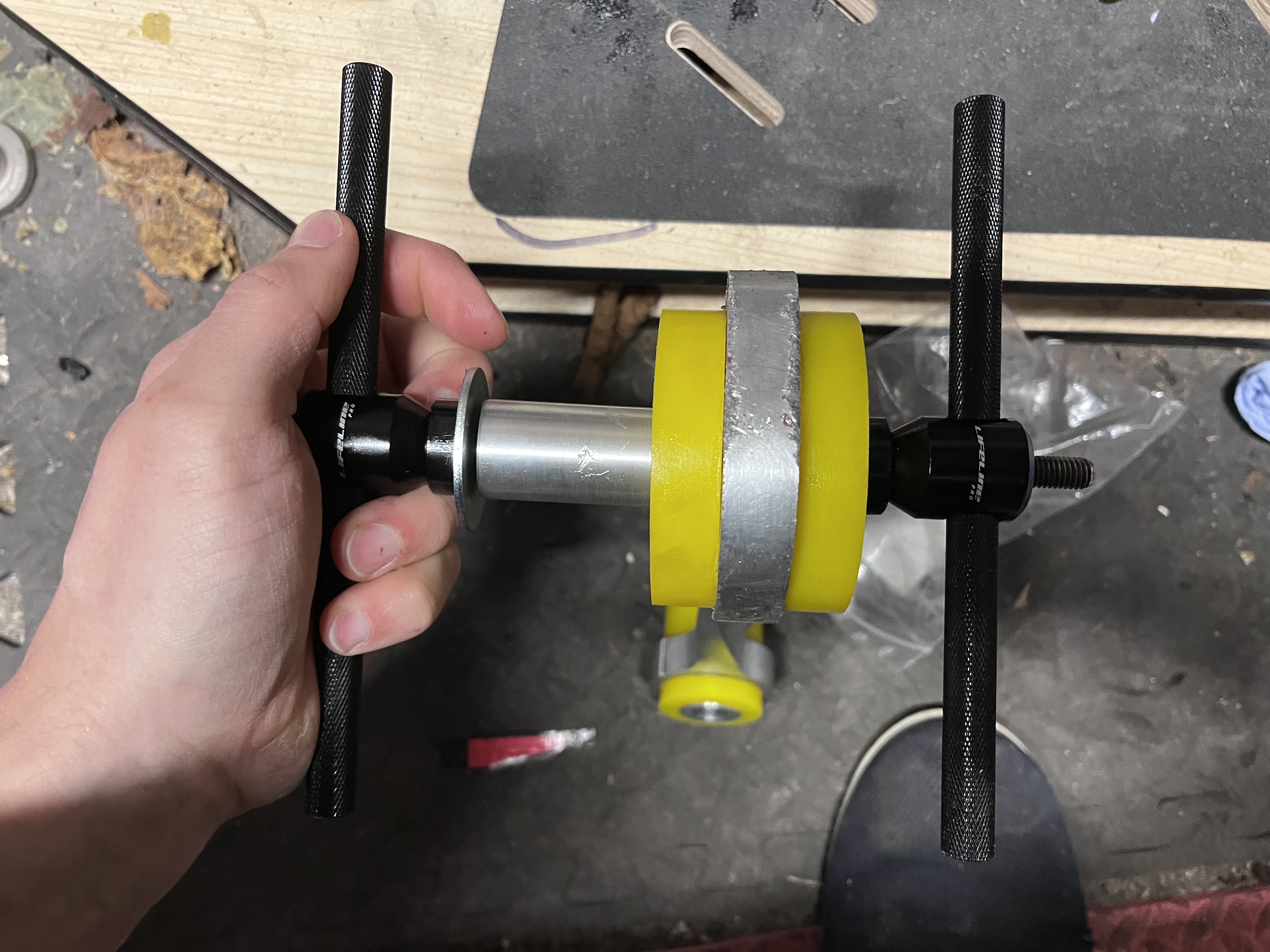

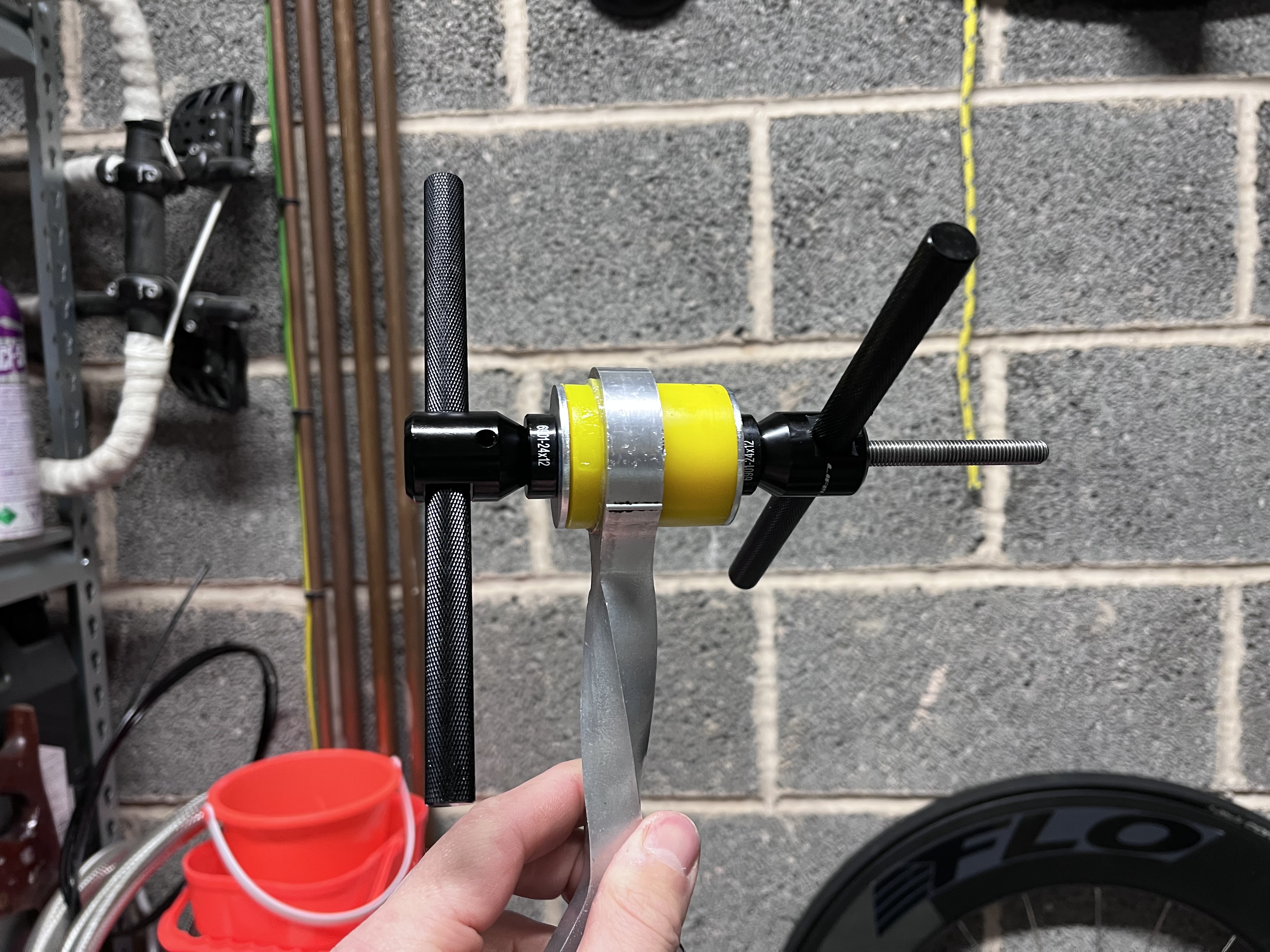

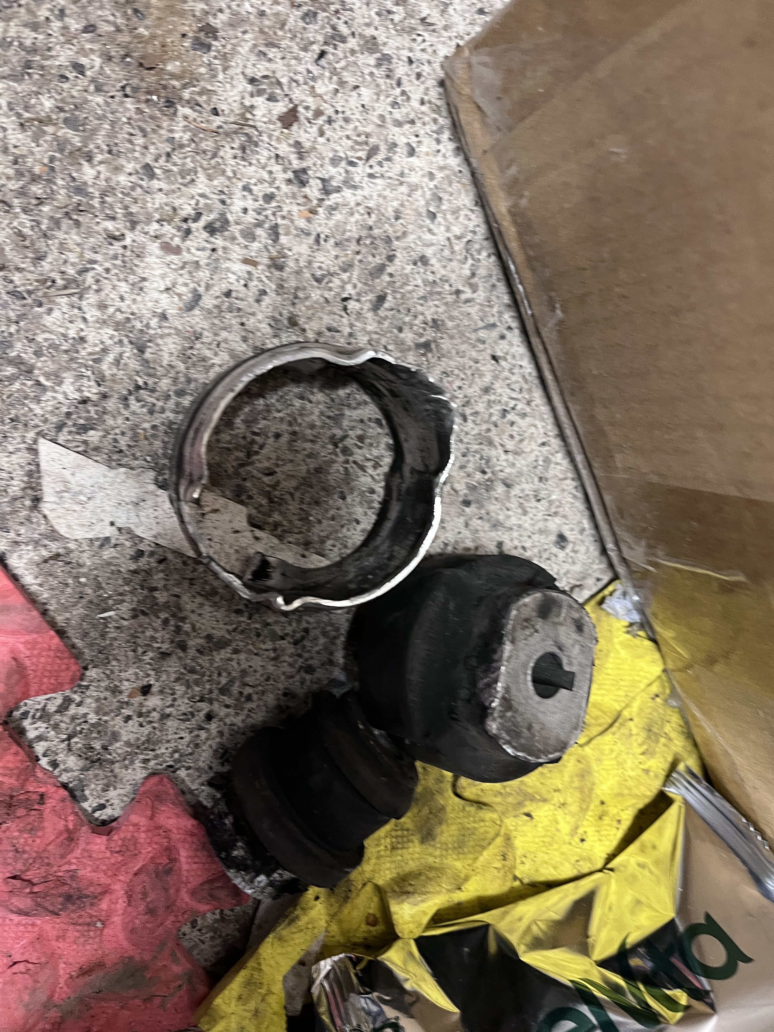

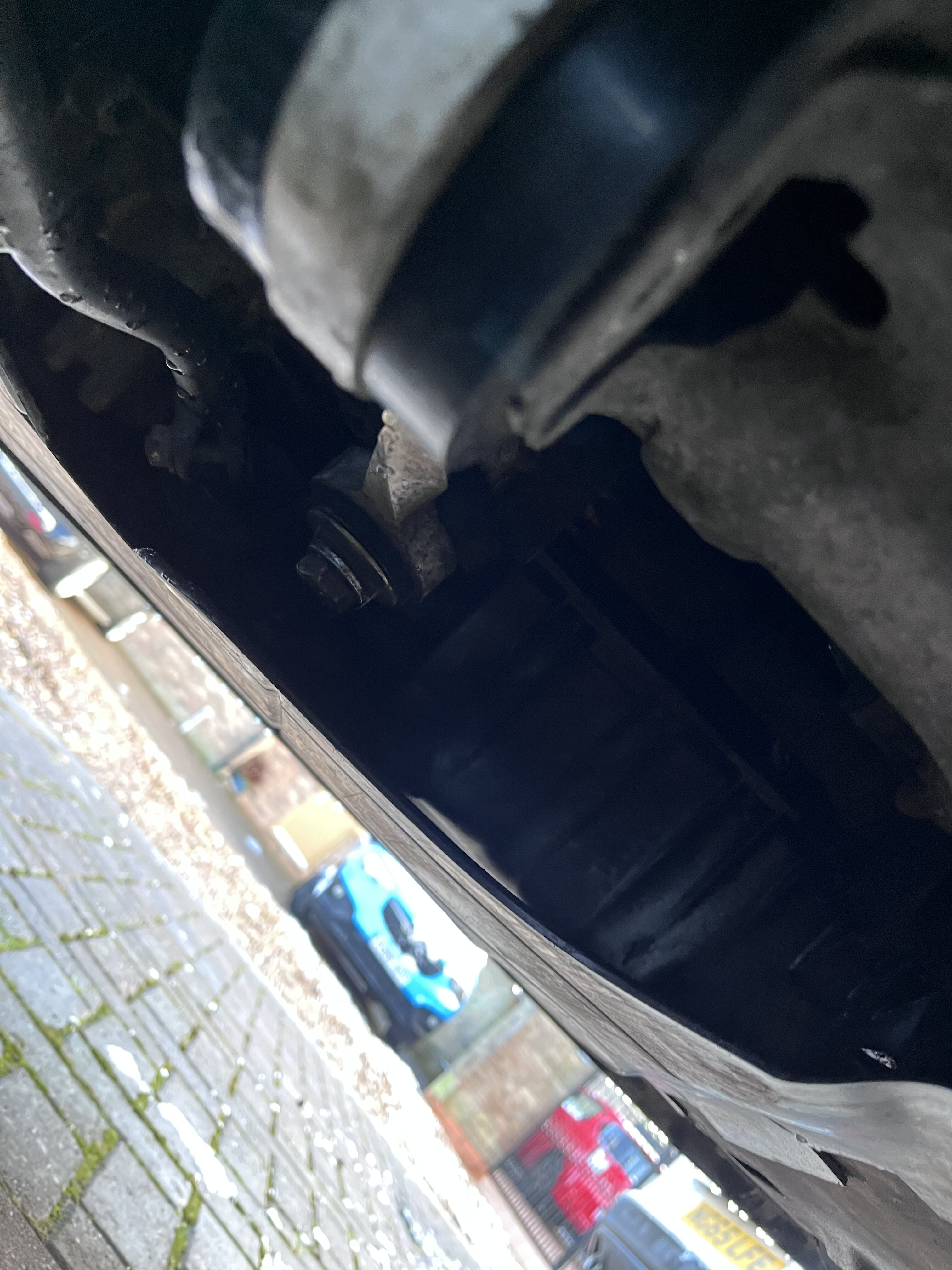

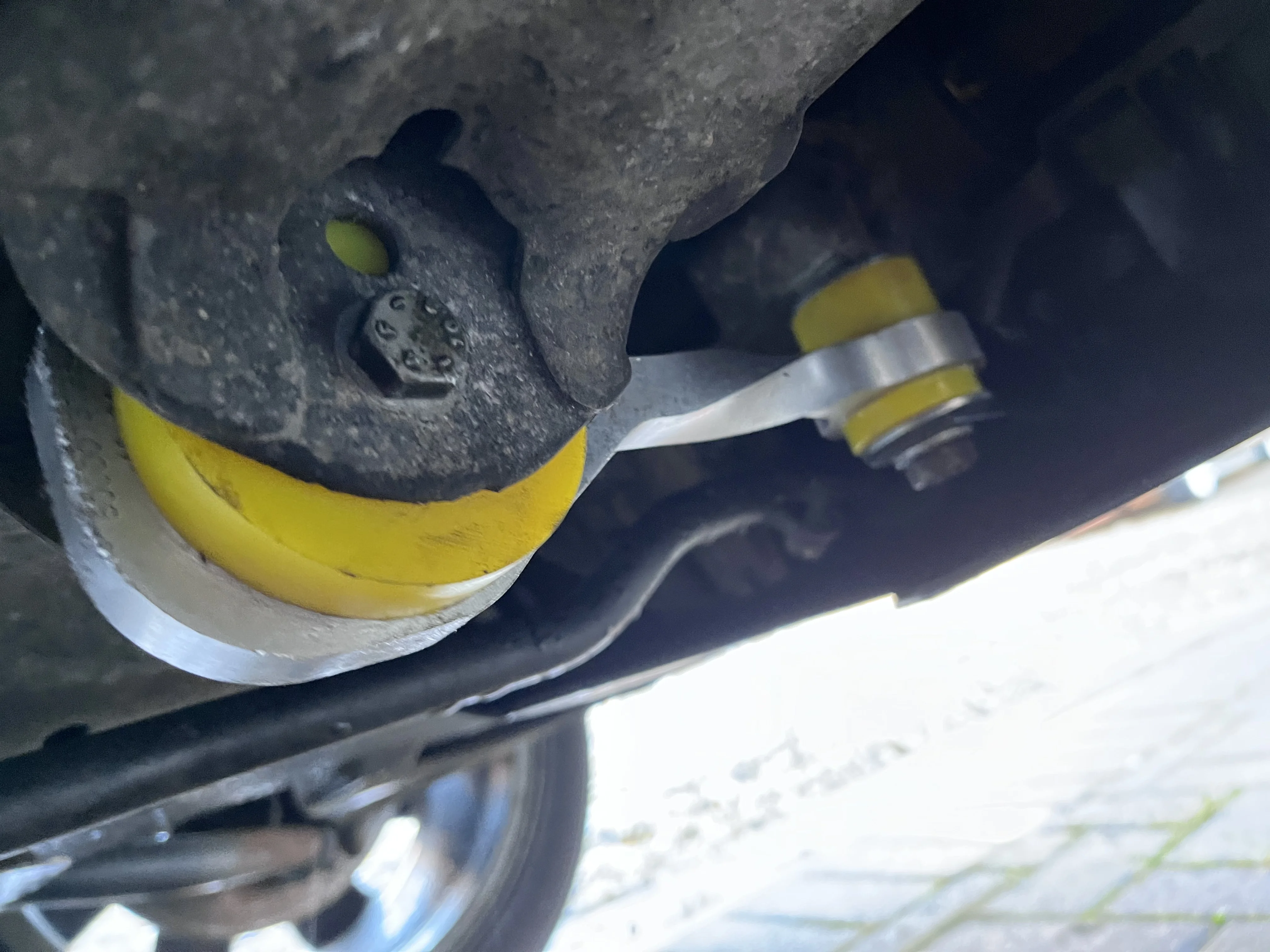

And here’s some of the worst photos you’ll see of a dog bone mount swap..
View attachment 1581535View attachment 1581536View attachment 1581537View attachment 1581538

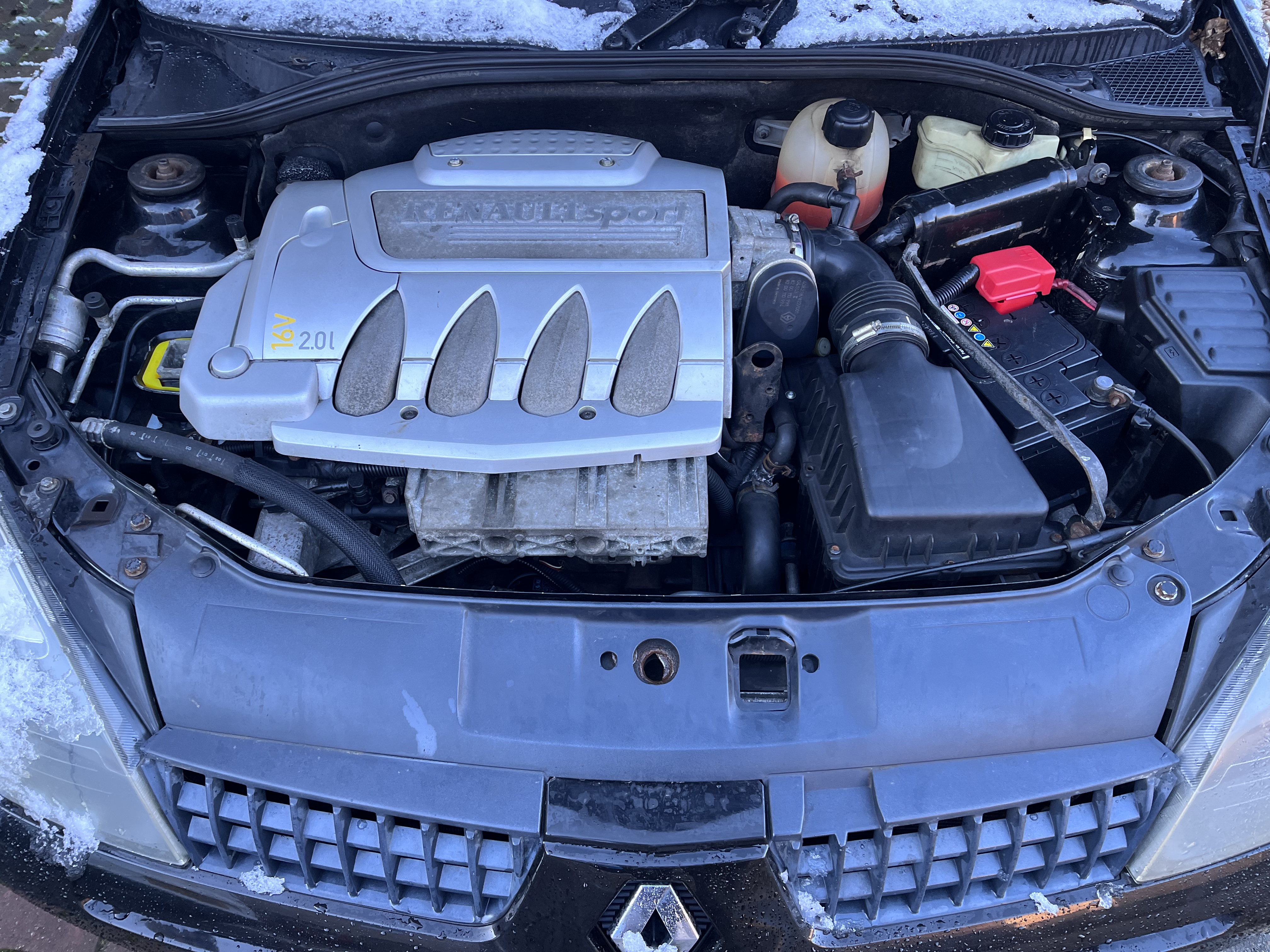

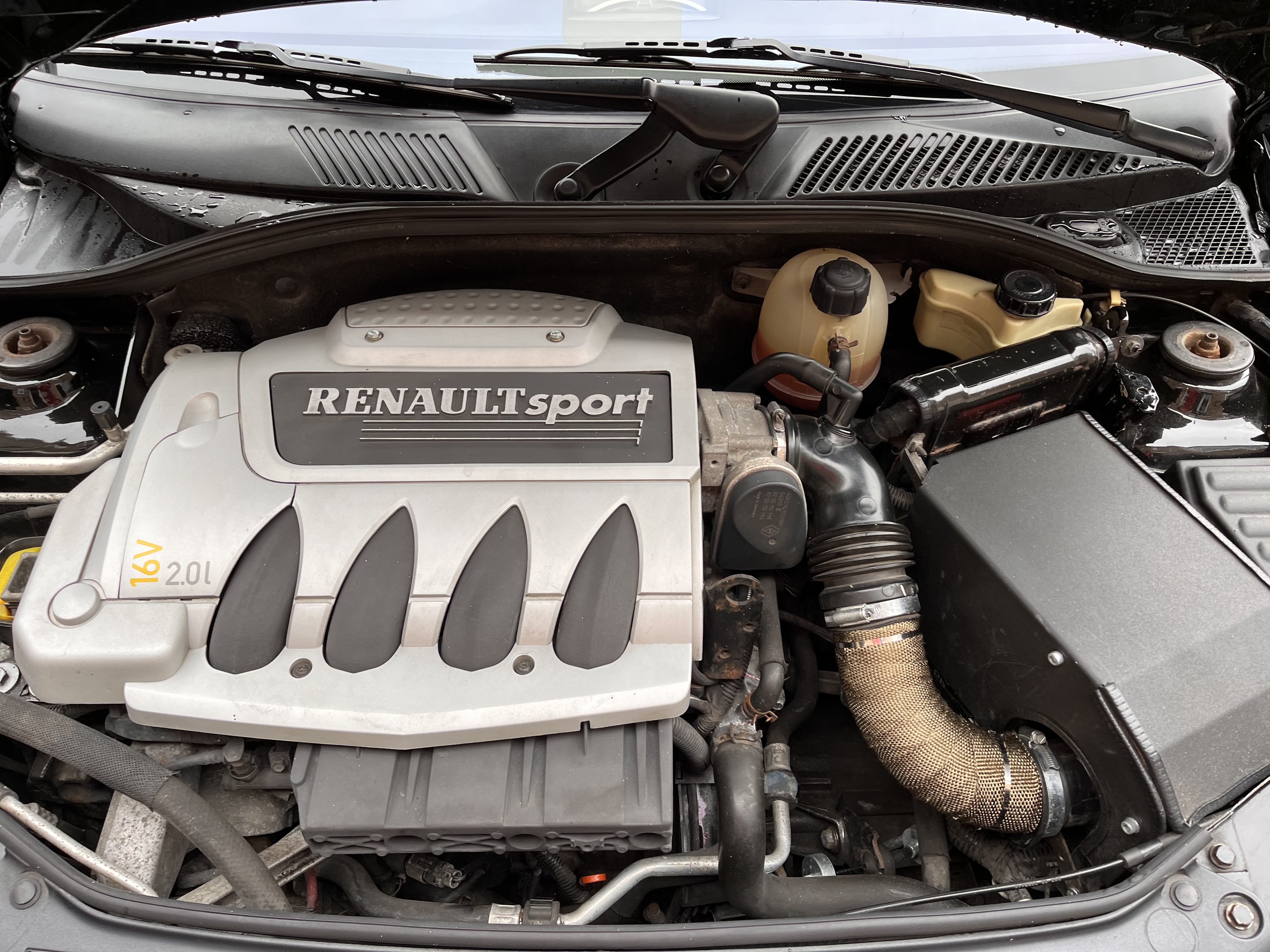

Battery cover, Intake and grill 😝

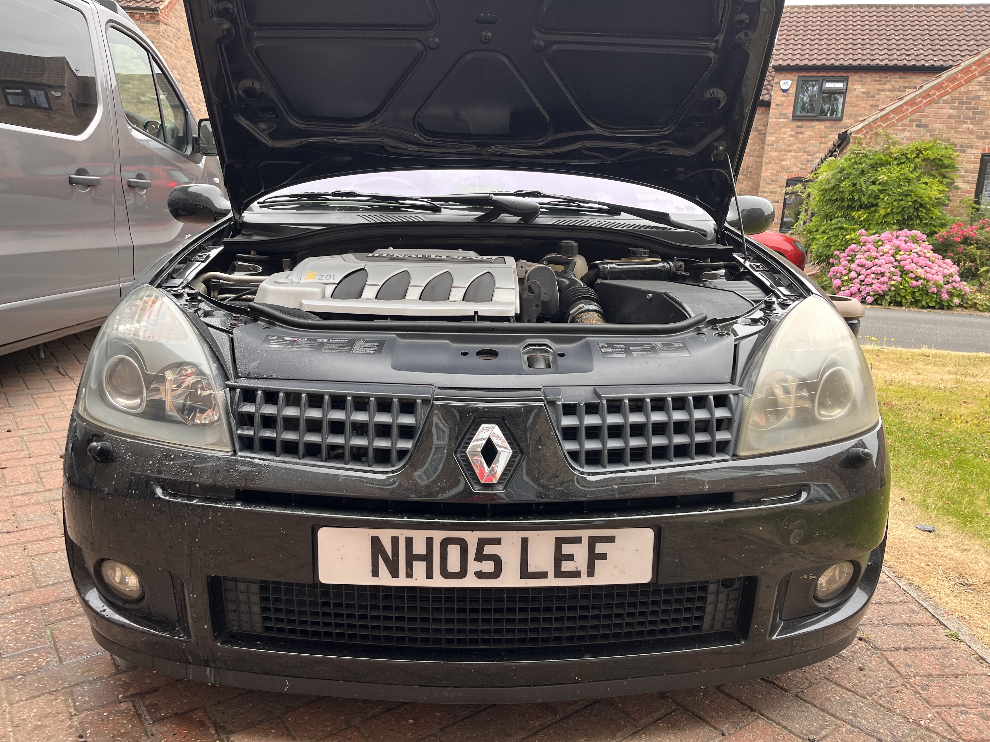

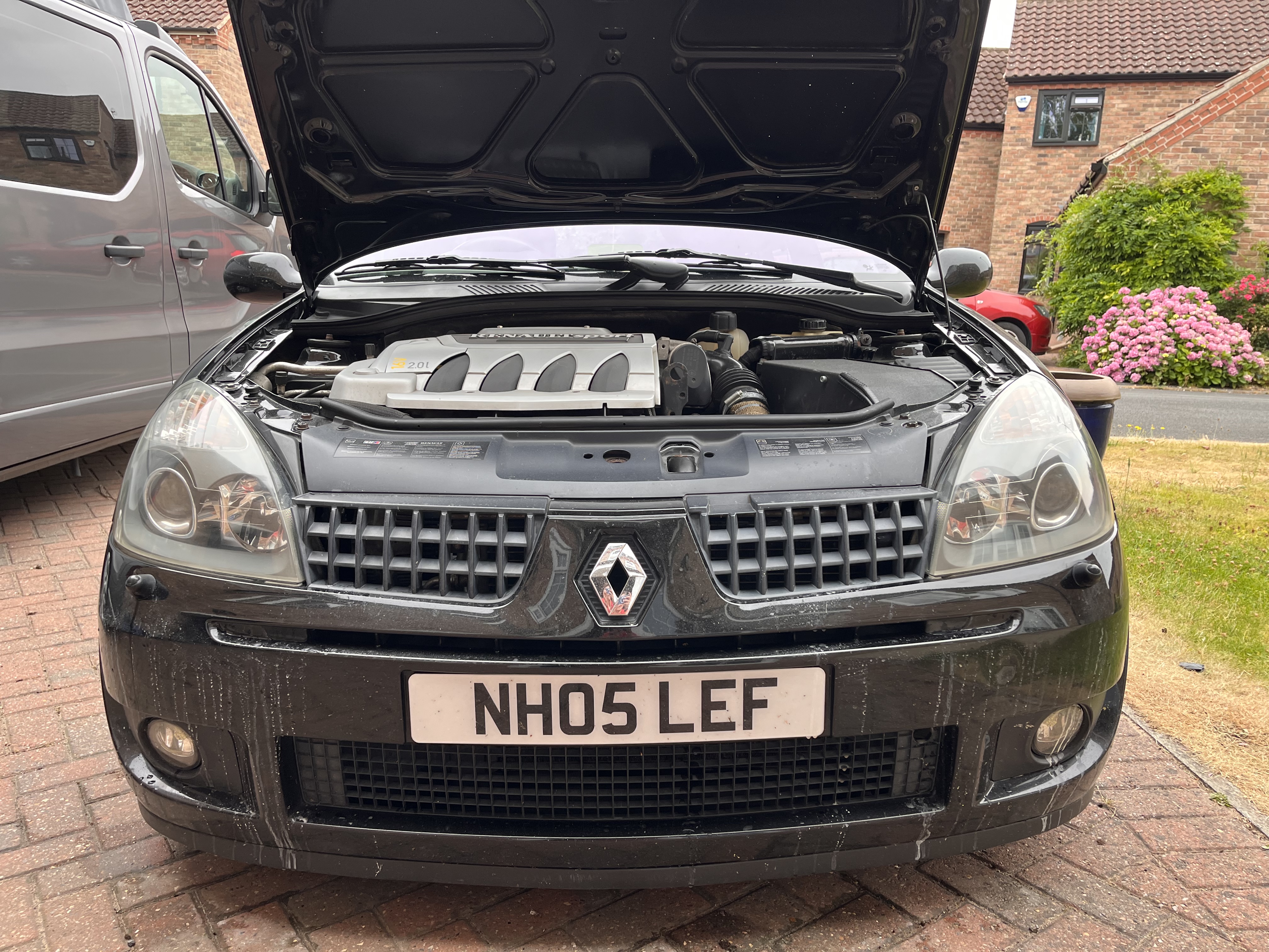

A very quick update. New plates are on but it very dirty and I can’t face it being on here is such a state so I’ll get some pics at the weekend when it’s clean!
Also a bit closer to under the bonnet being how I’d like it. Just need to figure out how to get the ÉCU cover off to paint and once that’s done it’s largely there bar some cleaning.
Pretty pleased with it tbh.

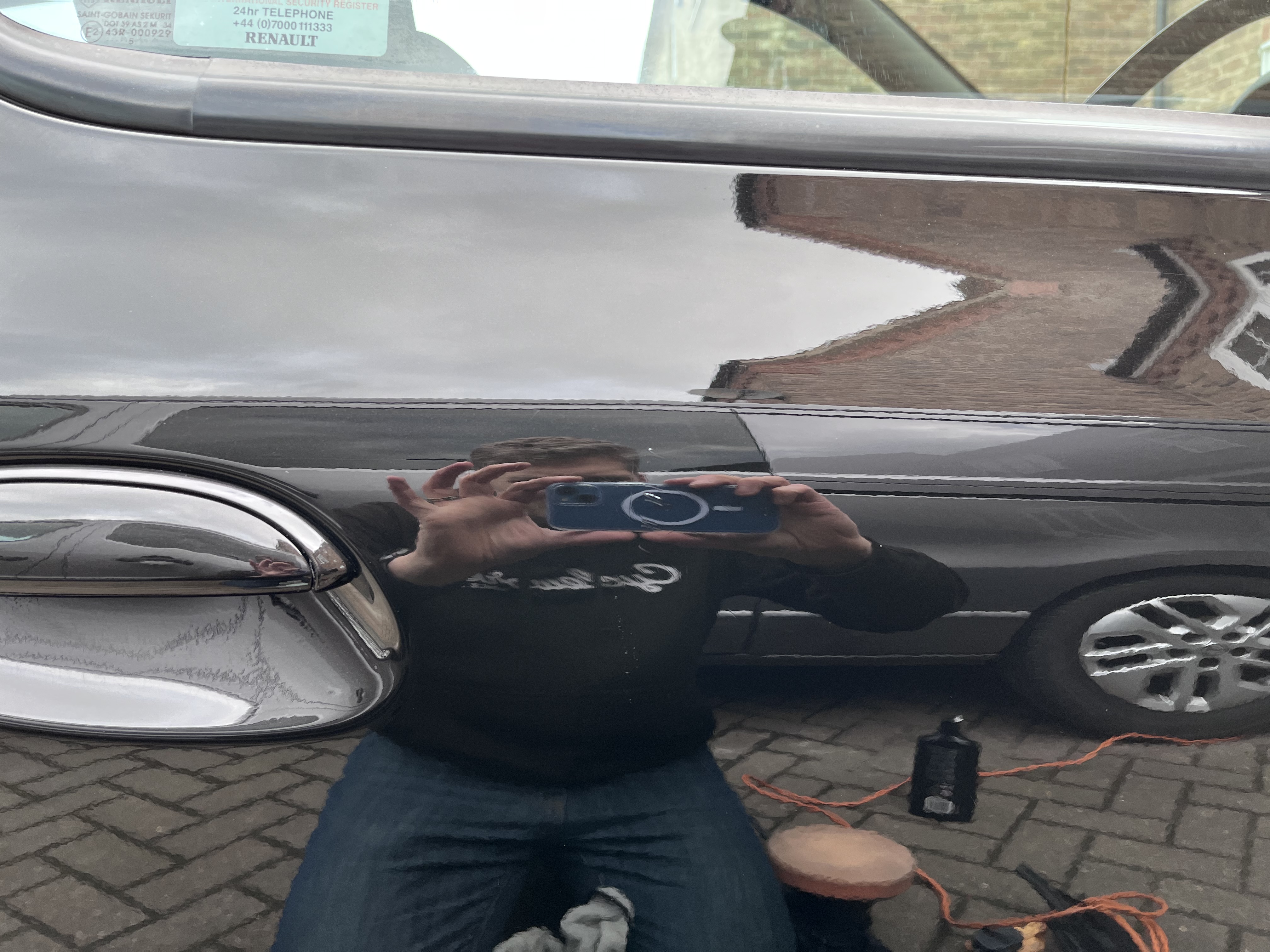

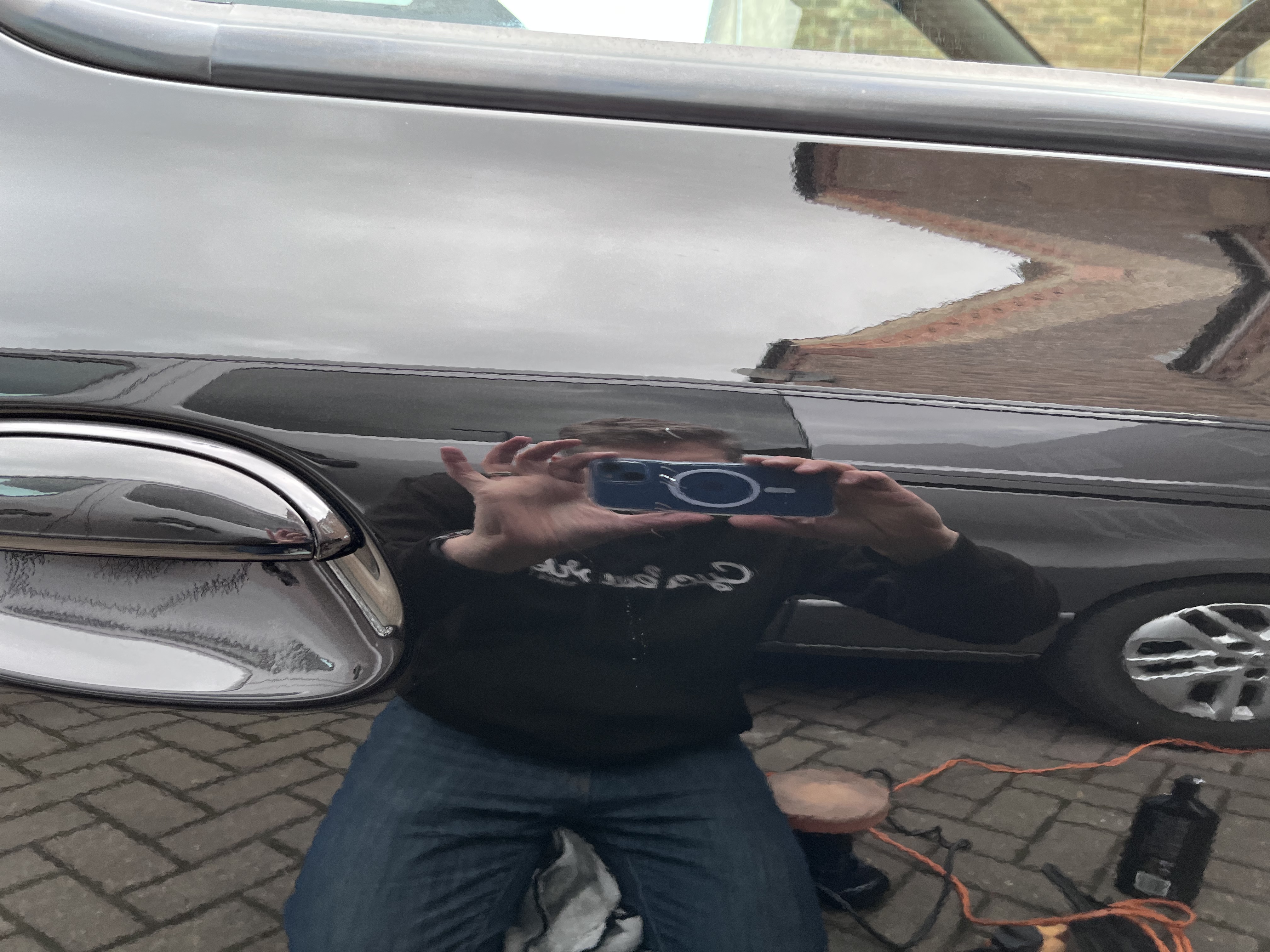

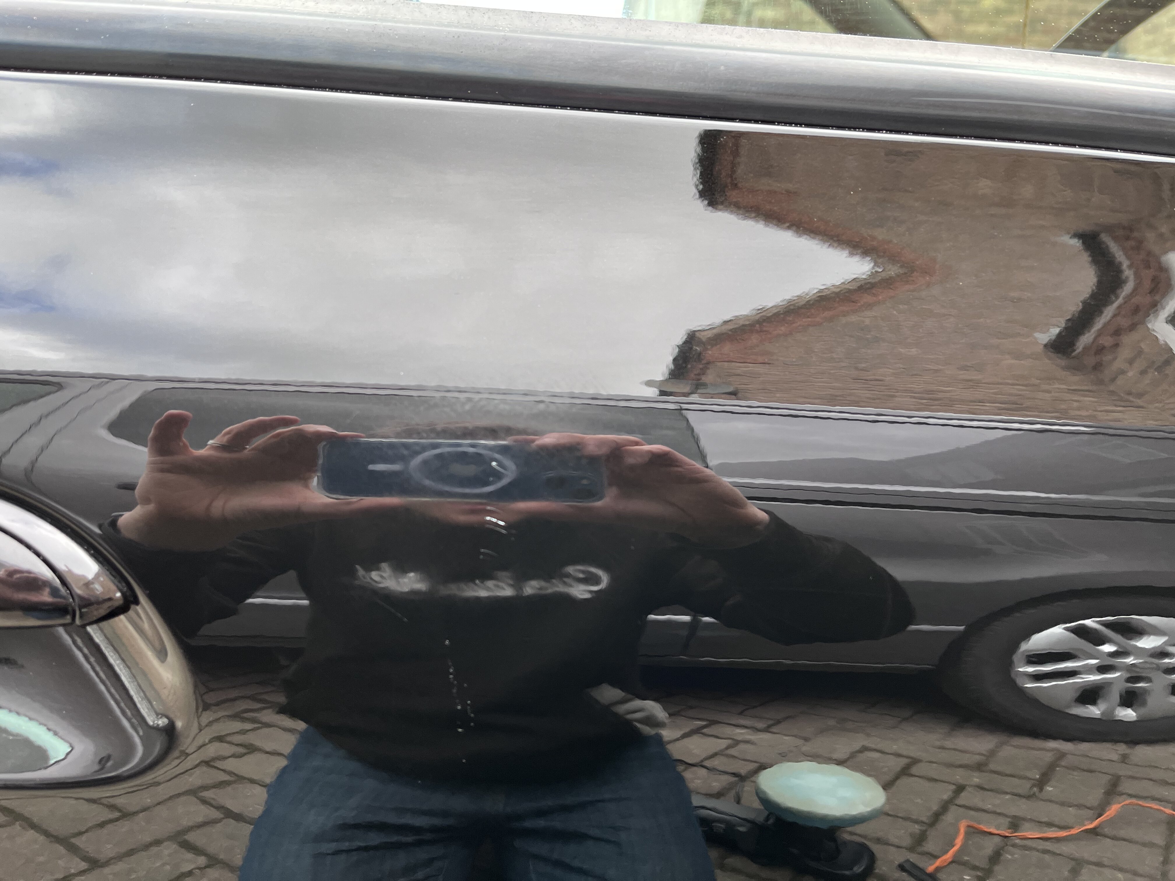

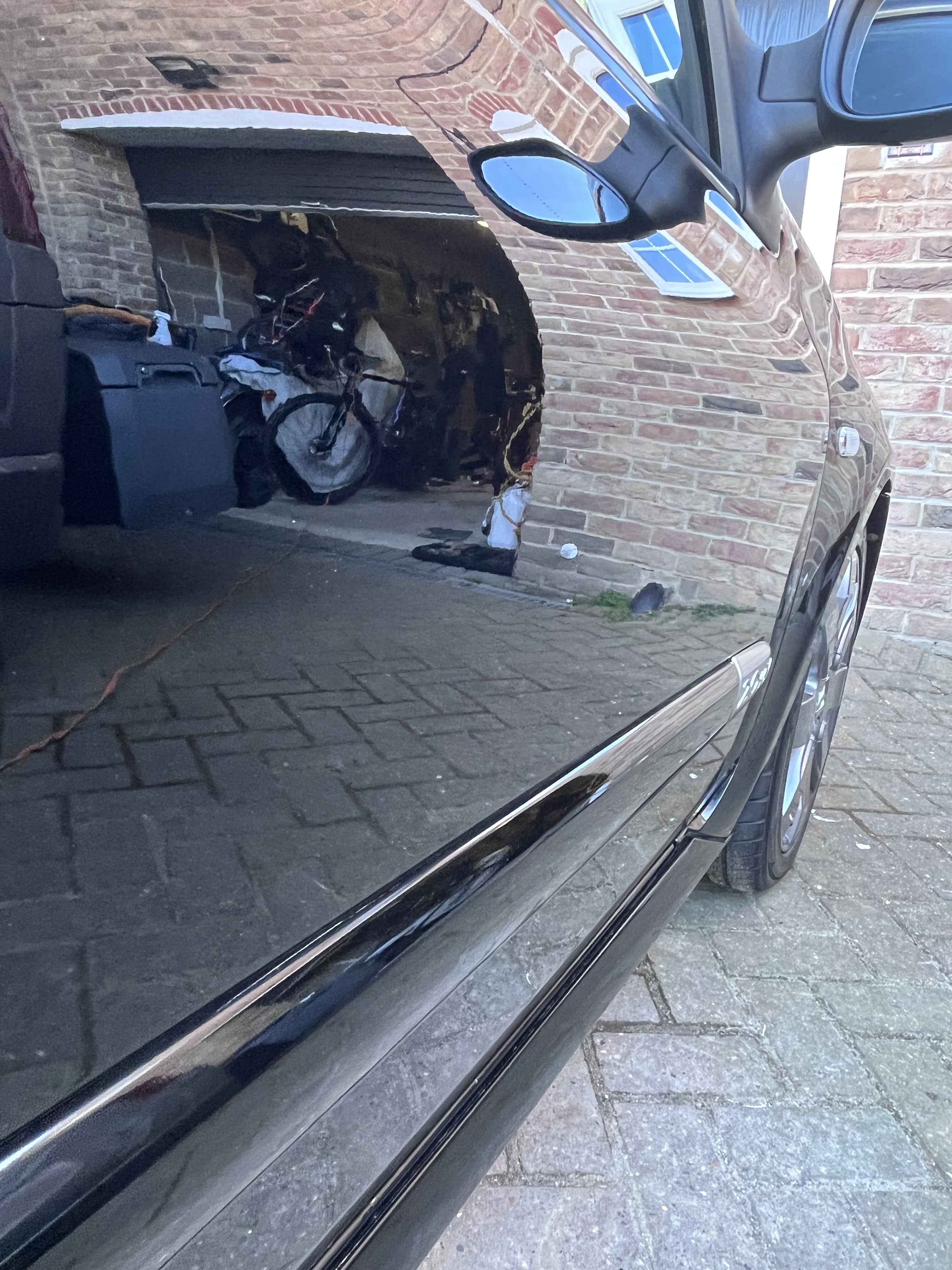

It’s been a while since I’ve done any wet sanding and I was a bit apprehensive, but just all on as there are some marks that I’m keen to get rid of, started on the door. Still not 100% but better than it was getting some more aggressive compound as mines run out, also some new pads. Hoping to get round the whole car and see where I can get to and decide how much need painting. Ideally I want to avoid a full re-spray.
Didn’t get a proper before pic…
First compound pass
second compound pass
First Polish pass
Second and final polish pass
After wax

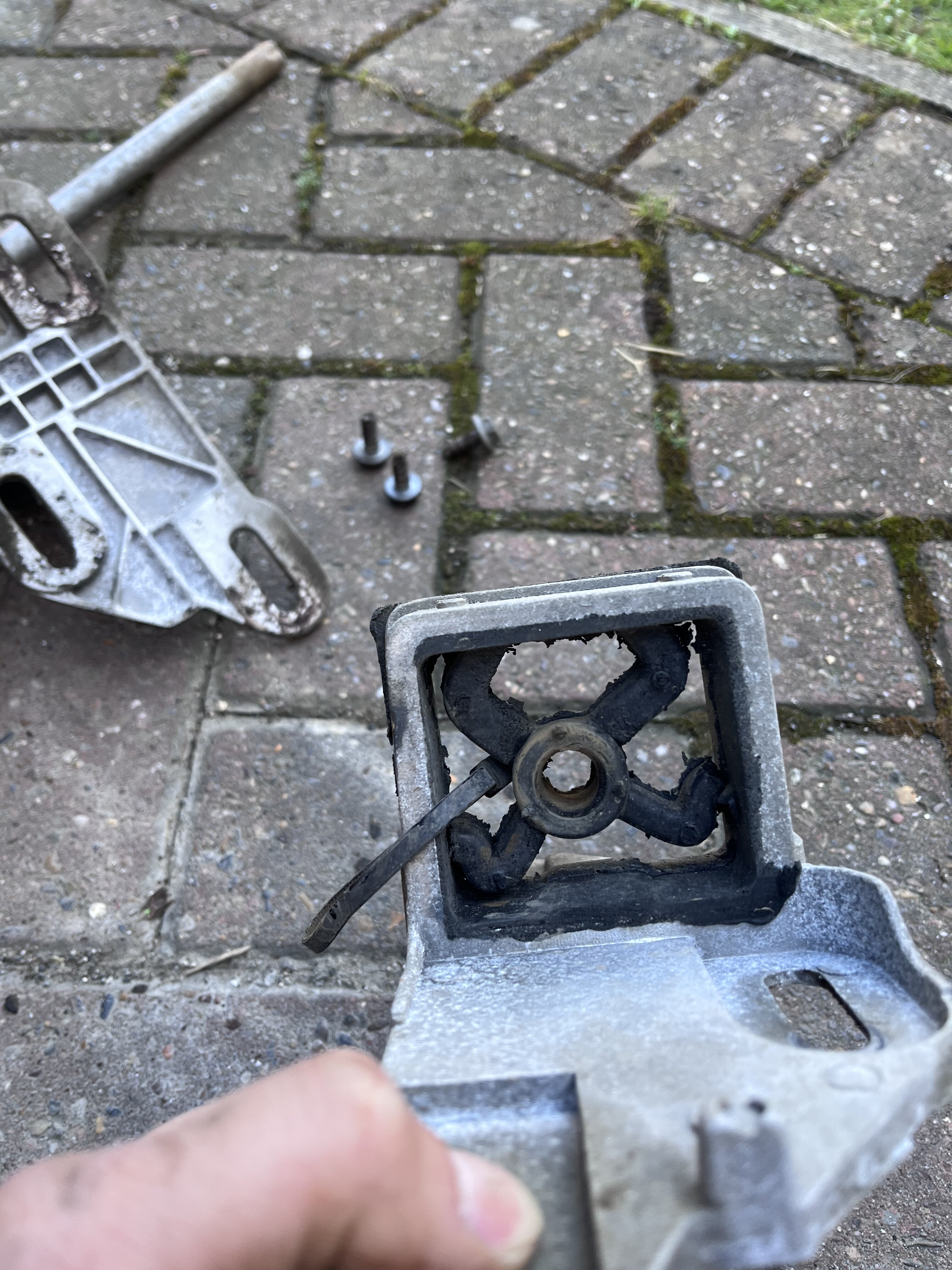

Exciting day today. New exhaust arrived. No photos as I was too keen to get into it. Sadly the joy turned to annoyance as there’s a pet missing, I managed to bidge the join but it’s very farty and sounds terrible. Pretty frustrating but KTec have been super helpful so far so i confident they’ll sort it quickly..
Was chuckling as I found all the zip ties holding the exhaust in place
also found a split in the centre section of the old system which also sounded farty, so happy with the swap, once this fits properly.
also orders a new centre section rubber as well as that needed 2 zip ties to hold the exhaust on, extra safe!!
so a few more things to sort out then I’ll get some more pictures.
Zipties are probably stonger than a lot of the rubber Renault used on their exhaust hangers on these :ROFLMAO:.

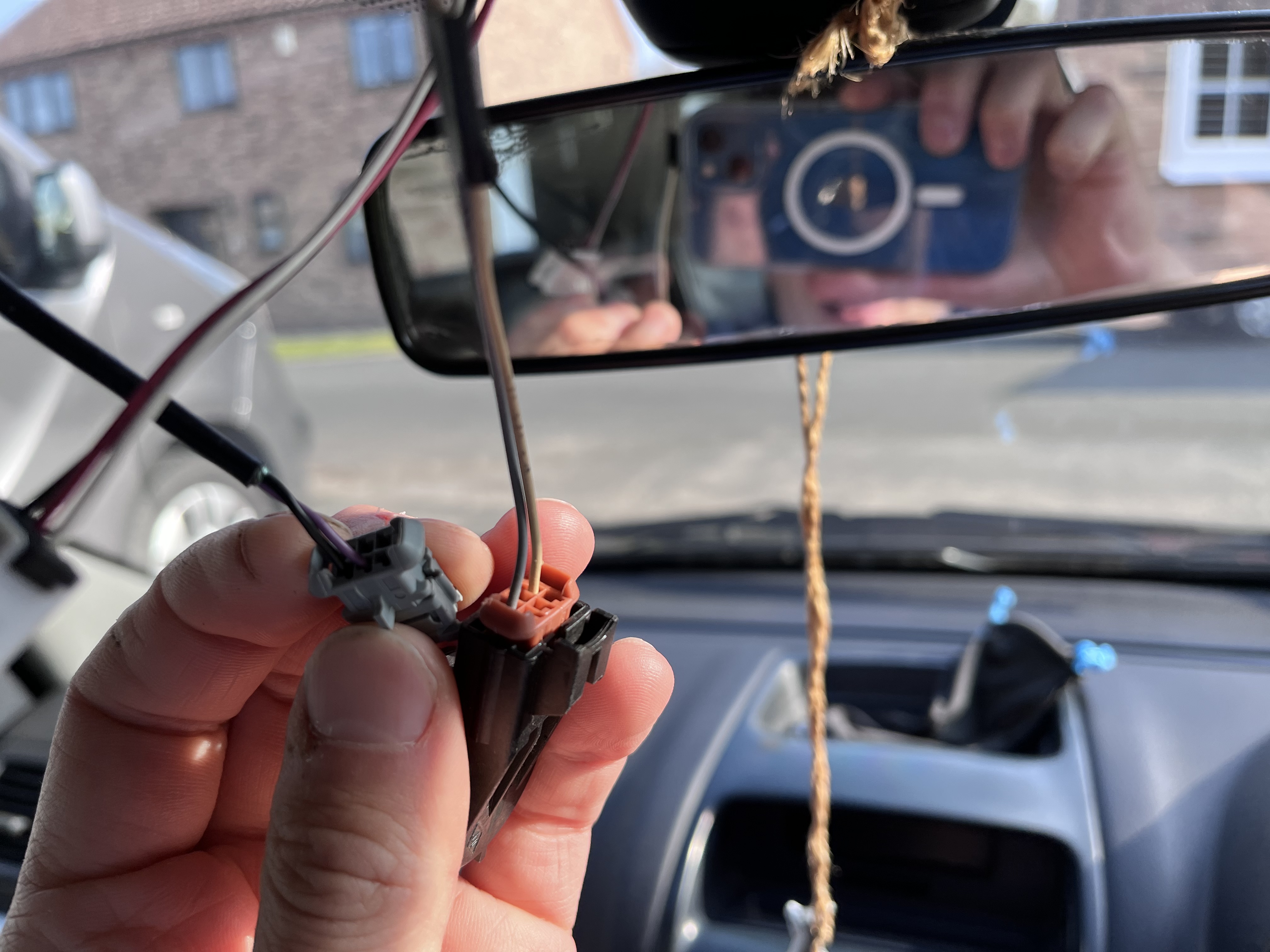

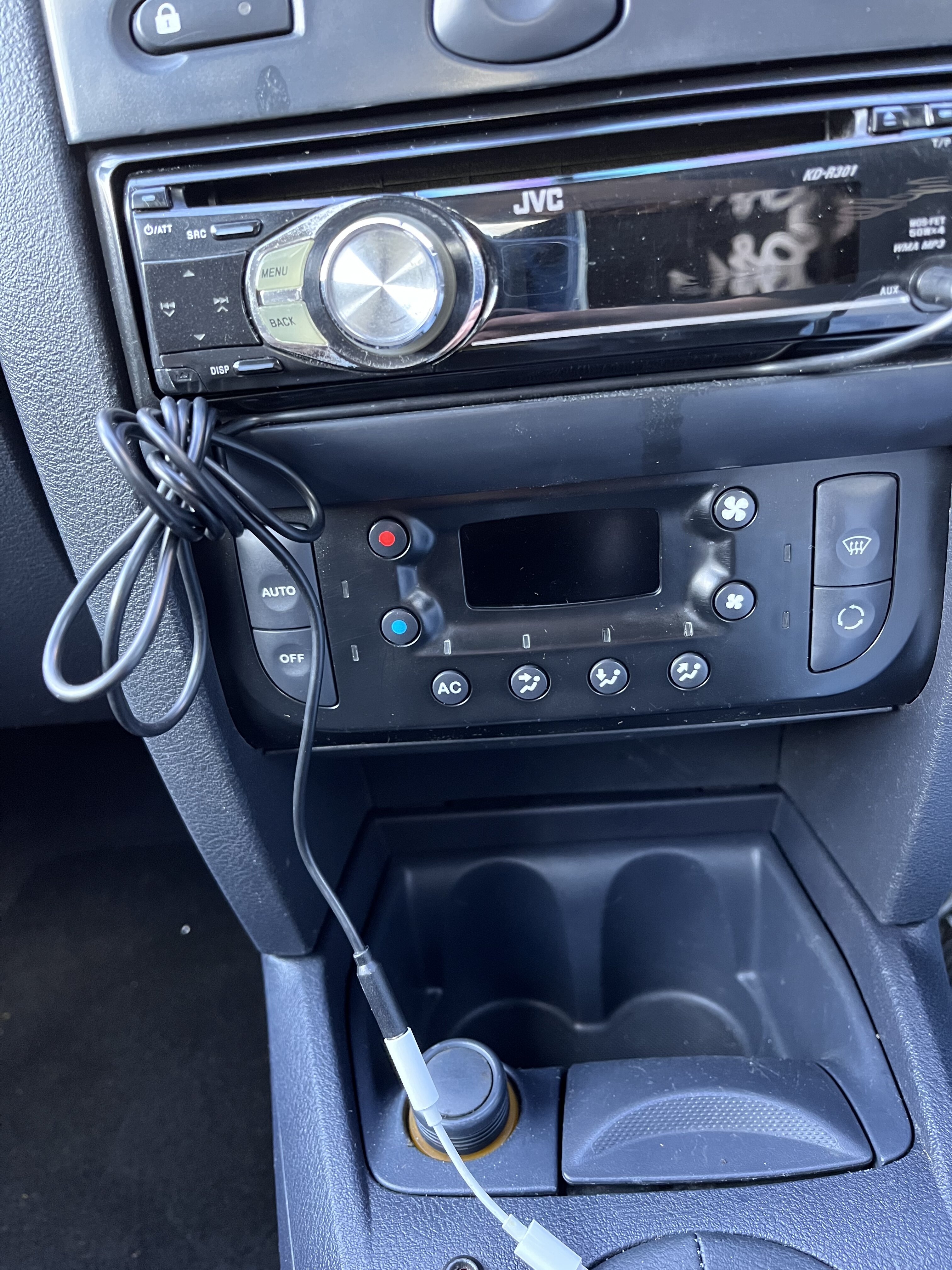

mon other news I may be on to something with my heating issue, it’s seems to be linked to an issue with one or both of them temperature sensors, could be as simple as the exterior sensor needing to be replaced (although it reading correctly) or rheee could be a break in the wire somewhere. So I’ll be looking to do some more investigation into that. Feels like I’m making slow progress.
finally, I’m starting to get a little frustrated with Ktec. The exhaust didn’t come with all the parts, the stub to connect to my cat wasn’t in the box I raised this last Friday and I’ve spoken to them twice now and I was assured the stub would be sent to arrive today, nothing. So I currently have a car I can’t drive which is pretty annoying as it’s my daily, currently having to go everywhere in the camper van.
Well blow me down… I’ve fixed the heater issue!! Mega happy. A bit more fault finding and looking at wiring diagrams and I found that the wrong connector was connected. There’s two similar connectors and the wrong was attached.
The grey connector was attached and the orange one should have been attached. Swapped them over and huzzah! All fixed!

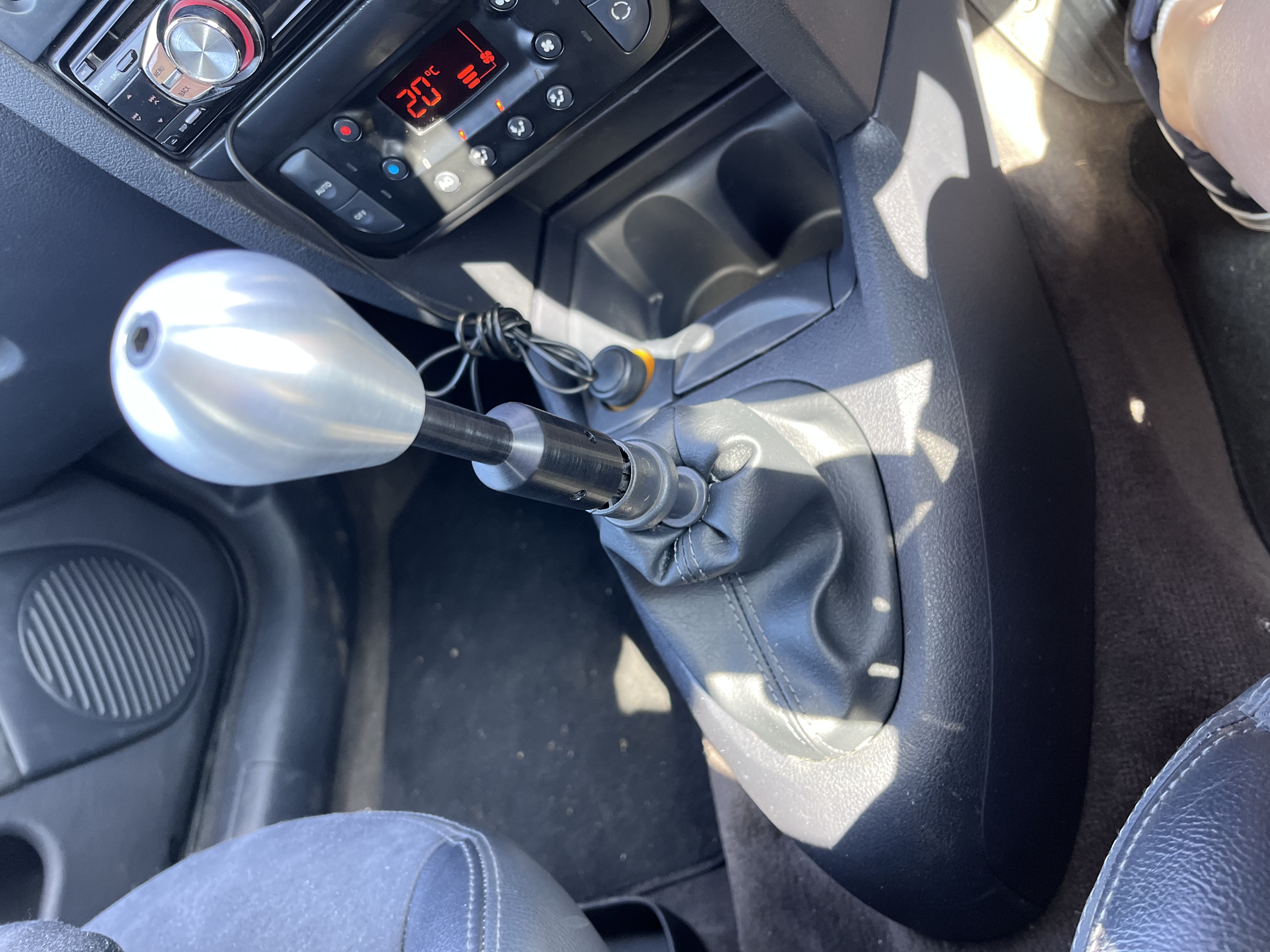

Another new gear knob, this one a cook sport with longer “shaft” (stop sniggering at the back), much nicer in terms of looks and general position… throw is now really long though, but I’m not that fussed by that at the moment as it’s not like i drove it super hard, might get a short shift linkage at some point.

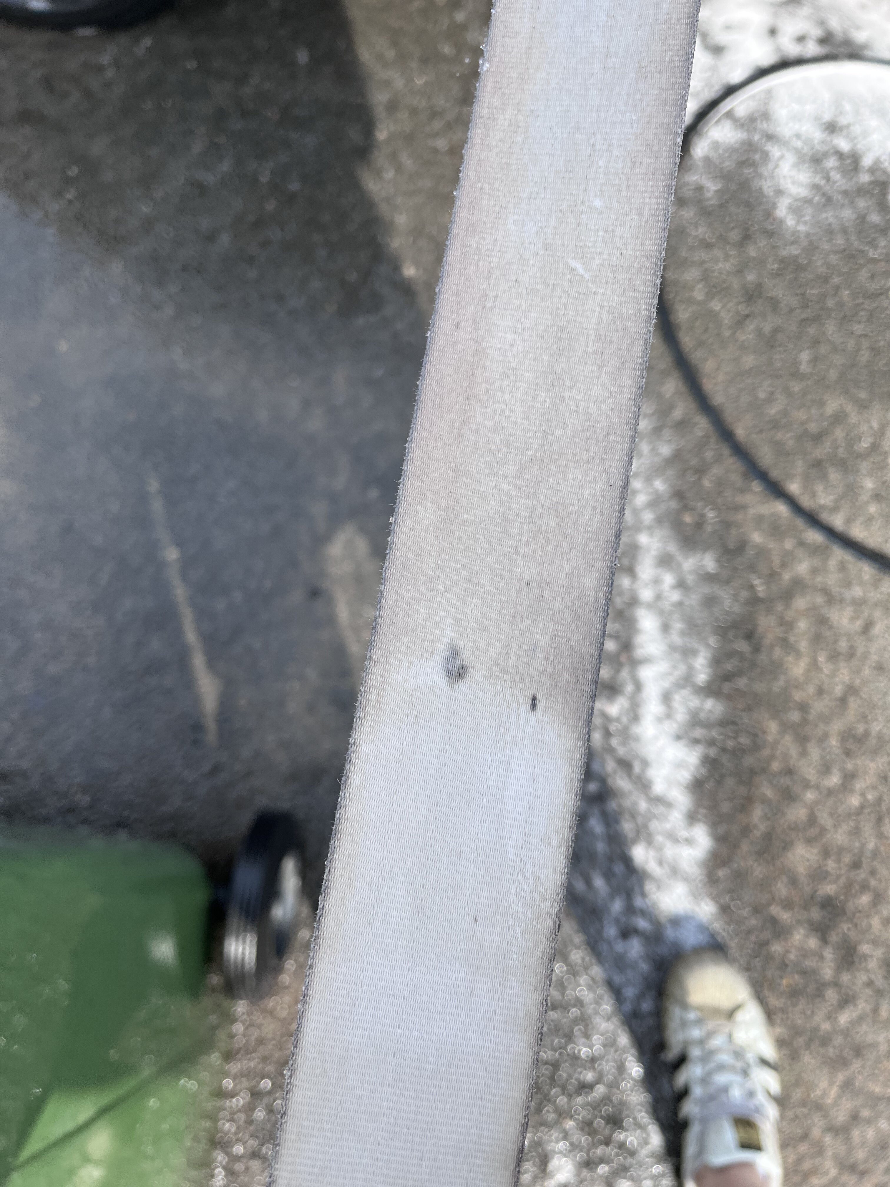

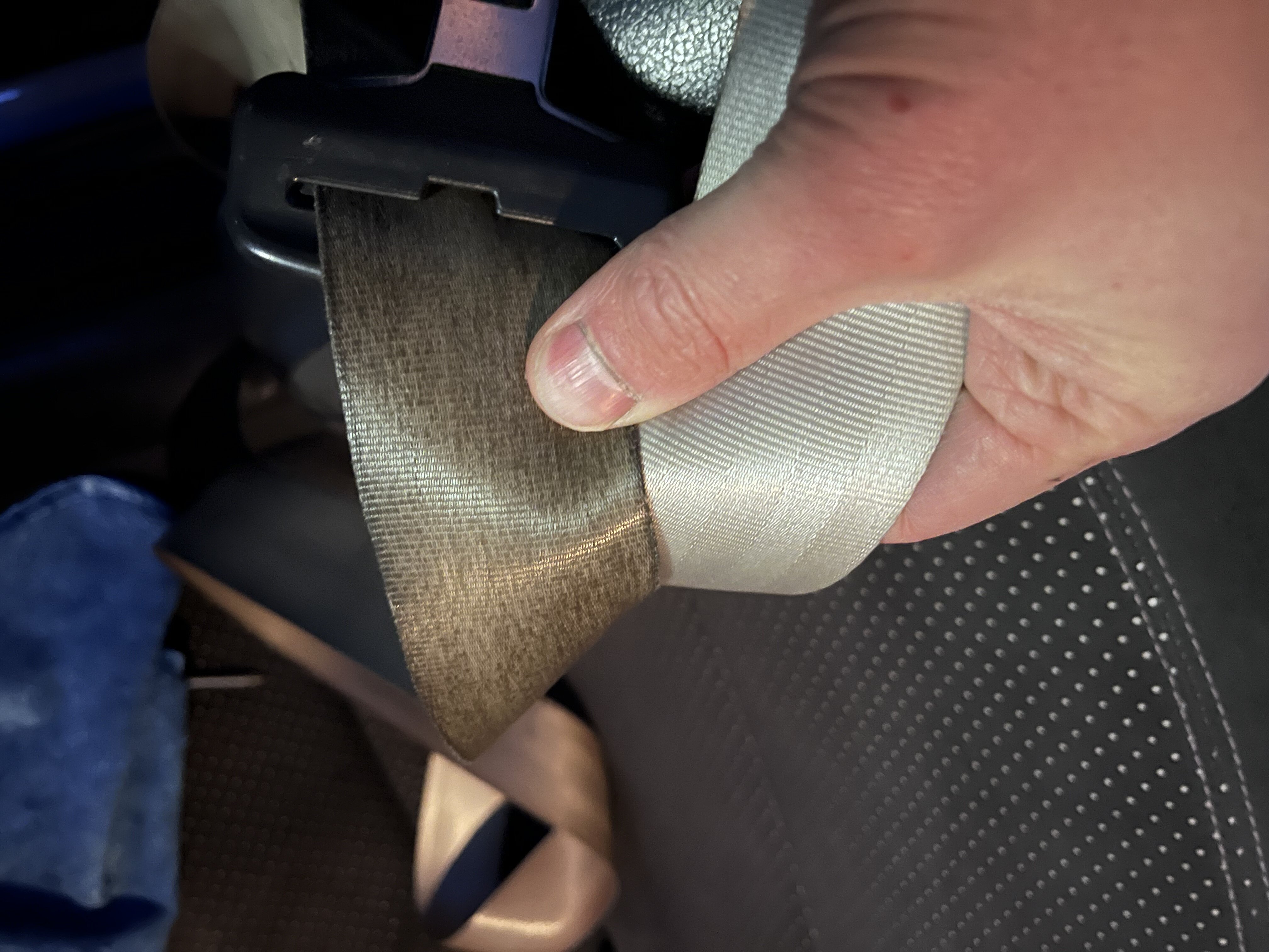

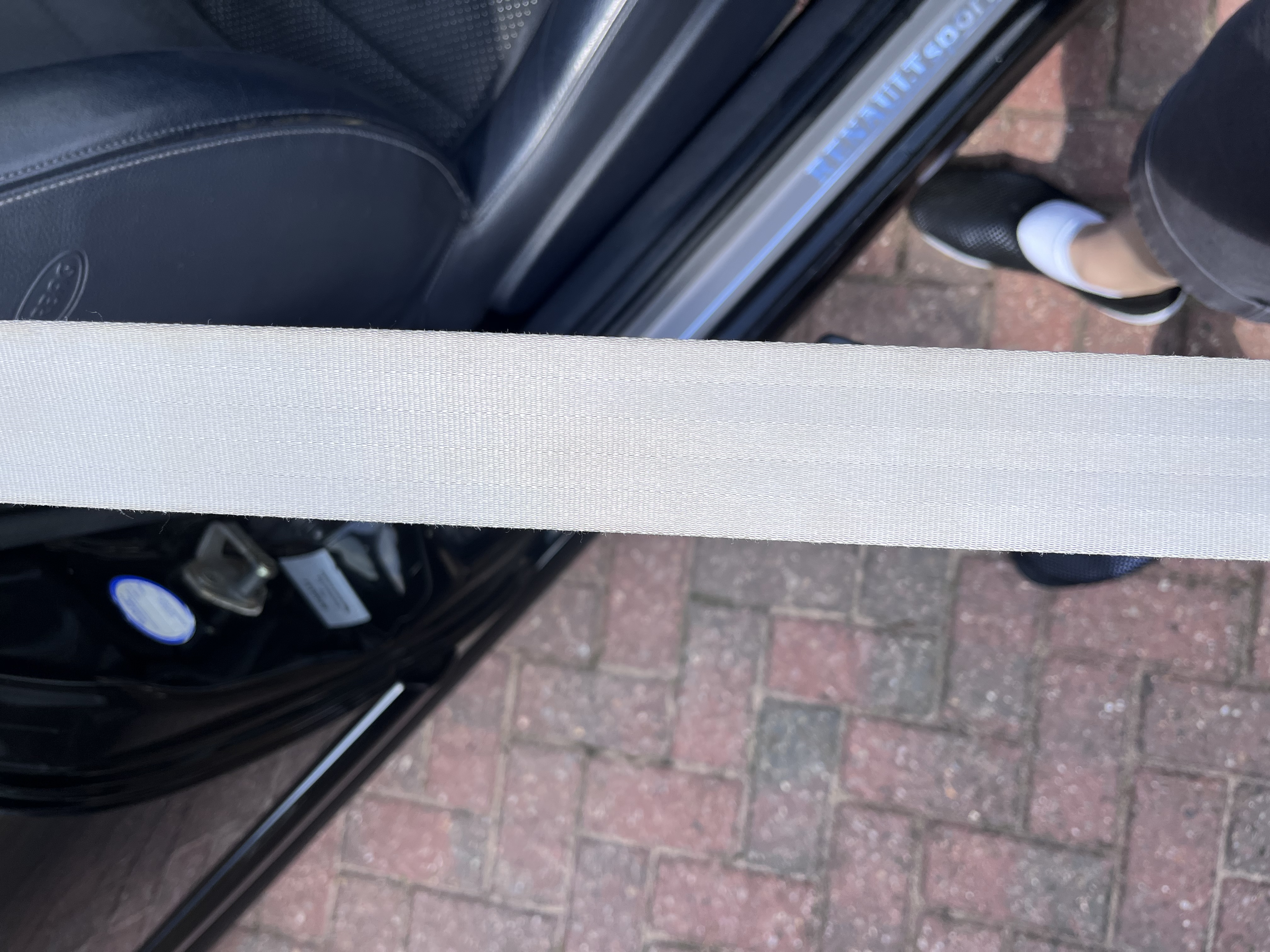

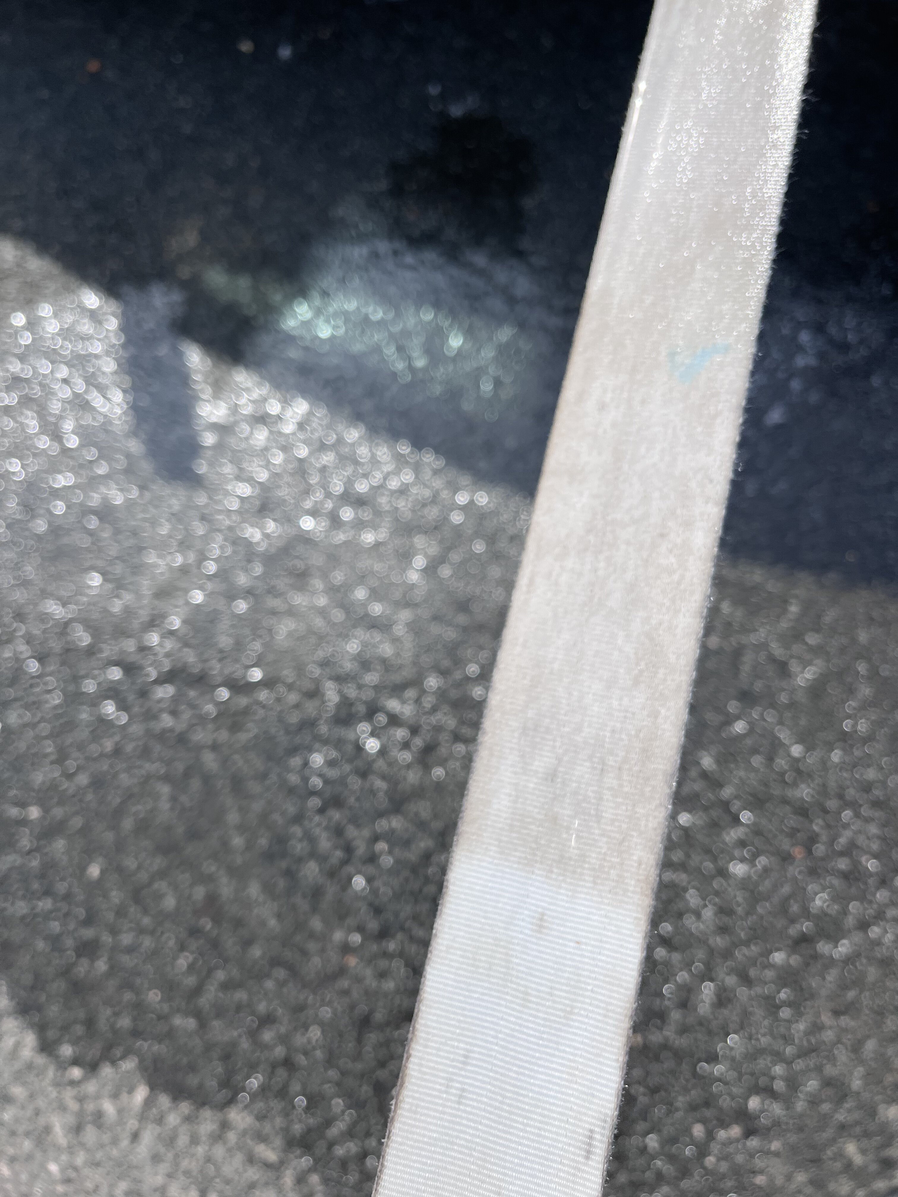

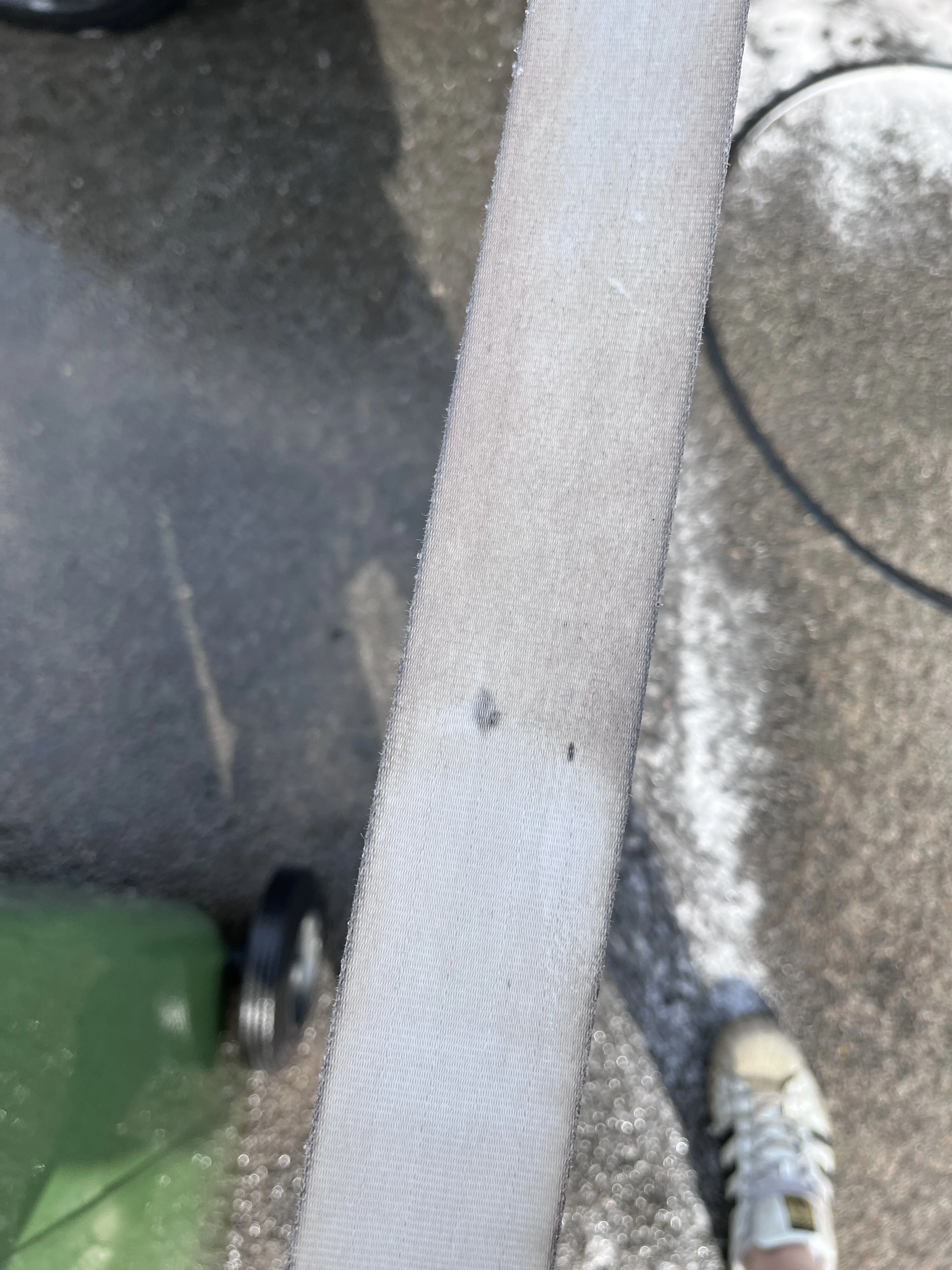

cleaned the seat belts, they look massive better now, still not 100% but not sure I can do much more other than replace them.
before
during
after

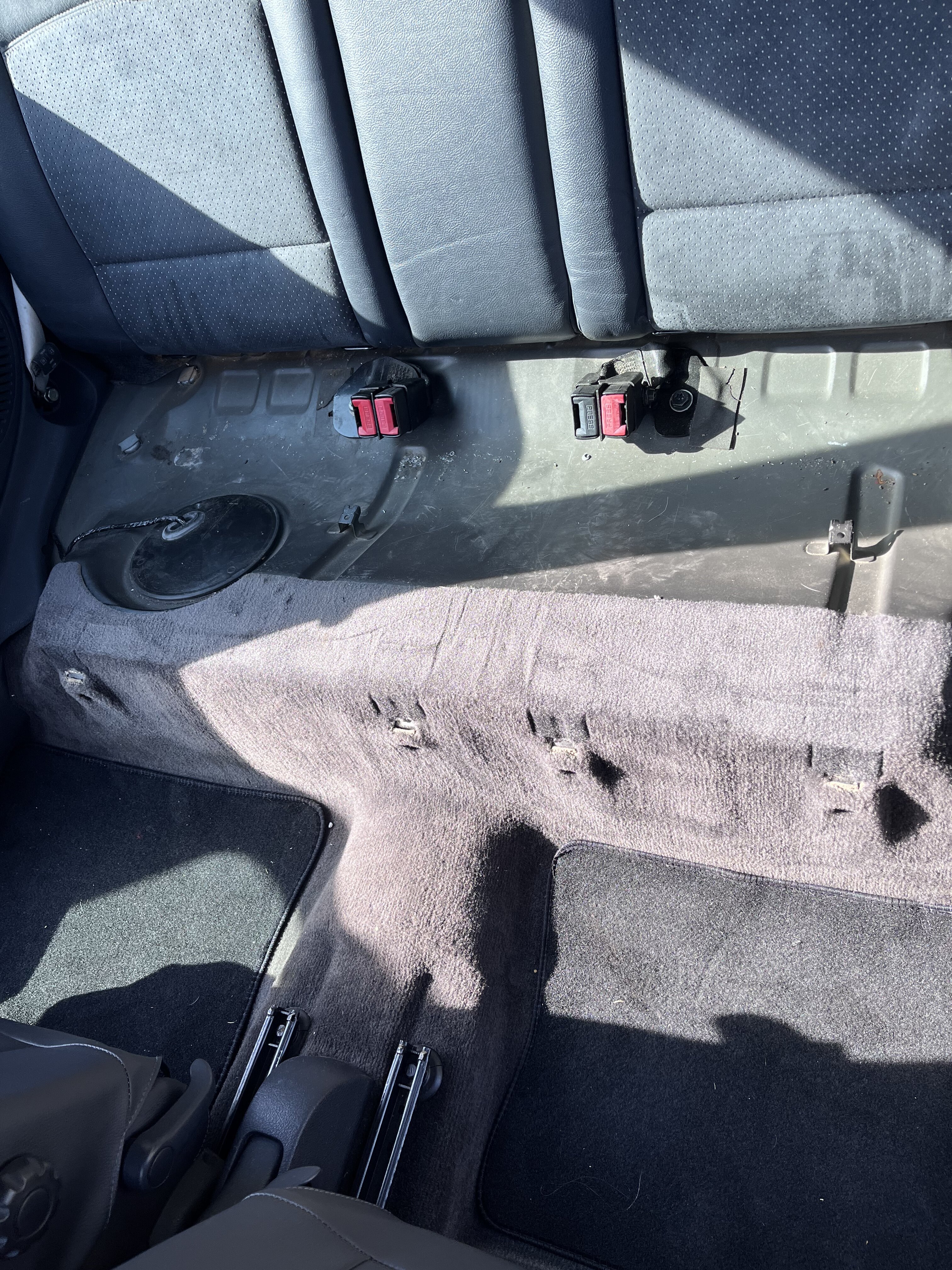

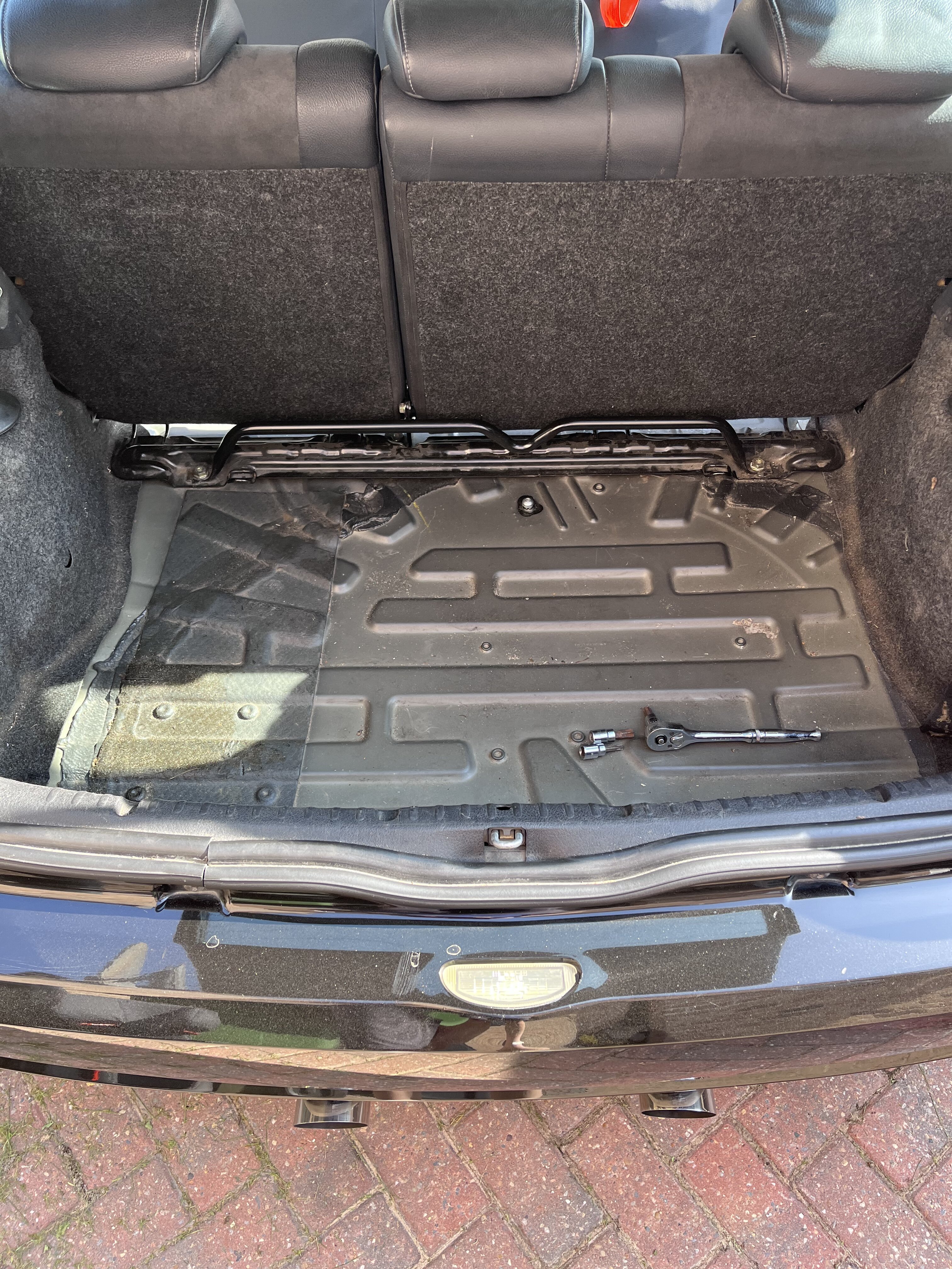

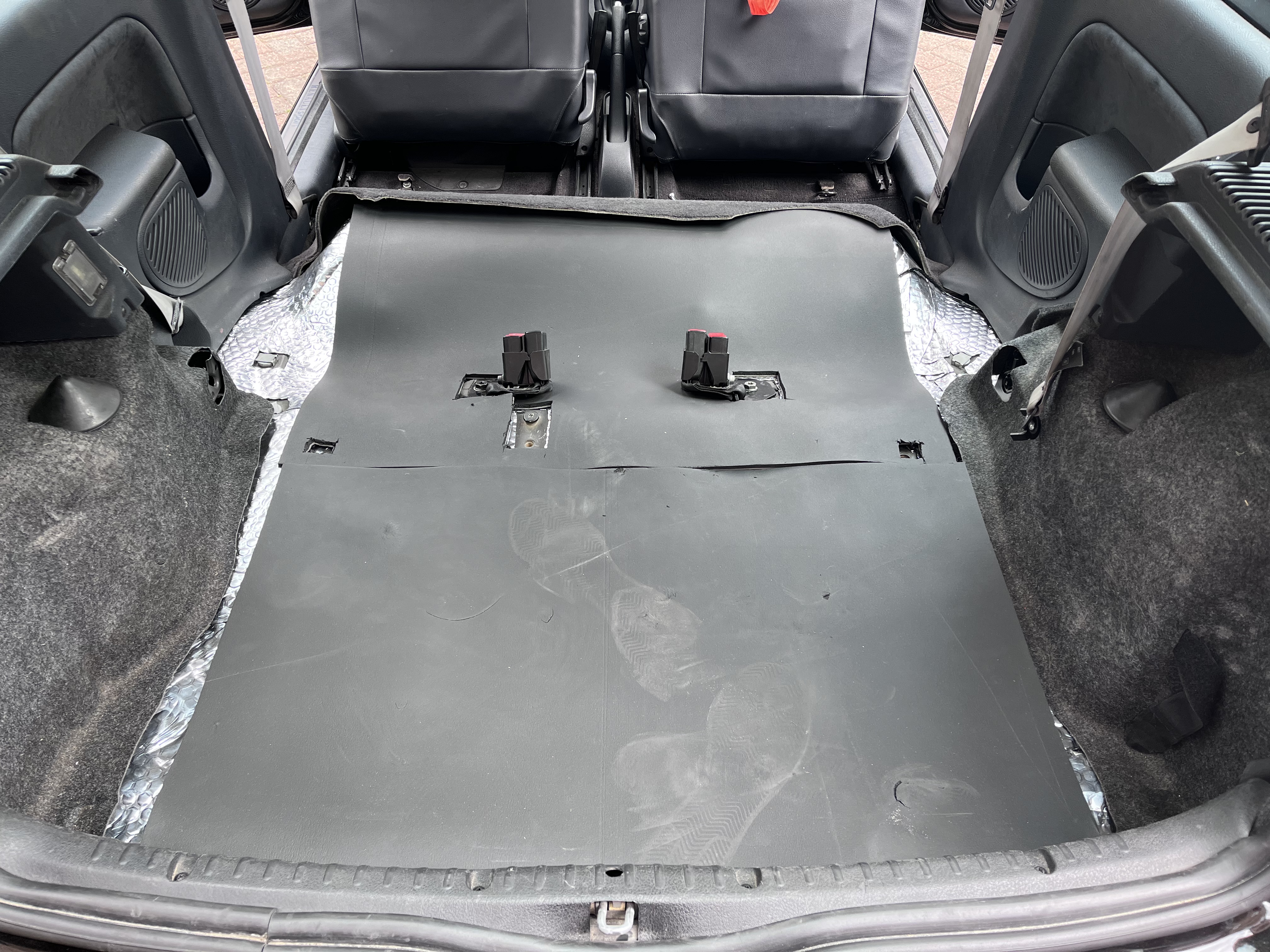

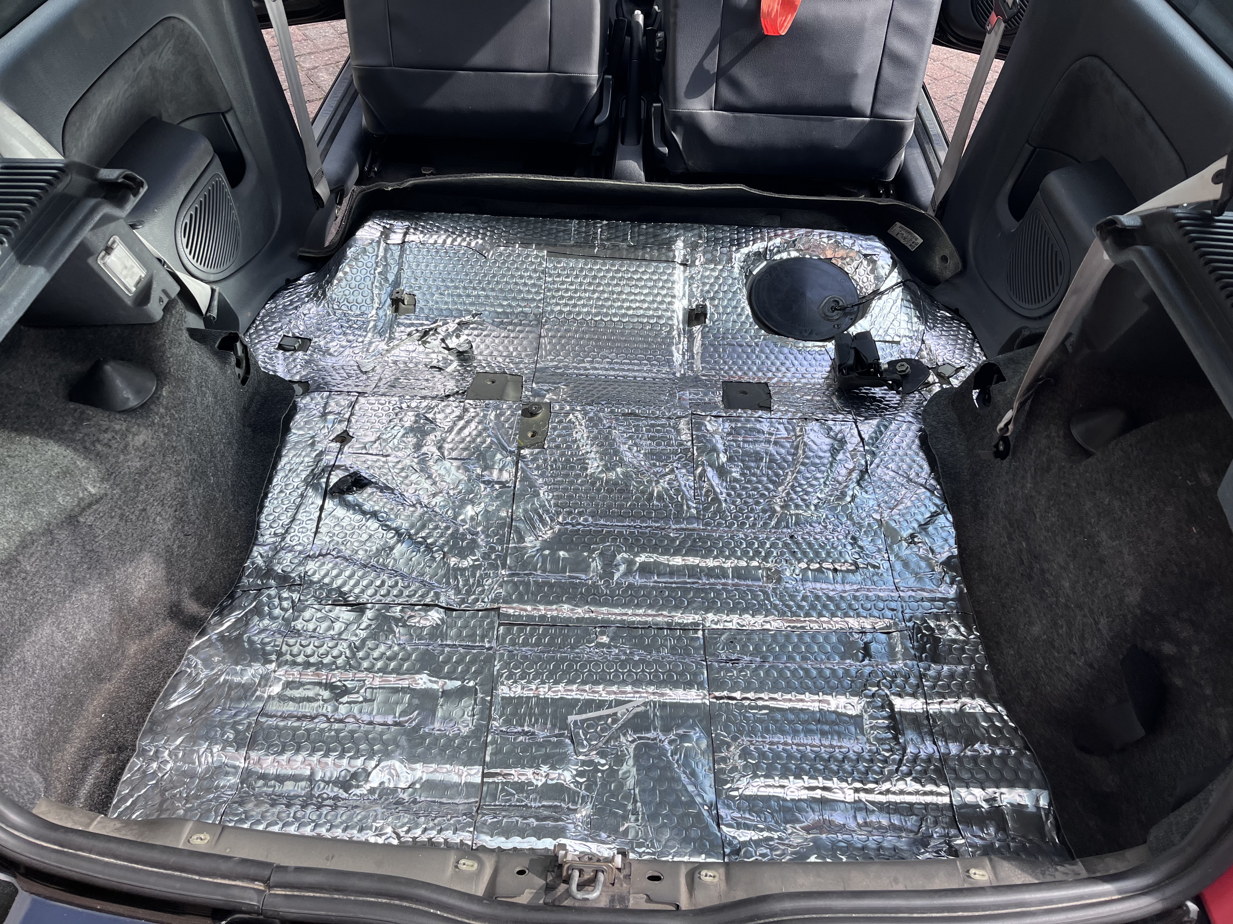

also did the rear end sound deadening in part, basically the floor.
The top layer isn’t stuck in yet but it’s noticeably quieter at cruising seeds. So once the rest of the cabins done it should be a nice place to be!

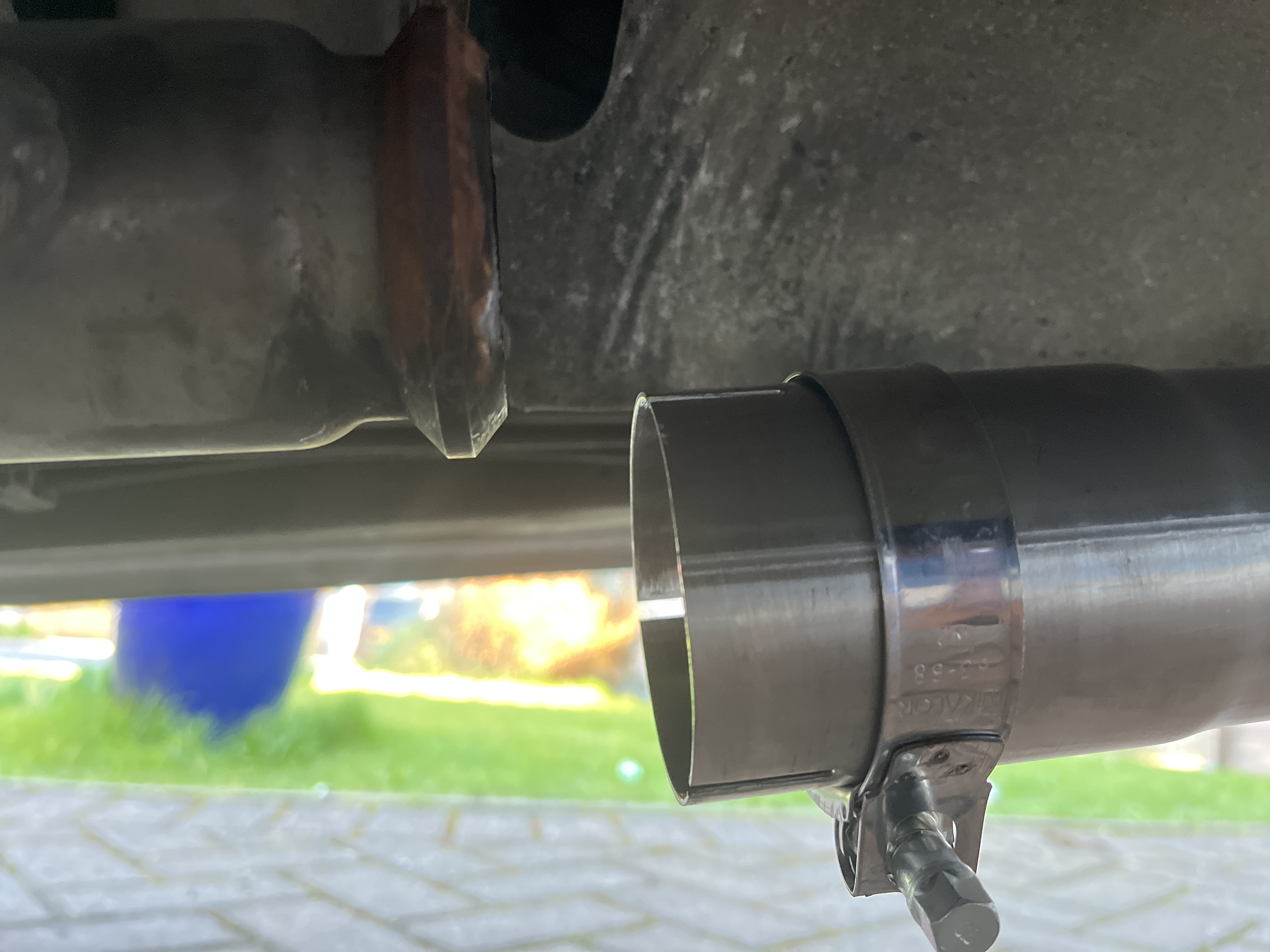

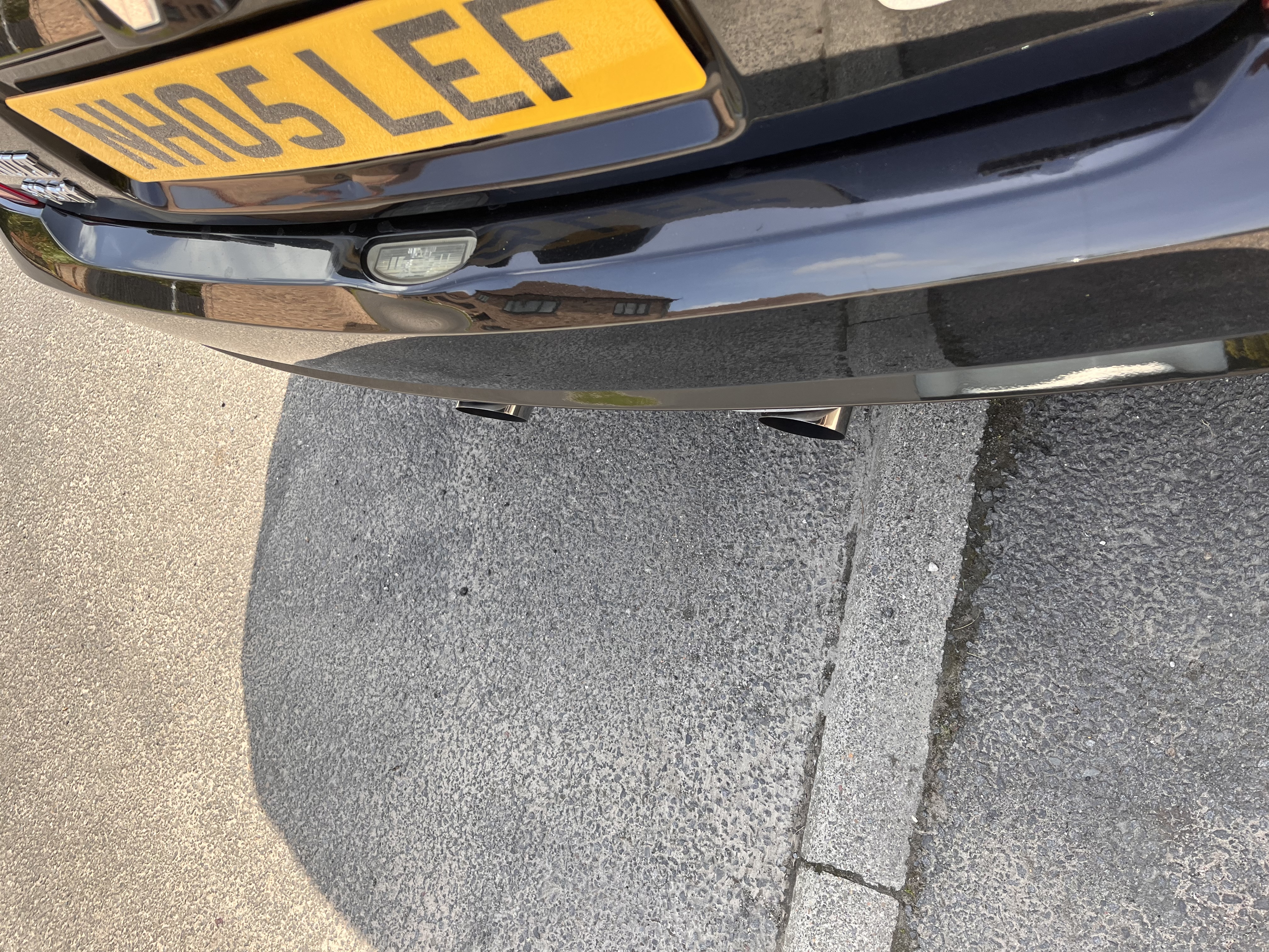

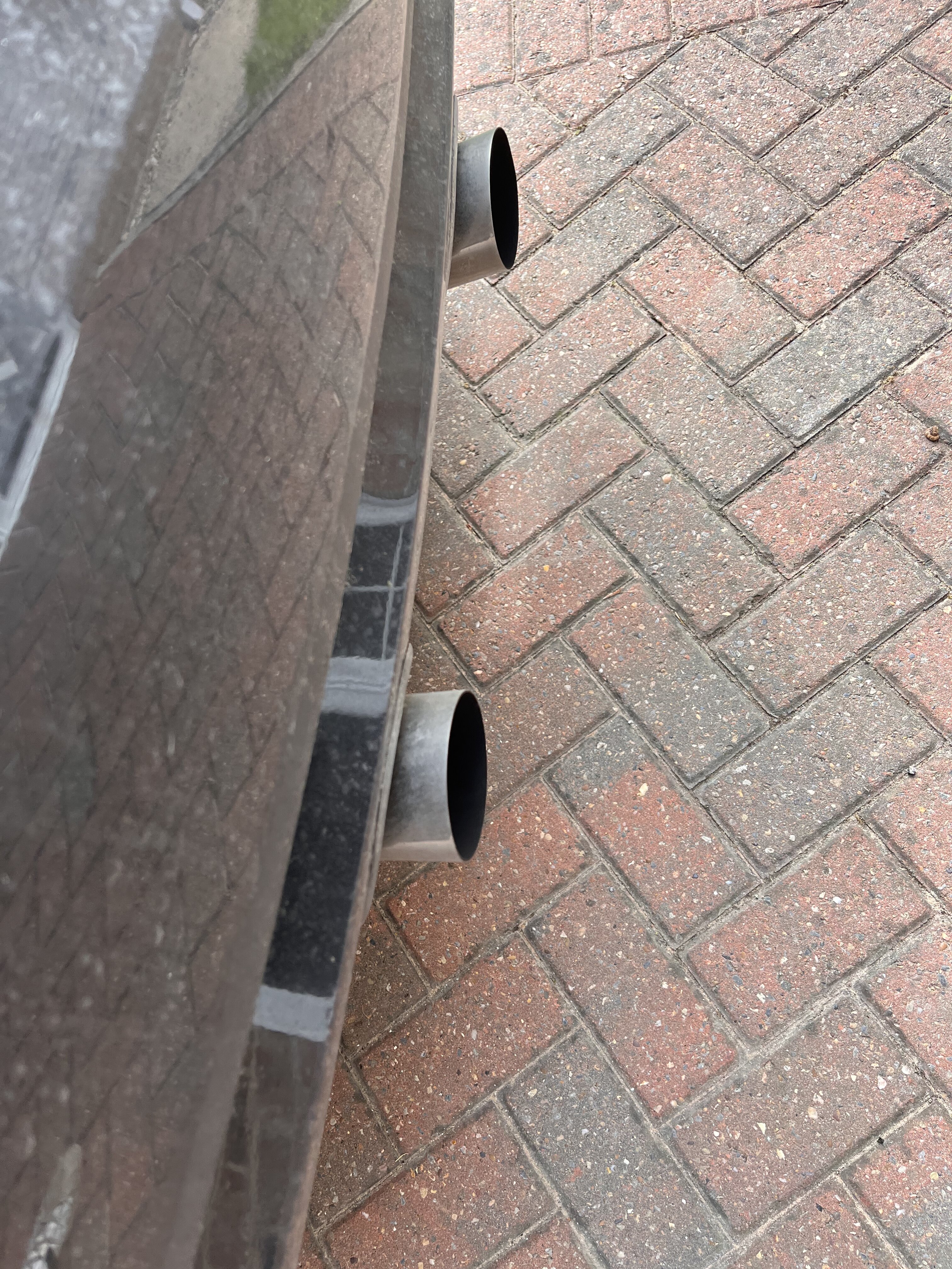

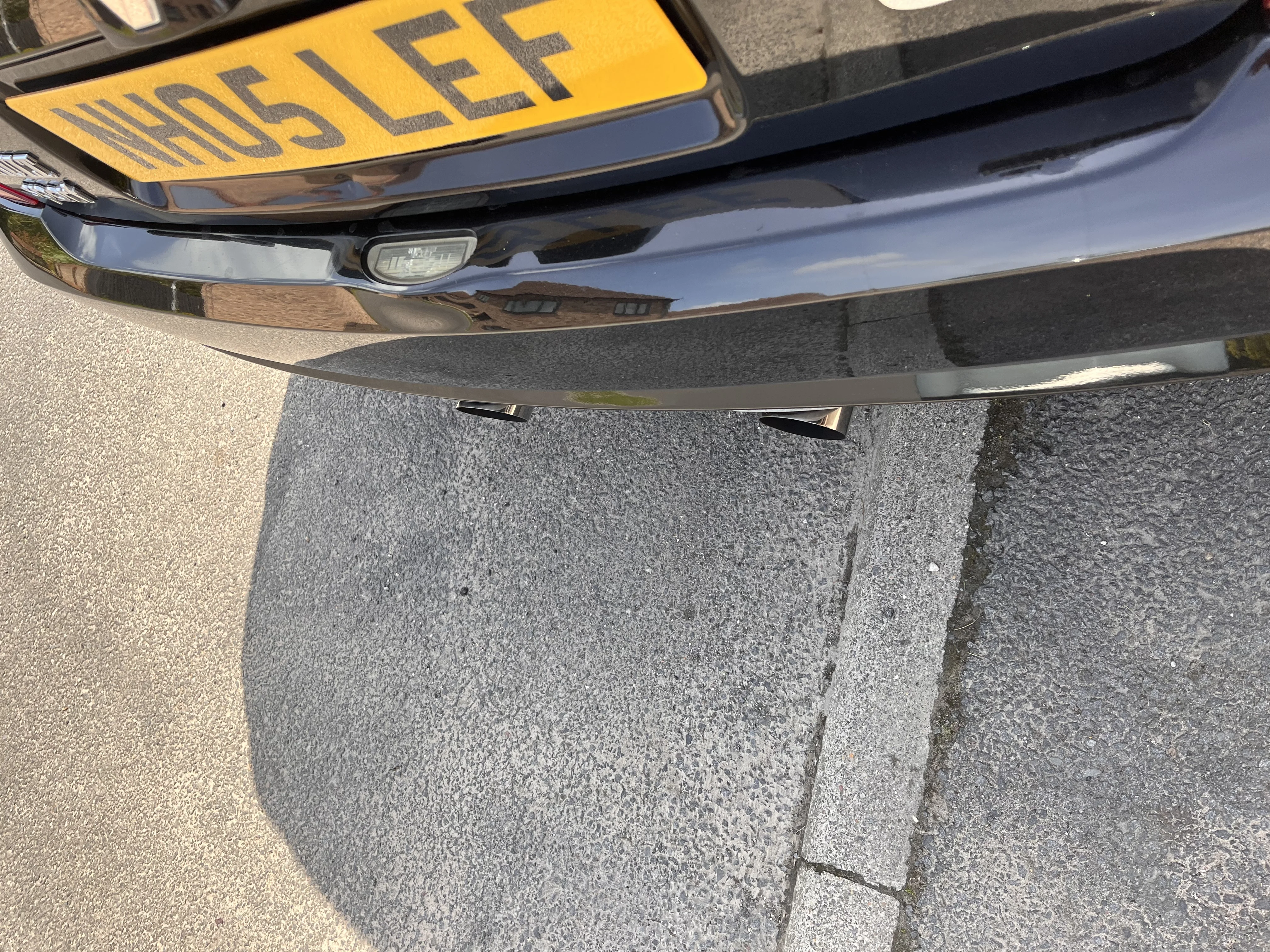

Never been entirely happy with the exhaust tip position on the Ktec this is due to decat and link pipes pushing the system back, it was also not that tight on the clamps so moved back and forward and sounded pretty farty. So I bought the Ktec decat and fitted it, allowed me to get the tips much more where I want them and the sound is much better.
Before
After
I’ll get a quick video of the sound as well, does sound good.

going to fit a sports cat for the MOT and I’ll probably just leave it on.
Few minor tweaks.
I knew my headlights were a bit yellow but i didn’t think they were that bad… I was wrong…
Looking much better now, also added some wrap to the cool air intake, purely for looks as I’d chipped the paint quite badly when I dropped a spanner on it ffs.
Then gave to old girl a clean.
