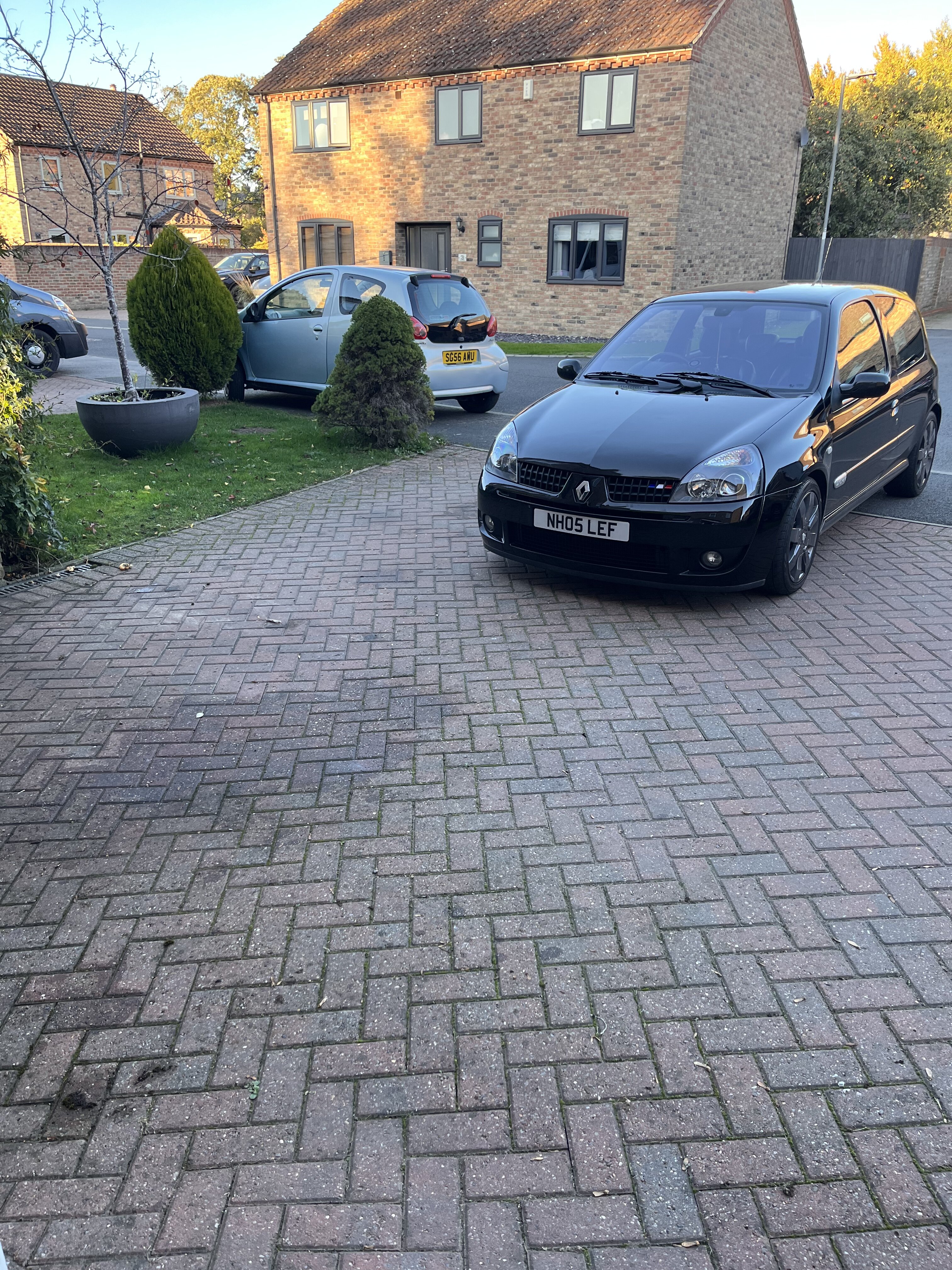

“Charlotte” The 182 FF
At last some pics and the start of my (probably slow) project thread.

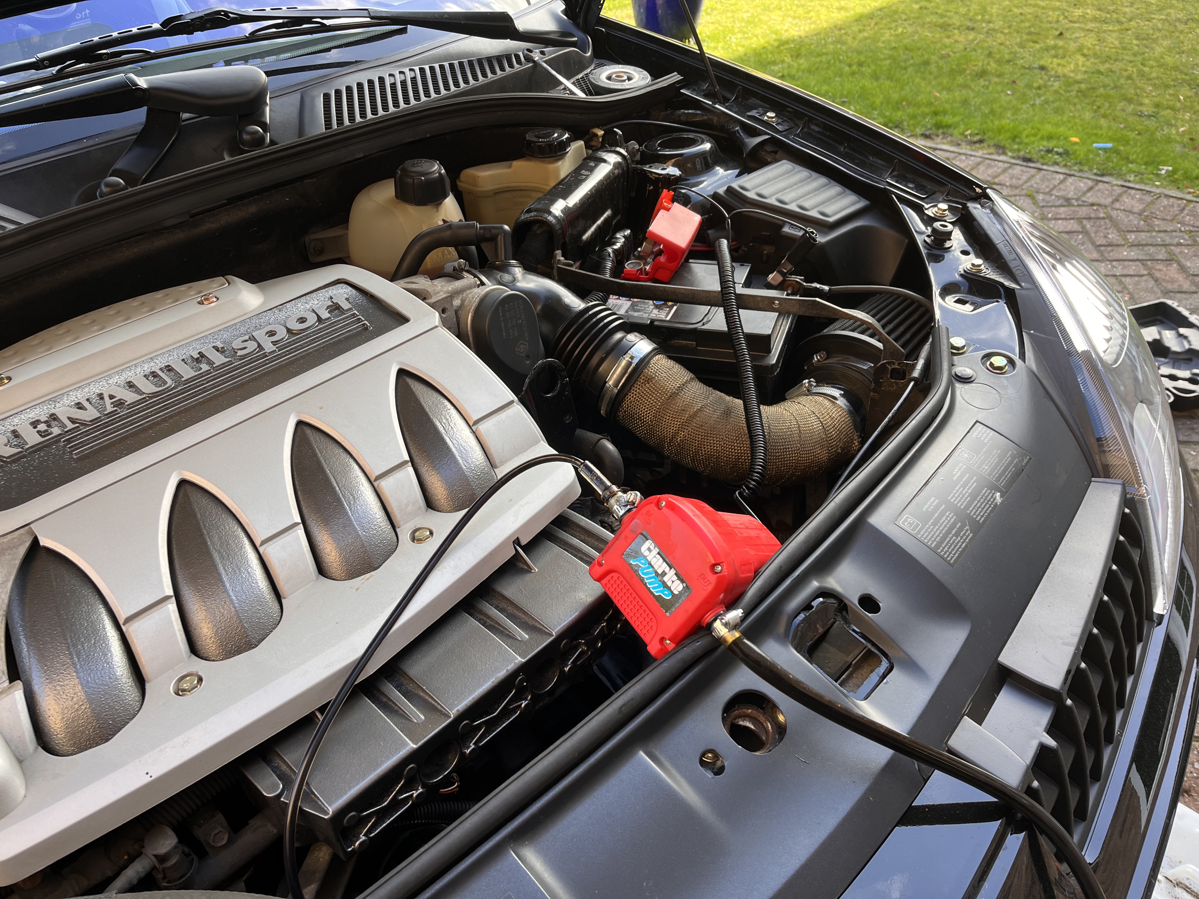

Picked up with limited history but from a friend who’s spent £1400 on lots of new bits like brakes, calipers, clutch, exhaust etc etc only to get a mk3 and sell this one.
I got it at a fair price but it needs some love as you’ll see. My intention is to not modify it but maintain it as stock as possible with some minor mods that I think really benefit the overall car.
I’ve done this before and termed it Stock+.
To first part will be to get and fit the missing bits, like the 182 steering wheel and gear knob, then sort out some odds and sods that are broken as well and deep clean it, as it’s pretty grubby.
Having been over it with my paint depth gauge it’s all original it would seems which is good, there’s some age related marks on the Bodywork that I’ll fix and the interior is, in places disgusting, but more on that to follow.

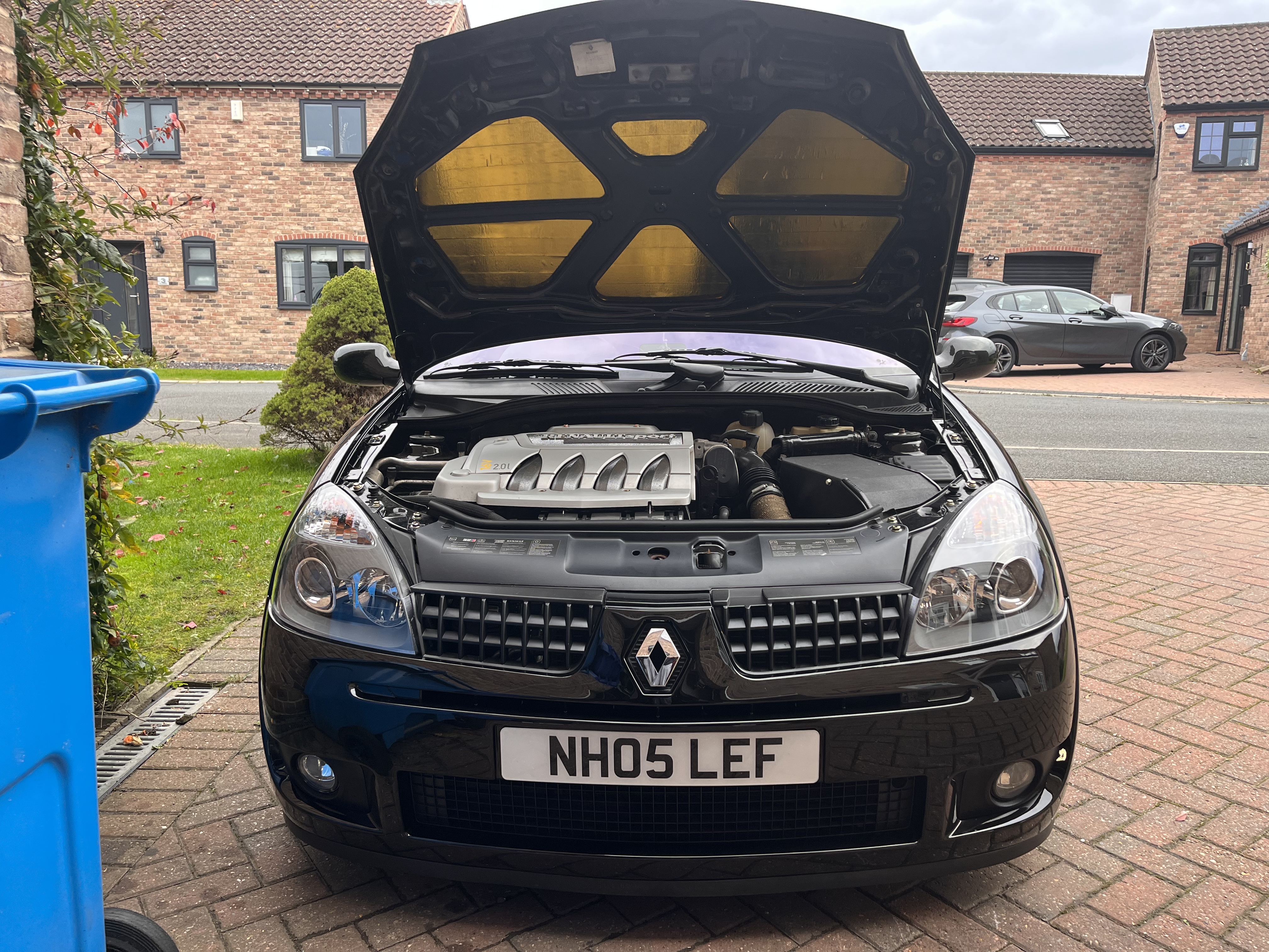

Here’s some pics to start with,

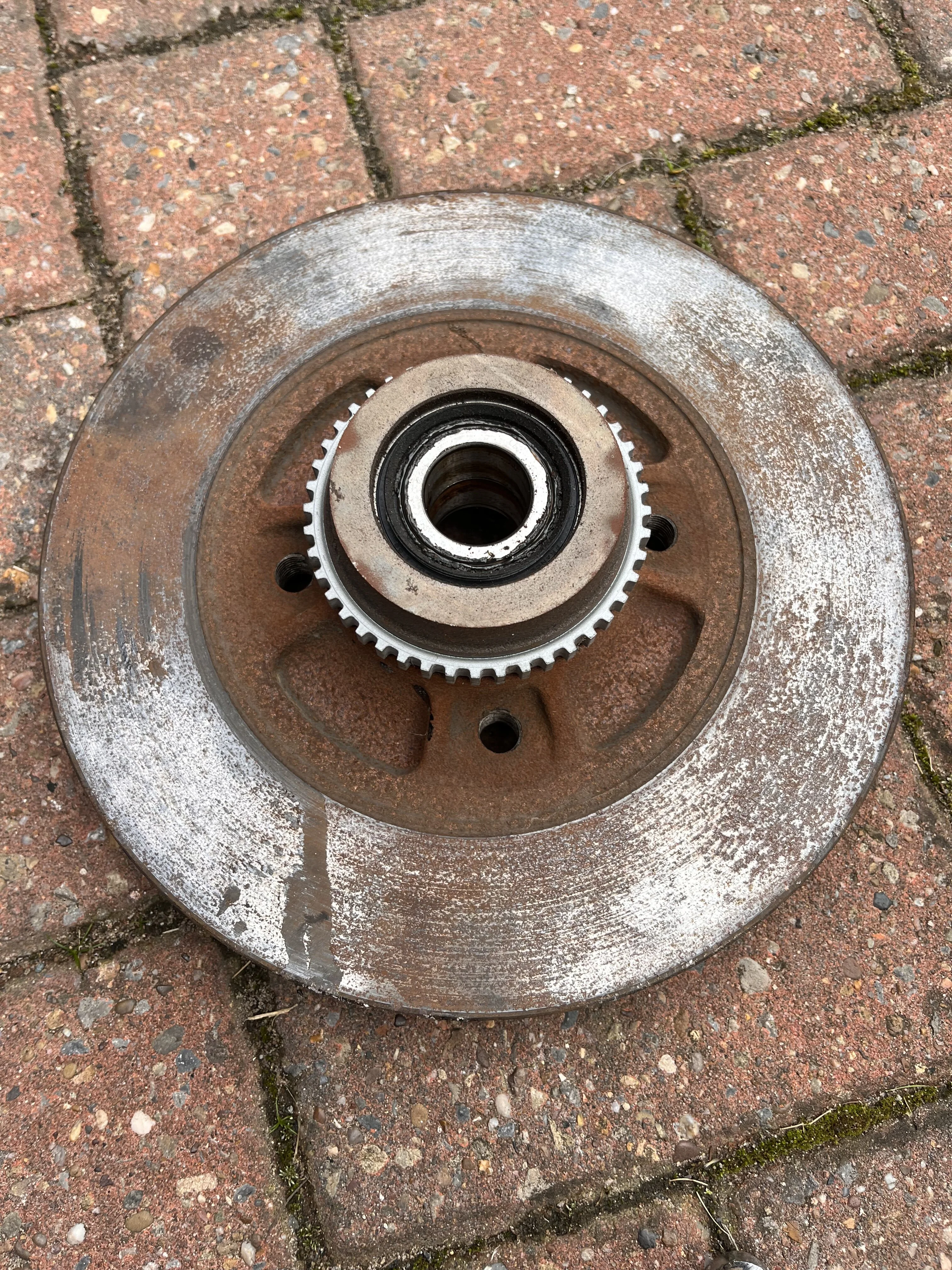

Oddly though I was expecting some spacers on the rear bearings but there was none present? Are they there on all cars?

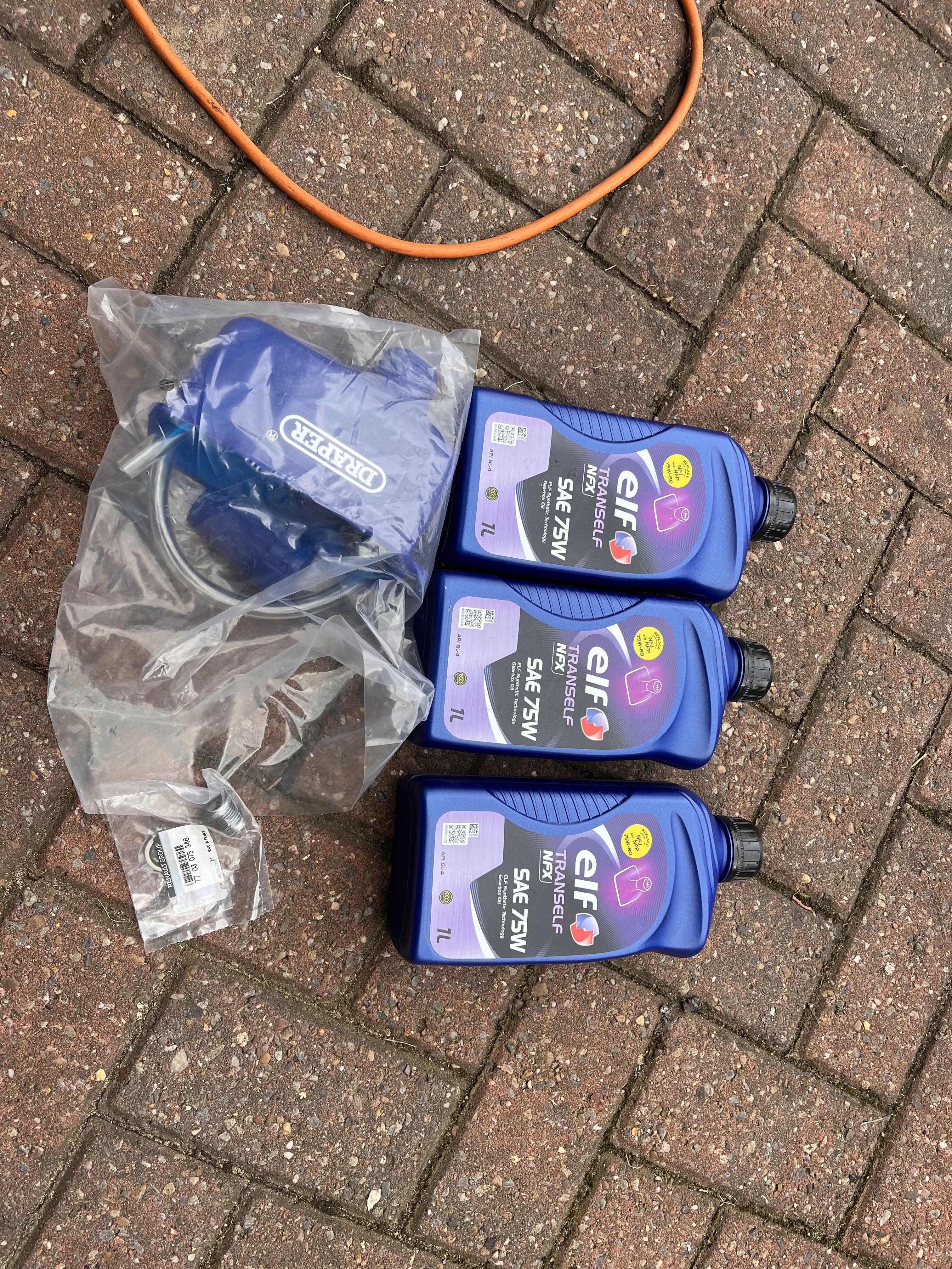

Then I’ve done the gearbox oil, didn’t look terrible to be fair but worthwhile doing to know it’s been done.

Yes, all cars need/have spacers.
Sometimes they stick to the back of the disc when it's removed, so it's all too common/easy to accidentally throw them out with the old discs.
You can buy reproduction spacers from KAM Racing, for example.
Thanks, I thought that would be the case, as it happens I have a set of spacers but couldn’t see them on the back of the disc or the hub hence the question.
looks like it’s time to take the rear apart again. 🤣
Don't drive it far without those rear disc spacers, becomes a real pain to get the discs off if they've not been fitted. Ask me how I know.

I’ve heard a lot about the bearings breaking quickly and almost welding themselves to the axle without the spacer so I do feel I’ve got lucky. The more I look the more I find. Shouldn’t pull on the loose threads….
Quickly whipped the rear discs off again tis morning to double check the bearing spacer situation and confirm they were not there, they were not. As it happened I had a set from the rear axle I bought do cleaned them up and put them on, being careful to get them the right way around and then put it all back together.
I can see how easy it is to throw them out, I took on of the discs off again to wind the calliper back and it was on the back of the wheel bearing. One ot remember when I come to changing them in the future.

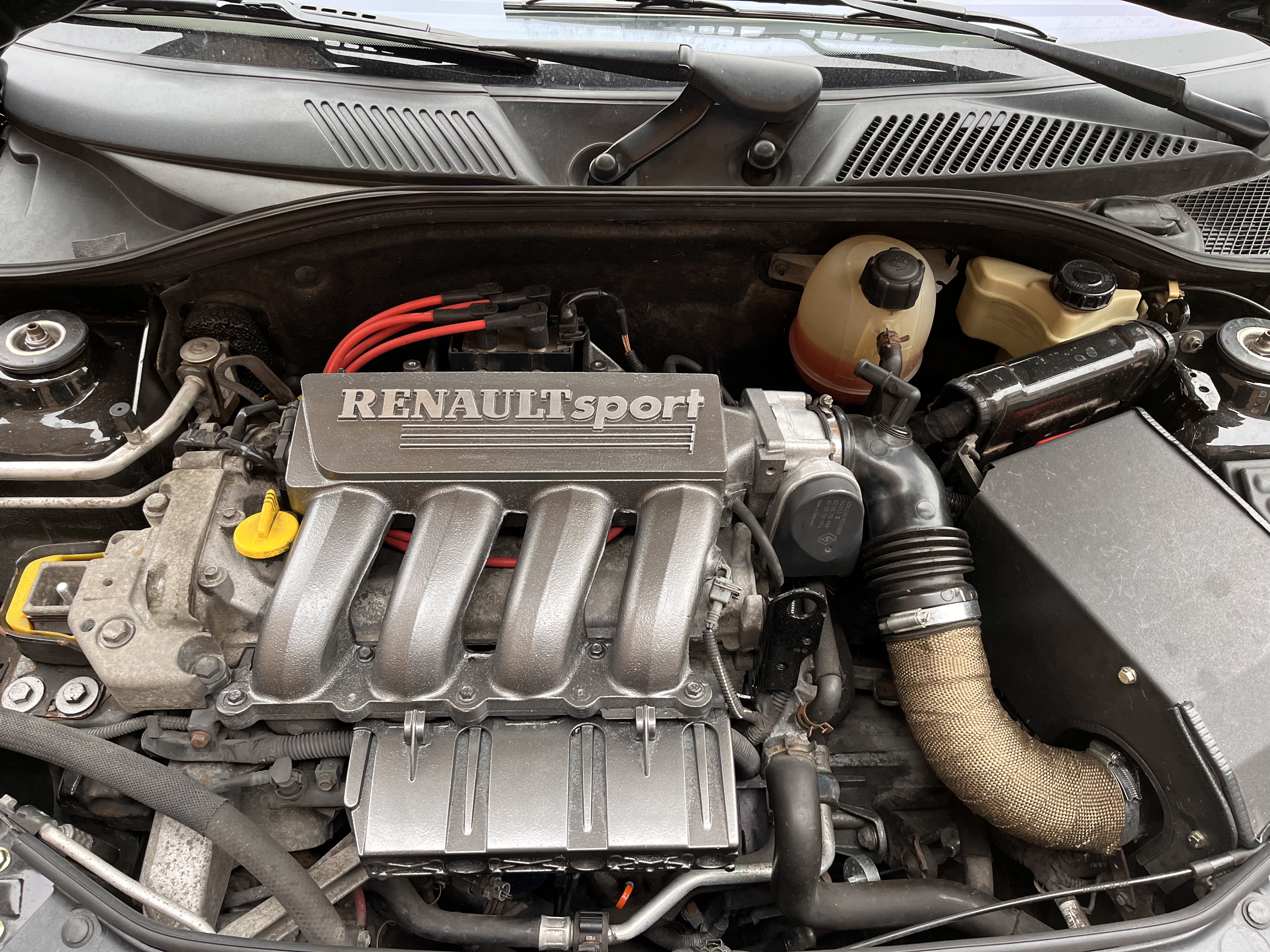

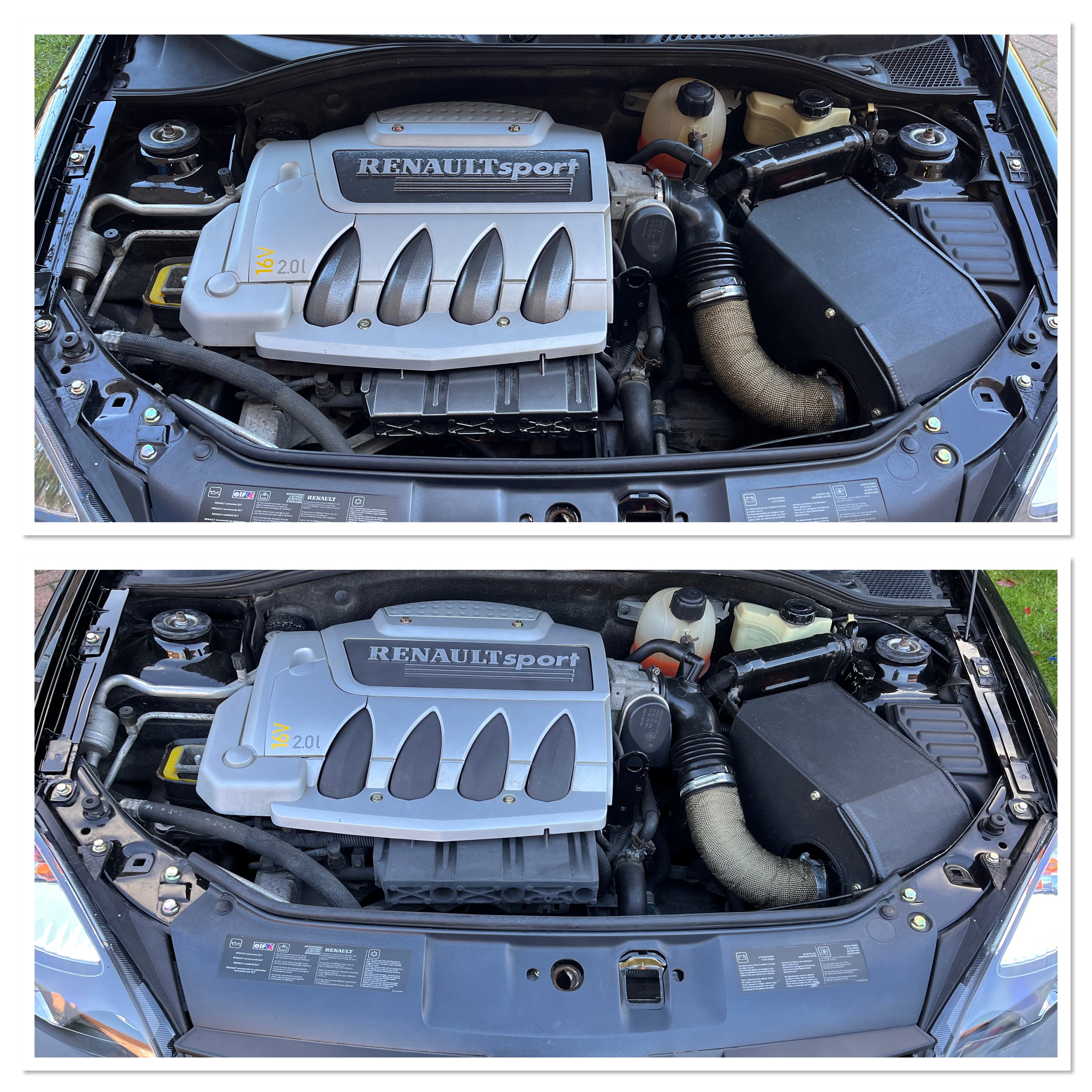

Quickly repainted the inlet and injector cover. Looks better but ideally want to ditch the engine over in time but not happy with how it looks at the moment with it off.

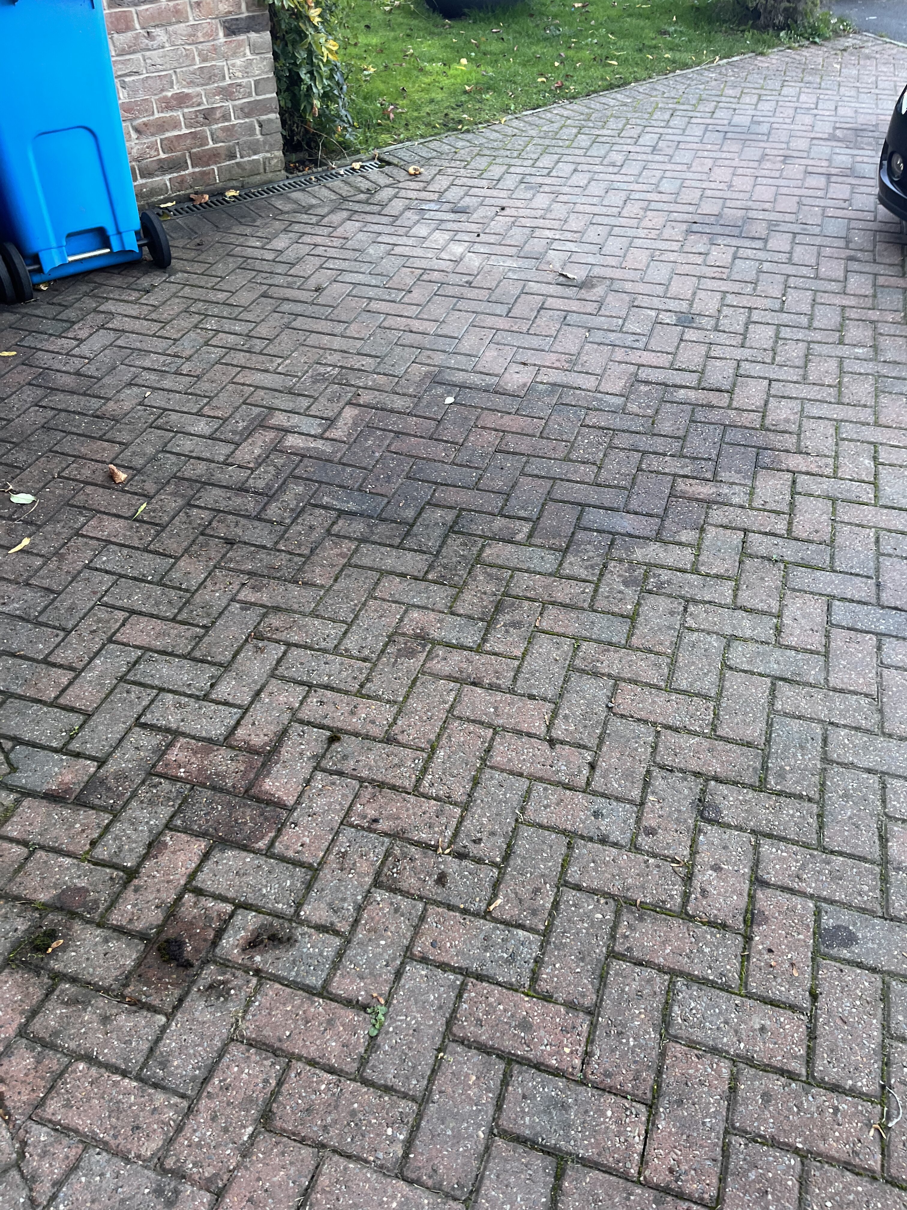

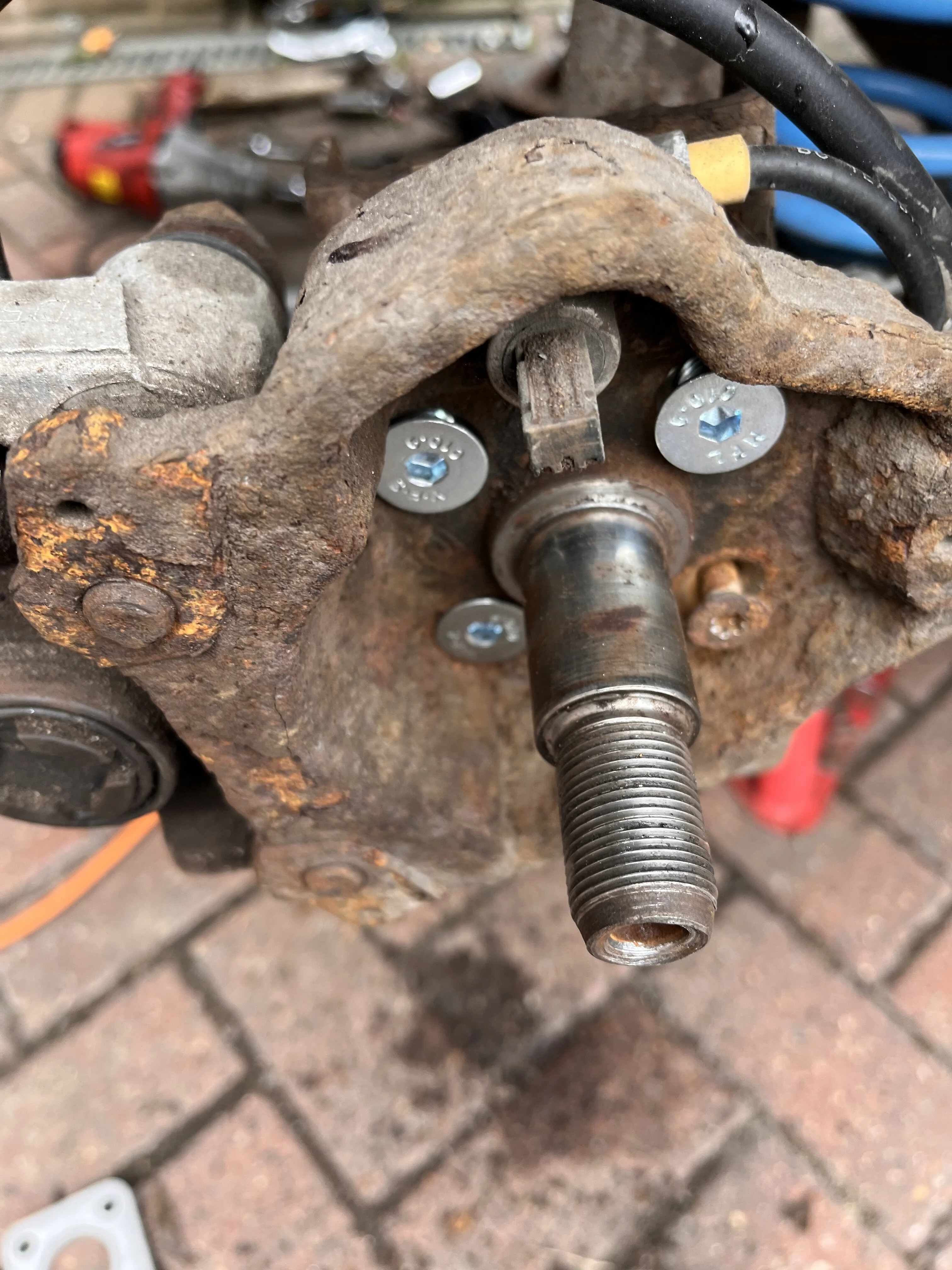

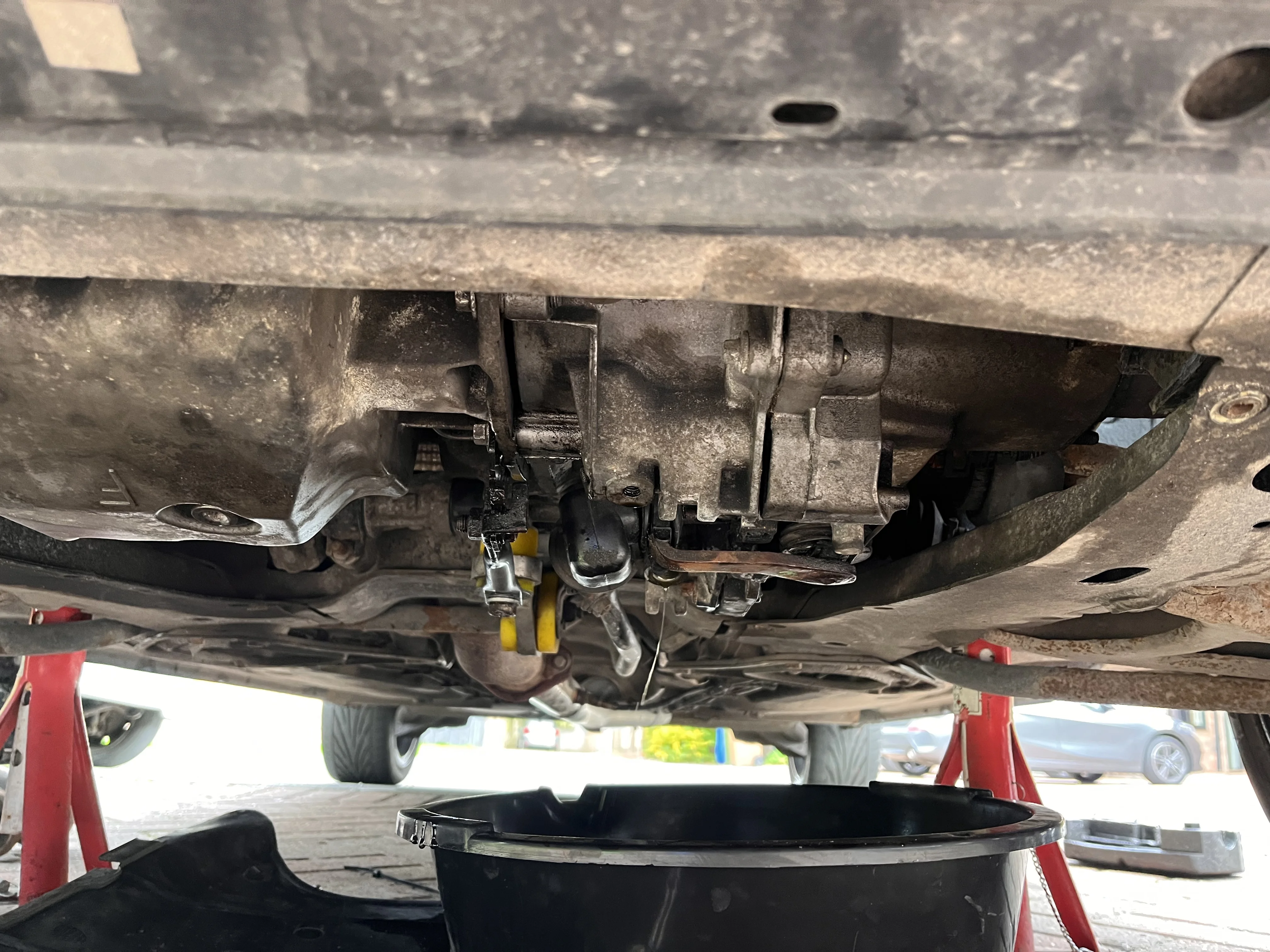

so… on the MOT the mechanic said the near side spring was dragging in the carrier so I thought I’d just whip the strut off and check it out, easy peasy… turns out the top mount wasn’t mounted correctly (doh) so I fixed that and was putting it back on when the front hub got a bit wild and pulled the drive shaft which pulled the seal clean off the mounting… which I’m turn allowed all the (brand new) gear box oil out and all over my drive… gah.
so a run over to drakes and £71 in new gearbox oil and a jubilee clip later and I’m not really hoping that it doesn’t just come off as I drive lol. Paranoia for a few miles now.

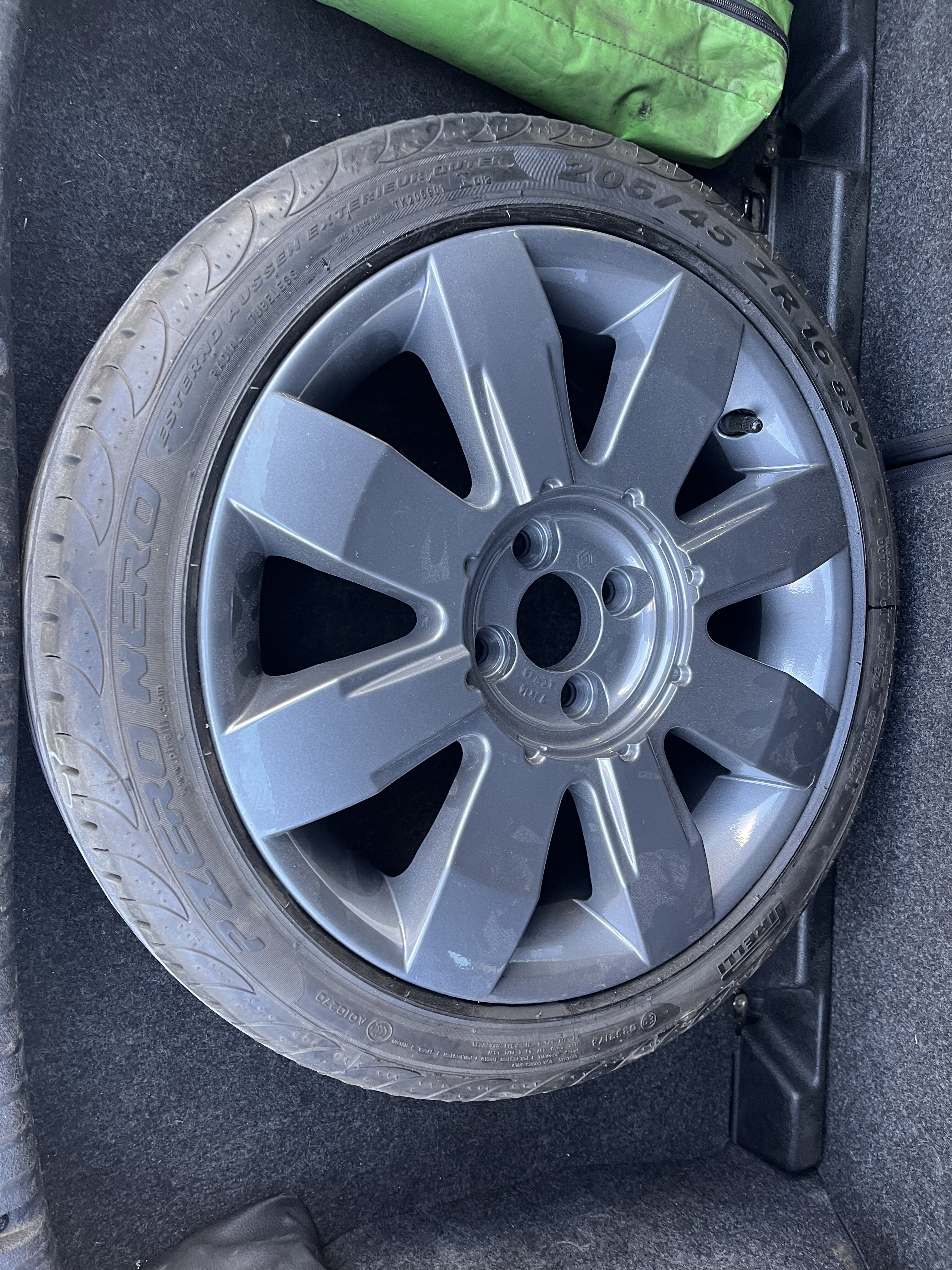

also got the spare wheel back from being refurbed, so all my wheels are now nice and new looking.
also totally forgot that you need spark plugs for a petrol car service so ordered some of them and a inlet gasket just in case, so a job for the weekend.

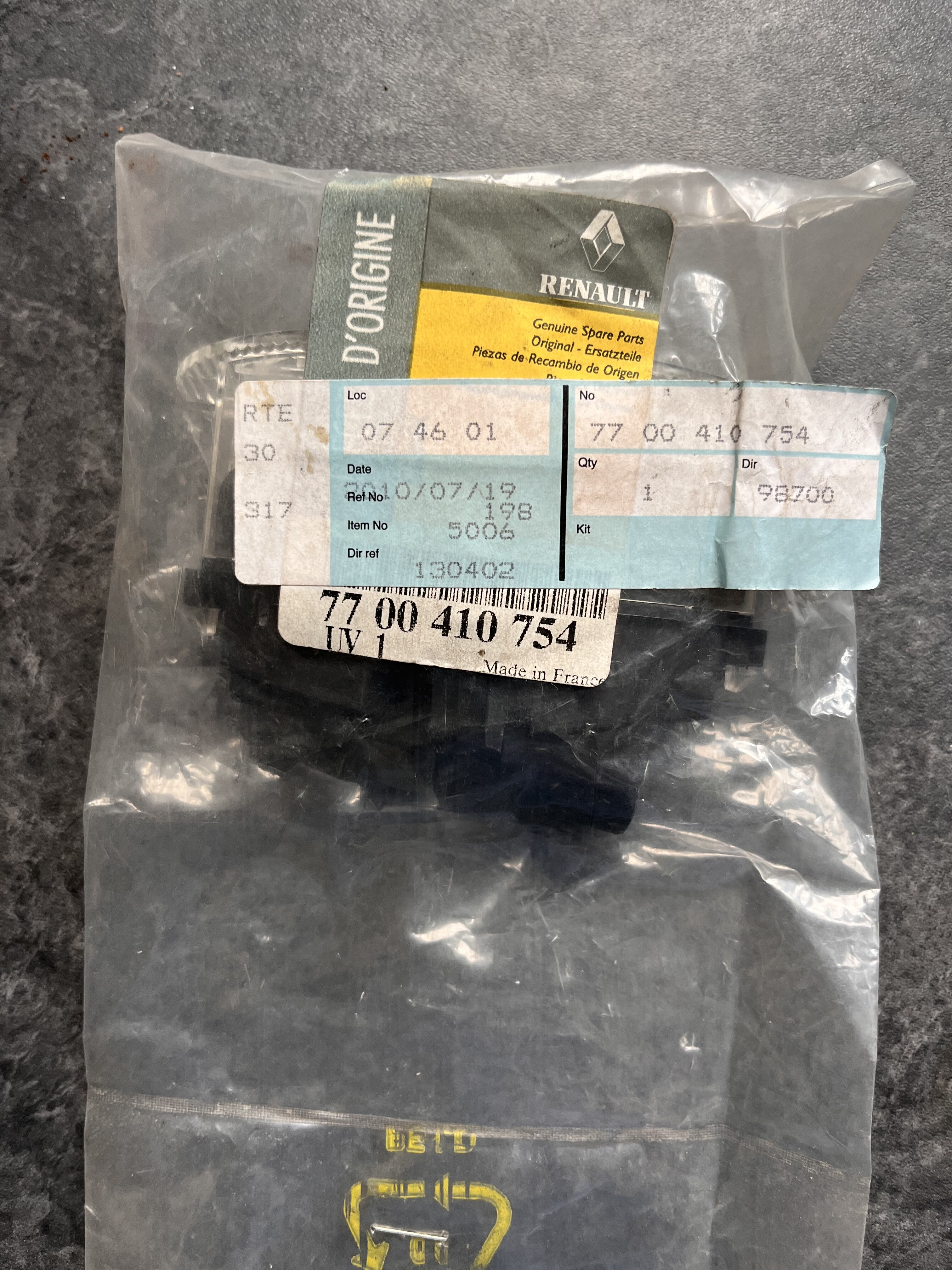

In other news the spare wheel is now permanently secured in the boot as it won’t unlock. Reading, it seems that it’s common for the mechanism to break so I’ll be looking into that.
French car doing French car things.
I've been through that pain so many times I buy them in pairs now😂. Enjoy crawling in the boot through the back seat to release it.
Literally just ordered one of those. Was tempted to get two, but might get a spare next month to add to the warehouse of spares I’m accumulating.
ive put a screwdriver in my car so that I can access the boot as i can almost certainly guarantee to get a puncture now.

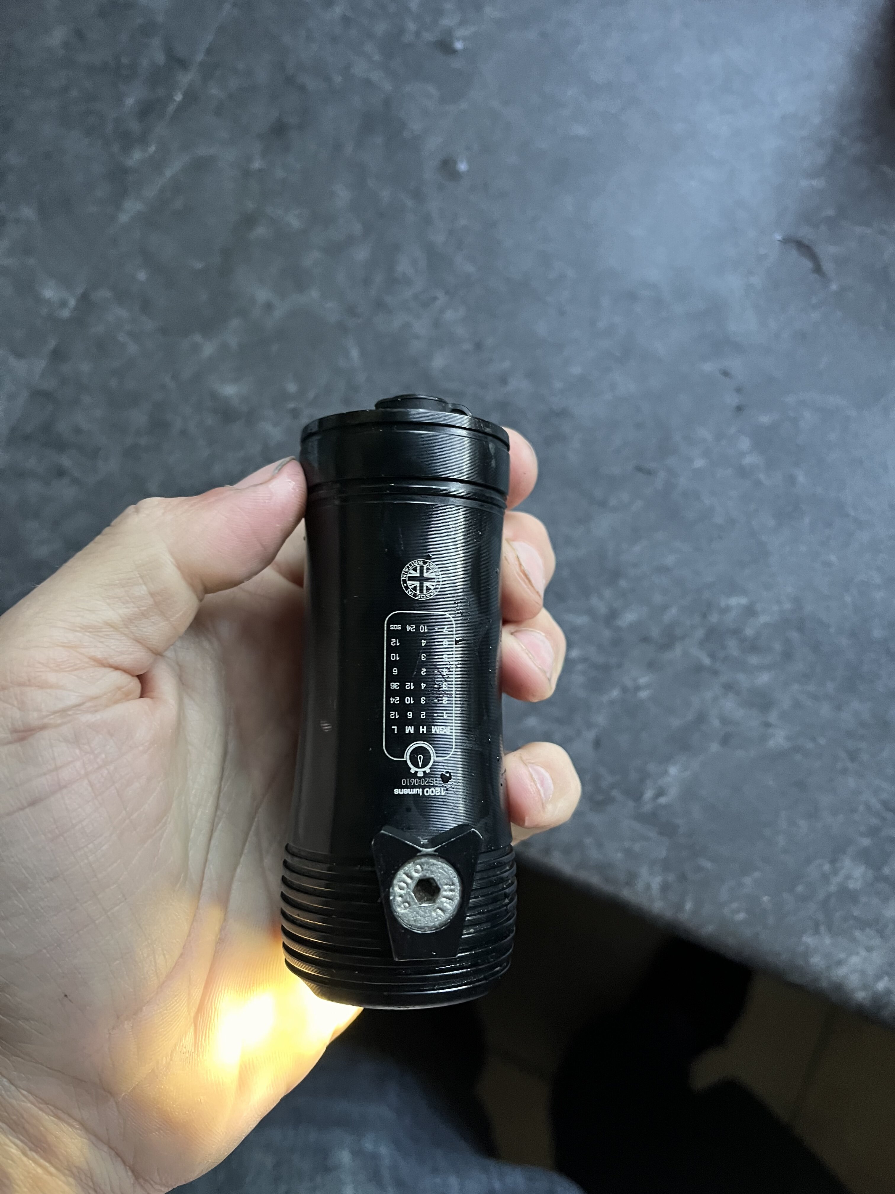

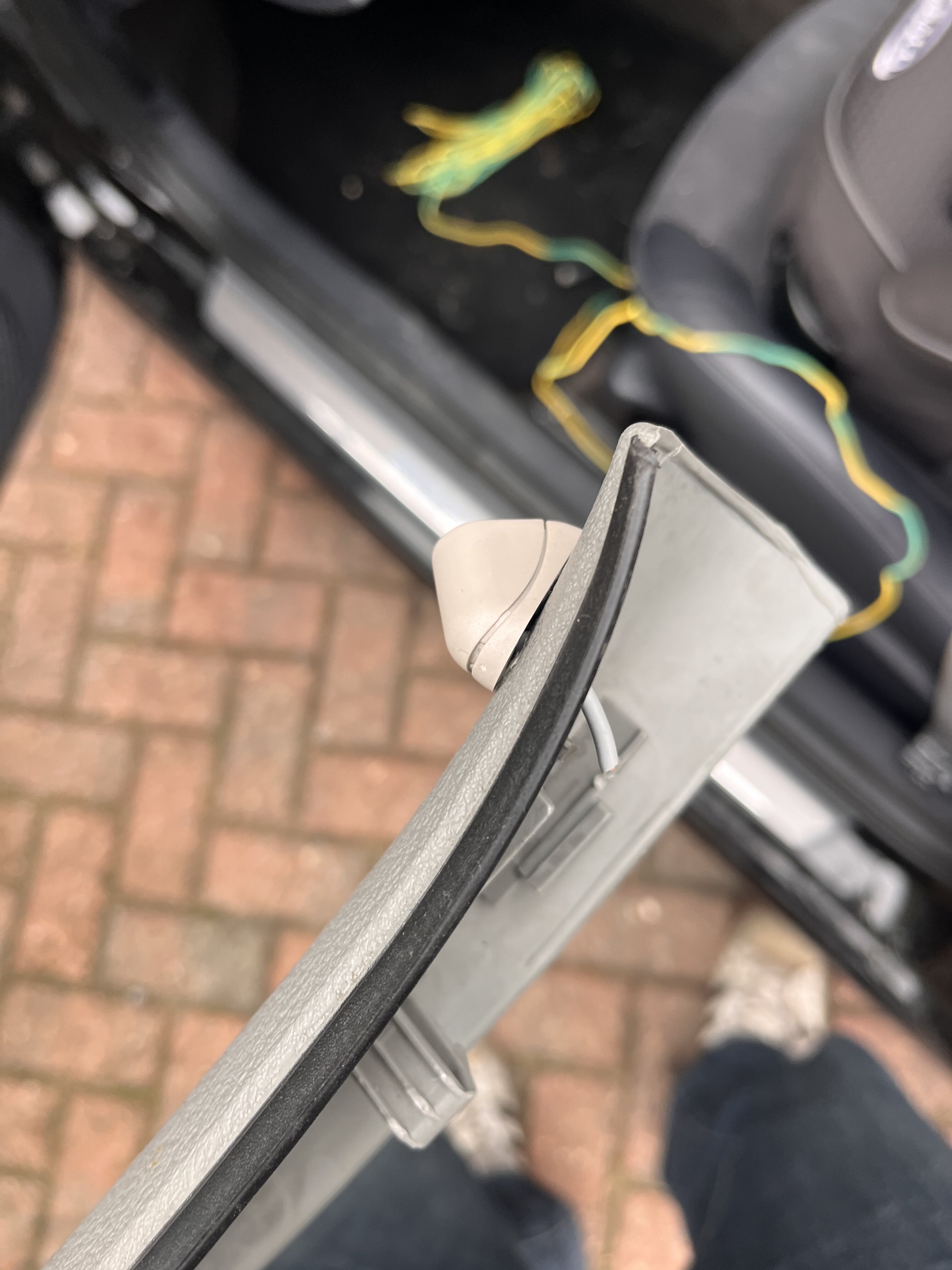

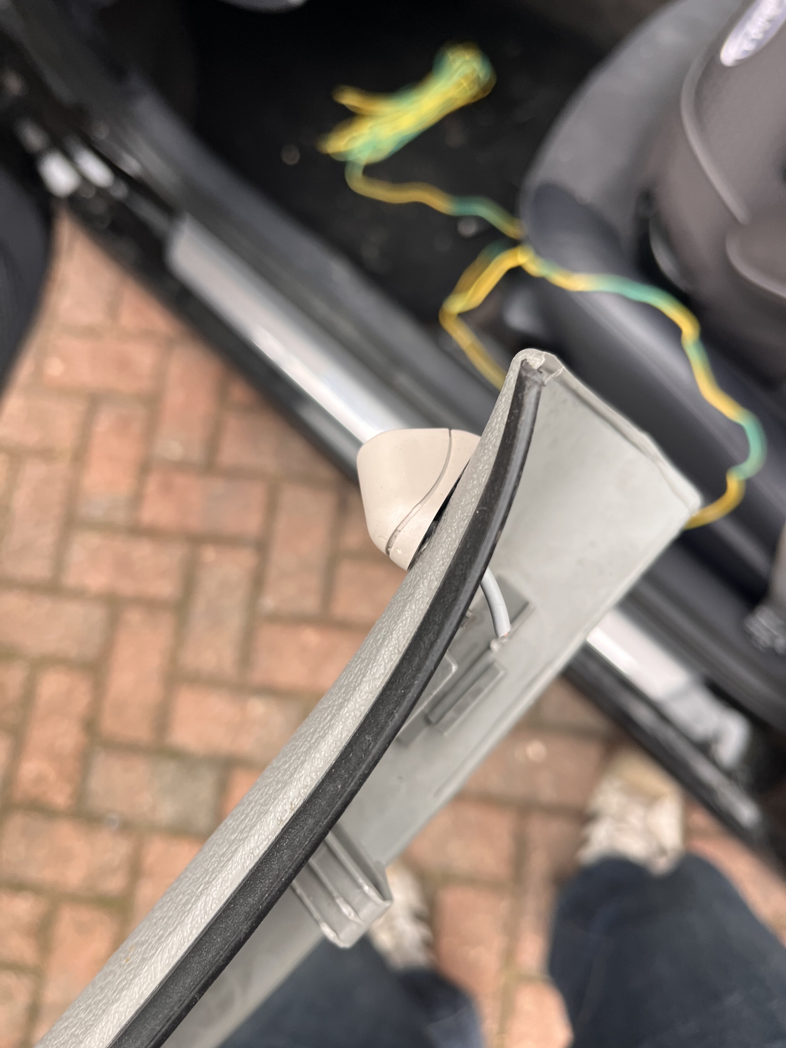

Something I chuckled at was how my internal alam sensors are doing a great job…
anyone else seen this? Basically the arbor is visible at the top on the pic and the wire has just been cut off.
So the Motor is actually working fine, it seems to be going into some sort of fail safe as its locking the boot but its like it bounces off the "lock" position and then stops part way between, if I wiggle the wires it them works fine again, Im thinking its just a connection issue. So I will need to do some more digging unless anyone has come across this before.

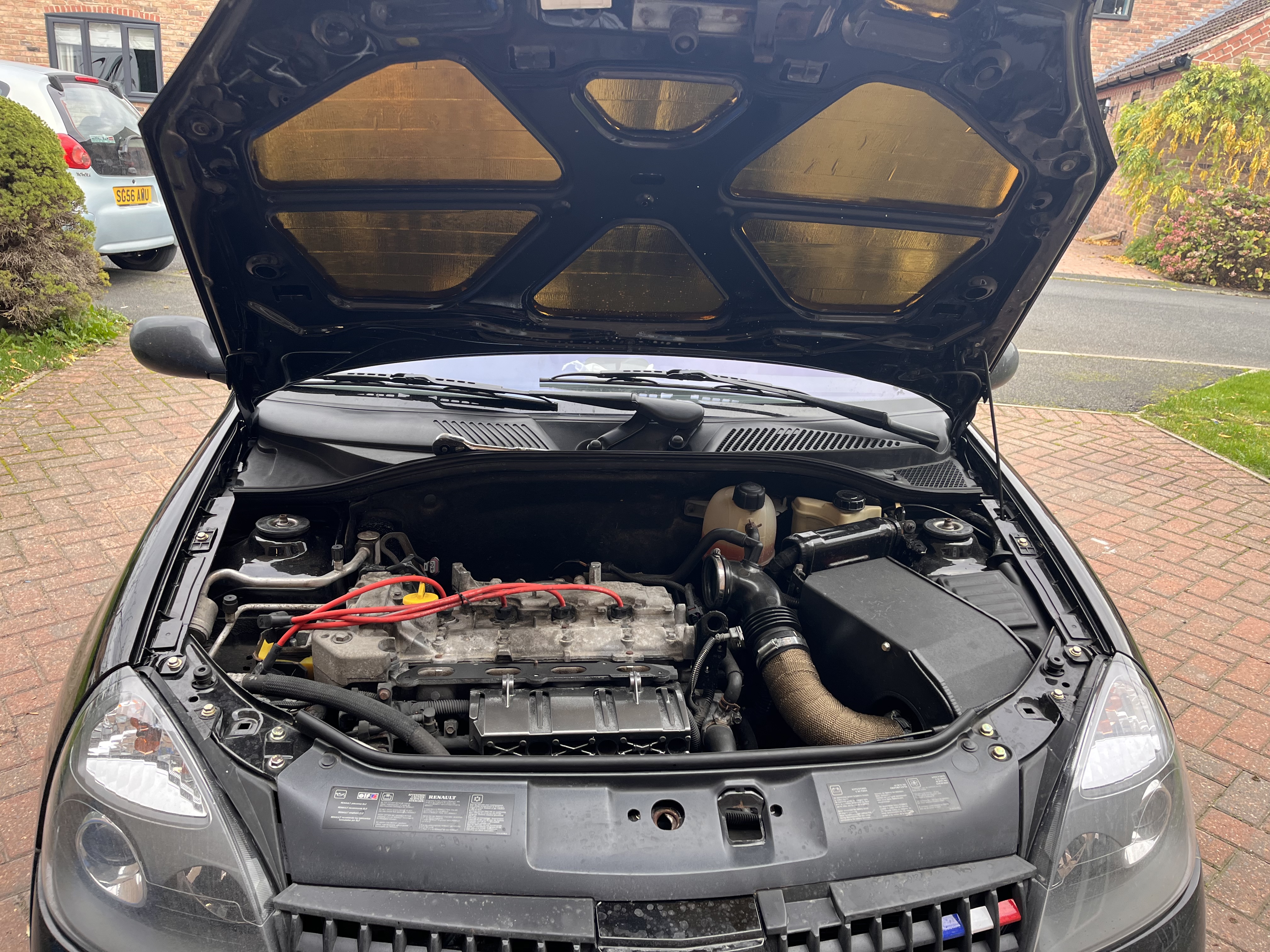

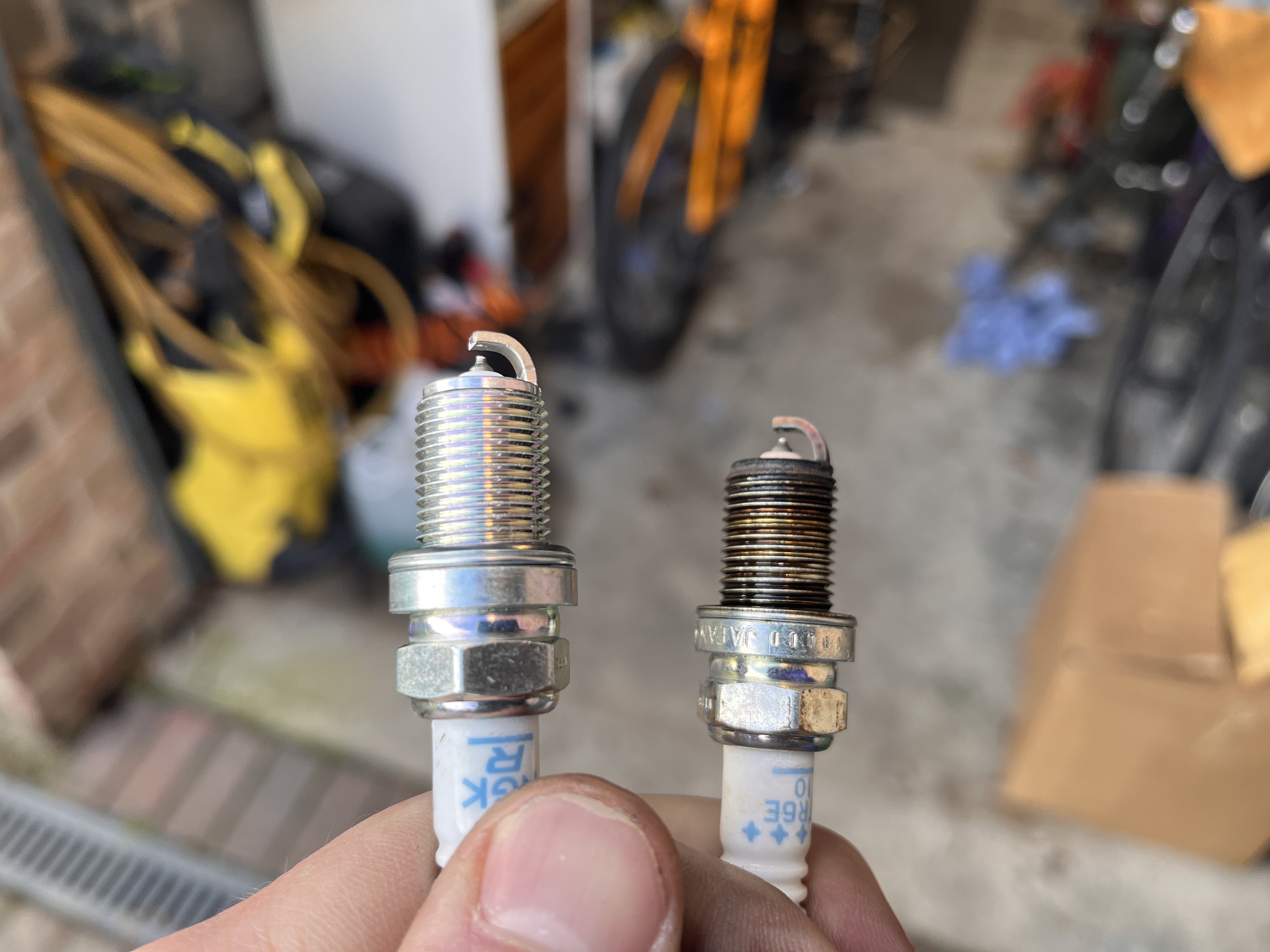

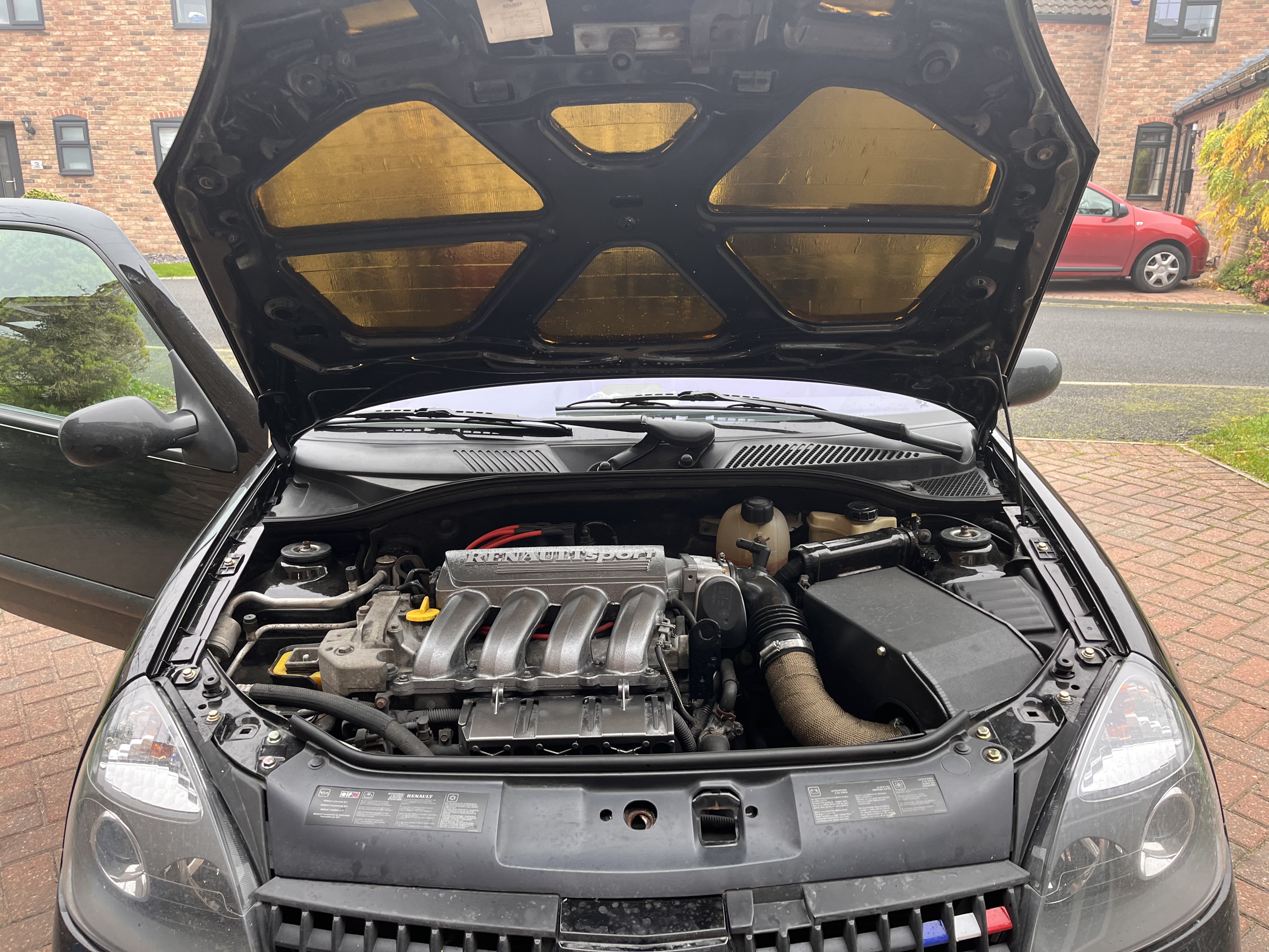

Spark plugs changed.
dont think the old ones look too bad but they were not torqued to spec so worthwhile changing them anyway.
also took the opportunity to paint the inlet properly and throttle body.
it’s starting to look much closer to how I want it under the bonnet. Few more things to tidy up but happy to keep plugging away.
