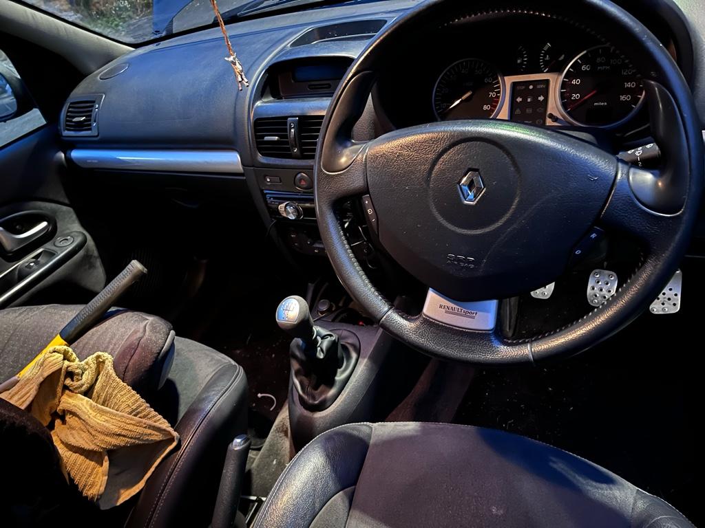

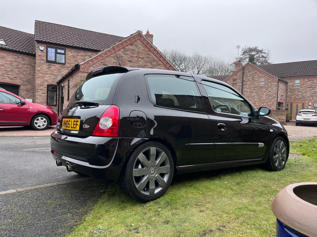

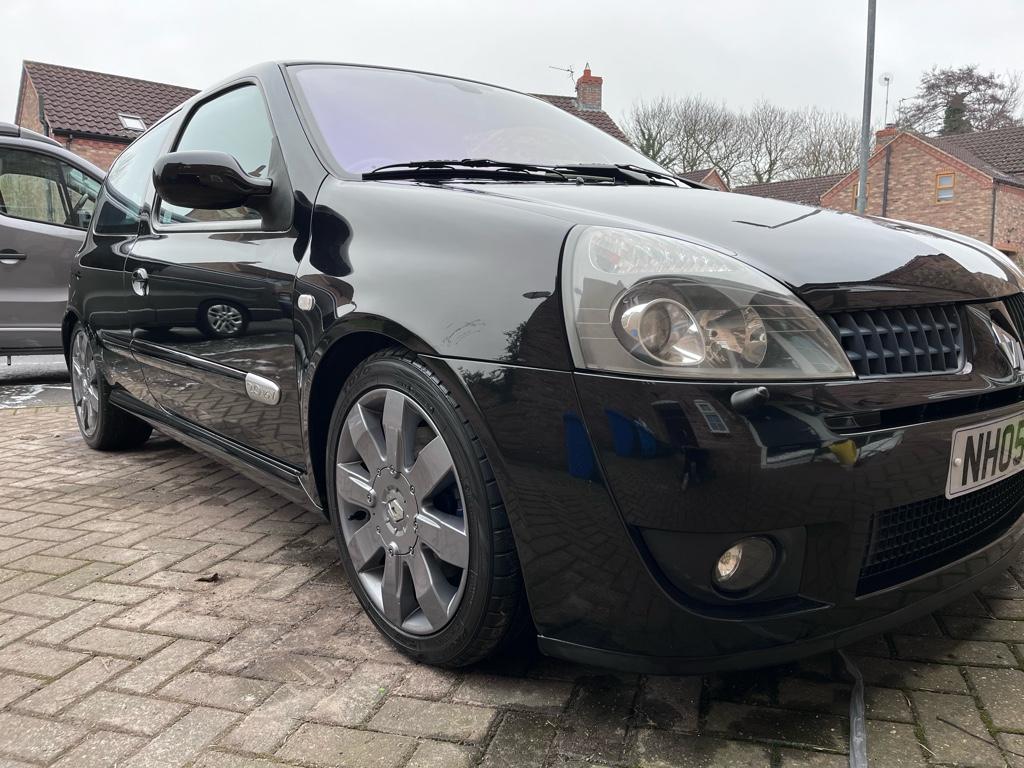

“Charlotte” The 182 FF
At last some pics and the start of my (probably slow) project thread.
Picked up with limited history but from a friend who’s spent £1400 on lots of new bits like brakes, calipers, clutch, exhaust etc etc only to get a mk3 and sell this one.
I got it at a fair price but it needs some love as you’ll see. My intention is to not modify it but maintain it as stock as possible with some minor mods that I think really benefit the overall car.
I’ve done this before and termed it Stock+.
To first part will be to get and fit the missing bits, like the 182 steering wheel and gear knob, then sort out some odds and sods that are broken as well and deep clean it, as it’s pretty grubby.
Having been over it with my paint depth gauge it’s all original it would seems which is good, there’s some age related marks on the Bodywork that I’ll fix and the interior is, in places disgusting, but more on that to follow.
Here’s some pics to start with,

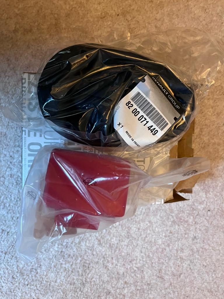

It’s definitely new and I have the receipts showing how much it cost, daft thing is a new stainless system wasn’t much more expensive.
Hmmm..that's really cool. I was going to buy a new genuine system for mine - around £800 at the time - but heard how rusty they get in such a short space of time. Plumbed for a PMS system instead.
Yeah, it’s not great. I think what I’ll do is replace this one with a stainless, clean this up and treat it, then wrap it up and shove it in my loft so I’ve got it if i ever sell the car.

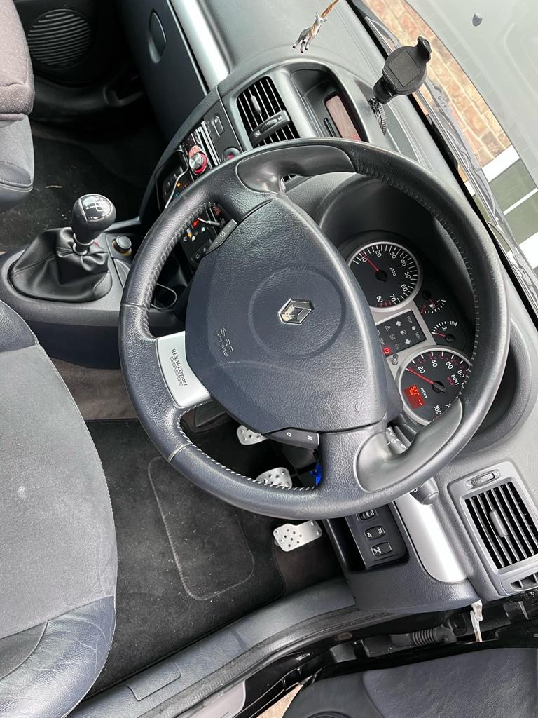

Not much to report although I really need to sort the rattles in the cabin, they are getting to be pretty irritating. I think Sound deadening may be the next thing I put money into, should also help with the general noise. That aside I've really been enjoying driving it about.

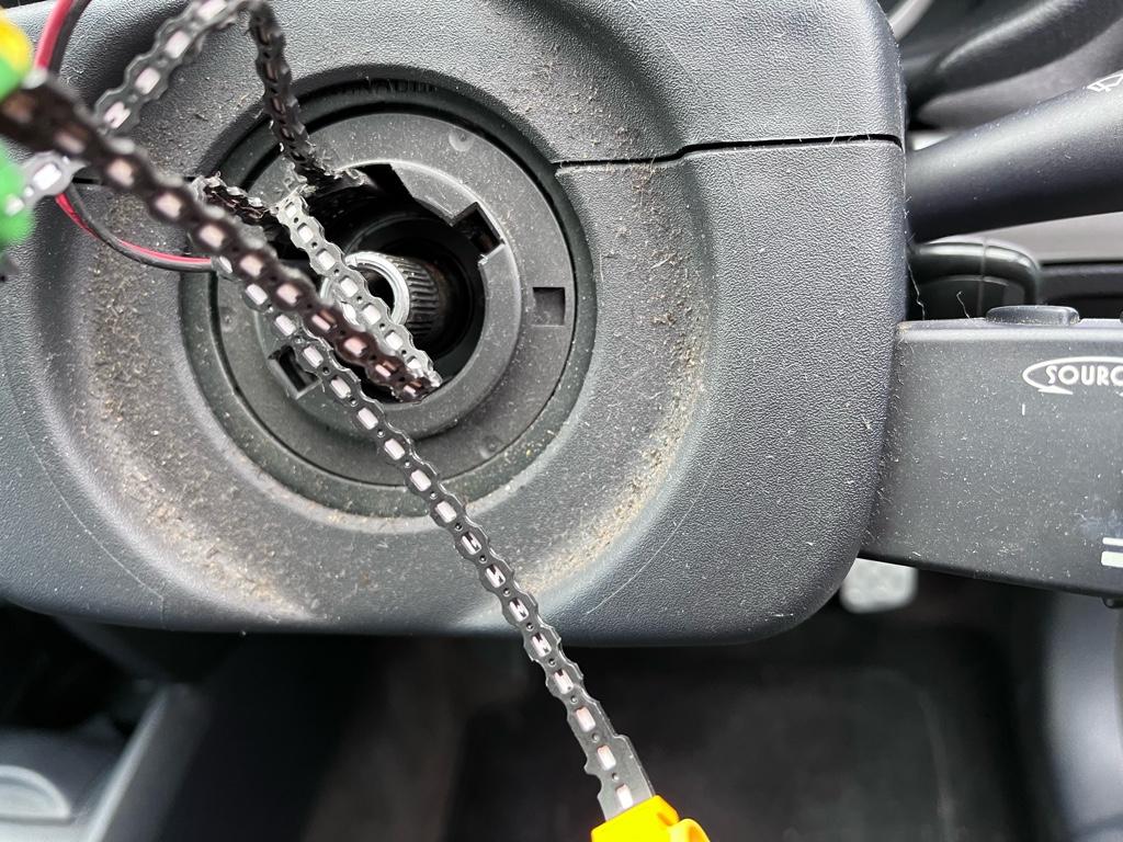

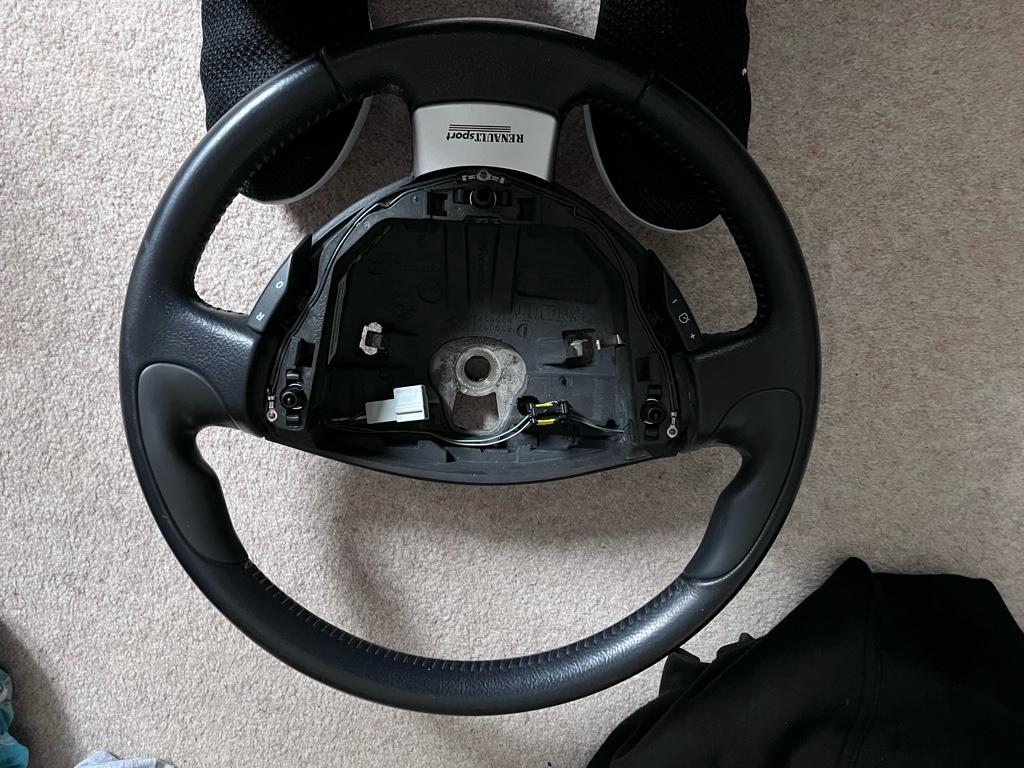

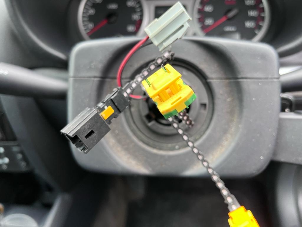

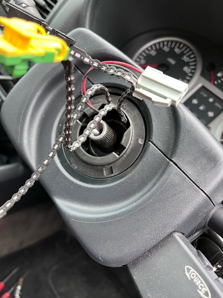

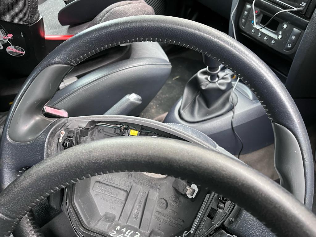

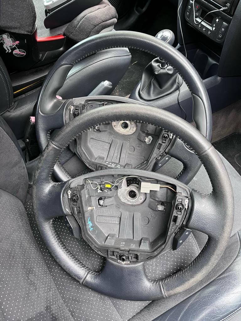

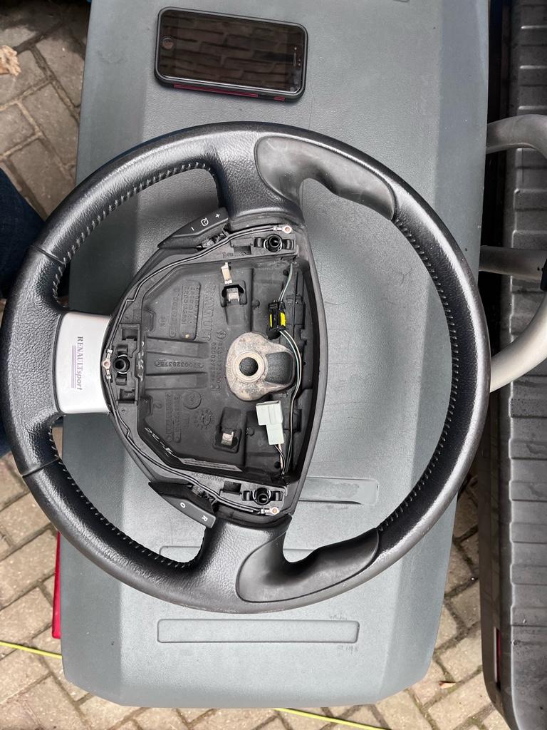

The steering wheel from @hopgop1 arrived today thanks again! , its it actually in really good condition vs the one in my car, so Im going to clean it up and put it in for now. I'll keep the other one as a spare for when I send this one to eventually be recovered.
Despite some trepidation around the airbag the job was really easy. All back together and an added bonus of cleaning the crap from behind the wheel!

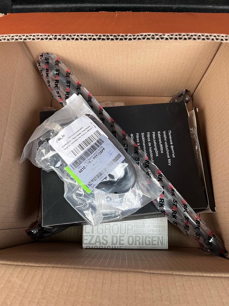

So a few odds and sods turned up, just waiting on one more part before I stop buying bits until the cam belt is done..
Gas struts, cabin filter, door release handles, battery terminal positive with cover and new gear gaiter as mines broken and glued in.
Just waiting on a new gear knob, the rest will be an investment of time getting it tidied up.

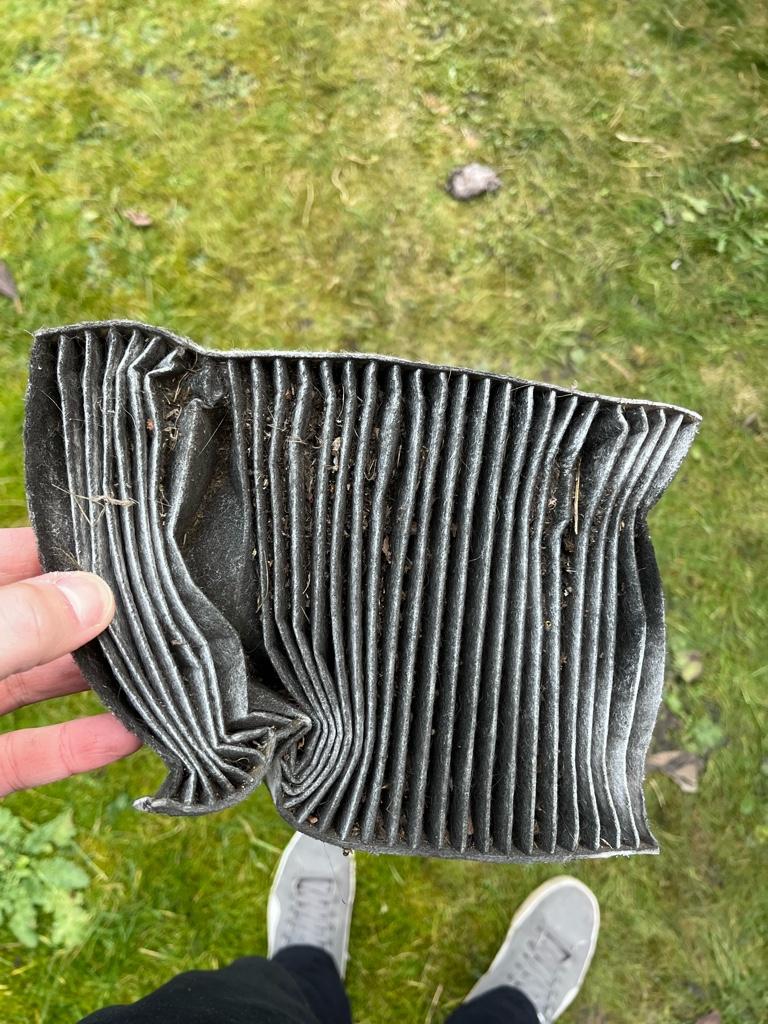

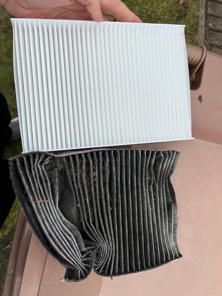

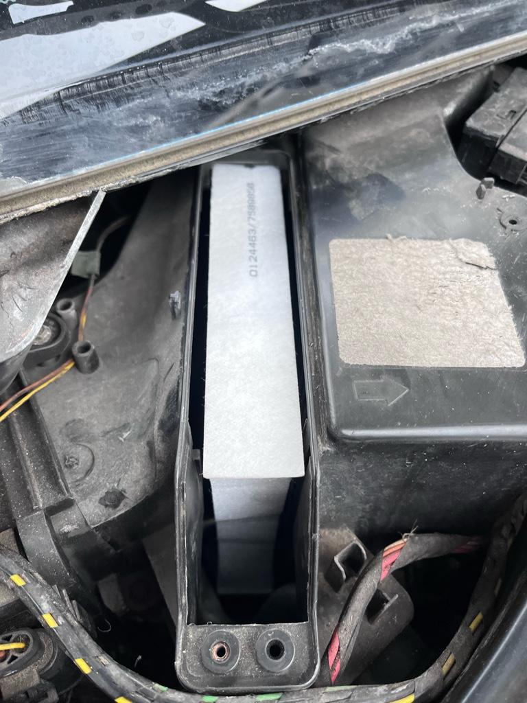

Speaking of the timing belt, confidence in it hein done recently has evaporated, I know cabin filters are often overlooked but really..

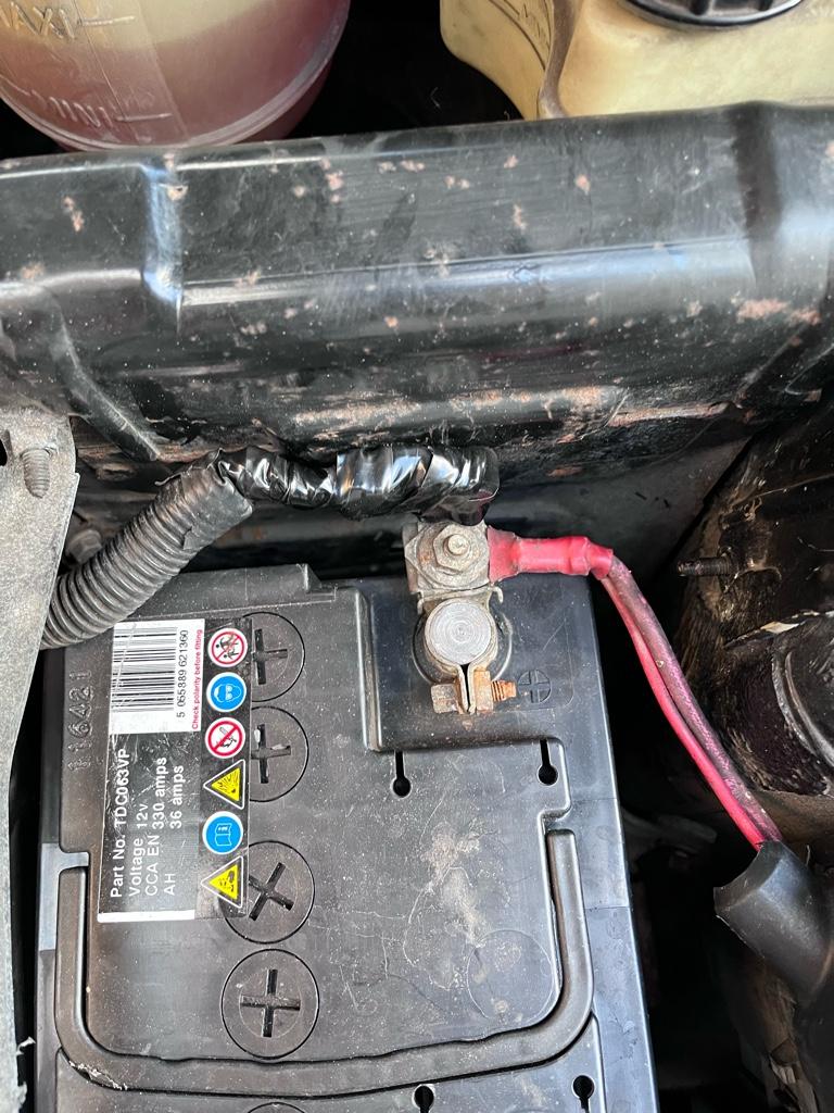

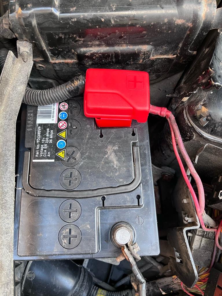

The battery terminal cover is a different thing, it
Had been put on 90degs out and was really close to the metal cover behind the battery, it had been solved previously with insulation tape which isn’t ideal.
So another simple job done but quite satisfying.
There’s now a big gap between the terminals and the risk of it shorting out so it shouldn’t burn to the ground… well not from this anyway.
Yeah battery live touching the ecu cover not a good idea! Little jobs like that are so satisfying 👍.

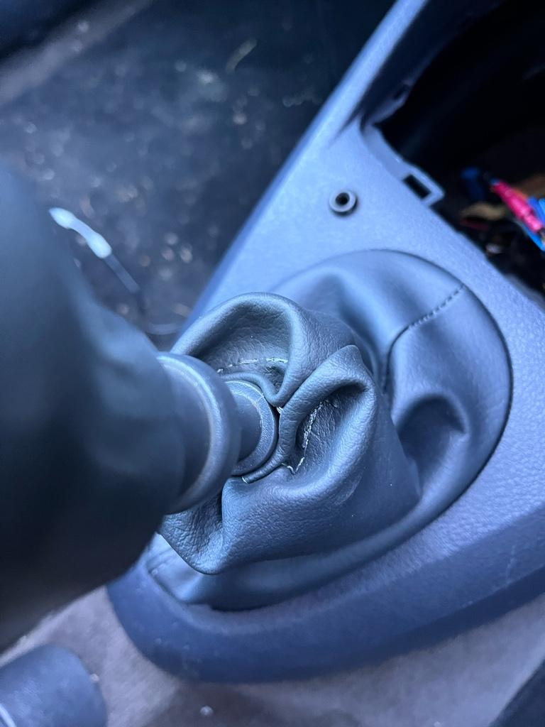

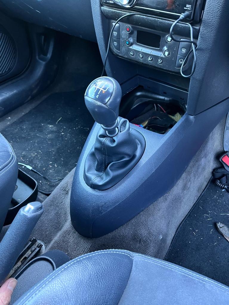

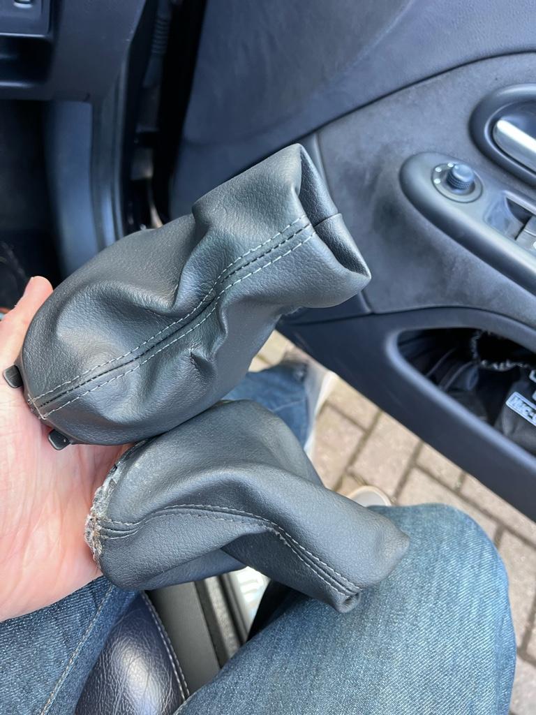

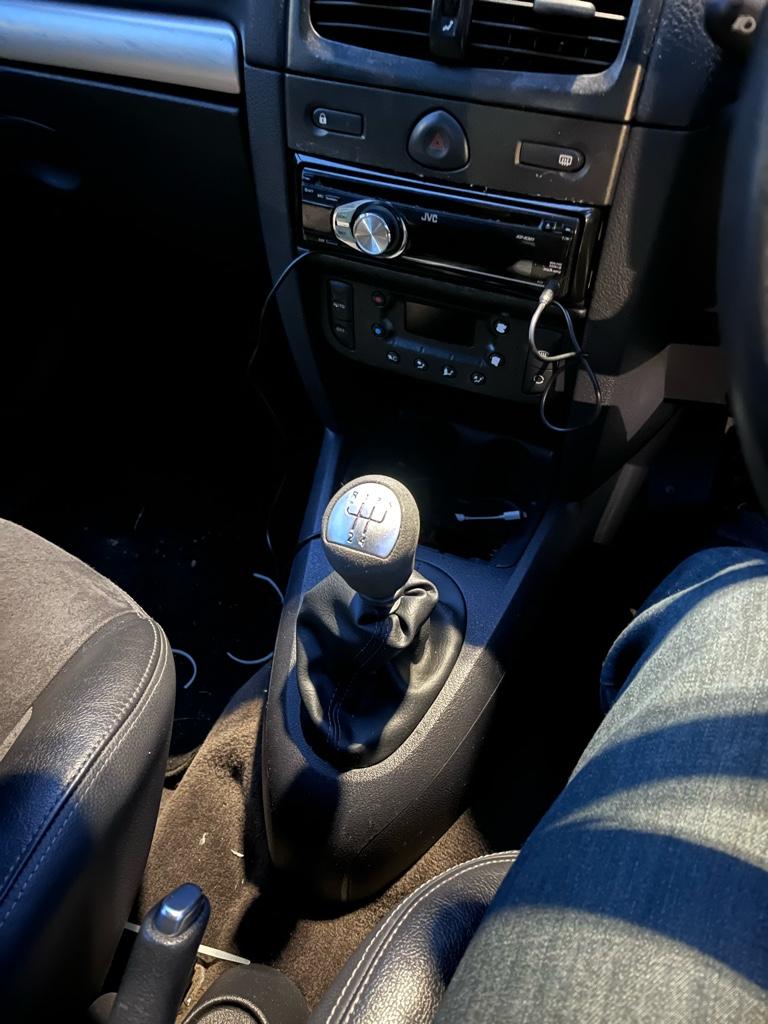

New gear gaiter fitted… badly so I’ll need to do it again, a learning experience. Just half they’re zip tied on.
still it looks tidier.

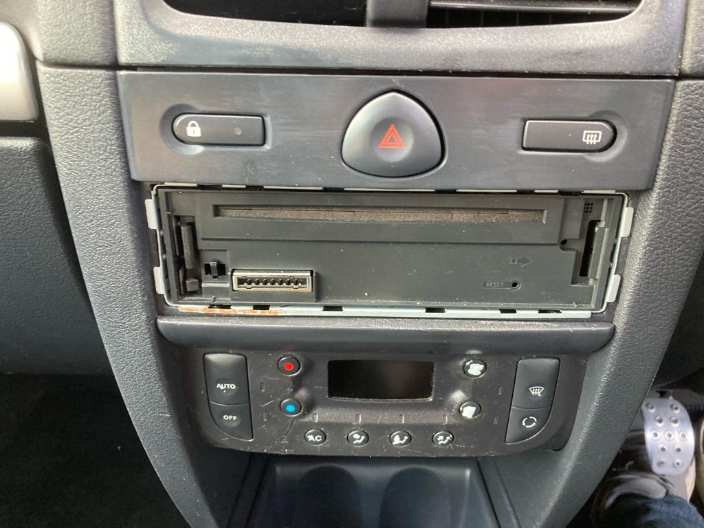

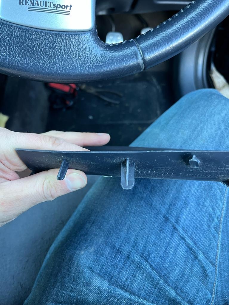

Also, whiles messing about with my AC servo motor things I found the a rattle… just been forced in and the lug was bent, you couldn’t really tell but now it looks bette, again satisfying little jobs.
Just need the gear knob then I’ll be happy with the overall look of the cabin, just need to sort out cleaning it properly. The weathers looking okay next week so might take a day off and get the seats and carpets out and give them the pressure washer treatment and a good wet vac, the the carpets, not the seats, they’ll just get the wet vac.

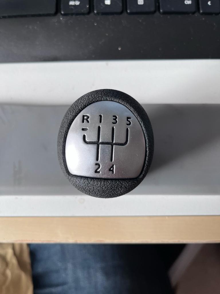

My new knob turned up, easy enough to fit and I like the look of it but hate the feel of it, don’t know why but it just doesn’t feel nice so I can’t see it staying long.
I’ve got another on mind but it’s not quite the same as a standard one, but I think it’ll be much nicer to the touch.

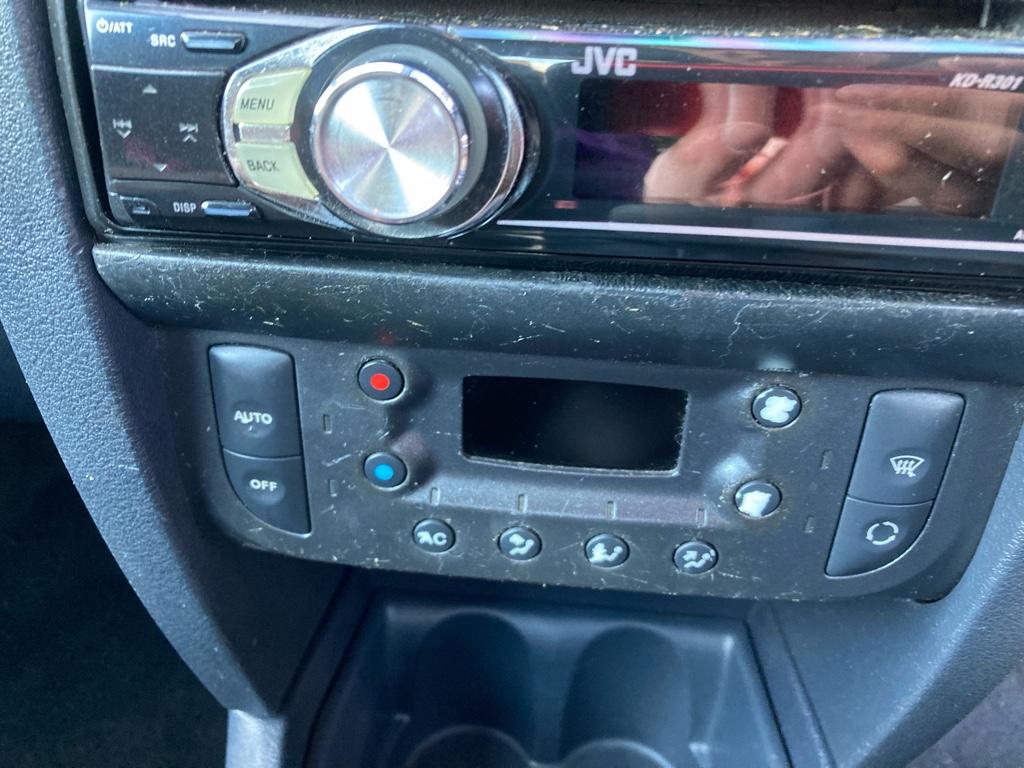

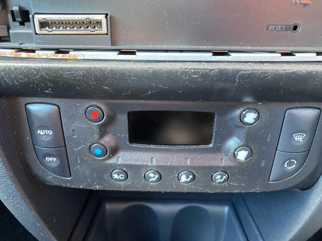

I’ve replaced the cabin temperature sensor on the hope it fixed my cabin temperature issues, I’m not convinced it will but I’m just eliminating things as I go. I’m now wondering if the control unit itself if faulty as you put it on auto and it literally does nothing, the fan speed doesn’t change at all regardless of the temperature in the car so I’ve got some more investigation work to do there.

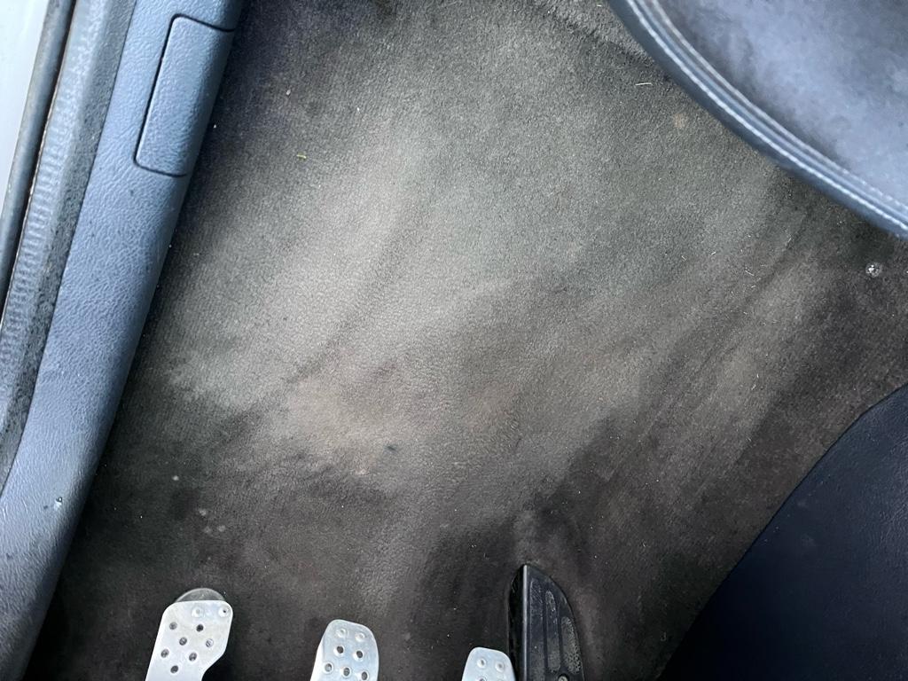

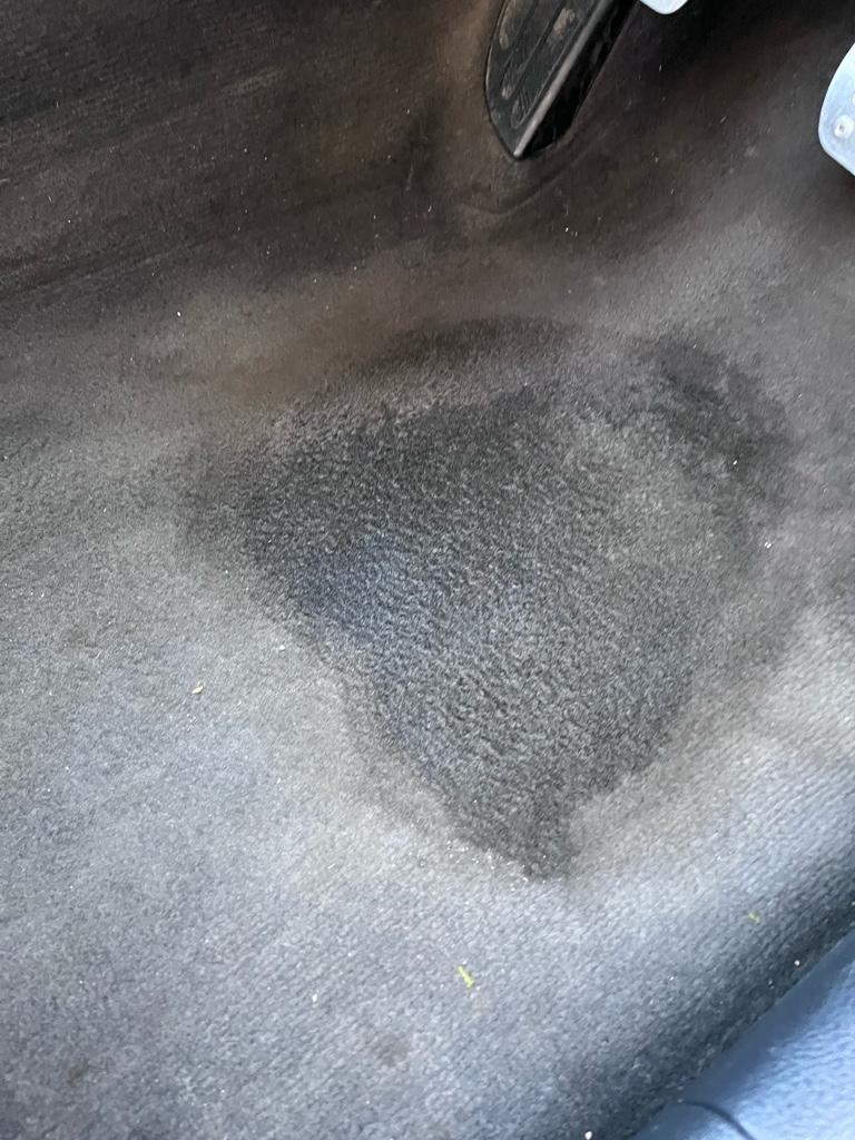

I’ve also did a test patch on the carpet as I wanted to see if it could be cleaned and it wasn’t just faded… it’s going to take some work!
Before
Test spot after, this was a really quick scrub and wet vac, when I mean quick I mean 5mins or so.
I’m pretty sure it’ll come back to a reasonable standard, just going to take about 7 years… lol

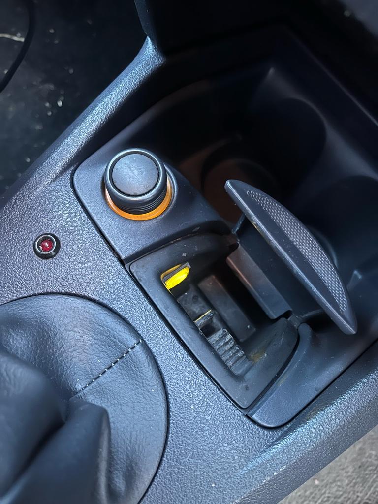

I’ve also fixed the cigarette lighter light, the Earth had been cut to so fixed that and replaced the bulb and it’s back! Wish the heating issue was this easy!!

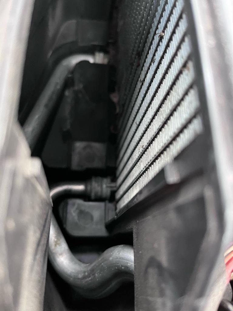

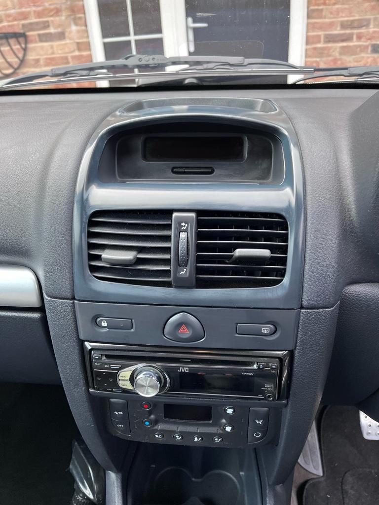

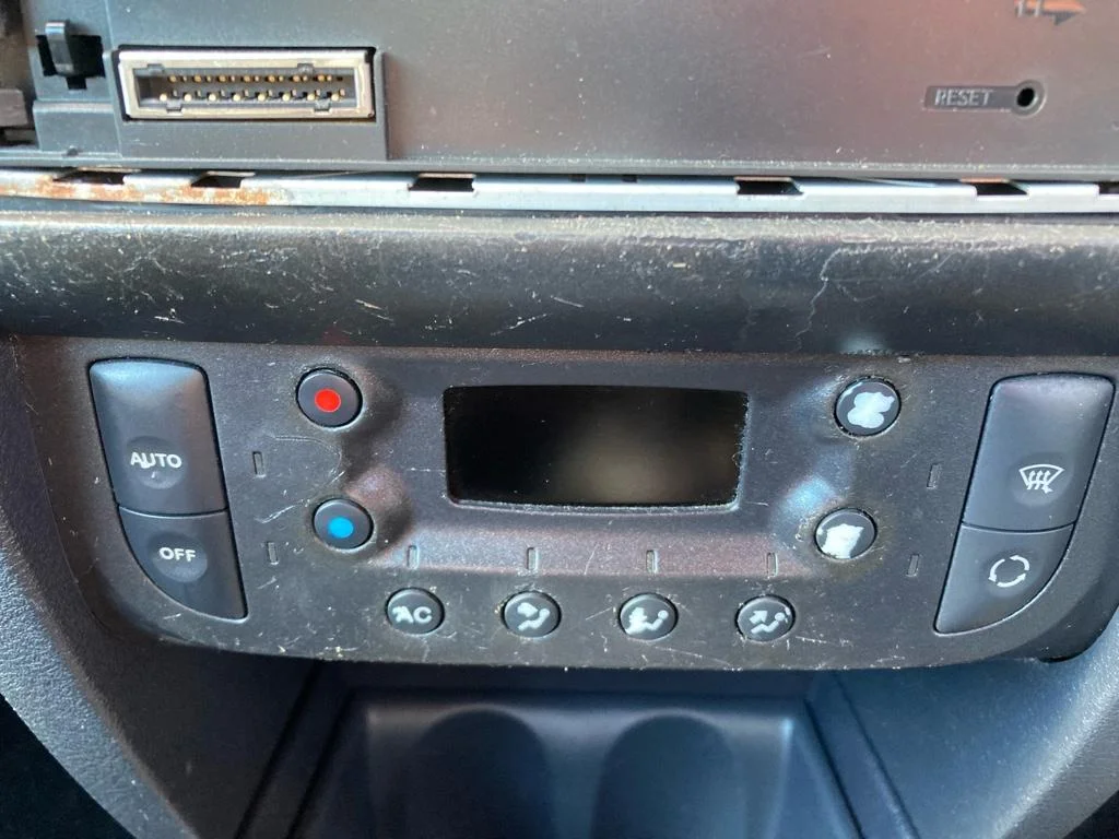

What’s the full symptoms of your climate control issues? Common issues are the resistor pack (under the scuttle panel) or the little cog that you can see in the drivers footwell near the centre console, which splits. It can be fixed with some cable tie/jubilee clips.

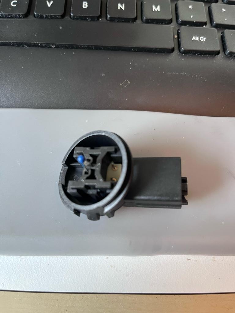

Basically I can get both hot and cold air on manual and the motors both work, the little cog thing was okay in mine as that's the first place I went to, I also threw a zip tie around the cog since I was under there.
When you press auto nothing ever changes, you can up the temp and the fan speed and temp just remain static the same when you drop it. I feel like if the cars cold inside and you set it to "Maxi" the fan speed would go up and the same if you dropped it. Its all with AC set to "off" as I know there is no gas in the system (that's on the list for resolving), to me it seems like its just not really picking up a temperature to decide what to do?!
So, are you only trying Auto when the car is cold? Or have you run it in auto until the car is warm. The system has an in built ‘step up’ as the car warms. So if it’s stone cold in auto mode the fan level will be very low. As the engine warms it will step up the power. If you are pushing auto and the car is up to temperature. Then there is a problem I guess. Temp sensor would be a great start. If the fans are working in manual mode it’s unlikely to be the resistor pack and as you say you have checked the cog.
Okay, thanks thats useful to Re the way the system steps up but makes sense. I replaced the internal temp sensor but just started the car and it didn't do anything but that makes sense now.... an excuse for a drive out!

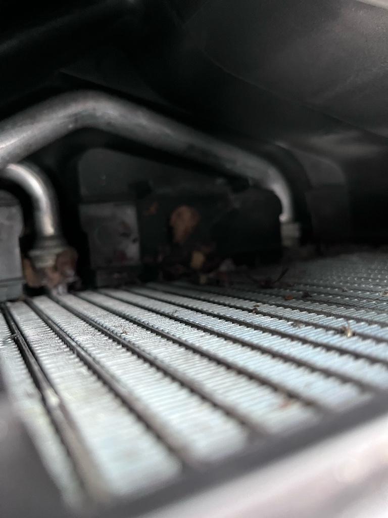

So I have just tested the "sensor" using a multi meter and it appears to operate as expected. The resistance varies depending on the temperature and is deceptively sensitive with me just needing to blow on it to make it change. Next up will be to see if I can identify the other end of the wires for the senor and check they are okay and there are no breaks in them. While a bit annoying I quite enjoy this fault finding forces me to think about things!
Just found this useful link as well...
So I now know what I am looking for and where it goes into the unit.... a job for another day.
