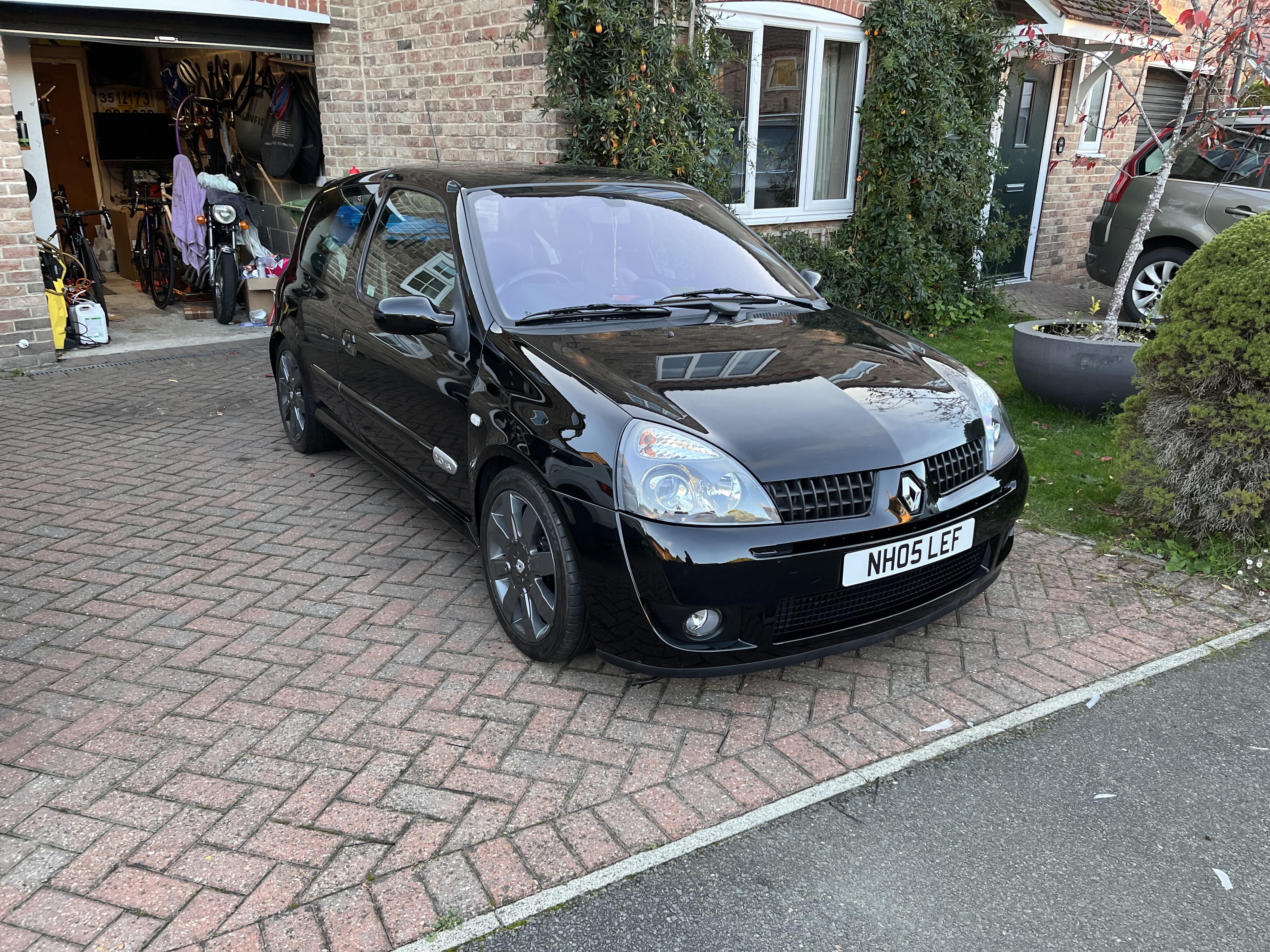

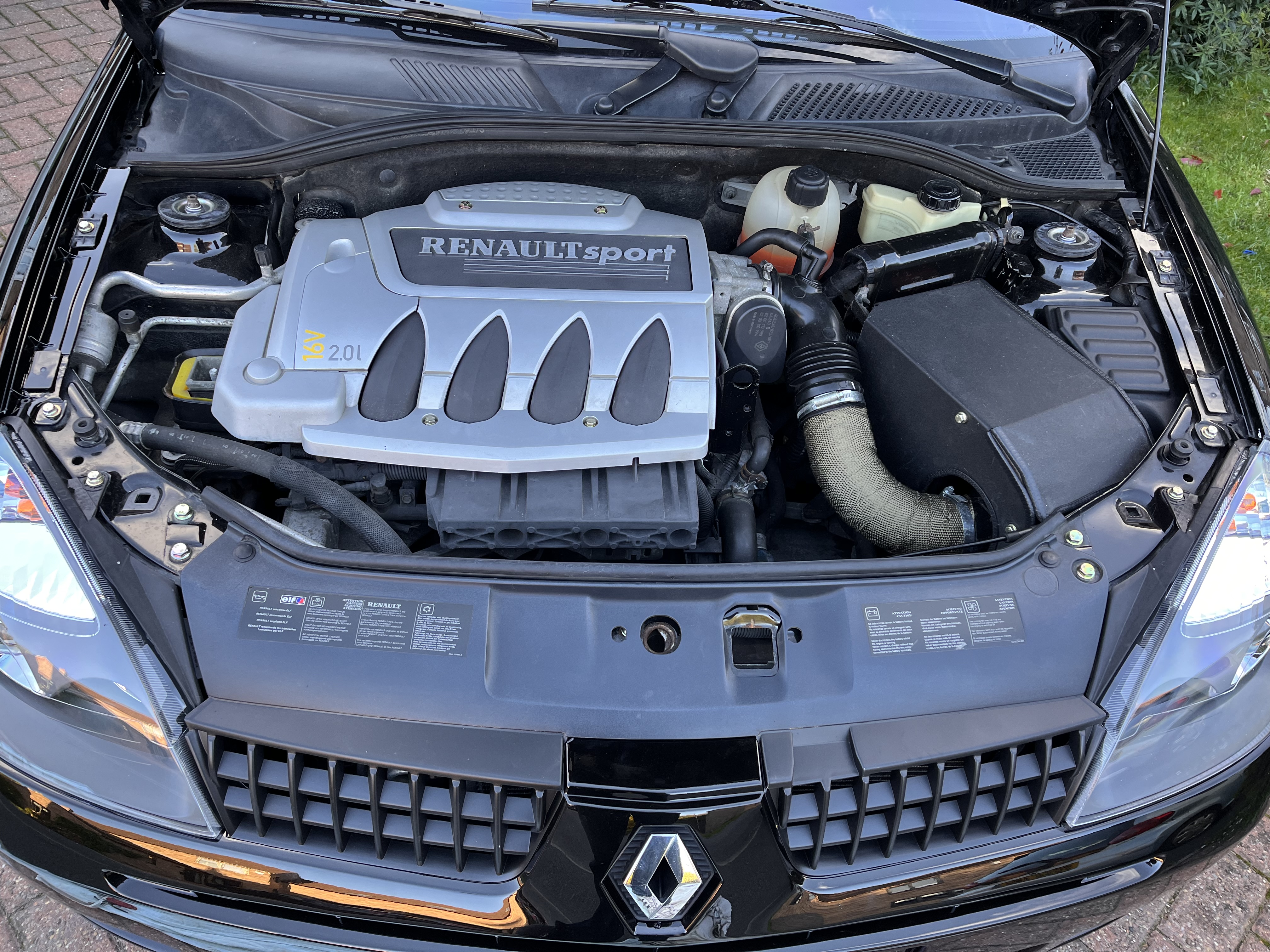

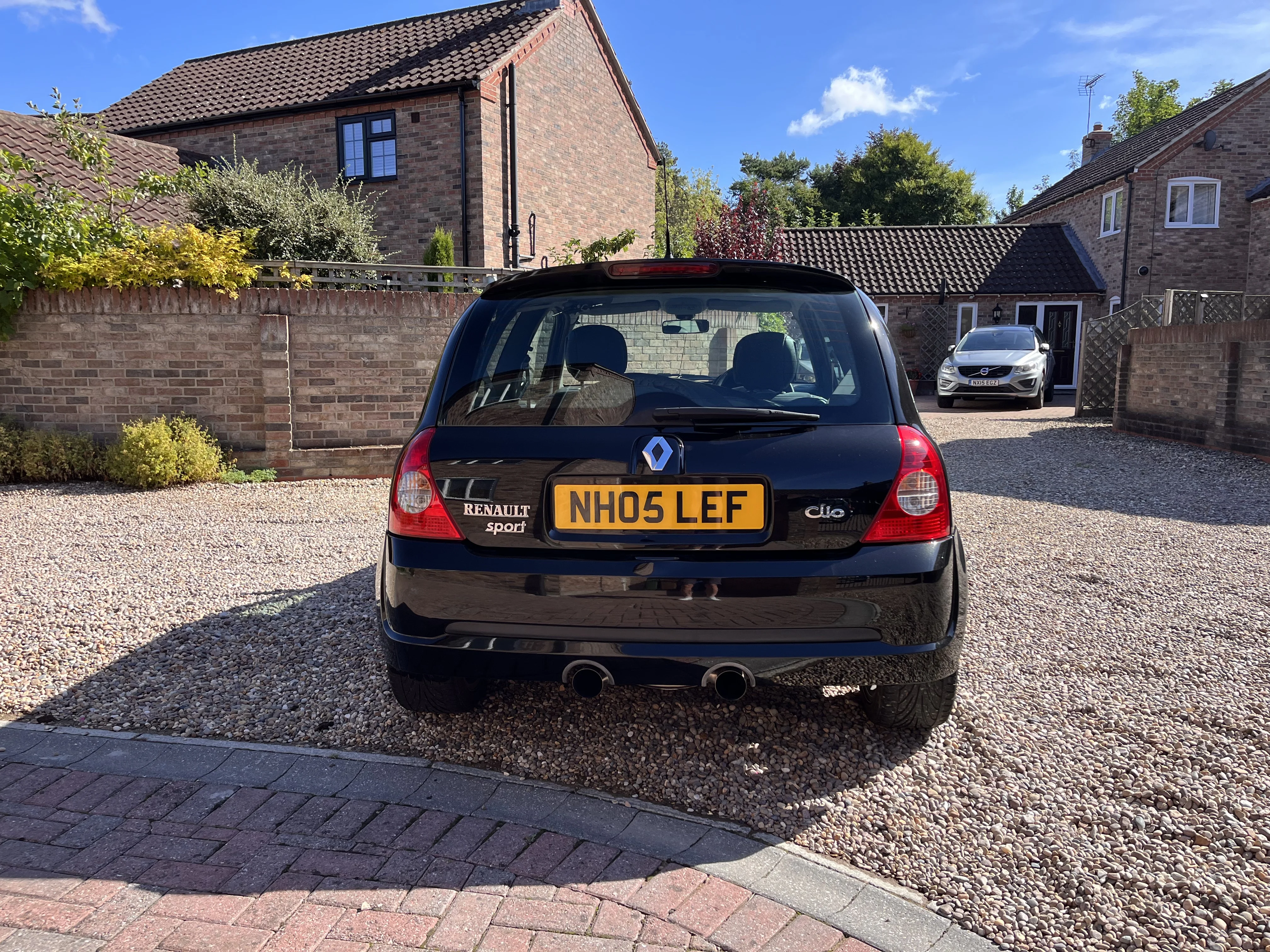

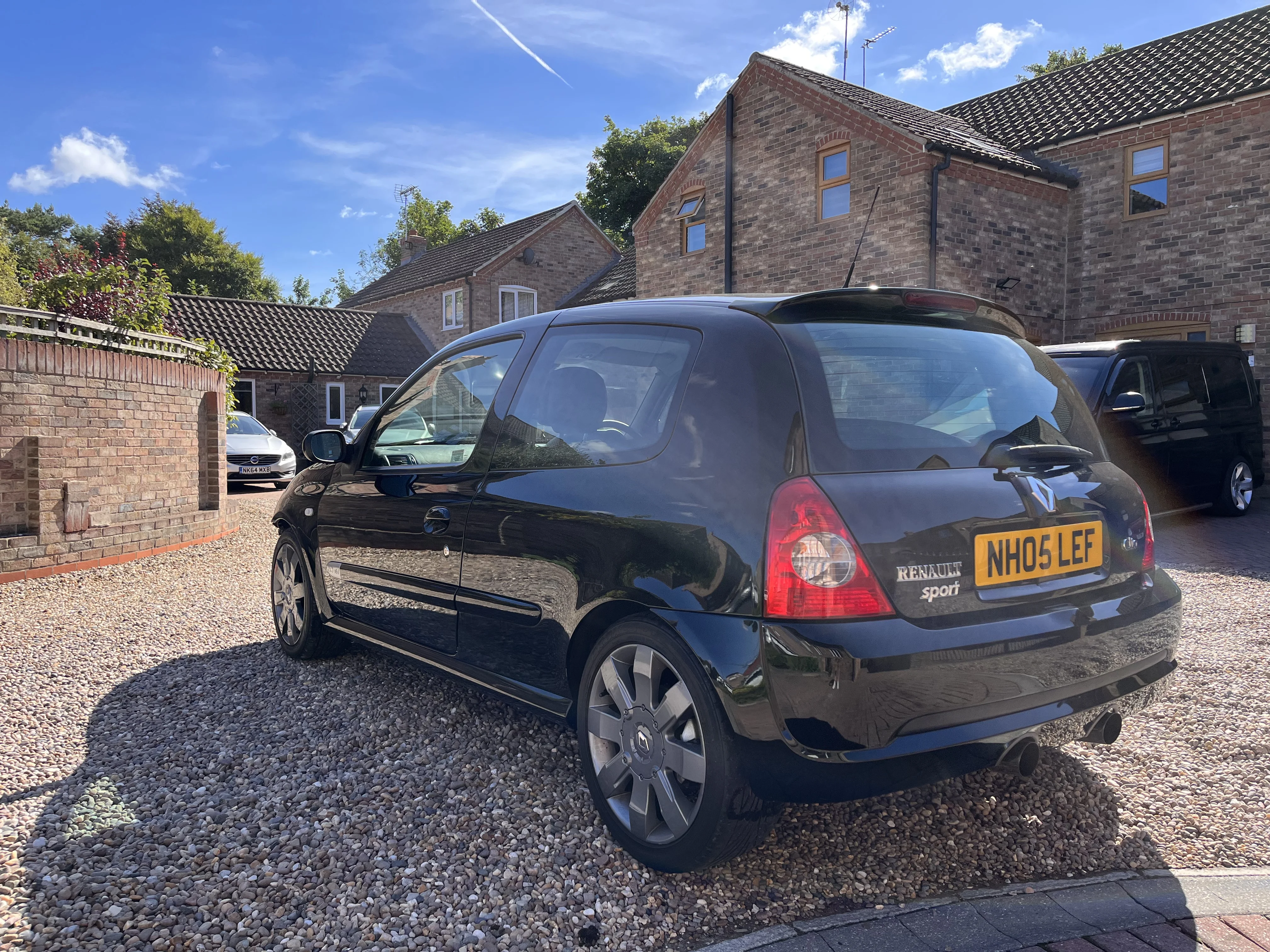

“Charlotte” The 182 FF
At last some pics and the start of my (probably slow) project thread.
Picked up with limited history but from a friend who’s spent £1400 on lots of new bits like brakes, calipers, clutch, exhaust etc etc only to get a mk3 and sell this one.
I got it at a fair price but it needs some love as you’ll see. My intention is to not modify it but maintain it as stock as possible with some minor mods that I think really benefit the overall car.
I’ve done this before and termed it Stock+.
To first part will be to get and fit the missing bits, like the 182 steering wheel and gear knob, then sort out some odds and sods that are broken as well and deep clean it, as it’s pretty grubby.
Having been over it with my paint depth gauge it’s all original it would seems which is good, there’s some age related marks on the Bodywork that I’ll fix and the interior is, in places disgusting, but more on that to follow.
Here’s some pics to start with,

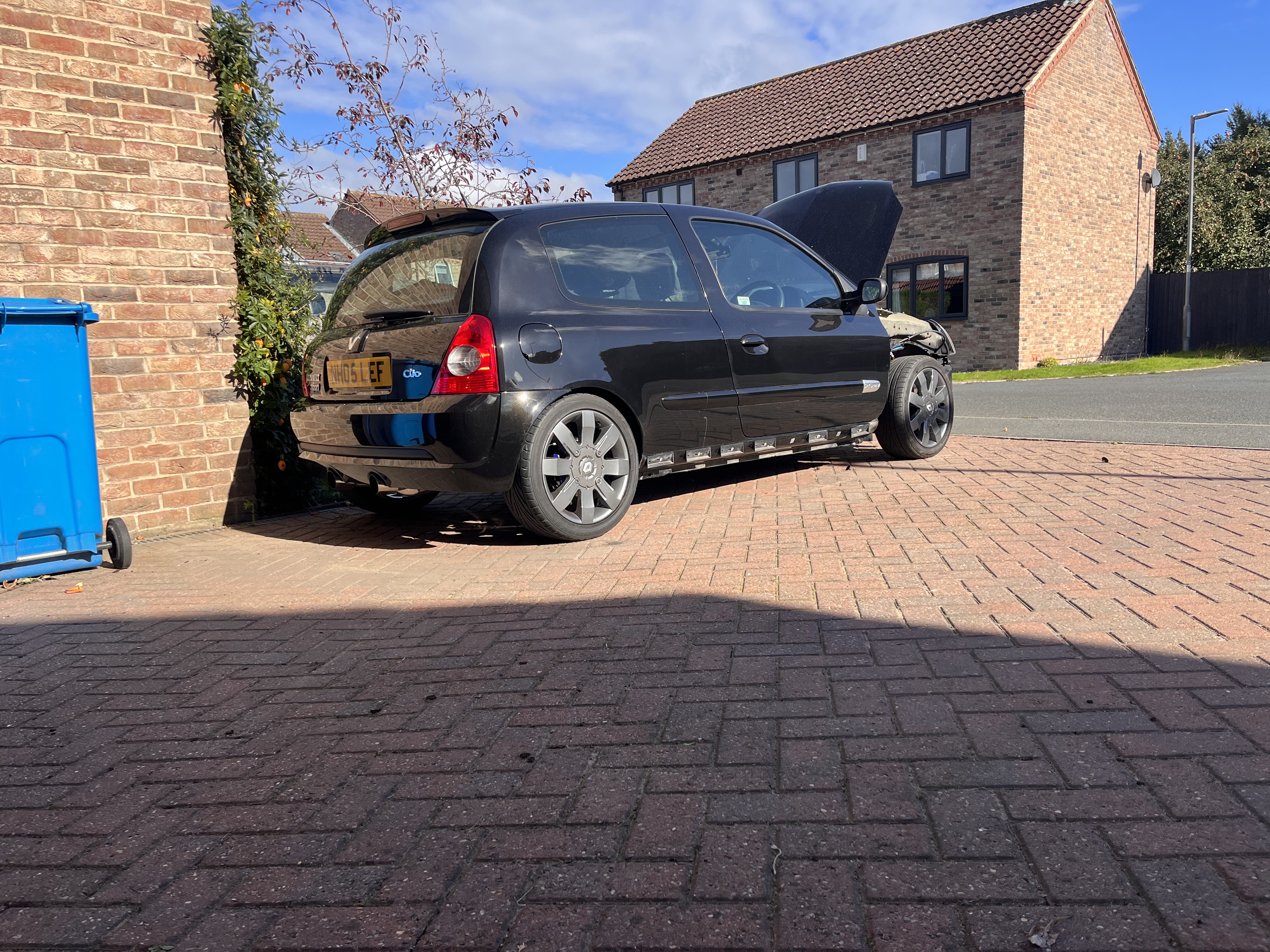

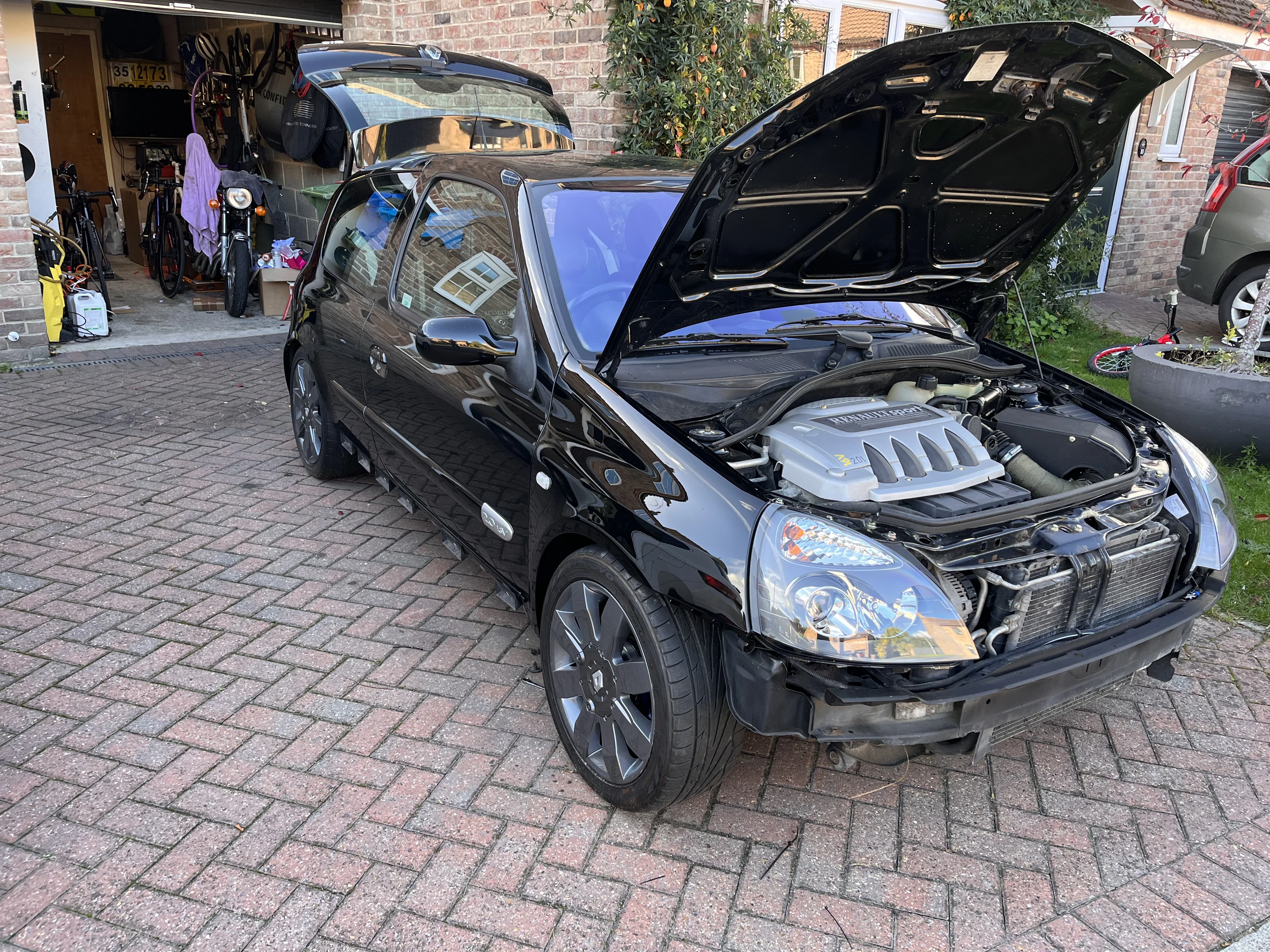

As she stands

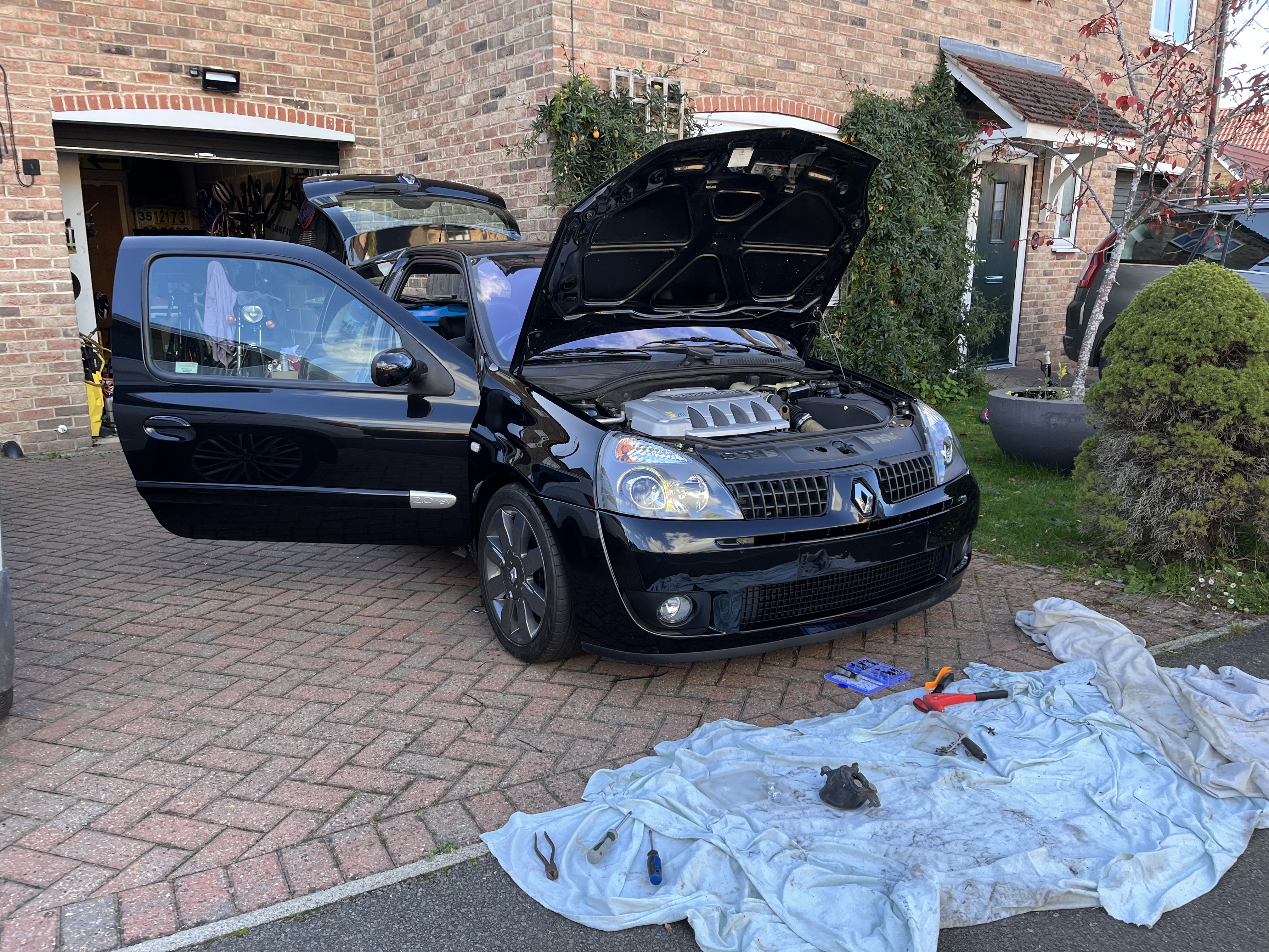

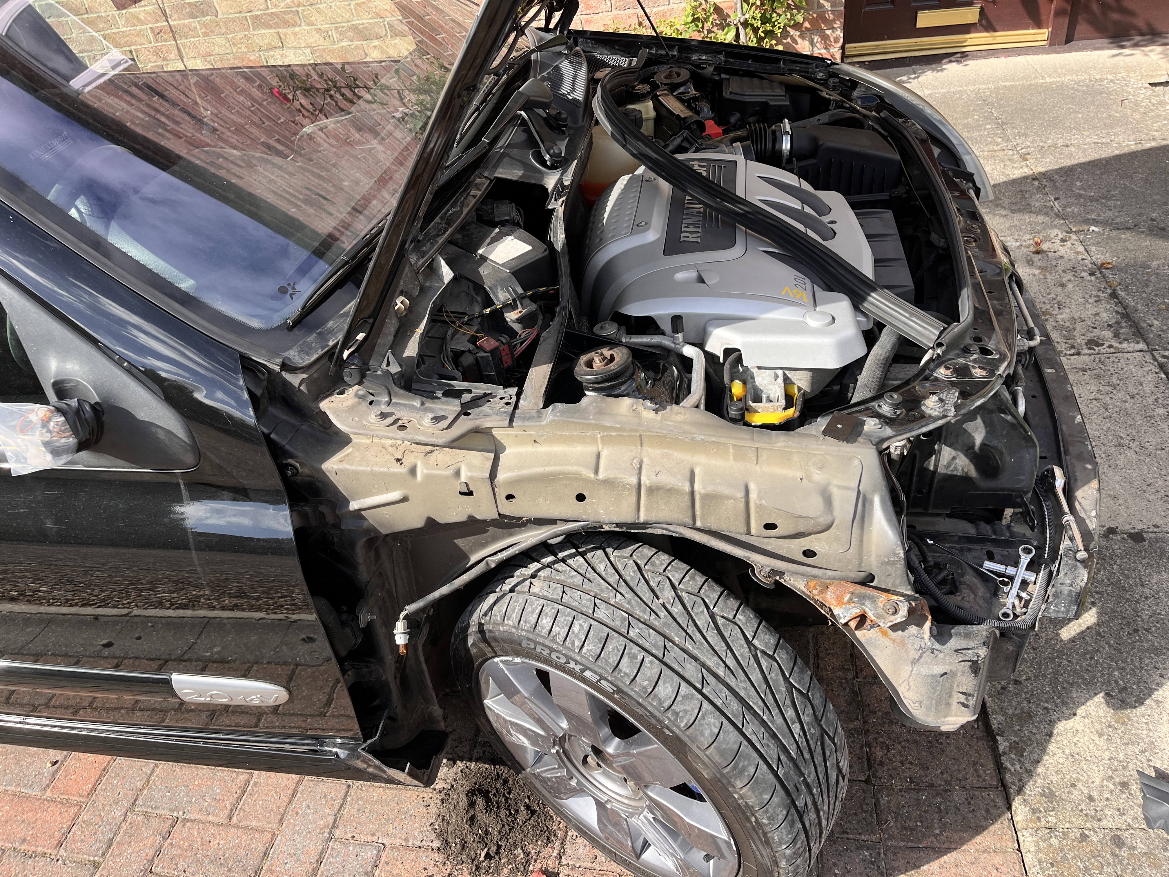

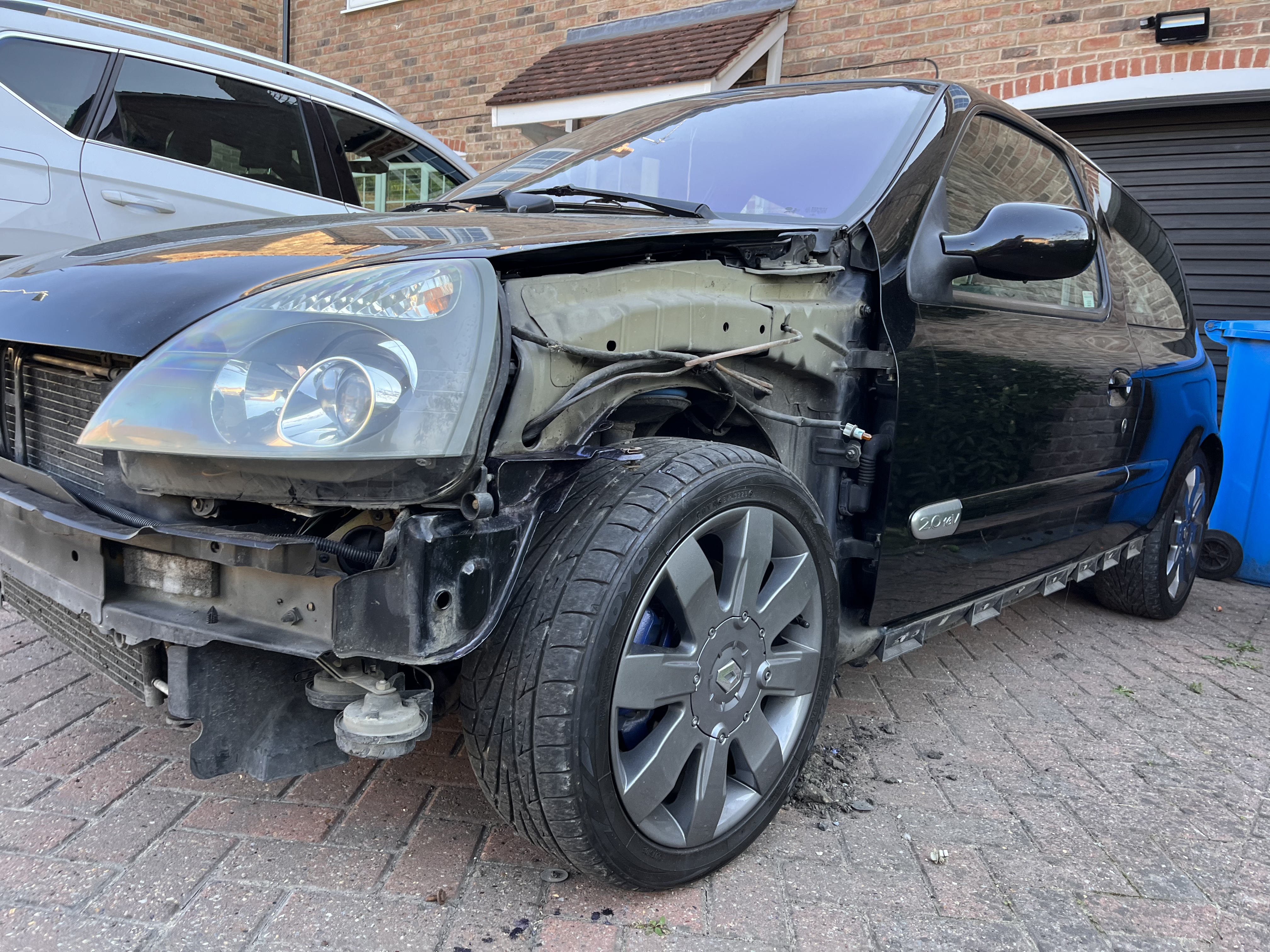

So I’ve made a very early start, I need to get the front wing off which means taking the skirt off so I’ll get on to that, in the meantime I cut the wing off with a saw to see what was going on, worst of it seems to be the bracket at the front that I’ll need to straighten out.
I’ve decided to get two new headlights as Hella units are still available, that way they’ll be nice and fresh and match as well.
I’ve got a front wing and wing mirror on the way, they’ll need painting along with the front bumper, might get the other front wing and bonnet painted as well so it matches well

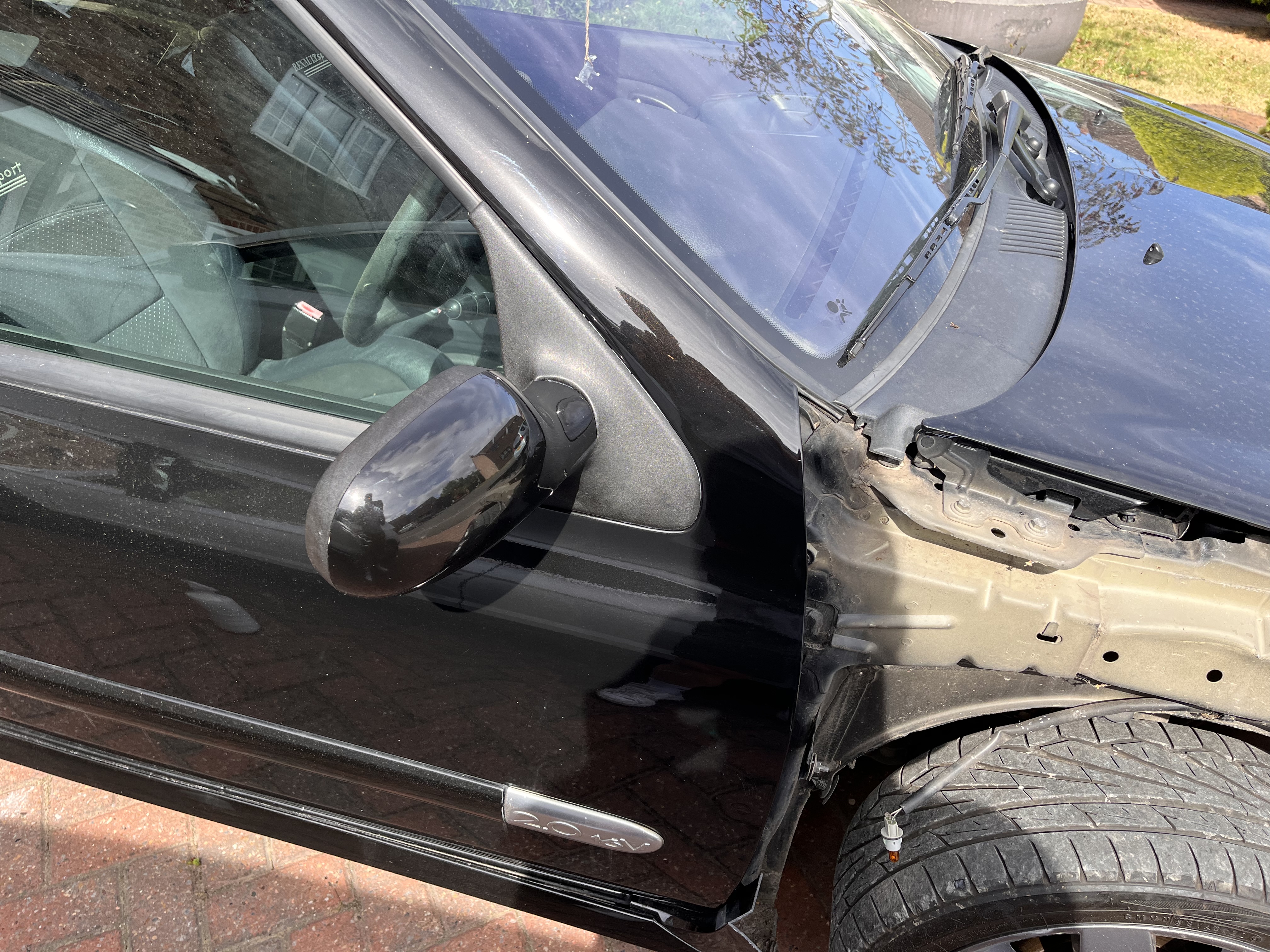

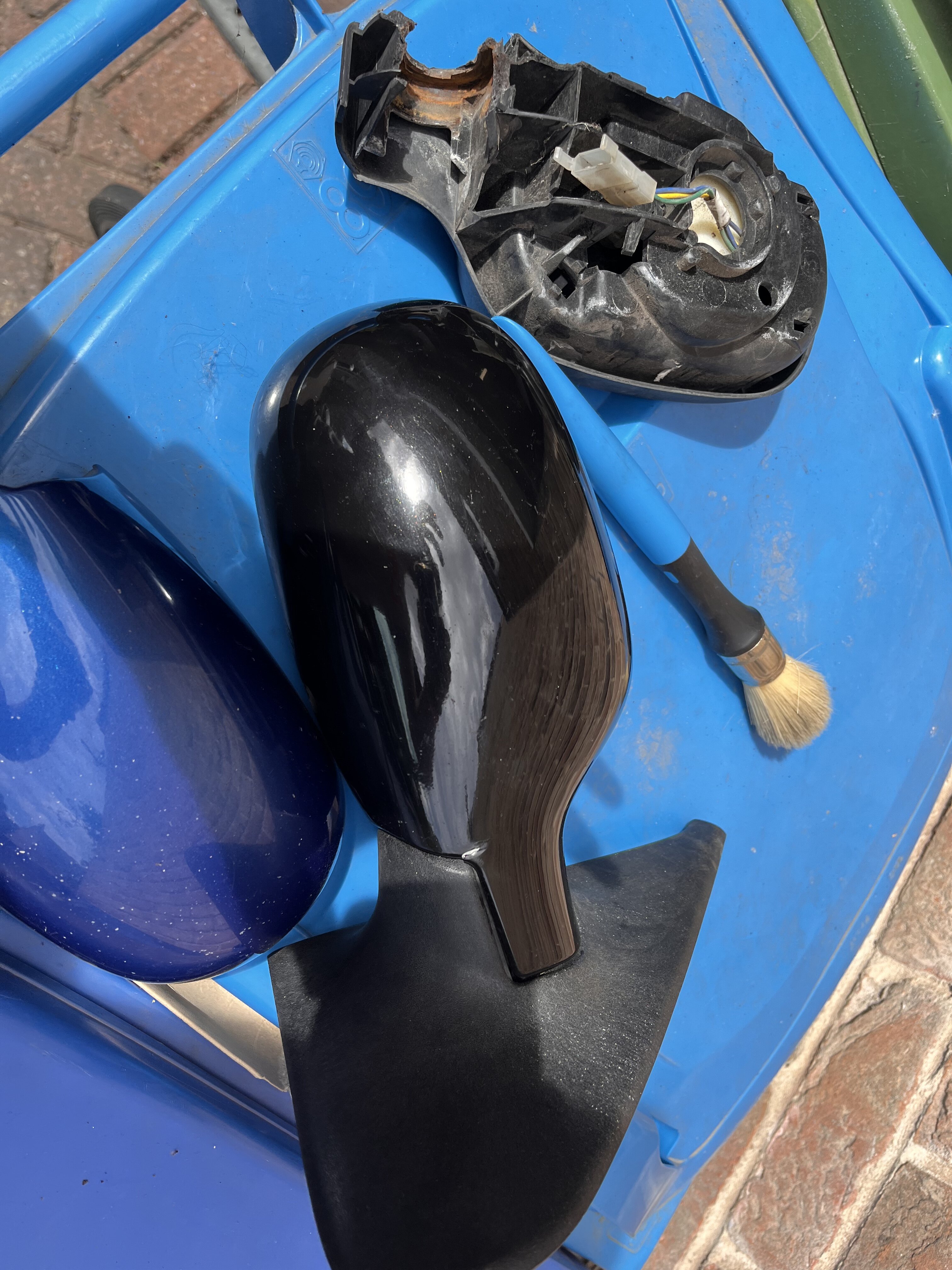

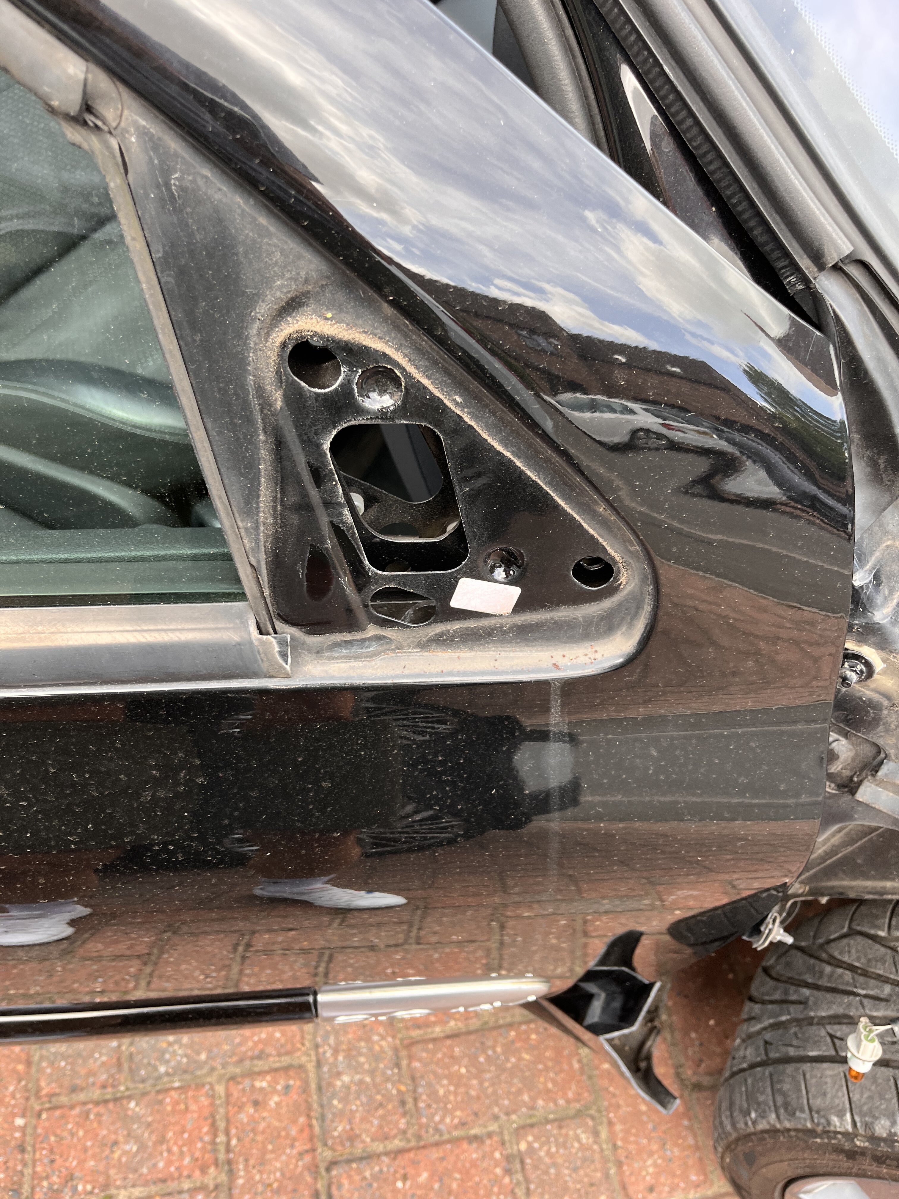

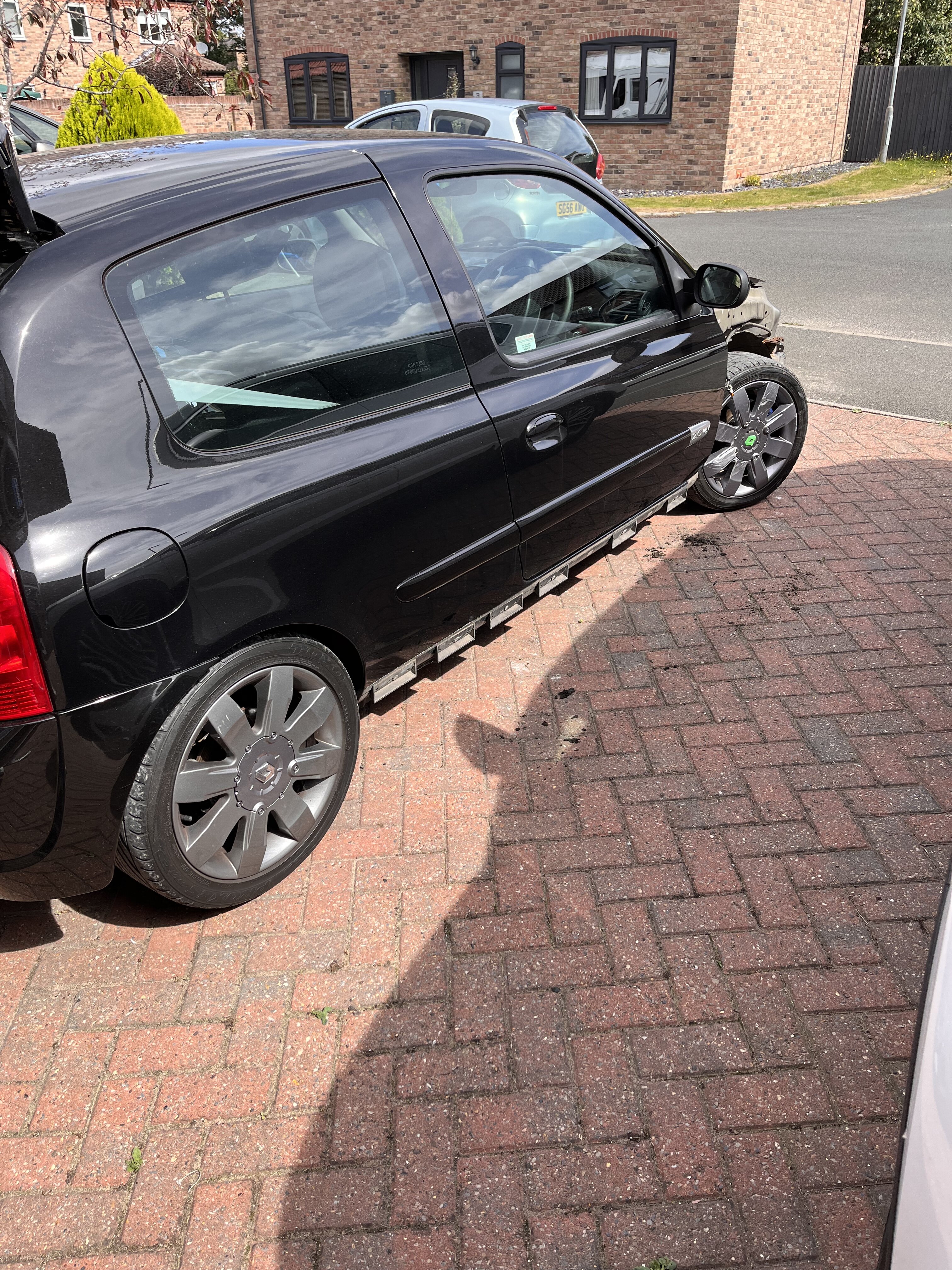

i have a wing mirror and spare wheel and I’ve taken the skirt off…

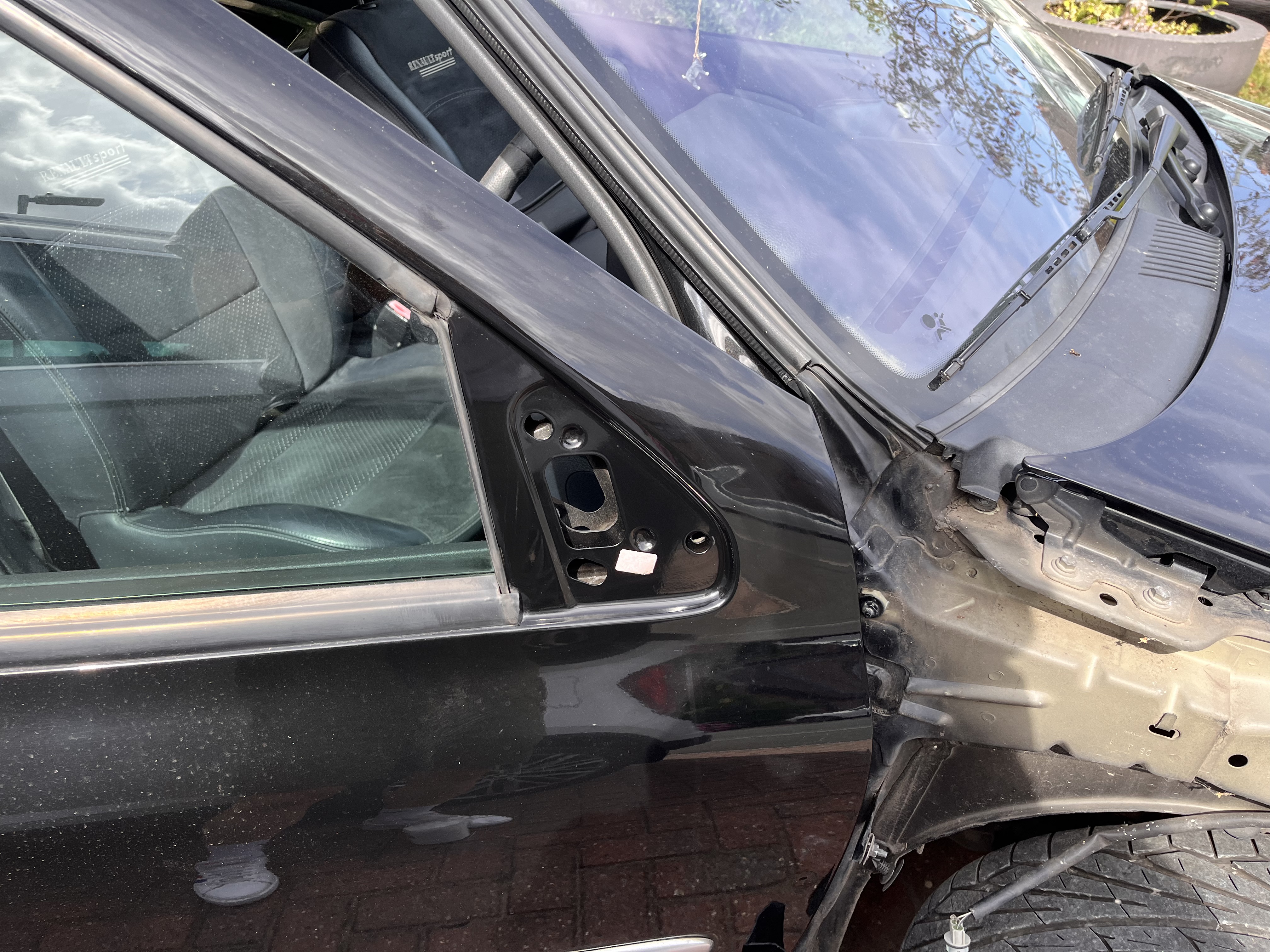

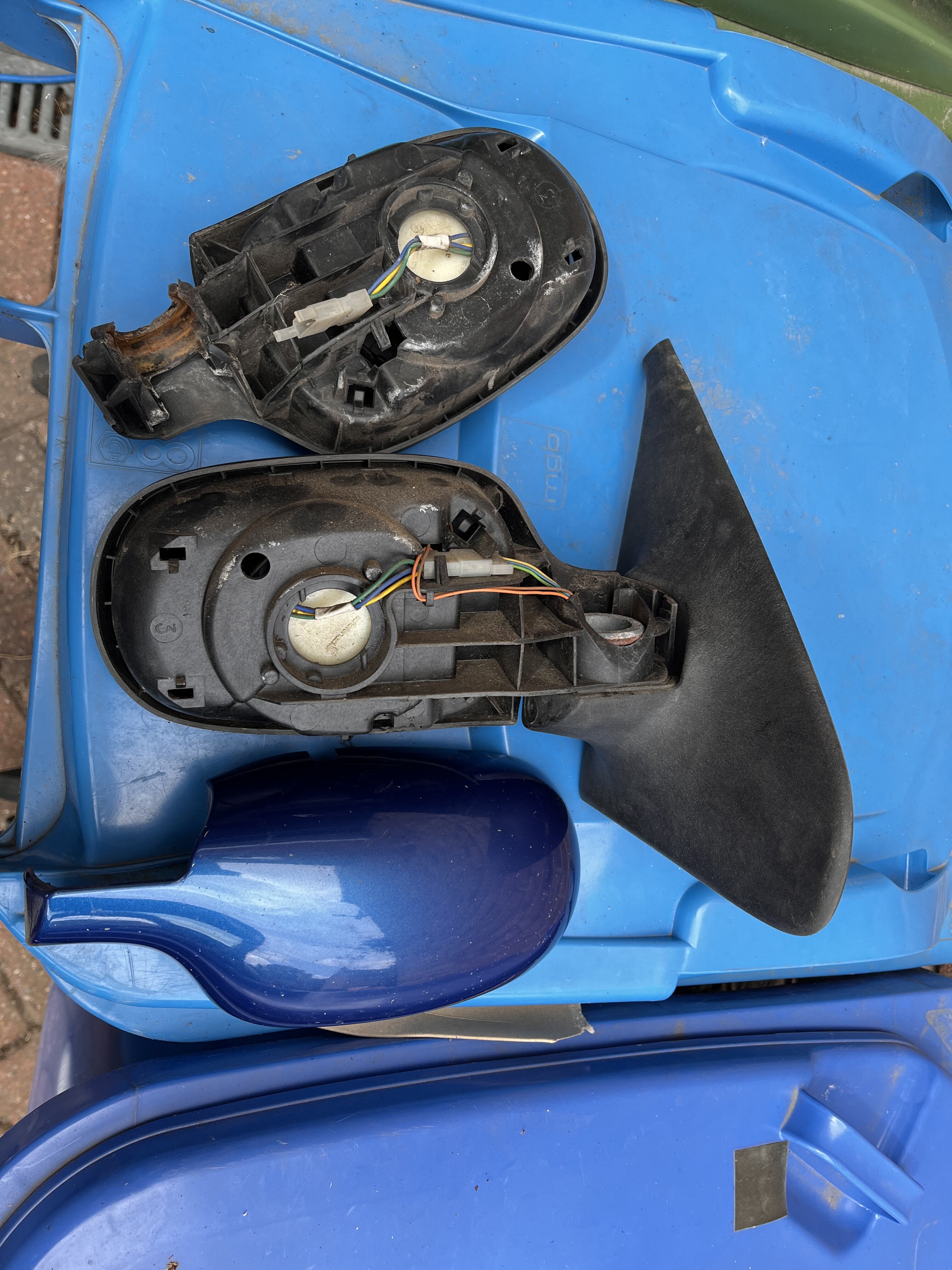

Wong mirror was an easy job, the cover had embarked on a solo trip and is actually not really damaged so fitted that then gave the area a quick clean and swapped the whole unit over.

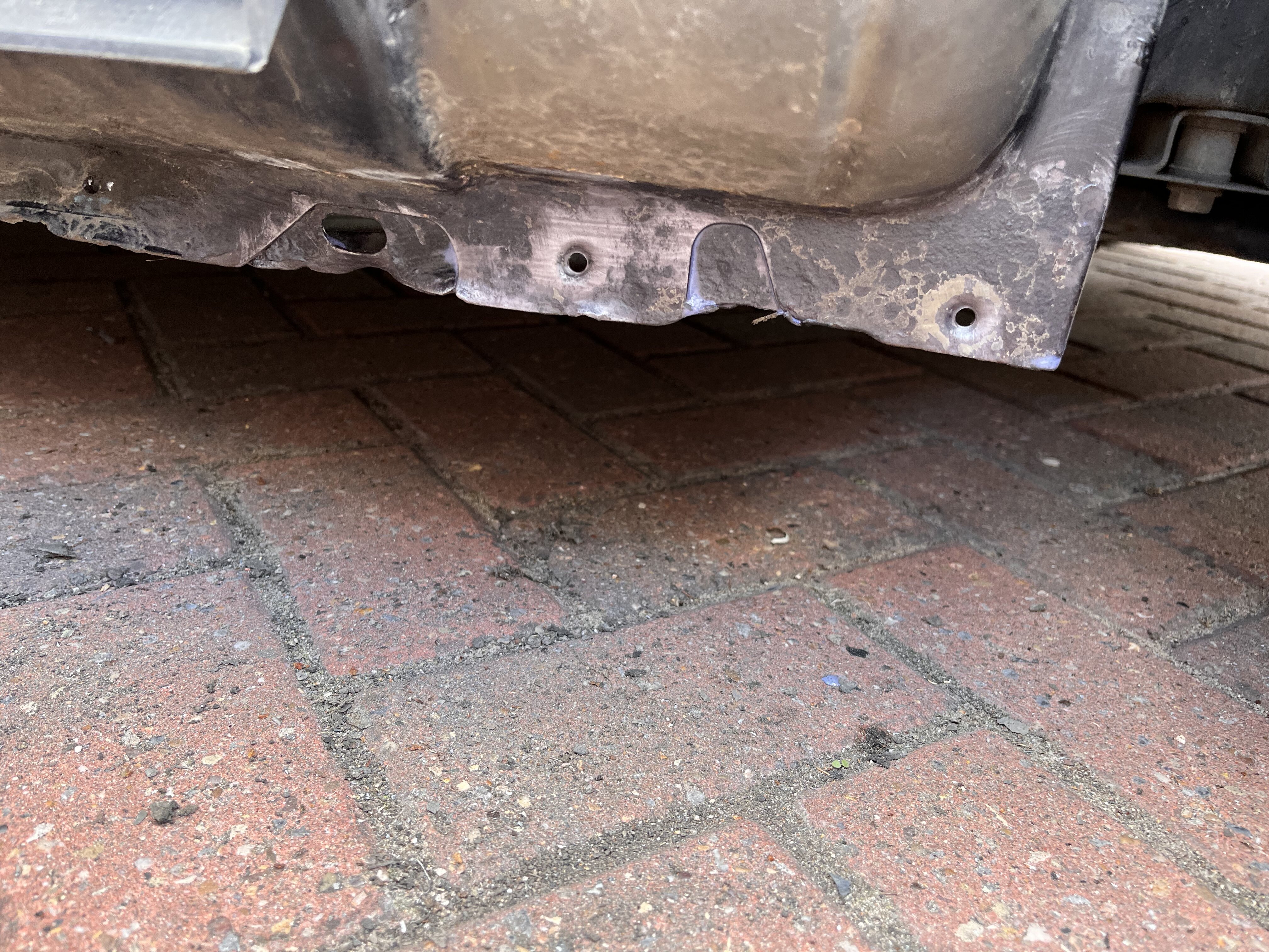

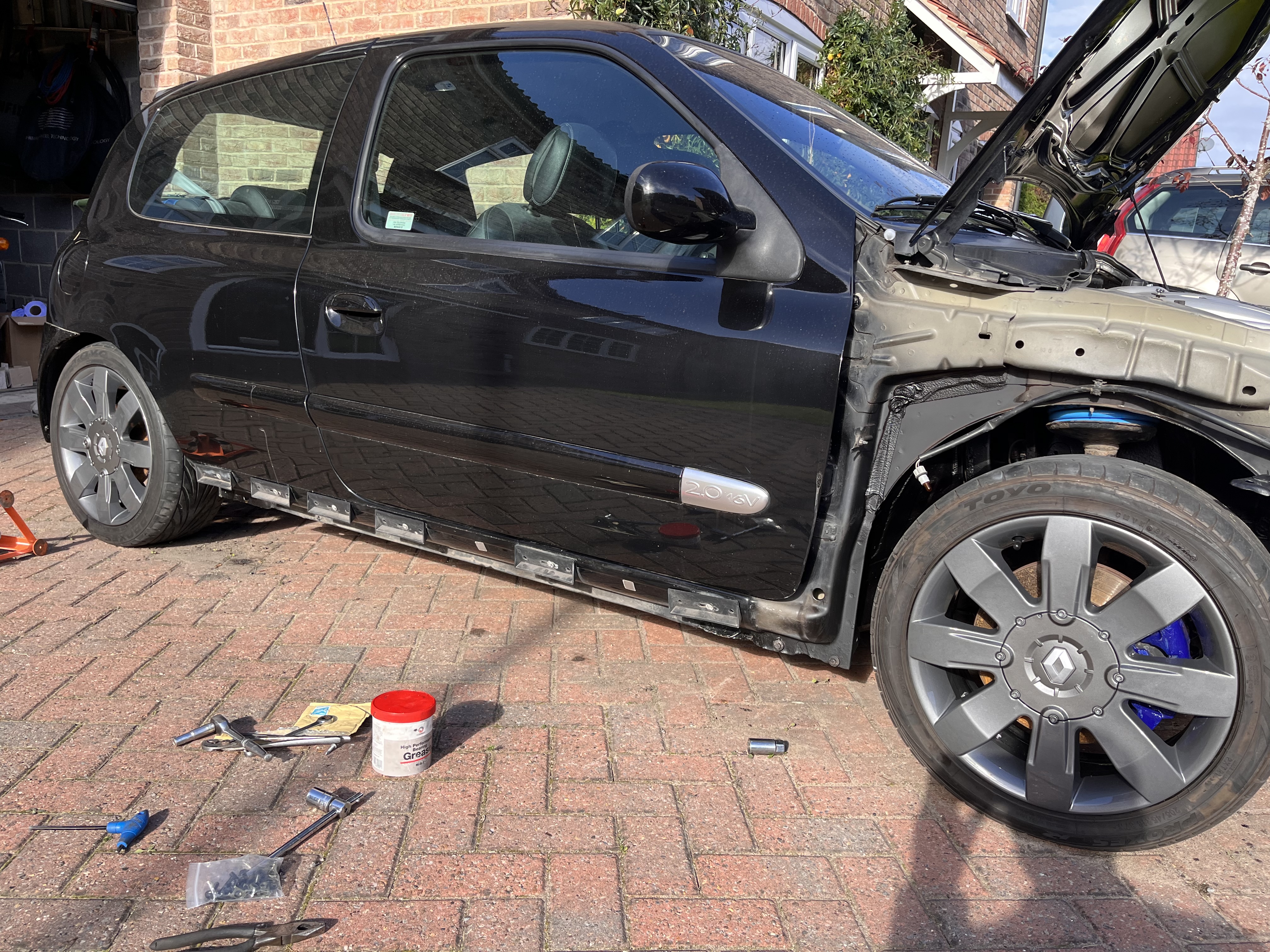

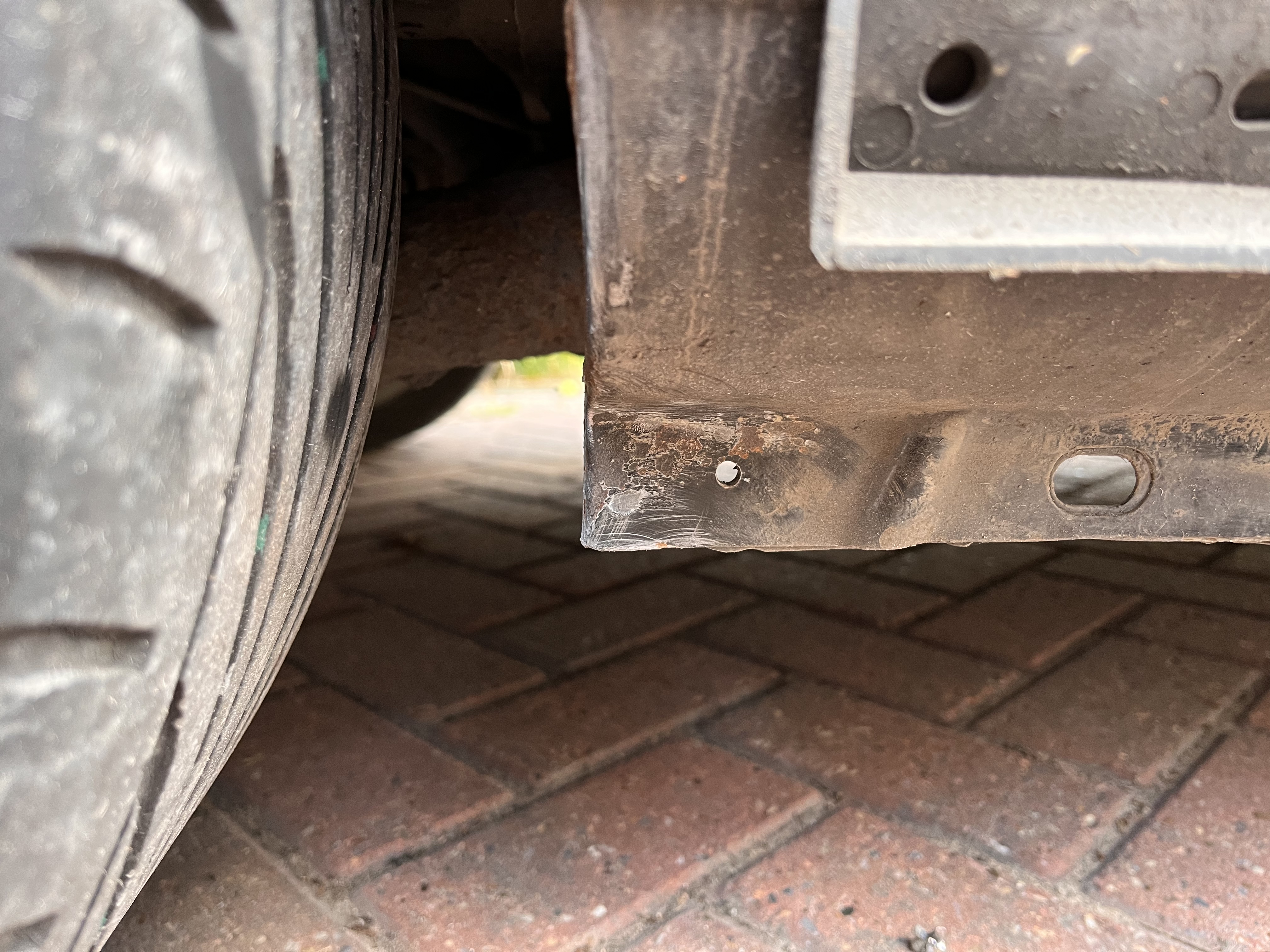

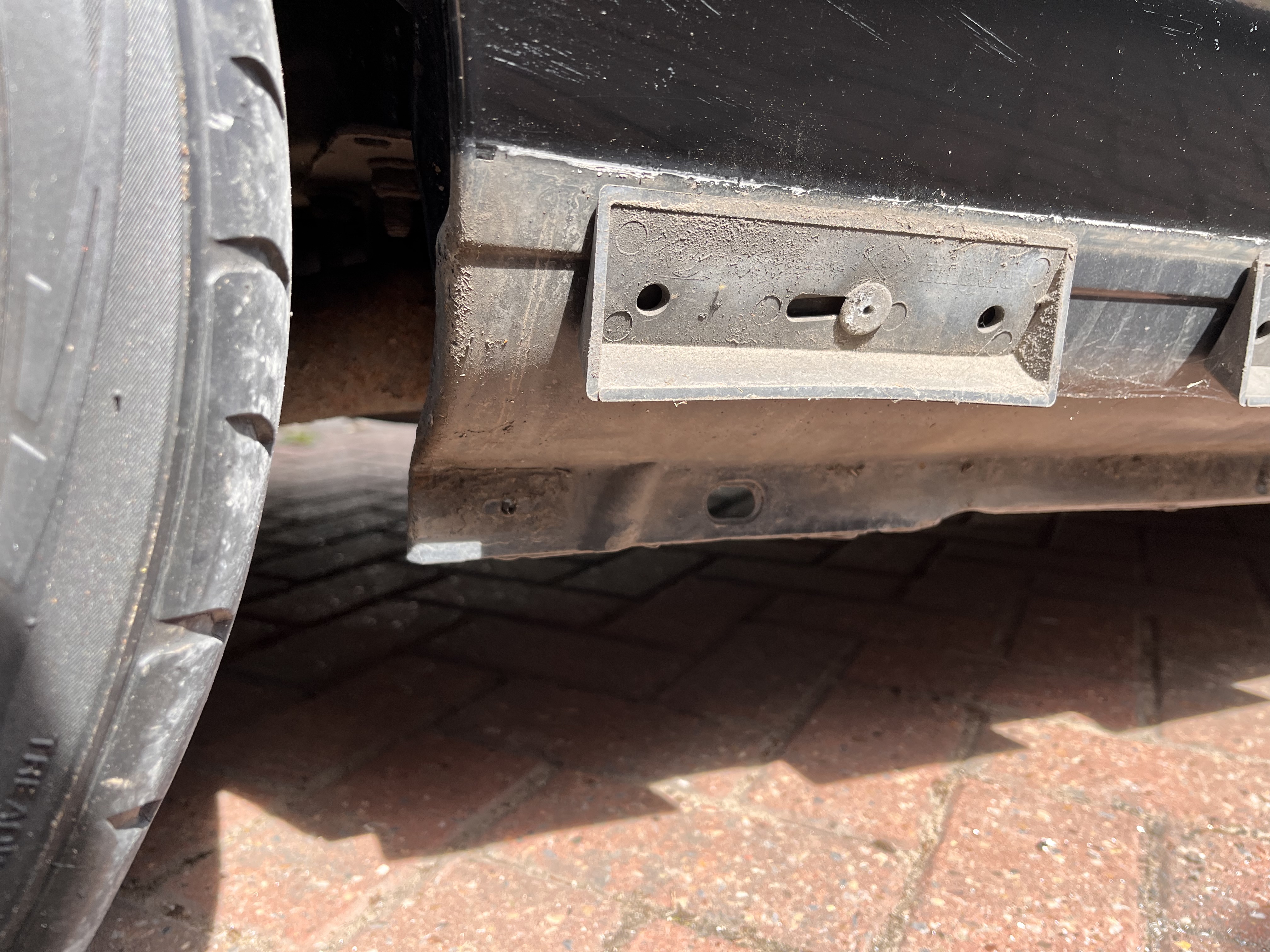

Next I drilled out the rivets and pulled the skirt off, pleasantly surprised to see it’s in great condition underneath, only a few areas that need some minor attention.

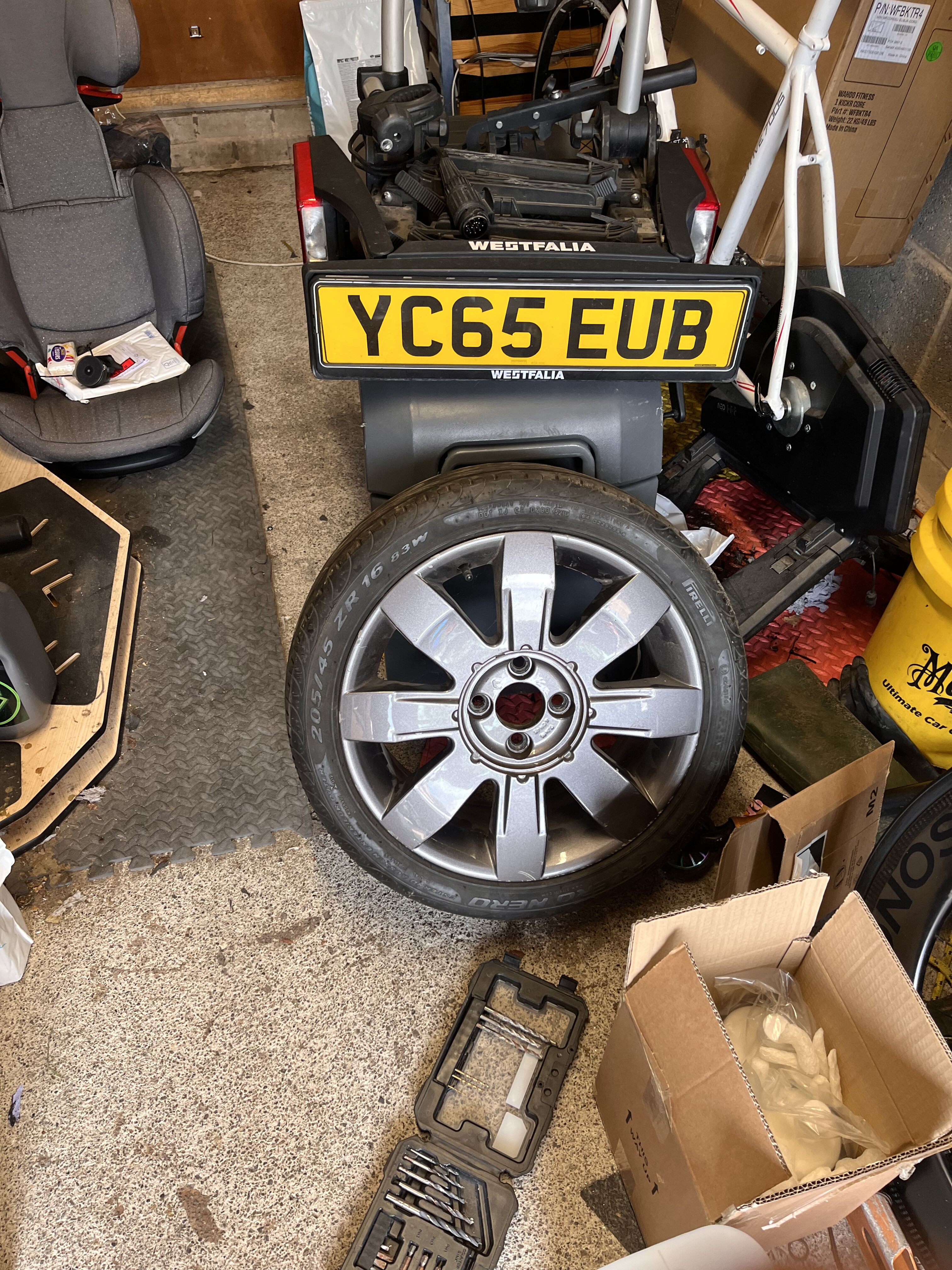

Finally picked up a spare wheel, been looking for a while and as it came with a centre cap and it was close to me I grabbed it, needs some tlc but I’ll get them all done anyway so no bother there, also means I’ll be less worried about driving further as one worry was getting a flat tyre and no way of repairing it.

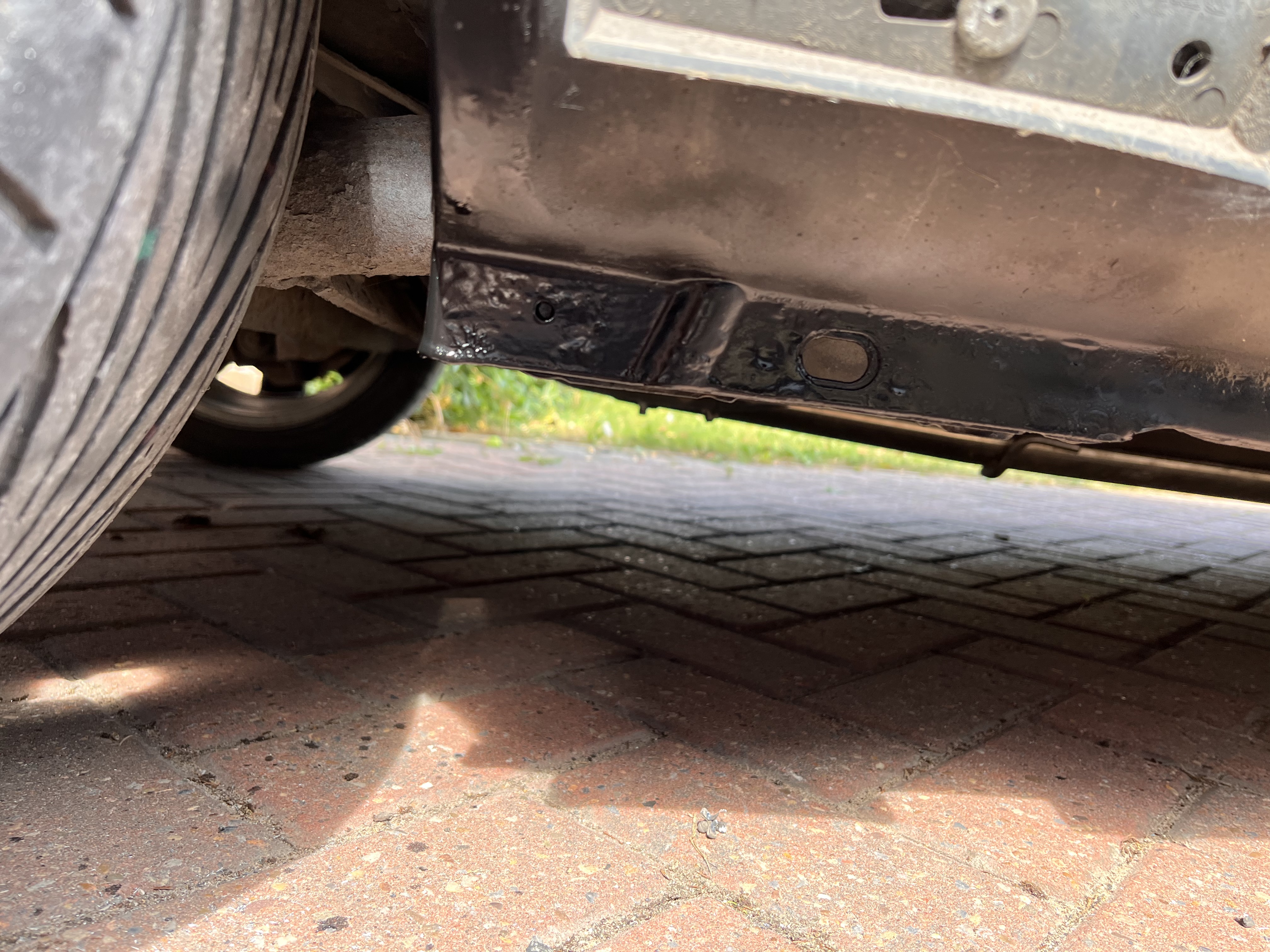

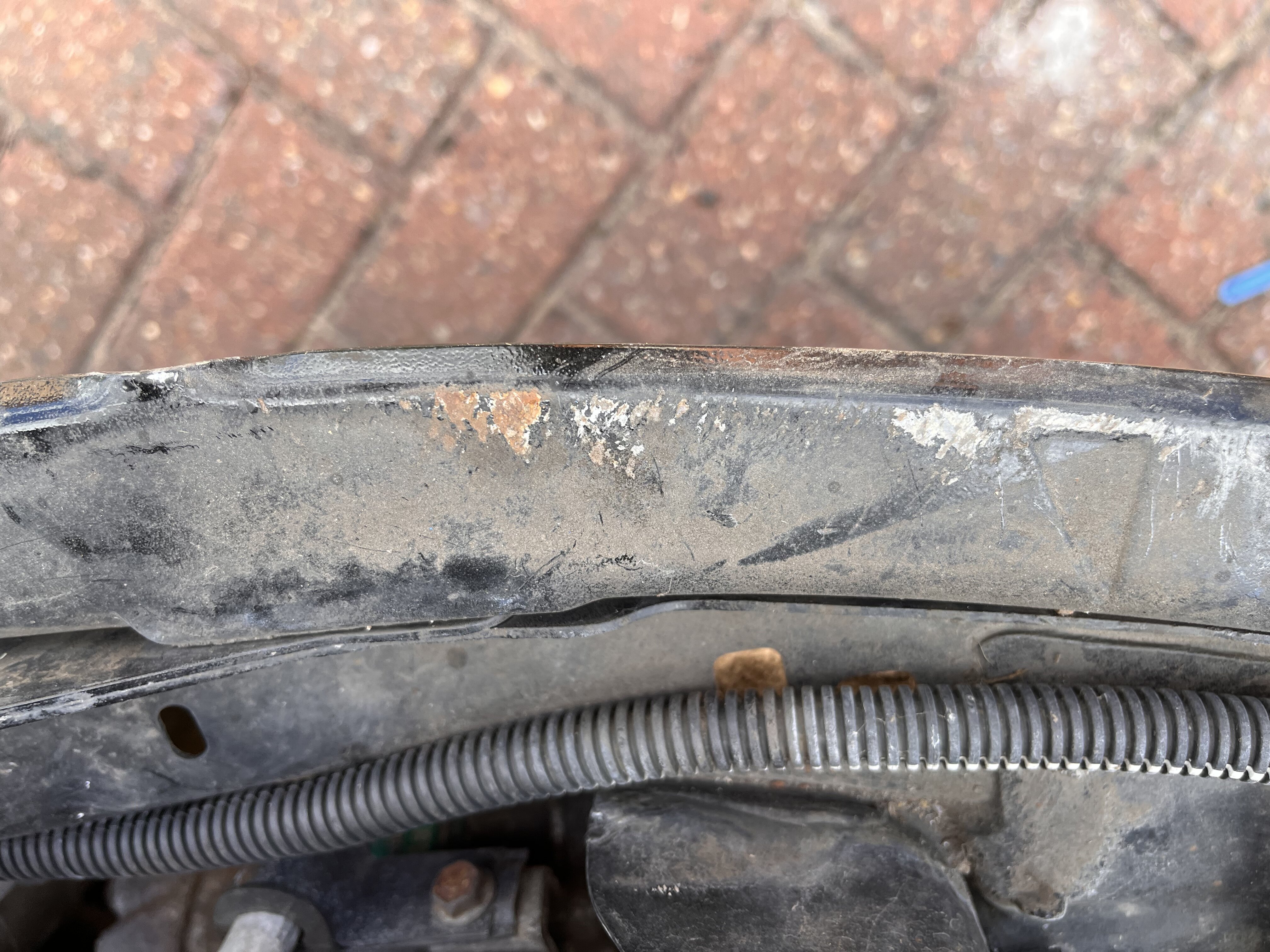

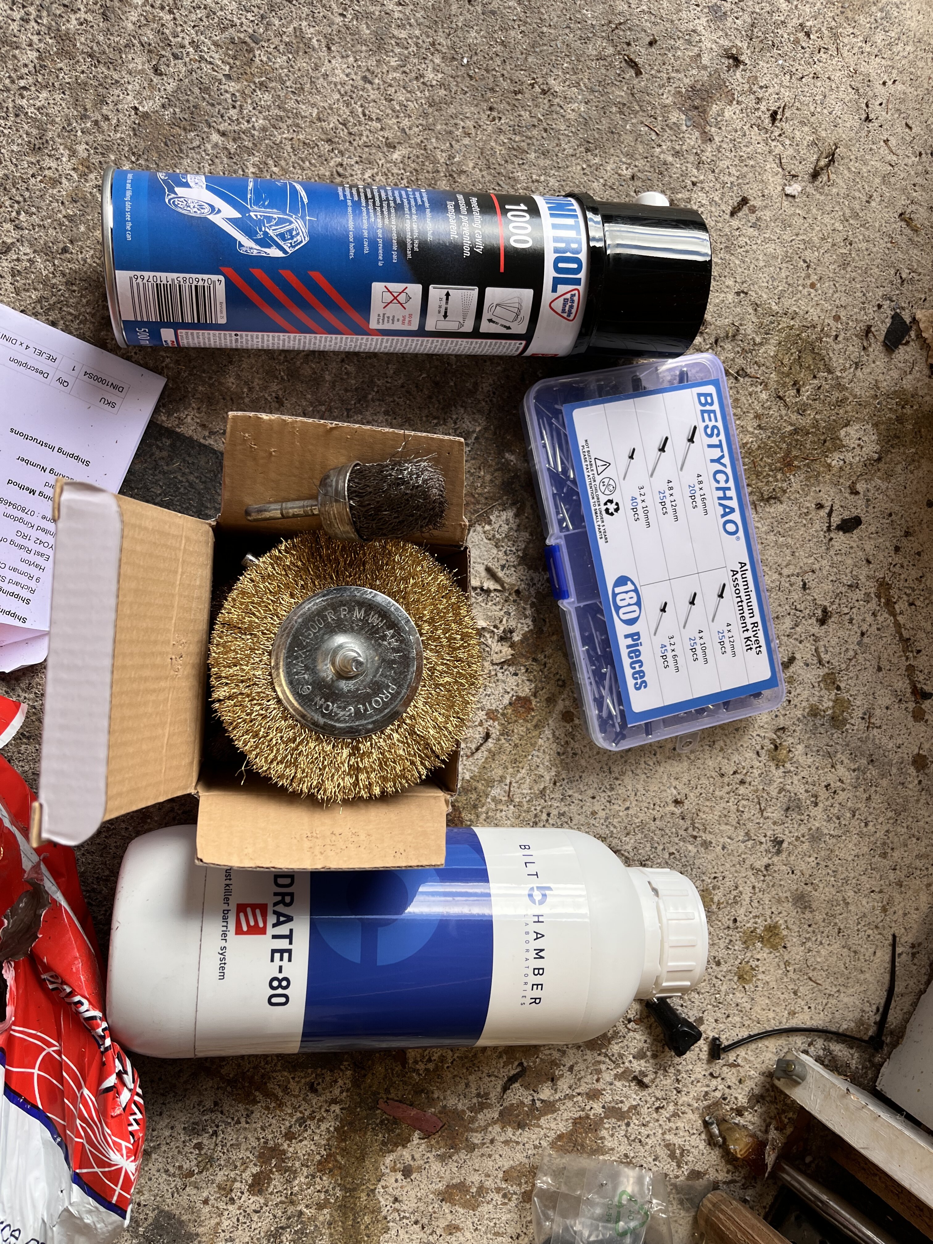

I’ve been waiting on the new wing arriving so I’ve been treating rust and and fixing the front bumper and swapping my intake and steering wheel back in, the latter two I took out when CoPart were collecting the car.
Various parts for treating rust and preventing rust.
So hydrate80, primer and paint.
I thought I’d take photos of the primer phase but I have not, but pretty happy with the result is mainly to slow the corrosion as it’s all hidden so it’s far from perfect but it’s okay.
ive then also taken the wing and splitter off the passenger side to do the same treatment, to be fair there’s very little rust behind the bracket and a small amount at the jacking point so it seems pretty solid.

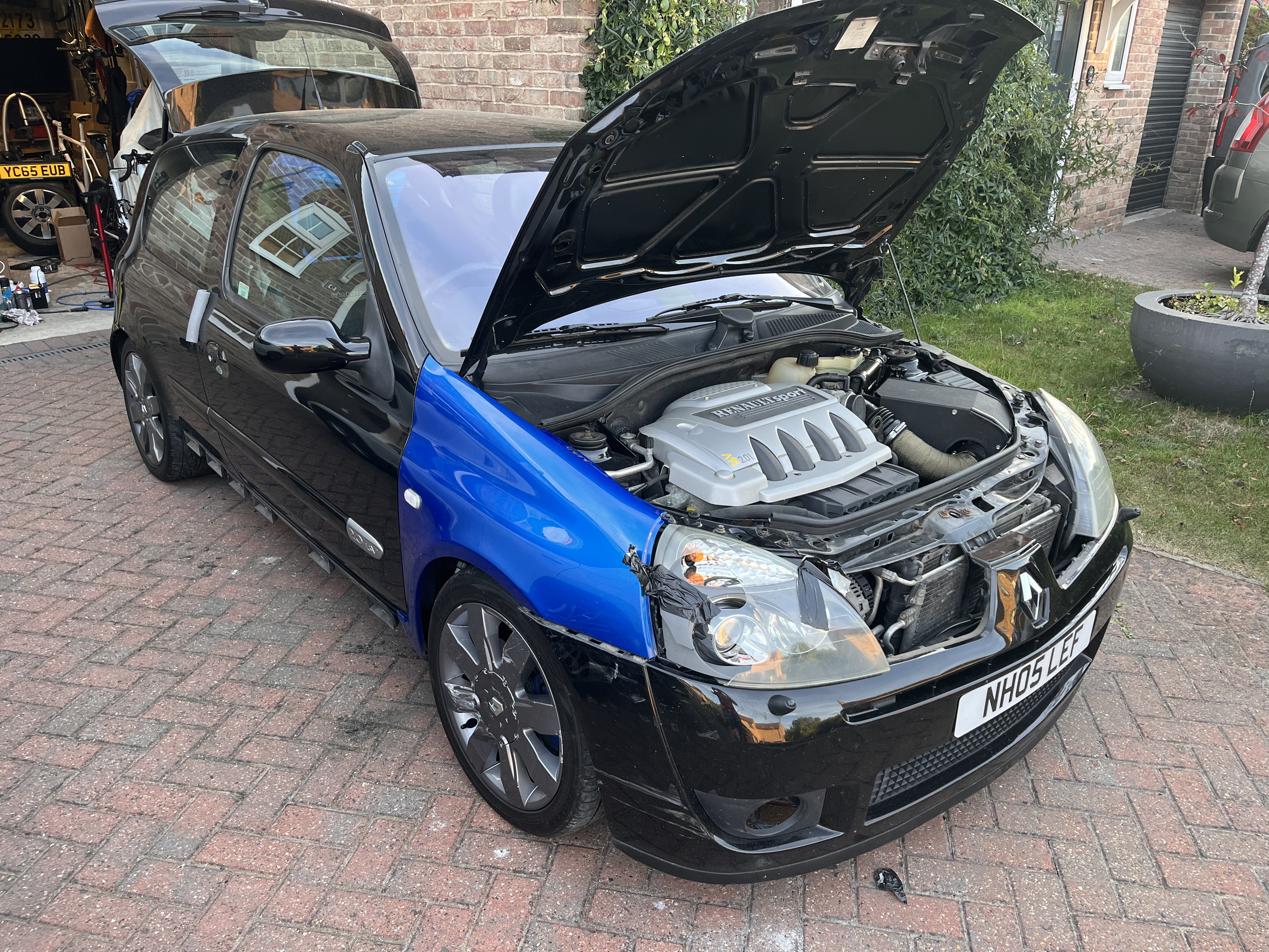

after unwrapping I’d hoped for a c63 amg son image my disappointment when it was the wing I’d bought.
still fitted and more small bits of progress. Got sort out the panel gaps but it’s in good condition and much better than the old one.

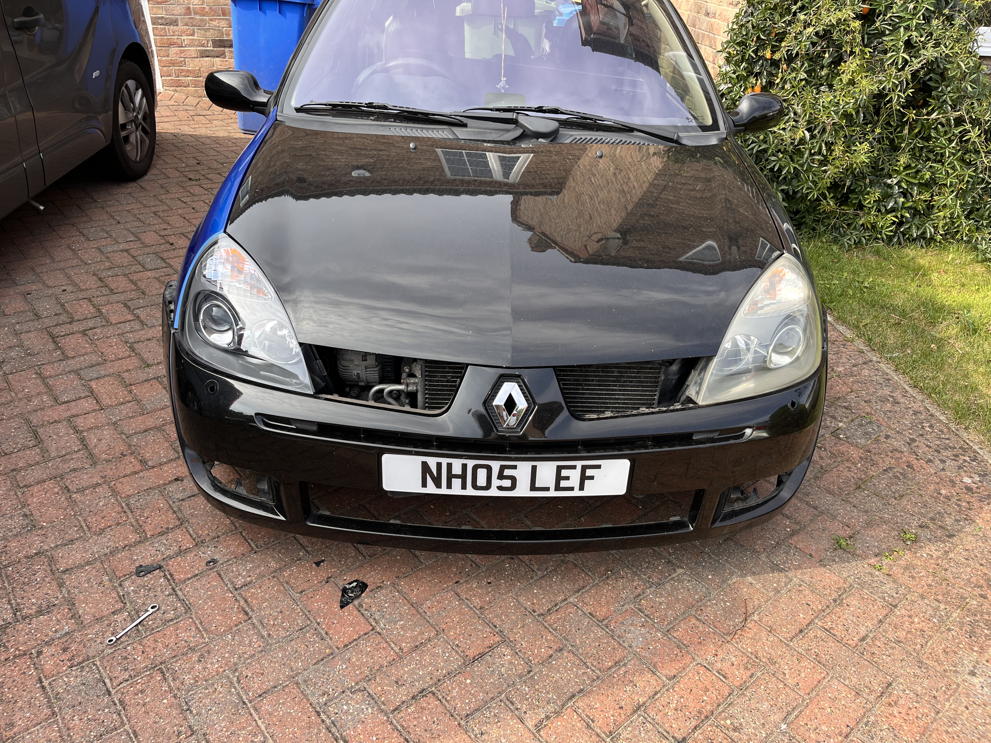

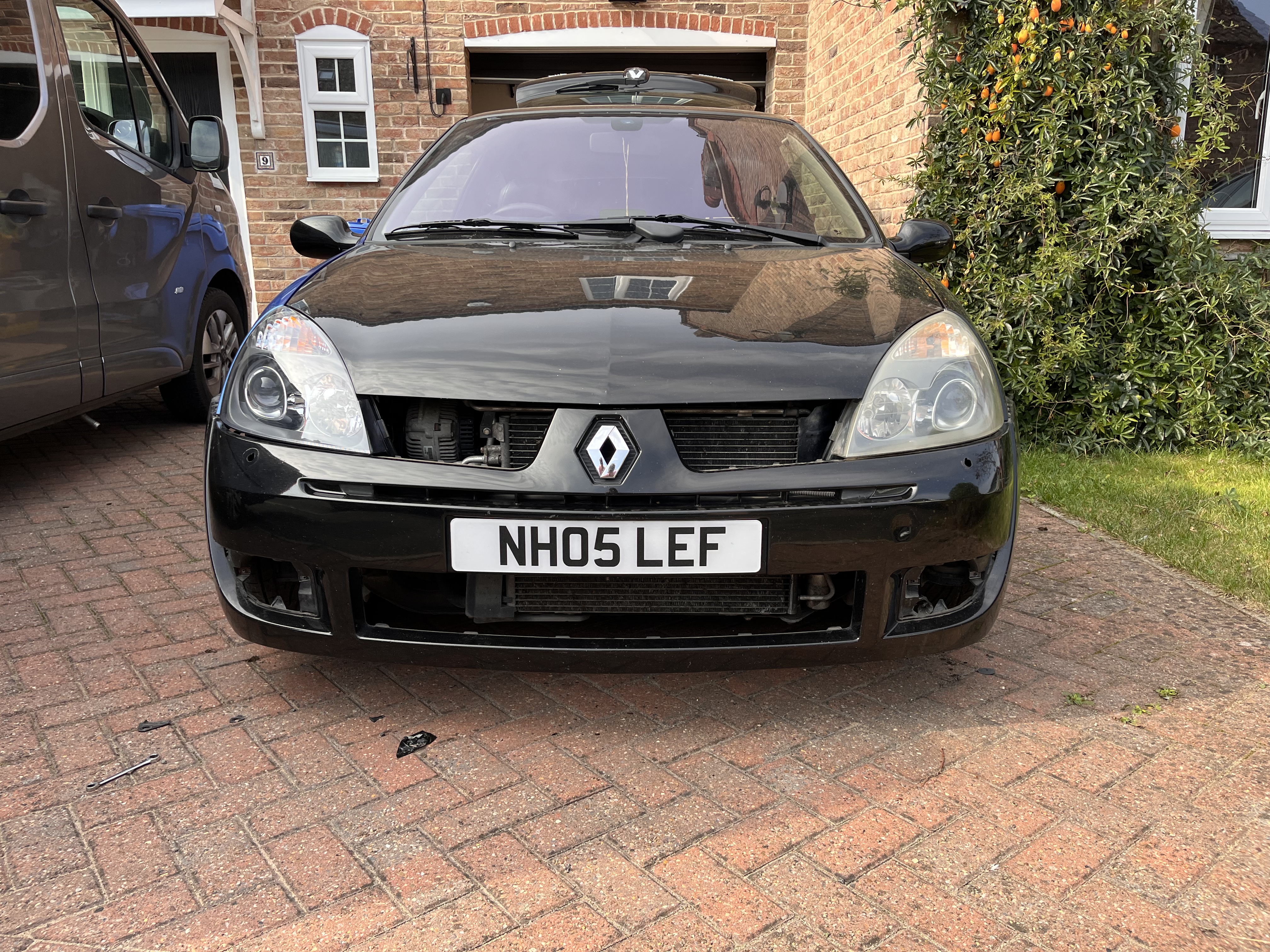

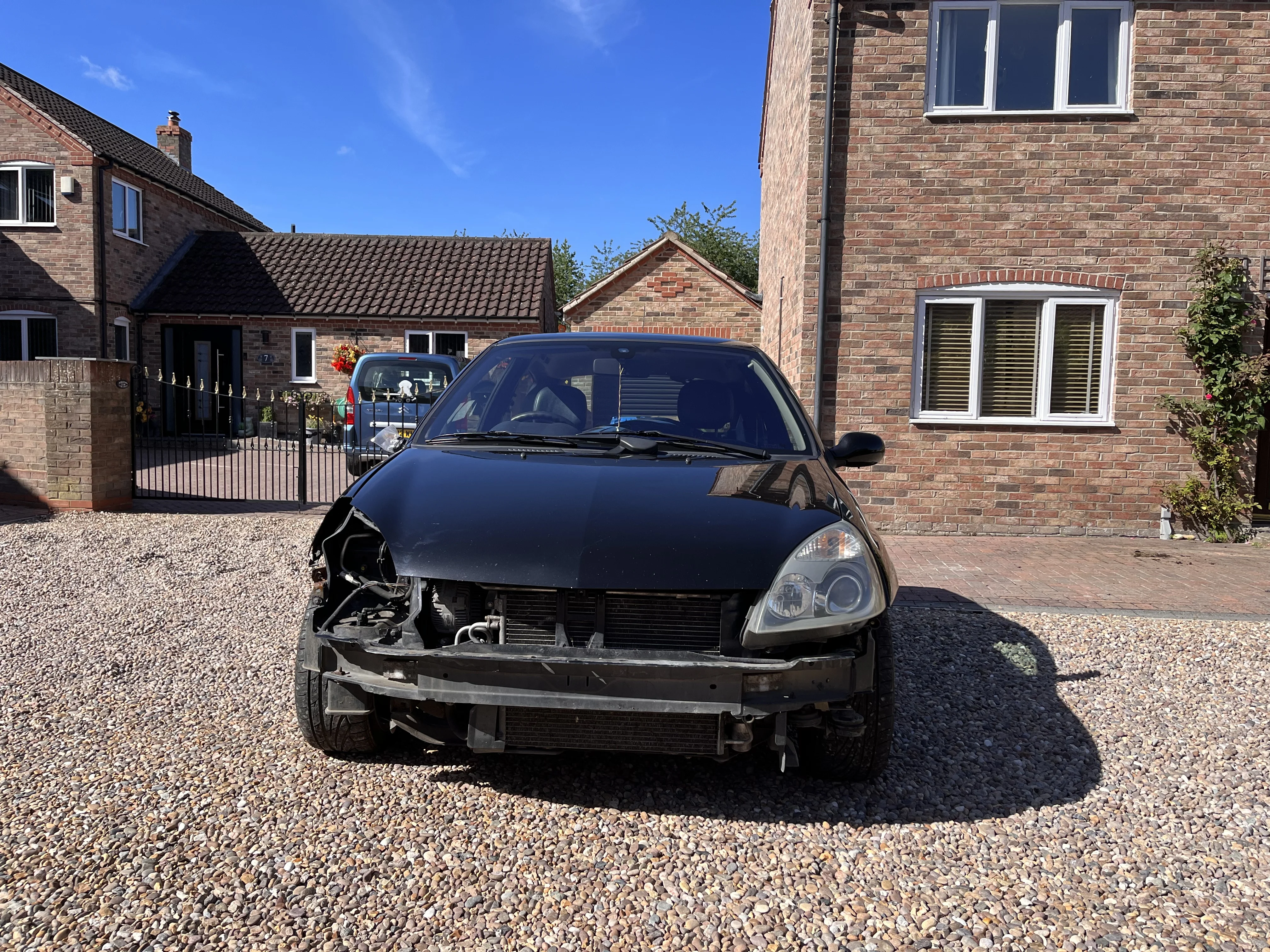

Back from holiday and straight on with the car… new Hella headlights as you can’t match old and new despite how hard you try, also good to see both lights still work.

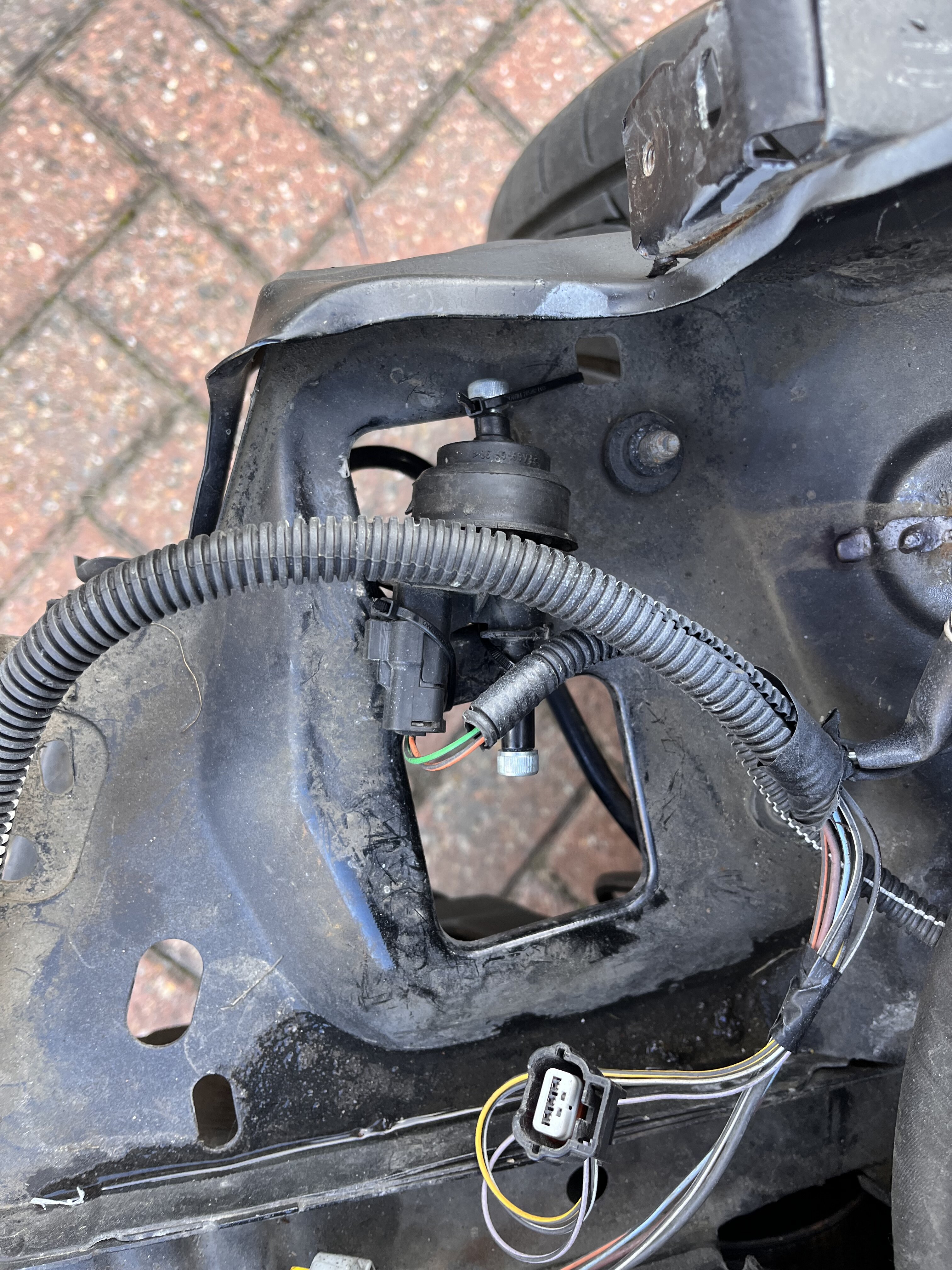

had to remove the offside One after fitting as I hadn’t connected the levelling servo properly but that aside it was a pretty straightforward process.

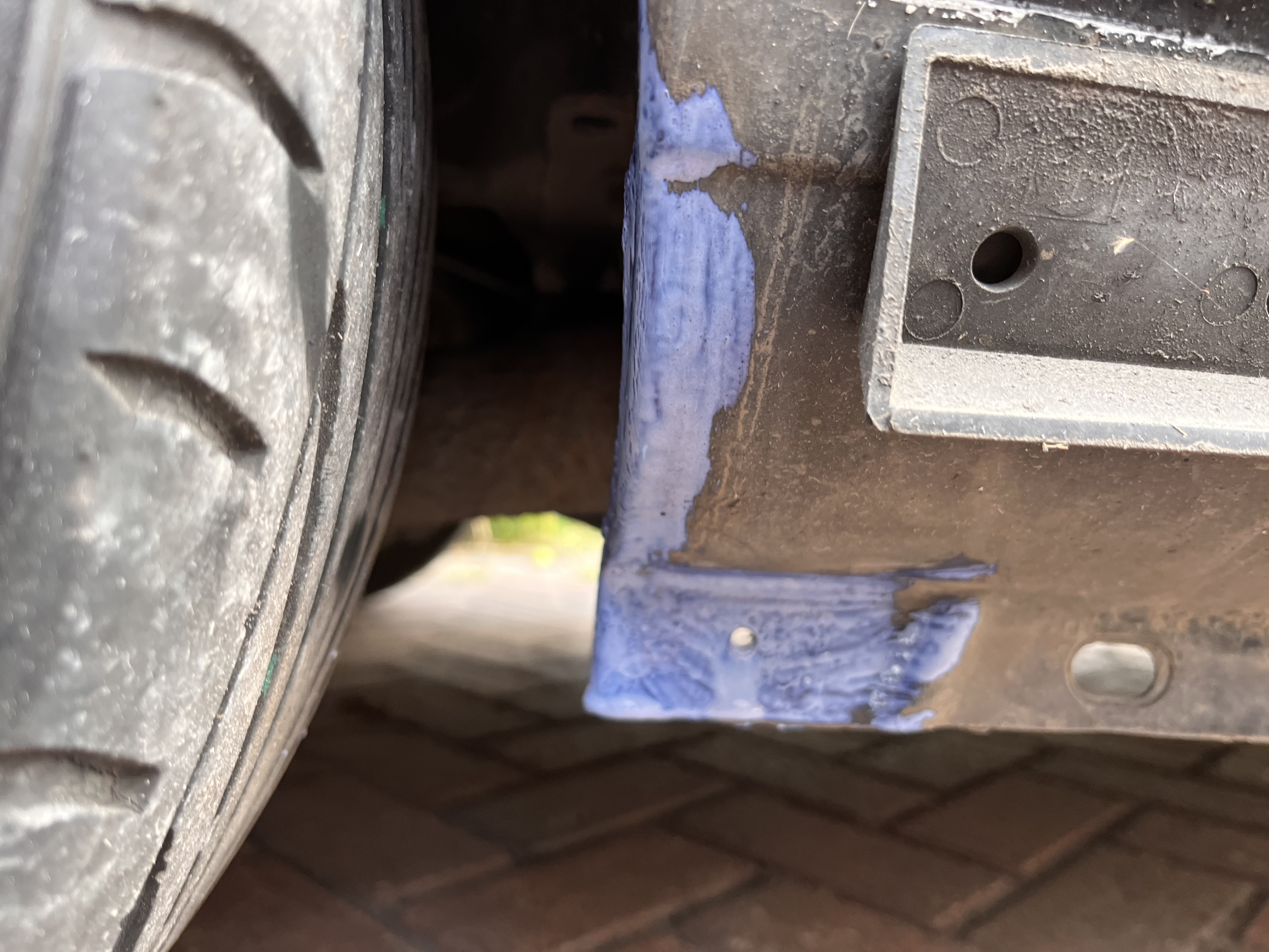

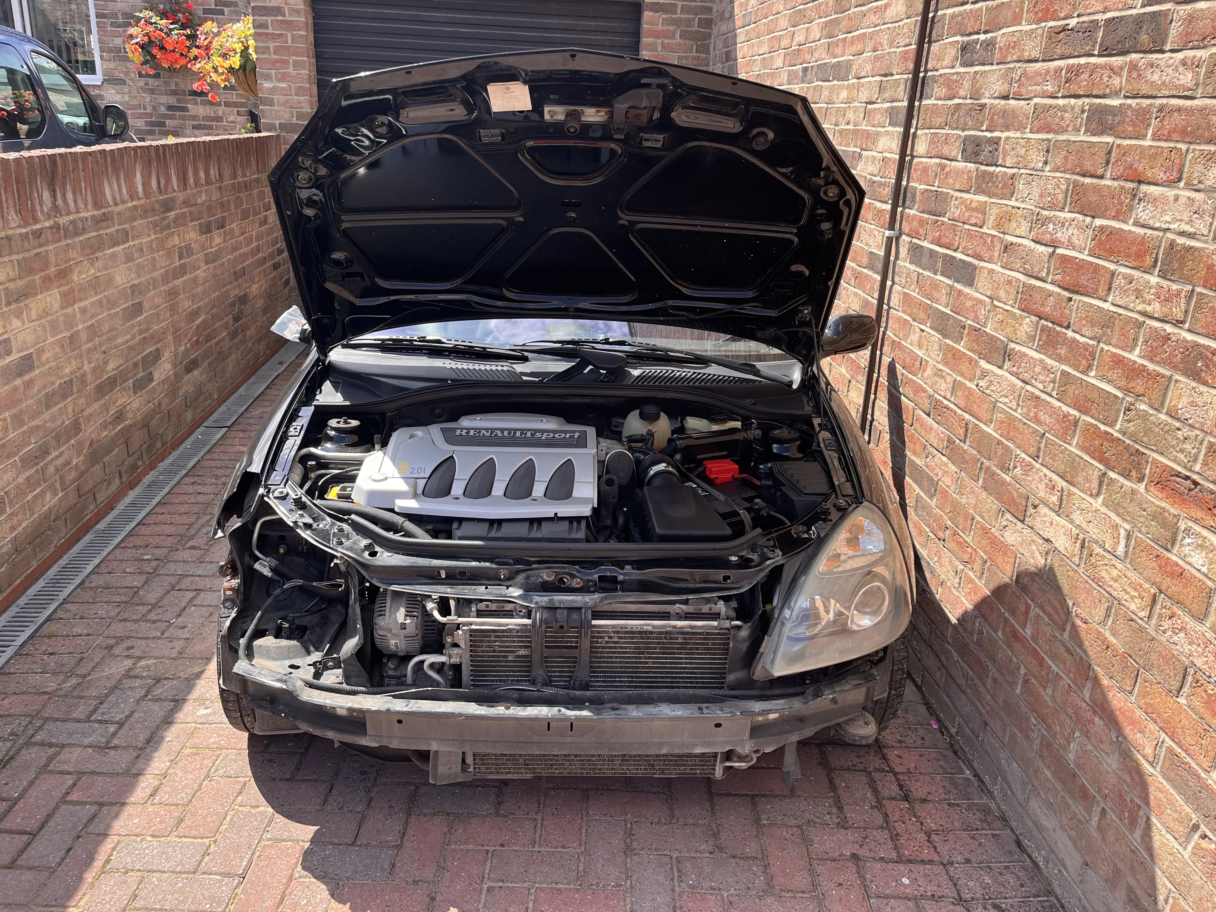

So all that’s left now is the bumper and wing repair and spray and wheel refurb to get it back on the road.

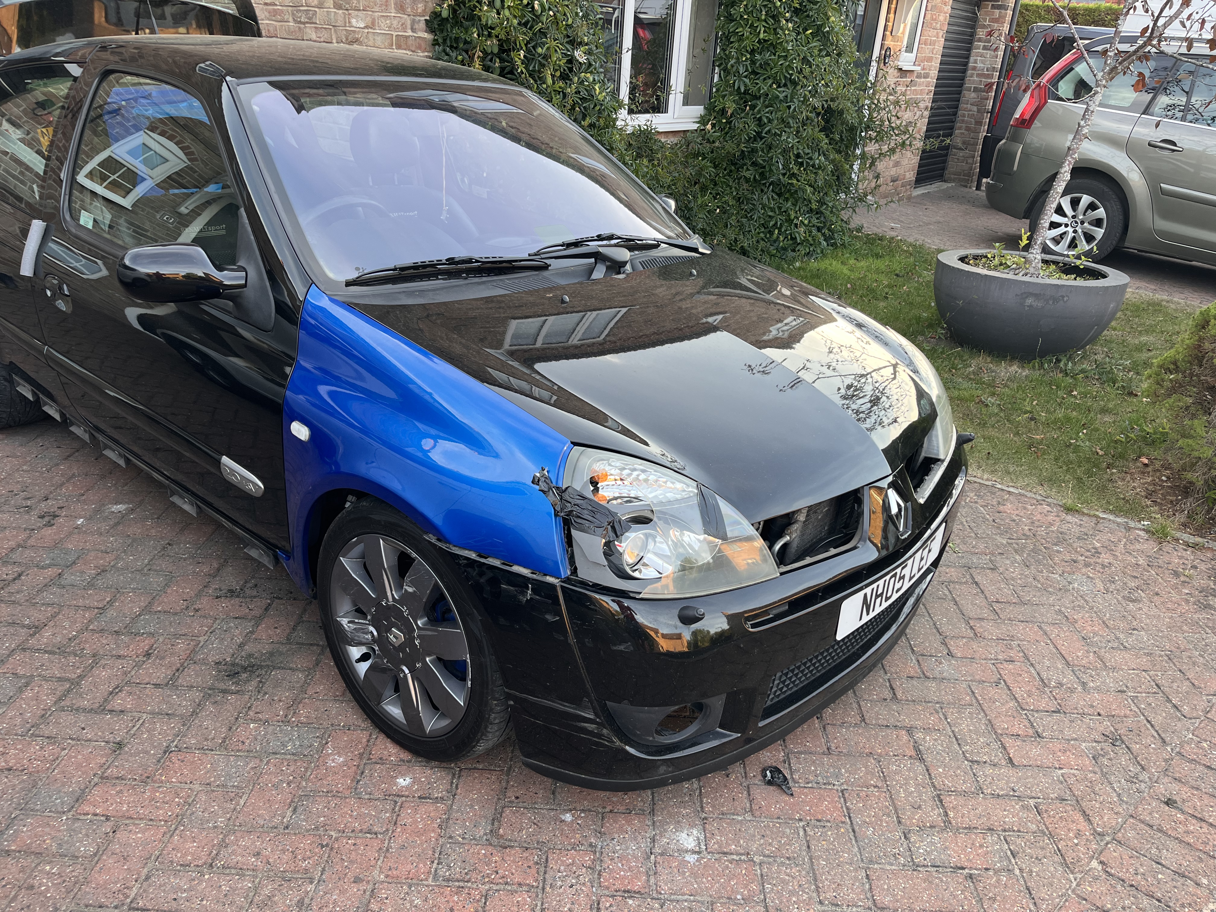

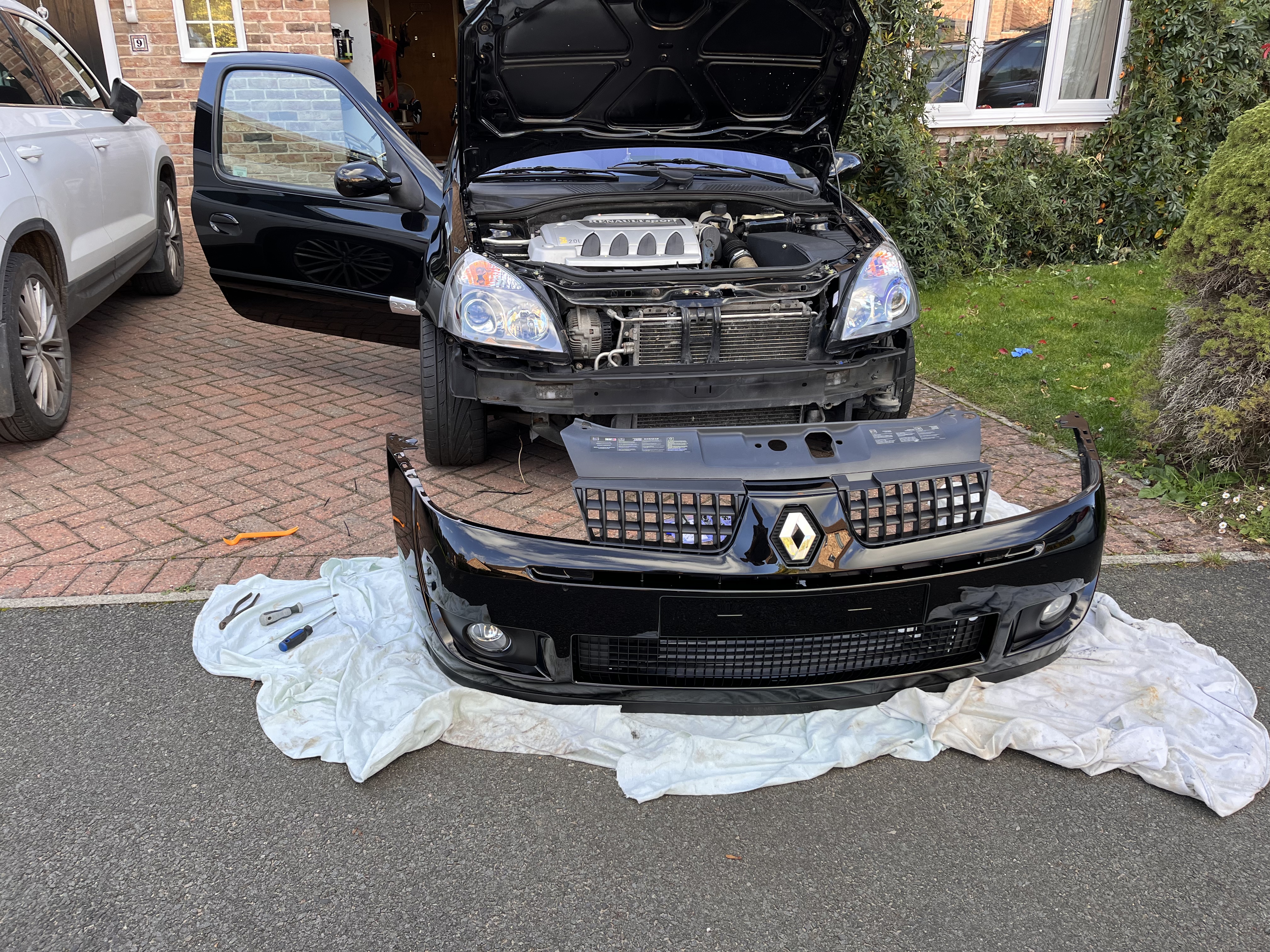

A bit of a half arsed update tbh. 🤣 had a couple of hours after work and my painter was coming round to take a photo with his magic paint camera to do a card to see the match as that will decide how much blending (if any) is needed.

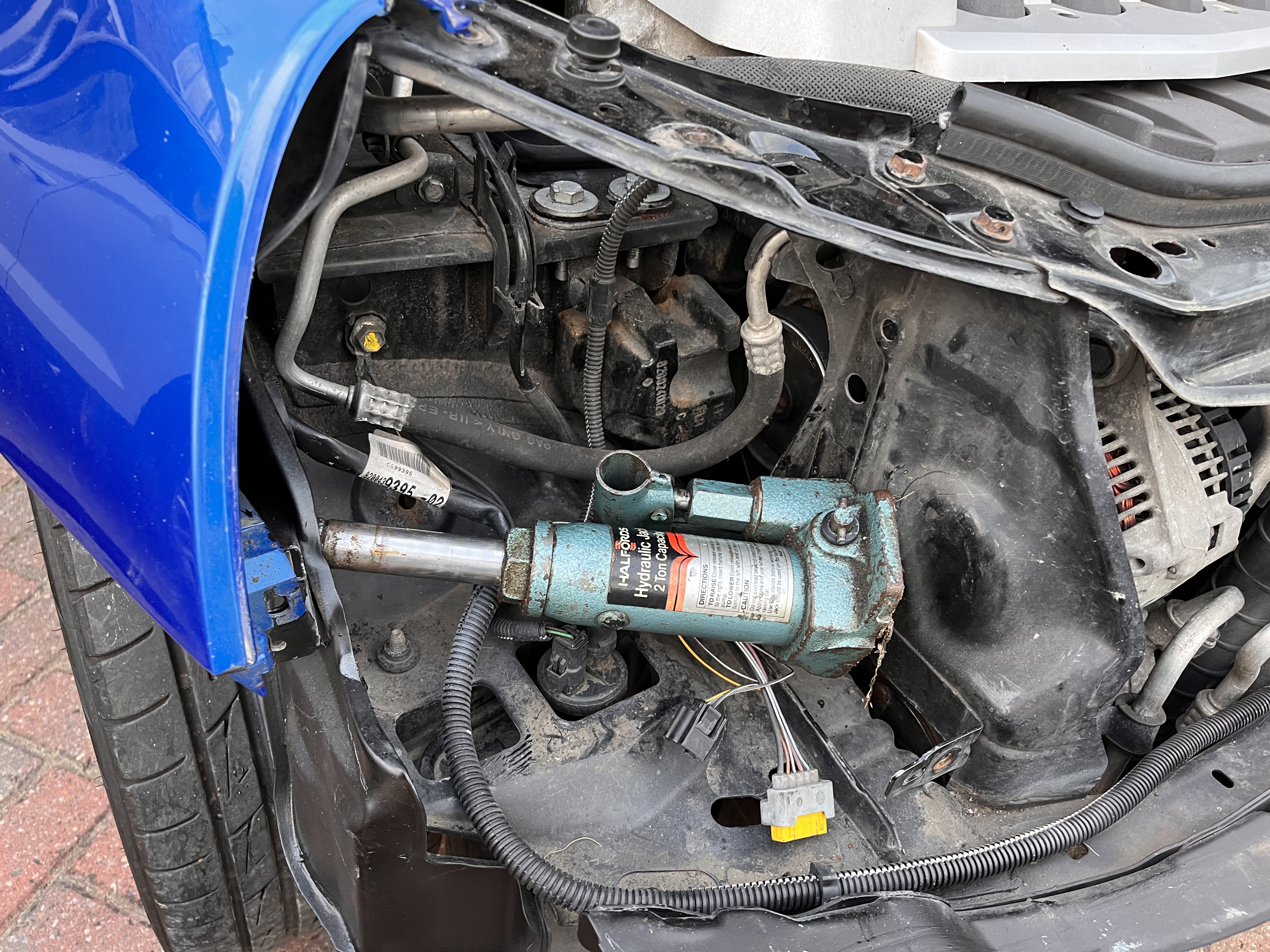

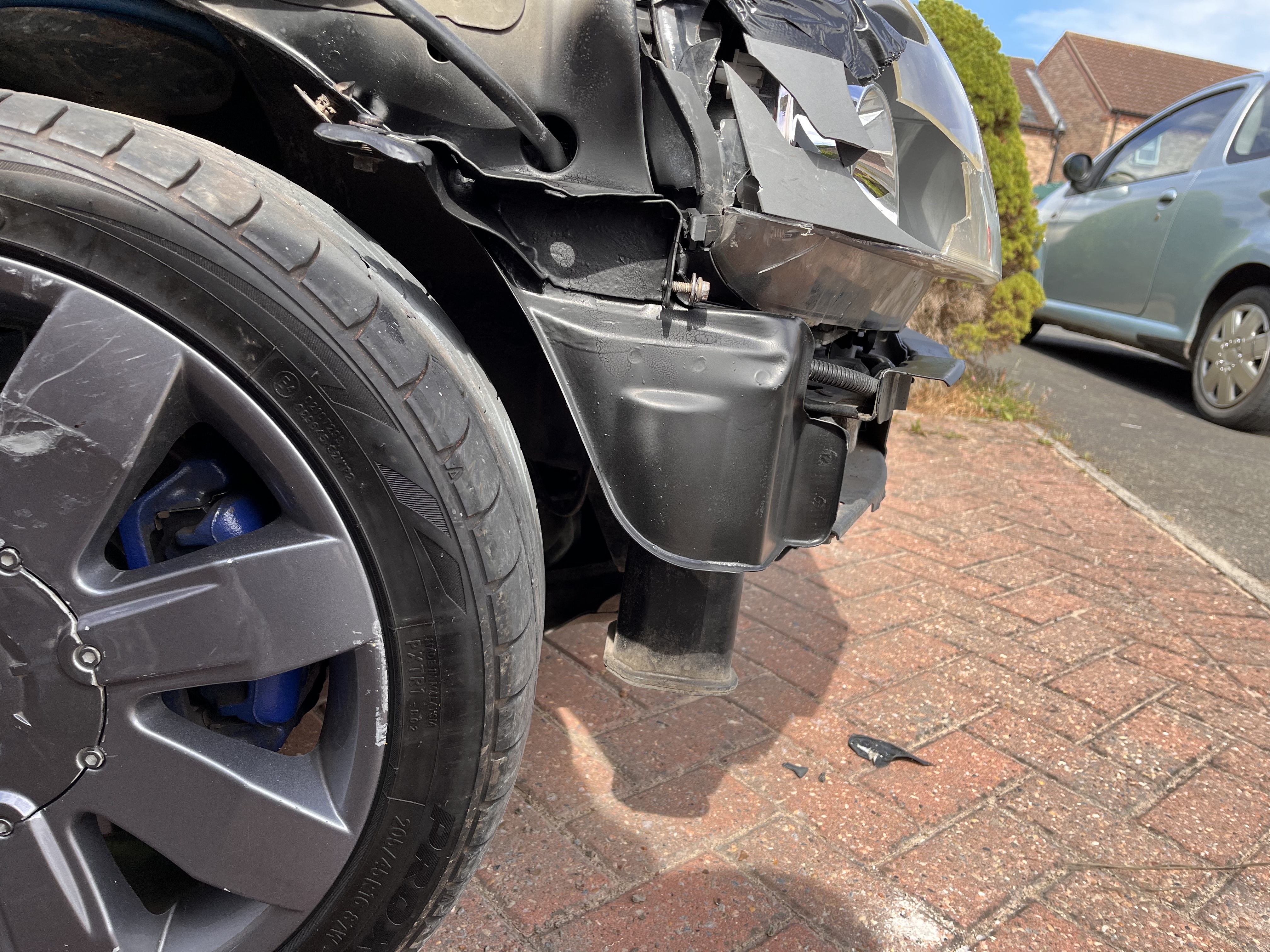

It turns out the front of the car was a little more bent than I’d appreciated and needed some gentle realignment so I grabbed the bottle jack that I’ve had for most of my life and the trusty device served me well again and straightened the panel out, basically the lugs on the headlight wouldn’t line up so it didn’t sit quite right, that’s now sorted.
Honestly had that jack so long now, it was my dads before mine and a Halfords special. Seals are a hit leaky but still just about works.

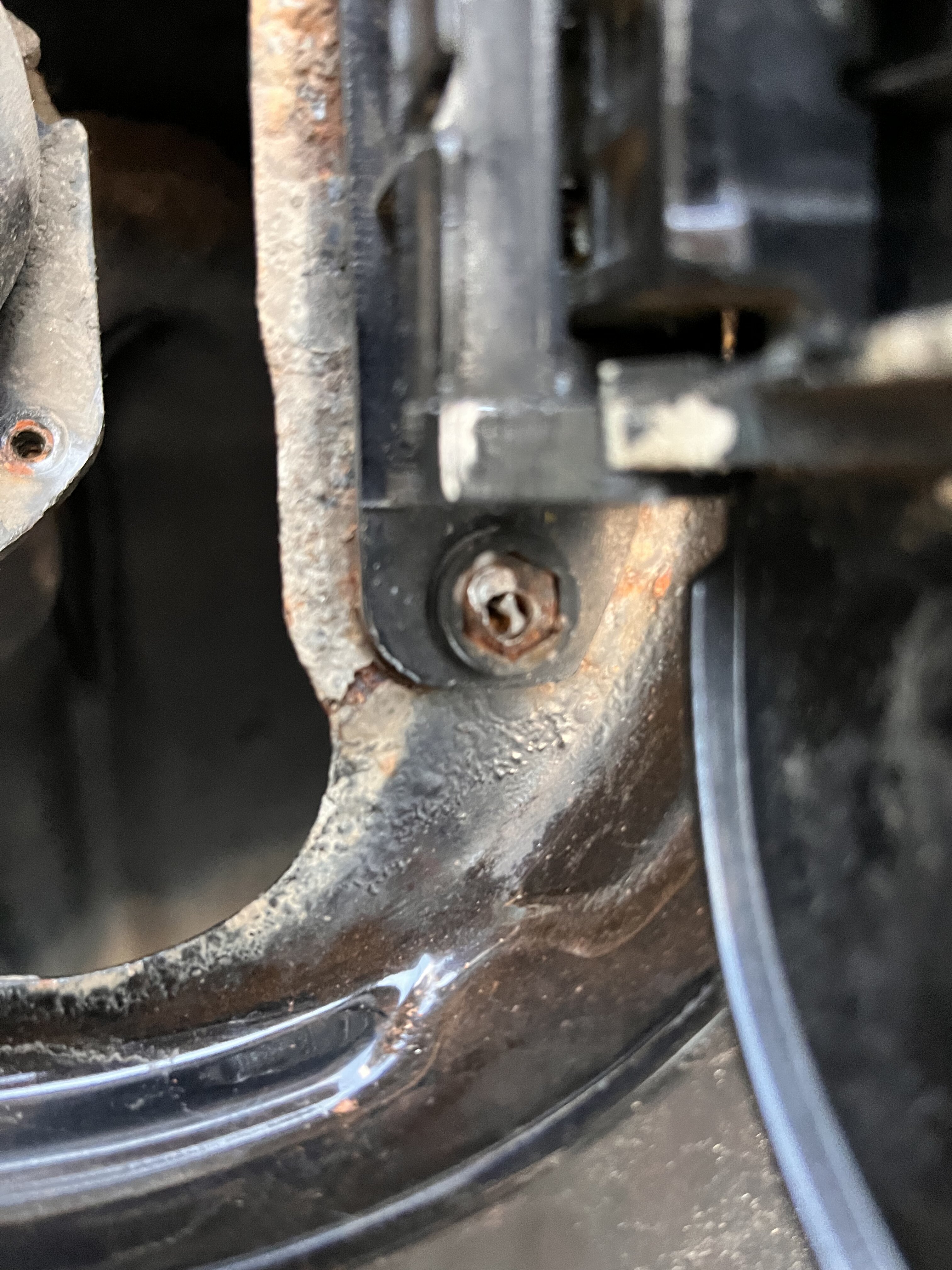

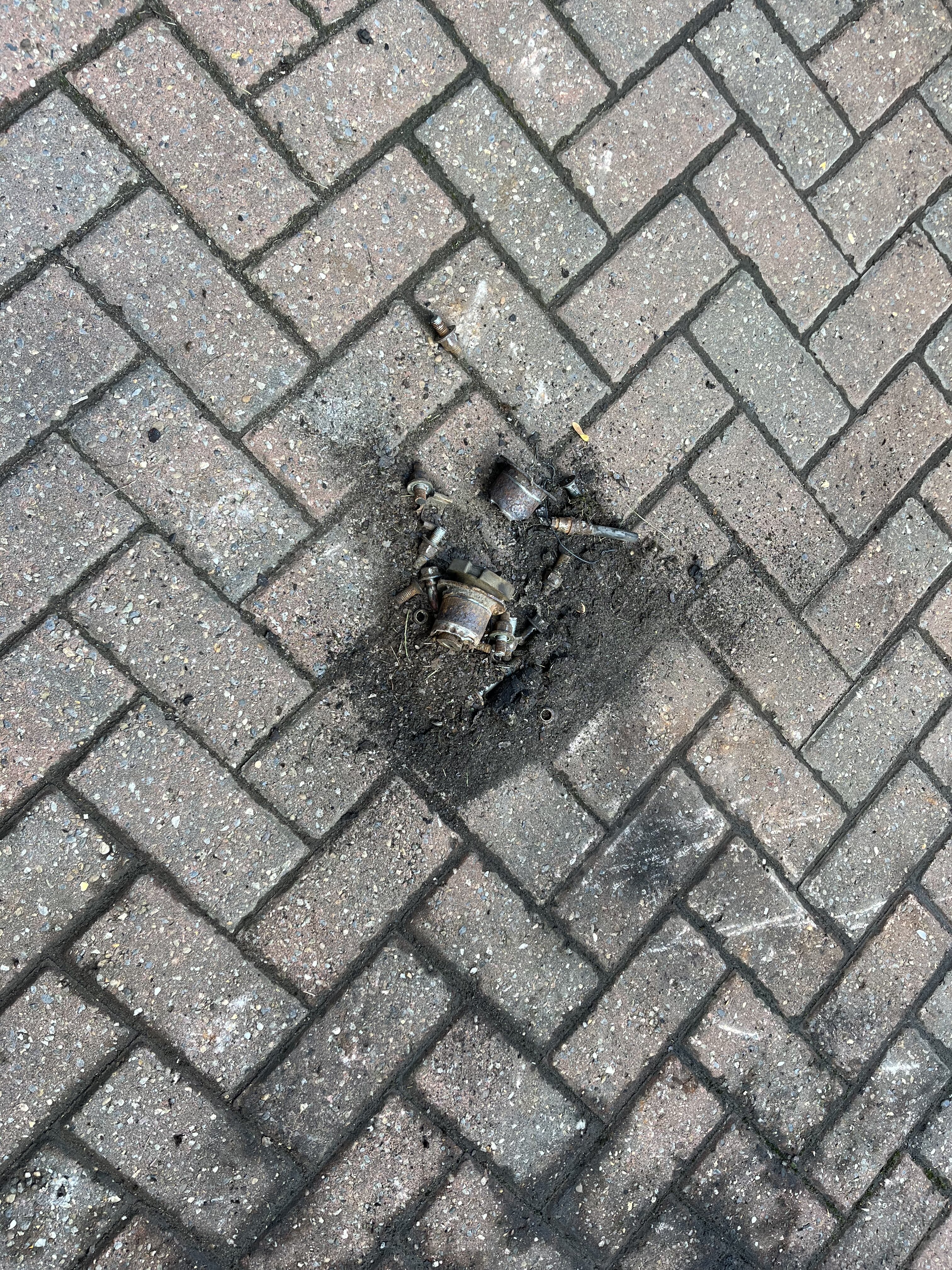

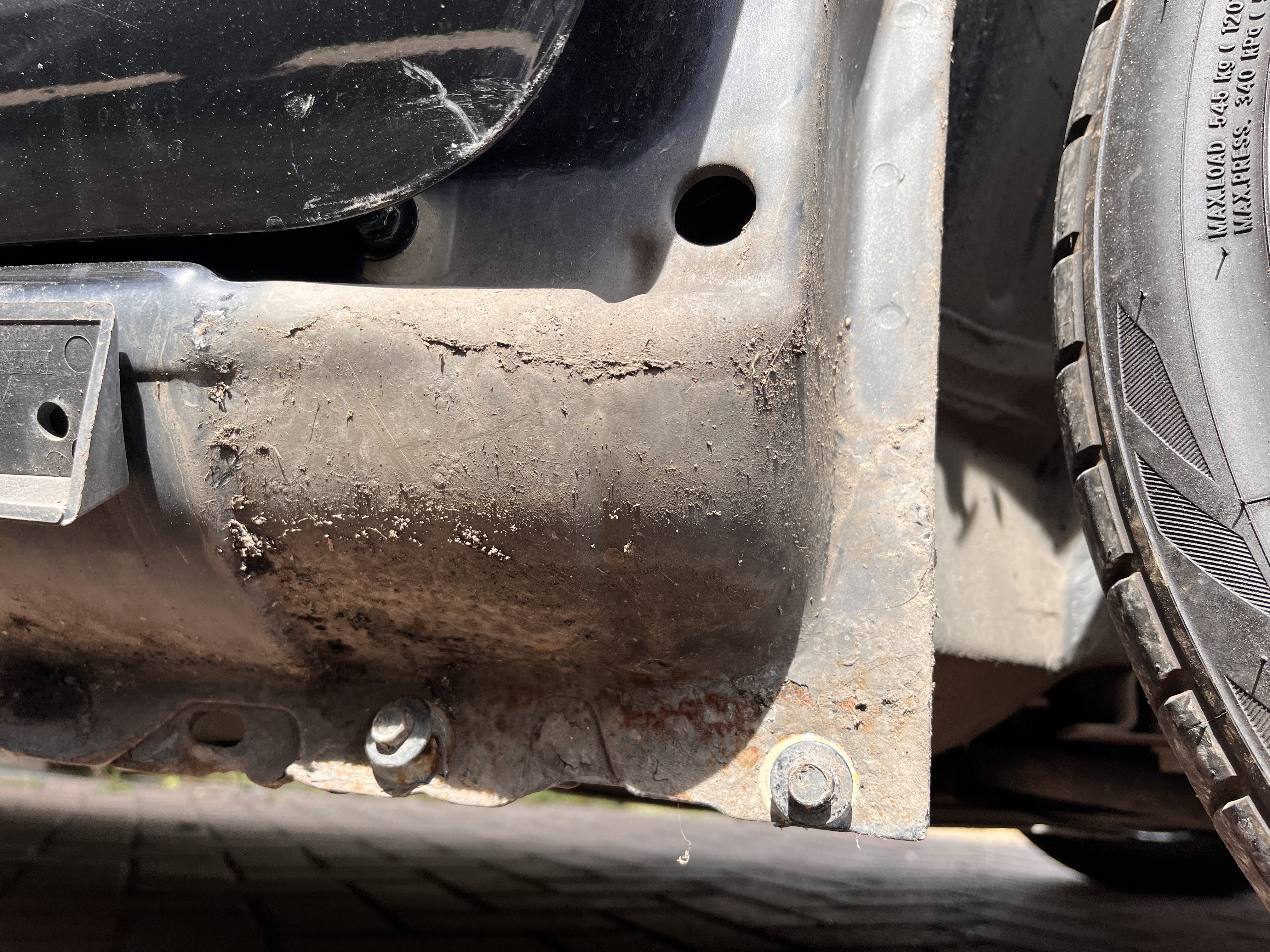

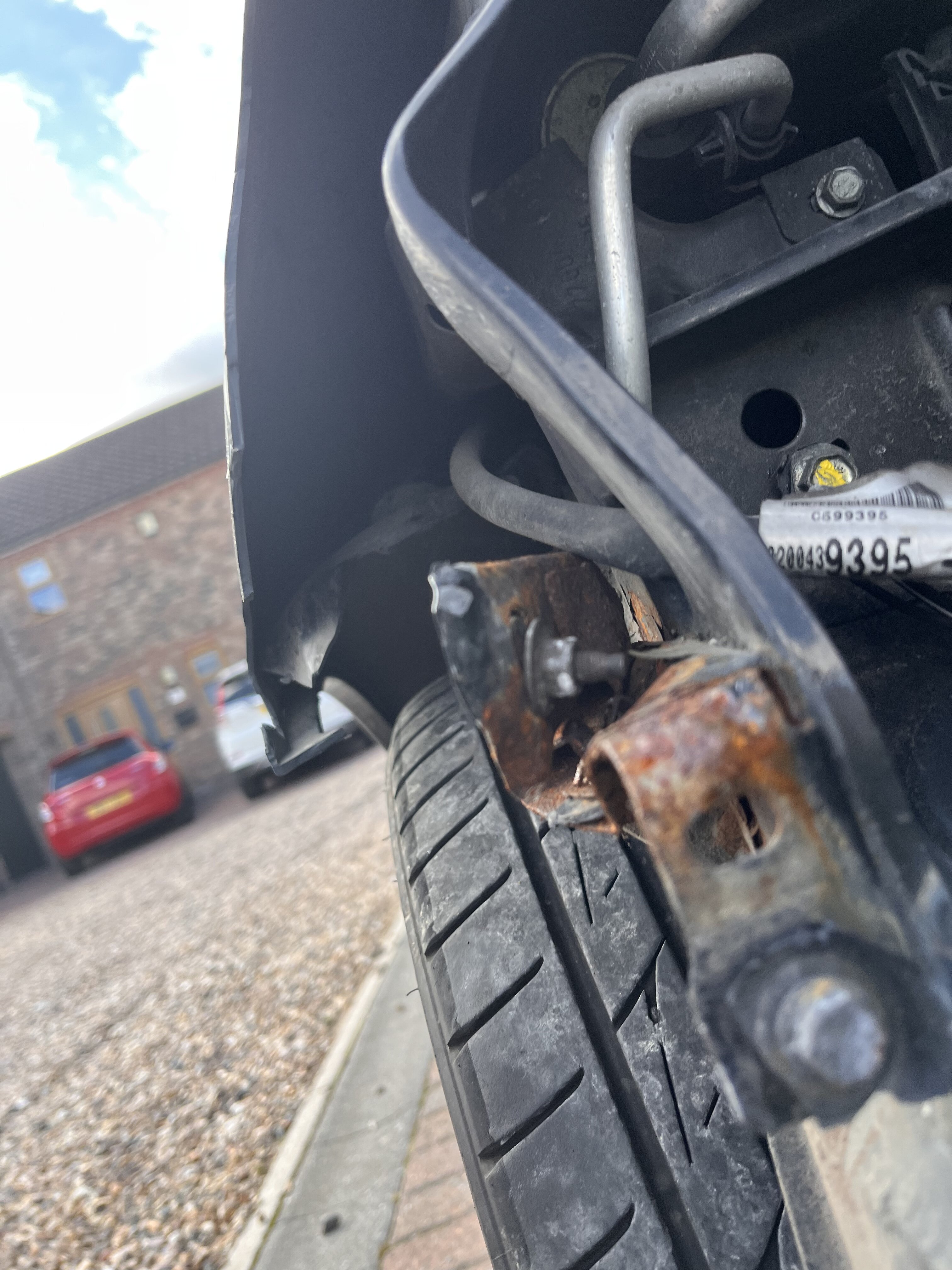

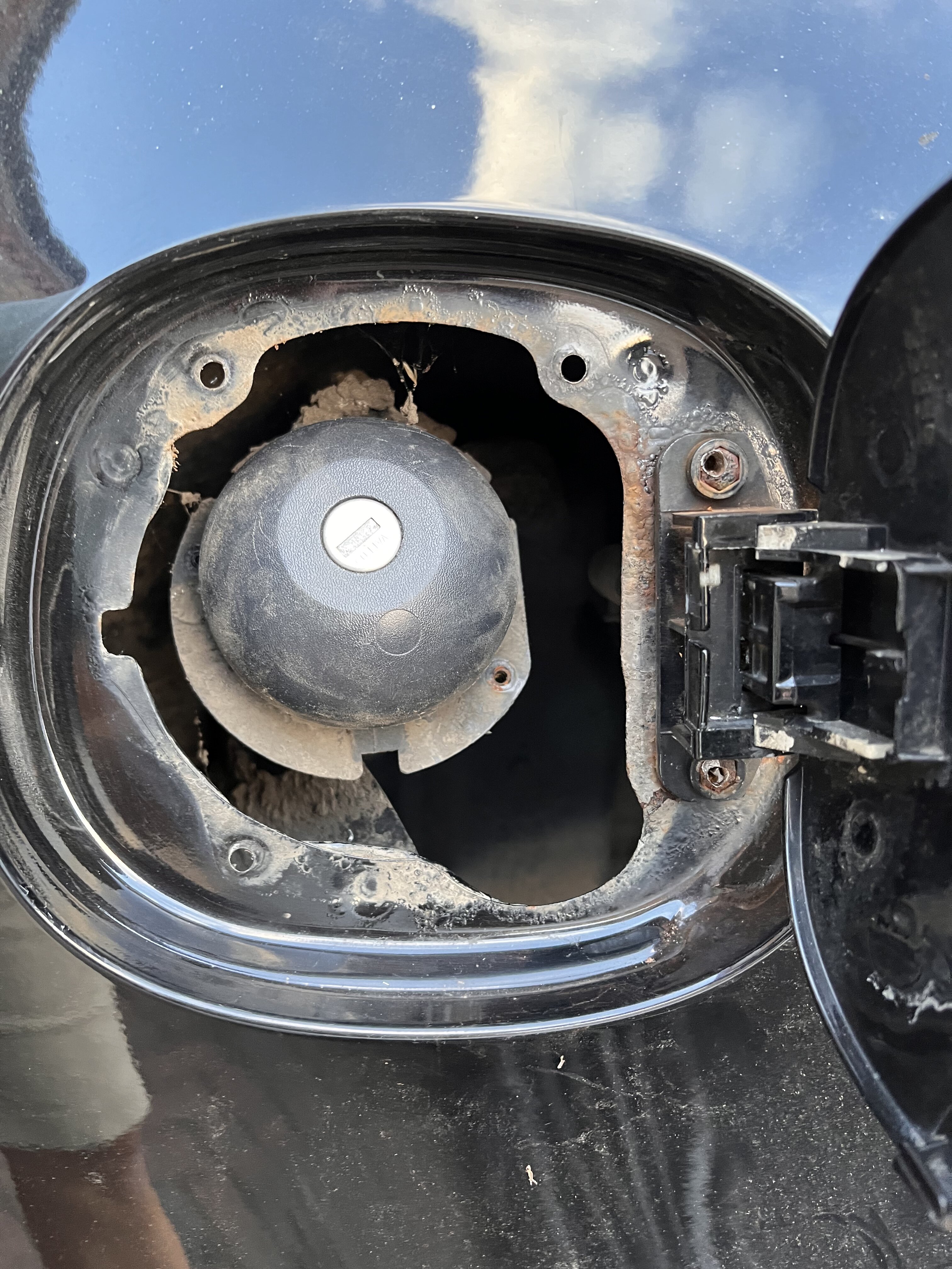

Next I set about the rust around the fuel cap, immediately rounding off the bolts and needing the drill them out.

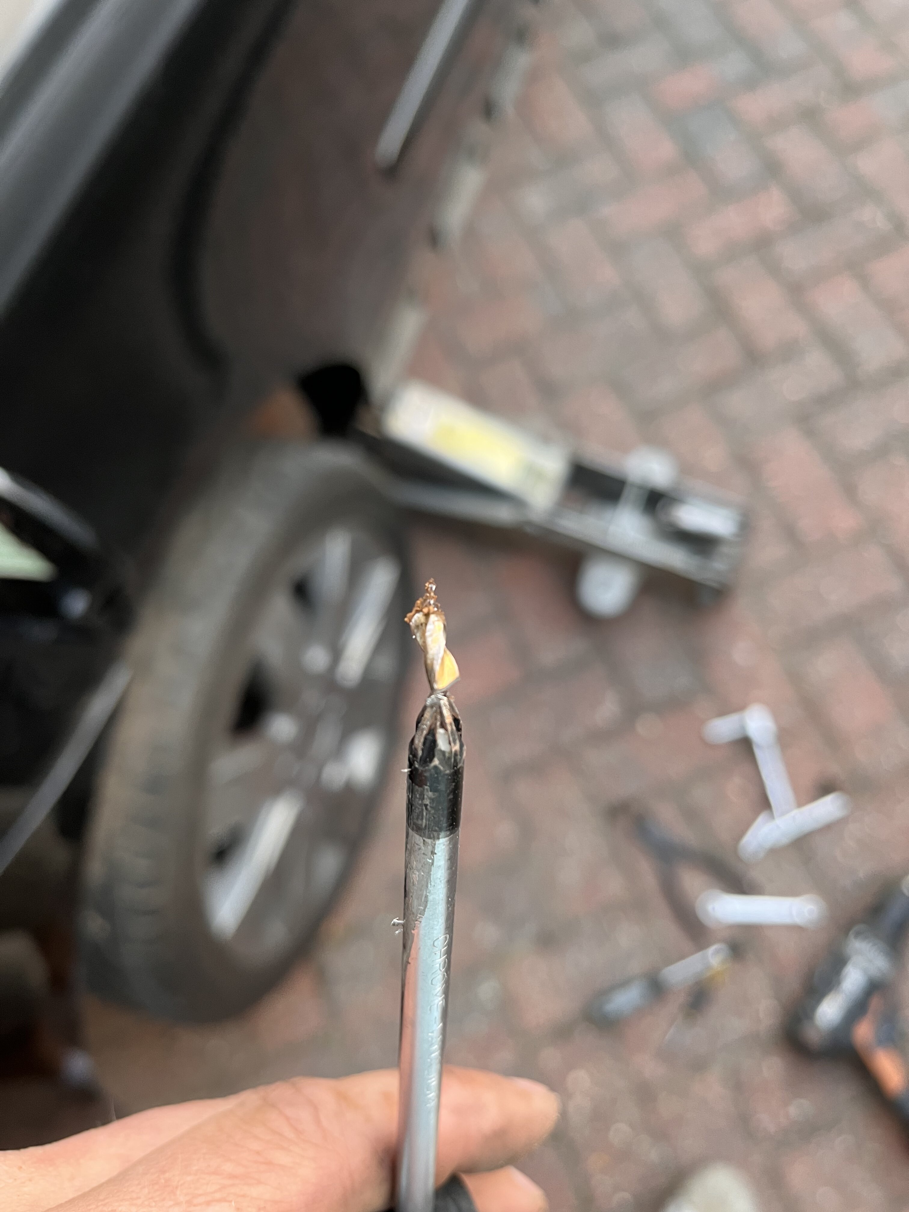

after making a good start my Amazon special drill bit snapped… oh the joys…
however on this occasion I was saved by a magnetic screwdriver, how rare is that! Normally it’s impossible to do anything about that situation.

So hopefully the wing and bumper will go in this week and I’ll get them back over the next week or so and can start getting it back together.
My friend came over and scanned the paint to get a good match but interestingly it matched best to GNE and not 267. We are going with 267 on a spray out card. Still hoping to just be able to paint the bumper and the wing and it not look terrible, I do intend to get some other work done in due course but just can't merit the spend right now so trying to keep the cost under control a bit!

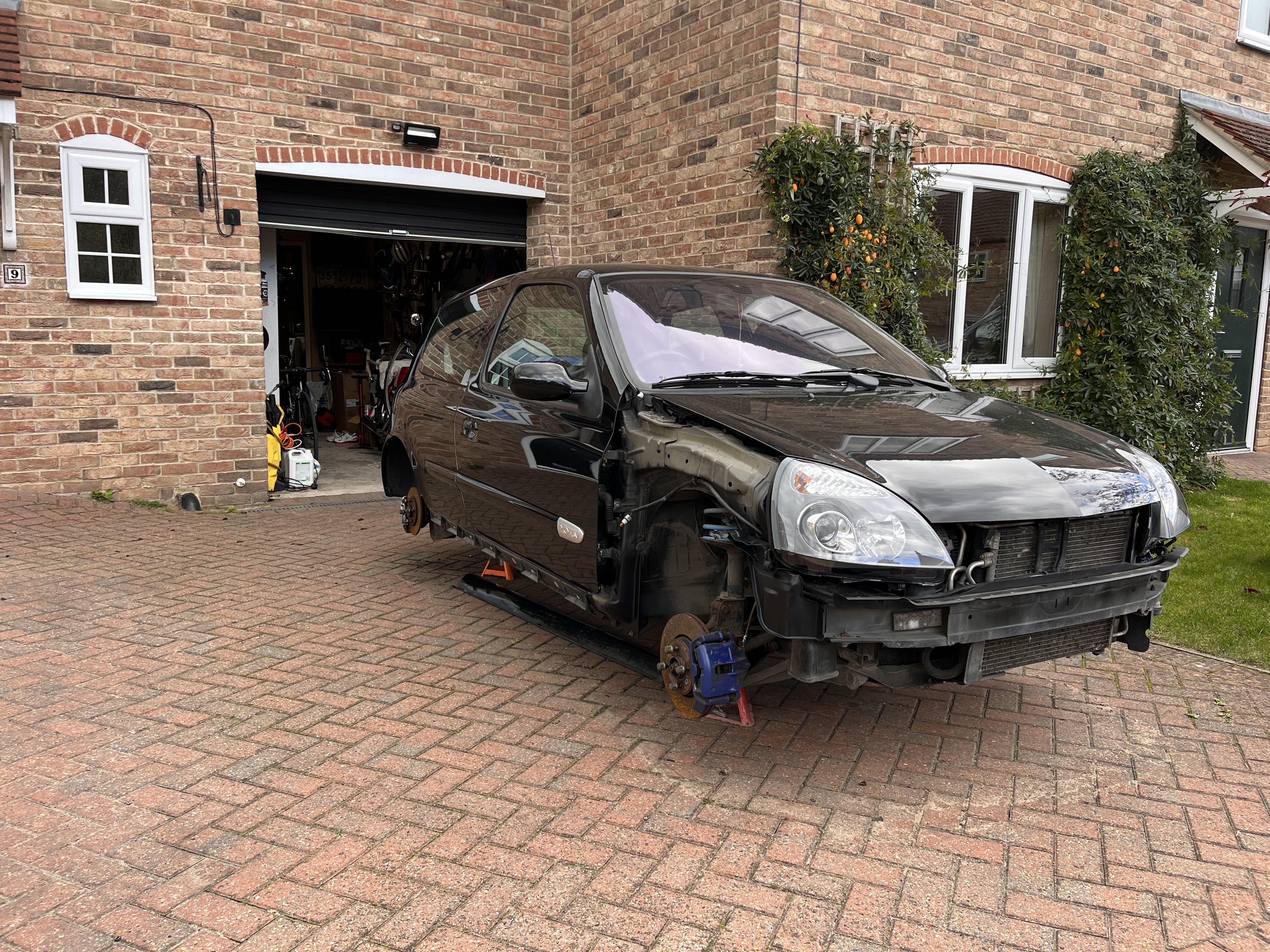

Something resembling progress has been made although the car looks less complete than ever.

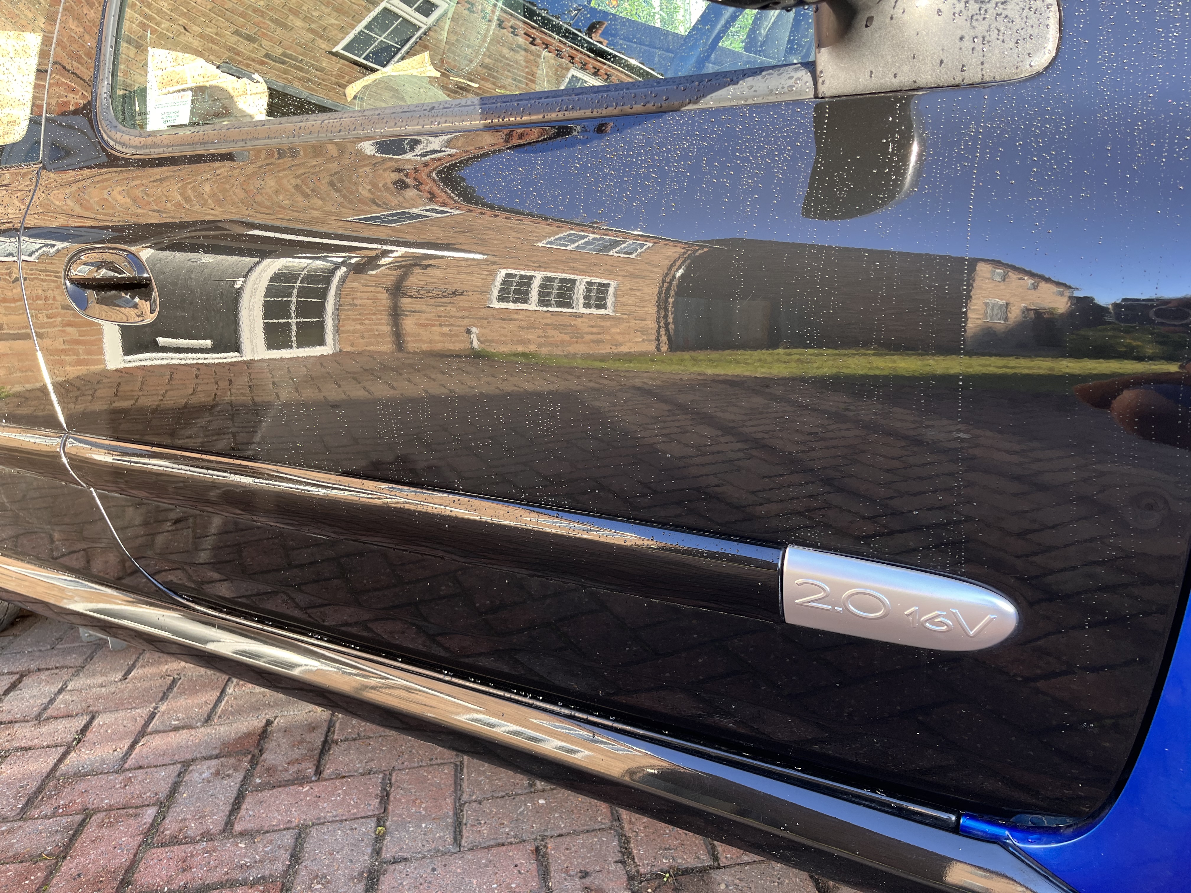

I finished painting a few things and sorted some of the rusty areas.

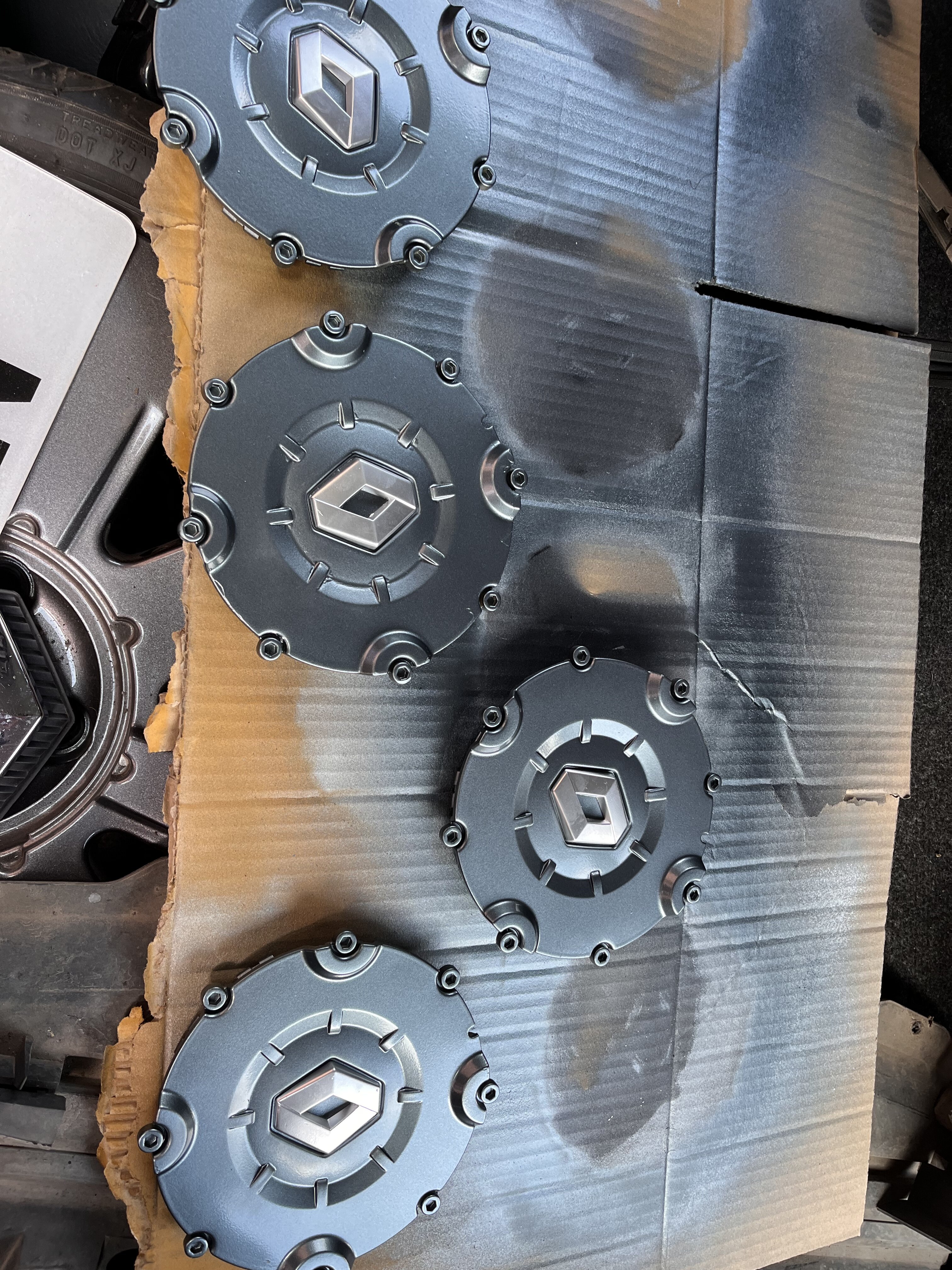

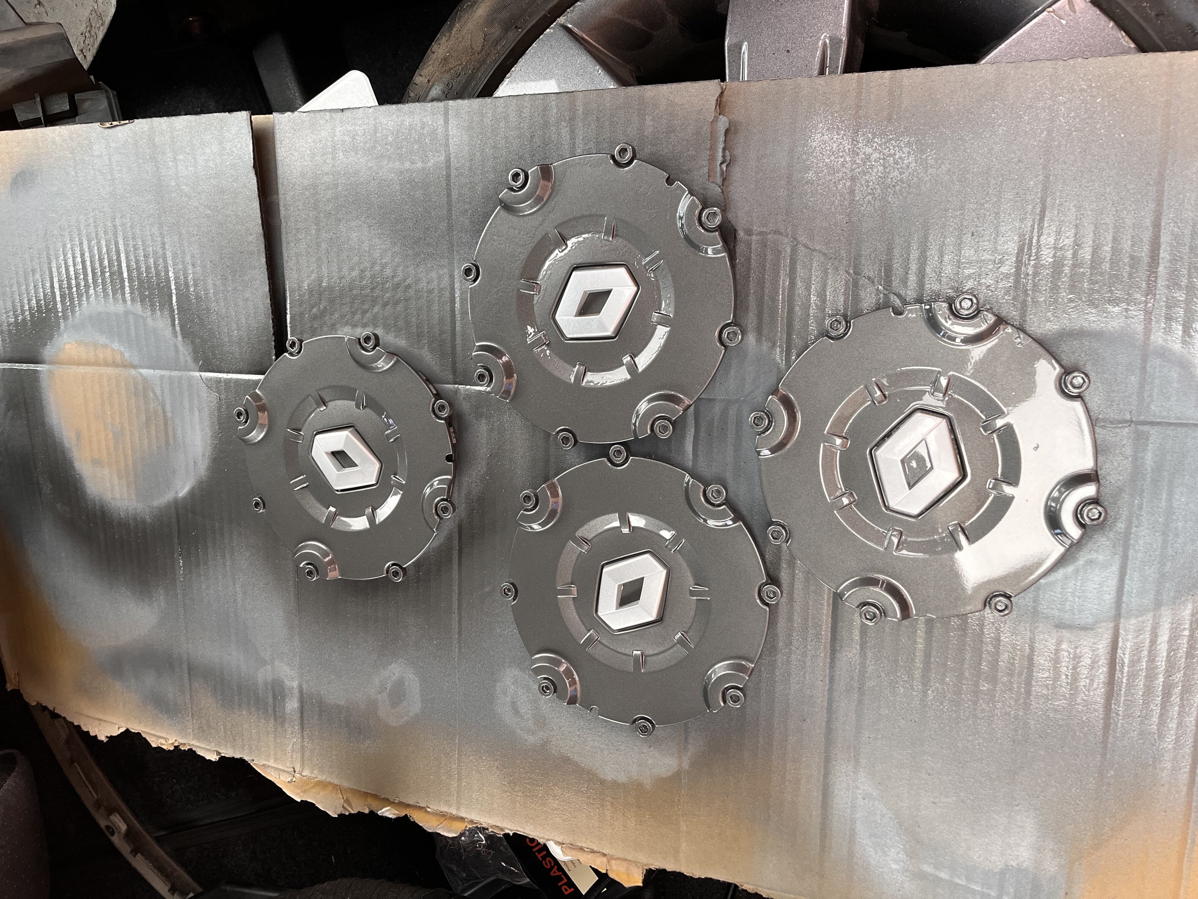

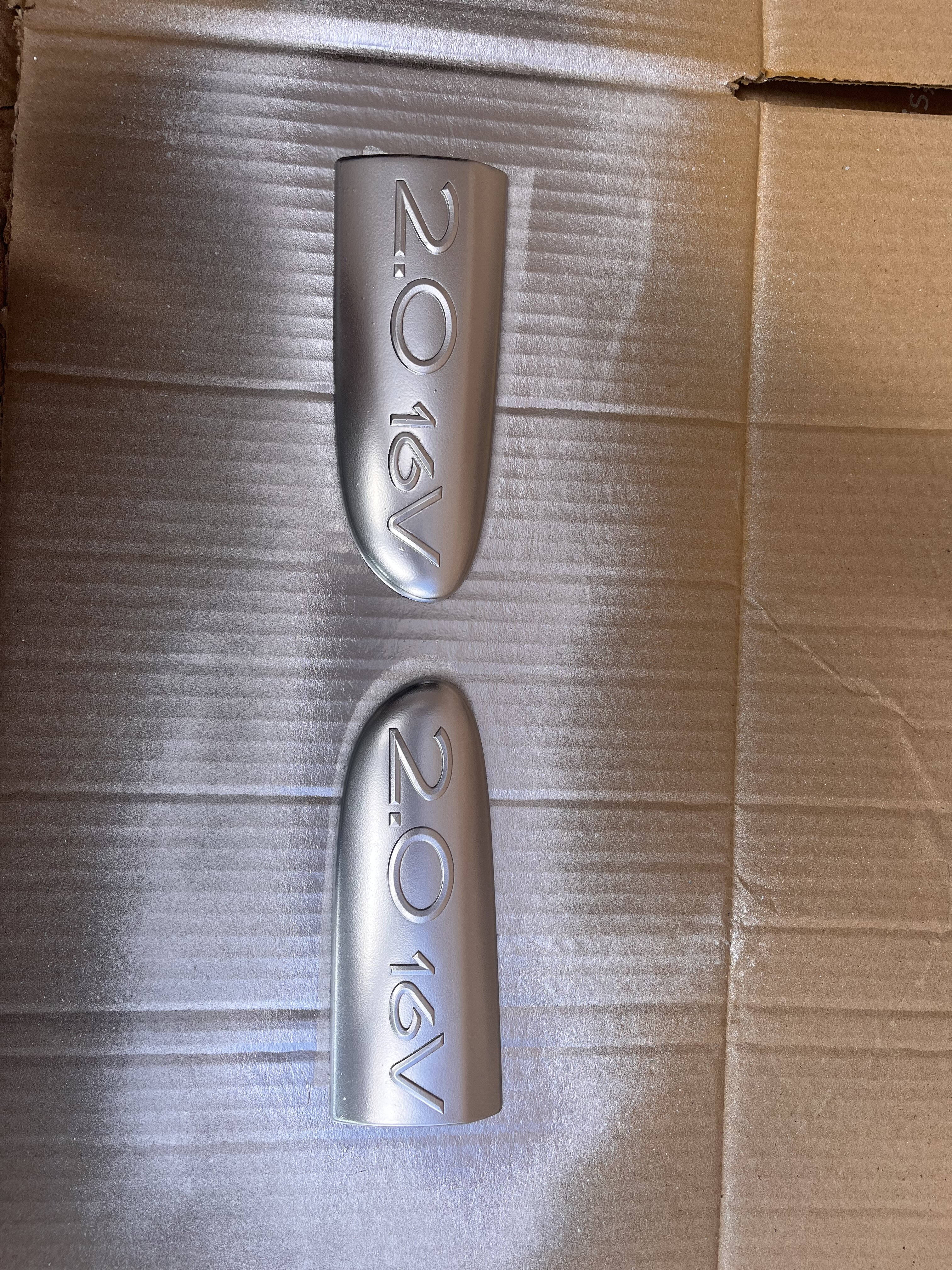

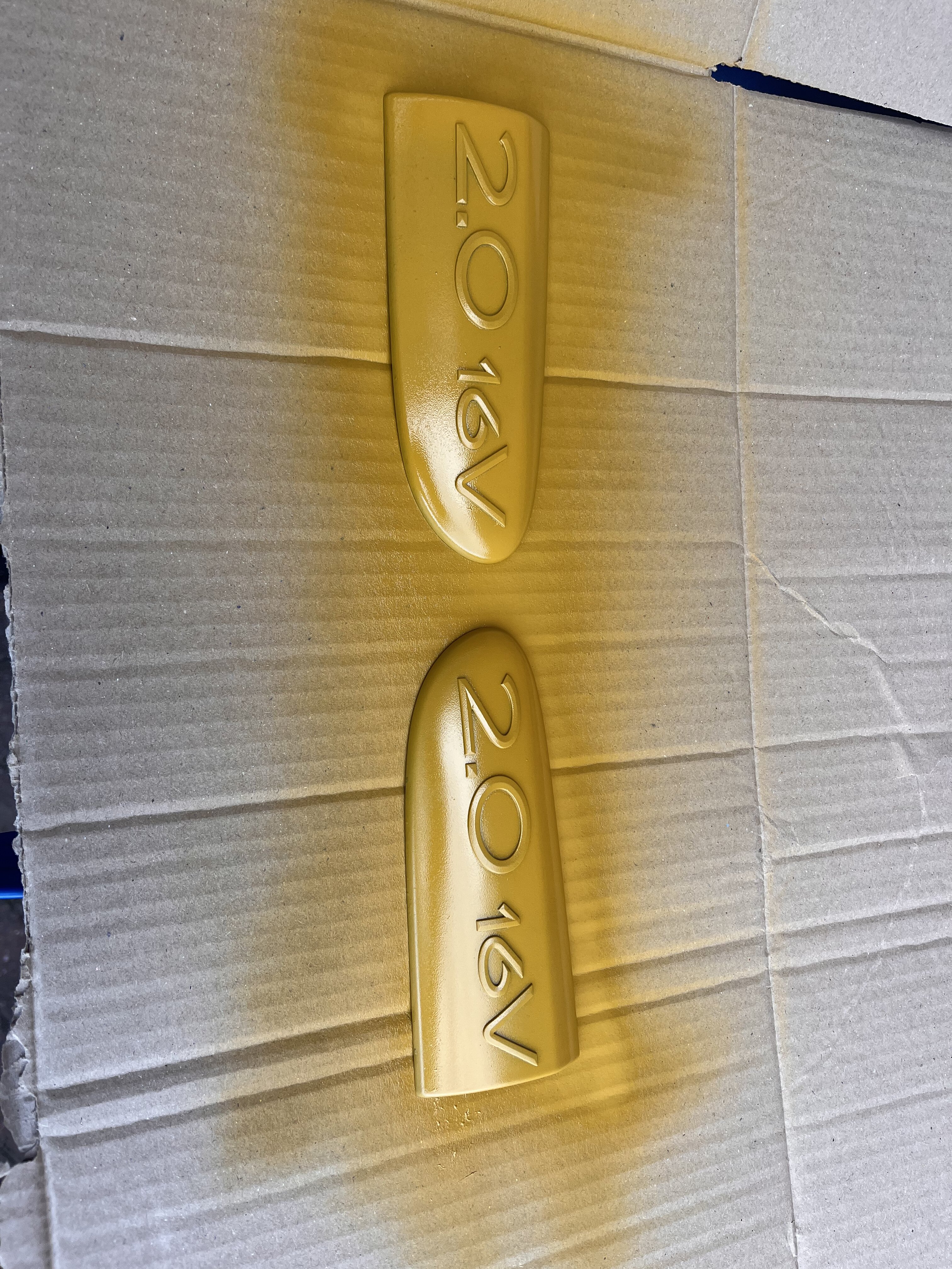

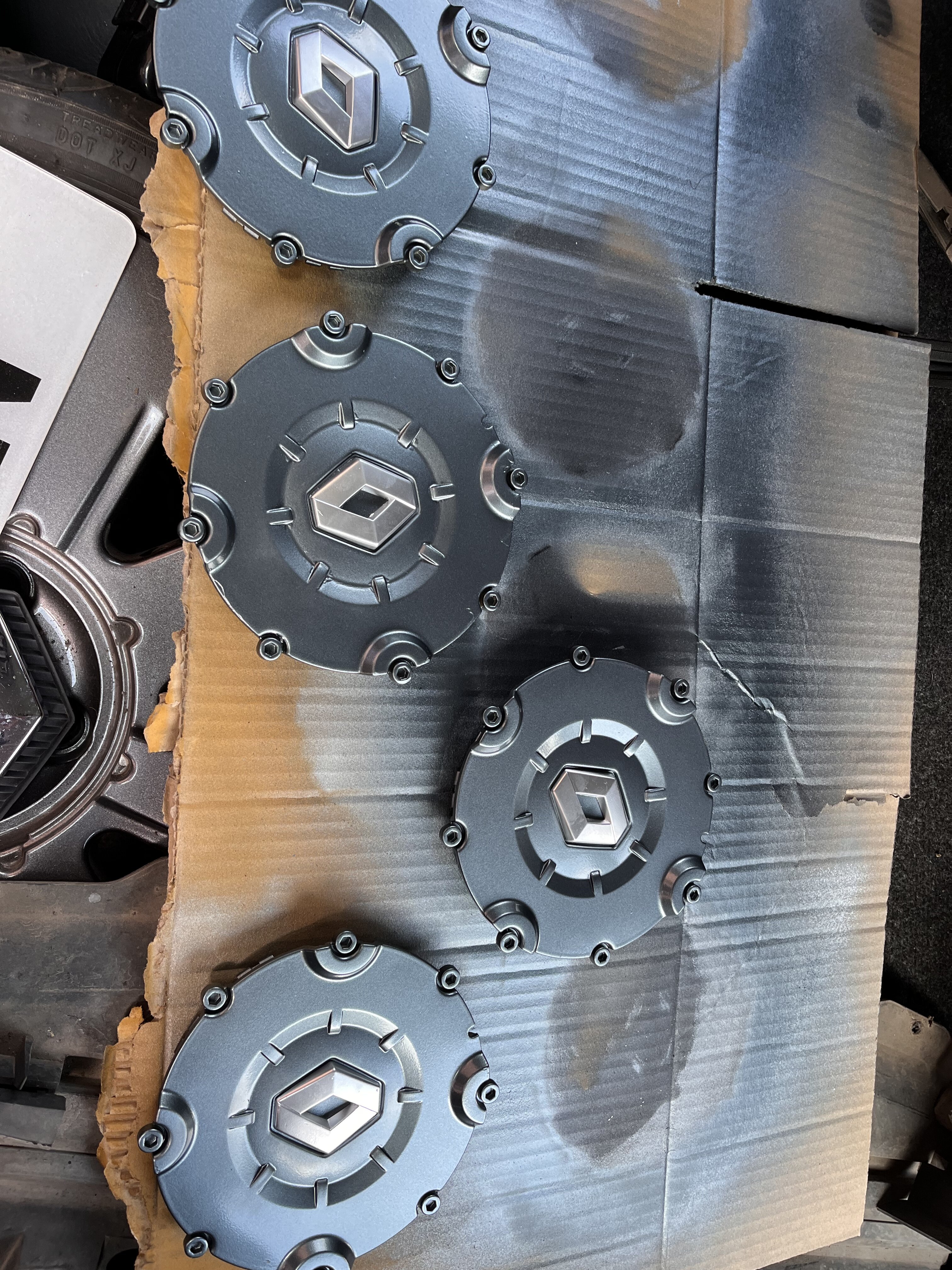

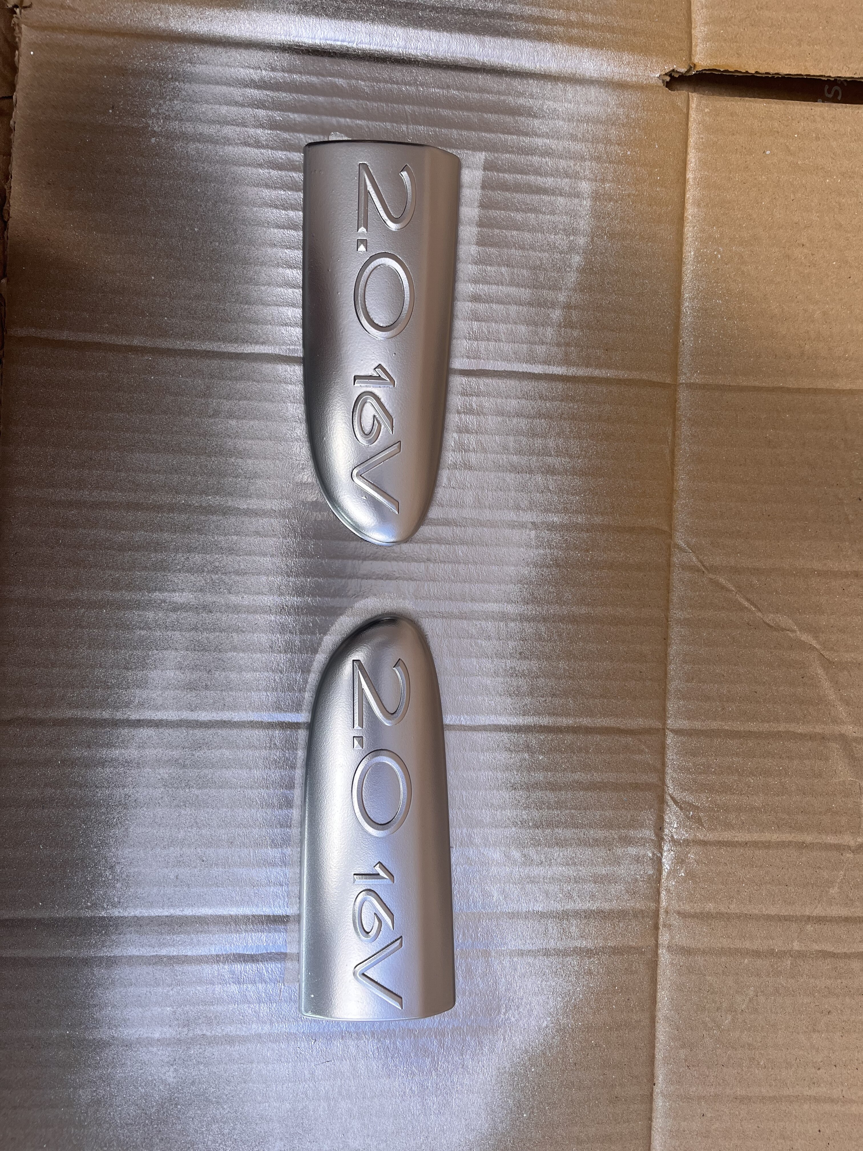

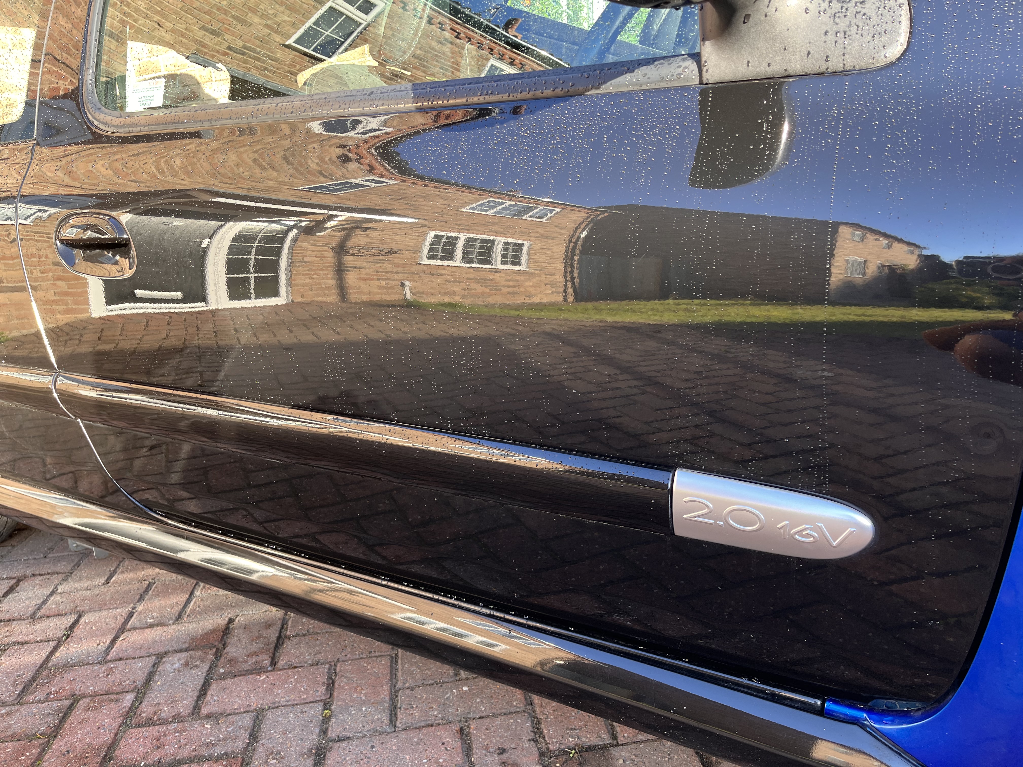

finished bullets, pretty happy with how they turned out, against the black they look really nice.

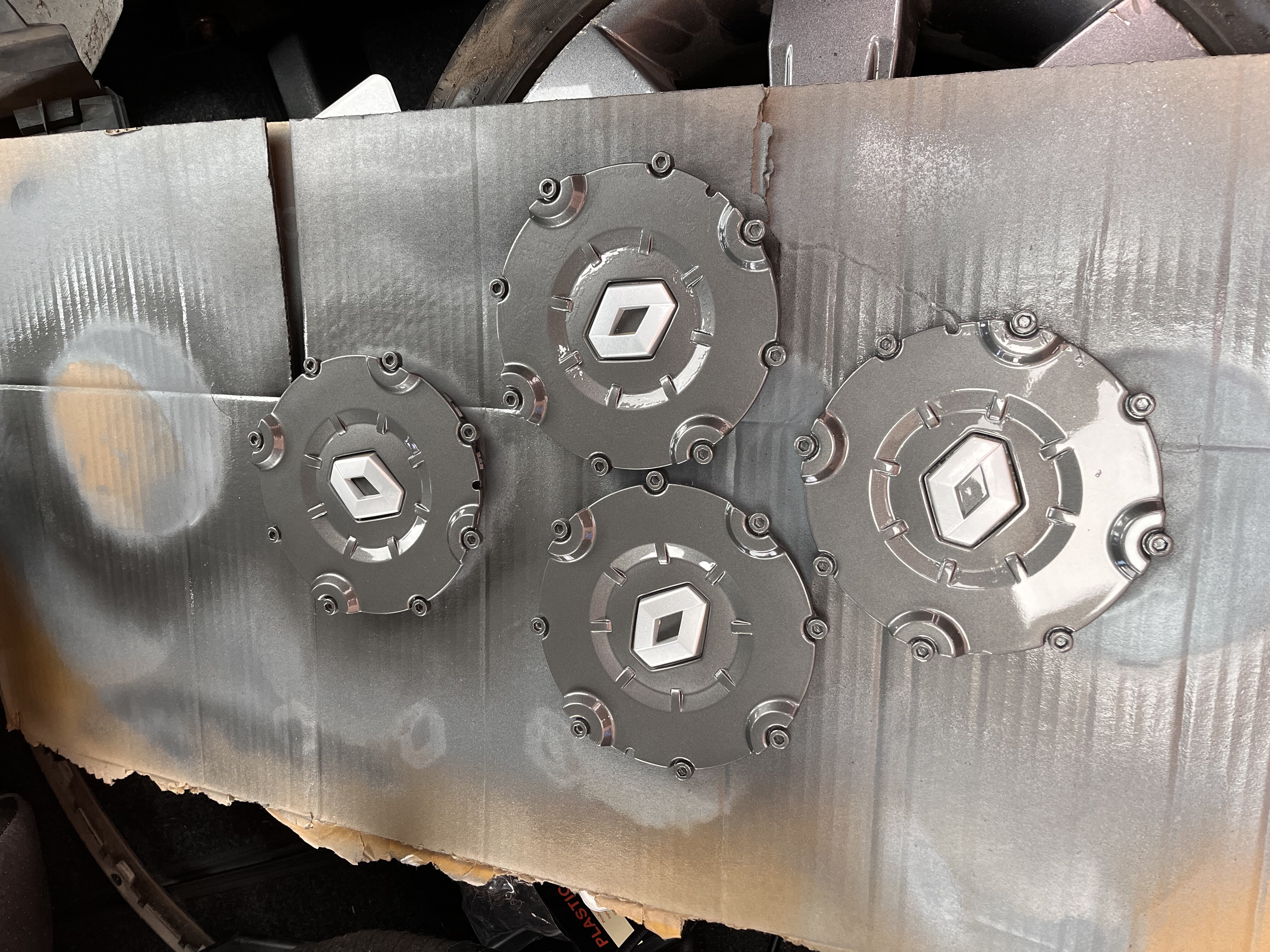

next up was the wheel caps, following the information on the forum I went for rover stone grey as a “good match”, turns out it want a good match at all so ended up taking the paint off and starting again, using the Halfords “anthracite” I got to a reasonable match and should be okay vs the wheels when I get them back.
Rover paint
how they are now

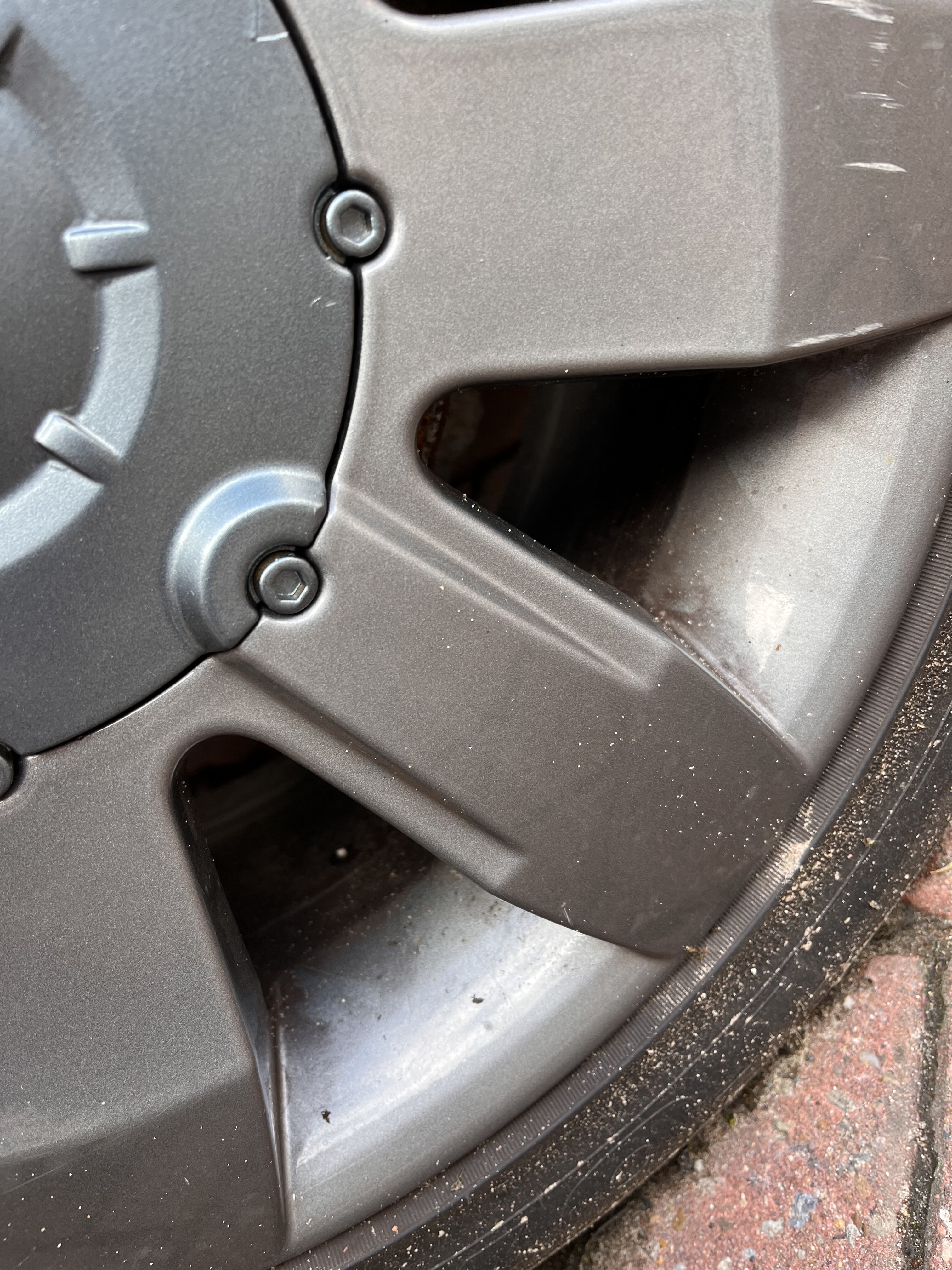

two of them have an restore under the paint, I wonder if it’s a reaction so they’ll need doing again. Fml. But happy with the overall colour.

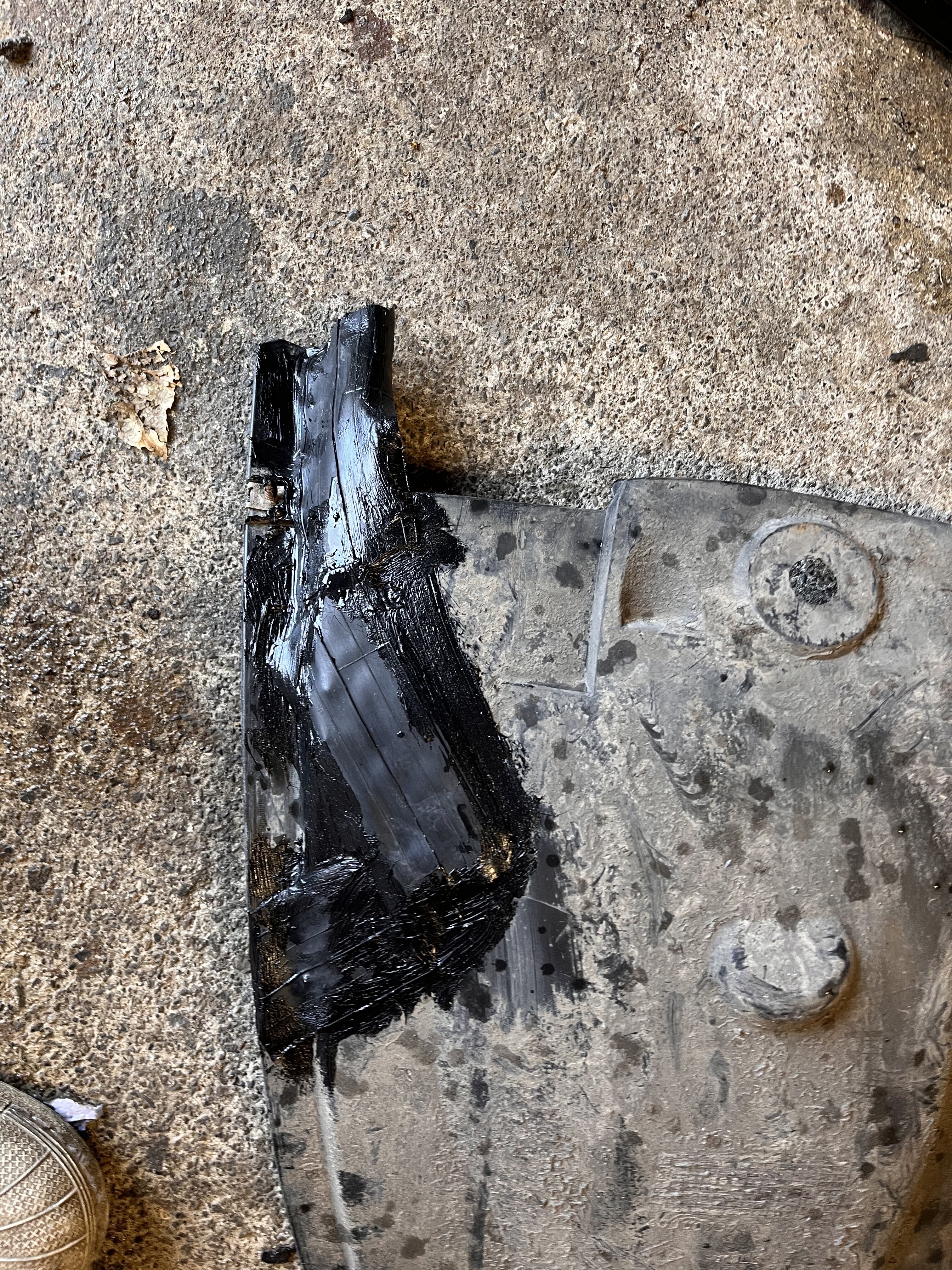

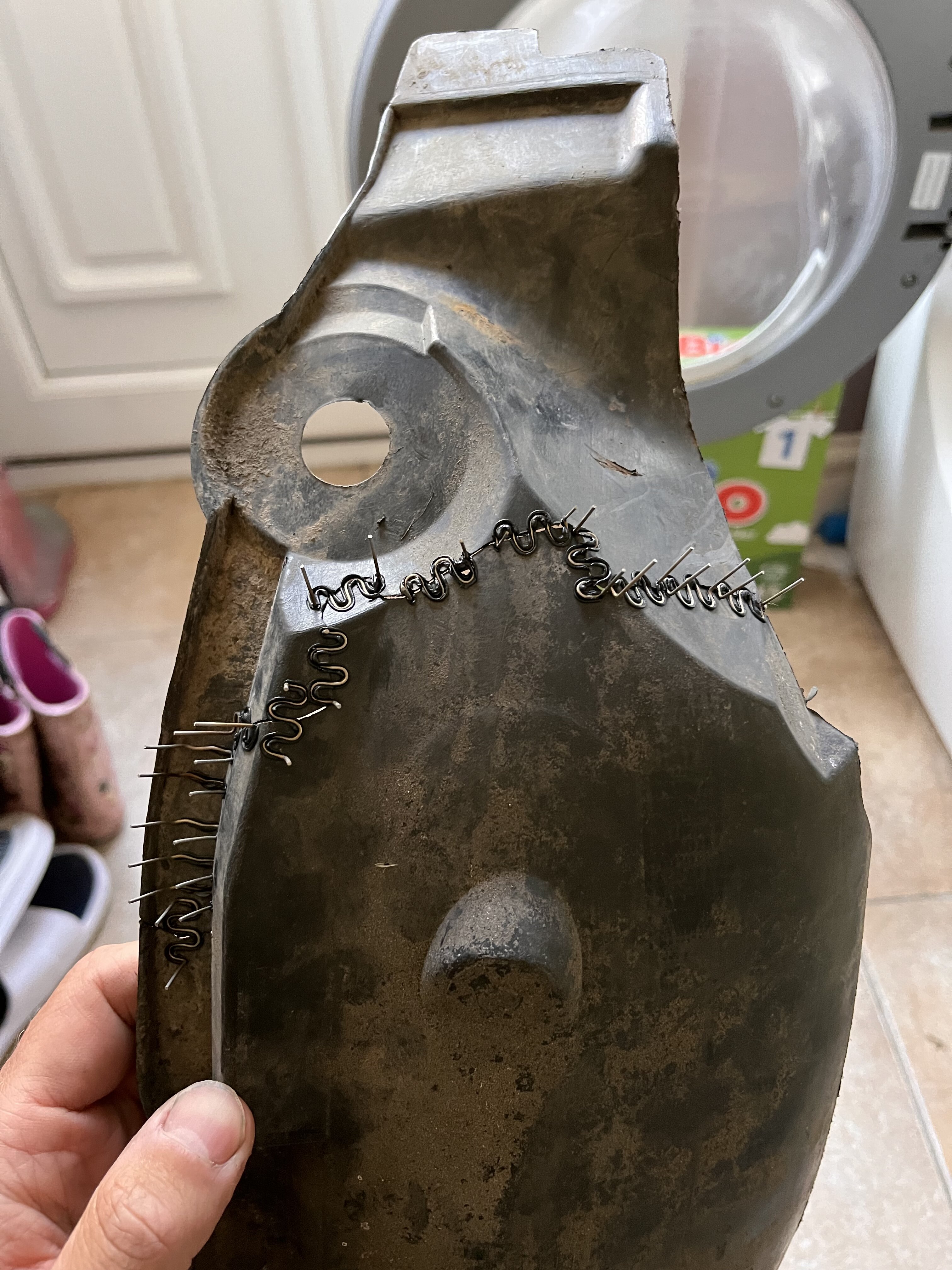

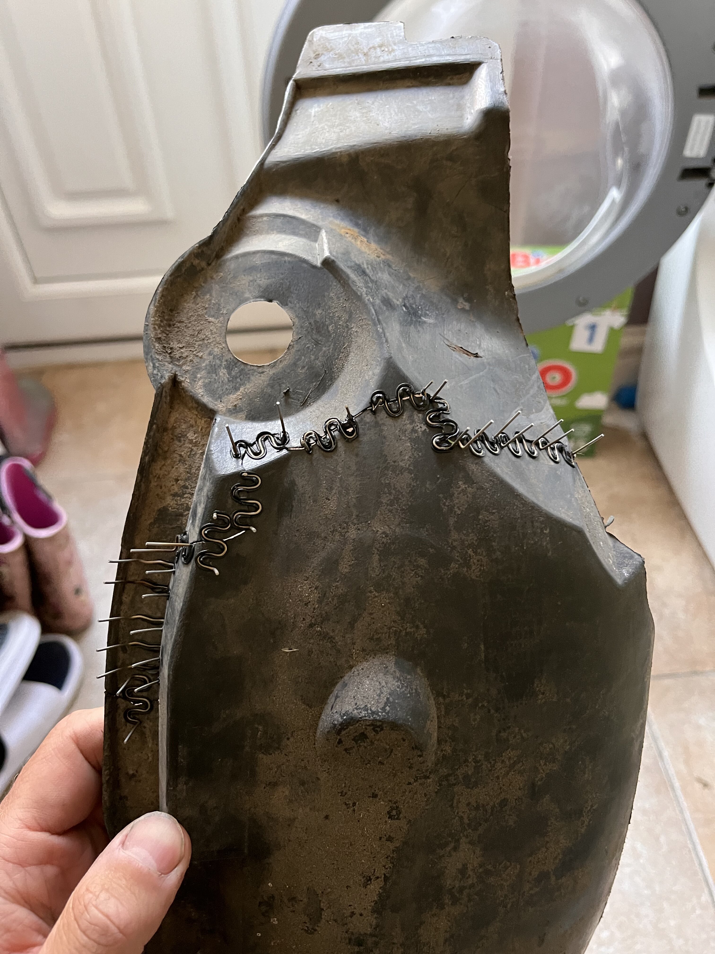

I’ve also bought a plastic welding / rivet gun and repaired the arch liners, it’s not pretty on the back but should be effective, I’ve stapled them together, added sikaflex and then added inner tubes from a bike with more sikaflex, overall it’s very strong and should be just fine.

Looking good. With those tools it's good practice to out the staple in then rotate about 25deg.
Thanks, yes I did find that just pressing them in wasn't really good enough and I got better the more I did.
Can you still buy genuine arch liners?
I bought some eBay specials once and they didn't fit, so I ended up forking out for genuine.
Im not sure, I was told they were NLA but might be worth a look!!

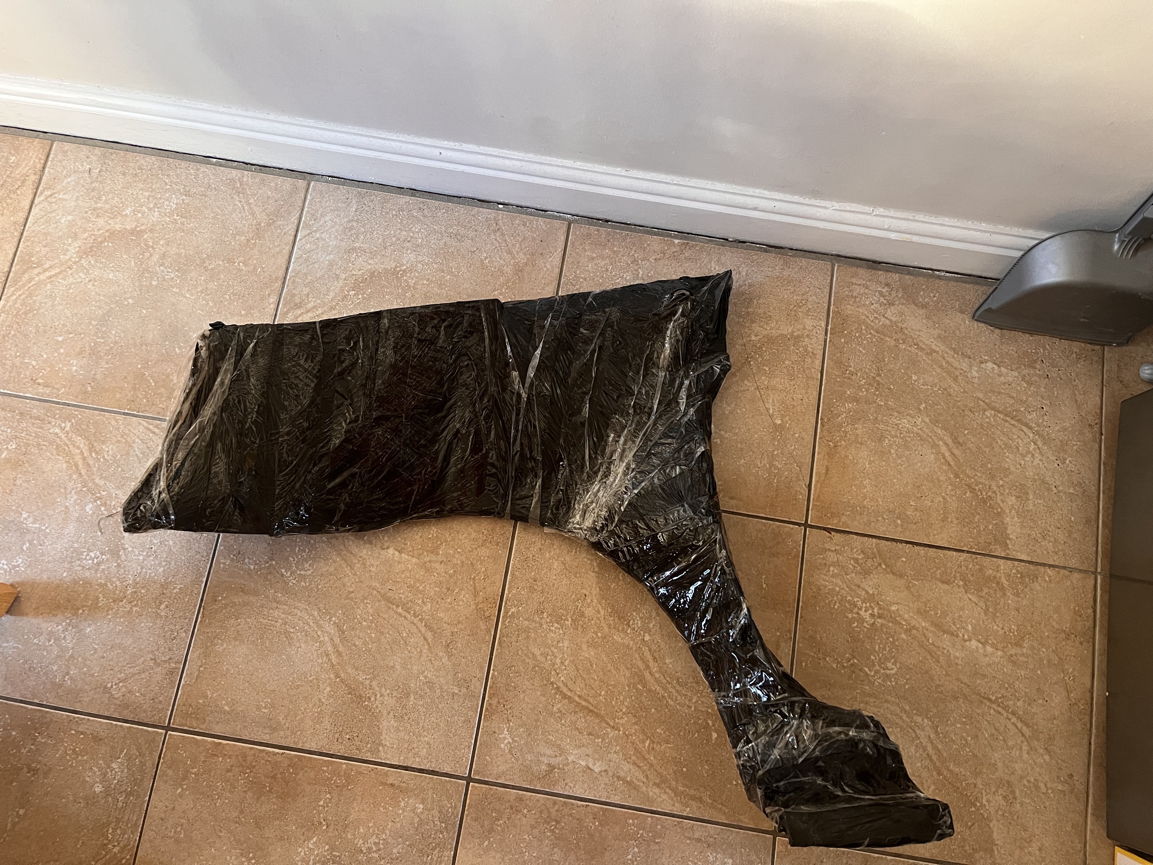

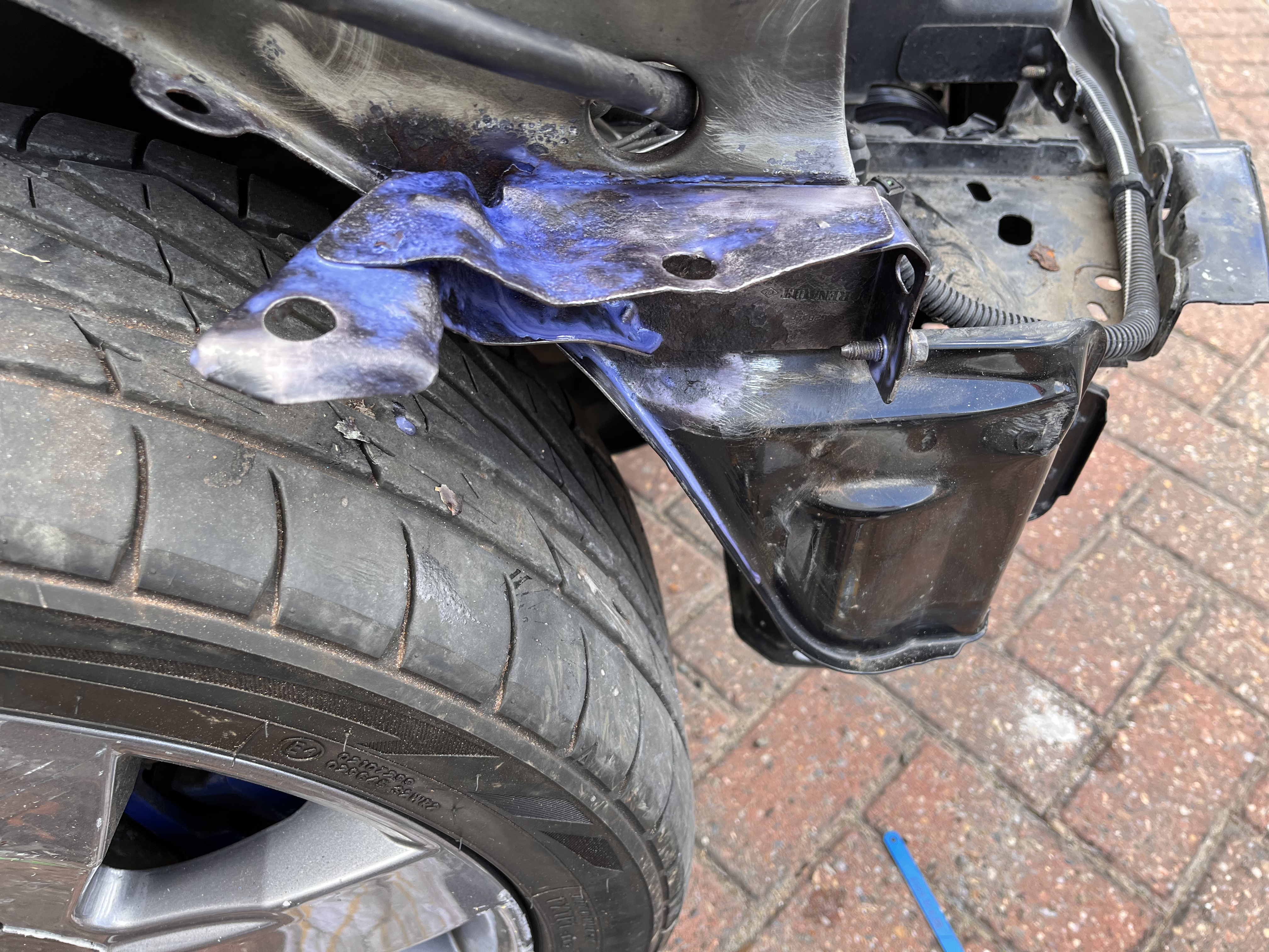

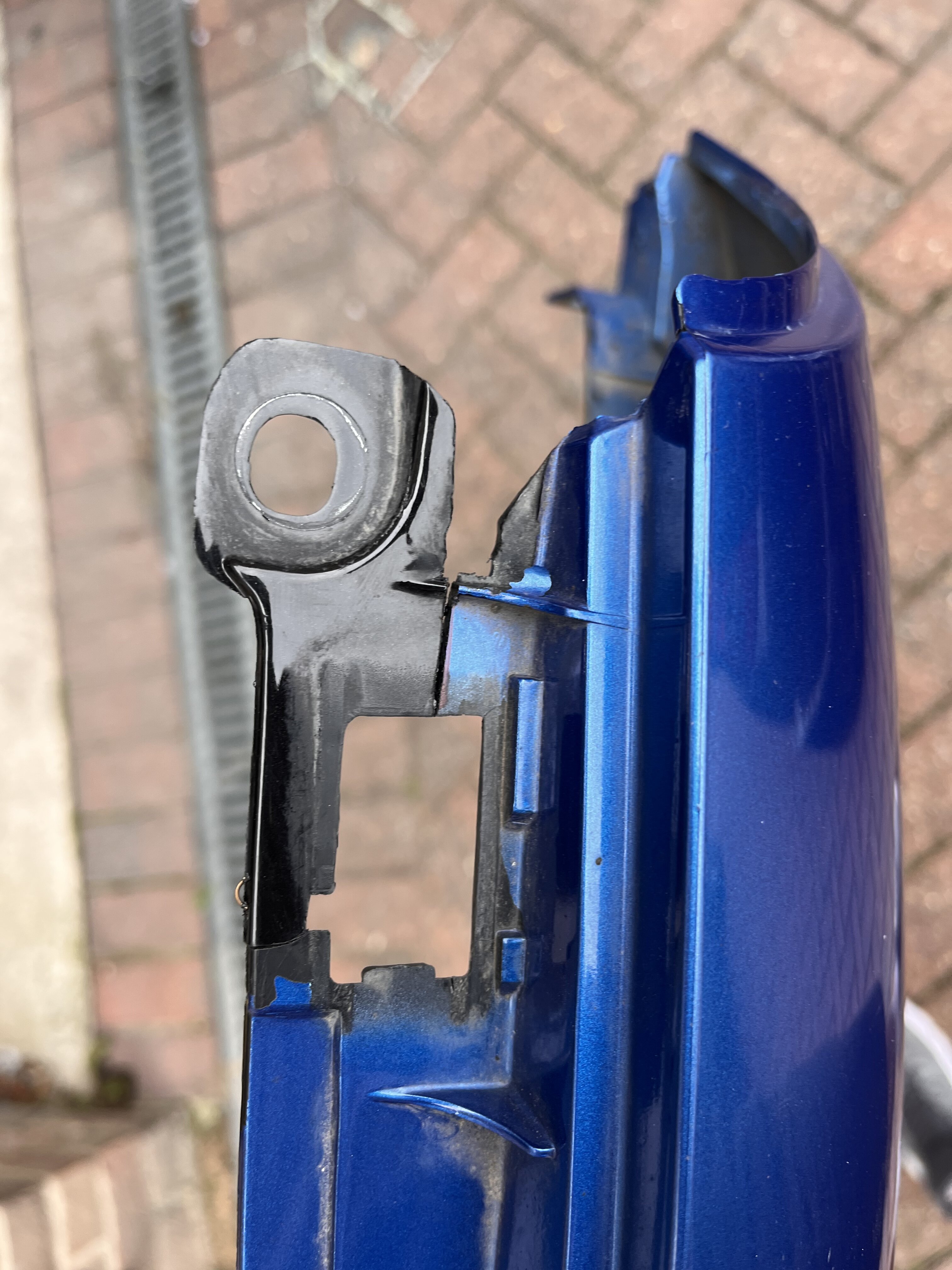

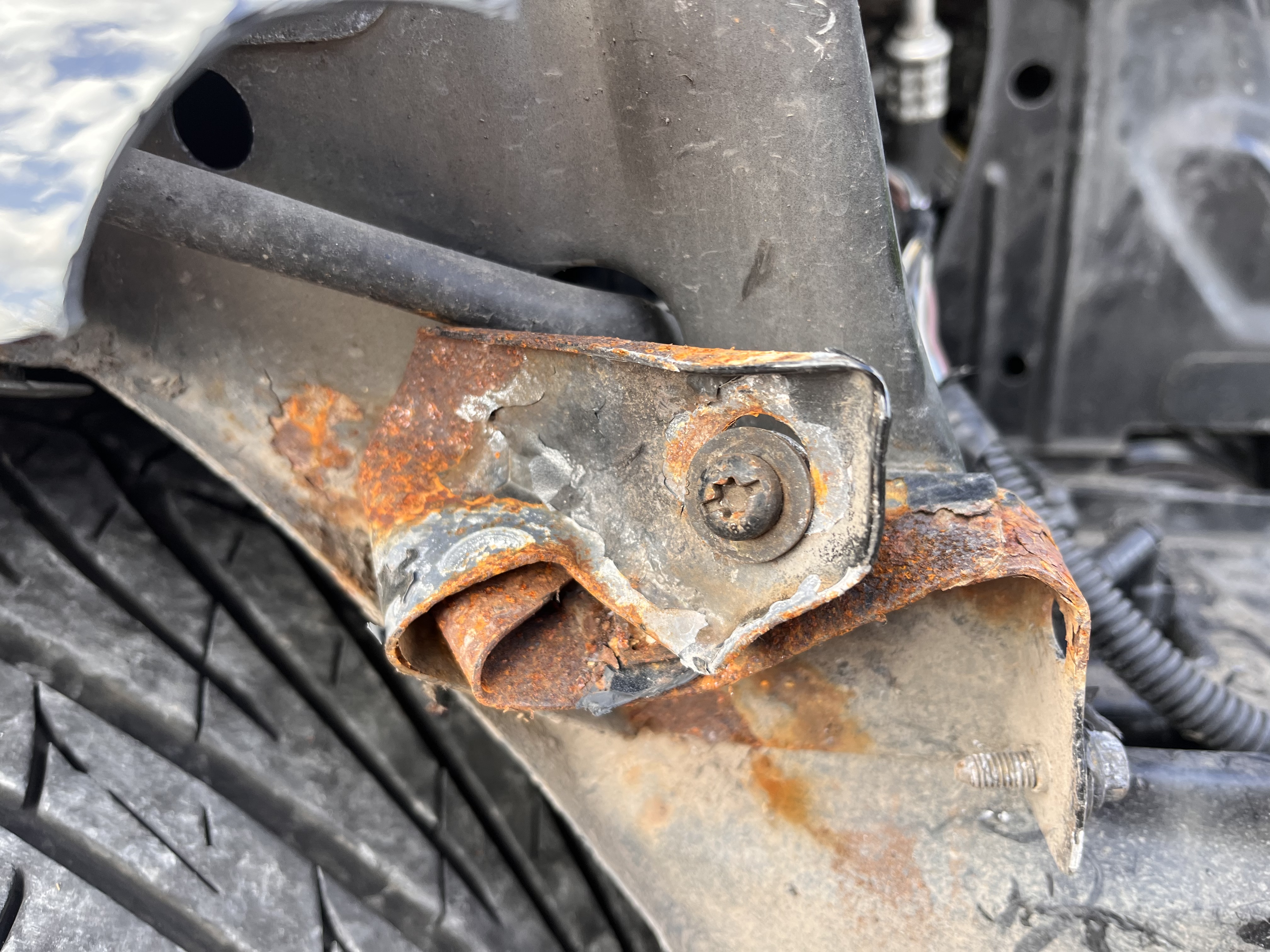

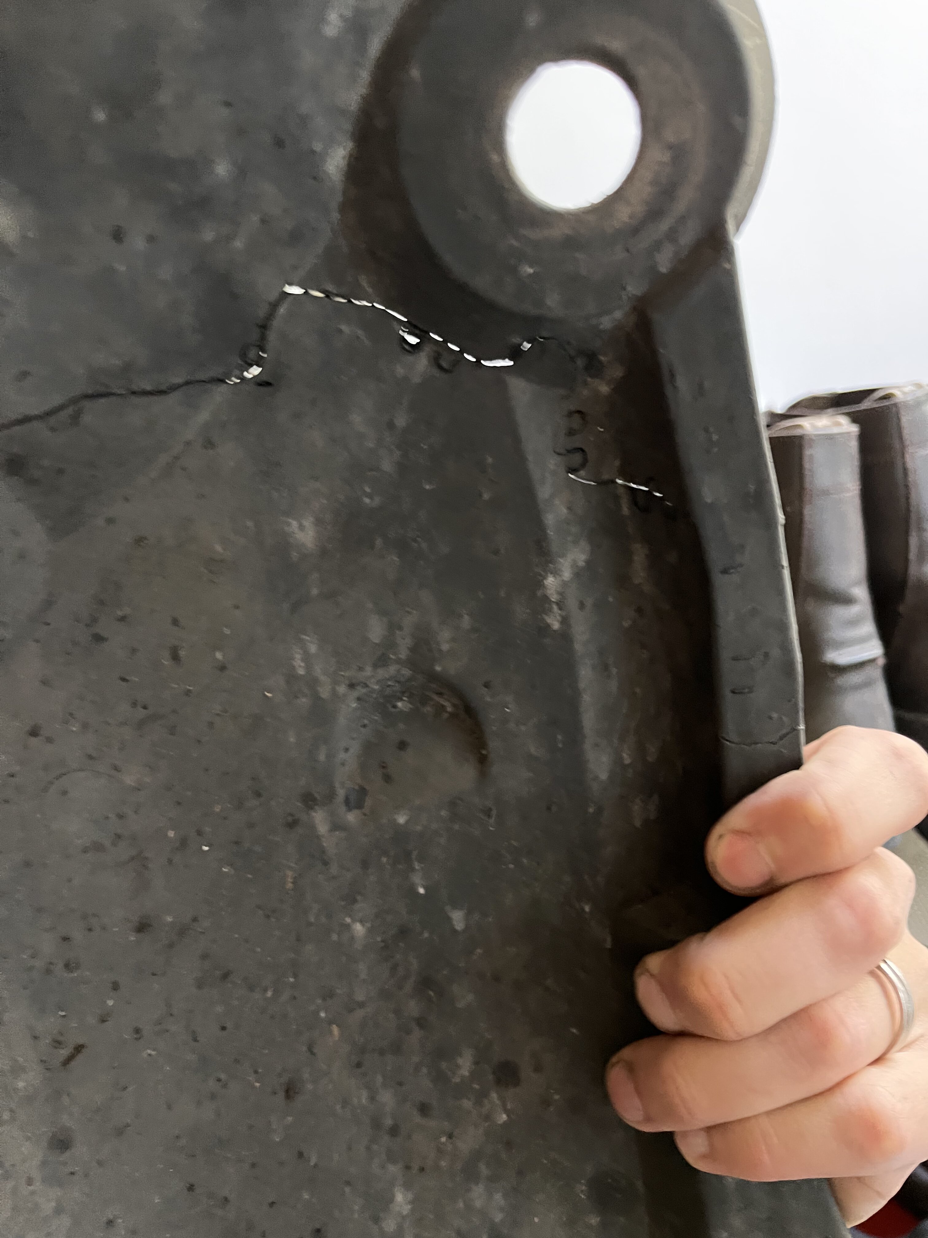

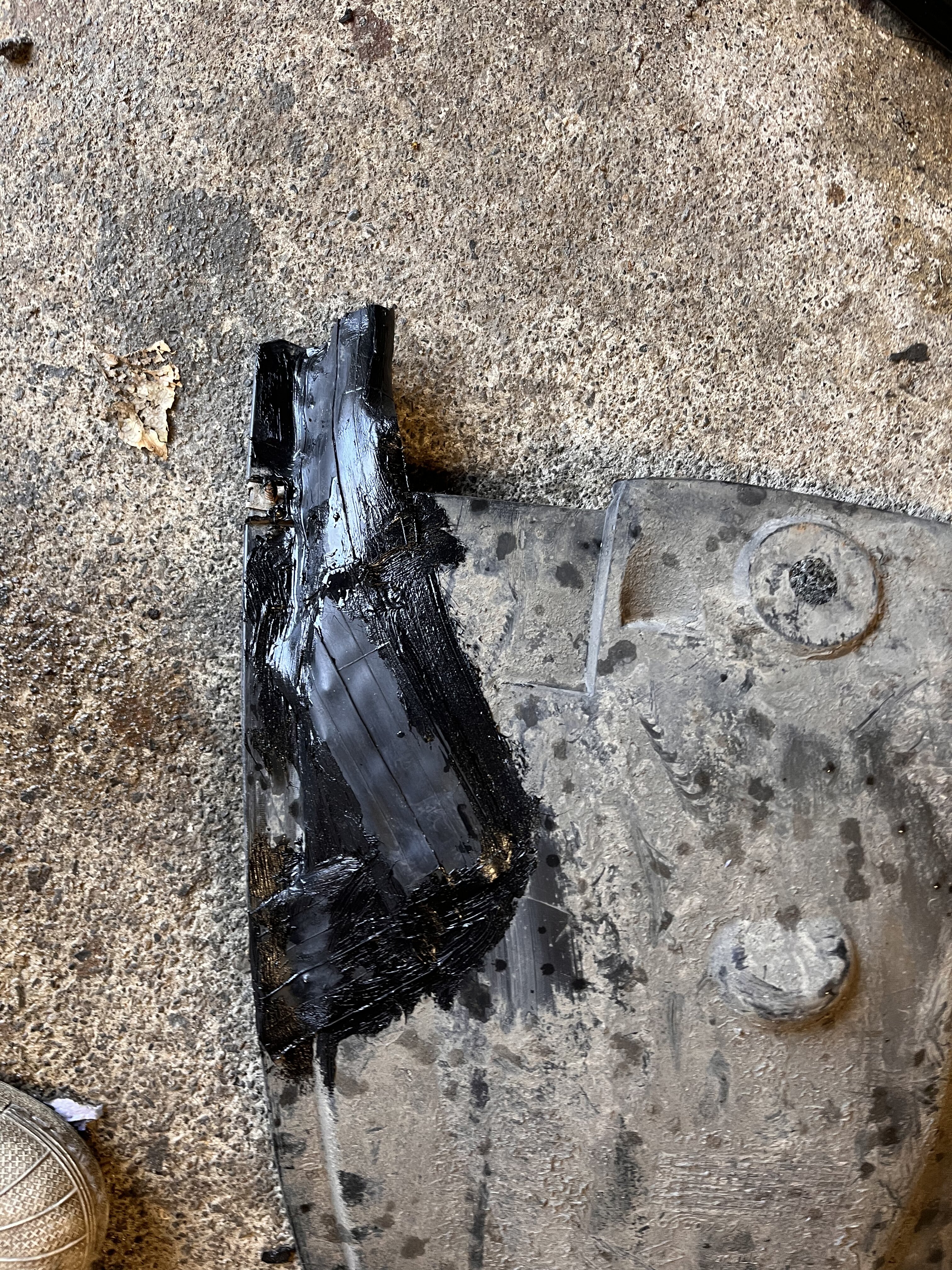

Next up I repaired the front wing I bought as while the loop on the crashed panel was okay the new panel was broken, again the plastics welder did a grand job.
With that the bumper and the wing have gone for painting, as have the wheels so the car is now looking quite sorry for itself.

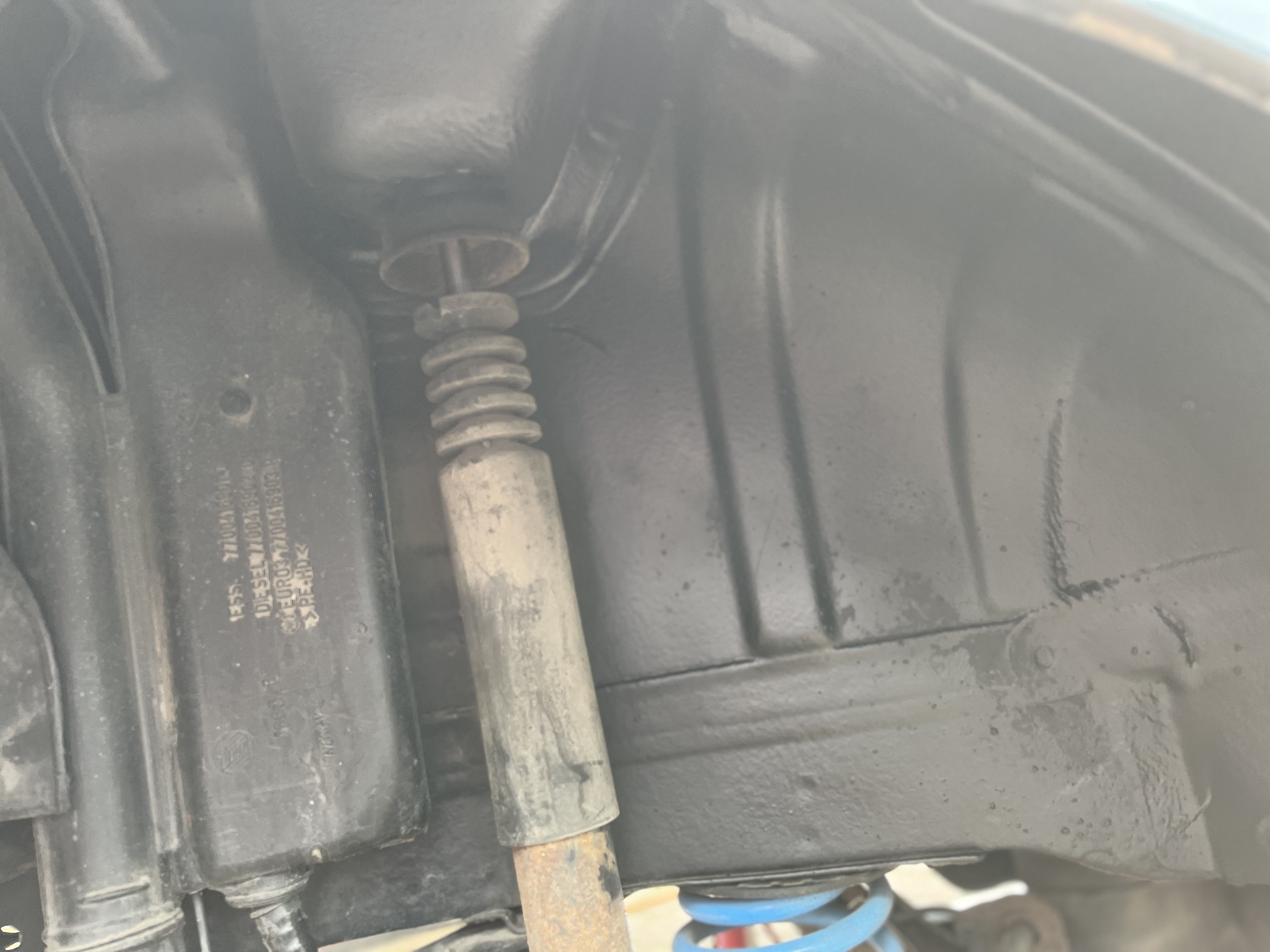

Finally I’ve removed the rear trim panels to see the carnage but it’s pretty good, I’ll get the rust sorted out and then spray some protectant in for good measure.
driver side
Passenger side

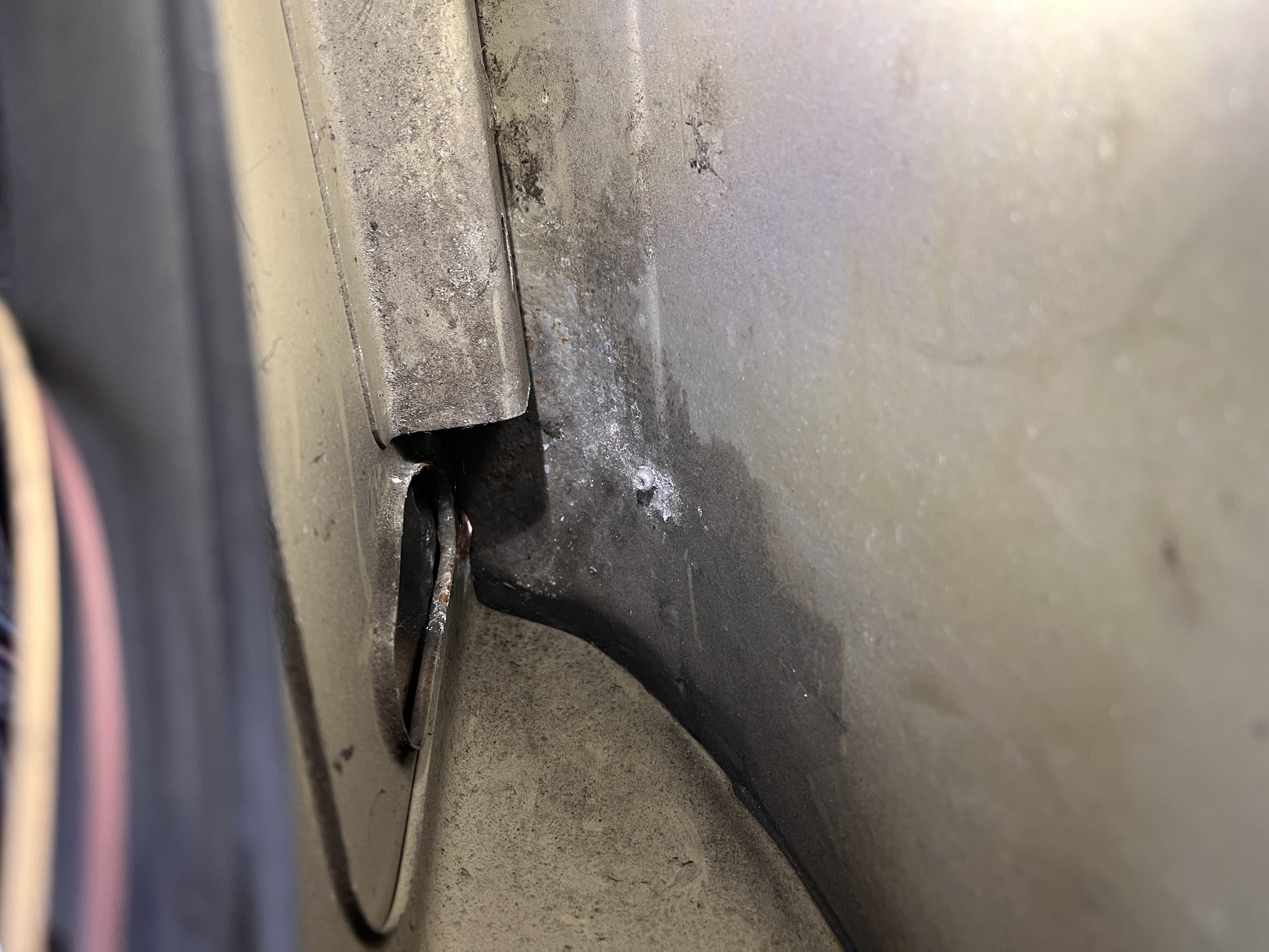

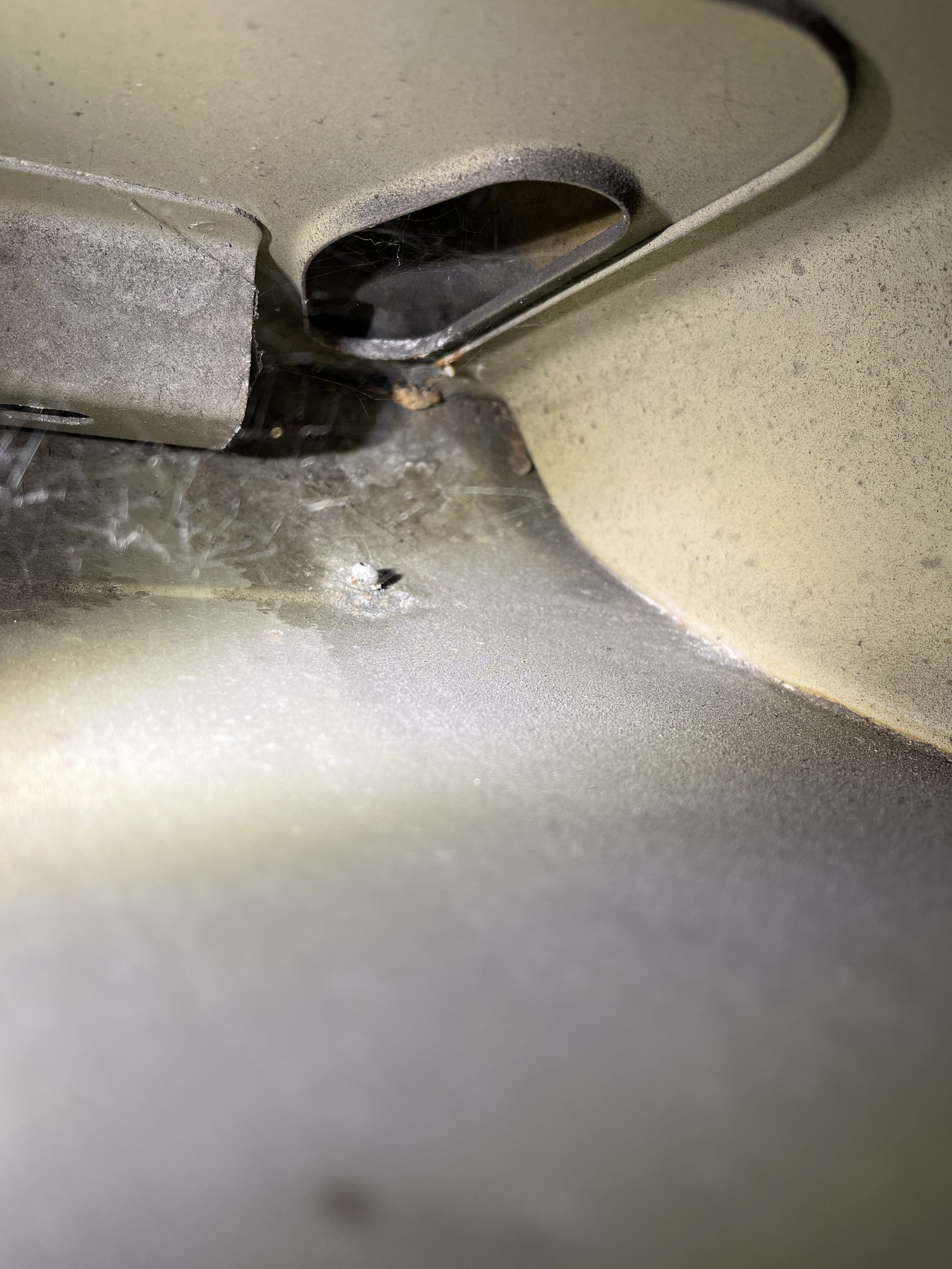

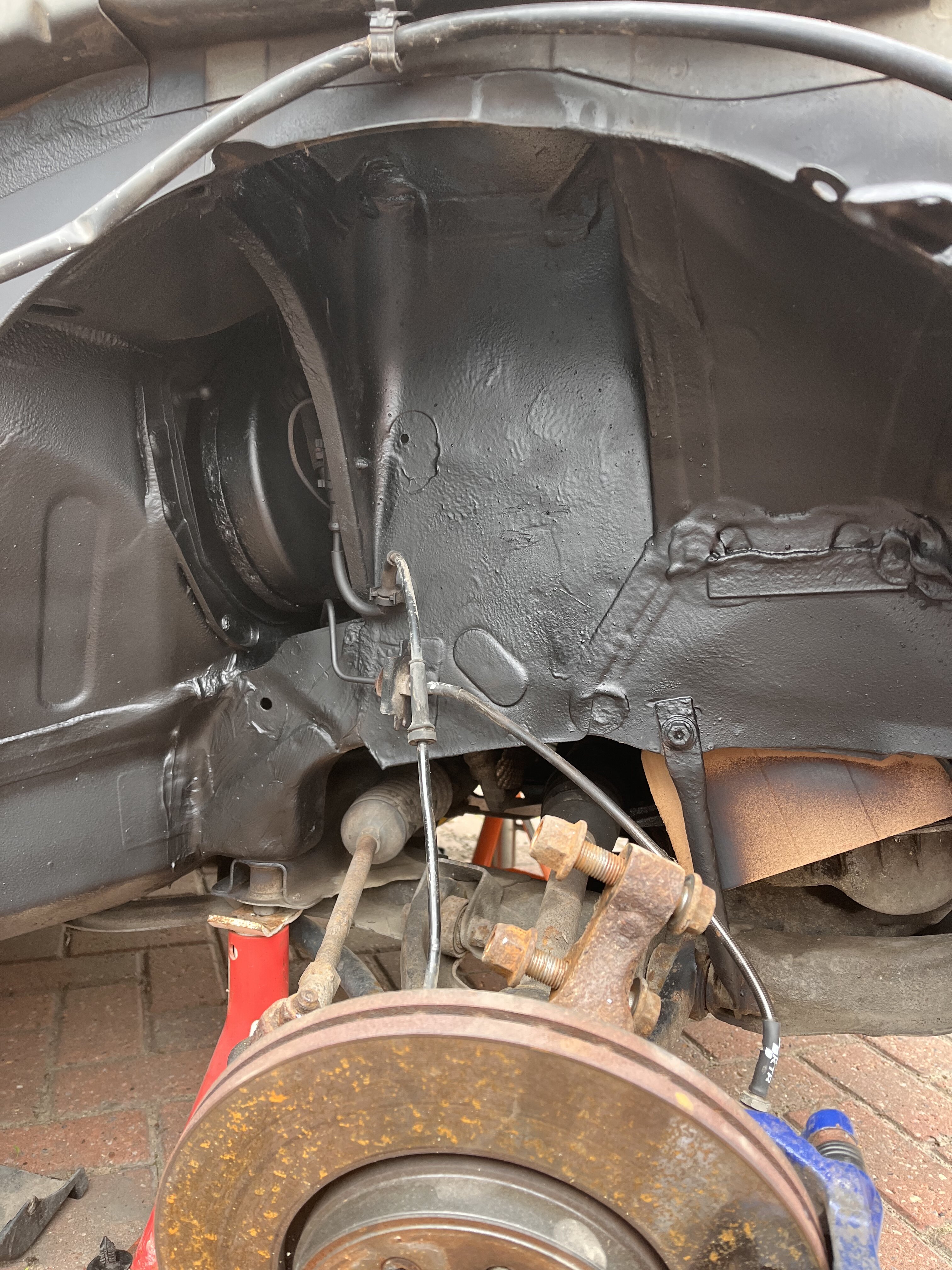

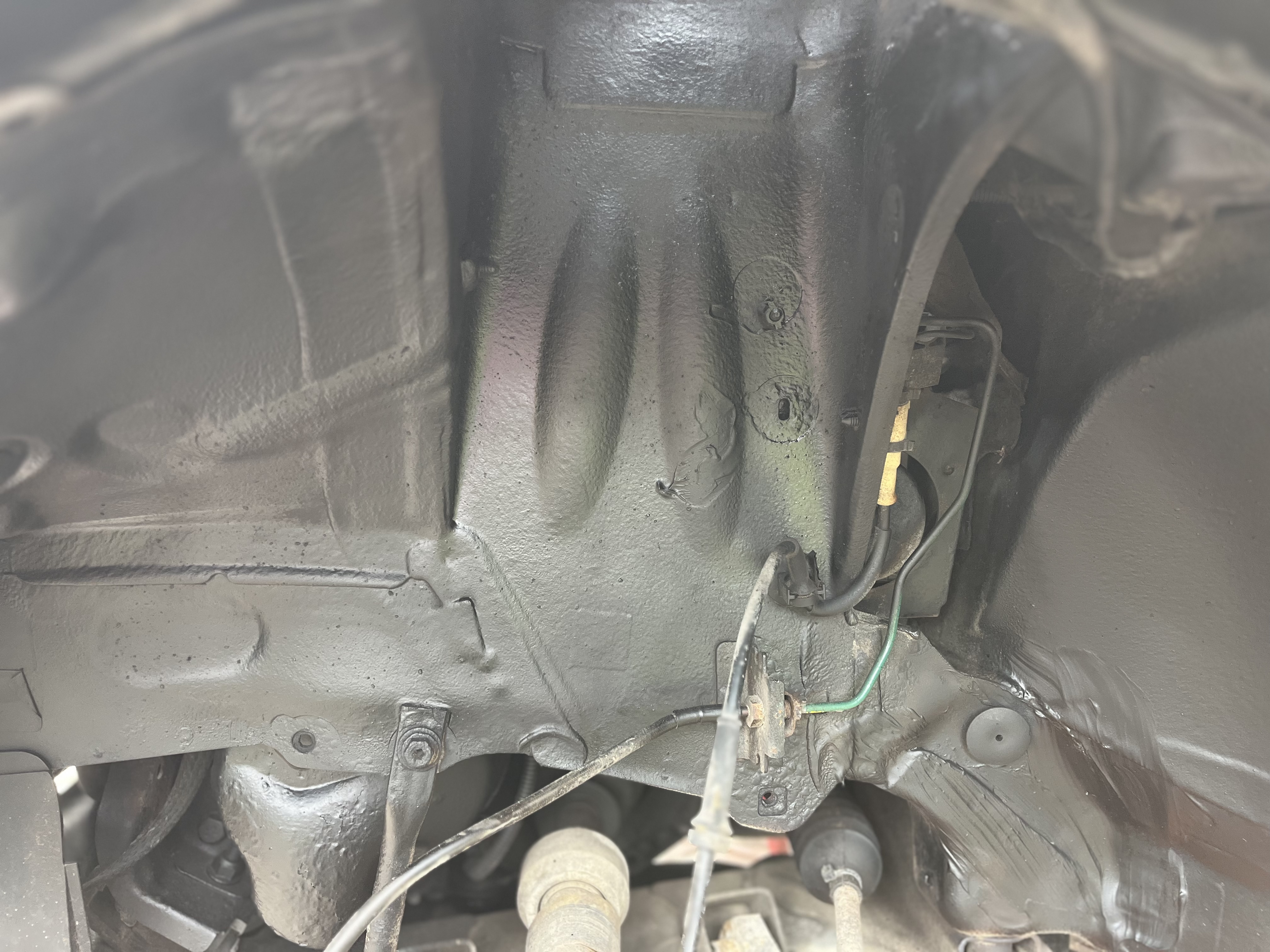

Oh and I found some more rust I want to treat in the front wheel arches where the line plugs go in. So I will be on with that this weekend as well. Its not going to be mint but it should be better than most and have a good few years of life left!!
Found some time today and made some more progress, I knew there was something amiss with the front suspension and had narrowed it down to the bearings in the top mounts… I think I guessed right…

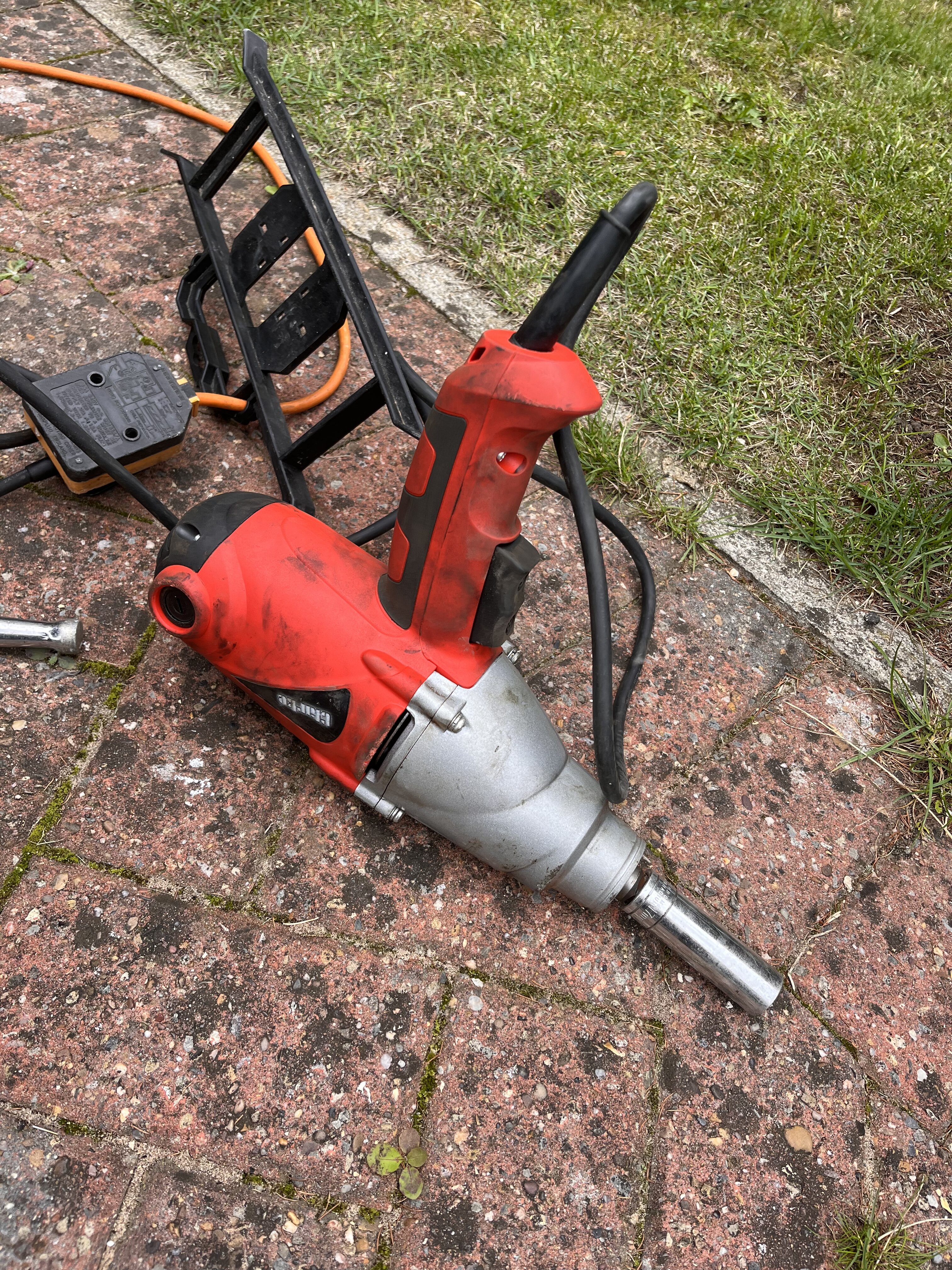

It all came apart pretty easily using my clarkes uggadugga machine, given it was pretty cheap it’s served me well and breaks most things loose.
move also finished the rust treatment (for now, as it’s French so the rust will be back) and the arches look much better and tidier.

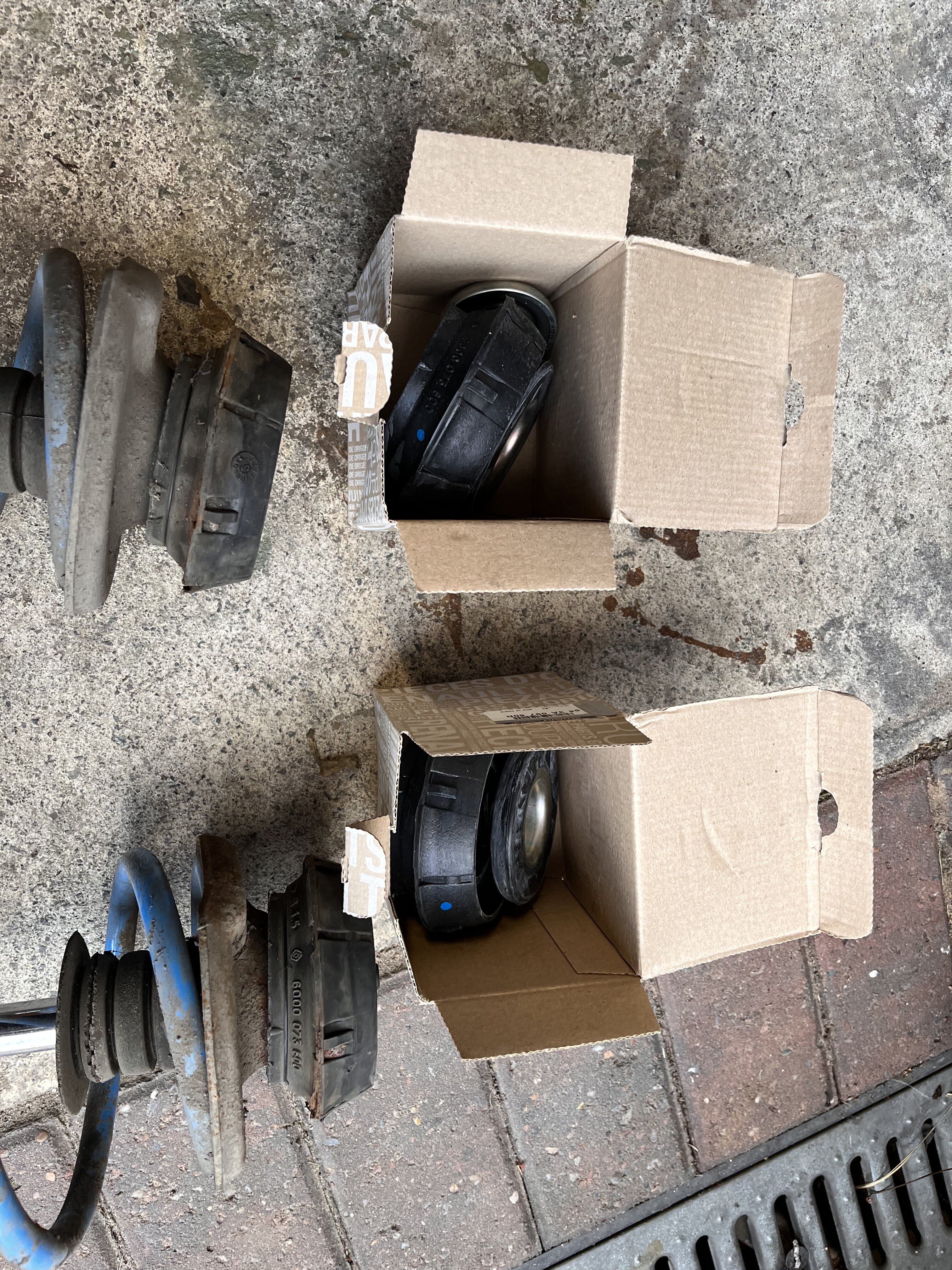

so now I’m left waiting, I have new suspension top mounts on the way as well as a service kit including new gearbox oil.

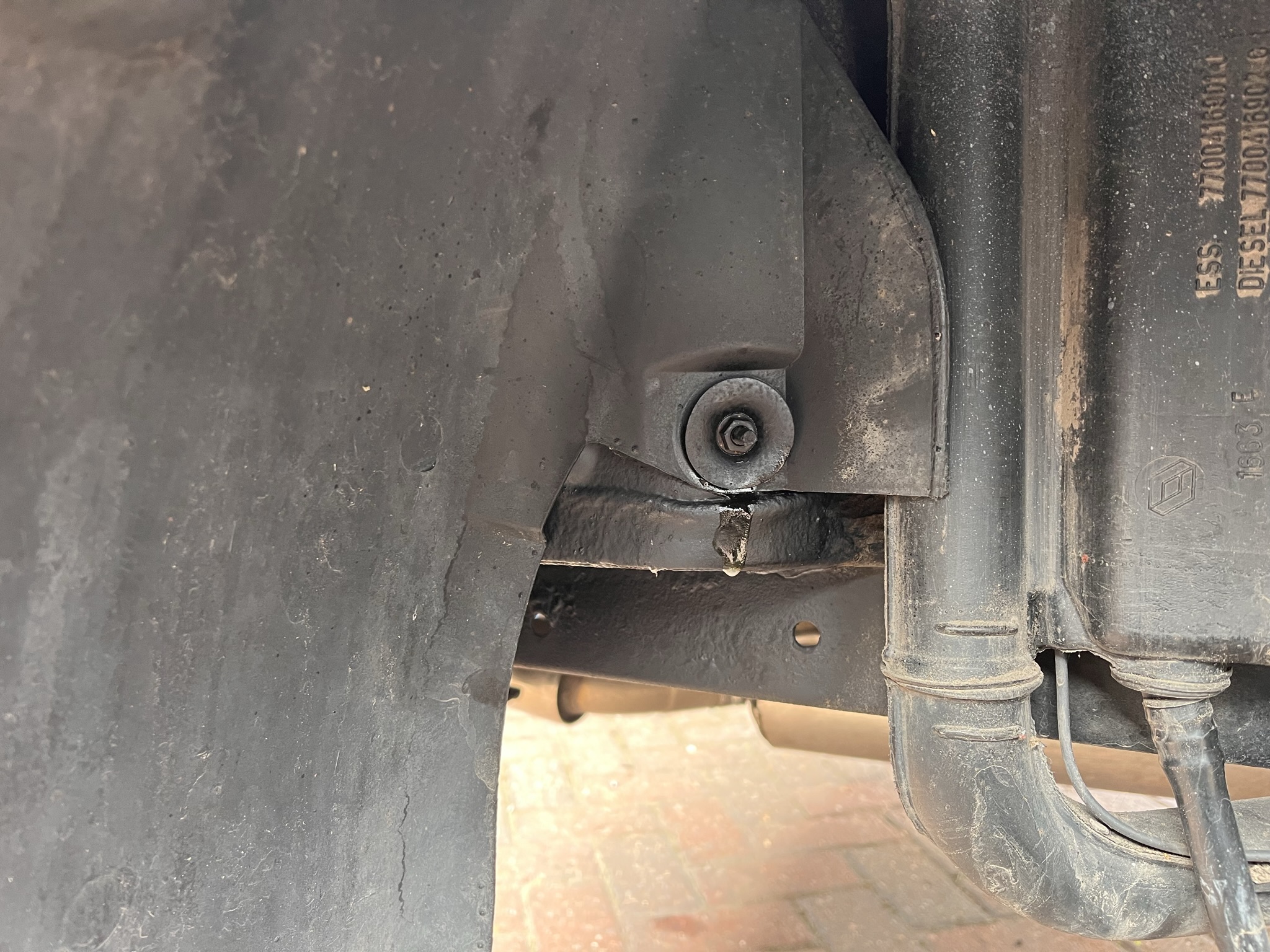

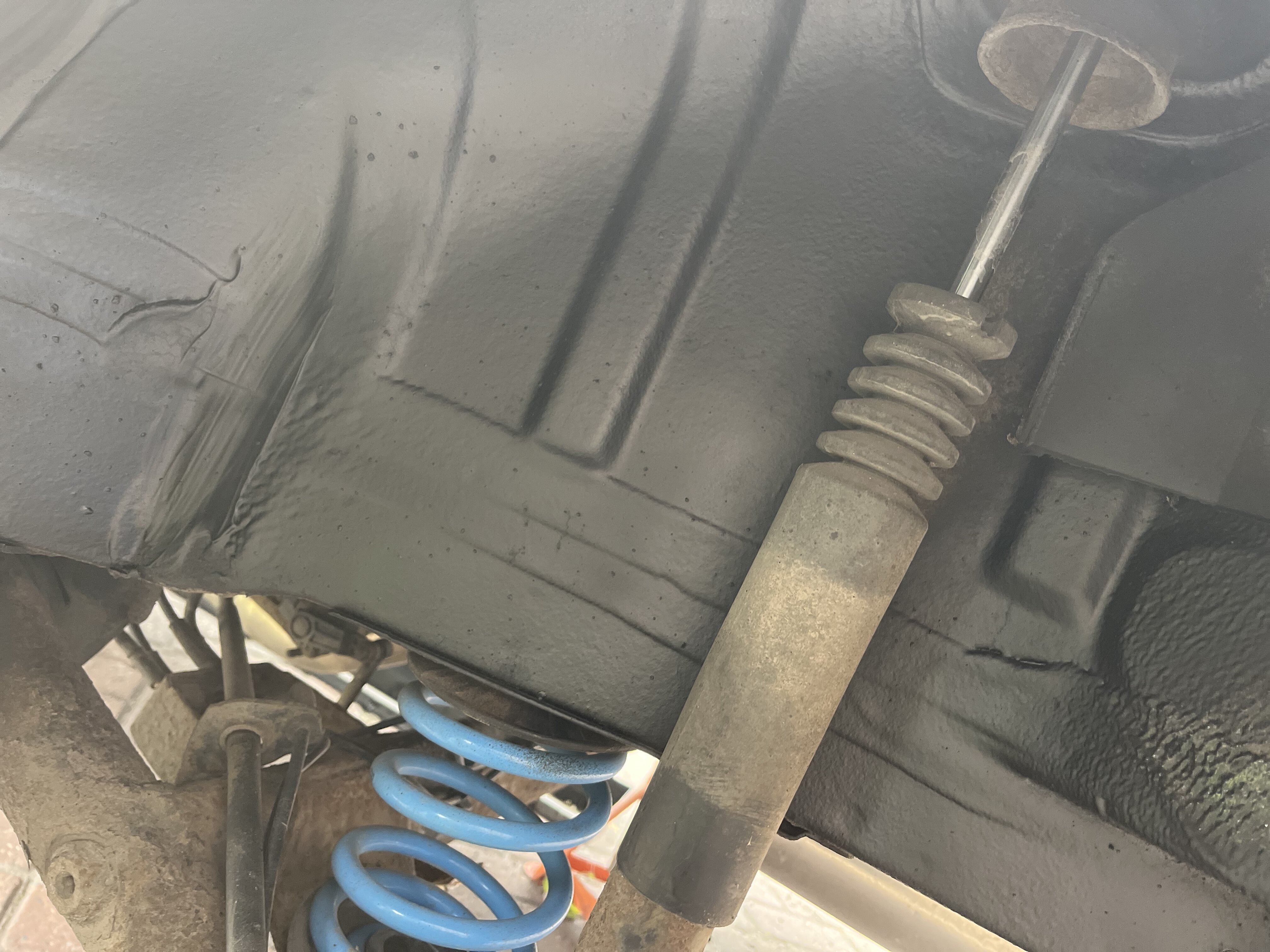

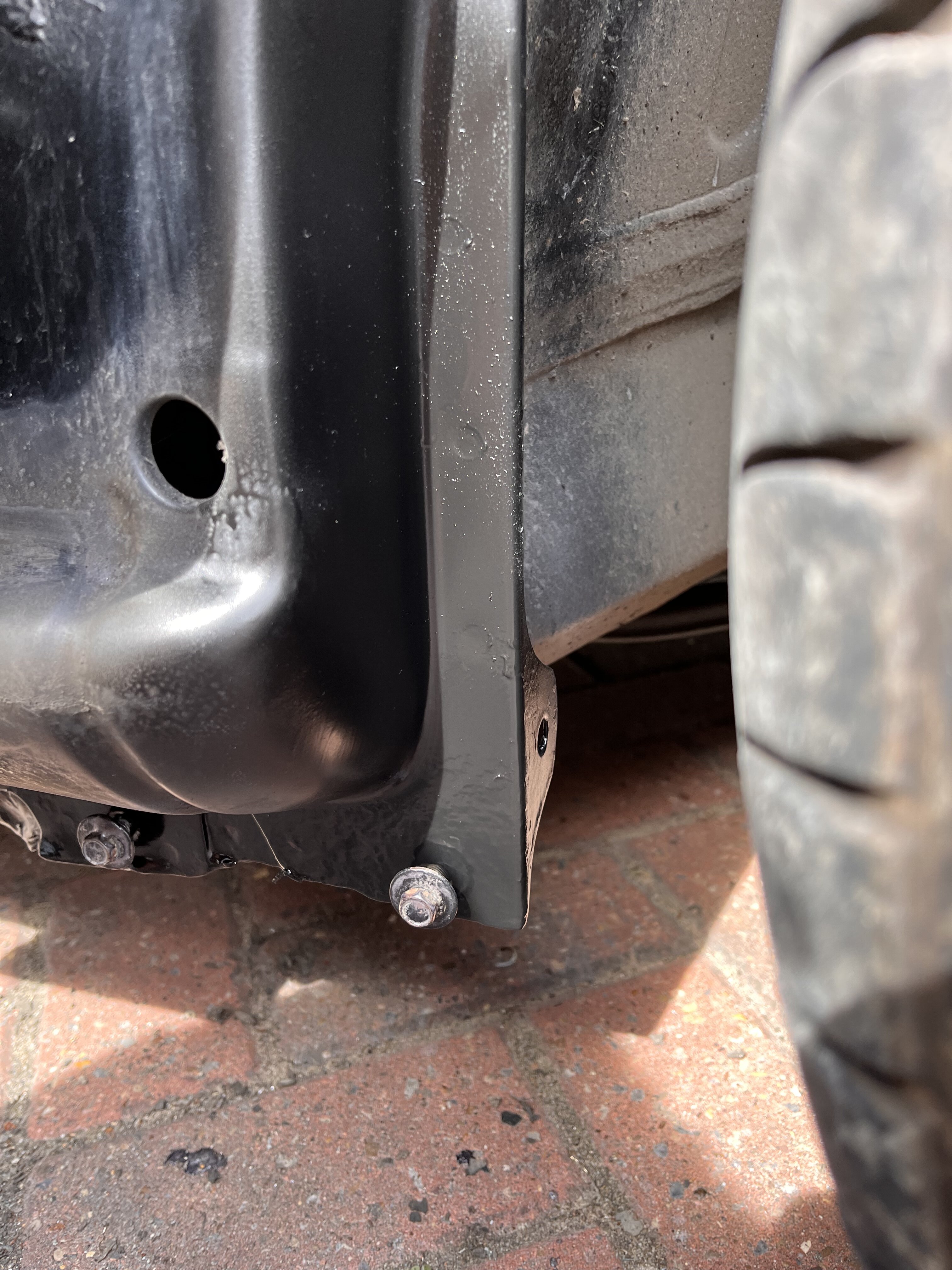

Sorted the sheared bolt in the rear arch, was way enough to drill the old one out and replace. Sealed the hole with under seal and sikaflex and used an old liner clip to hold the trim securely in place, actually really pleased with the outcome.

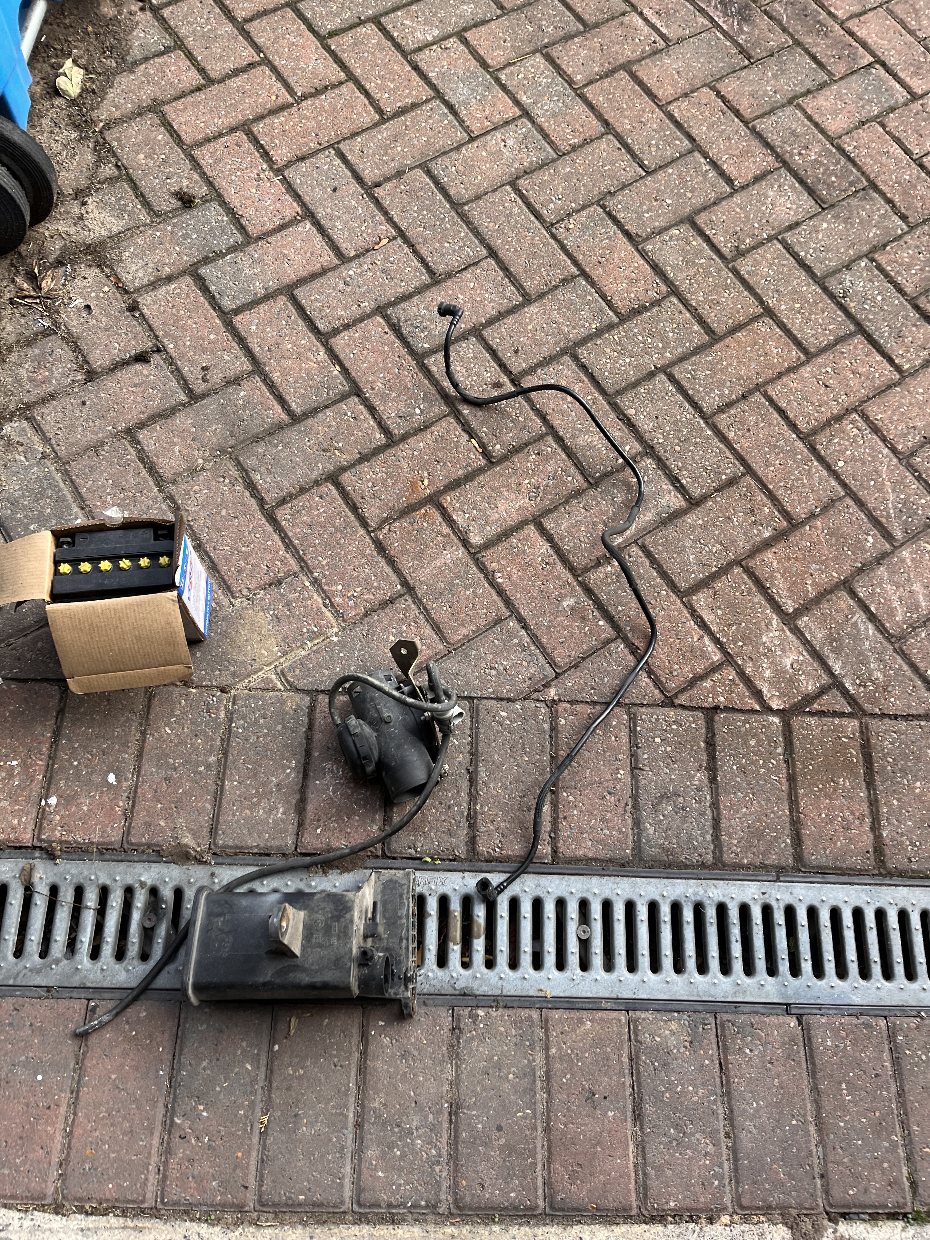

I also removed the washer bottle as I wanted to sort the rear washer not working and as I removed the spoiler realised the issue was the hose was squashed under the spoiler hence no flow so an easy fix.
So I took some time to clean things up and put it back together including finding a new bolt to hold the washer bottle in place as there wasn’t one in there.

New parts were here when I got back from London and the top mounts have been replaced.

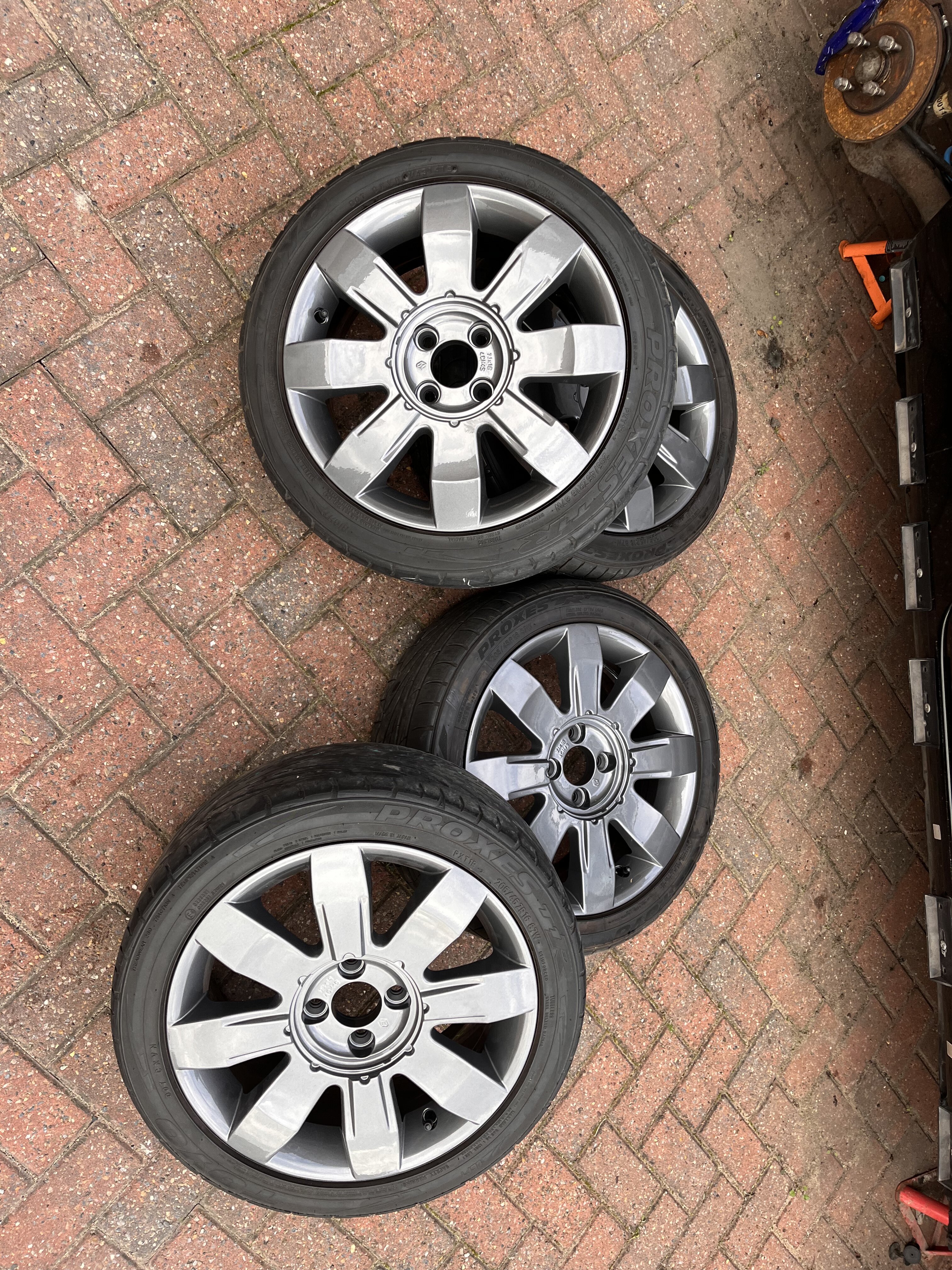

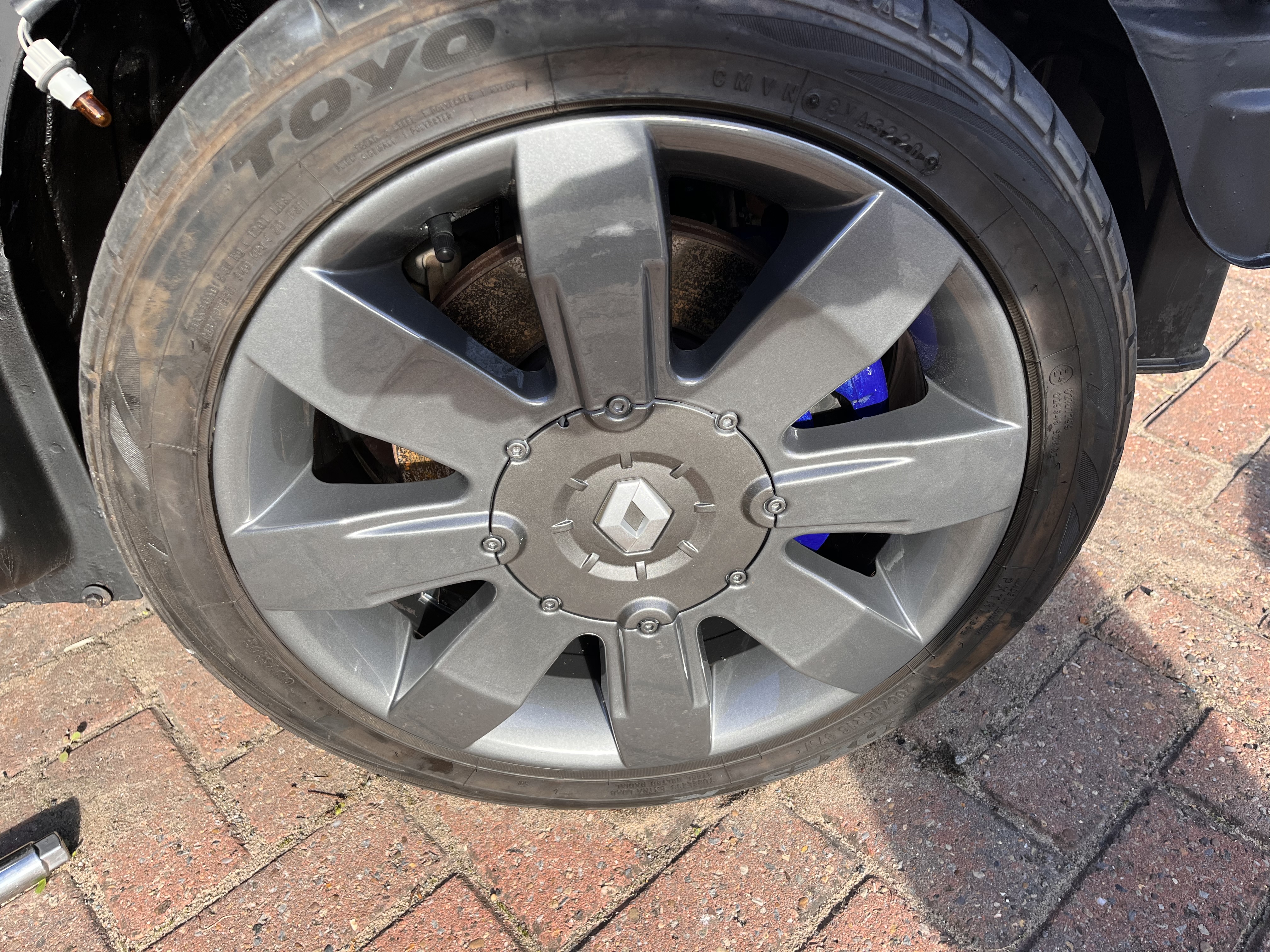

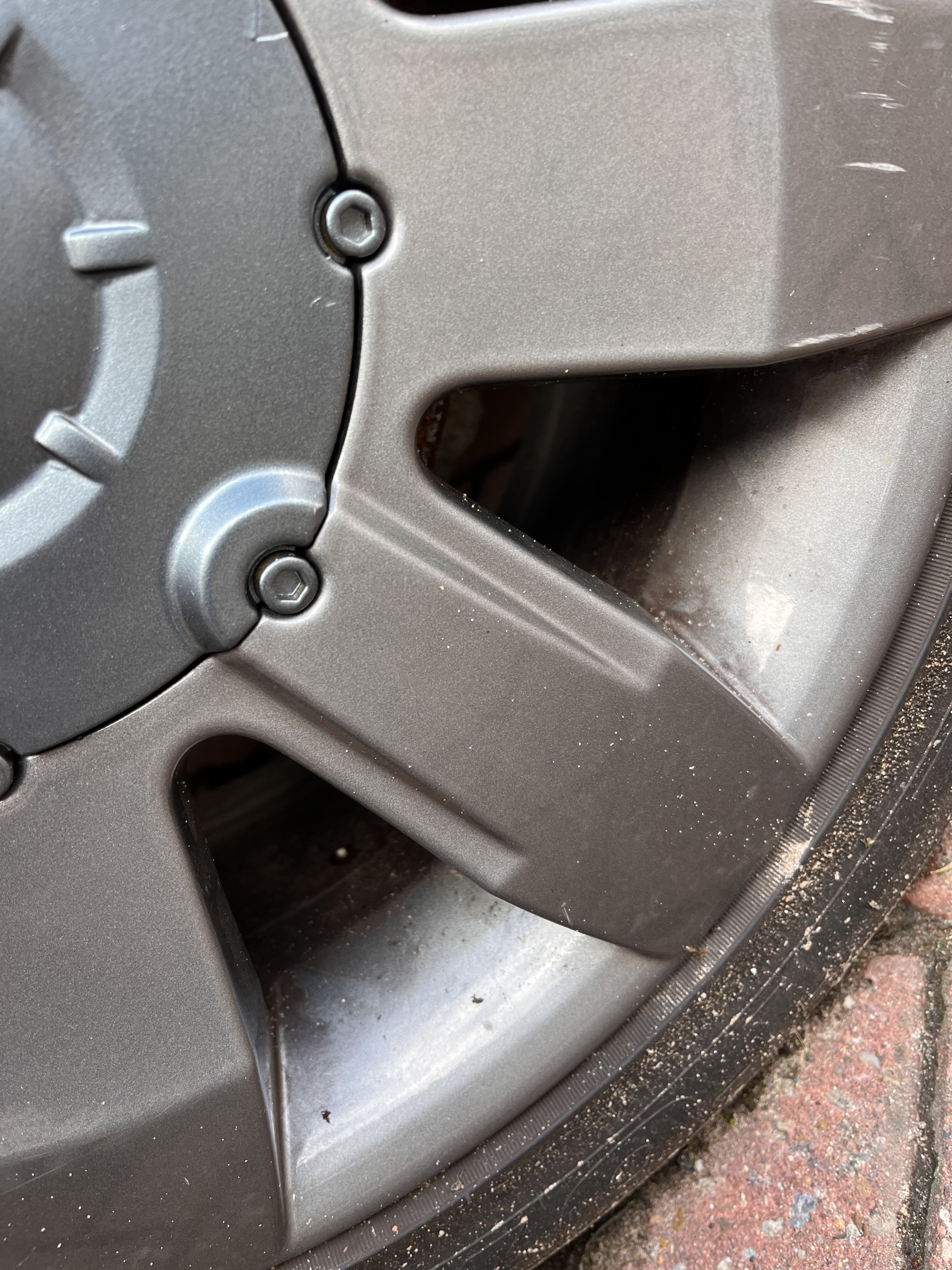

Also got the wheels back from powder coating really happy with the result and the centre caps are a pretty close match as well.
So it’s back on 4 wheels but I’m still waiting on the bumper and wing, hoping it’ll be ready next week. Could do with getting the MOT booked.

Sometimes this cars does things deliberately to wind me up. I’ve removed the hoses for the headlight washers as I’m not keeping them, turn out you need to blank the pump as well otherwise it leaks…
so wipers and washer bottle off again. Now should be fixed…. Again.

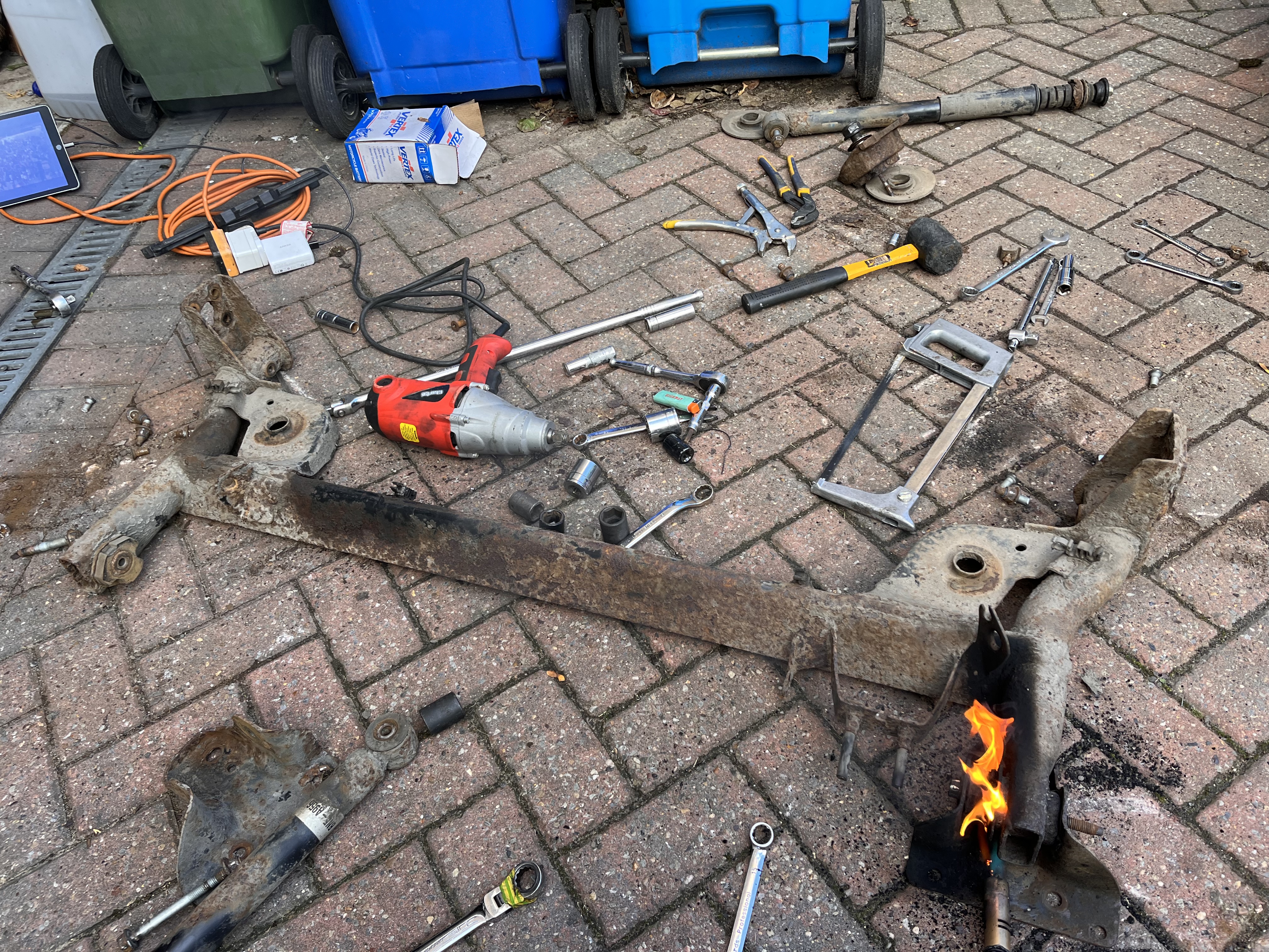

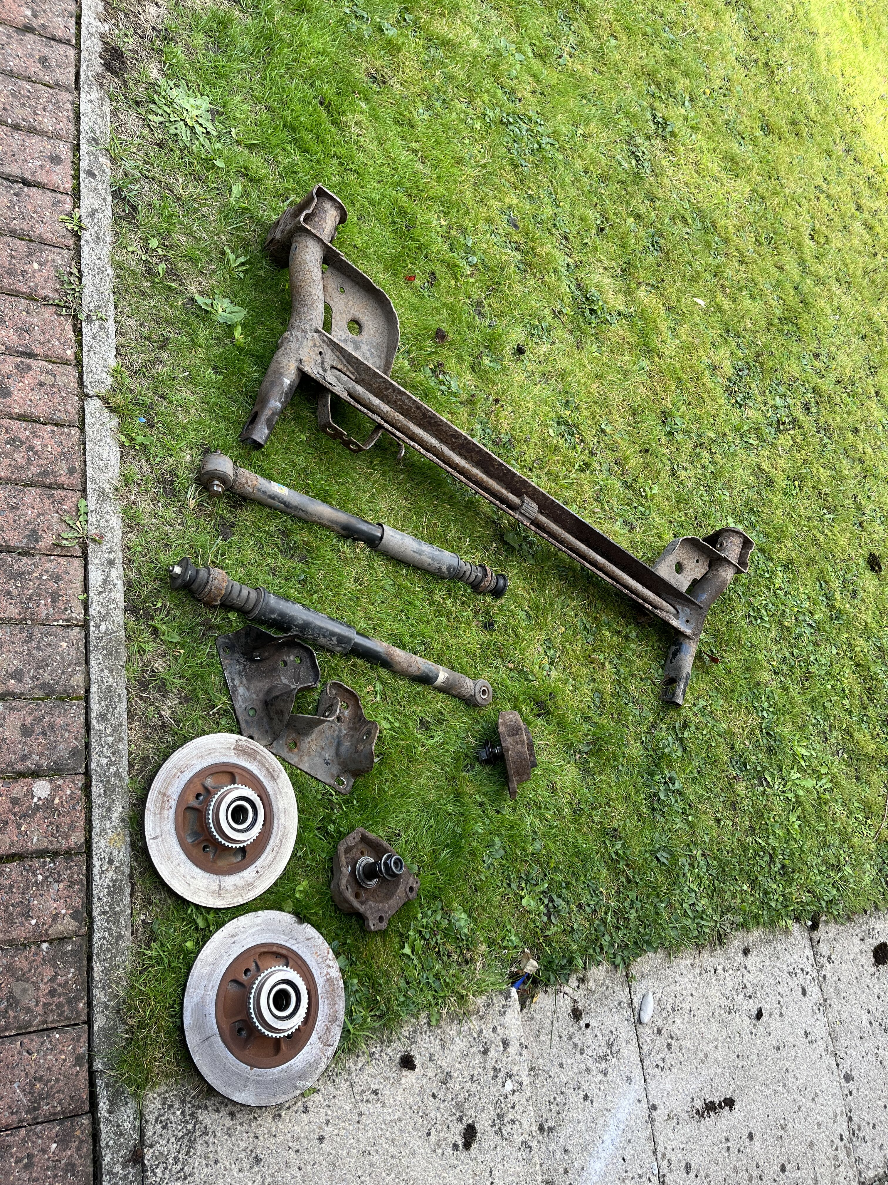

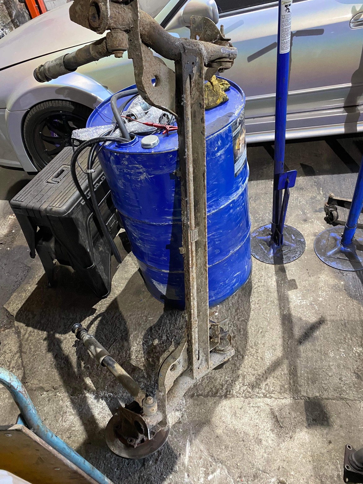

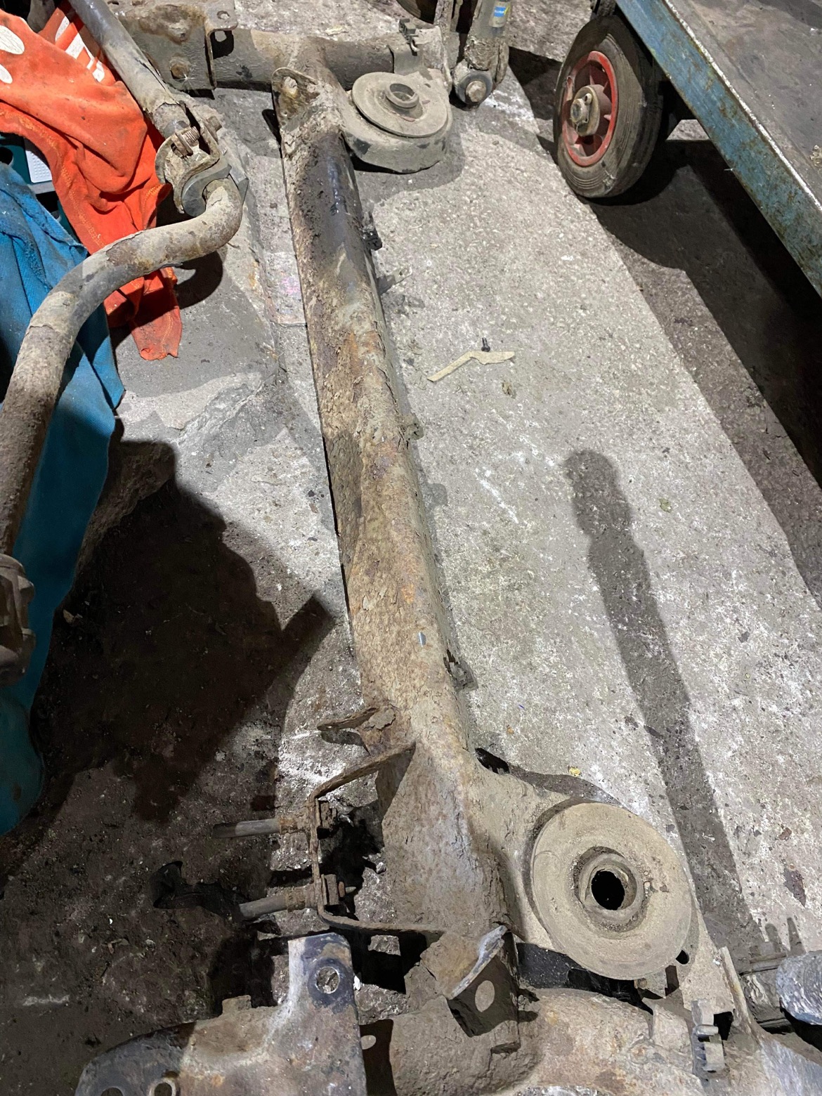

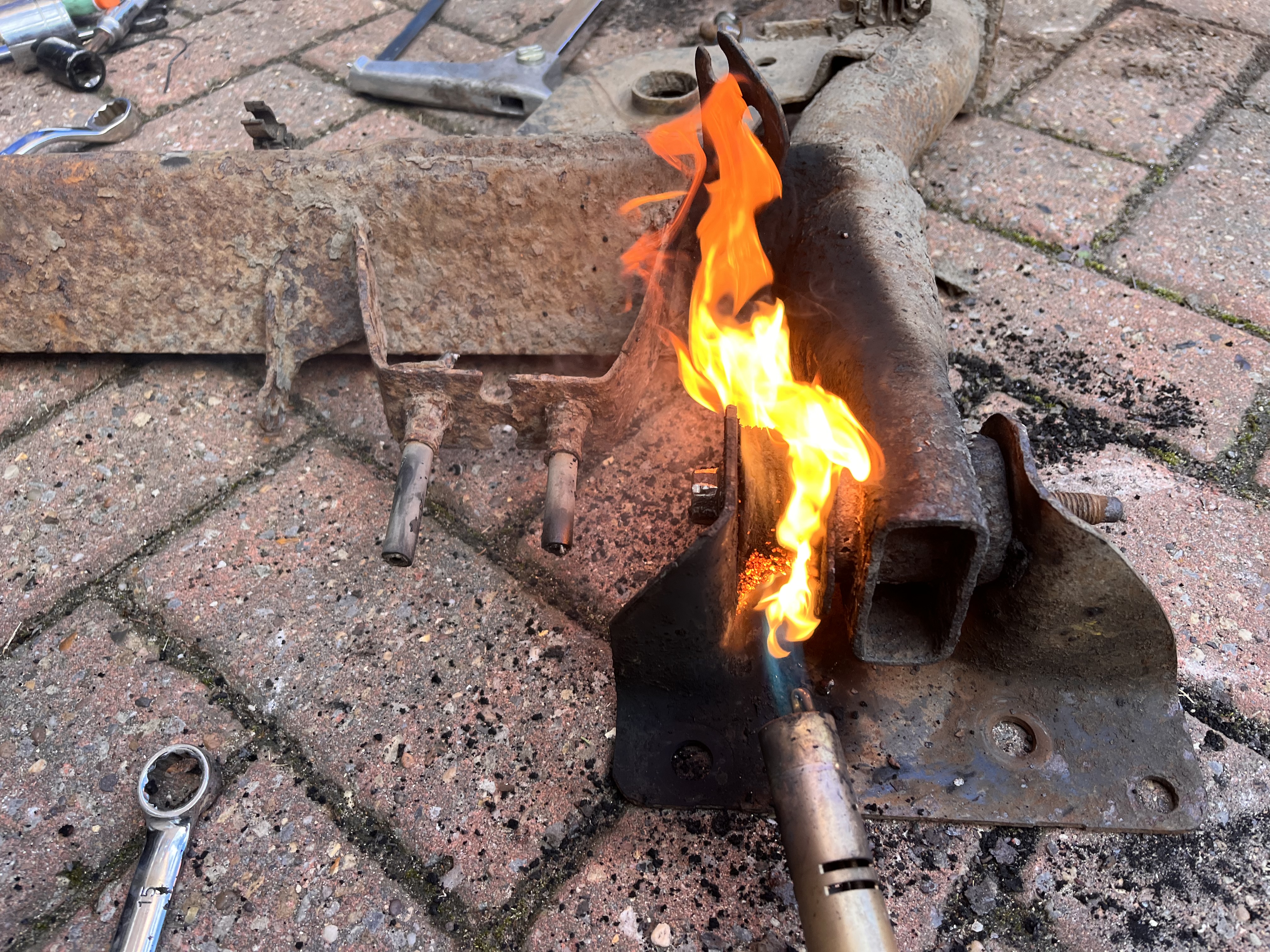

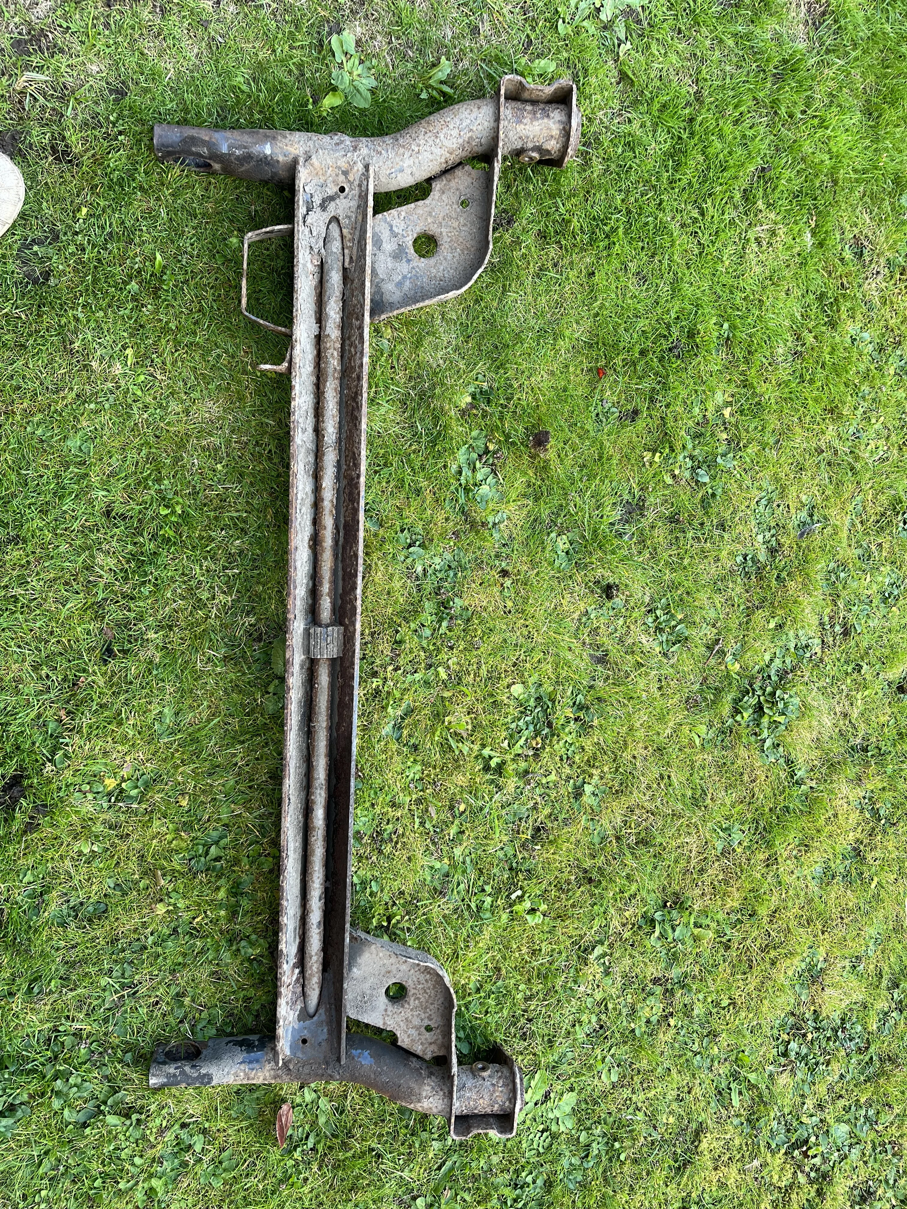

Having picked up some odds and sods in the week I spent some time getting the rear axle ready for dipping and powder coating. Wasn’t without its battles but all told not an horrendous job.
This is fine, everything’s fine….
One question I have is around the bar underneath, does that need to come out / can it come out?
Also, tell me you own an old French car without telling me you own an old french car.

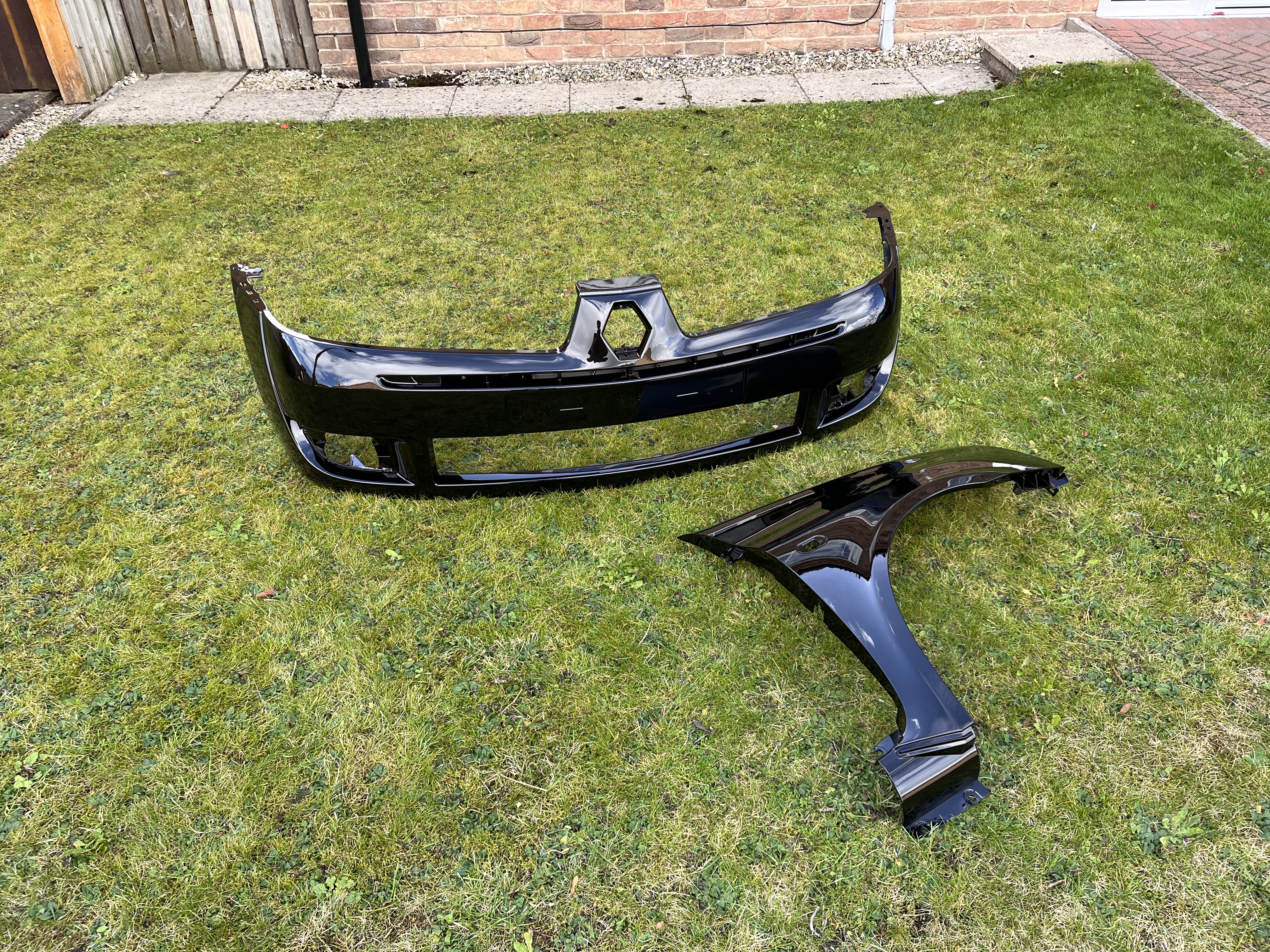

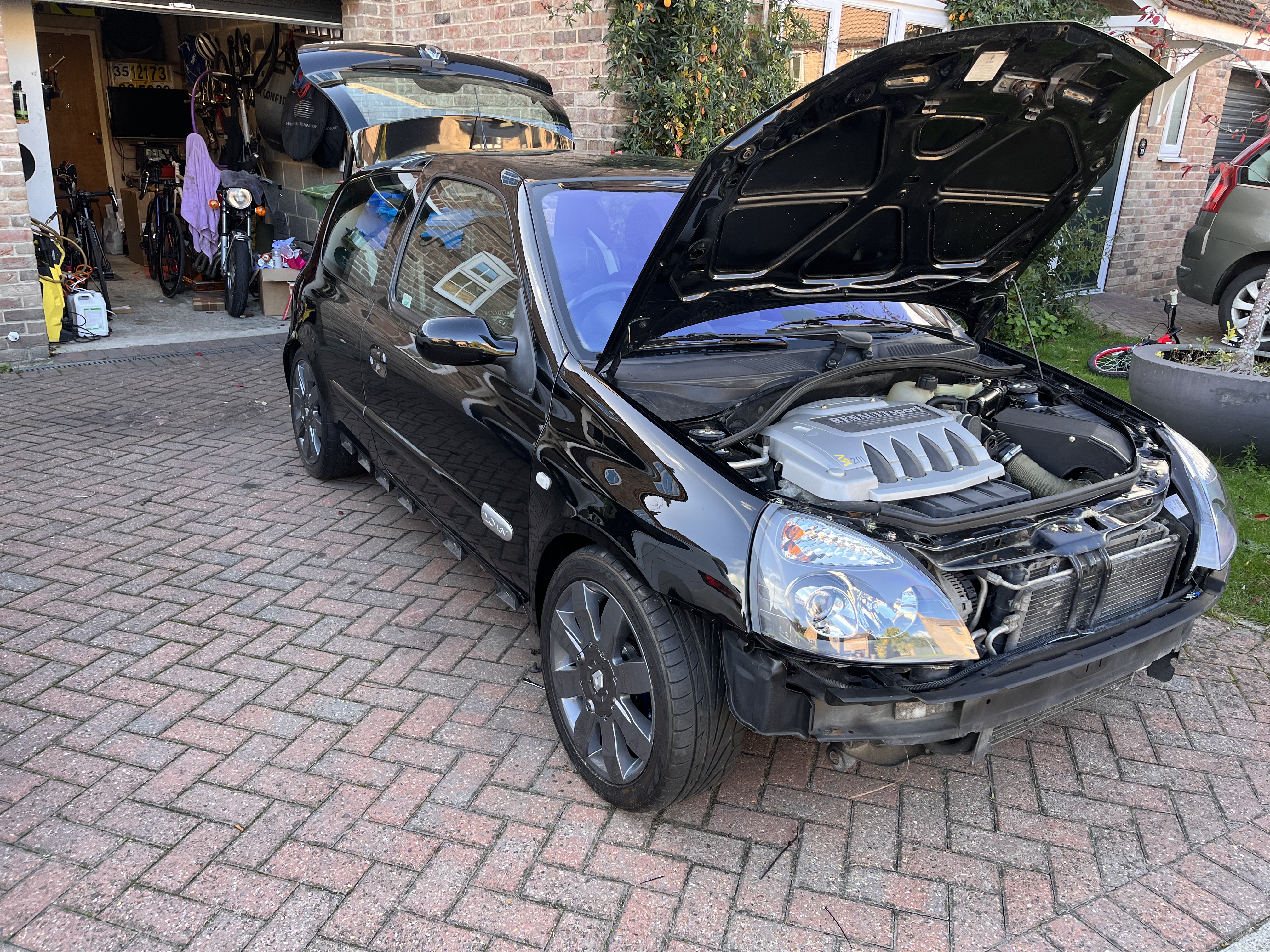

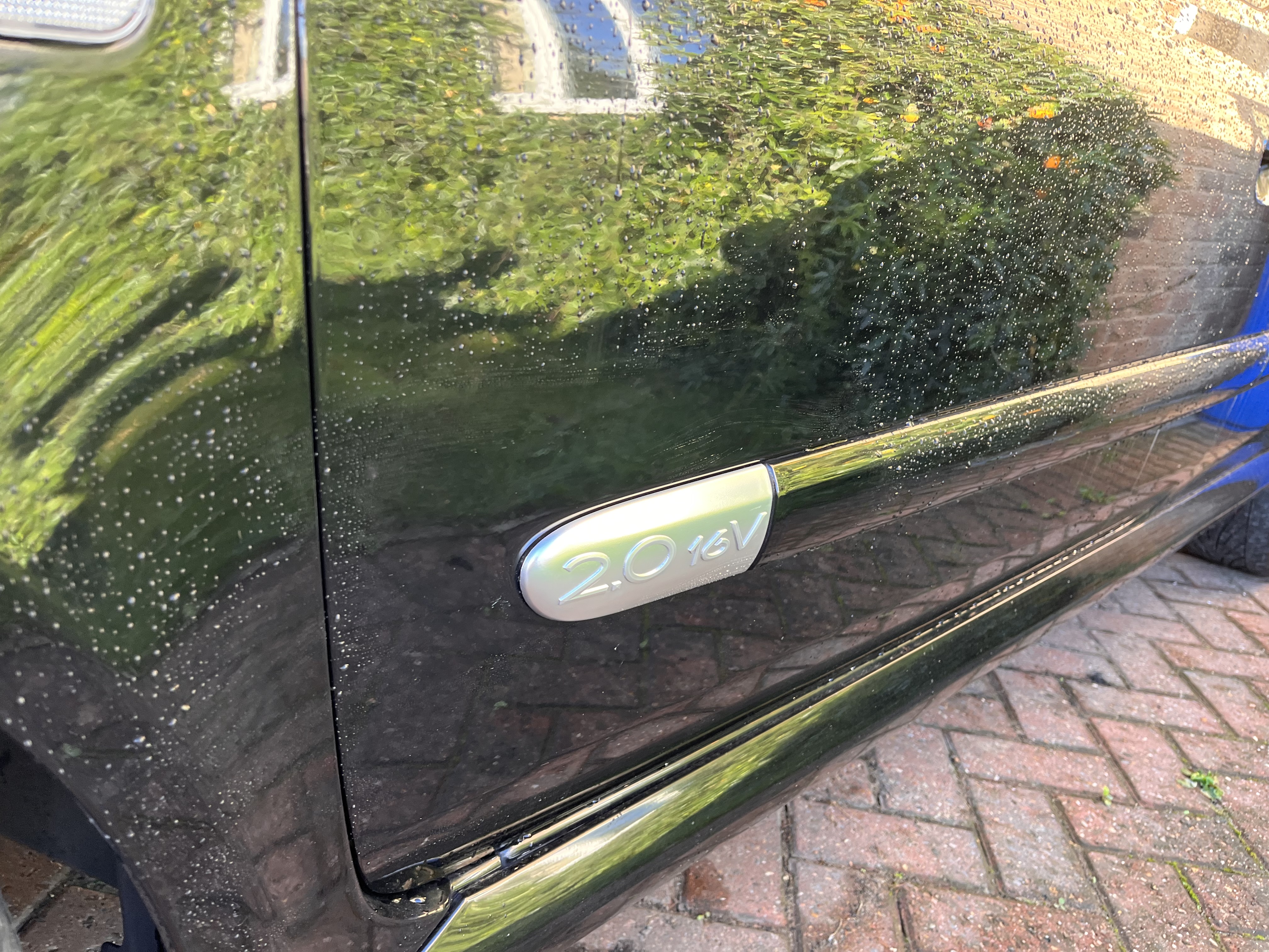

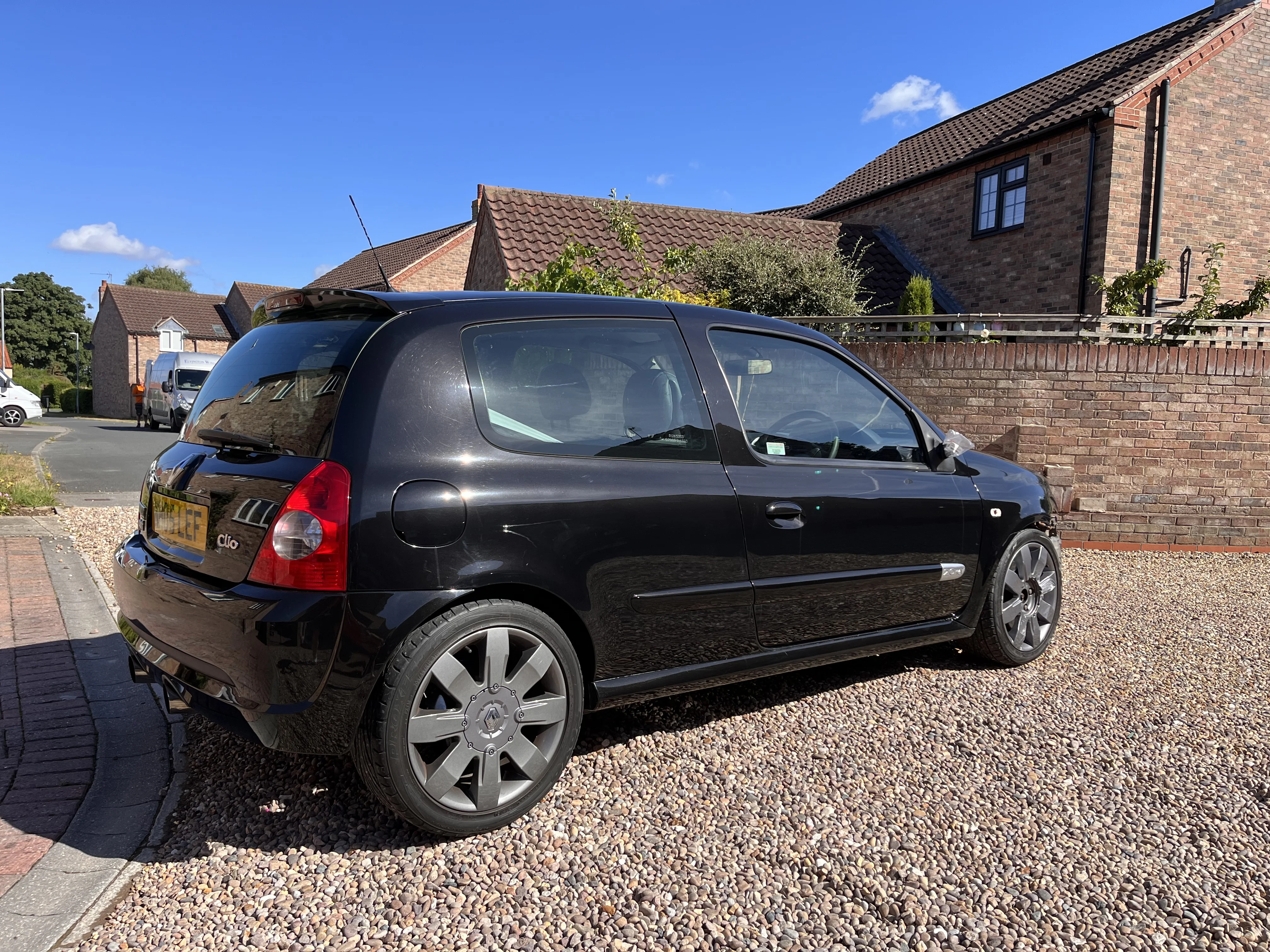

Finally. The panels are back, it promise on the edge to edge match but I’m not too fussed as I’ll be getting some more work done anyway and we can worry about a better match then.
I’ve also removed this rubbish and tidied the cables etc away,
So got to building it back up.
so there we are, almost there.
The front end looks mint! The clean fogs really set it off, need to sort mine out at some point.
Thanks. Yeah, the new headlights and fogs make it look really fresh, the bonnet is shocking when you get close, so many stone chips, that needs painting as well.
A small detail is the lack of washer holes… really tidies up the front end. My friend just did it as the blanks I got look crap. Really happy with it and easy enough to drill out if needed.
