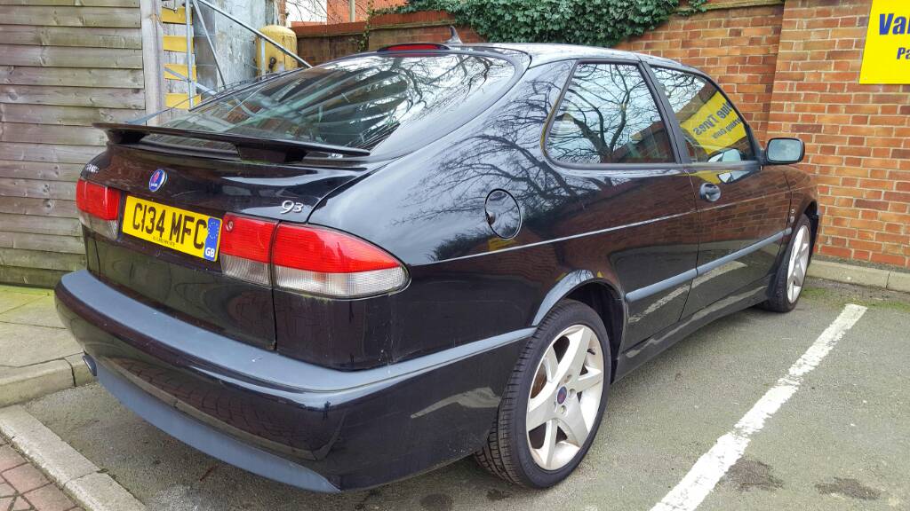

While the track Clio is tucked away hibernating for winter I've been playing with my Saab Turbo. Bit of a marmite car but to me i see a cool 90's car, plus it used to belong to a friend of mine that sadly passed away ealier this year.

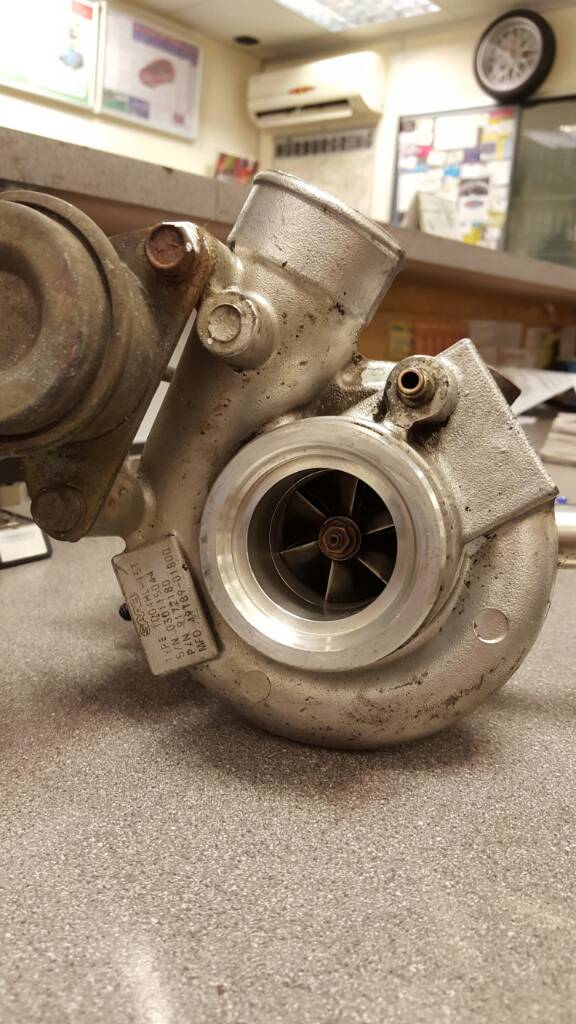

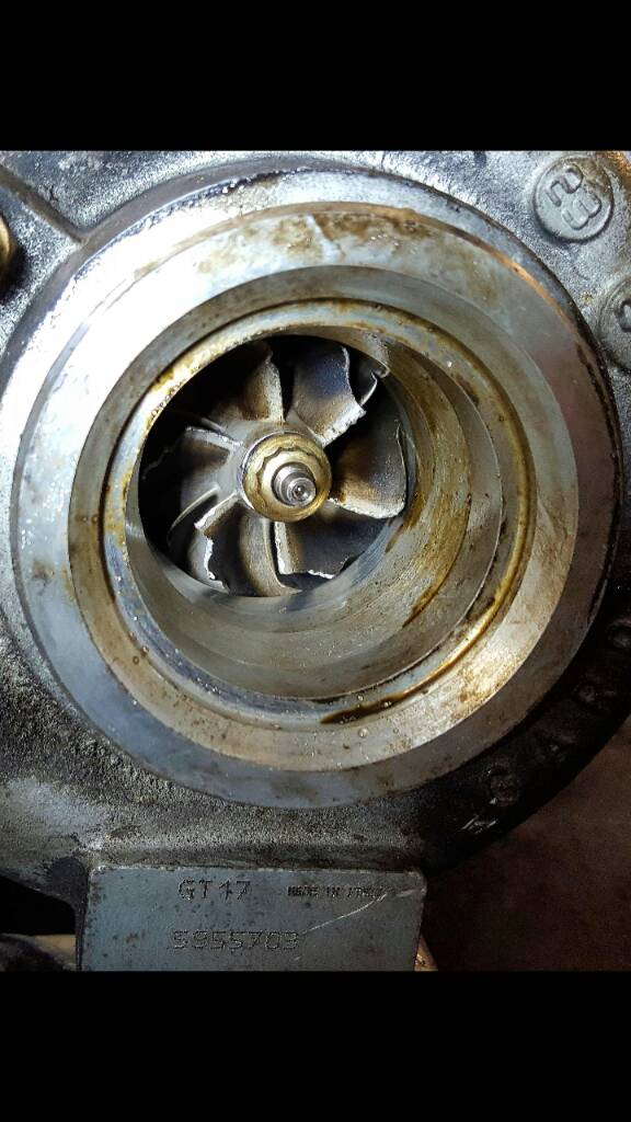

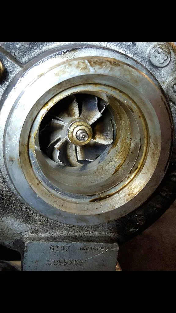

It had been sat for over 6 months before i pick it up and on the first drive the turbo failed causing thick clouds of smoke from exhaust.
I currently have the turbo off and awaiting a replacement TD04 which is an upgrade in preperation for running higher boost.

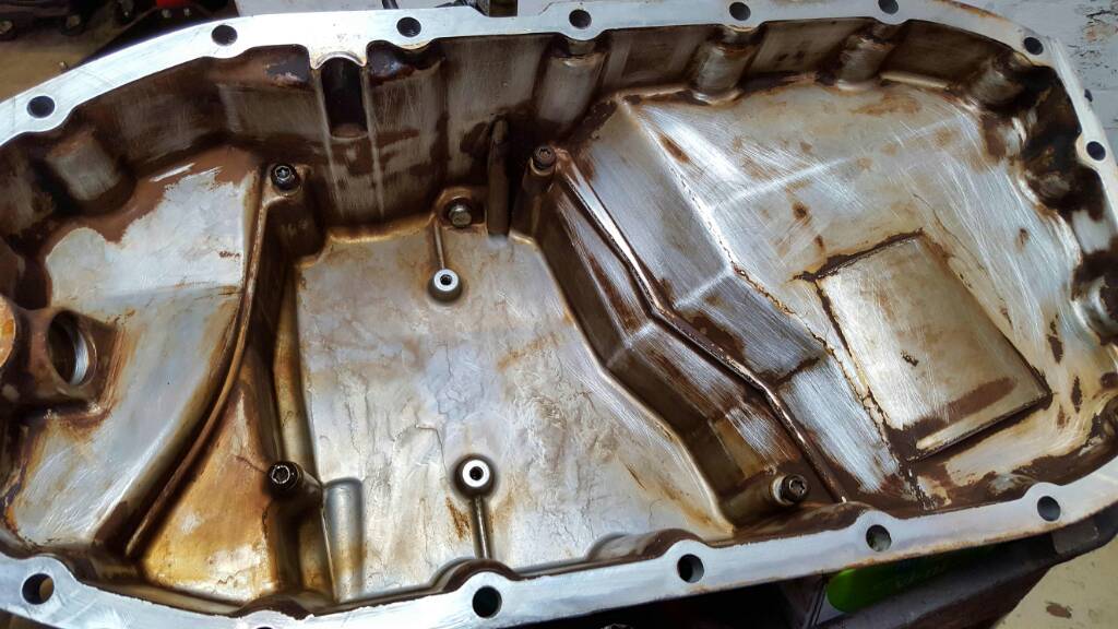

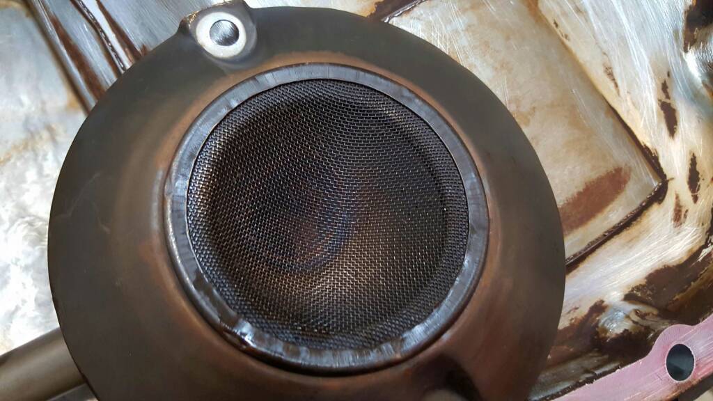

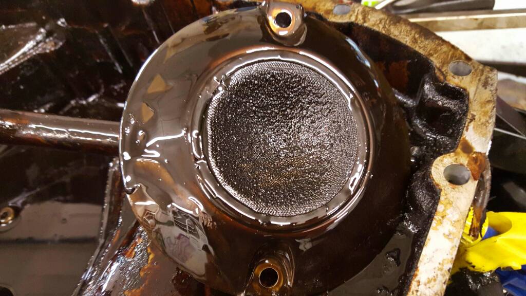

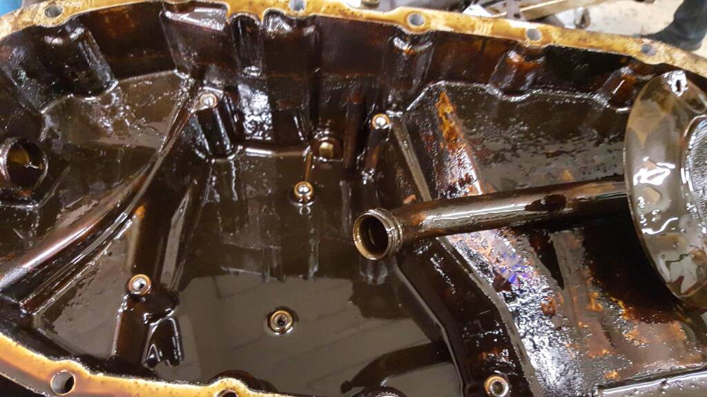

While the turbo is off ive also removed the sump as the oil strainers have a habit of blocking up on these engines
And mine was no exception lol
Stripped and clean now

Apparently the sludge issue is due to fully-synth oil.......or maybe not using fully synth......one of those. Can't remember, but I've looked into this quite a bit over the last decade. Really want one of these before they all become either sheds or prissy, overpriced show-cars.

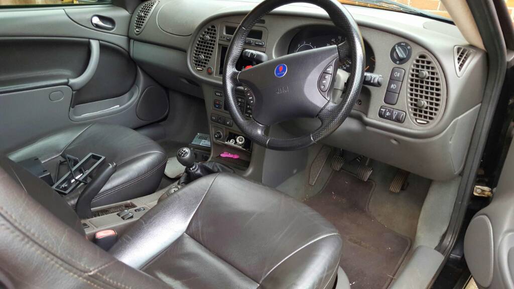

I see you've also pulled the stereo, are you changing that for something else? in which case, let us know if it's a bugger about, because I swear I saw something about external amps etc.

I'd image a combination of wrong oil and lack of oil changes, but this is now going to change.
I'm toying with the idea of fitting a double din and from what i can see it all looks like standard ISO connectors. I'll look into this further when its up and running.

Yeah, I think you might need to do a bit more than just clip in a new unit.
As said, I could be wrong here, but I suspect the speaker-out lines actually run to discrete amplifiers. so you'd need to splice the RCA outputs on your headunit into the ISO.
Depends on what the stock kit was, there were 3 or 4 different stereo set-ups, some more elaborate than others.

Apparently a far more reliable turbo than the Garrett GT17 which is now only useful as a paper weight.

So the TD04 charger has now been installed and delivers the power nicely. No more oil pressure warning light either.

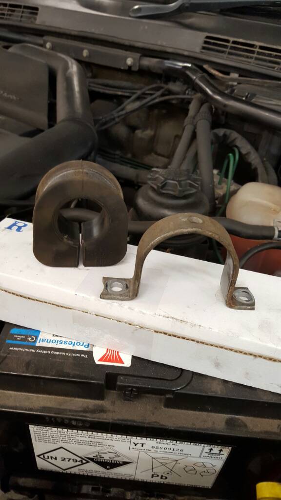

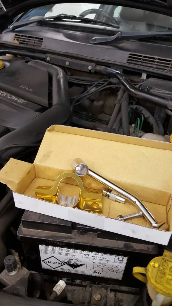

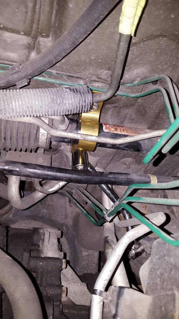

These early Saab's have notoriously poor steering response due to a flimsy steering rack mount. This evening i fitted a modified clamp and brace bar supplied by Parts For Saabs.
The old flimsy bit of tin and soft rubber mount, verses the new mount kit
Doesn't look like much but it has really made a difference. Improved steering feel and reduced torque steer has made it much nicer to drive. Still got further improvements to make to the chassis and suspension.
