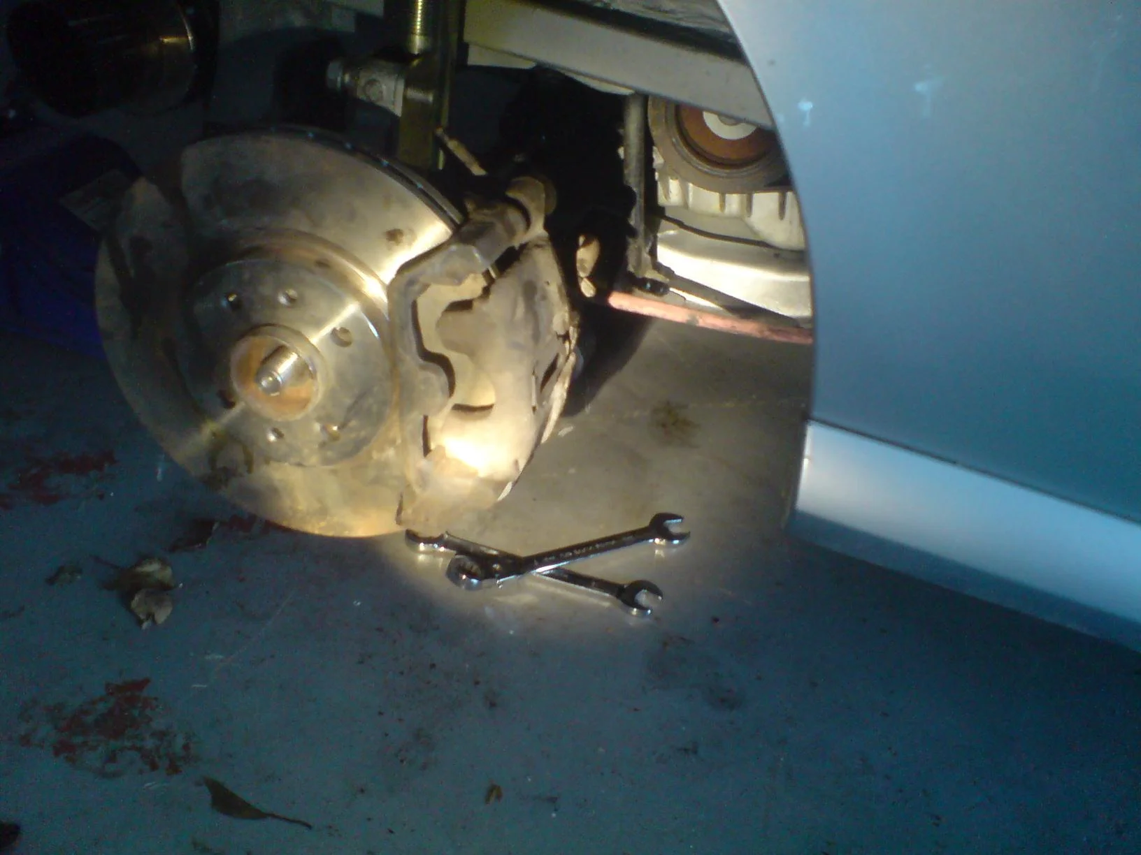

brakes so far from a citroen fwd handbrake:)

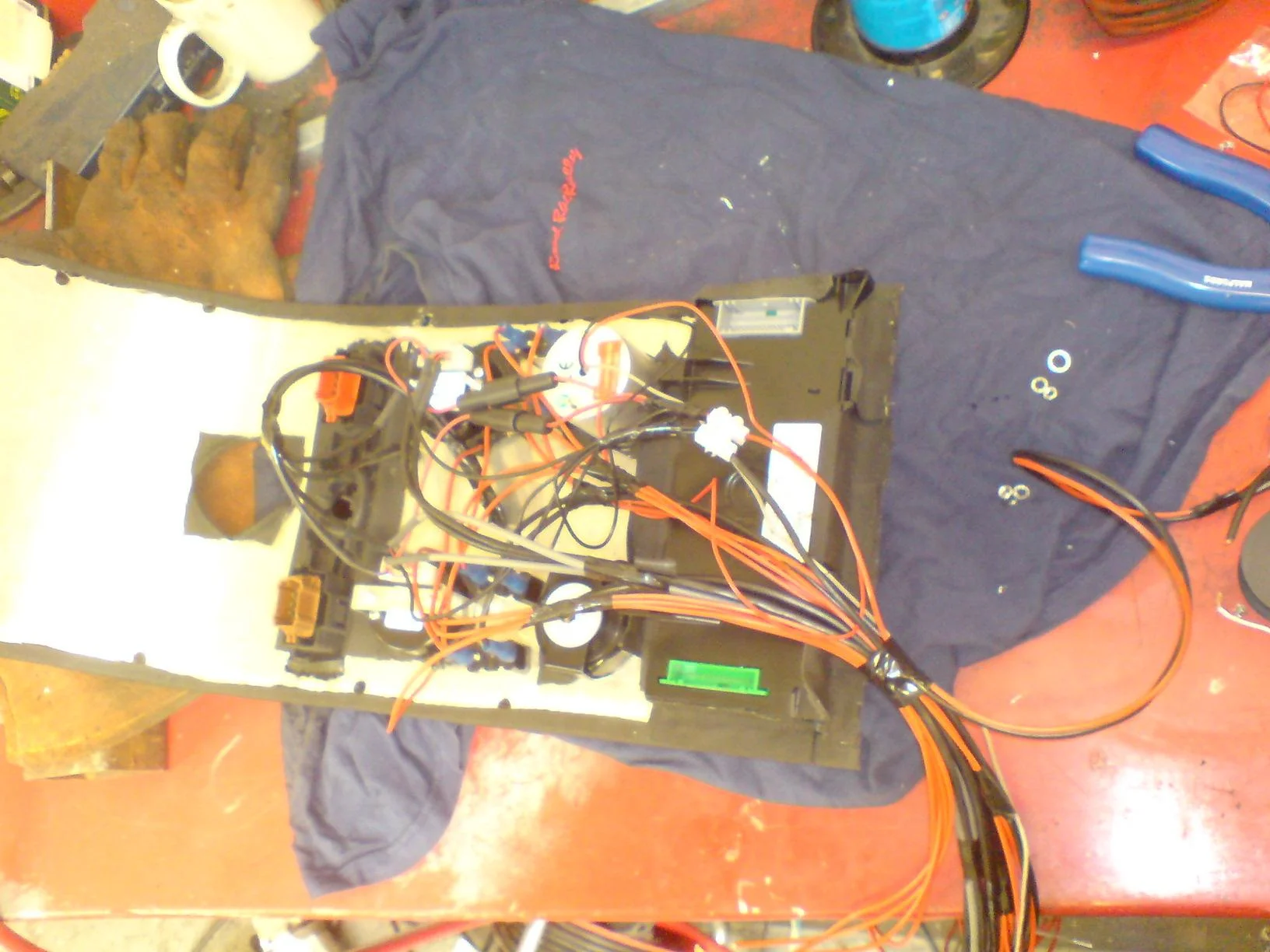

Re: 80% complete 172RWD! - updated
some new ones.
have new vids too which sould be up later.:approve:
