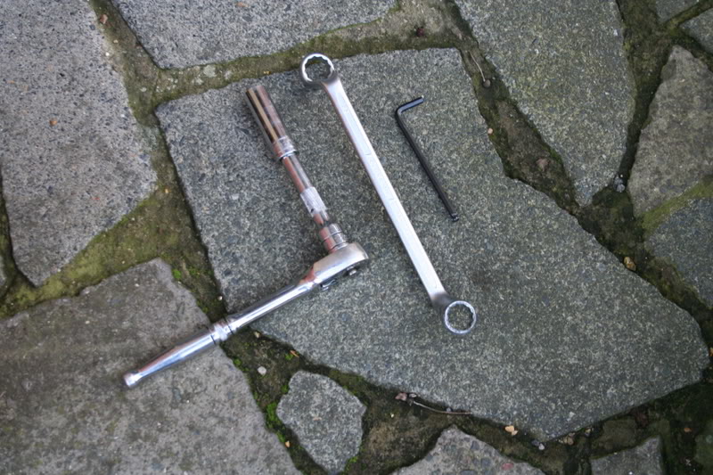

Tools you will need for this -
5.5mm Allen key
21mm Deep Ring Spanner
or 21mm socket and rachet (1/2inch is better)
So in pictures.
Tools all lined up ready to go.

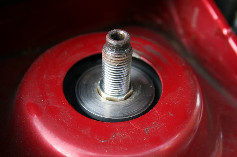

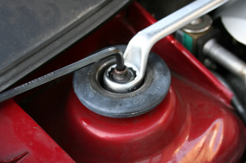

Need to undo the top nut - The Allen key is vital here - So do not attempt without it.
Put Washer in place.

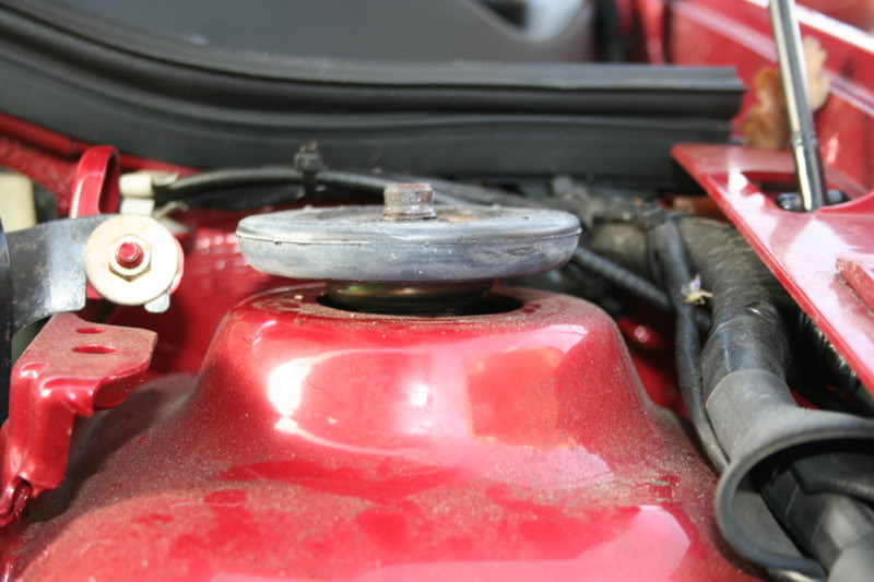

This is how it should look.
Put the rubber doughnut thing back on again as well - The 3mm Washer clears the doughnut off the turret as seen above.

right guys i have got mine coming soon the guide seems straight forward can i just ask how hard do you actually re-tighten the nut back up do you stop straight away when you feel is get alot stiffer dont want to break it and make it worse ha ha.
  111s
I'd just do the reverse of undoing it. Use the allen key to stop the strut turning and tighten against that using the deep ring spanner.
Thats how i'm planning on doing it anyway.

arrrggggg!!! just bought a 21mm spanner and it dont fit it is too big!!! bugger what a waist of money to halfrauds!! he he are we sure its defo 21mm also if you use socket wrench how the hell do you use the allen key?? does it come in a later stage of removal or something cheers
davo172
  TCR'd 172
you need a long swan neck spanner put the allen key thru it to sop the piston turnin when you undo the nut.
