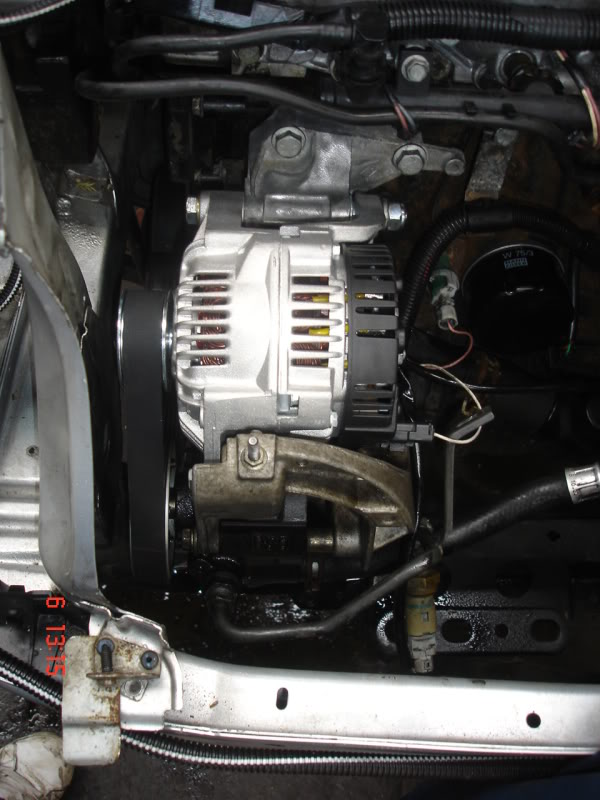

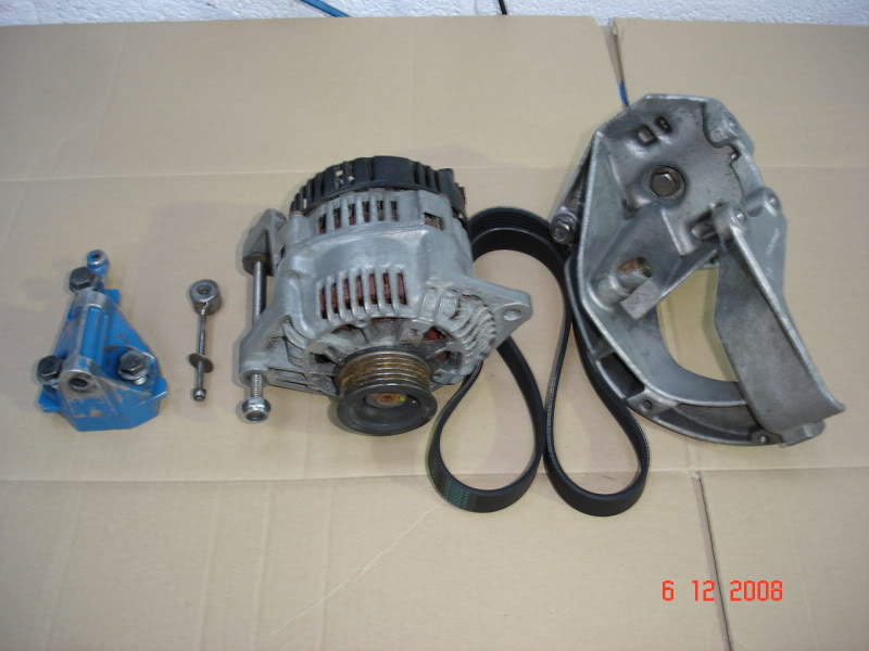

A 30 second google search gave me this........
All images from Cliosport.net
I've got the cup alternator, but the pas pump is above where the cup alternator should go ? I cannot fit alternator with the pas pump in the position it is now. On the pictures above the pas pump/pulley is below the alternator, whereas on mine the pulley/pump is above, (if that makes sense). I may go for a Pure aircon delete kit, (brackets+belt only), as I can return the alternator etc...
I've got those brackets, I've fitted the "adjuster" bracket on the car but the cup alternator will not fit because the pas pump is in the way.I could possibly remove the pas pump and fit it on the alternator bracket under the alternator. On the last image in your post on 20:02 you can see the pas pump bolted on below the alternator, on mine it is above.
Mine is similar to this:
http://www.cliosport.net/forum/show...o-172-Air-con-delete&highlight=air+con+delete
Nothing possibly about it, the pump must go under the alternator. the adjuster bracket is designed for it. Just do this............
Thanks for the reply. I may just go for the Pure kit, because it will work out cheaper, ( can take back alternator + belt), won't have to go to Pirtek for modified pas pipe and because with the pas pump now under the alternator there is very little room because I've got the small Polo rad and it may foul the fan frame with engine movement. Once again thanks for the advice and input.
