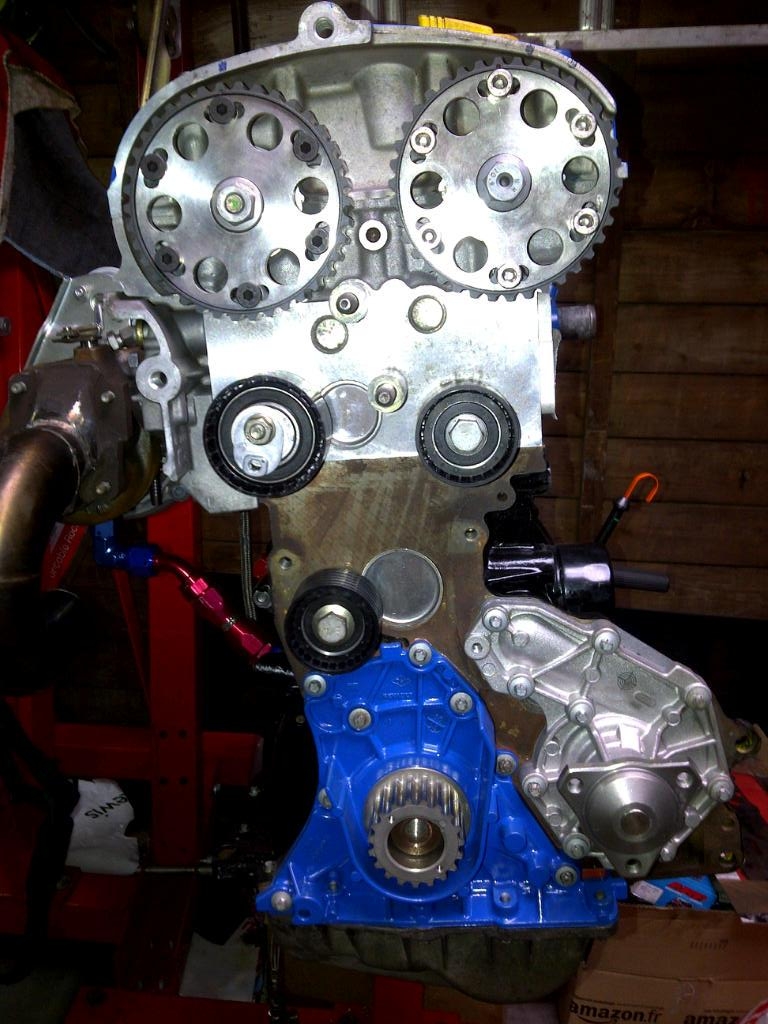

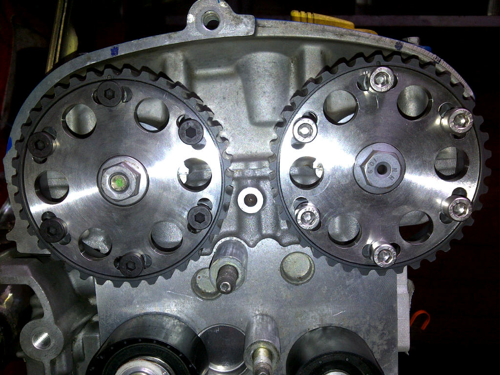

Both cam pulleys now sorted and fitted to the engine. Should give +/- 8deg of timing so we'll have a play and see what works best with the setup. The exhaust pulley needed modified slightly and uses shorter headed cap screws to clear the cover but all fits now with a couple of mm spare. Need to get it times up this weekend and build the engine up complete.

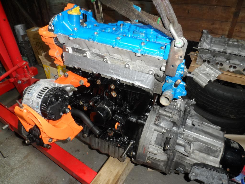

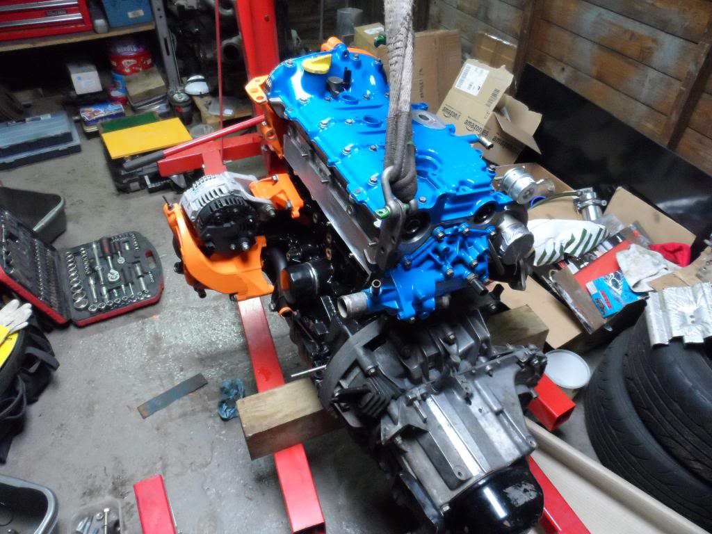

Got the engine all timed up and also got the alternator setup, clutch and box all fitted so basically, to complete the engine I need the inlet manifold welded up (want to size it in the bay to make sure everything is where it should be) and drill and tap some holes for gauge and a coolant sensors.

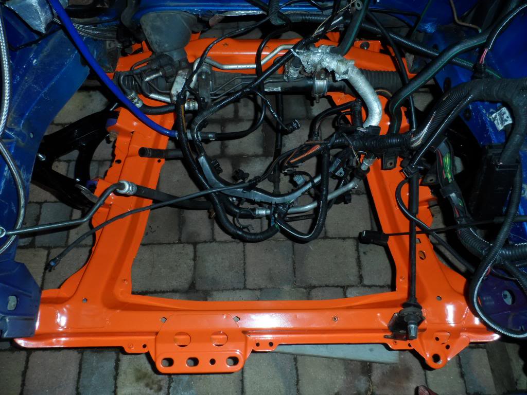

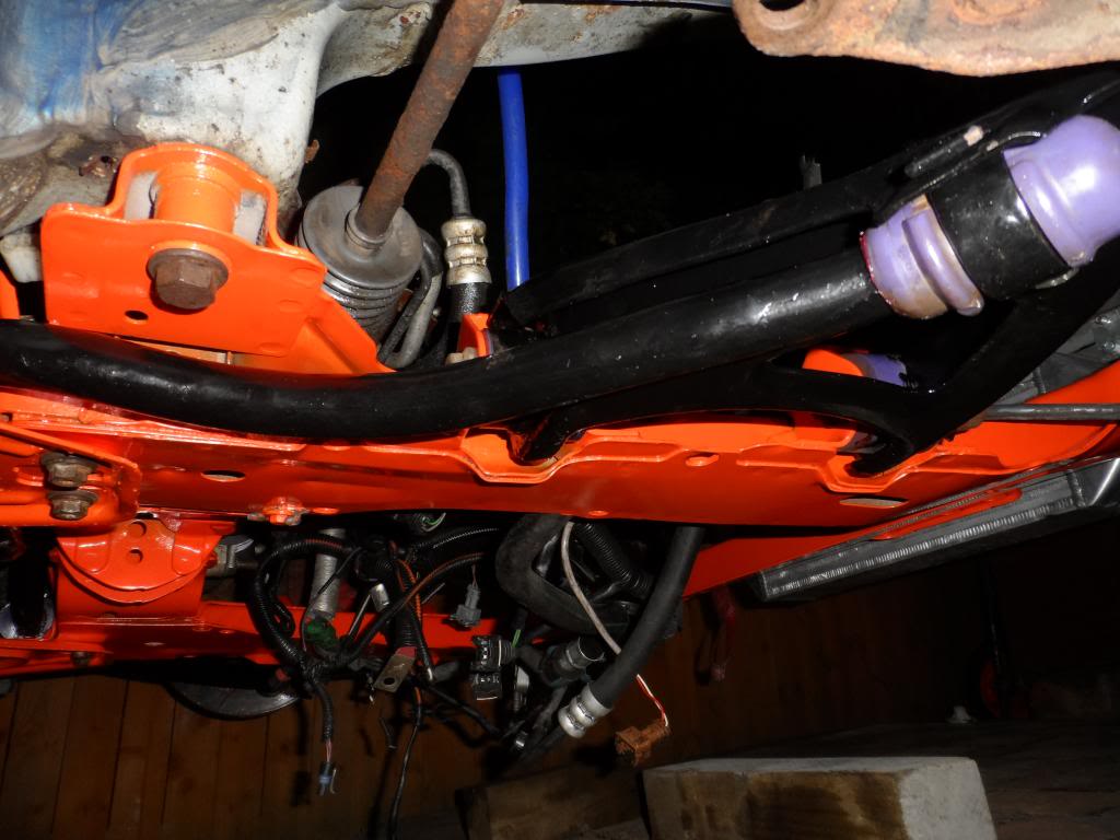

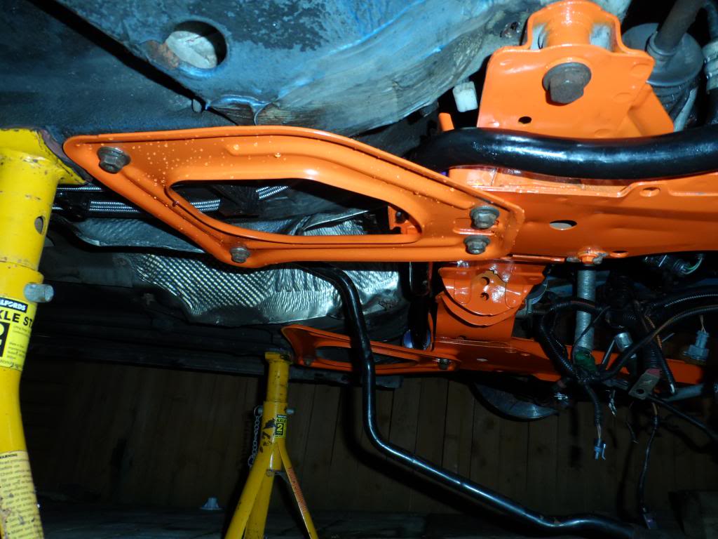

Got the powder coated parts back a couple of weeks ago including the cage and front subframe. The subframe was fitted after getting built back up with the wishbones, ARB and I must say, I like the look of it on.

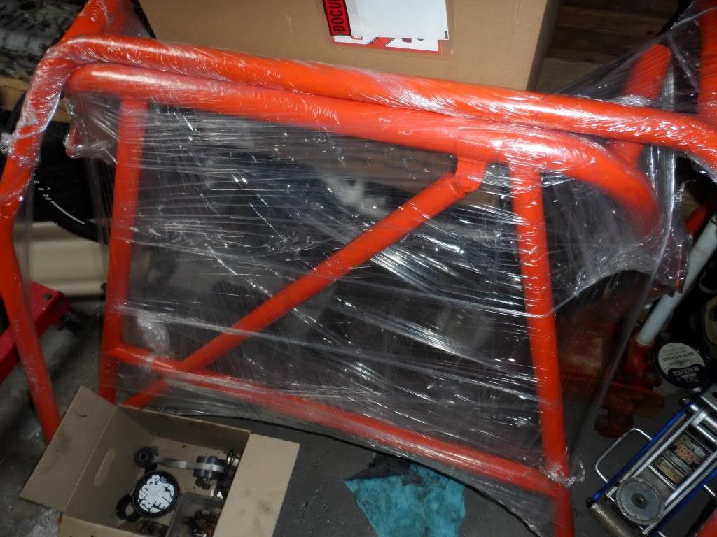

Cage still wrapped up to keep it good. It will be fitted after the interior is sprayed with some rattle can mondial blue.

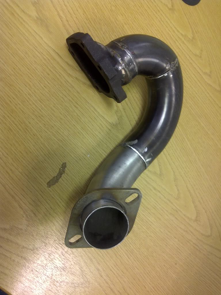

Not had much time at all lately to push the build on but have managed to get the engine in which has allowed me to see the down pipe hit the steering rack so that needed a rethink. There is not much room to clear the oil drain and also miss the steering rack but managed to clear both and end up meeting the decat flange which was an added bonus!

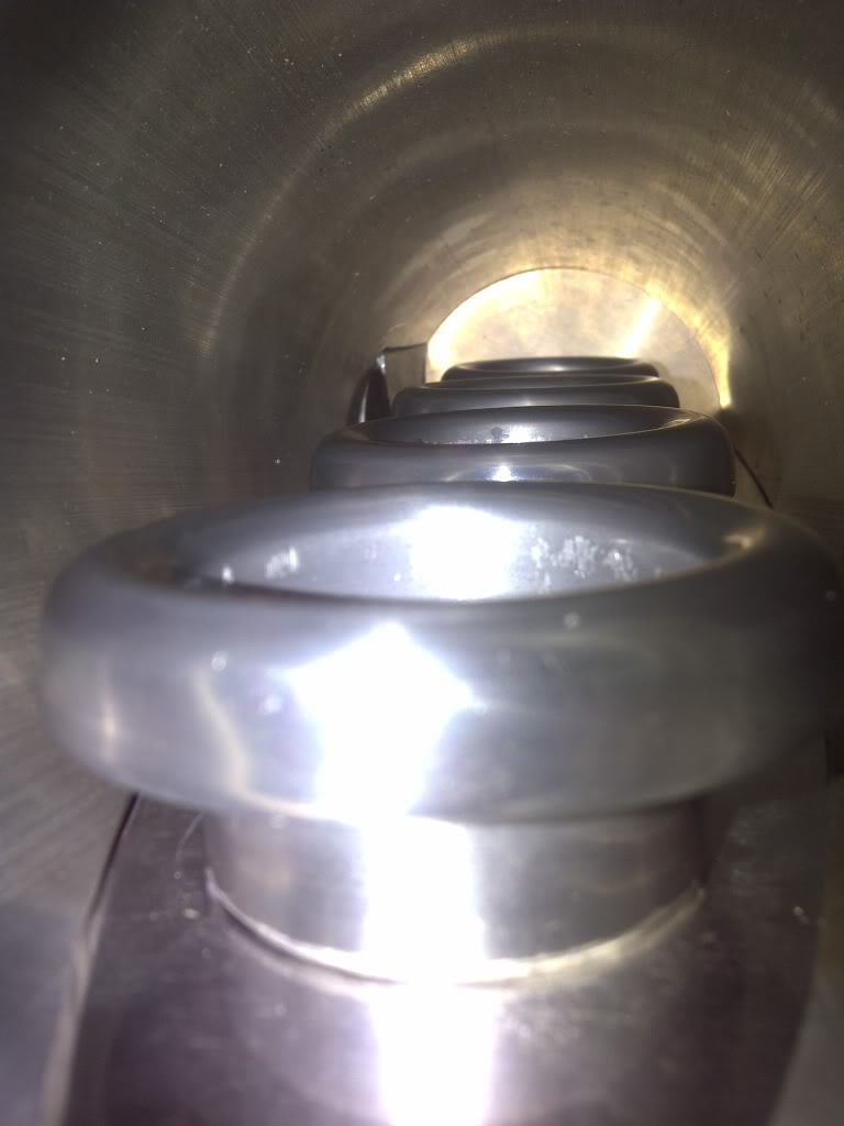

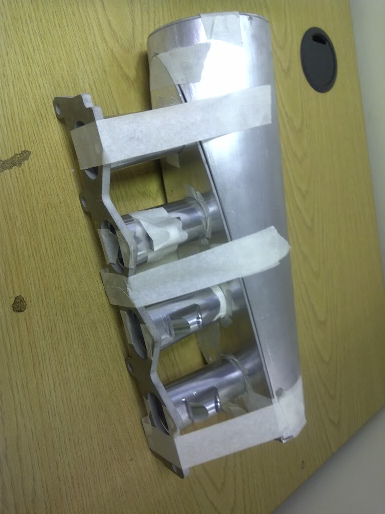

I have also managed to get all the parts made for the inlet manifold. I taped it all together to ensure it fitted and also to help my welder know where everything goes. The only issue with fitting was at the narrower end or the plenum, it fowled on the alternator bracket so I had to make some space for that. Hopefully you get the idea. Getting picked up today so should be back by the end of the week. Just need to complete the fuel rail and another few bits and pieces then finish building up the rest of the engine bay.

There definitely is no room for the down pipe to be anything other than perfect. I was playing with mm to get it just right so I'm going to get another pipe made up with a screamer pipe now you've got me in the mood for one. :p

It was hard enough to fit a 2.5" downpipe in nevermind anything bigger. It would only work about the spring pressure in the actuator which is about 0.5 bar of boost.
