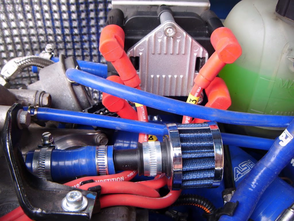

Got some NGK PFR7G-9 plugs fitted yesterday and then put on the Magnecore leads. If anything, they look good but I'm sure they will be better than the standard 7mm leads!

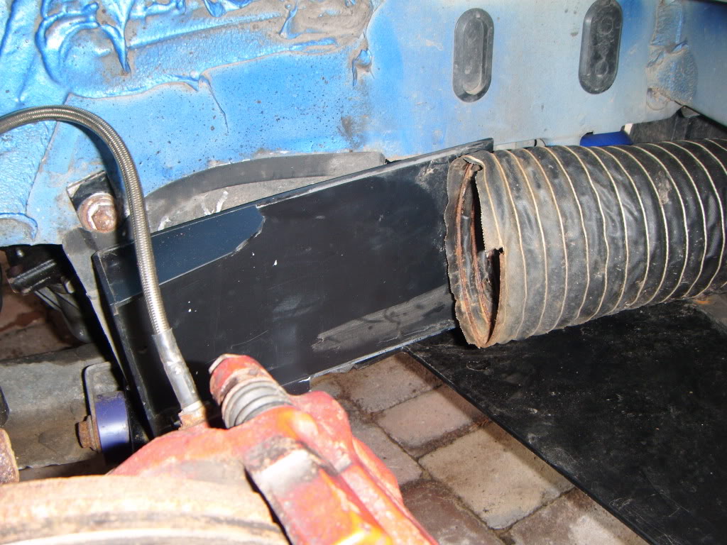

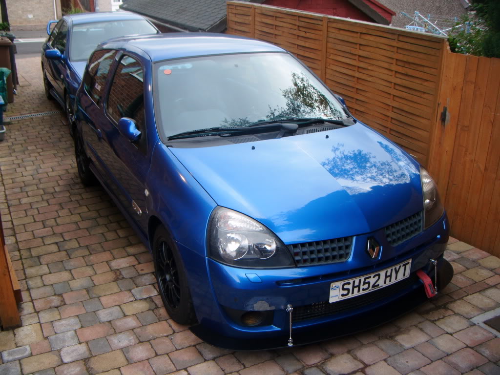

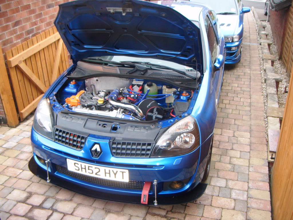

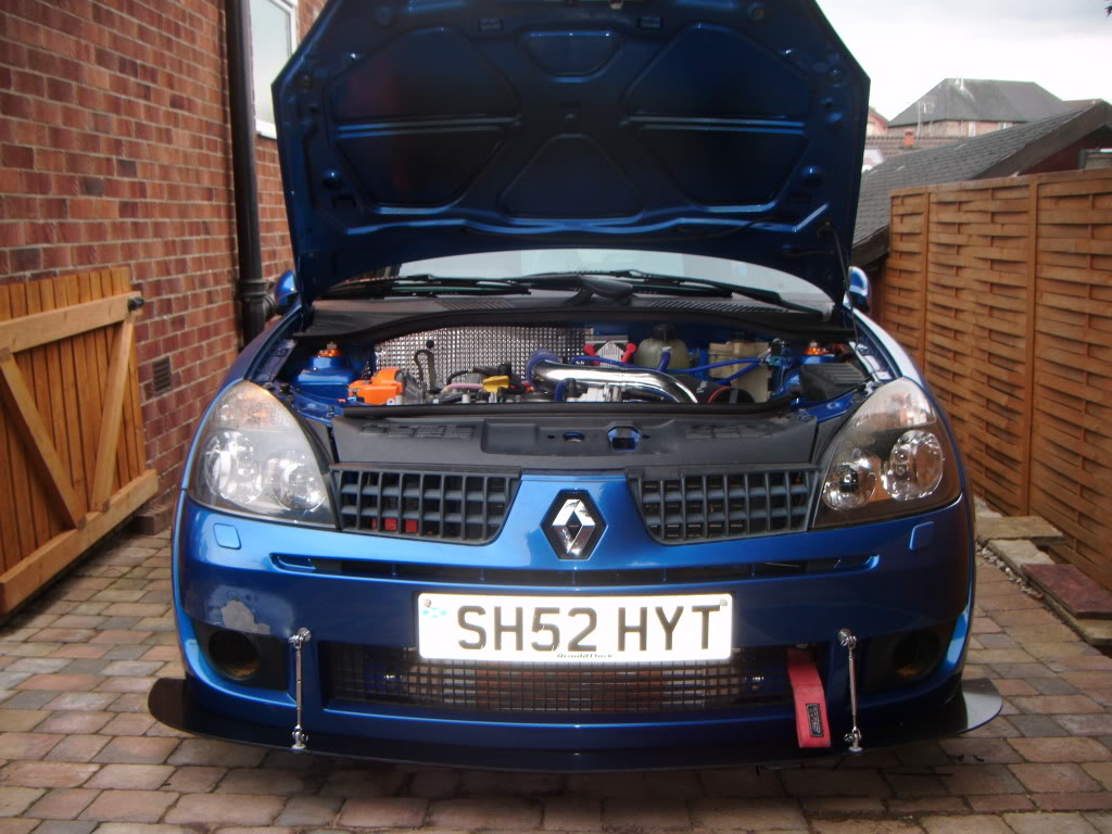

Car is going to get Scoffed tomorrow at EFI Parts so wanted to make sure everything was spot on so had a couple of jobs to do. Checked all fluids again and had to remove the bumper to pull my tow strap through as i forgot when putting it on last time, oops! Also did a nut and bolt check and all is spot on.
Also trimmed my brake cooling deflectors as the tyres were rubbing on full lock with the last design.
Got an early start (well 8am :p) when daverb from DB Motorsport is coming to load the car onto his trailer for the drive south. Hopefully all goes to plan and the car will be back with me in a couple of weeks.

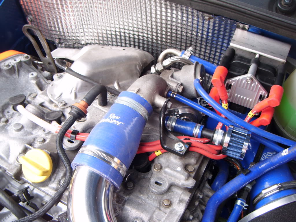

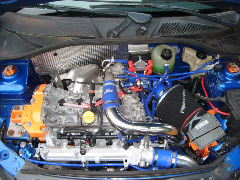

Some pics after a wash:

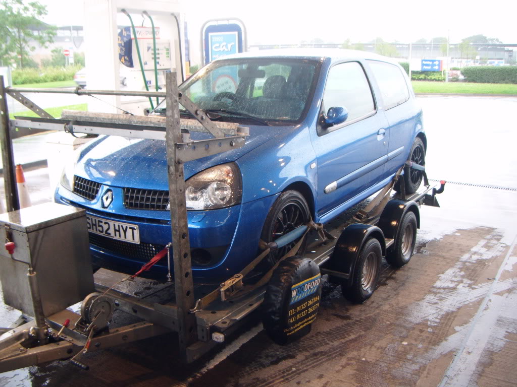

Big thanks to Dave and his mate Chris for getting it safely down to Scoff's. :clap:
Filling up with some Momentum 99
On the M6 making some progress south
Should get it back next week then running in the engine starts.

Looks absolutly mint mate! I'll be happy if my engine bay looks half as good as that! Hope all goes well with the wiring and mapping, looking forward to seeing the end result.

I'm at Scoffs at the minute mate, and just had a look around it. Hats off to you buddy it's a really neat install and one of the best conversions I've seen :)
