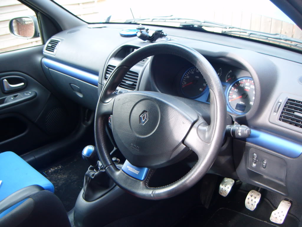

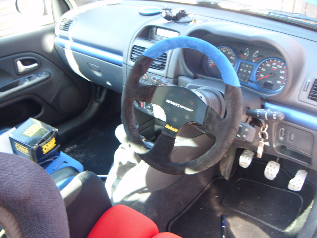

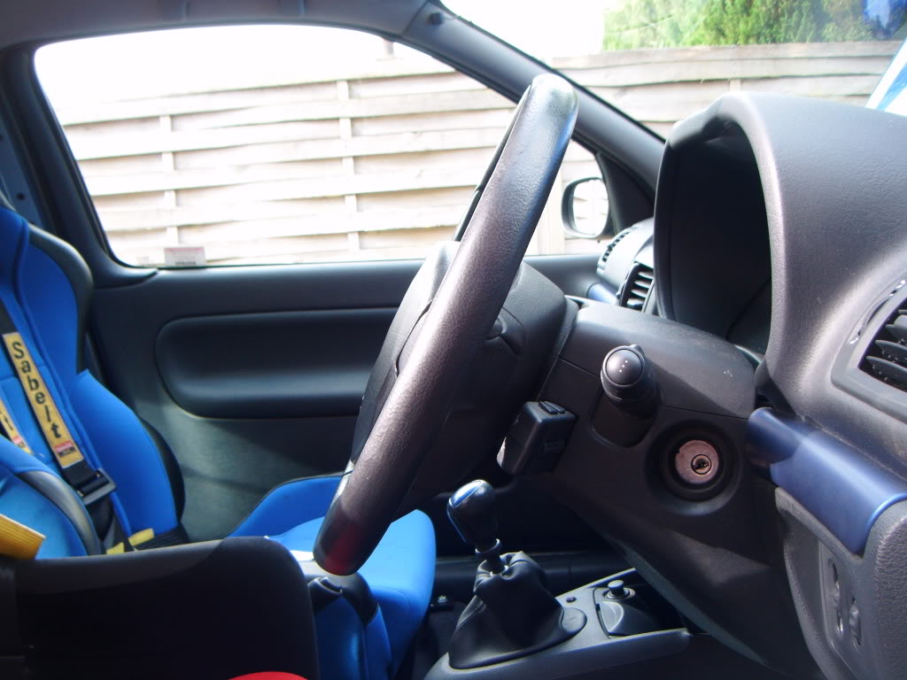

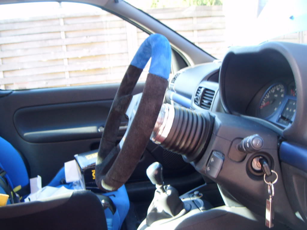

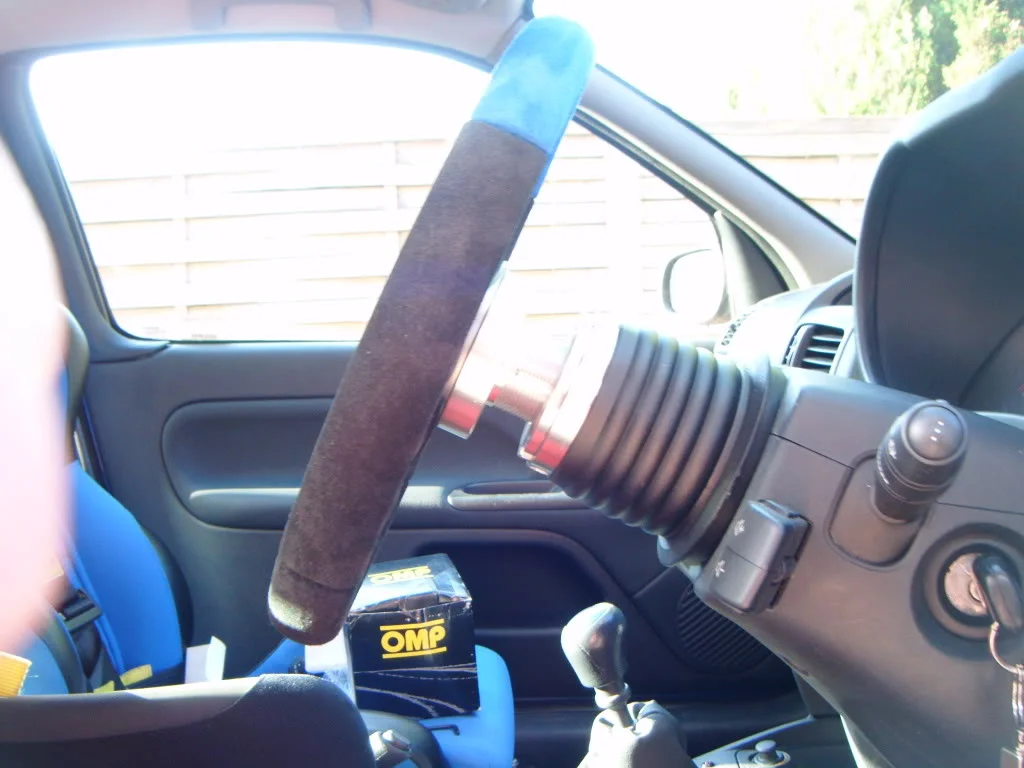

Got my new Sabelt Renaultsport steering wheel, spacer and boss so thought i'd crack on getting them fitted. After getting the perfect seating position for my legs I thought the wheel was a bit of a stretch but the spacer set to 60mm is bang on.
Before:
and after:
The driving position is now just the way I like it. Feels like a Cup racer driving position now. Just need to get the gearstick position sorted now but not sure how yet.

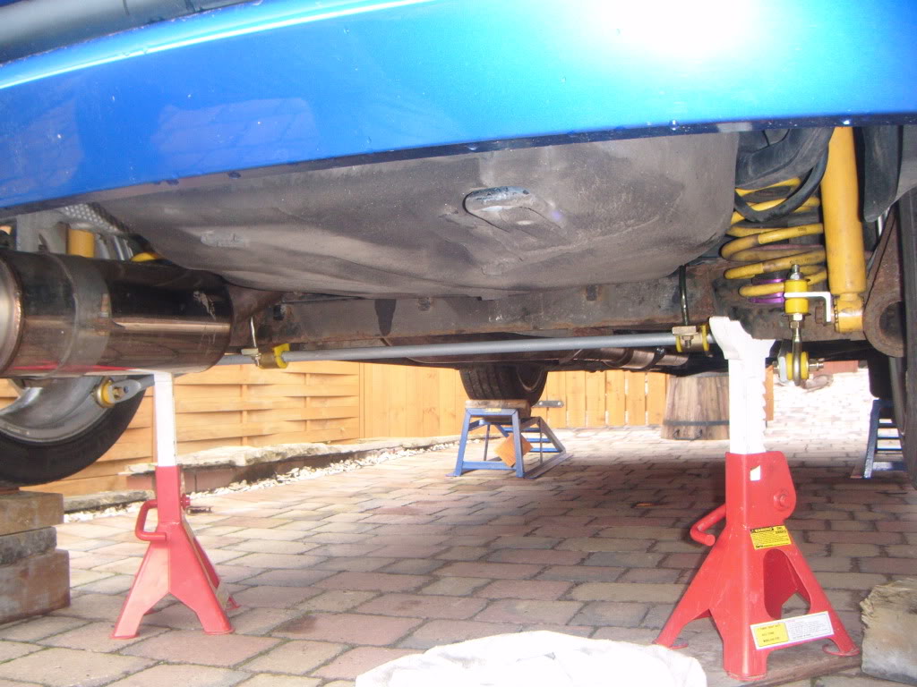

Fitted the Whiteline ARB from the group buy:
Not sure what difference it makes yet but will be finding out at Knockhill next weekend.

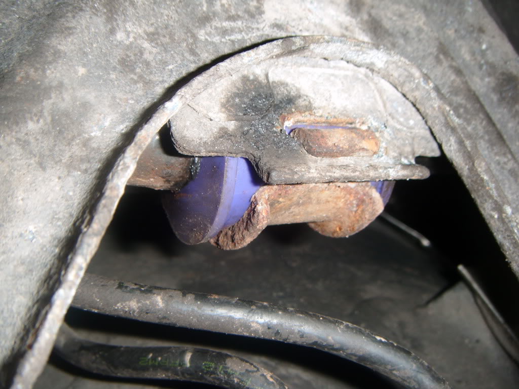

Also got the front ARB bushes fitted and what a pain in the ar5e the centre one are!

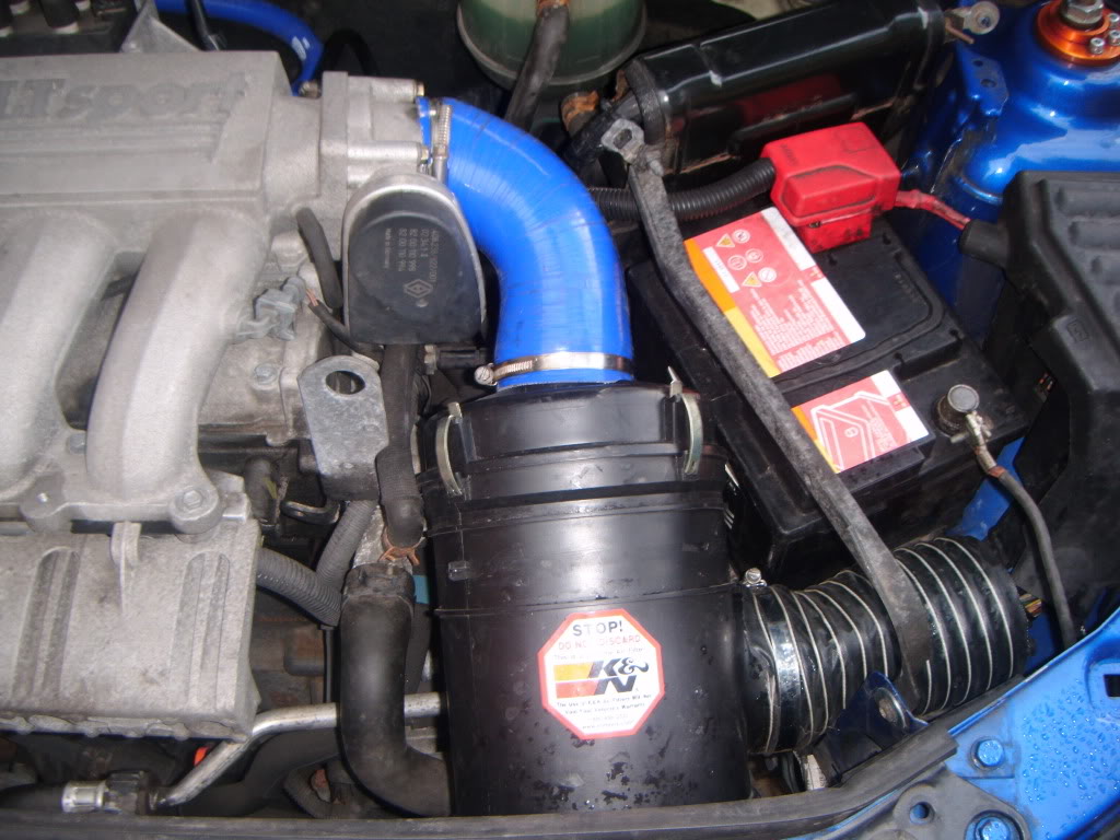

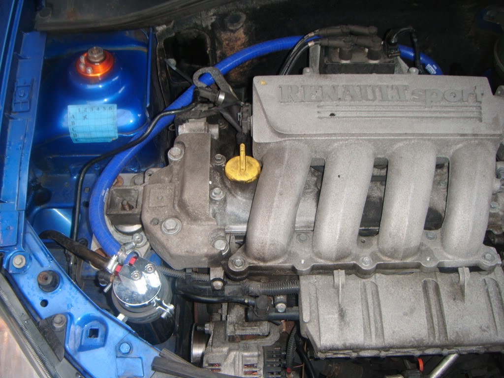

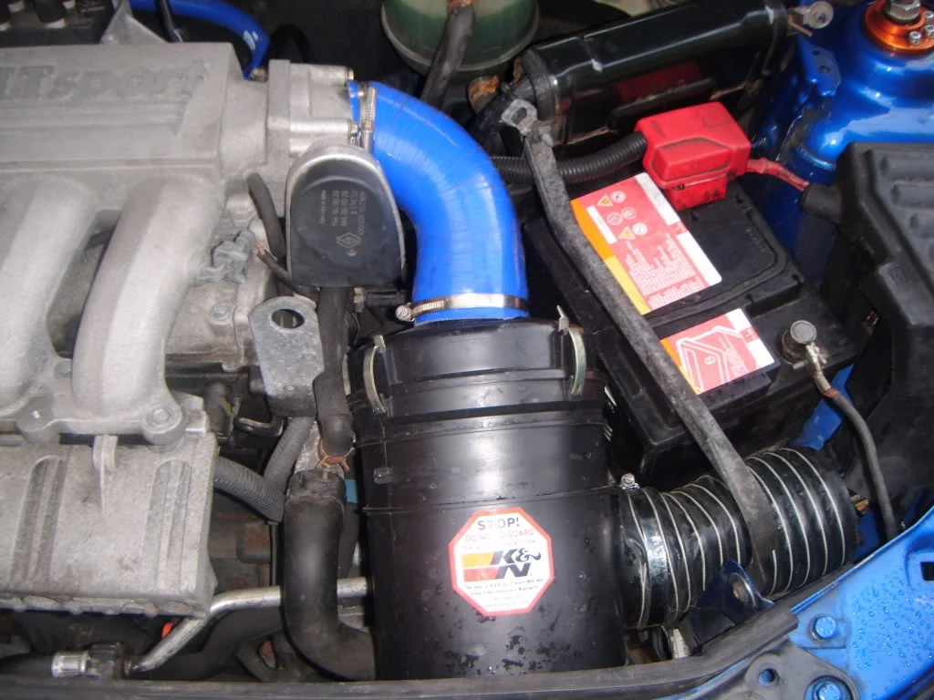

Last but not least was the V6 airbox and Oil catch tank. Wanted to take the vent pipe to a catch tank rather than into the inlet as we all know every little helps and oil vapour will lower the octane of fuel so....
[ATTACH=full]829430[/ATTACH]
[ATTACH=full]829431[/ATTACH]

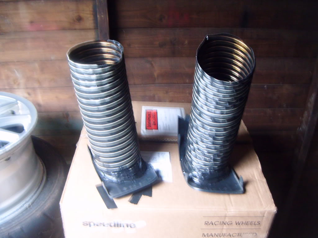

Hopefully I'll get time tomorrow to fitted brake ducts from the fog lights. Needs to be done before next saturday. I have got some deflectors being made out of plastic so when I get them home from work they're getting fitted.

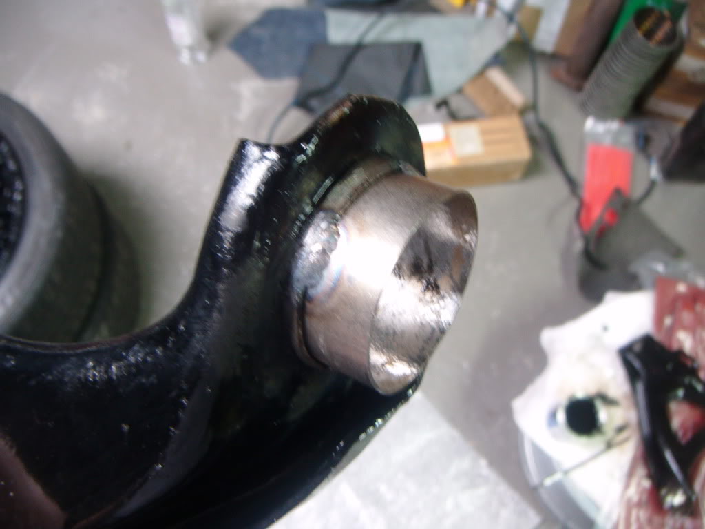

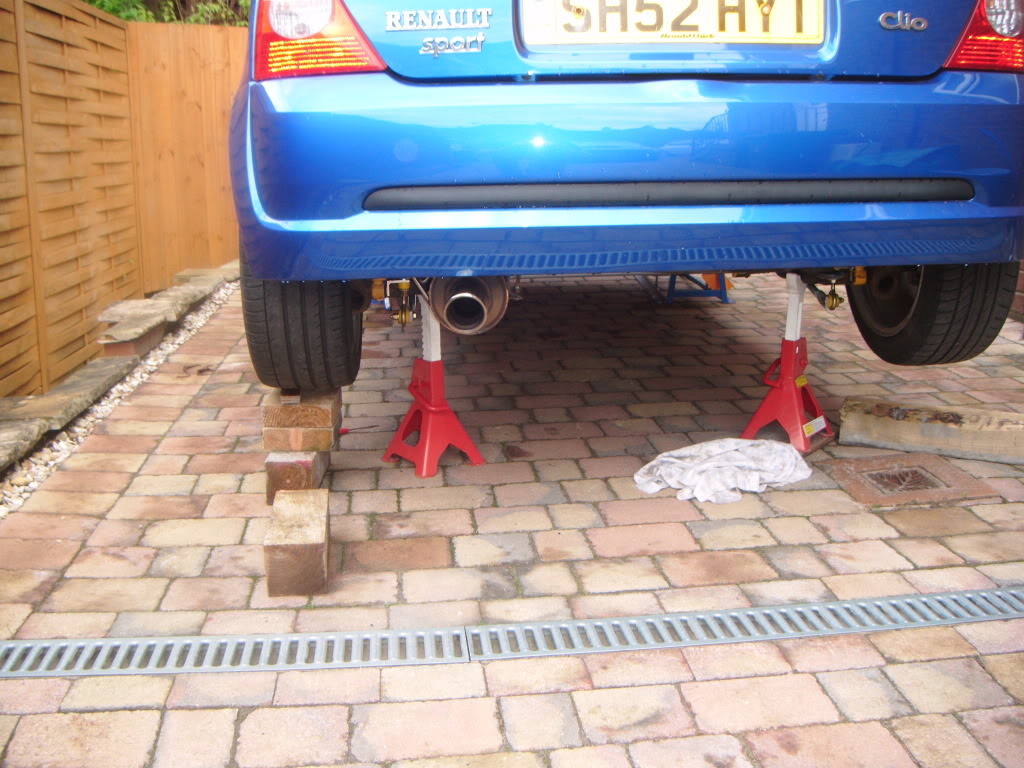

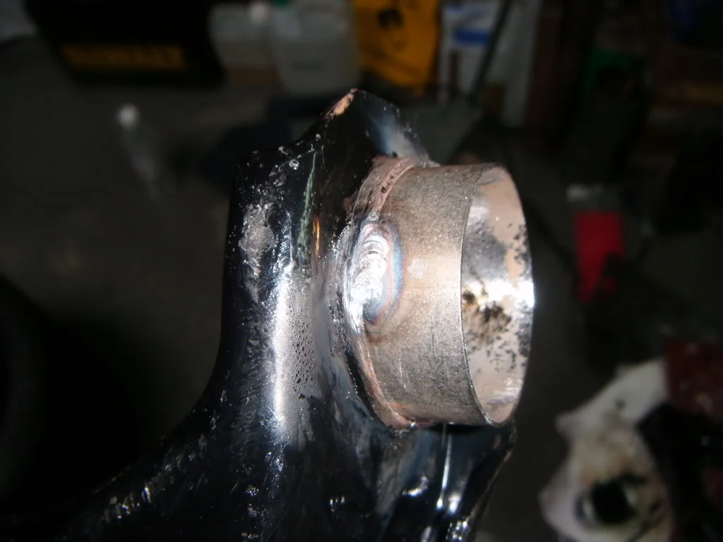

Managed to get the wishbone bushes fitted. Had a bit of bother getting the sleeves welded but eventually found someone to do it and quite a nice weld if i dont say so myself. After a quick rub down and a lick of hamerite smooth they were fitted.
Forgot to take a pic of them actually fitted as it was late at night and I was in a rush to get the car ready for Knockhill on saturday morning. When the car was up on axle stands I also removed the Carbon Canister to allow easier access for the brake cooling ducts. They certianly make a difference to brake temps.

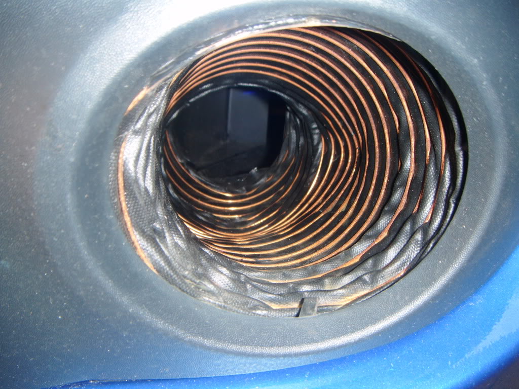

I use 100mm ducting onto the fog lamp surround and stuck it with some tiger seal. That stuff stick like sh*t to a blanket! Also used some plastic moulded deflectors which then needed a bit of trimming due to the wheel fouling on full lock.

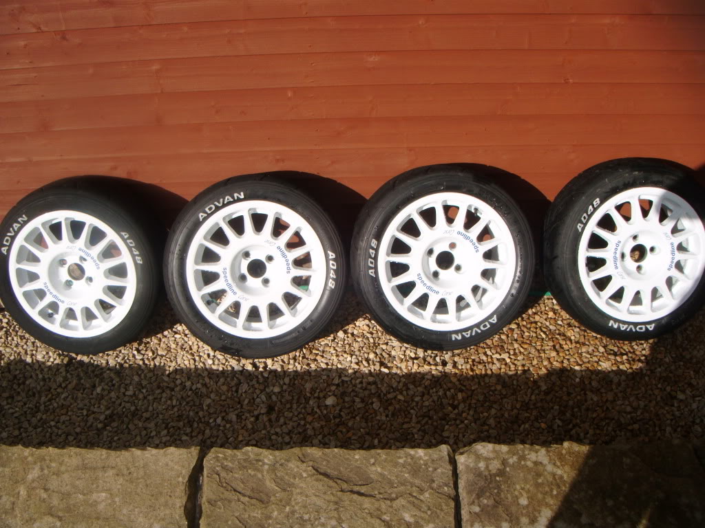

Yesterday was my first track outing on 15's as I was using turinis previously. I bought some 2118's which I must say are a very nice looking wheel and look the dogs in the photos i've seen of the car on track. The Pagid RS-4 brake dust is a bugger to get off even after using some Poor Boys wheel sealer. Took me about 30mins to wash them today! :mad:

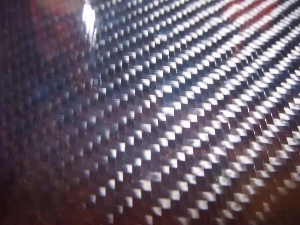

Bought some more goodies for fitting over the winter.

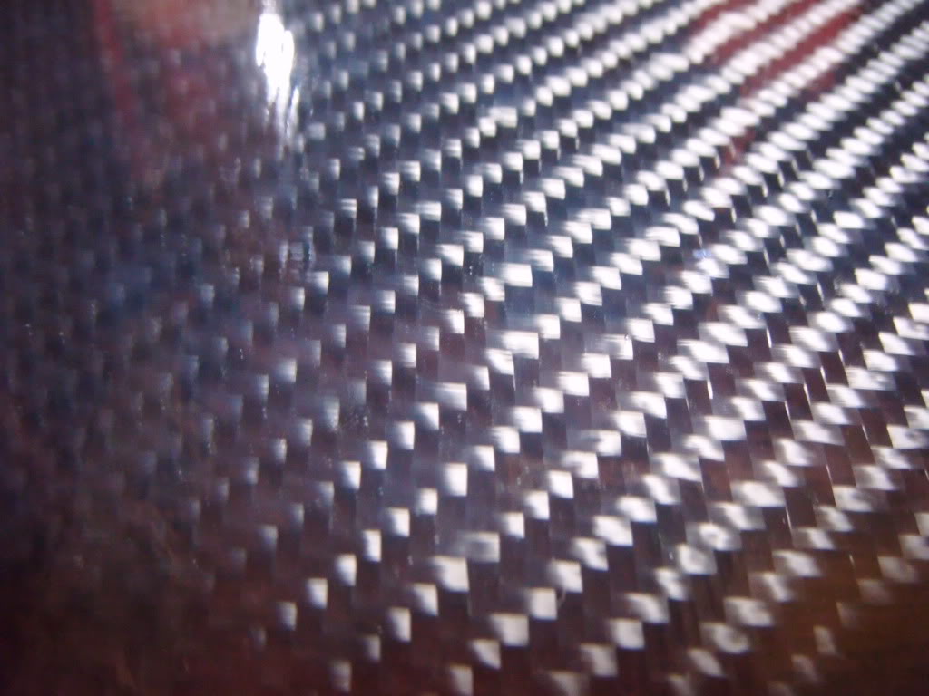

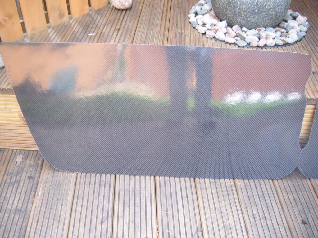

Some carbon door cards and door handle spacers:
I'll wait till I get the front polycarb windows before fitting so that I dont need to find a home for the electric window switch.

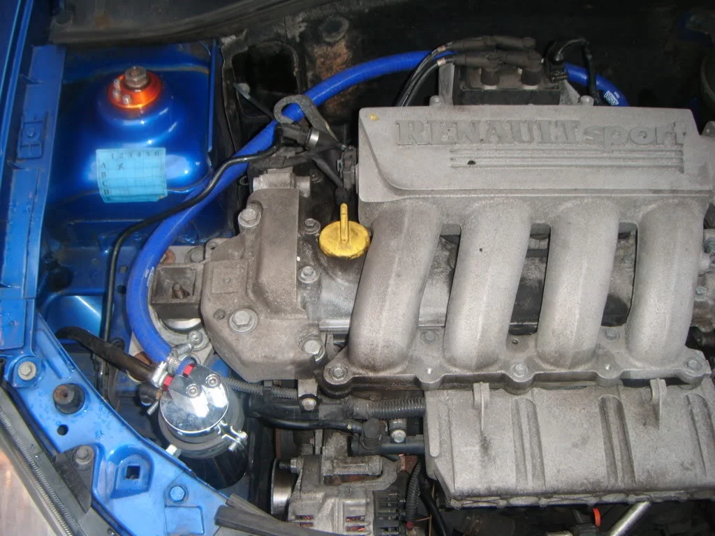

Do you have any pictures of you're oil catch tank plumbed in? as it's something im wanting to do!

There is a pic on the last page that shows the catch tank and hose. All you need to do is follow the pipe on you inlet elbow and remove it. Put the new hose from the catch tank in its place.

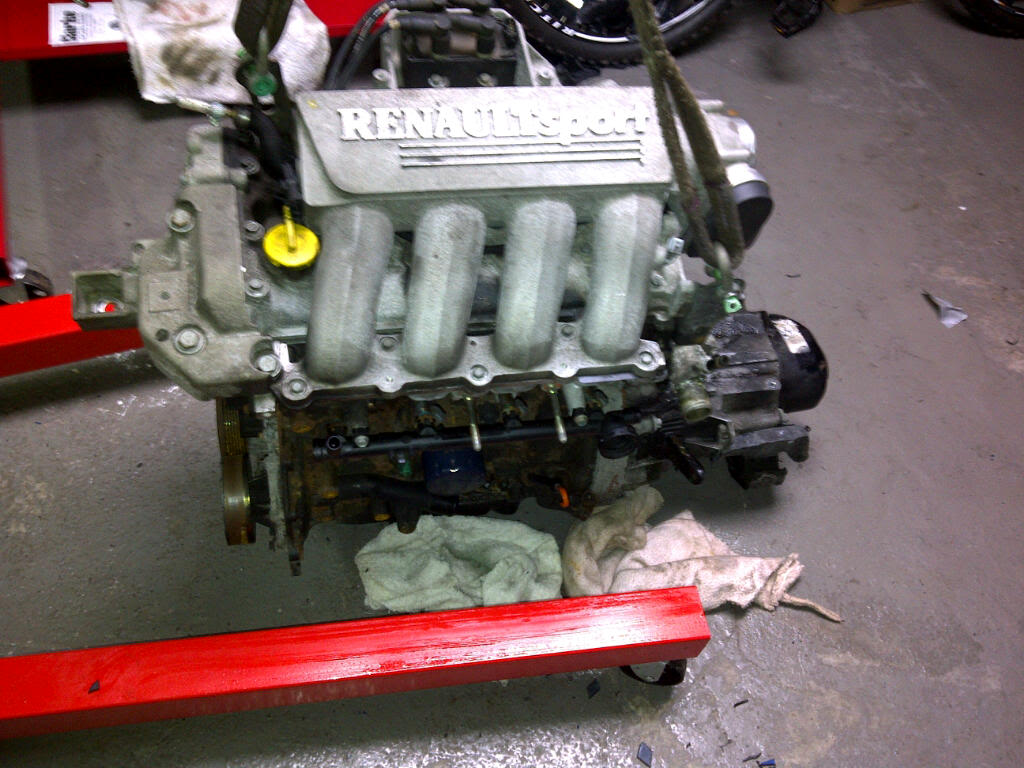

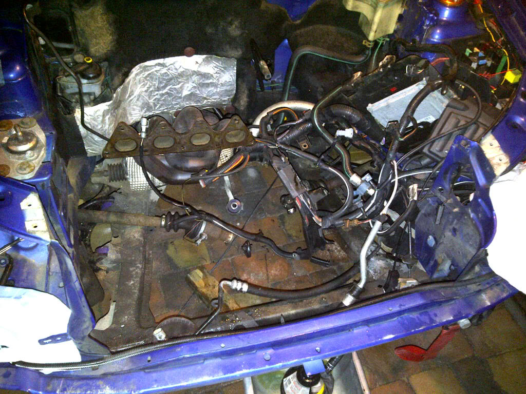

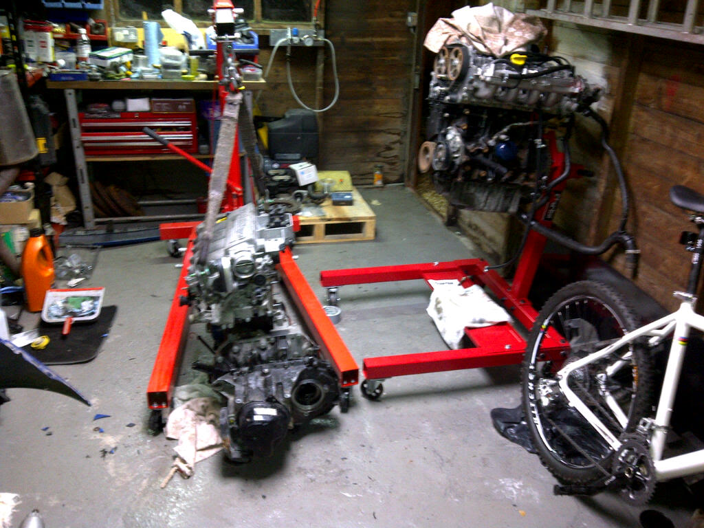

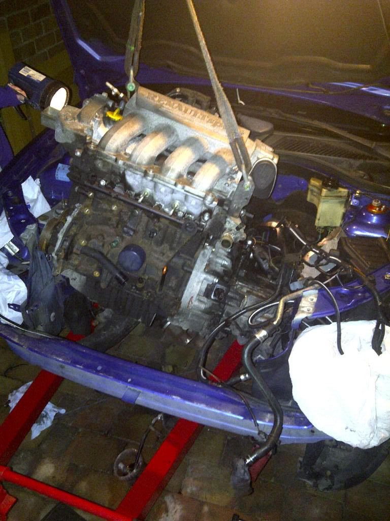

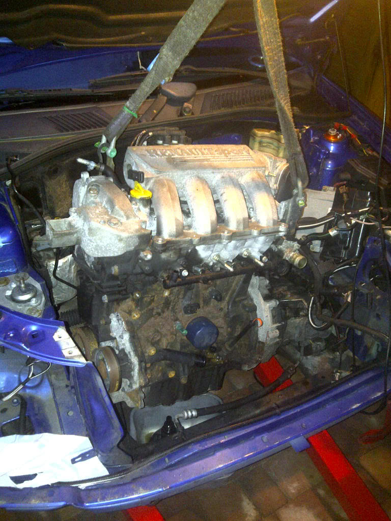

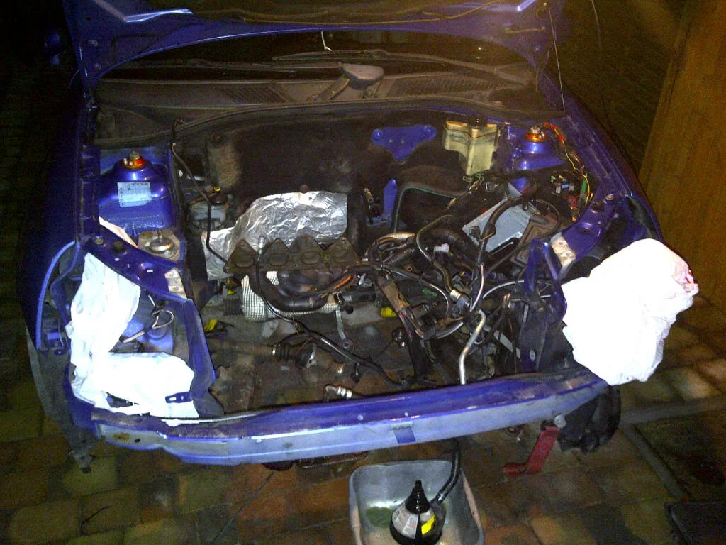

Bit of an update on the car. I've been working since the new year with the engine swap and other bits and pieces but managed to finally get the engine out today with some help from the mrs who incidently was hung over! What a girl!!

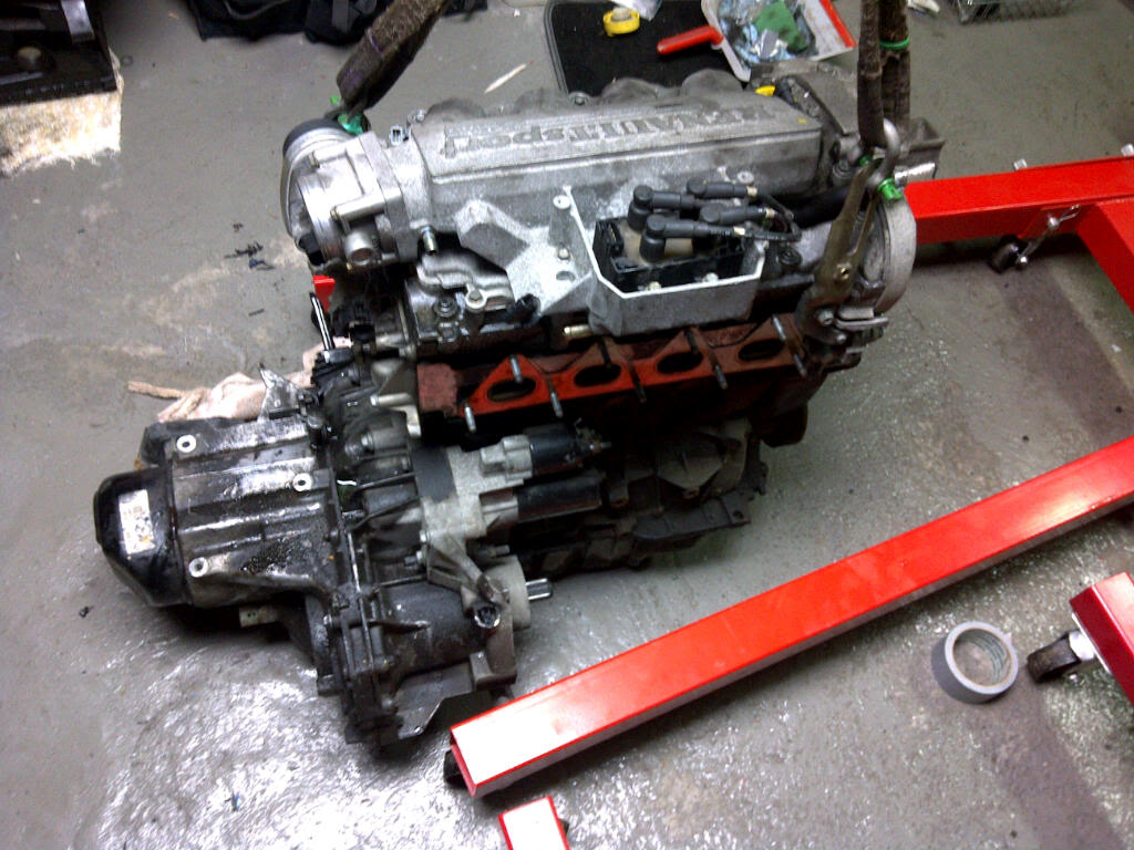

And the engine and box out after a bit of a wrestle.
Old engine and my new one on the stand.
Going to do a bit of a engine bay tidy up now that the engine is out.
Need to remove the sound proofing and fit some heat proof matting as the turbo downpipe is right next to the brake reservoir and also the turbo is very close to the bulkhead.

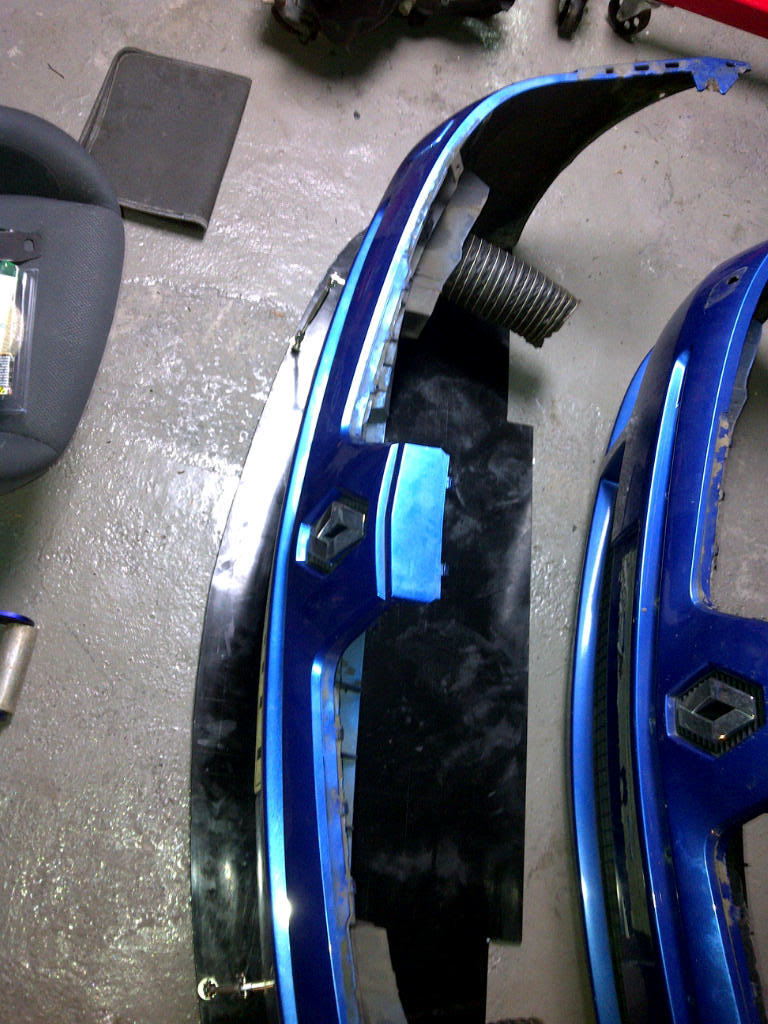

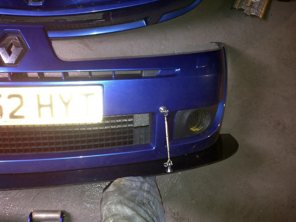

Also got round to making my front splitter and getting it fitted to the bumper with some stainless tie rods.
Noticed some gearbox oil leaking from the selector so that will be getting looked at as the box is out along witht a helix 4 paddle clutch gettiung fitted.
Sorry about the phone photos but couldnt find the camera. :eek:

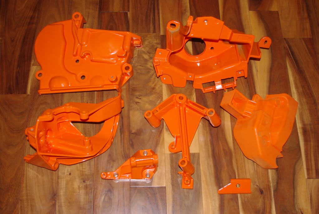

Got these back from powder coating today. Going for orange with blue hoses in the bay.
Going to get the new engine fitted in over the weekend so fingers crossed.
