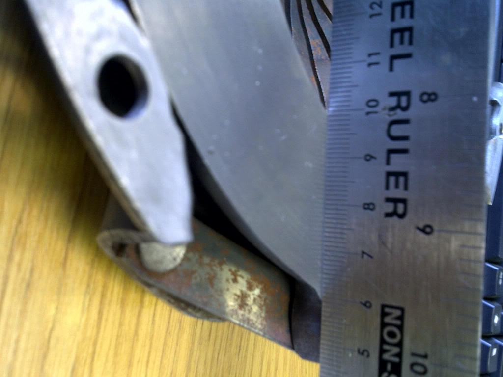

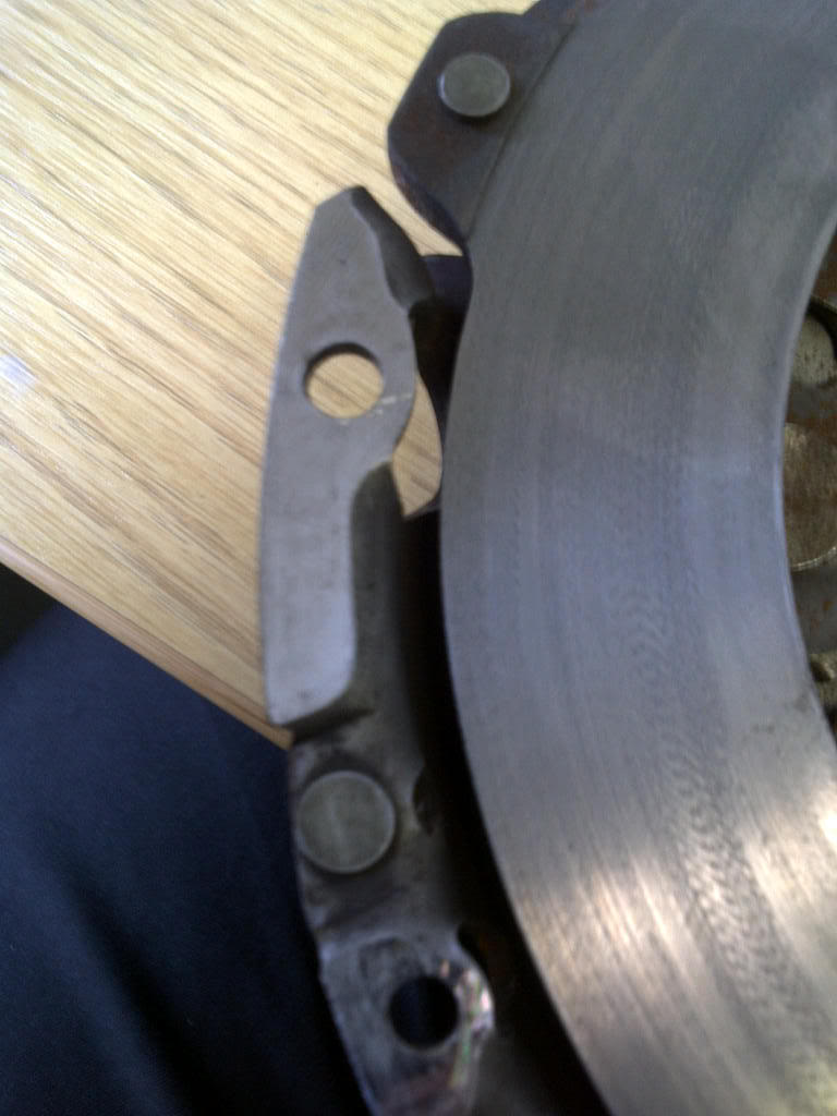

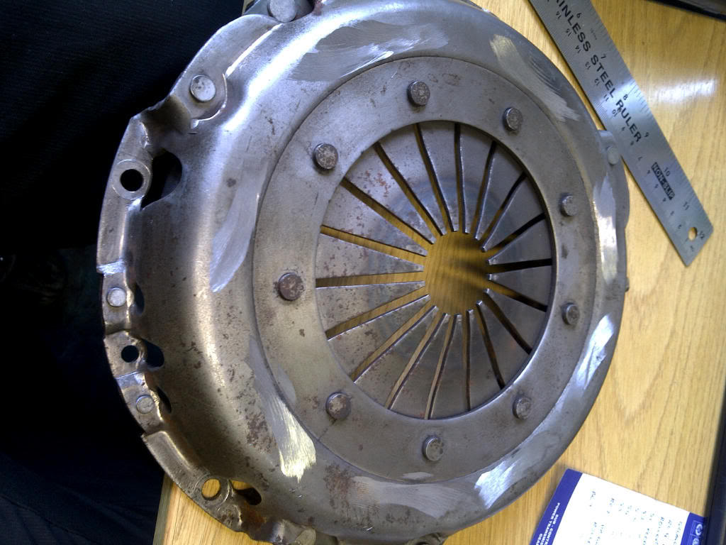

At least that is making at least 60% contact. What's the script with these then, do helix know that this is an issue?
  Cup In bits
Re: 172 Cup track toy!
Yeah I guess its because its been hammered for 30 mins + qualifying that it has bedded in more than yours. Im not sure if it is an issue as everyone I have seen is worn like that, mine included but mine has been fitted longer so it's 90% coverage of the paddle.
No word back from helix?
  172 cup, Impreza P1
No word back, not great from them tbh.
Not sure yet what would cause this. Heat in use or bad manufacturing?

Clutch pressure plate is getting skimmed today so engine is going in on Saturday. They said they had to skim 0.7mm off the plate and mating face of the cover which is a lot in my eyes but I'll see how it goes.

Here is a few pics of my machined helix cover plate. The company did quite a good job by actually welding a large pipe to allow them to hold it in the chuck to allow them to skim the face of the pressure plate.
Cover plate after removing pipe:
Pressure plate after skim is completely flat now :approve:
As they removed 0.6mm from the face of the pressure plate, the same had to be removed from the mounting face.
This will now allow me to get the engine back in over the weekend and so the running in started. Hopefully no more set backs now! :nono:

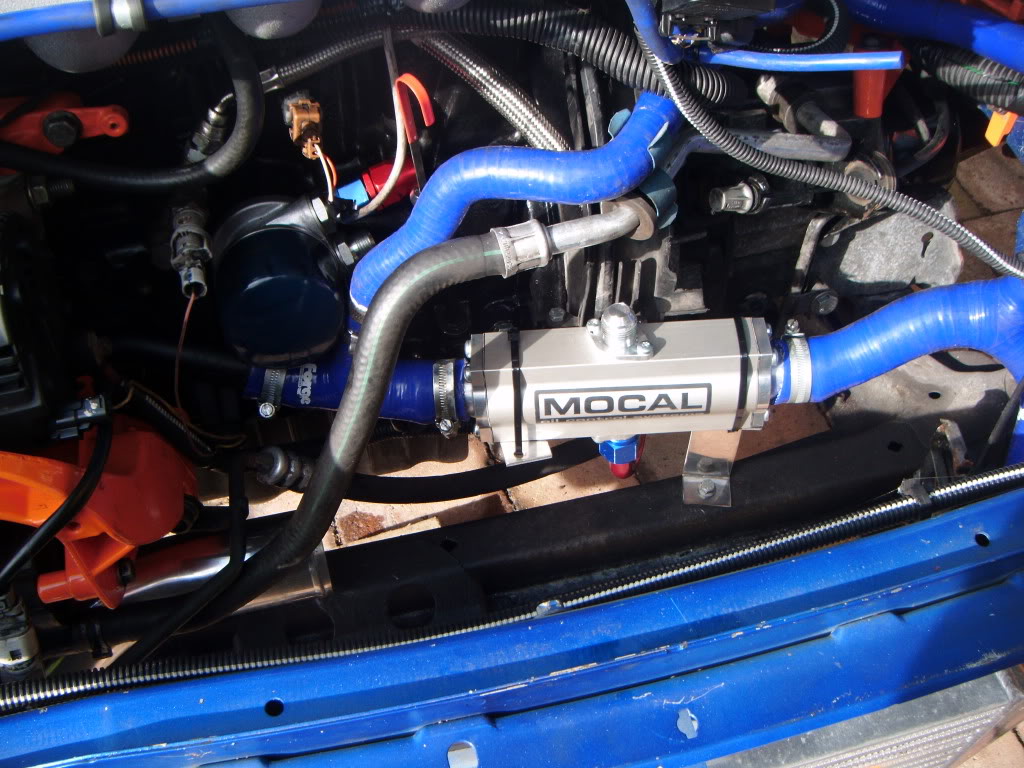

Got the engine in today and all the wiring loom conneted. Started to fit my mocal laminova oil cooler but the straight fittings I have from the sandwich plate dont seem to be compatible with the hose I have. The oil cooler fittings are fine so I'll need to get some other fittings for the plate end.

Yeah you have to get correct fittings for the teflon hose and standard hose, different mounting style. Mocal stuff is 1/2bsp typically, so you need the crossover fitting, im sure you already know about this after fitting sandwich plate??
  172 cup, Impreza P1
Yeah, it's 1/2" bsp to AN10 straight fittings I have for the sandwich plate but it's the hose side that won't work with the hose I have. It's not Teflon hose I have either, just steel braided rubber.

emmm not really sure what you could do to sort it, the company I bought mine from do standard and speed flow fittings for the normal braided hose, then the teflon stuff. I have noticed some variations from hose securing method from different manufacturers of fittings. Have you mixed and matched different company's hose/fittings?
  172 cup, Impreza P1
Yup, 2 were from torques and 2 were from demon motorsport. The demon ones fit and the torques don't.
I'll order some 1/2" bsp to an10 male adapters to fit on the sandwich plate and the I can fit the same an10 fittings from demon.

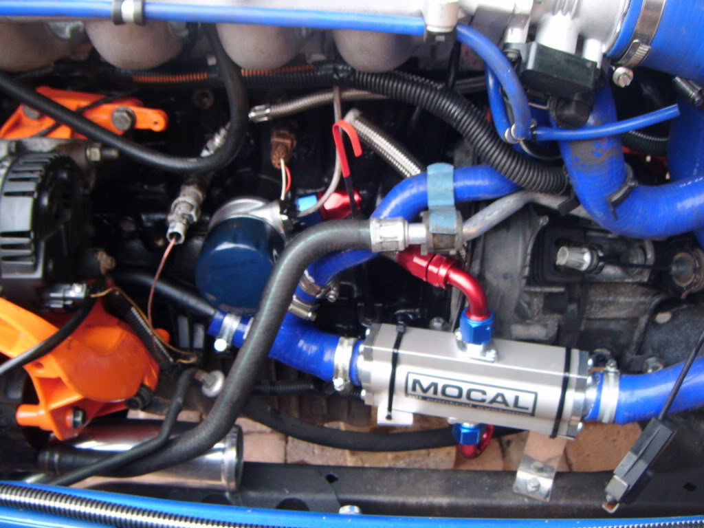

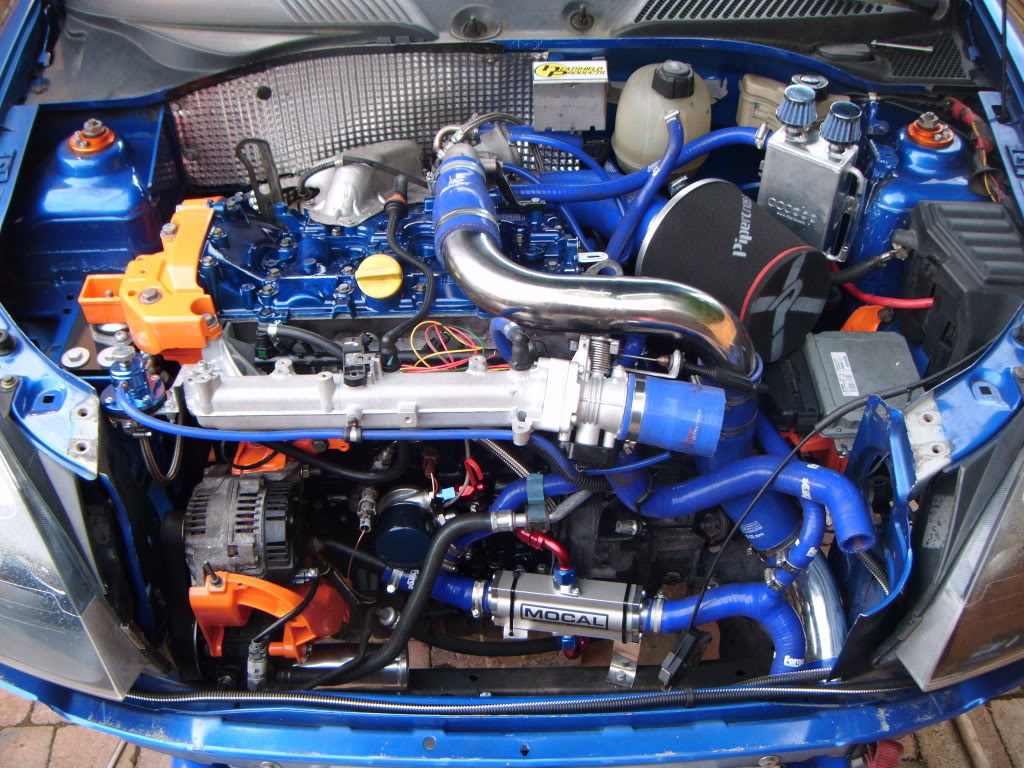

Got the rest of the engine bay assembly finished off and also fitted the driveshafts. Thats everything done apart from the oil cooler lines and then I can fit the radiator and boost pipes from the intercooler to the inlet manifold.
Pic of the oil cooler
Some shots of how it stands now

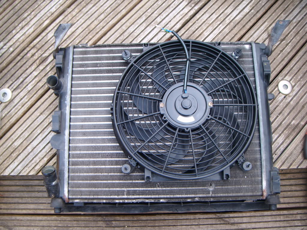

And the new 14" fan to help the cooling a bit hopefully

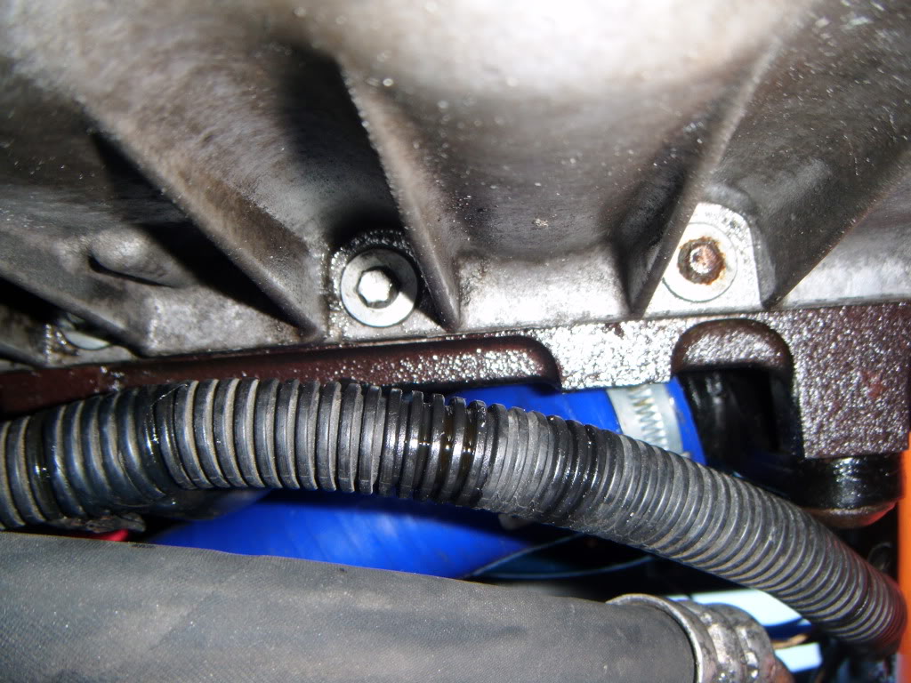

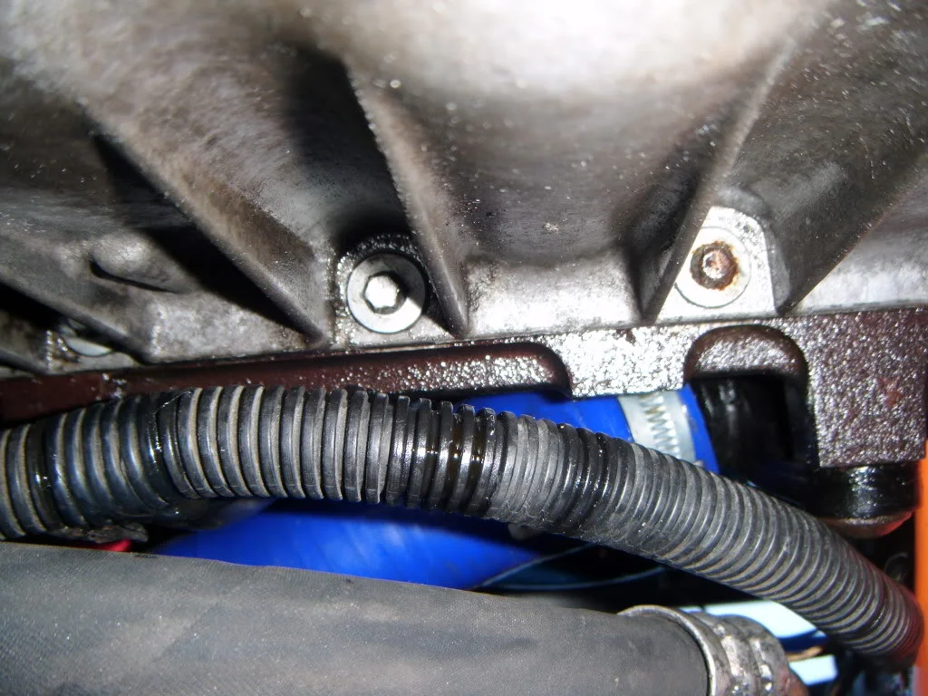

The head sounded very tapety for the first few seconds then the oil came up to pressure and it quickly quietened down to a normal noise level. Ran it for a short while then turned it off to check for anything untoward. Everything seemed ok so fired it up again and left it running for about 20 mins or so. I spotted a small amount of oil running down the sump to the front of the engine but cant see if it is coming from the sump seal or the oil cooler. I'll have a better look when I'm doing the first oil change to semi-synthetic.

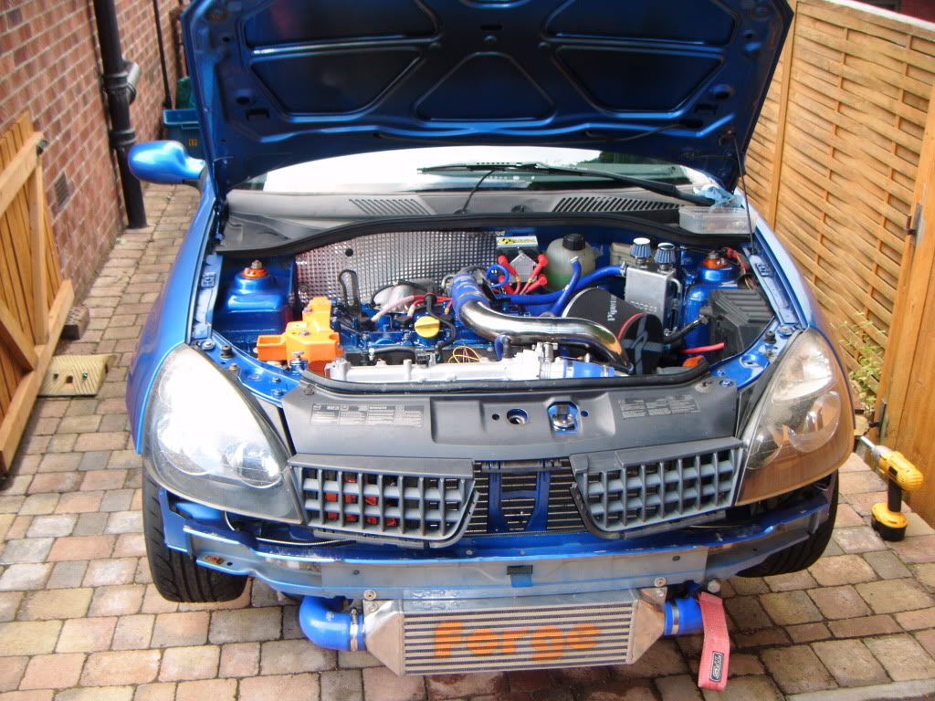

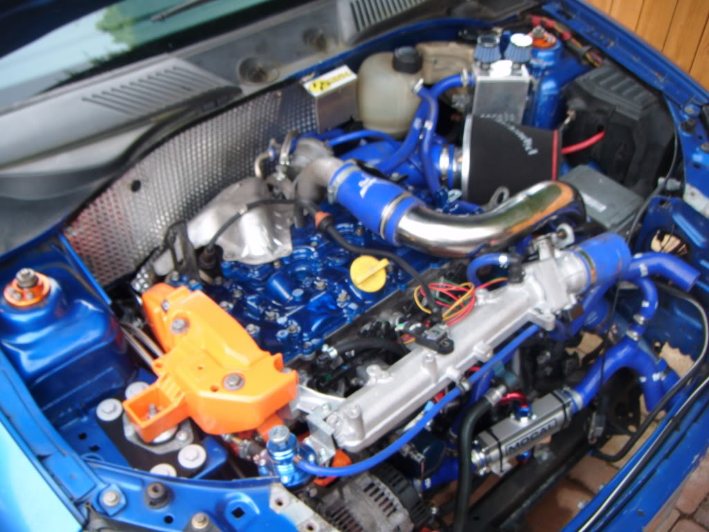

Here's some pics of it before the bumper was put on:
