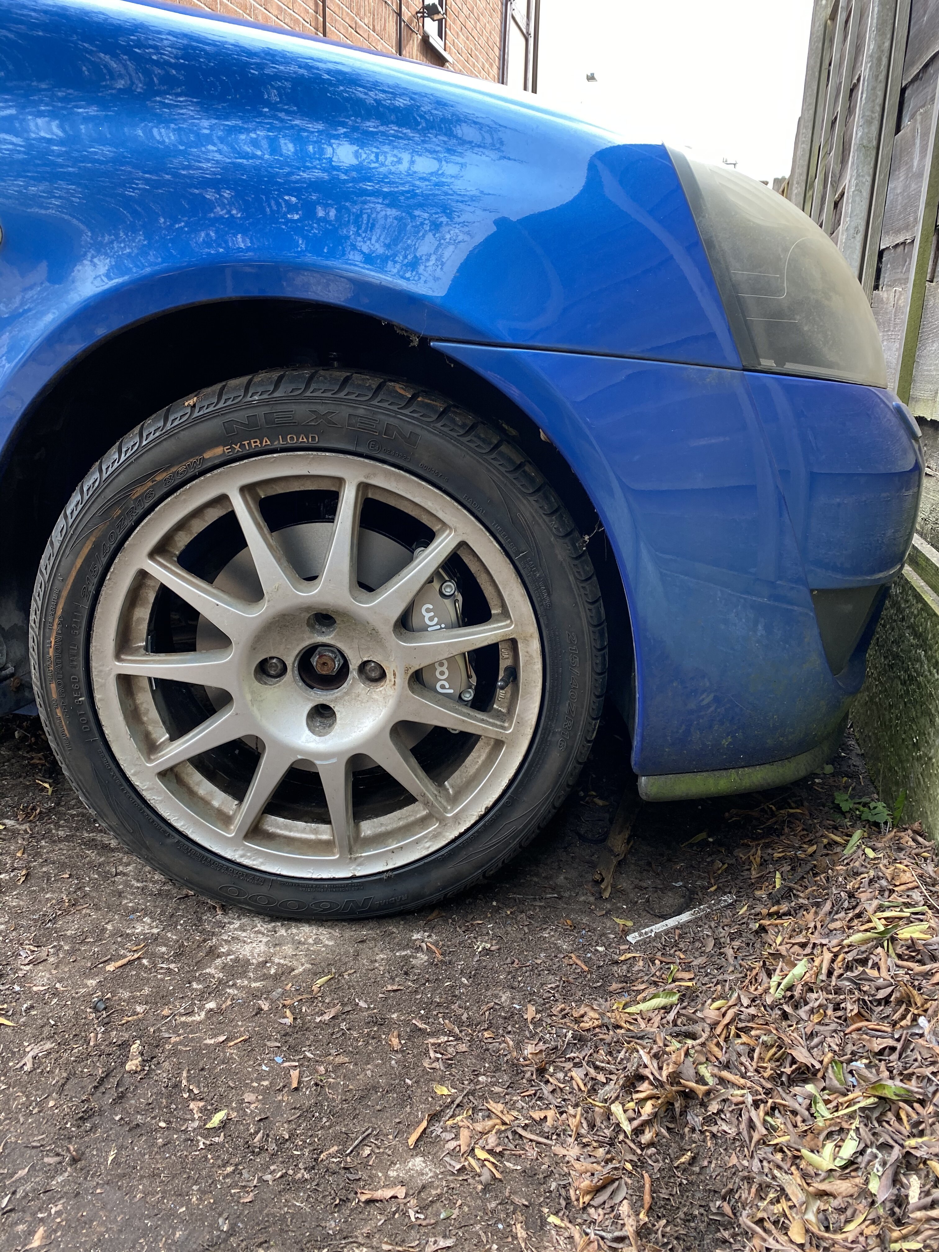

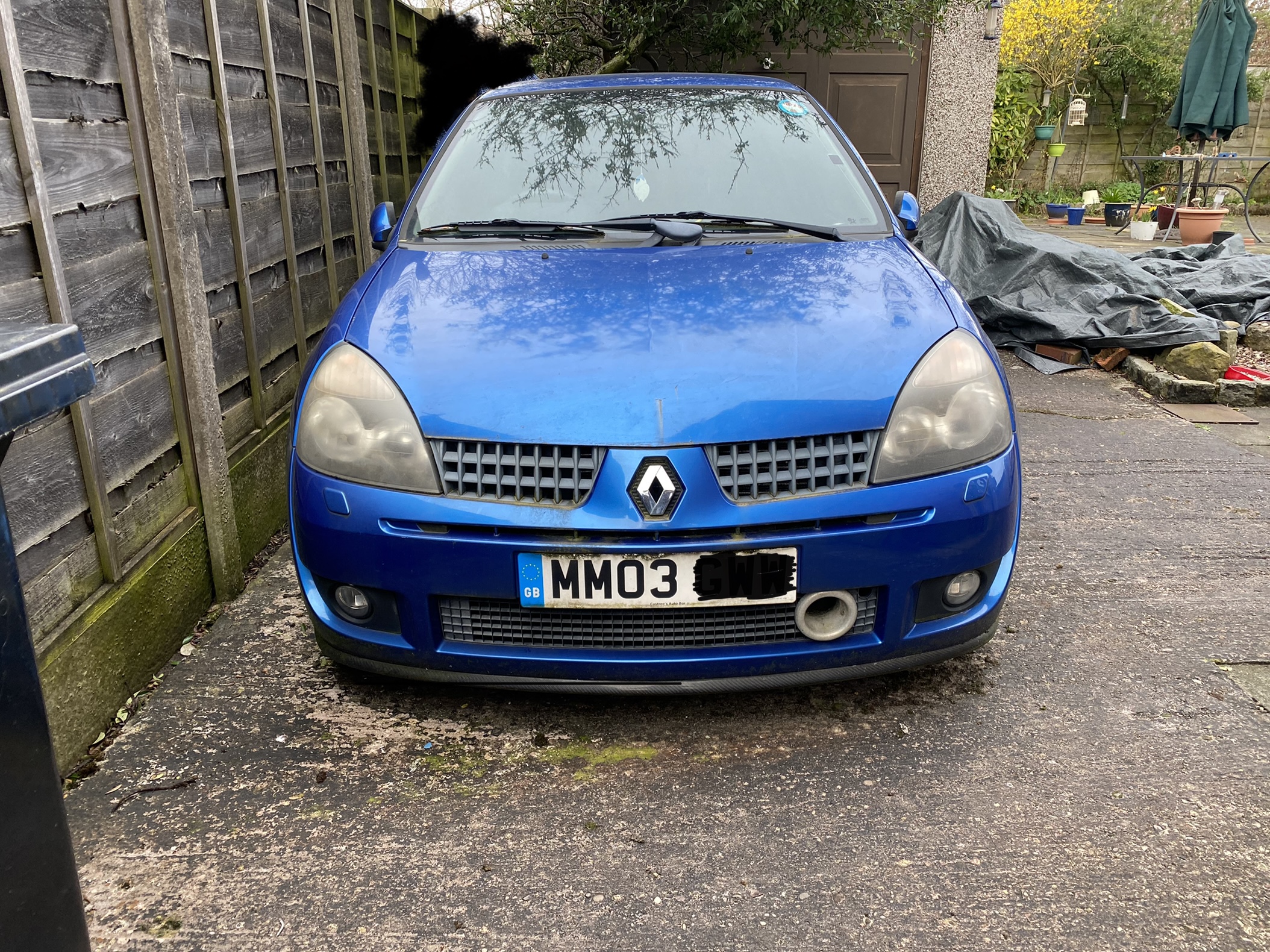

after some saving and some free time coming up I’ve decided to dust off the Cup and get it back on the road.

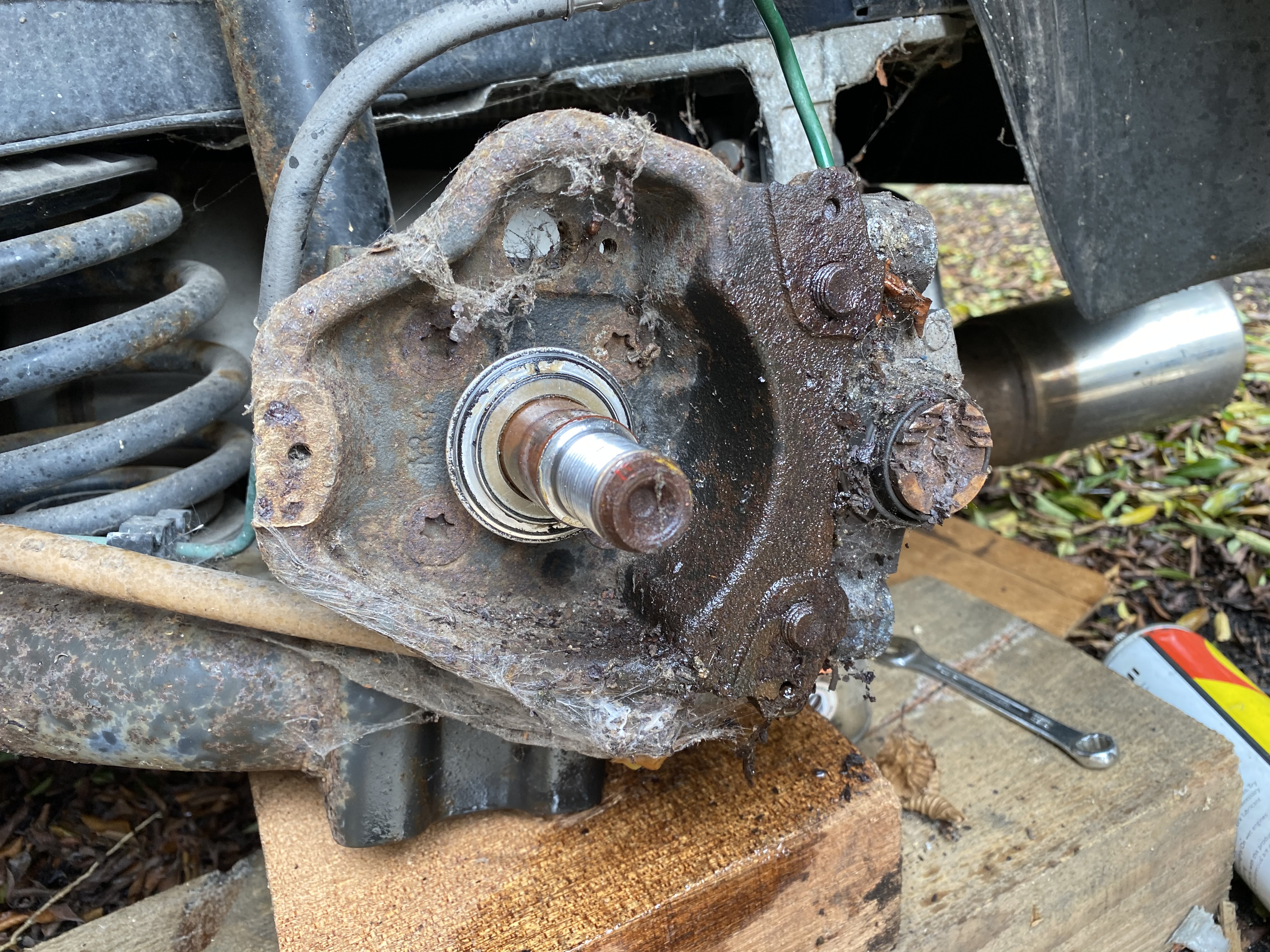

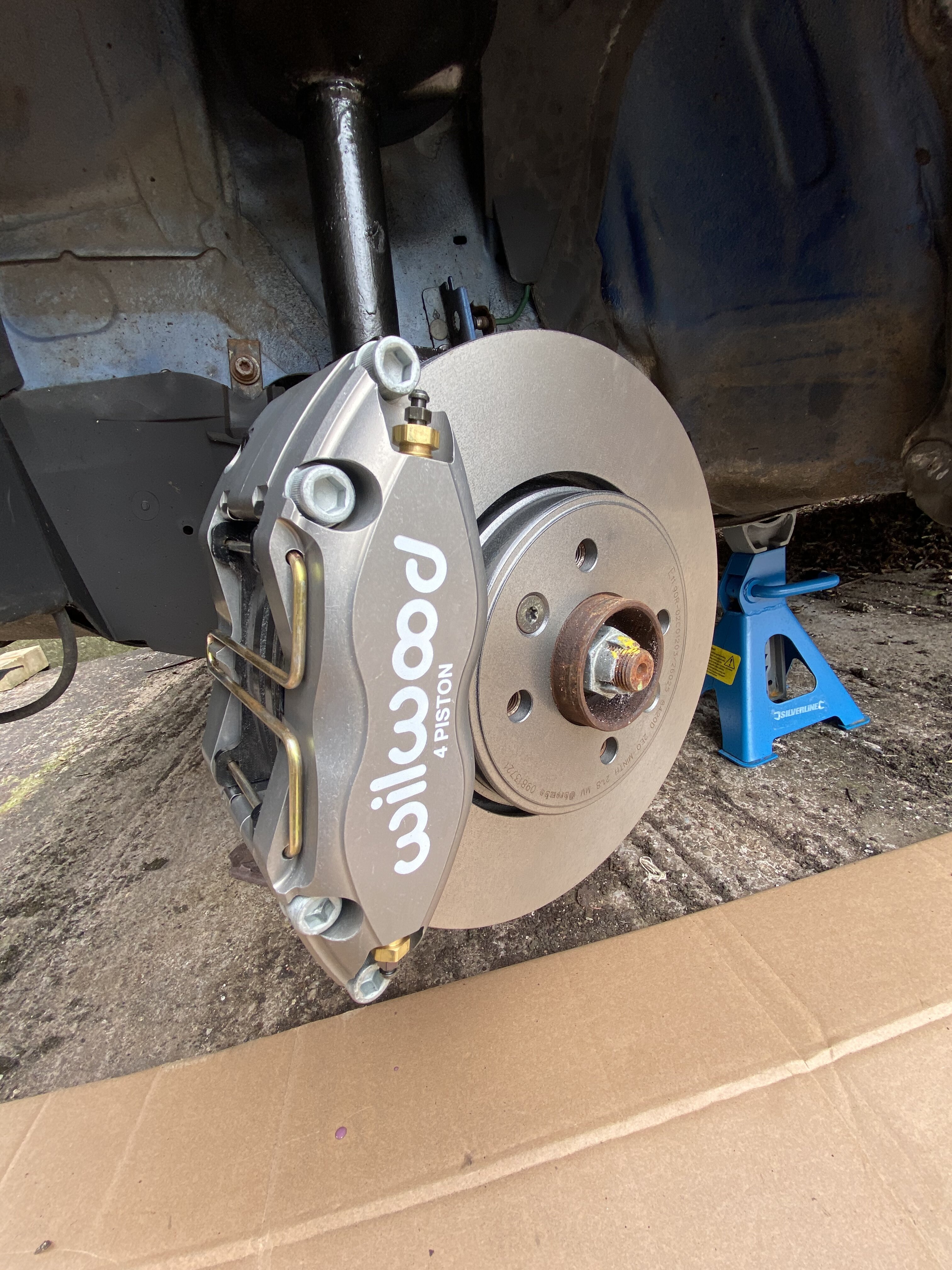

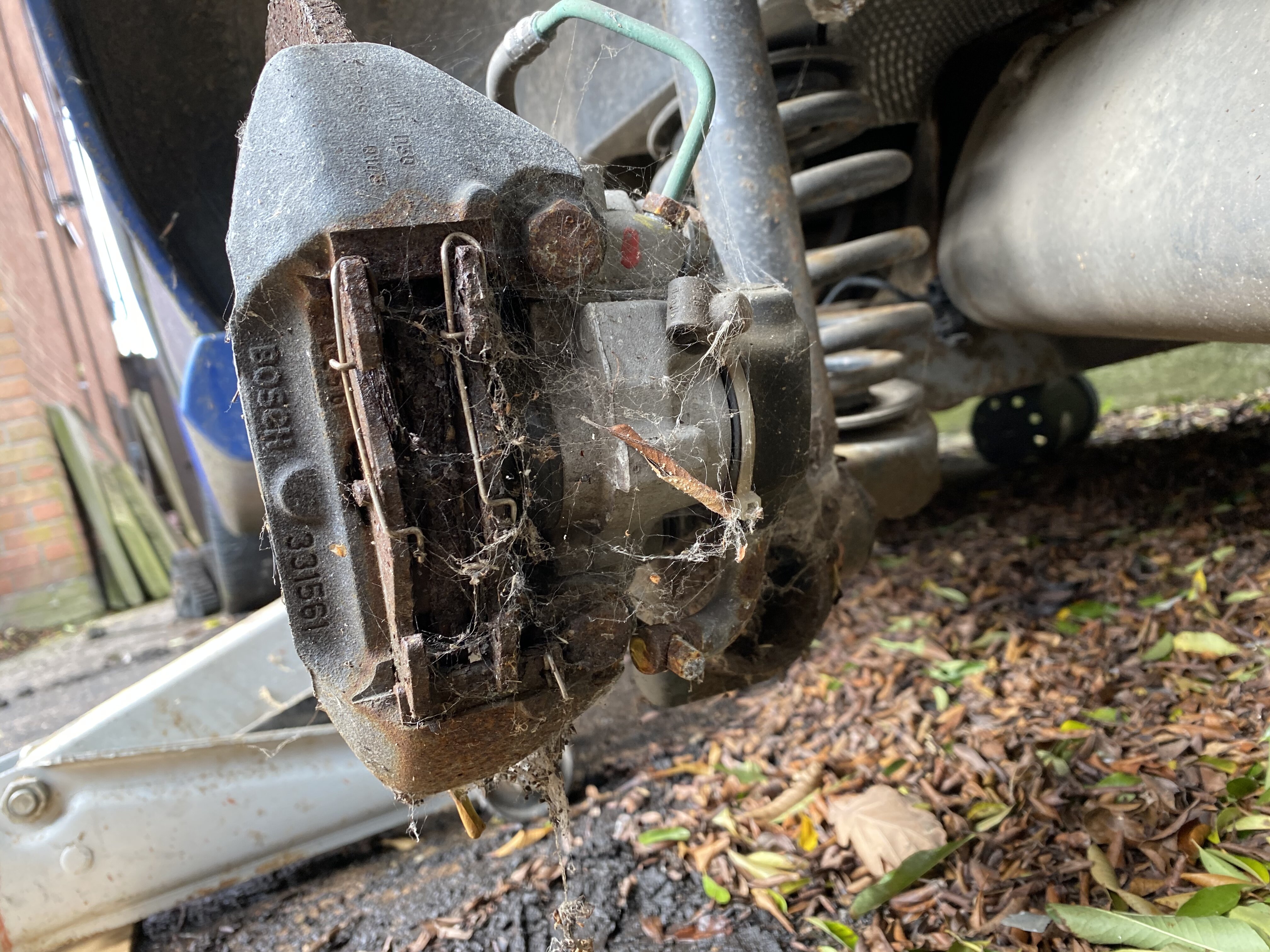

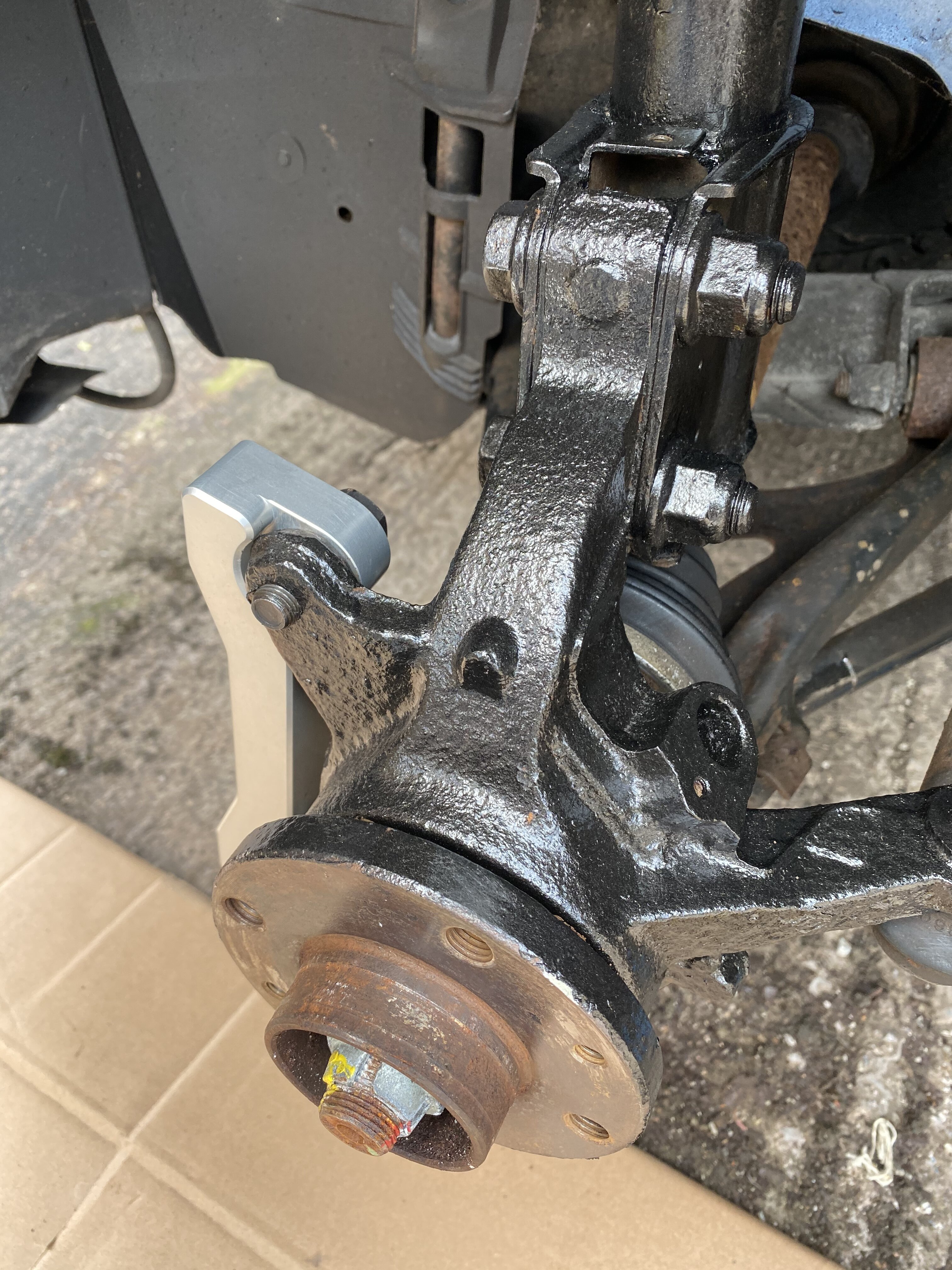

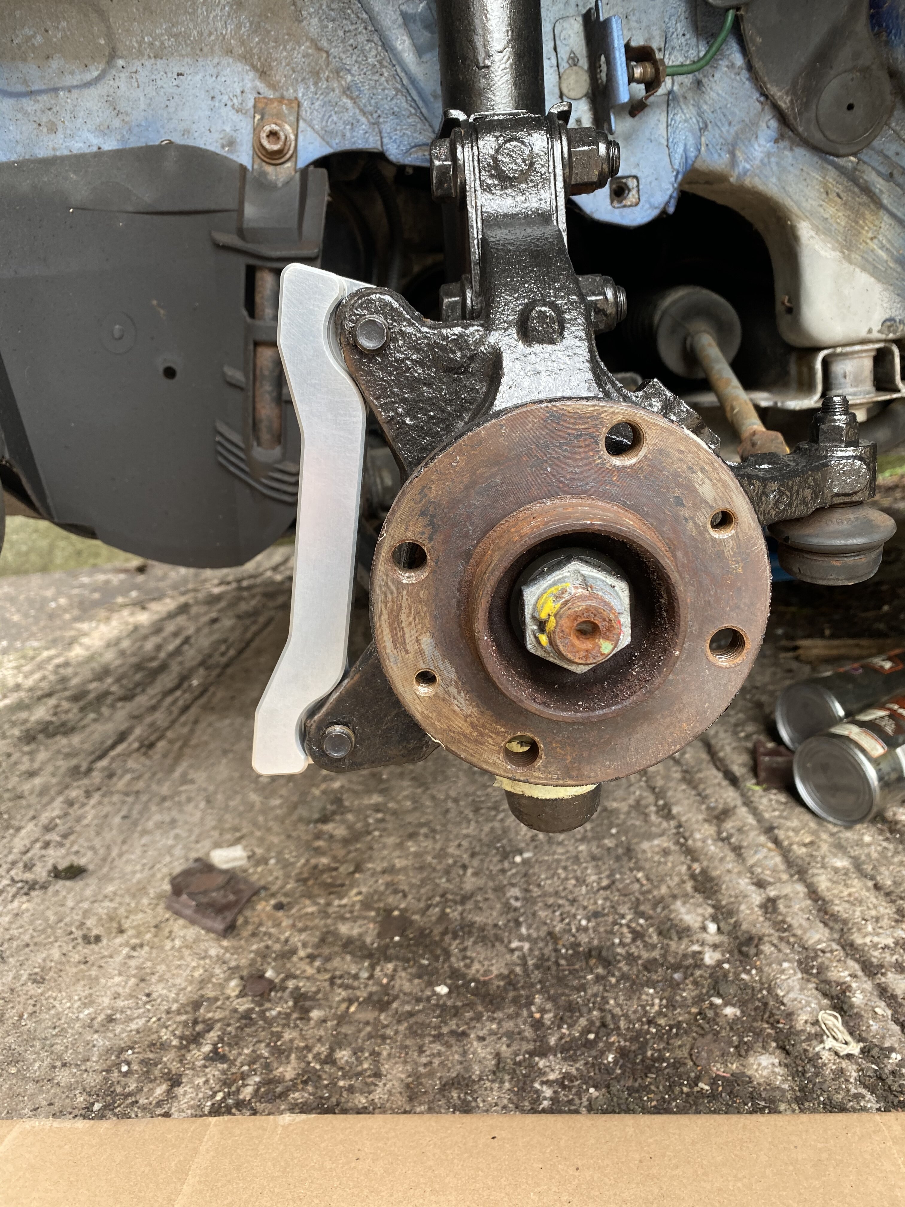

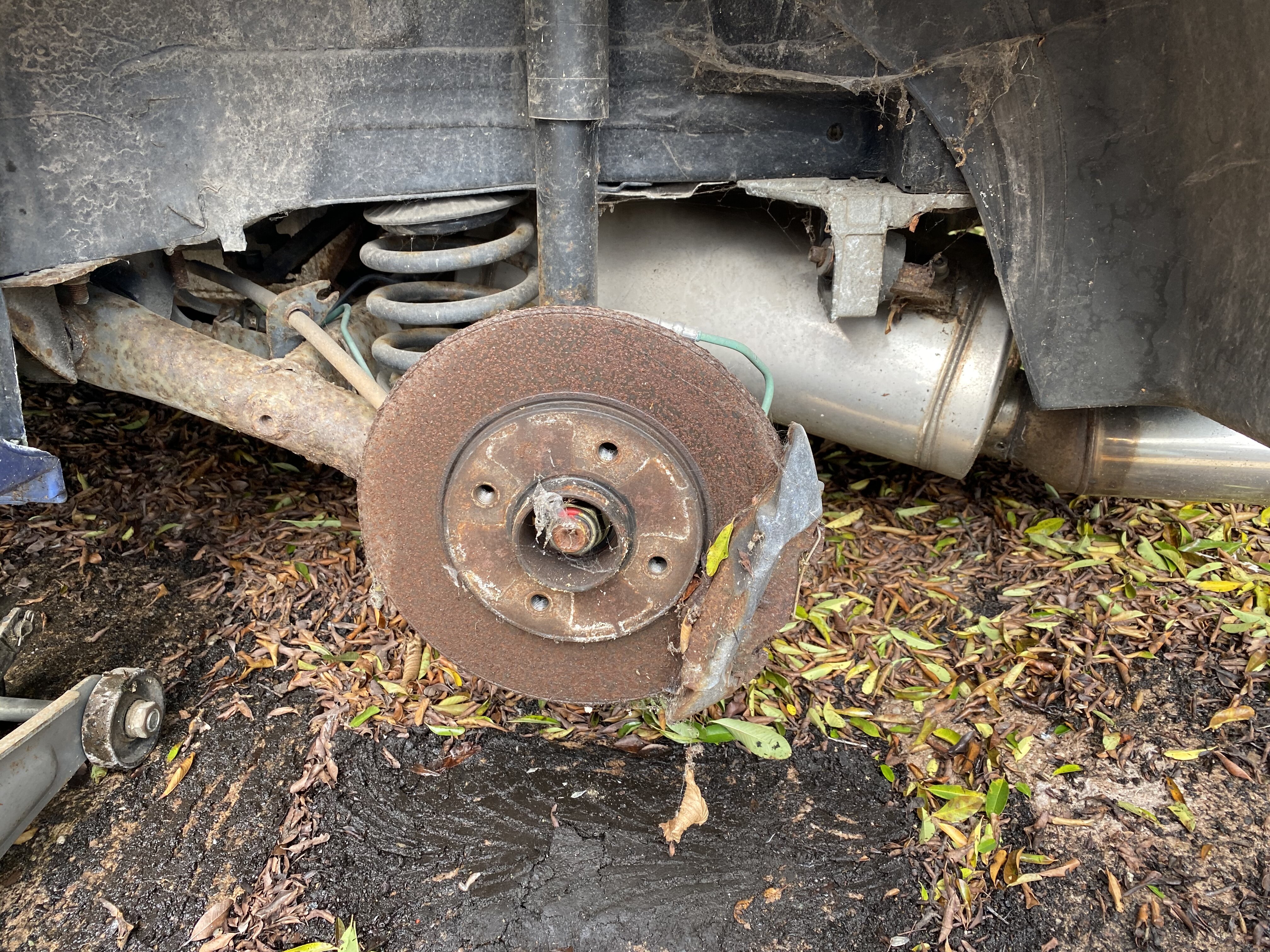

I’ve ordered myself some 4-pot brakes from KTR (2 weeks till they get here) Ive removed the old rear brakes and I bought new Pagid calipers and discs - that was after 4 hours of drilling to get the security bolts off (rusted to buggery) wheels are flaking pretty bad aswell.
I’ve realised it’s better to clean and paint any rust that’s starting, but as soon as they front discs and calipers arrive I’ll be able to move it - hopefully to garage to do the cam belts (planning to get all new hoses and alternator)

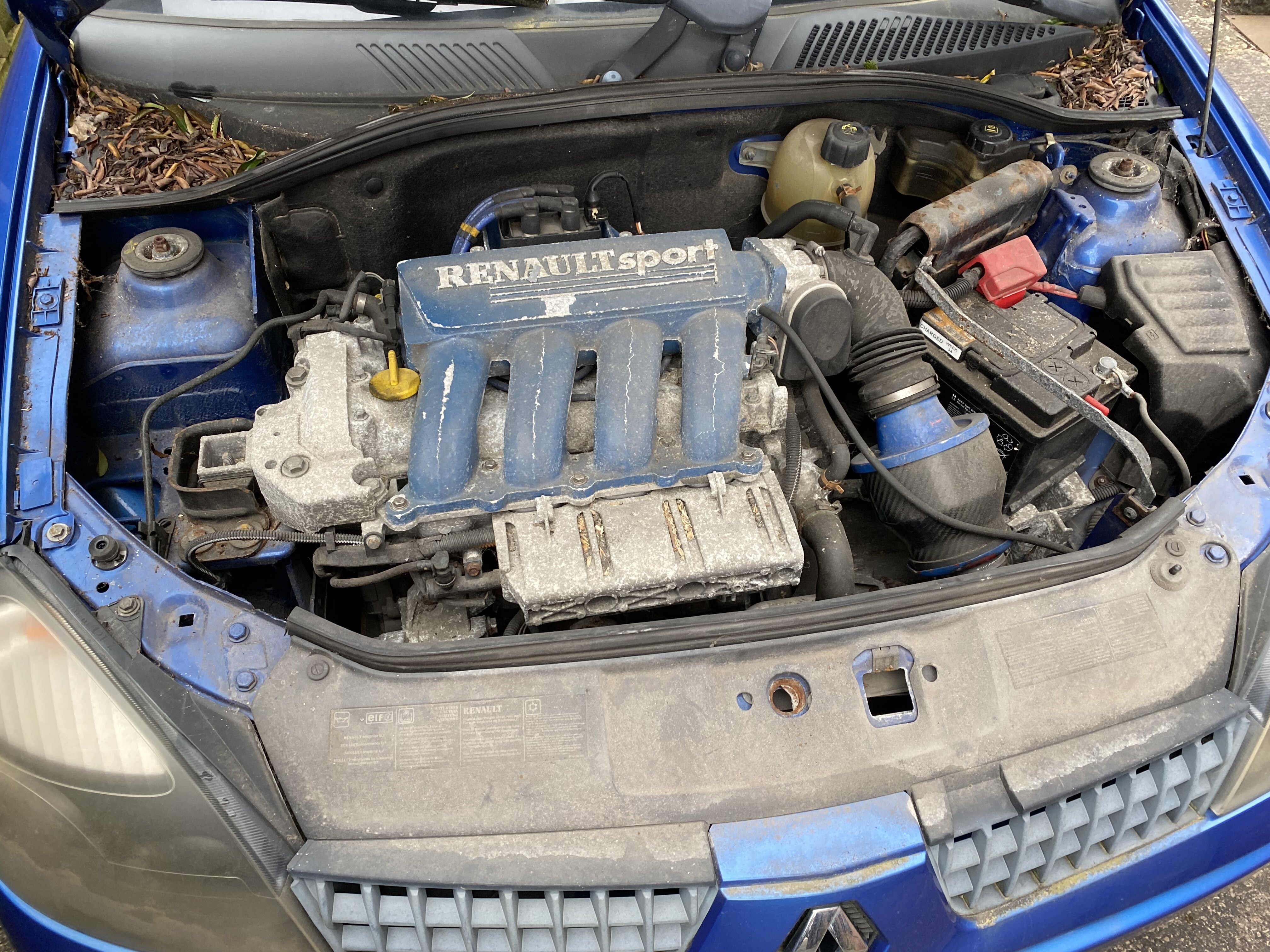

but I’ve got a question, ‘ the car has been stood still since 2011’ is the clutch fu*ked - how can I tell, I don’t want to start it I till the belts are done and I can’t test the clutch till it runs, not sure how to figure that one.

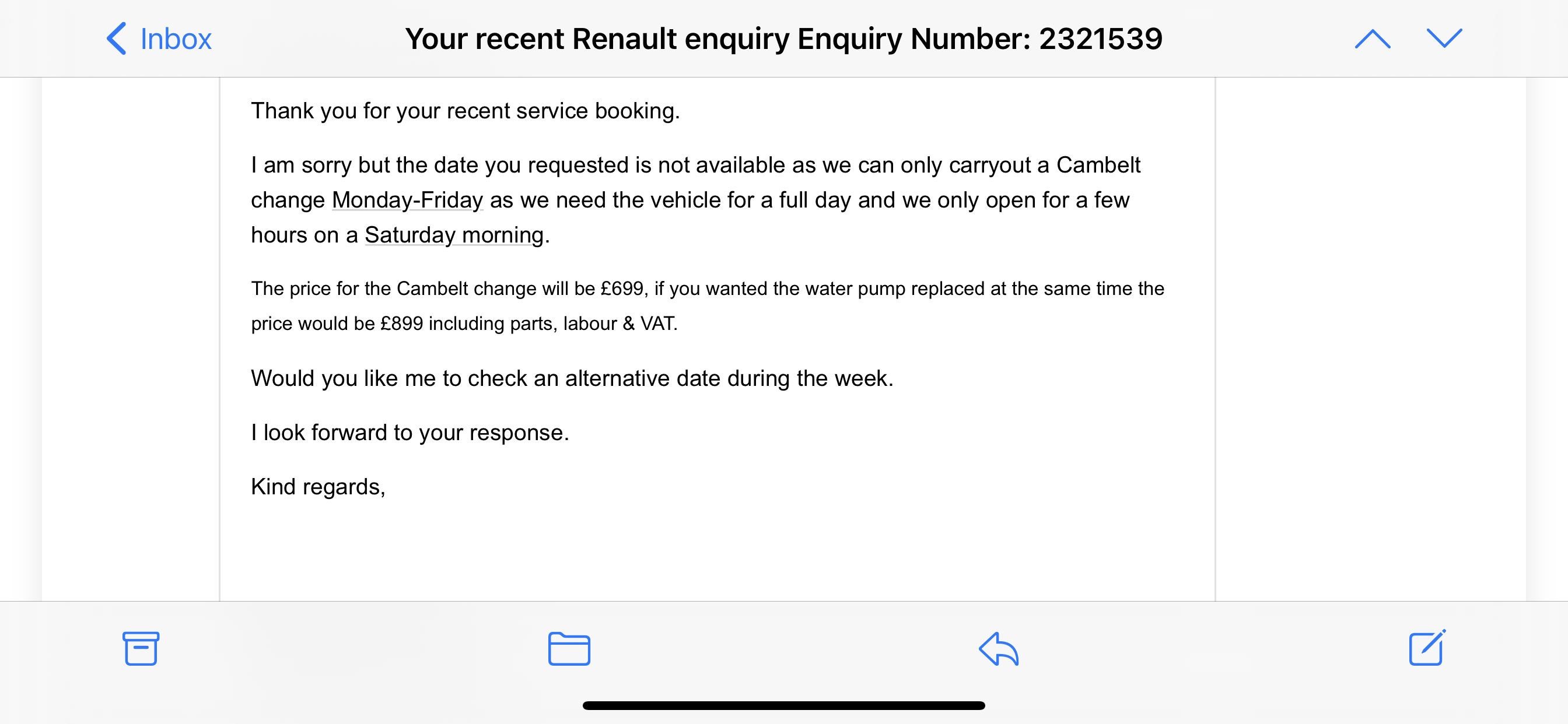

Well Renault Stockport want £899.00 for cam belts and a water pump. When I asked Manchester Trinity about checking the clutch during the quoted £499.00 change he said ‘the engine doesn’t come out so we’ll check it after’. ?! Hmmm

Stick the car in reverse and try to push it forwards with a couple of people. If it just stays in place after rolling 1ft then your clutch will be fine
If it just keeps going forward and rotates the engine then it will be shagged
You’d be able to get the clutch and belts done for under £1000 at a specialist, it’d be an idea to check with them?

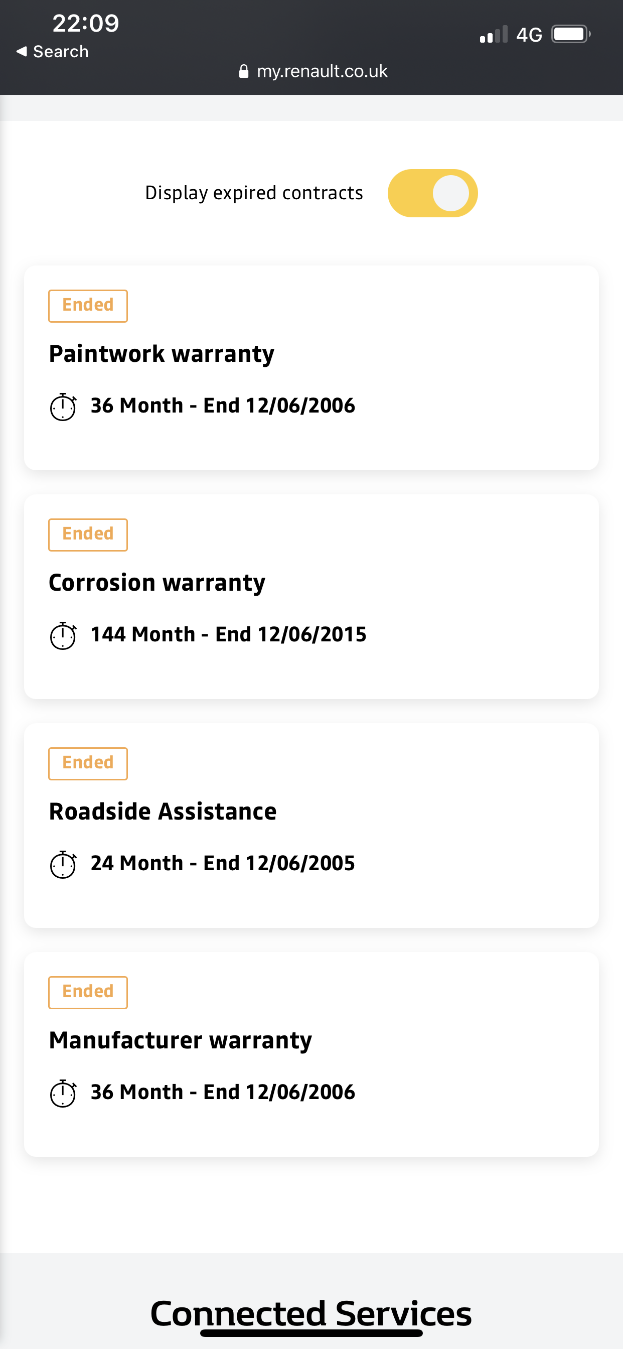

I’m struggling to find a list of recall notices for the Clio, I remember something about the bonnet catch & maybe the suspension mounts or bolts?
I registered with Renault but that gives you nothing useful except my paint warranty ran out in 2006 - corrosion ran out in 2015 pretty surprised with that.

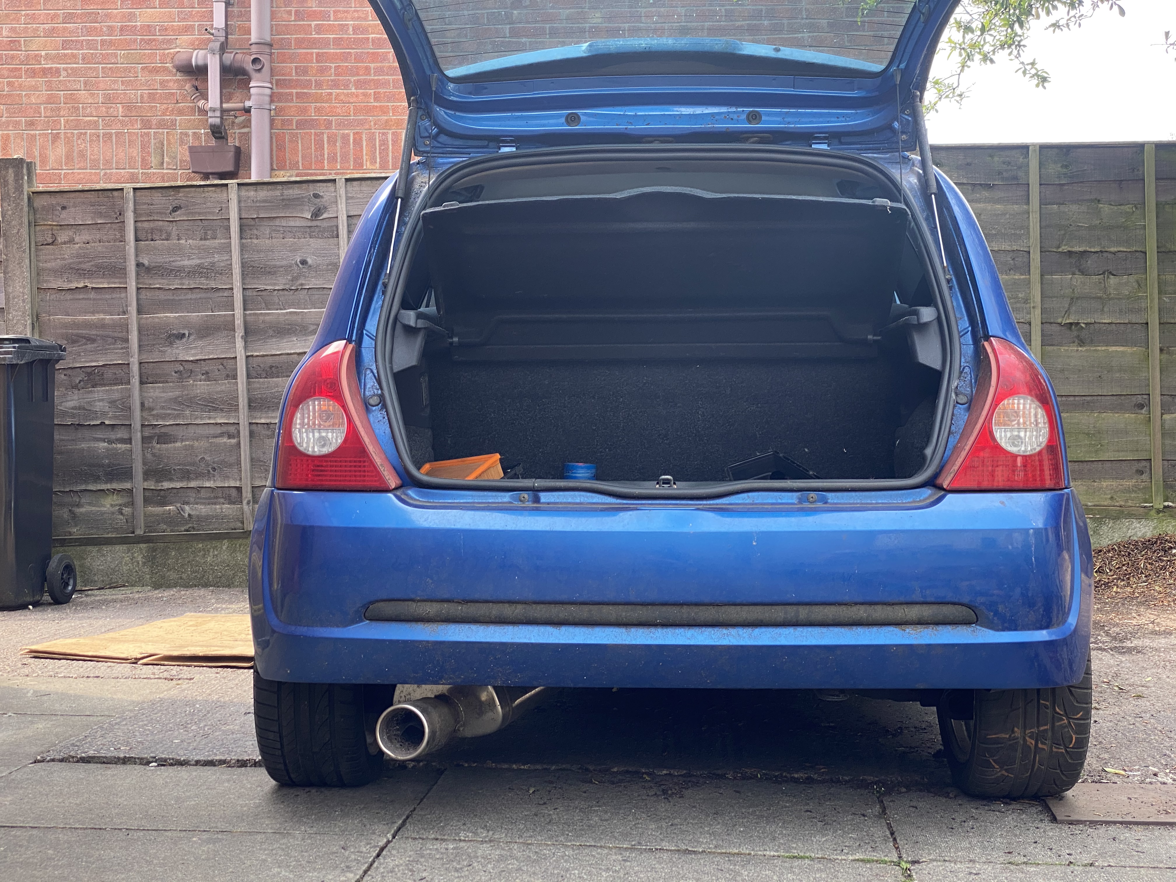

I'm really not keen on how that back box looks. It's hanging way too low imo.
