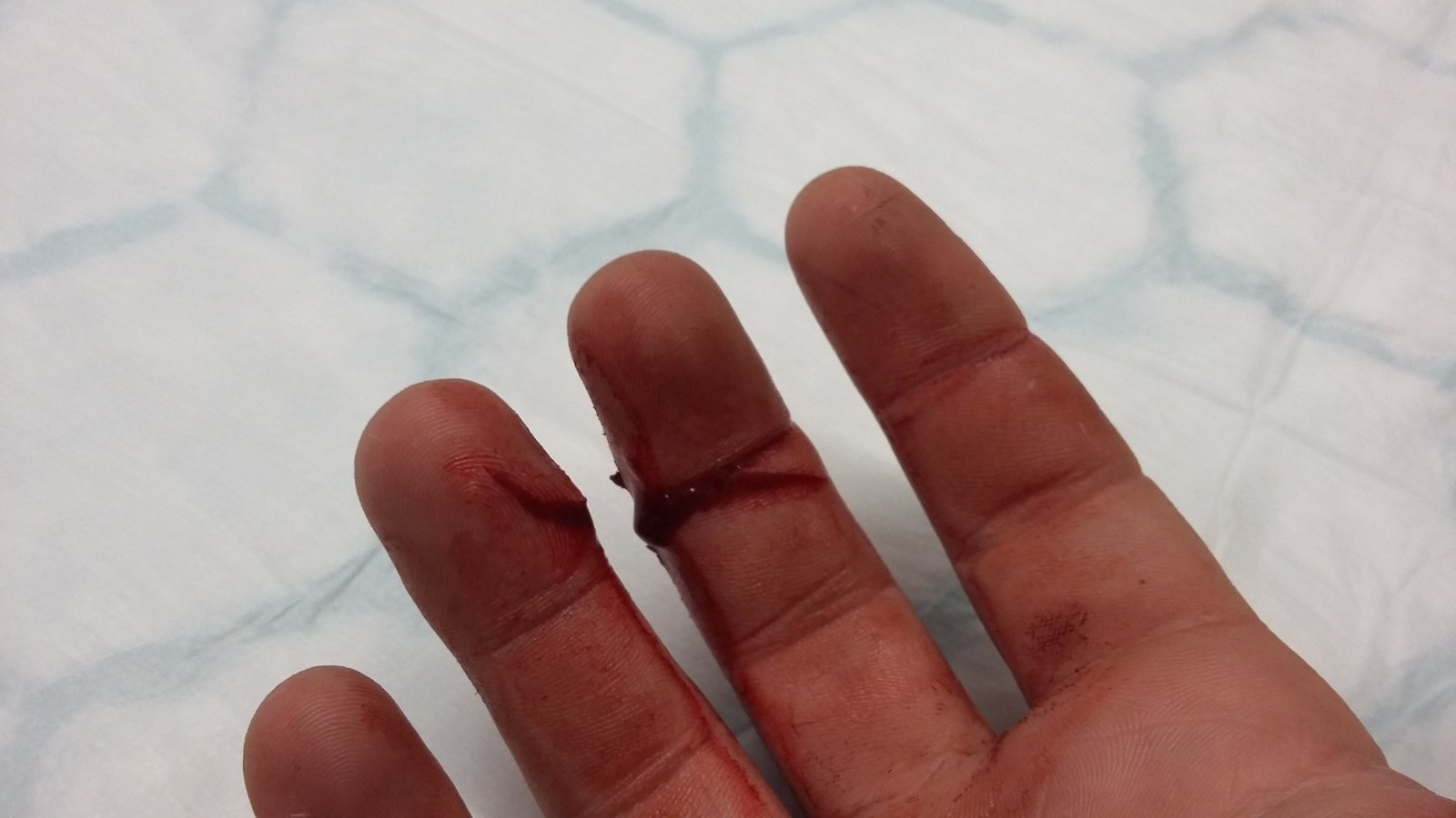

Another delay with working on the clio as I've had a whoops in work.

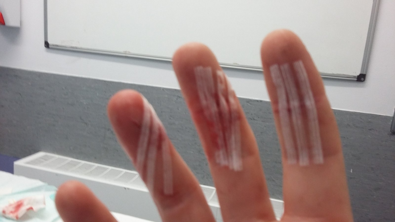

Slipped with a Stanley knife across 3 fingers.
Slight blood pic is at the bottom.
This was when I was in hospital and had just opened up my hand after a 2 hour wait so the one finger hadn't opened up again, but it soon did when the doctor was prodding about. Blood was pissing out then. They had to tie rubber gloves round my fingers to stop the blood enough to clean and dry them to get the strips on.
Luckily there shouldn't be any long term damage.

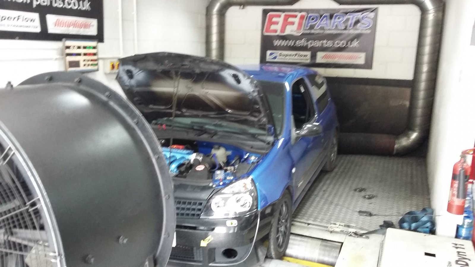

I was stuck in work all weekend so havnt touched it but I have collected 6 michelin tarmac tyres, entered a rally at Weeton on June 12th, and it's going to be mapped on Thursday.

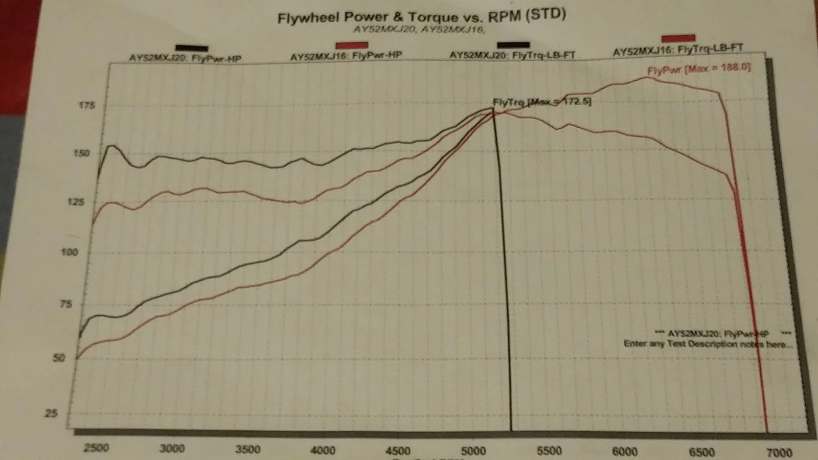

Engine spec
Ph1 F4R 730 engine on 91k miles. Cambelt, dephaser and water pump were changed on 87k along with fitment of the following at the same time:-
Ported and polished head by AL Developments, new stem seals and guide tolerances checked.
Supertech inlet and exhaust valves fitted by AL Developments
Piper BP270 cams fitted complete with shims
ARP conrod bolts
NGK Plugs
Magnecor leads
All new top and bottom end genuine Renault gaskets
Ph1 inlets, ported and matched
Adaptor plate and ph2 throttle body fitted
Standard airbox with K&N panel filter
182 manifold
Sports cat
Ktec supersport stealth exhaust
Well I finally got some more work done on it today. Due to working in Spain and then going straight to a weekend away with the family I havnt touched it since I had it mapped.

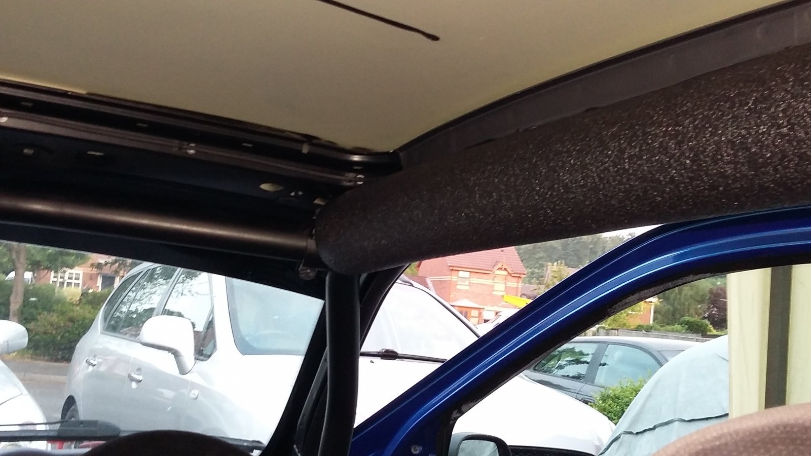

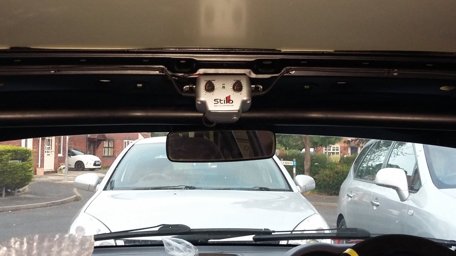

The Intercom is now fitted and just need to live wiring up to the new fuse block I am waiting for. I also dropped the nut from the case so it's just taped on for now. The upper cage padding is on too.

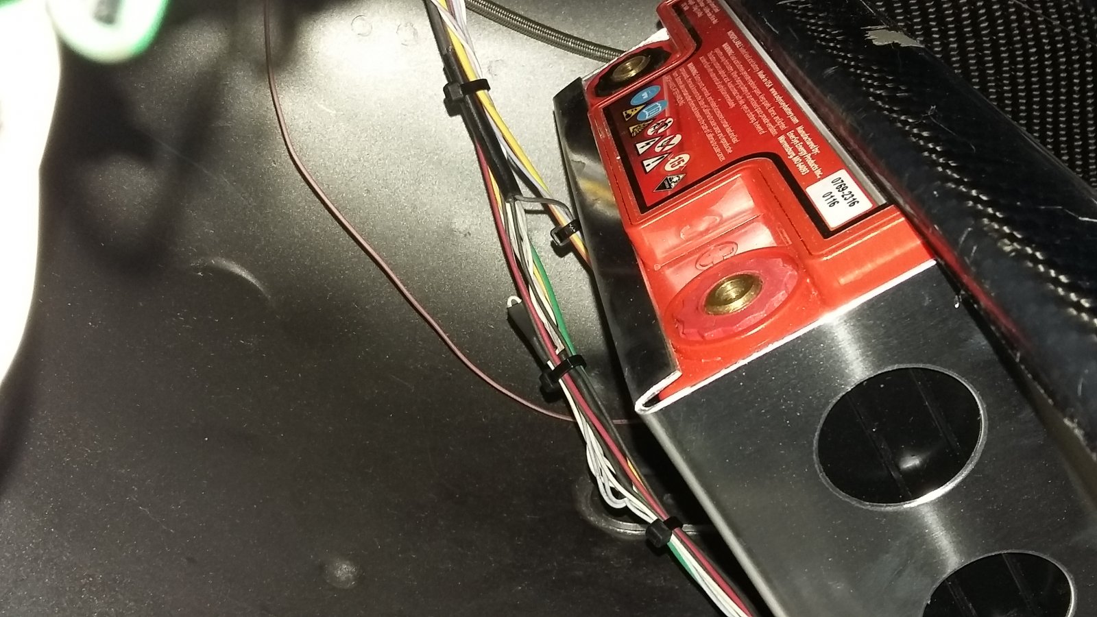

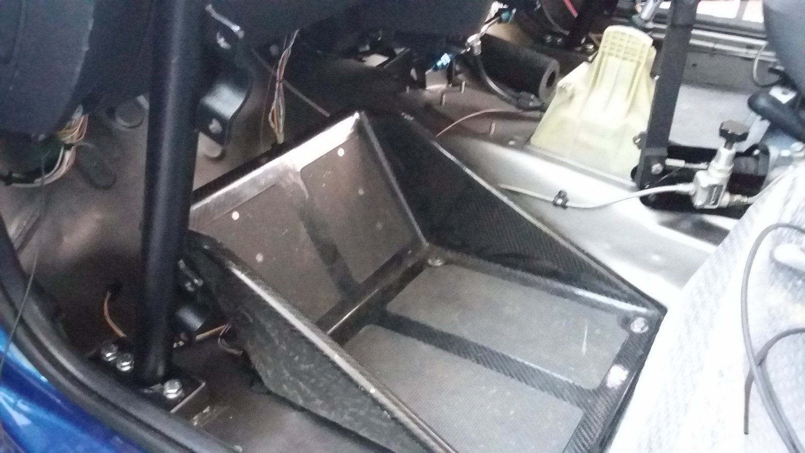

The new odyssey battery is now mounted on the back of the codrivers carbon footrest ready to be connected, and the footrest is now bolted in position.

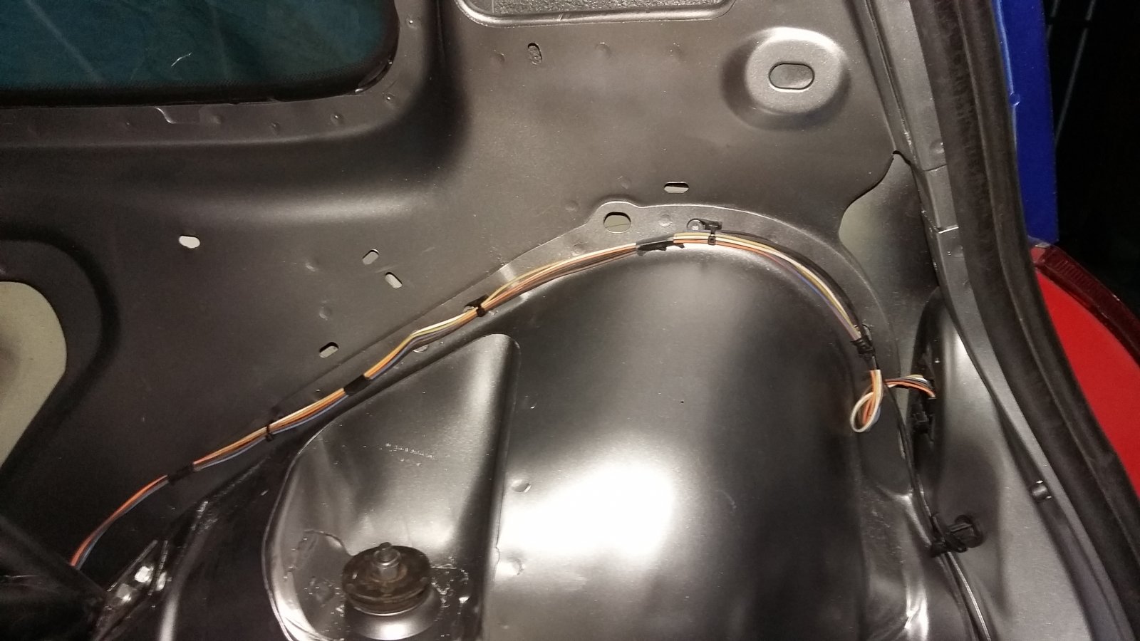

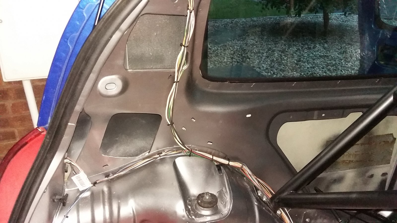

I have also started to tidy the rear loom up up cable tie clips so that's a lot neater.

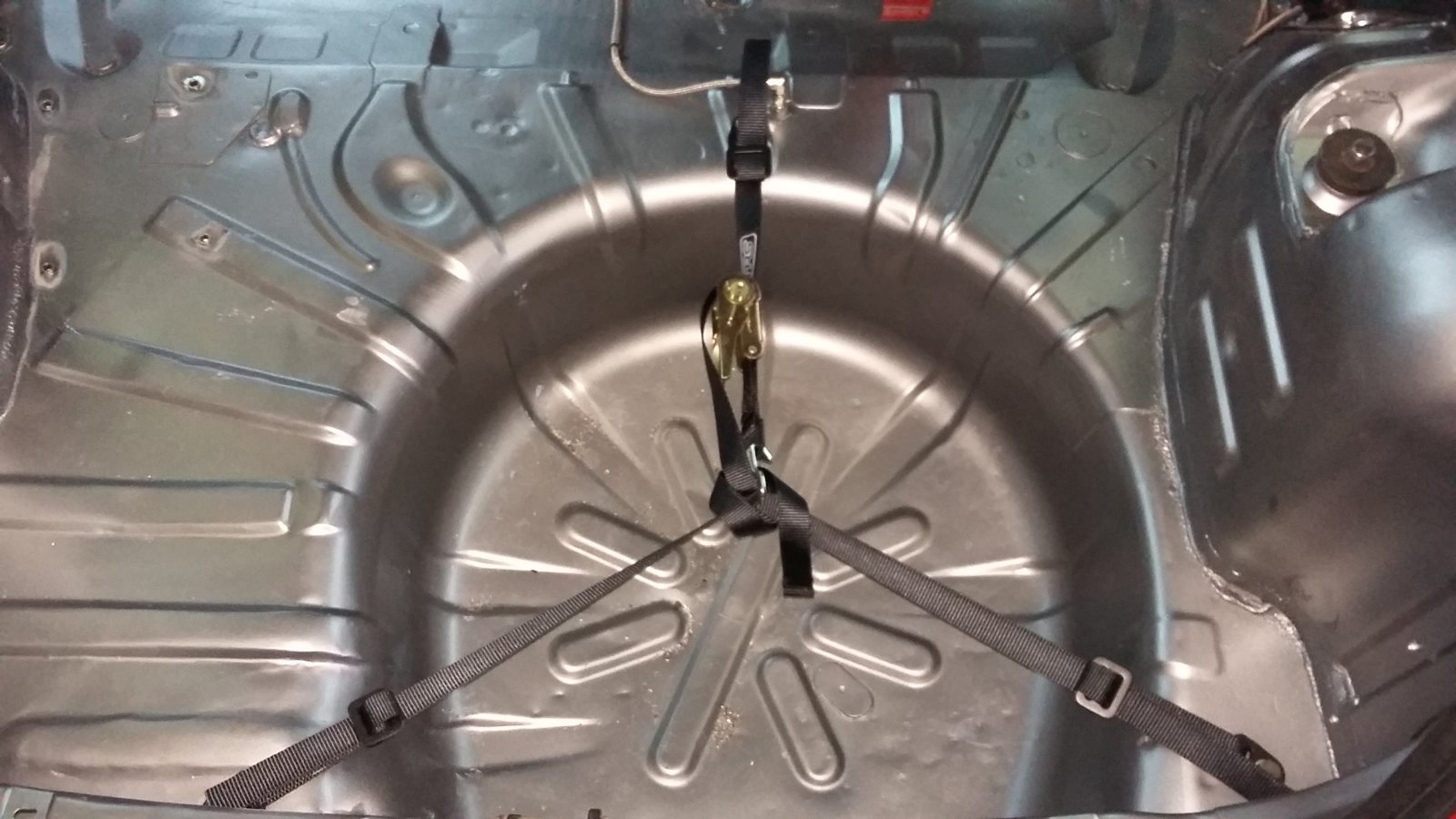

Fitted spare wheel strap

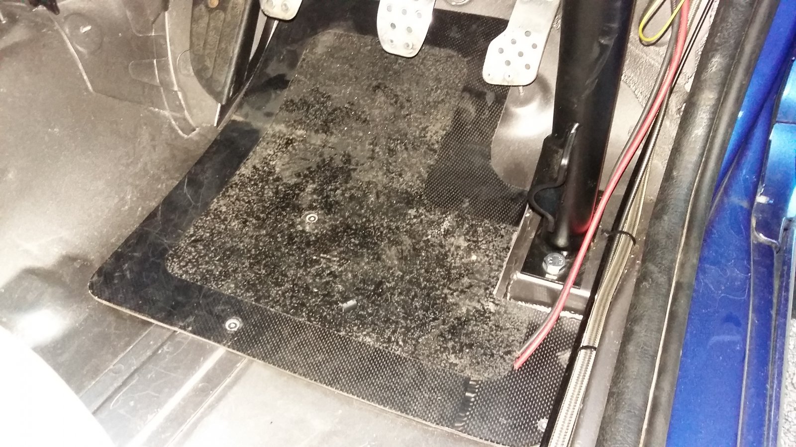

Carbon drivers foot plate (had to cut it to clear cage base plate)

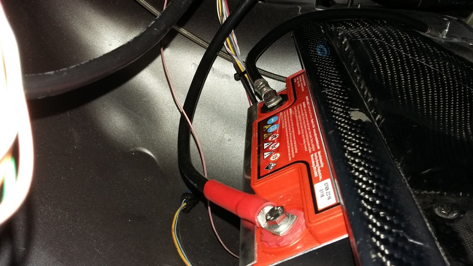

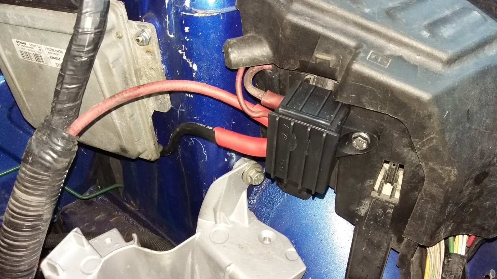

The big battery is now removed and under bonnet cables are now joined in a 2 way busbar.

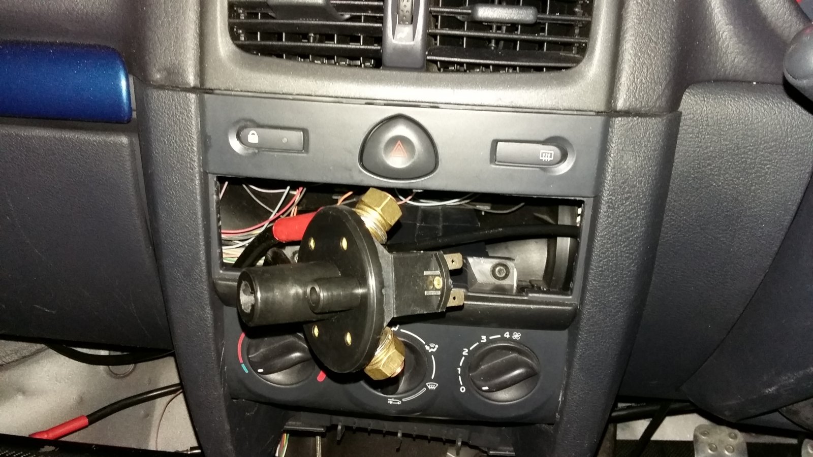

Cable runs into car to autolec cutoff and then to the odyssey battery which I have also made and fitted a new earth strap to.
I havnt made the blanking plate for the autolec yet so it's temporarily sticking out the dash. I still need to wire the ignition live through the cutoff relay too.

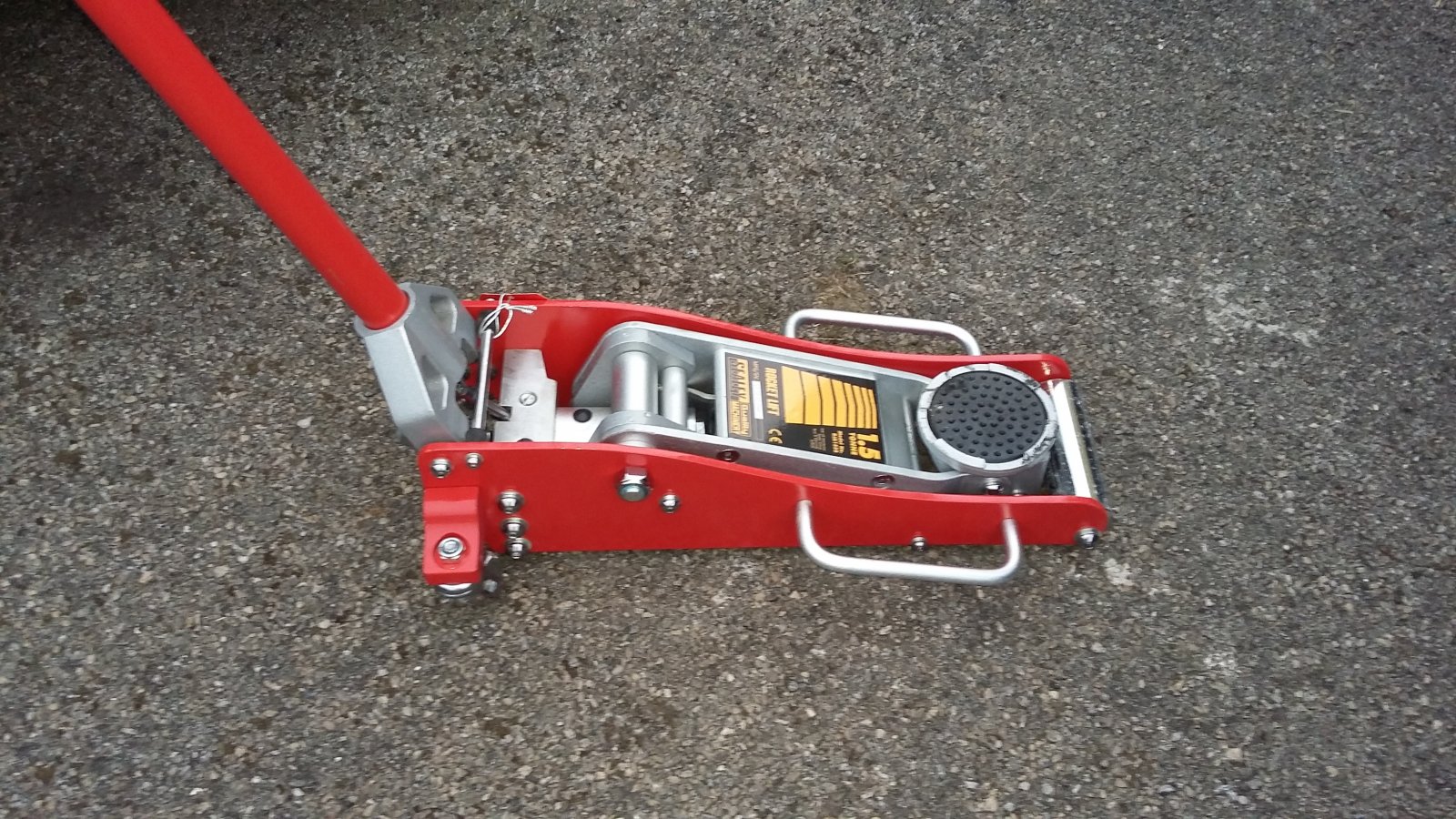

Finally, one new addition arrived today that helps is my new low entry jack. Save's me a lot of messing about.

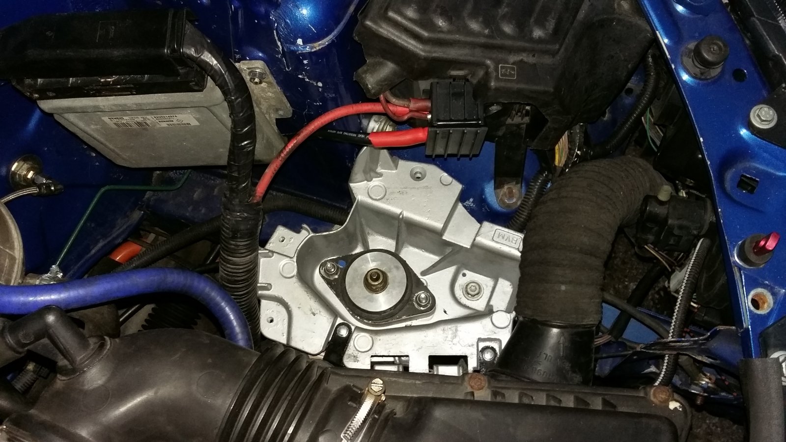

Epas is now wired and working, as is the autolec cutoff (kills ignition correctly), although I need to make a plate for the radio gap to secure it.

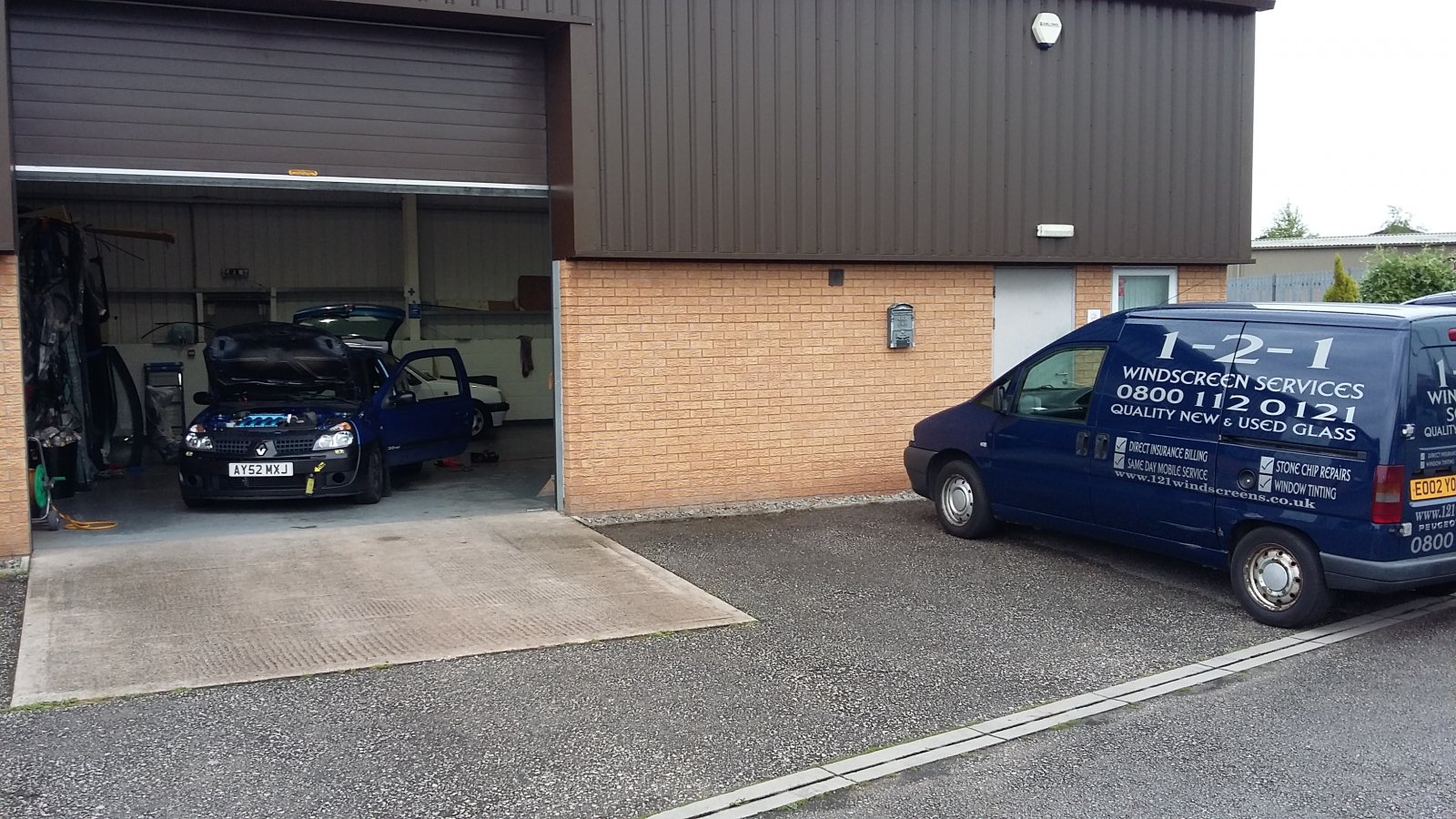

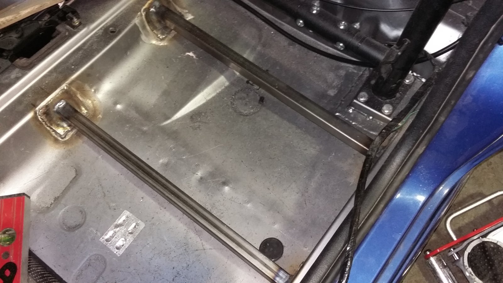

Trailered the car to mates workshop, took basic seat out and started the measuring and marking out.
The passenger rails are now in and I'm halfway through the drivers side.
I have also welded in the nuts that secure the plumbed in extinguisher.
only the one pic as there's not much else to see.

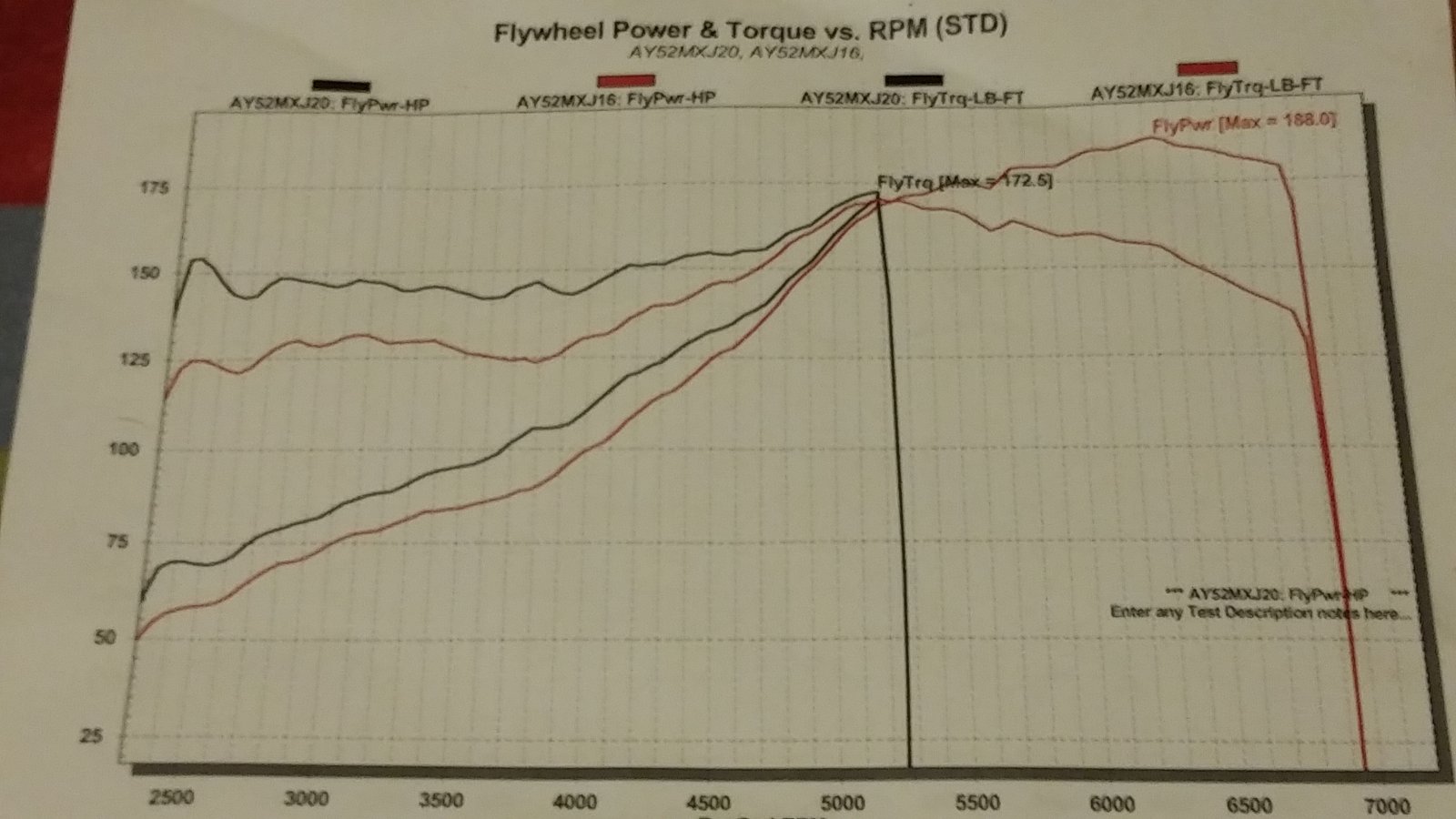

looking good paul! Nice to see some familiar bits!
impressive figures on the engine side, the 206 only made 170bhp after mapping on the same rollers! and that's on jenveys!
