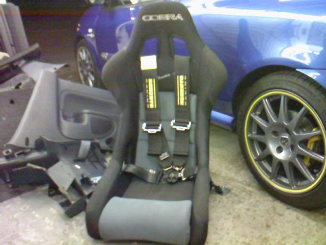

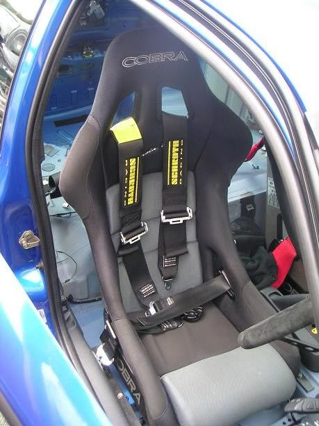

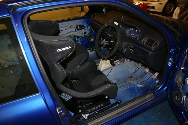

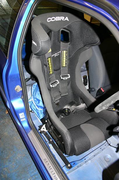

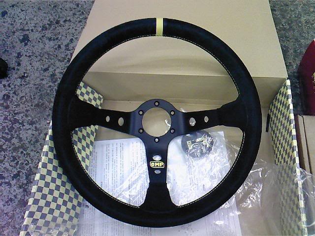

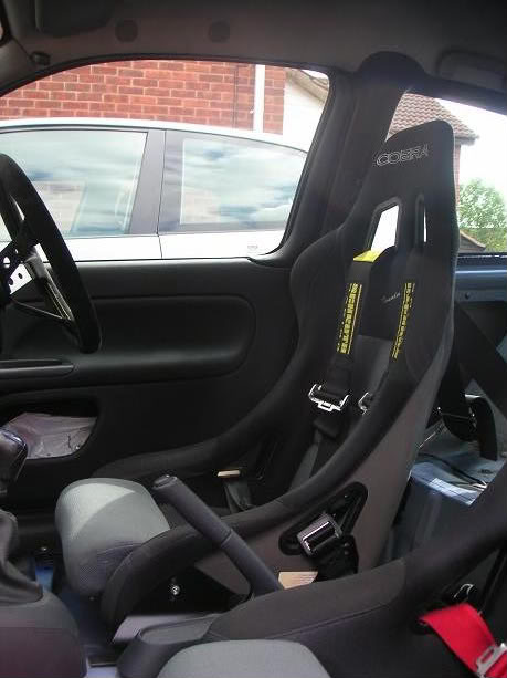

So after driving it around a little i realised i had to do something about the driving position(idiot french designers), the seats were too high, steering wheel badly positioned so i did some purchasing
Cobra Imola 2, Schroth Profi III ASM drivers harness(cheap crappy passenger harness off a mate) then a OMP Corsica steering wheel.

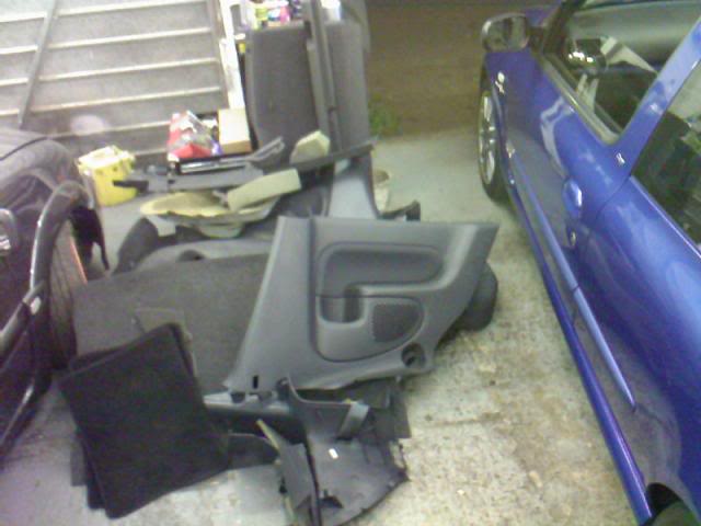

Also stripped all trim from the rear then all carpet and sound deading
Rather large weight saving of about 30kg.
Still have front door cards and roof lining. Front door cards will be changed for carbon ones once i actualy find some descent ones that dont cost some stupid price. Then head lining will come out once i get the interior sprayed as it looks shite under there at the moment.

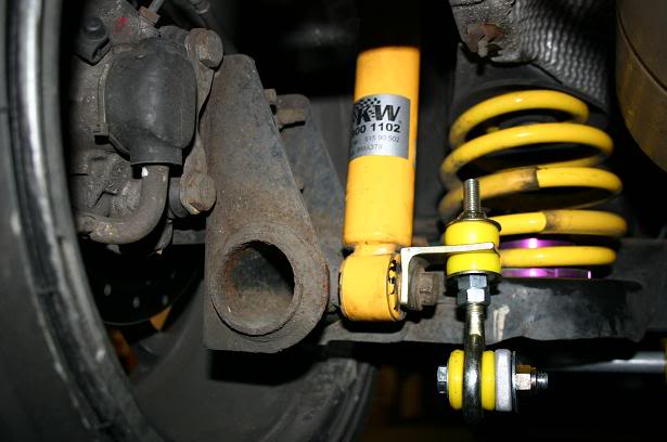

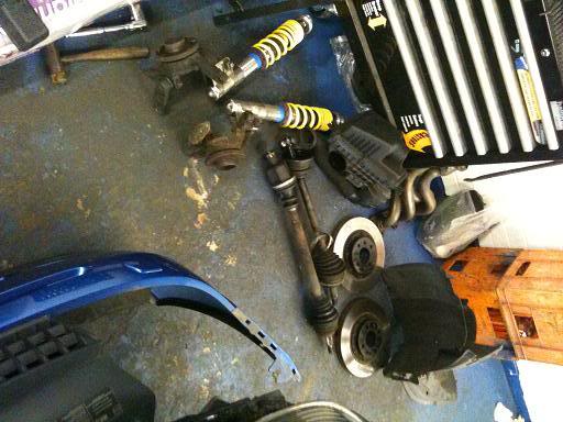

Next up was the suspension. After looking around for a while and speaking to a number of people i decided on KW V2 Coilovers

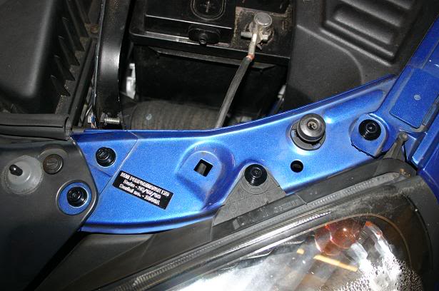

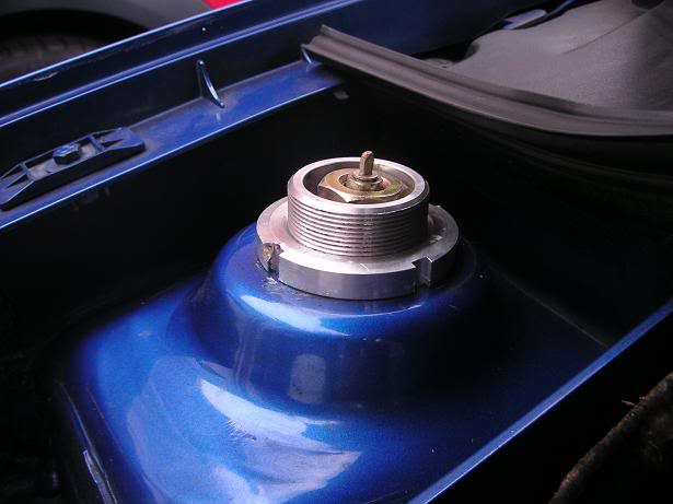

Next were the topmounts, seeming the standards love to move around and feel so bad they had to go. So brought these
Compbrake units, got to say compbrake have done a fairly good job for once. Then a couple days later K-tech realised there new ones so i am waiting for compbrake to do there normal thing and break and i will replace for them.

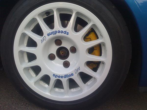

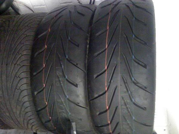

So wanting to get on track soon i brought a set of Speedline 2118's then a set of Toyo R888's to go on them

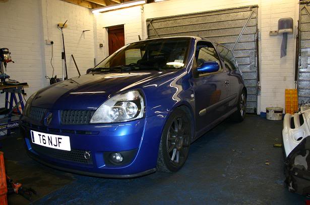

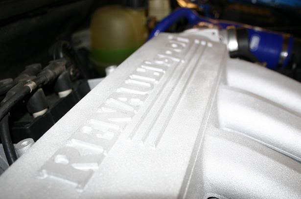

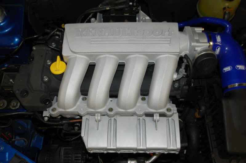

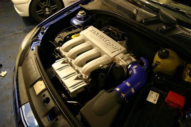

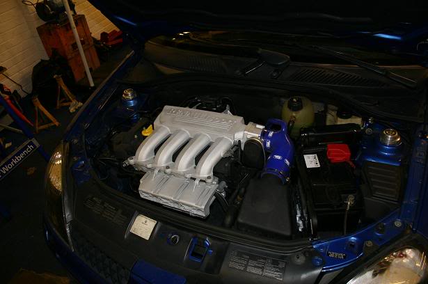

So once that was over i started to notice a few issues with the engine and the clutch was never the same really so i started with the intention of just sorting he little issues and be done with it. Then a 182 manifold popped up at a brilliant price so i snapped it up. Then it slowly grew into a bigger list of things i wanted to do so in the end i gave Fred a ring, so a long story short this is what i had done
Catcam 428's
cam seals and all the little extra bits
182 manifold fitted with all new fitting kit and nuts
joining pipe from manifold to my 172 exhaust(also having a 182 altered to fit for MOT)
AWT Matched Inlets
crank seals
sump seal
Cam/Aux belt kit
New plugs
Valeo Clutch
Then all finished off with a RS Tuning Remap.
In the process Fred cleaned and painted all my engine and inlet and it really looks a new engine.
So in the end it made 190bhp and 160FtLb Torque.
I need to make a point here about Fred(BTM Performance) the work he has done is brilliant, he kept me up to date will all the progress, the car runs brilliantly and the quality of the work is second to none. HIGHLY recommend.

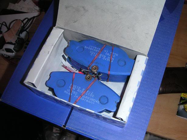

So now it is back its from Fred i got around to sorting the brakes.
Pagid RS4-2Blue front pads
Keeping the brembo HC grooved discs
K-tech rear discs
EBC Ultimax Rear Pads

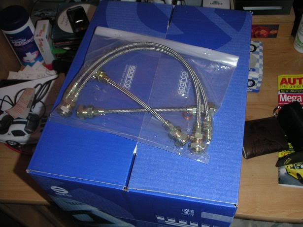

Exact Braided Lines
AP Racing DOT 5.1 Fluid

oh by the way, i've heard through the grapevine that those exact brake lines are far from it, apparently they don't fit properly, just a word of warning fella!
Yea there not the best bits of kit really, they are all fitted and are ok now but the connections where twice the size of the holes they were suppose to go through. Nothing some grinding stones couldnt sort out though.

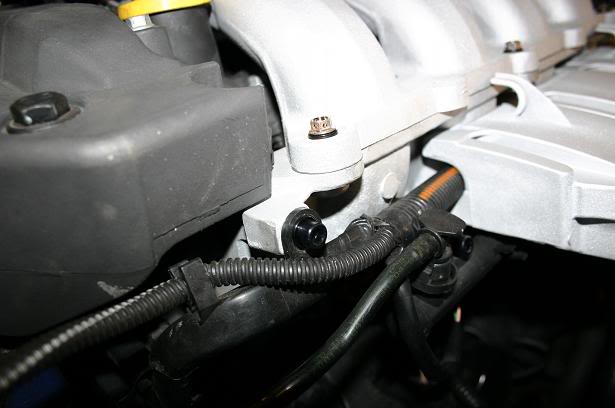

Unforently with how busy i have been the car hasnt had the most attention and the engine bay is looking a little dirty and needs some TLC. But to treat the bay i have brought some nice tasty bolts/nuts so will give it a good clean and fit these when they arrive.
Next up is the interior. Do have a new drivers seat but the passenger seat is just back to a standard for a little while. The rest again is looking sorry for itself.
But with this i will be stripping eveything out and respraying everything. exchange all the nuts/bolts for some nice fancy ones.

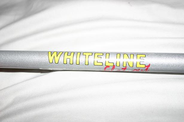

get a whiteline rear arb

pagids are brilliant. very impressed, do need a little heat in to start working well then when there at a descent tempertaure they are brilliant aslong as you use at least 5.1 fluid as it boils 4 very quickly.

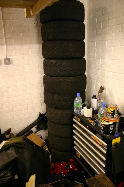

two full sets or tyres on the 2118's are near new then 2 spares that are near new and tyre that are barely legal but will stil take a bit more abuse on track.

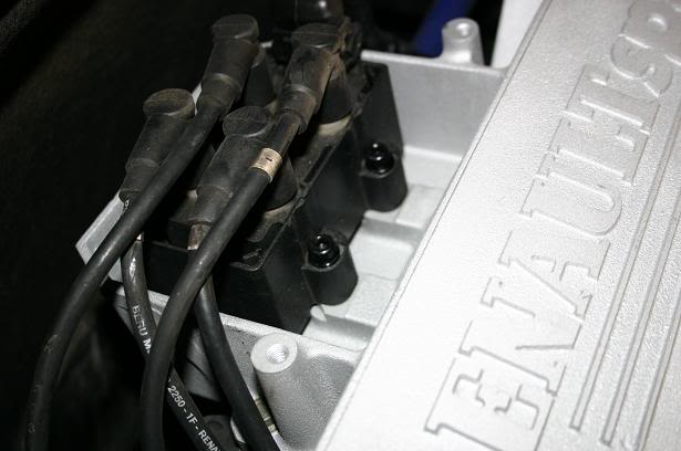

So i have finished respraying my interior. Really pleased with how it has turned out. I have rerouted the wiring in the rear now so its all hidden away. Looks so much better. Been busy this week though so getting pictures has totaly slipped my mind about that. Will get some tomorrow.

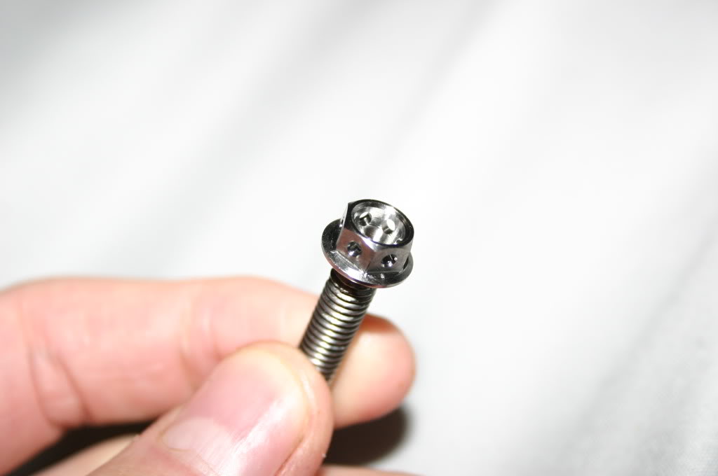

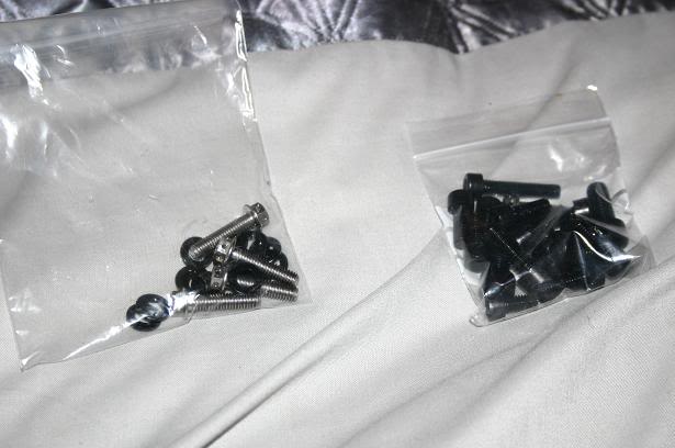

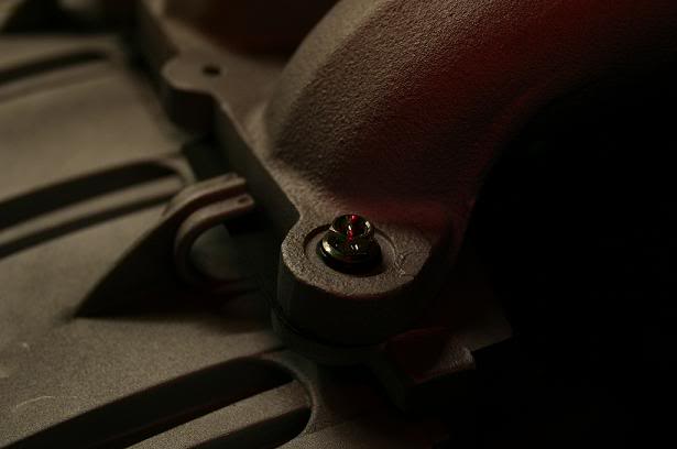

OK so i finaly have the pictures of all the bolts i brought. And yes most people will not care "its just a bolt" you will be thinking but little bits like that make it just look a different for me so keeps me happy.
hhhmmmm "Race spec" drilled Titiuam

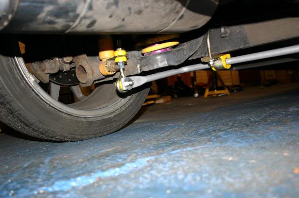

Next got this delievered the other day and got it fitted
Put on the softer setting at the moment just to make sure everything is OK but can already feel a difference. Helped more so seeming there is no weight in the back so tightened it all a little.

Still waiting for the top mounts to break?
