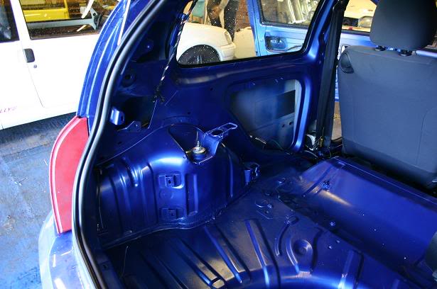

Ok so finaly got a picture. Not the best as makes it look patchy. Its not in real life, just light in a few areas. Im happy anyway
And yes crappy standard passenger seat at the moment :dapprove:

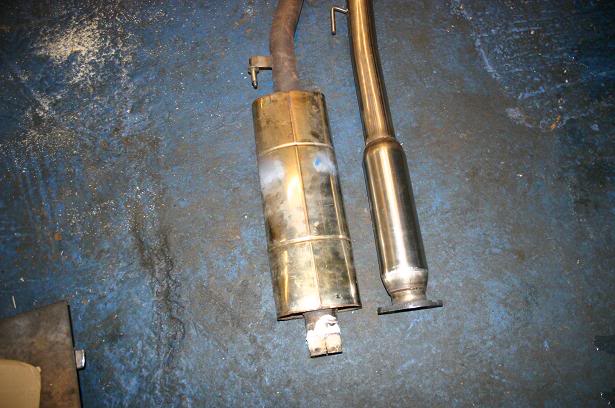

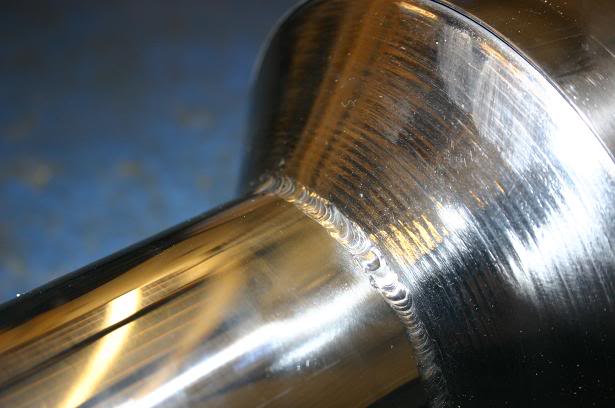

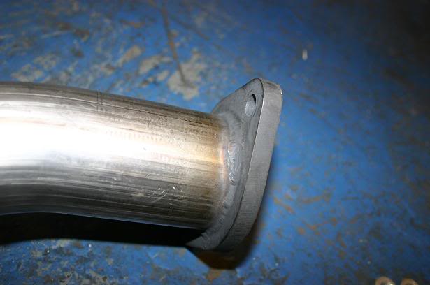

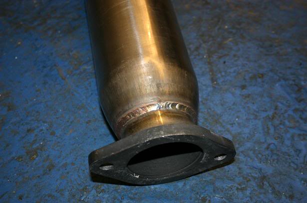

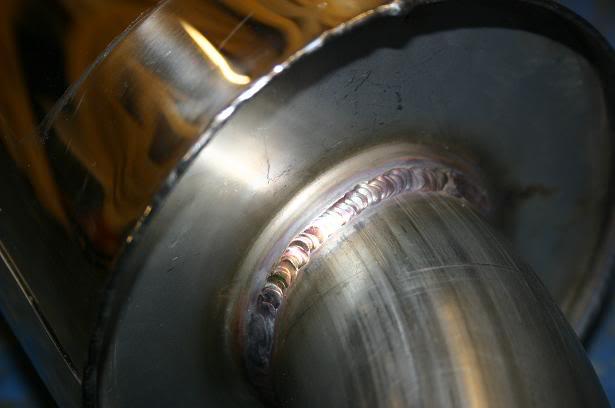

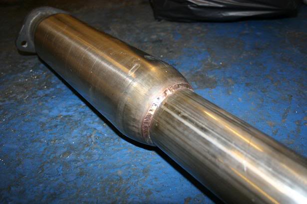

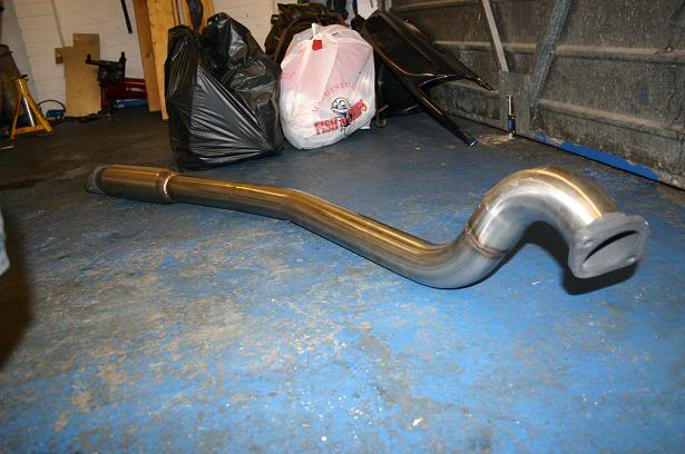

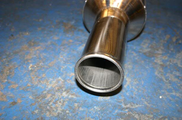

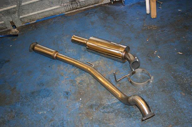

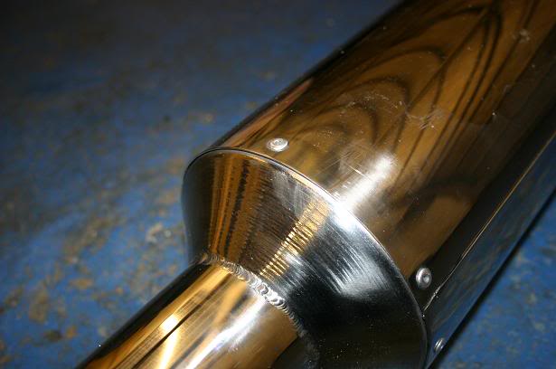

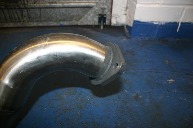

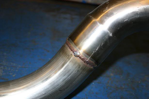

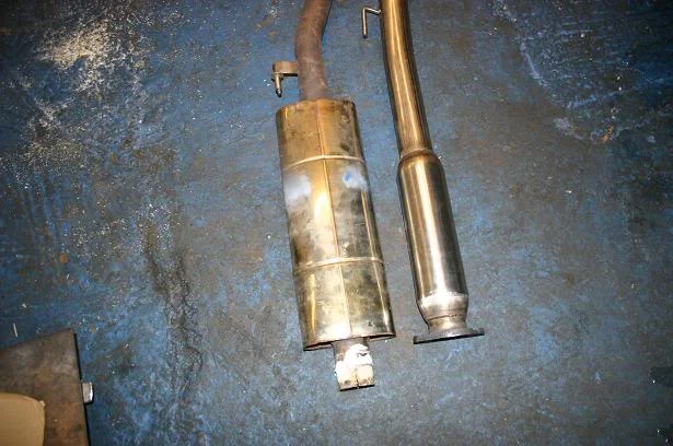

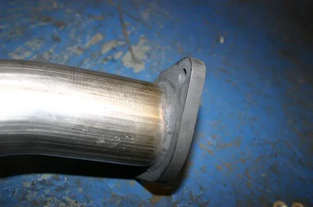

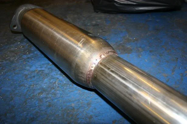

Right so as said i went over to Freds today. Came away a bit lighter of money. So basically i was fed up of the awful k-tec stealth exhaust, cheap crappy restriction in my opion. Its a perfectly fine exhaust for your average normal road car but as its not and im spending money on other areas i do not want that holding it back. So thats going and a beautiful yozzasport race system has been brought. Got to say i am very very impressed with the quality.
Unforently its not fitted yet as the jioning pipe i am using for the 182 manifold to the 172 exhaust is too long so hopefully will be going to Fred soon for that to be sorted.
but heres some pictures of the difference between the two and some of the brillaint craftsmenship in the YS.
Love the quality, really looking forward to it getting fitted.

Another who shares my opinion that the stealth is shite!!! They are poor and over priced imo, like all Ktec stuff.

Did look good quality. Did get about 200 pictures of the exhaust before realising i may of gone over the top!

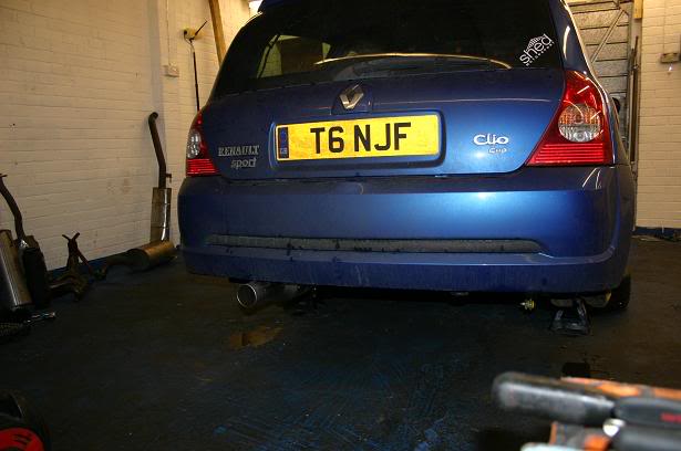

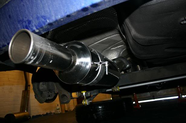

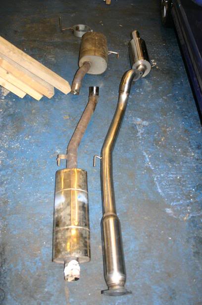

Right so went over to Freds yesterday to get my exhaust jioning pipe adjusted. So the exhaust is now fully fitted, is so much better. Also not as loud as i thought it would be, allot better sounding then the k-tec. Even quiter below 4k as the ktec just gave of a deep droaning noise. Then in the high revs its a brilliant sound. So glad i got rid of the k-tec.

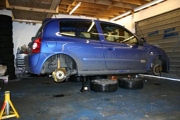

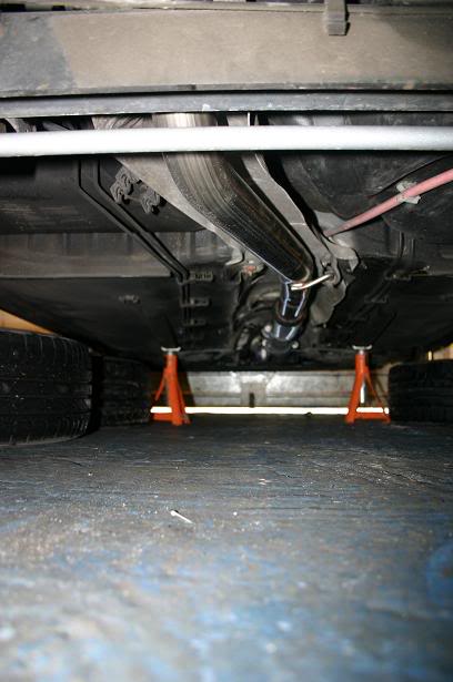

So today i got the car on stands to have a quick check of everything and got a few pics the exhaust.
So dirty

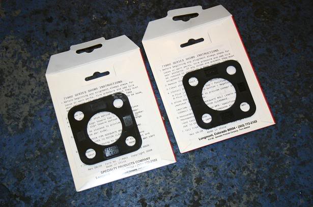

Also got a set of rear 1degree camber shims from Fred whilst i was over there.
So the plans over the next weeks is get the shims fitted. Replace the bearings out of the rear discs, only had them a few months but the bearings are ruined already. Just need to find out what size they are and get them ordered from GSF.

"Also got a set of rear 1degree camber shims from Fred whilst i was over there."
Hi I thought these were no longer available? how much are they if you dont mind? pm if you wish.

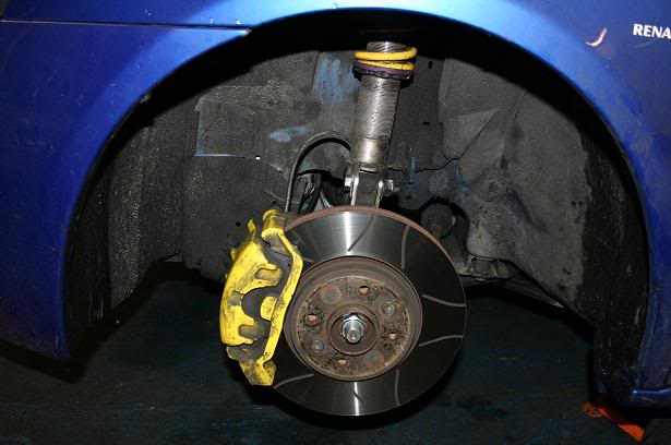

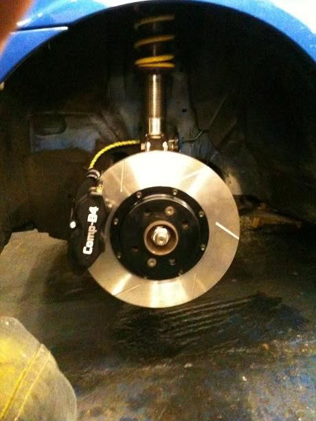

Right so havnt done much for a while but have got/fitted some new brakes.
Compbrake 295mm 4pots
Before
After
Very close to my 15" track wheels. The wheel weights hit the calipers so they will need to be moved but no biggy really.

Please dont just fire those shims in. You'll end up with about 3mm toe in on each side. 30 minutes of neg camber gives 1mm toe in on an X85 with shims so the mk2 will be very very similar.
