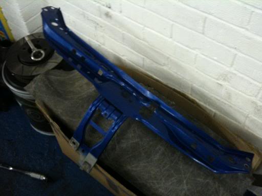

Nice progress mate. good to see :approve: When Fred painted you're TB, did he spray and mask it or powder coat?
  Golf GTD Mk7
just wondering if he did powder coat, how did he do the TB without damaging it? can it be stripped down to remove all the electronices to the bare shell? or would powder coating temps not damage the unit?
  Golf GTD Mk7
Fred@BTM said:
pulled apart and powdercoated? yes, but powdercoat seems to stuggle with engine bay heat
Ok mate, thought it might be more durable :S saves removing them again

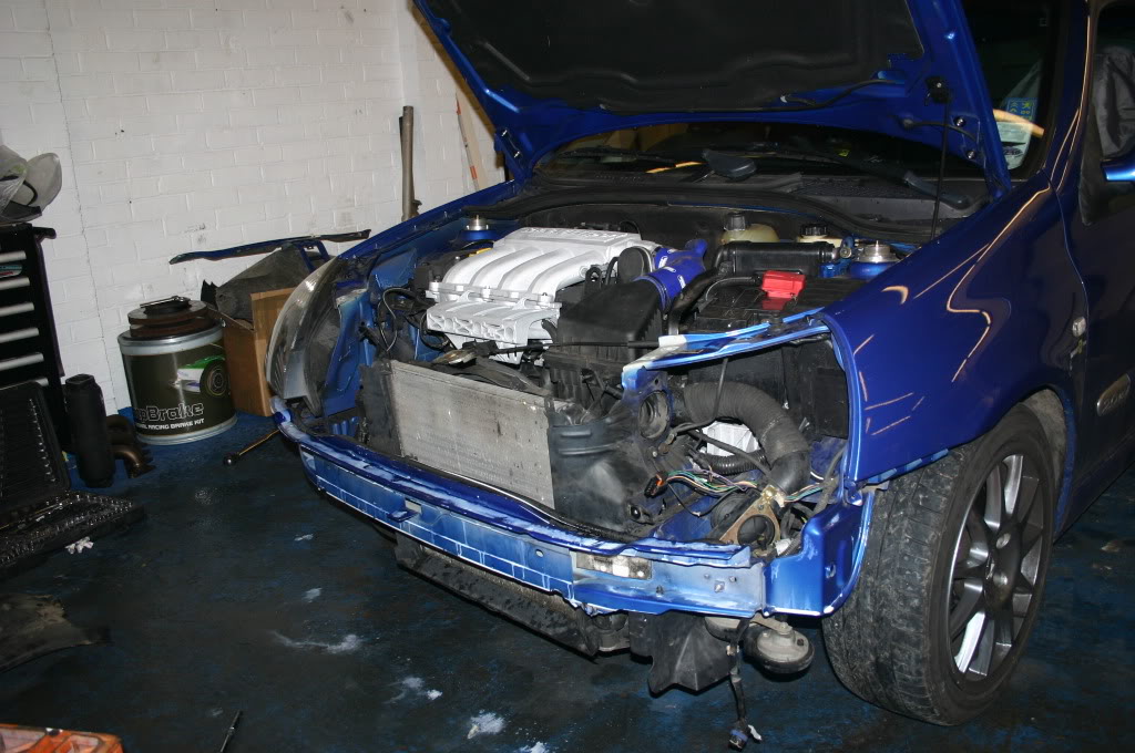

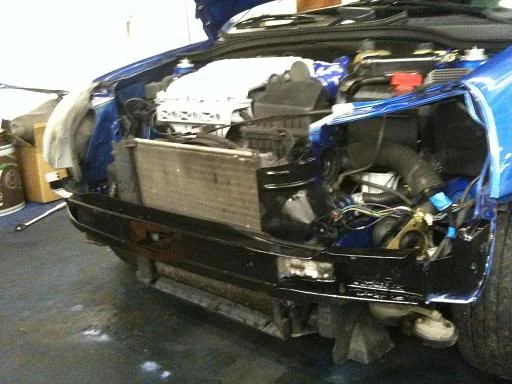

Right so did a little work this weekend. One my headlights had been steaming up recently so thought i would pull it off and get that sorted. Whilst the bumper was off i had noticed the front panel was looking a little tatty with couple small rust patches so thought i would treat and paint it.
Then
Sorted! Yes very little update but still was needed and tidies another bit of the car up.
Cleaned up the slam panel aswell

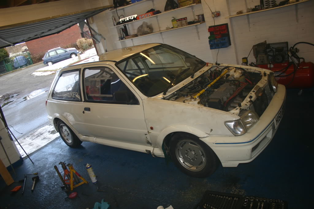

Did have some fun sorting out this beautiful(but rather beaten) XR2i rally car. Well is an i but with a heavy modifed ford motorsport carb'd engine.
