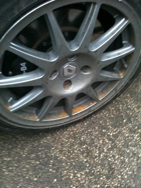

Poor wheels, lucky it is just the brake dust that has gone rusty not the wheel itself

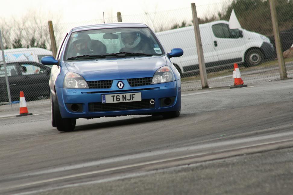

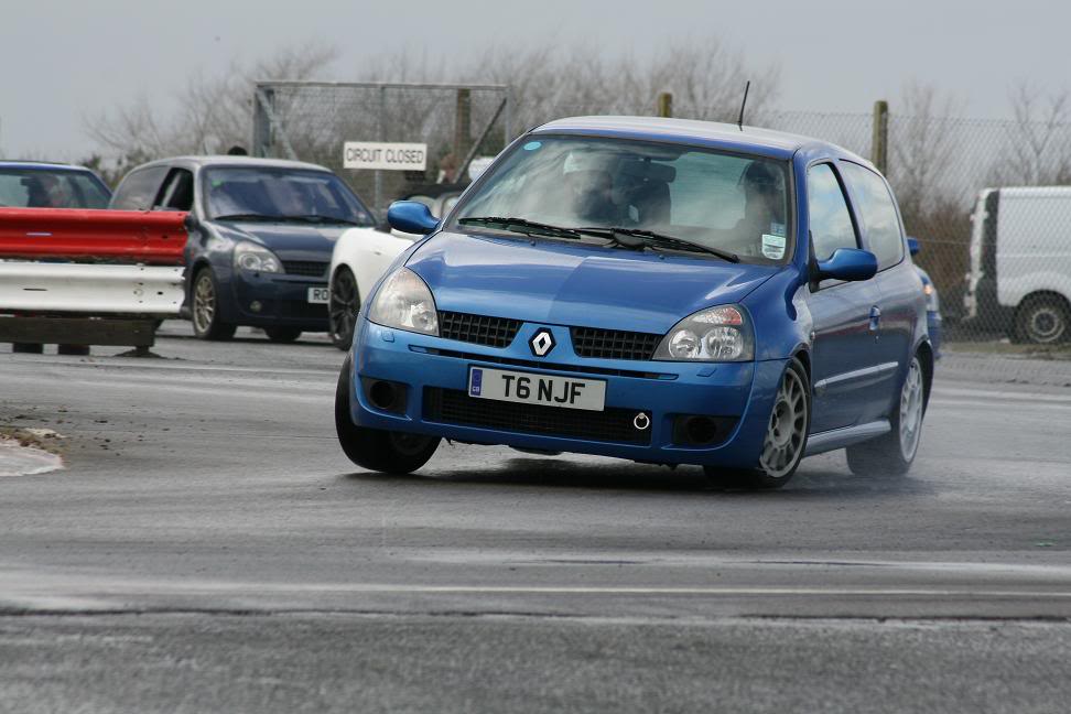

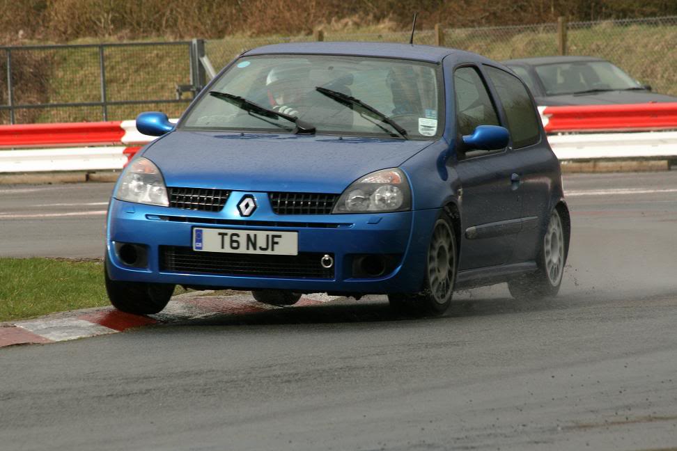

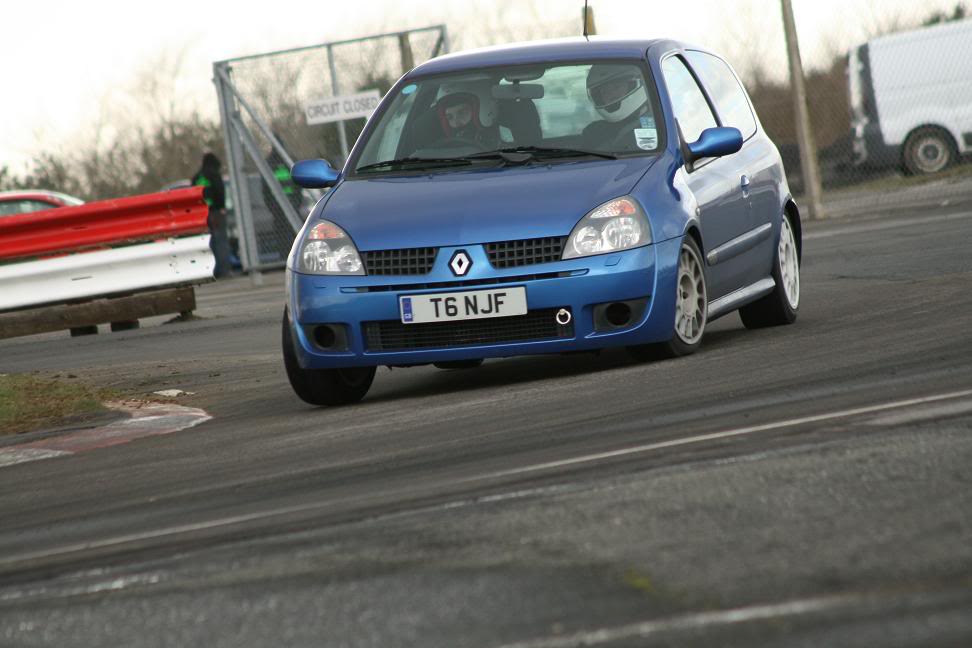

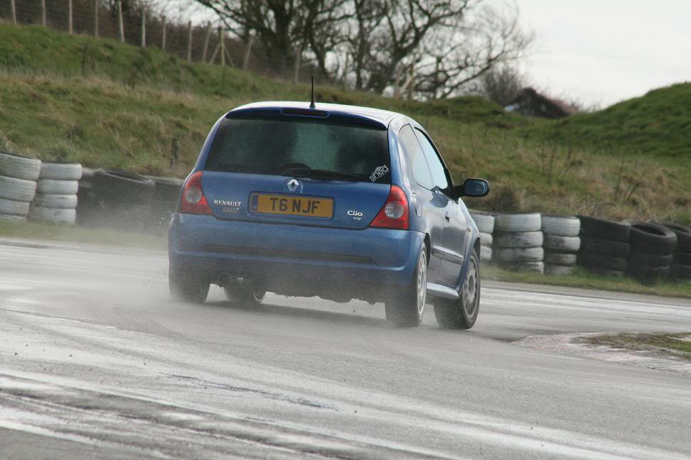

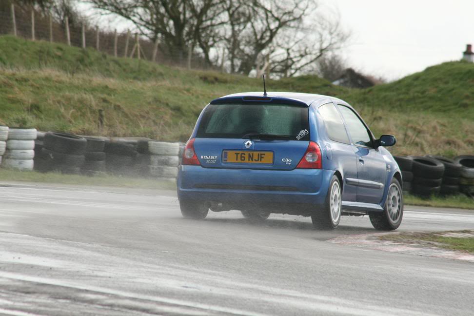

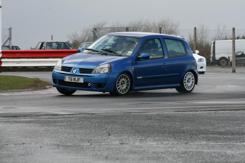

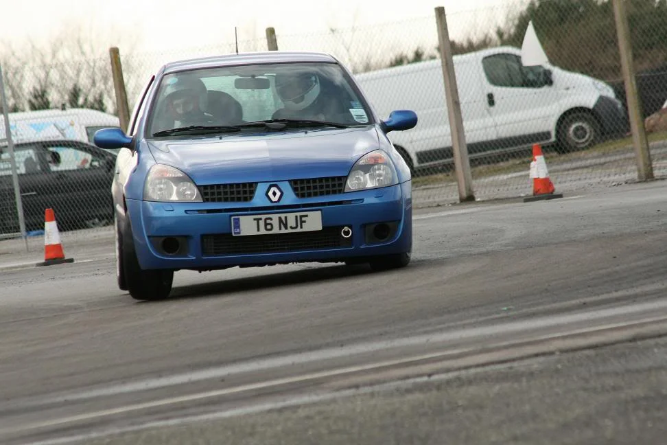

OK so here are some pictures. As you can see it was fairly wet but still lots of grip.
Had been playing with the camber settings last weekend so that was fun but have noticed there was still allot of wear on the outside of the front left.
Brakes have also basically gone through the discs in a day which is supprising.
