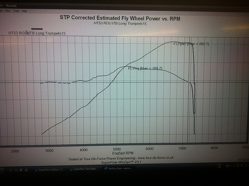

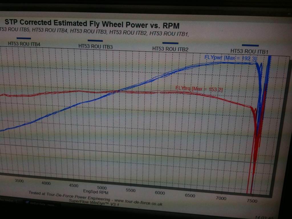

Correct me if i'm misunderstanding you Phil, but if you want to bring your torque curve down, don't you want smaller trumpets? I've not seen results of 120mm trumpets, but my experience was the 45mm trumpets were perfectly smooth straight line un-like the 90mm's that offered more of a peak torque...
45mm:
90mm:
Sorry about the size of the last photo, don't know why it is doing that :(
Lewis the torque curve just looks flat all the way through the rev range at 150lbft with the 45's where the 90's come from 150ish base range up to 170lbft.
120's are supposed to be the same gain as the 90's again from what I have heard but with more of a peak figure but also some more low down torque.
Barron & Bazoons car is the only RR printout I have seen with 120's but they had cat 422's and high comp bottom end iirc.
Is the only difference in those 2 printouts just trumpet size?
