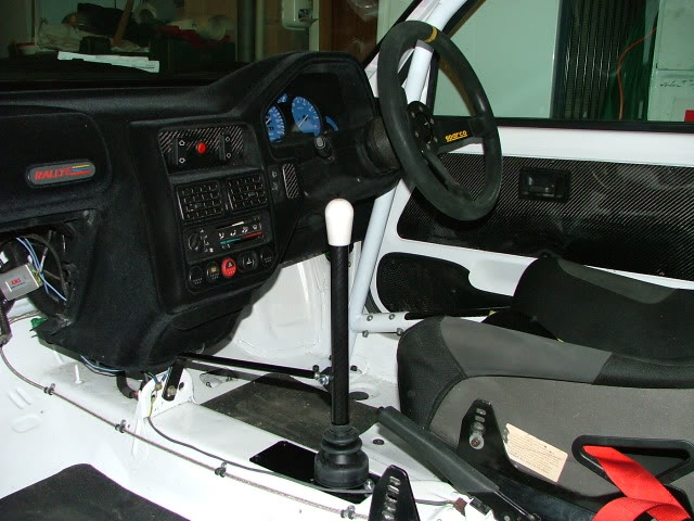

PMS are doing a similar cable selector kit to what the Peugoets use. Looks a good solution to the current poor gearshift location.
I guess it's not much of a secret then LOL
They're not doing a cable selector - it uses a long rod.
Satchshift they call it on a 106 as it's designed by Satchell Engineering.
All the 106 race lads use them and they are SUPERB. My mate has one in his turbo 106 and I'm very jealous
Puts the gear stick right next to the steering wheel!

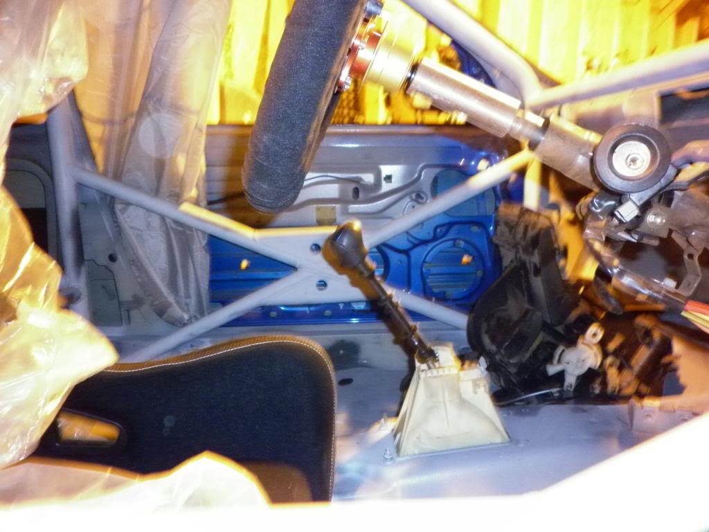

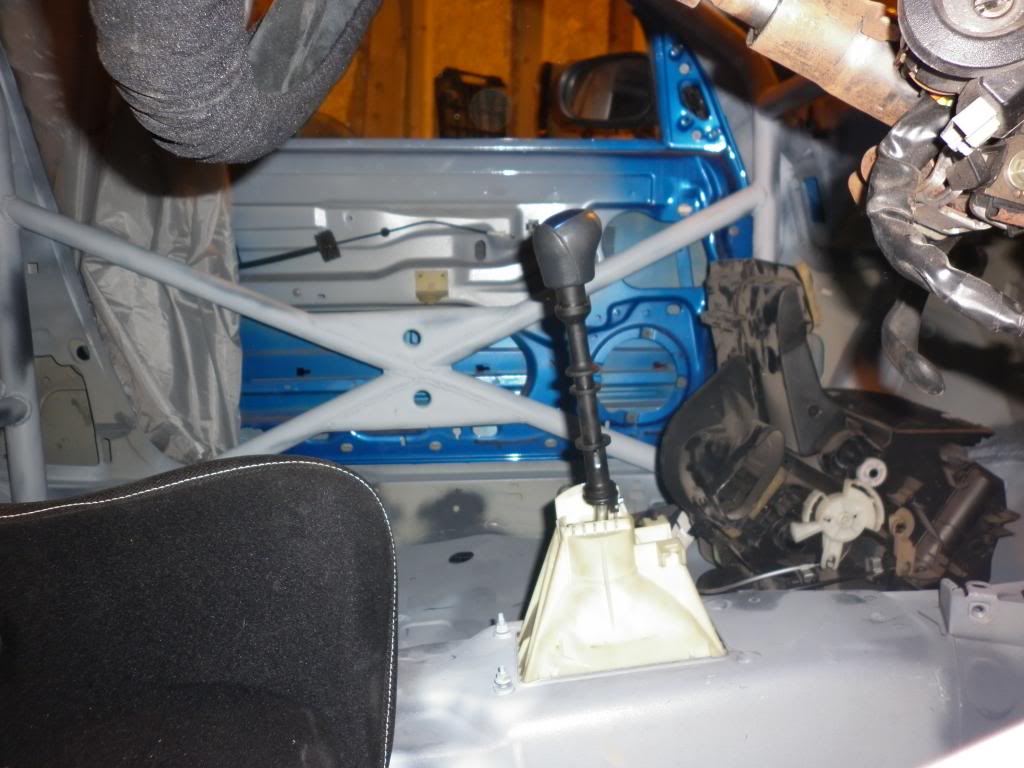

Few pics showing that there isn't any real need to modify the exhaust tunnel unless your sitting on the rear bench.
First gear
Second gear
