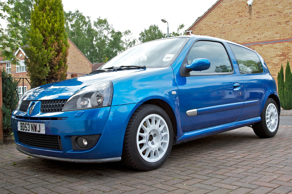

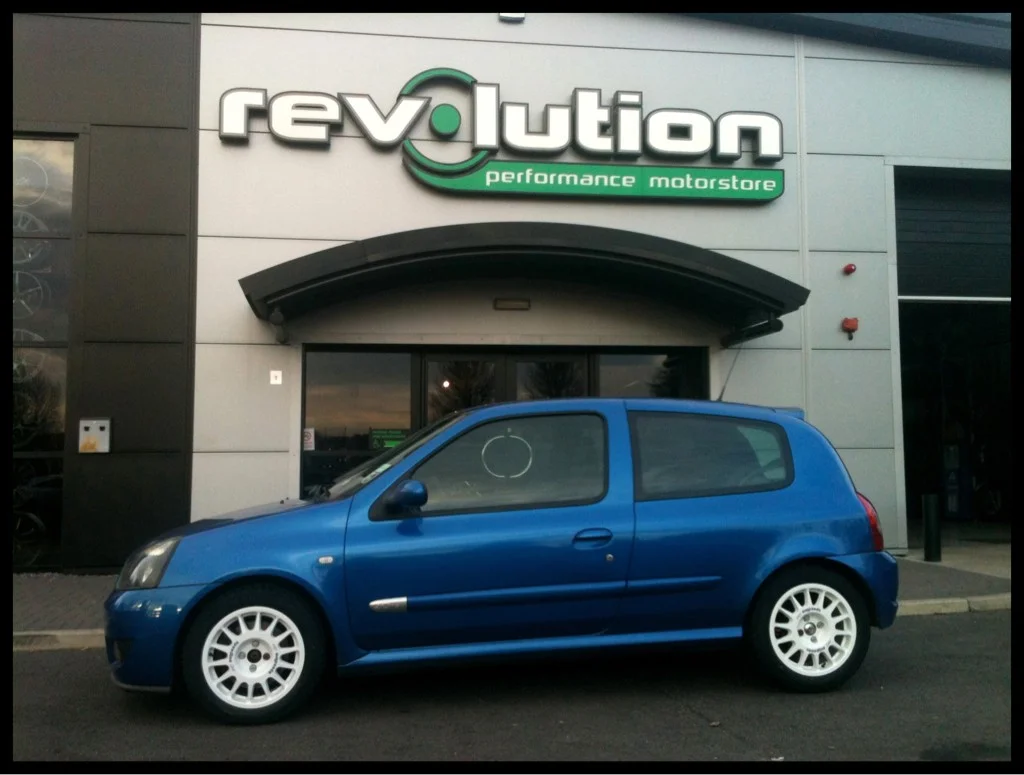

So yesterday I popped up to revolution in gateshead and got some new wheels
Sorry about the iPhone pic - I'll get some better ones when the weather is better

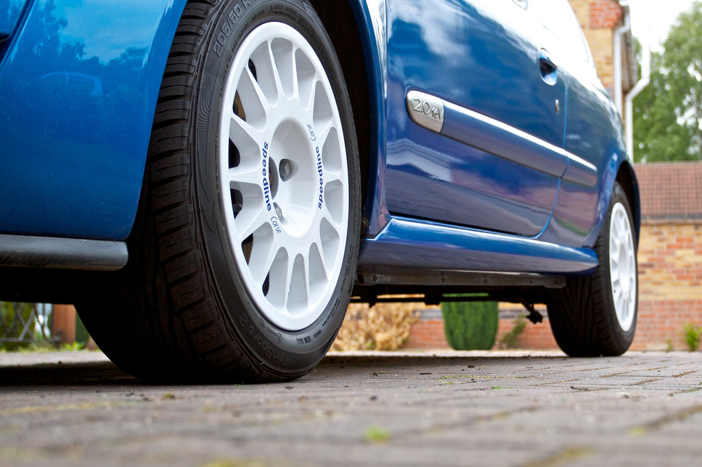

15" speedline 2118's - they're the palmer spec uprated ones (hence no center caps) and I love them to bits
205/50/15 uniroyal rainsports - it is so glued to the road now compared to before - I can't wait to get it back on track

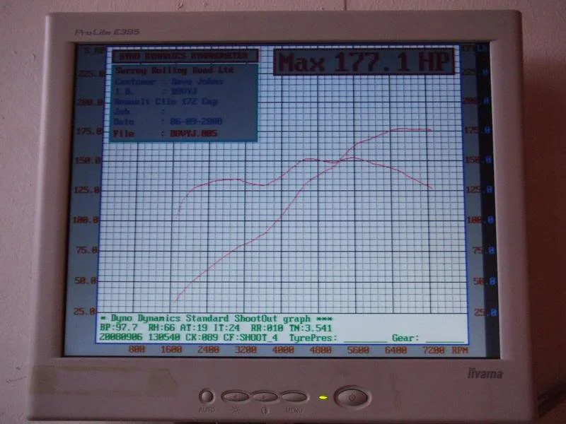

Was a strong one though, this is when it was standard bar a ktec exhaust (at Surrey RR):

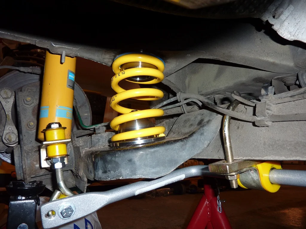

I managed to fit the rears tonight...
At the moment I'm not sure it's low enough at the back - but it has dropped 10mm and the springs haven't had time to settle yet
Also when I get the battery moved to the boot and the roll cage fitted it'll lower it more
Bought some 2nd hand compbrake solid top mounts which are arriving tomorrow - so tomorrow night I'll fit the fronts
The quality of the billies is as expected.. amazing. They look like they'll last forever
Read some really bad stuff about the compbrake top mounts on here after buying them - but they lad has had them fitted for a year with no problems and my top mounts are shagged - so i'll see how I get on
If they are crap I'll get some AST ones and get them fitted properly by someone who can set the camber up :)
  340i
The adjuster platform fits on the bottom for most other sets of Clio MK2 rear coilovers...
But the Bilstein's tell you to fit the adjusting platform on the top :)
Yup instructions say on top and spring must have writing the right way up
Reason is - all other coilovers the adjustor thing bolts into the bottom so when you remove springs it stays in - the bilstein one doesn't bolt in - it just sits there
So I assume it's on top so that it doesn't fall out when you jack the car up :)
