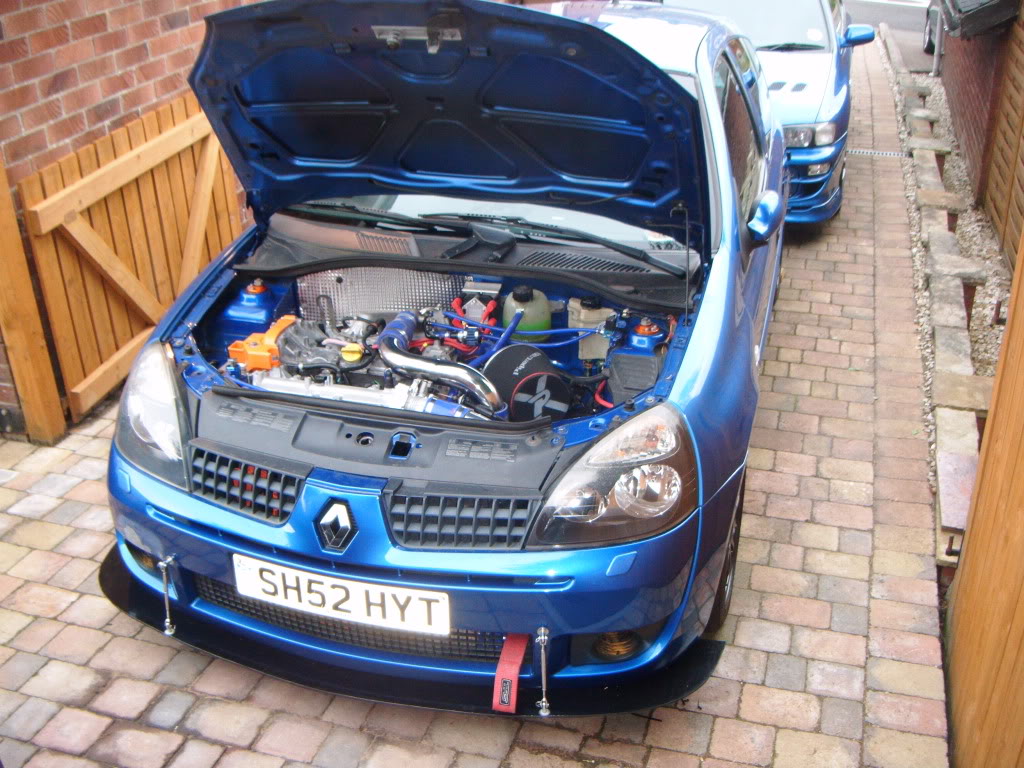

  172 cup, Impreza P1
Think I'd just be too scared that at high speed with the splitter I'm using it might come off. :dead:
I would be! i was shitting myself with this abortion on mine

Ahhhh nice! That's literally what I want to make - was hoping to design something that could bolt to the 2 bumper bolts at the bottom - or make it go the full way under the engine to replace the engine shield and bolt into those 4 riv nuts
You noticed much difference with it on track?
  172 cup, Impreza P1
I use the front to 2 holes on the subframe to attach onto but didn't want it to go all the way back to aid cooling with fresh air under the sump.
I've only done 1 trackday with it and didnt do a back to back test but it did feel different through the higher speed corners.

Course it will make a difference. The time attack guys love them but you need to adjust the tie rods to make sure its not giving you lift rather than down force.

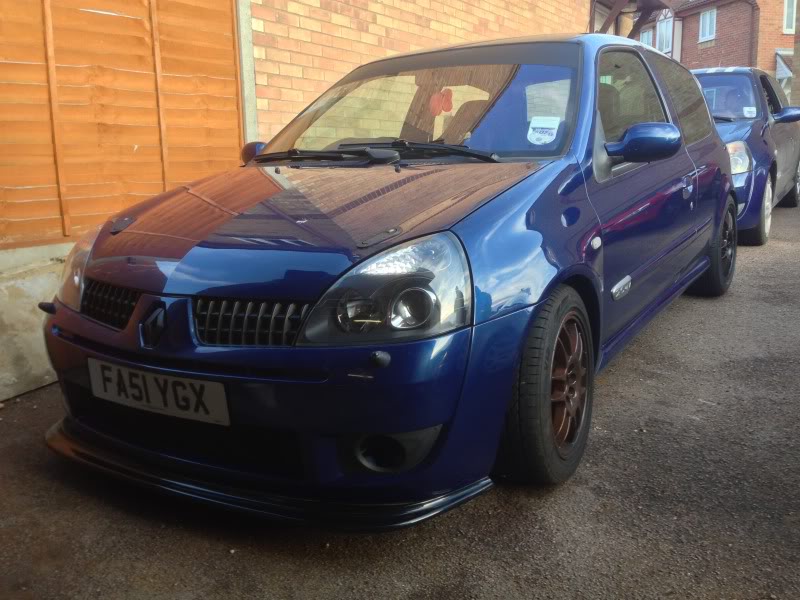

One showing how far under mine goes.
Cupman that's awesome! Seeing pics like that give me bad ideas ha.
chip that splitter is solid, no play in it at all so it can only sit like that or not meet the line on the front bumper, would work on a ph1 though due to the bendy bumpers!

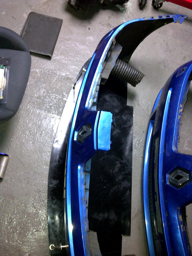

I wanted it to be 100mm deep at the front and taper to 50mm at the sides so measured out from the bumper making a series of dashes than joined them up. Then for under the subframe I went as far as I needed to reach the fixing holes and cut around the wheel arches for clearance.
