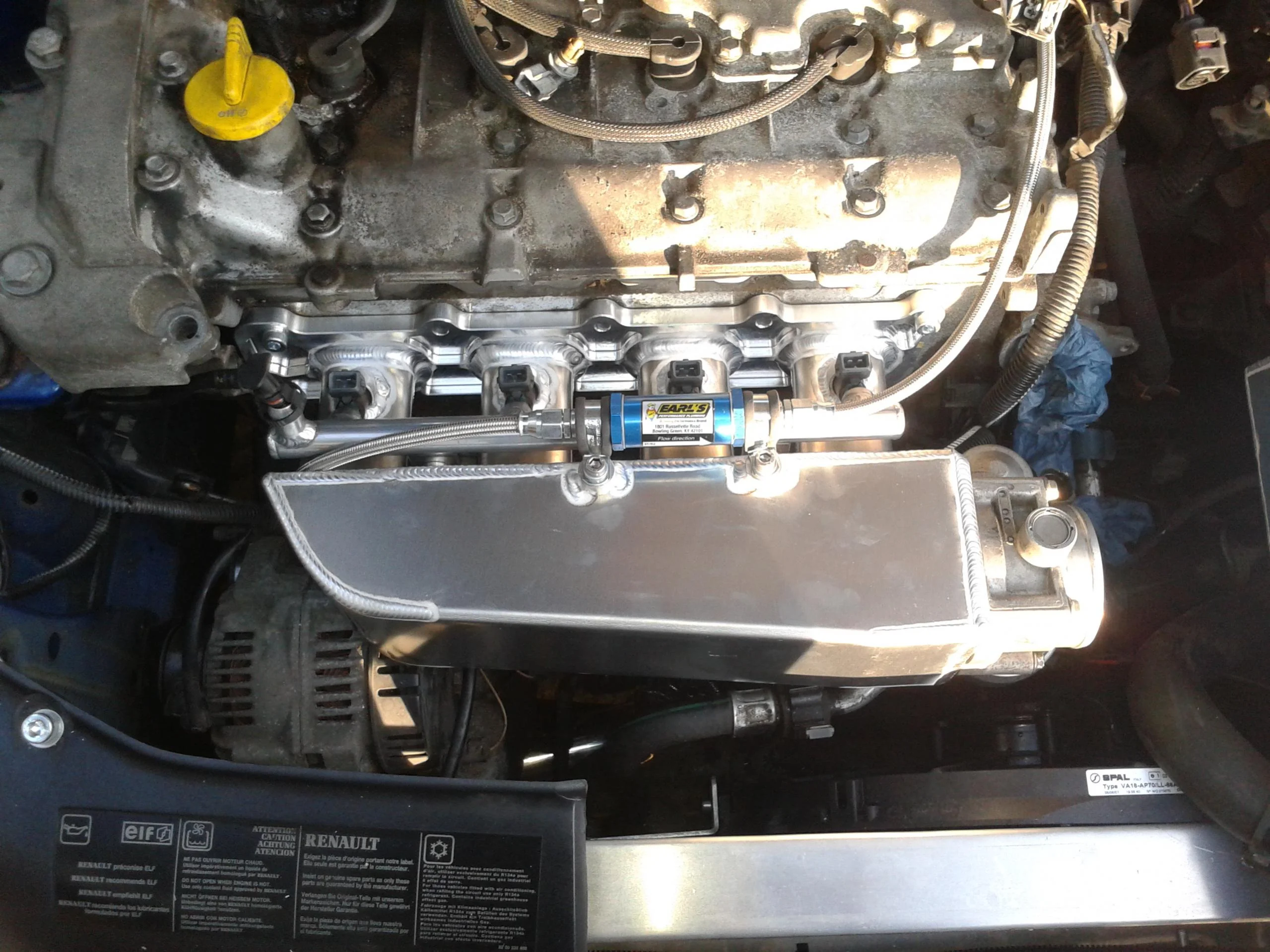

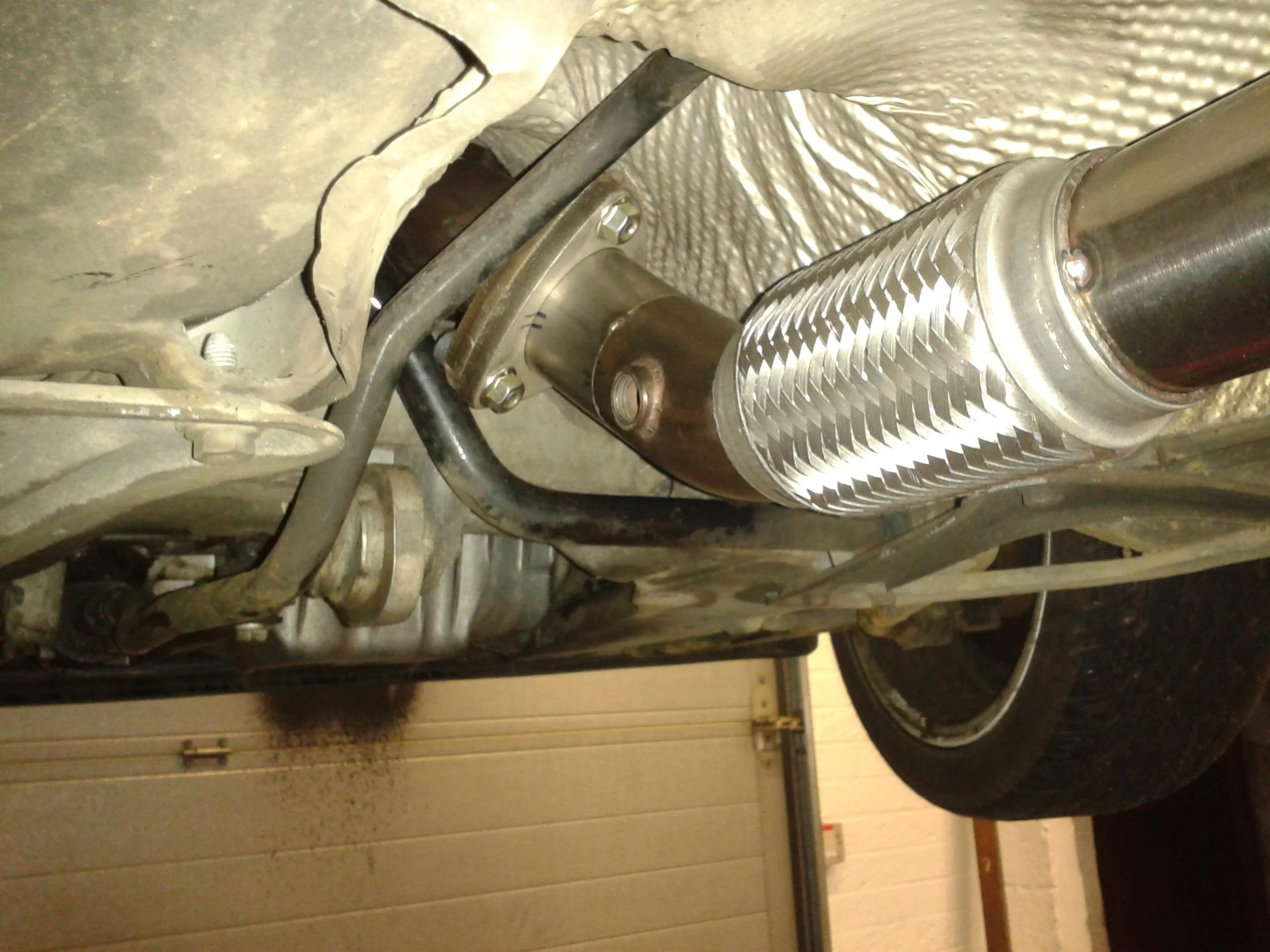

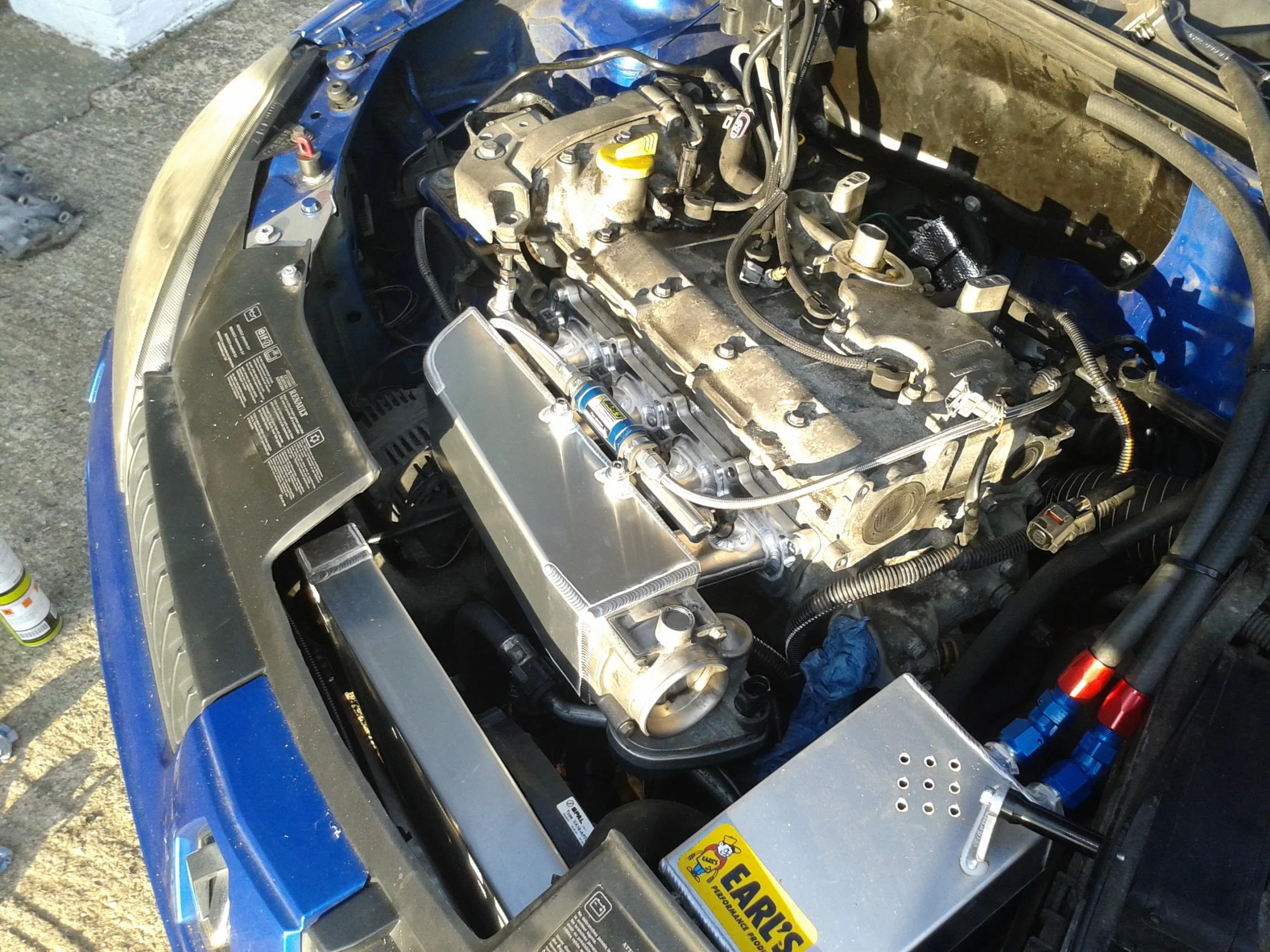

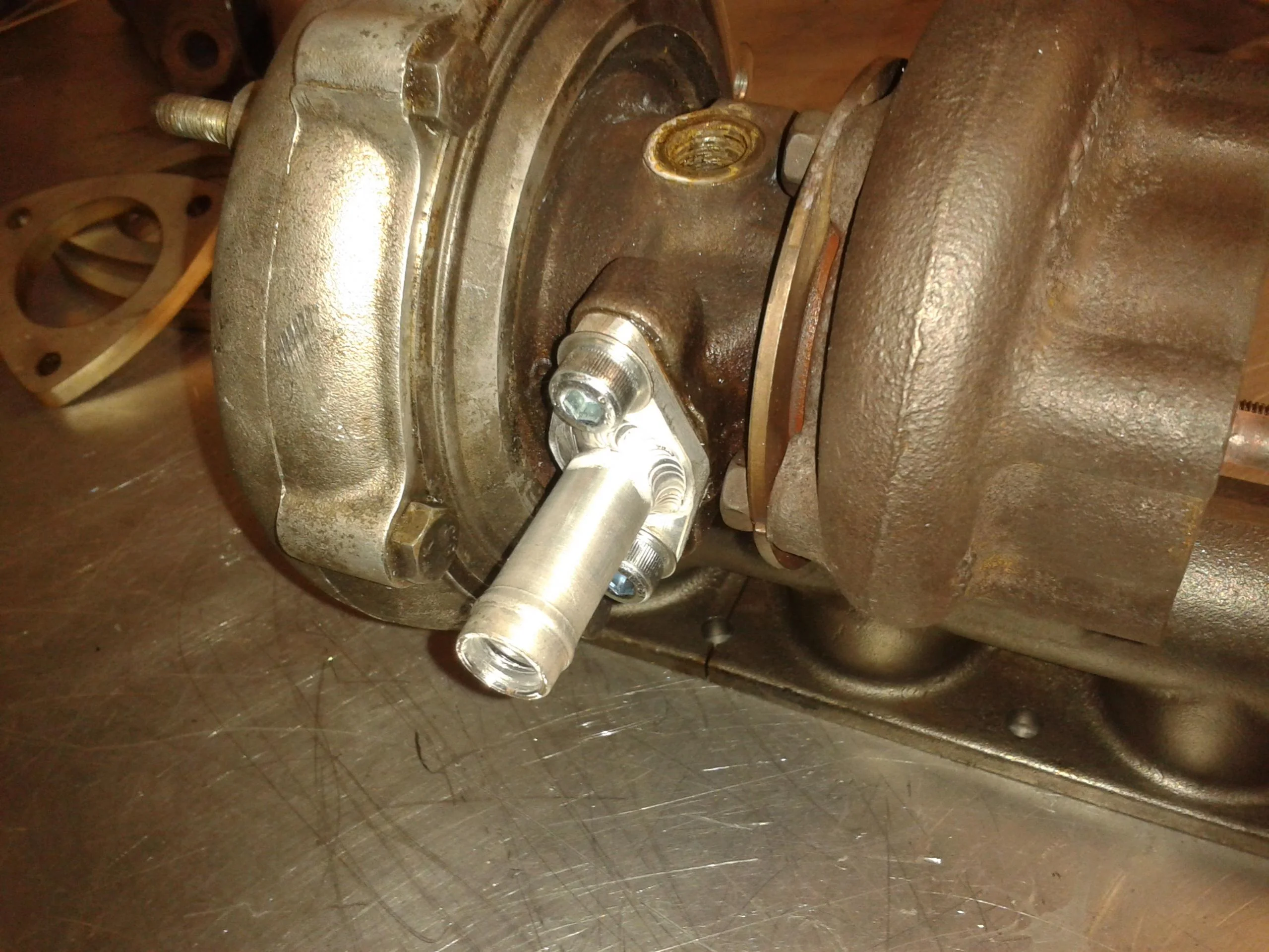

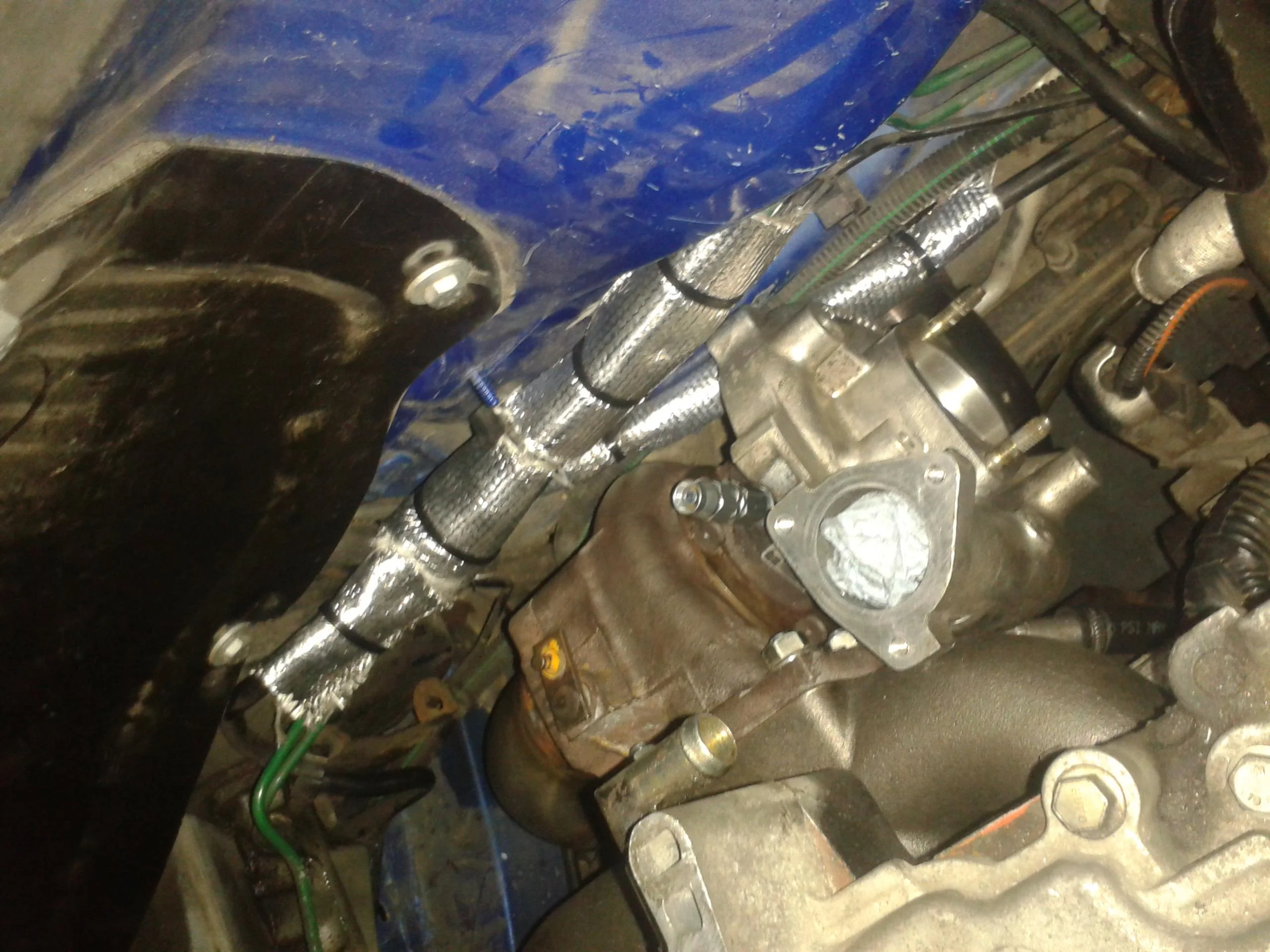

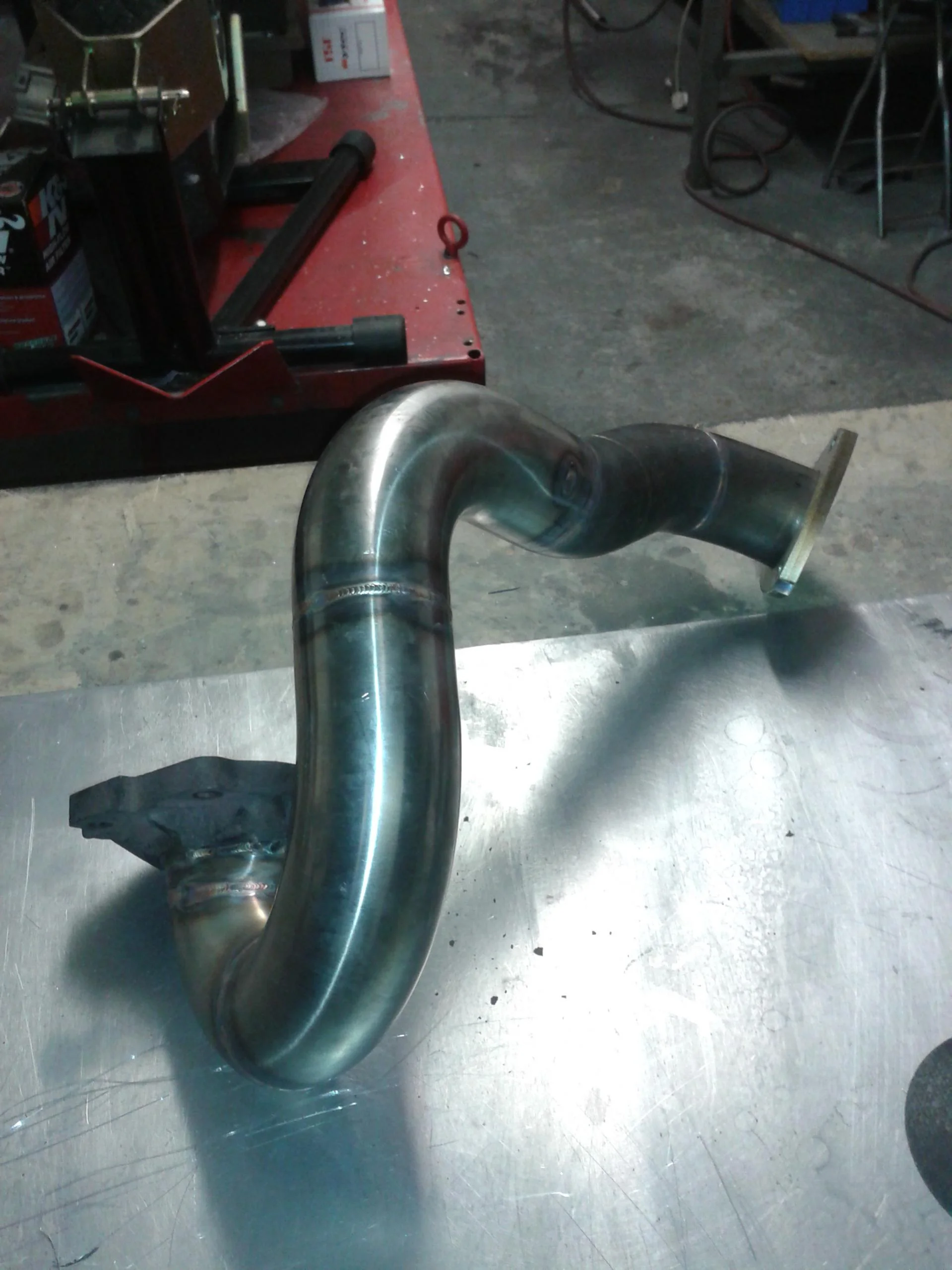

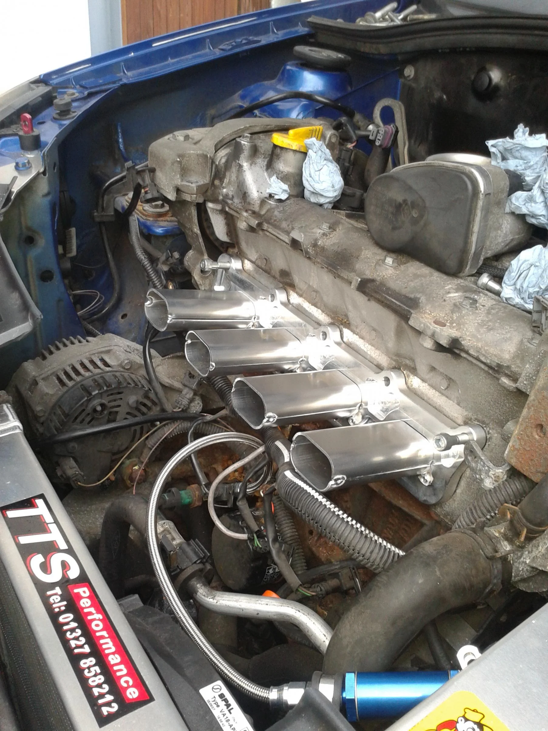

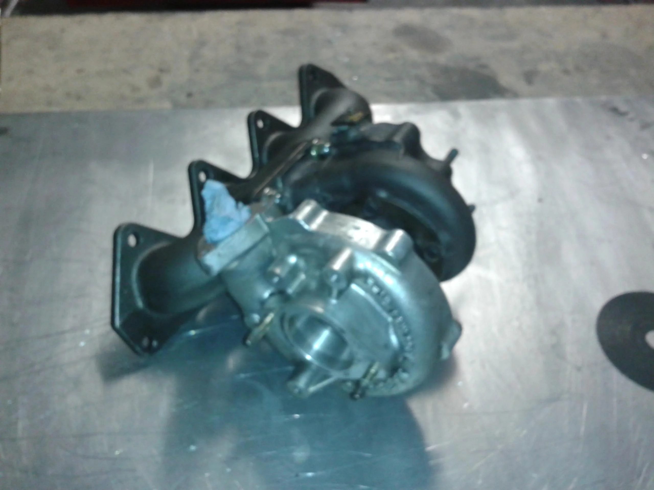

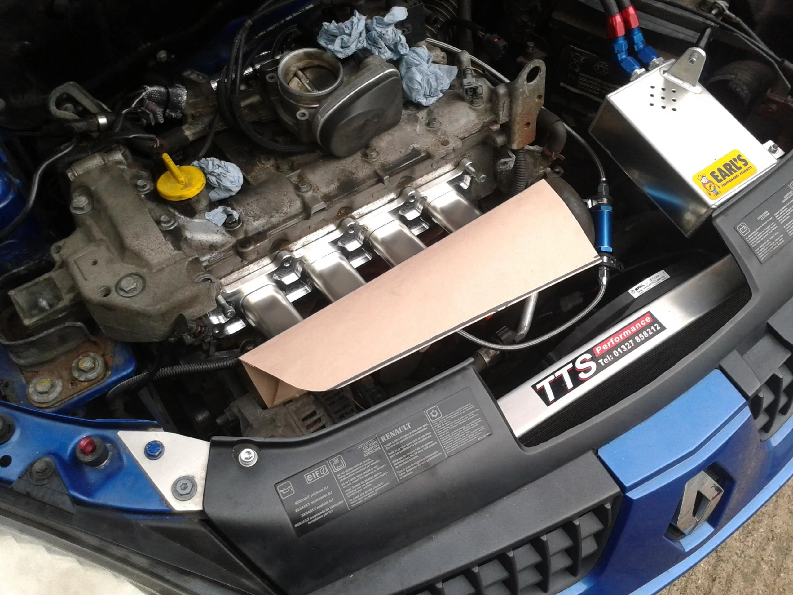

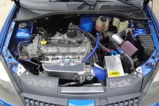

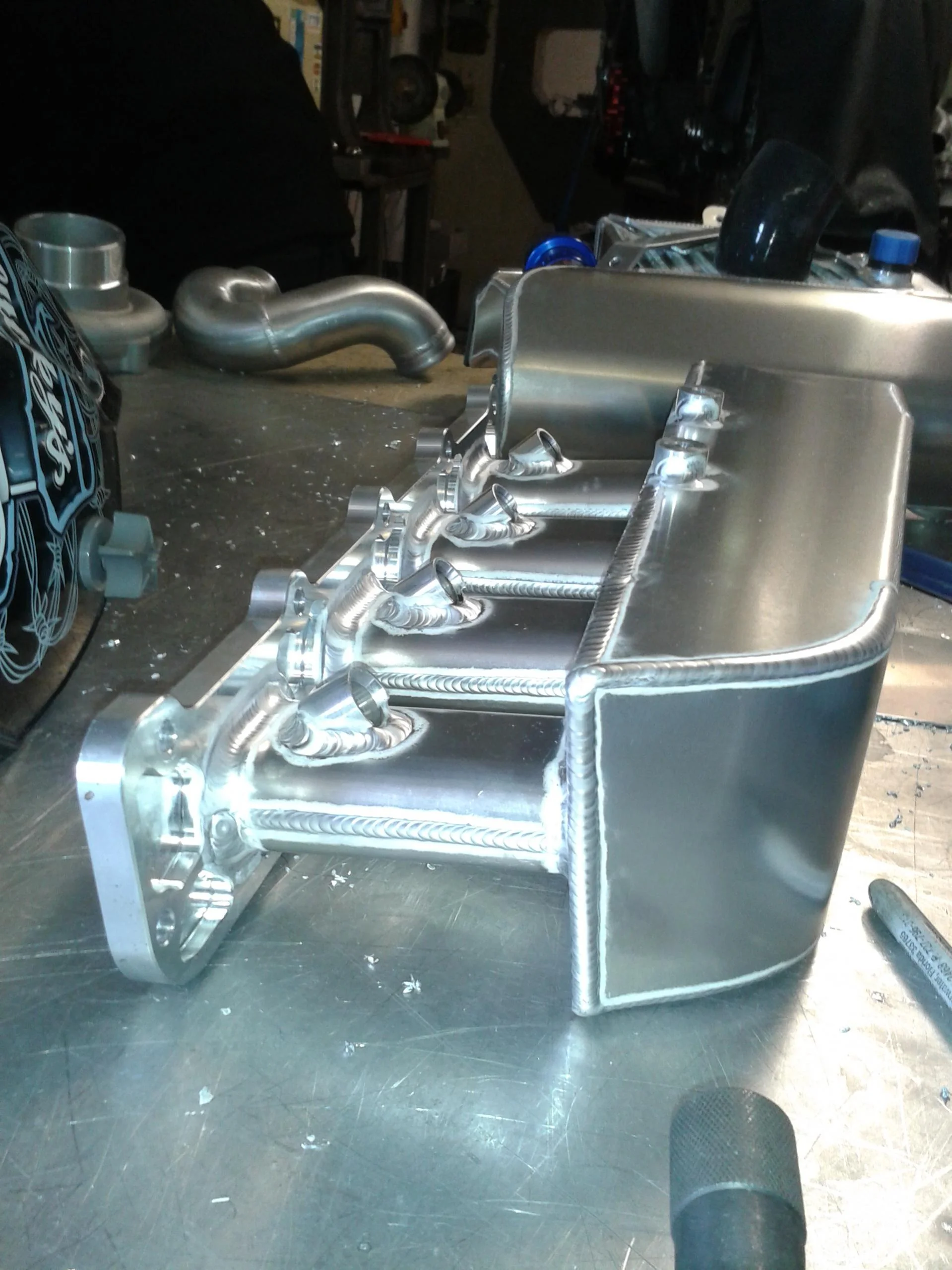

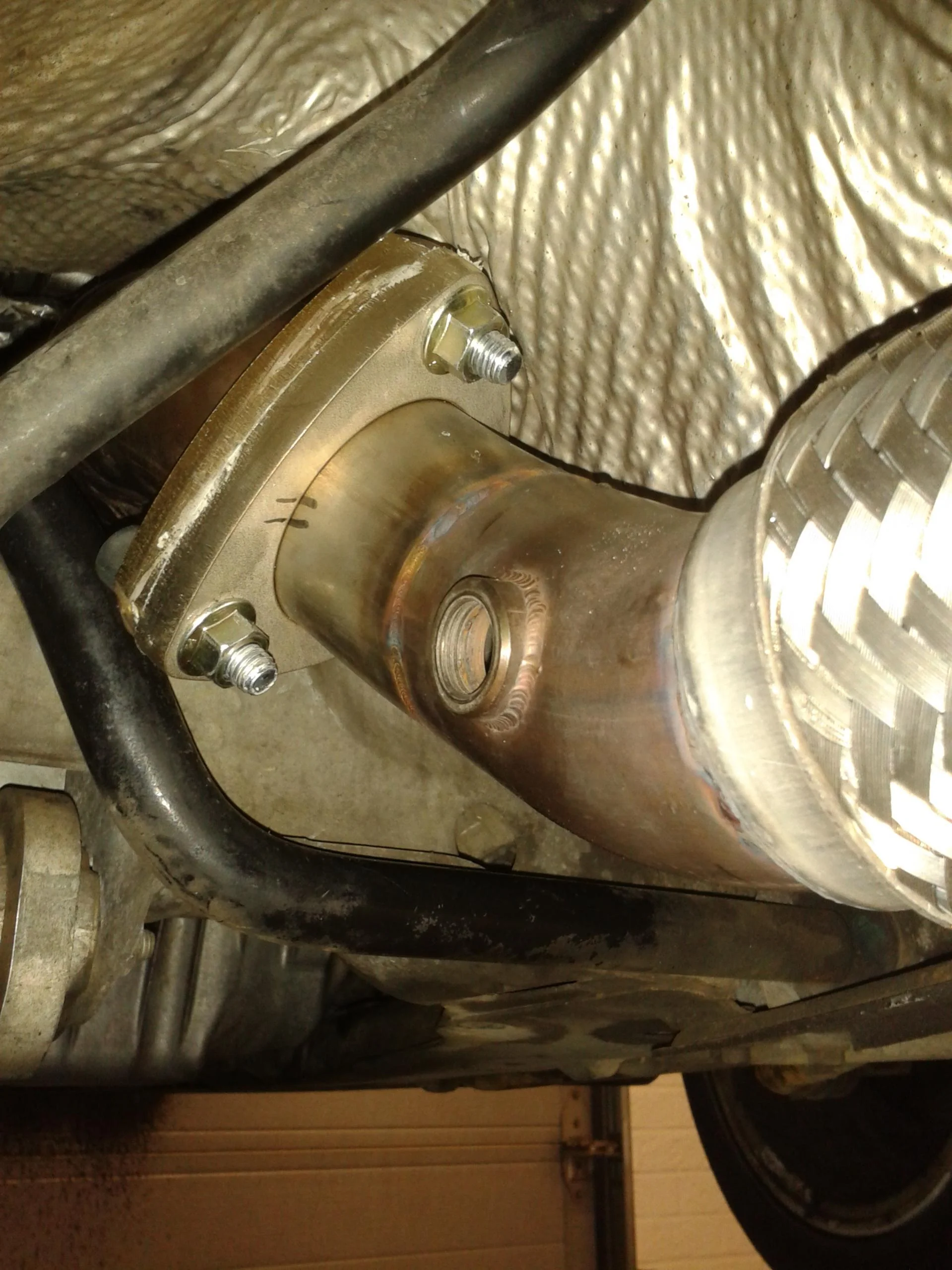

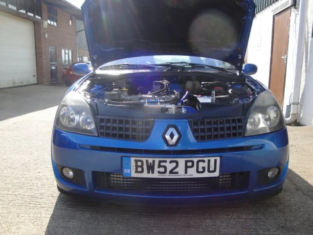

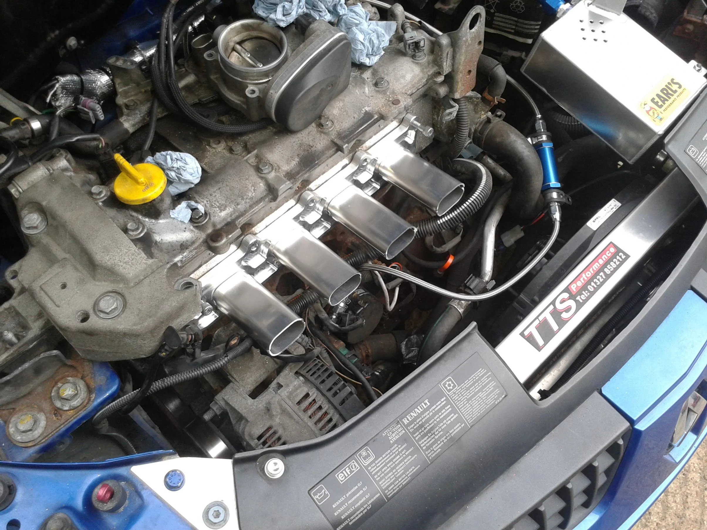

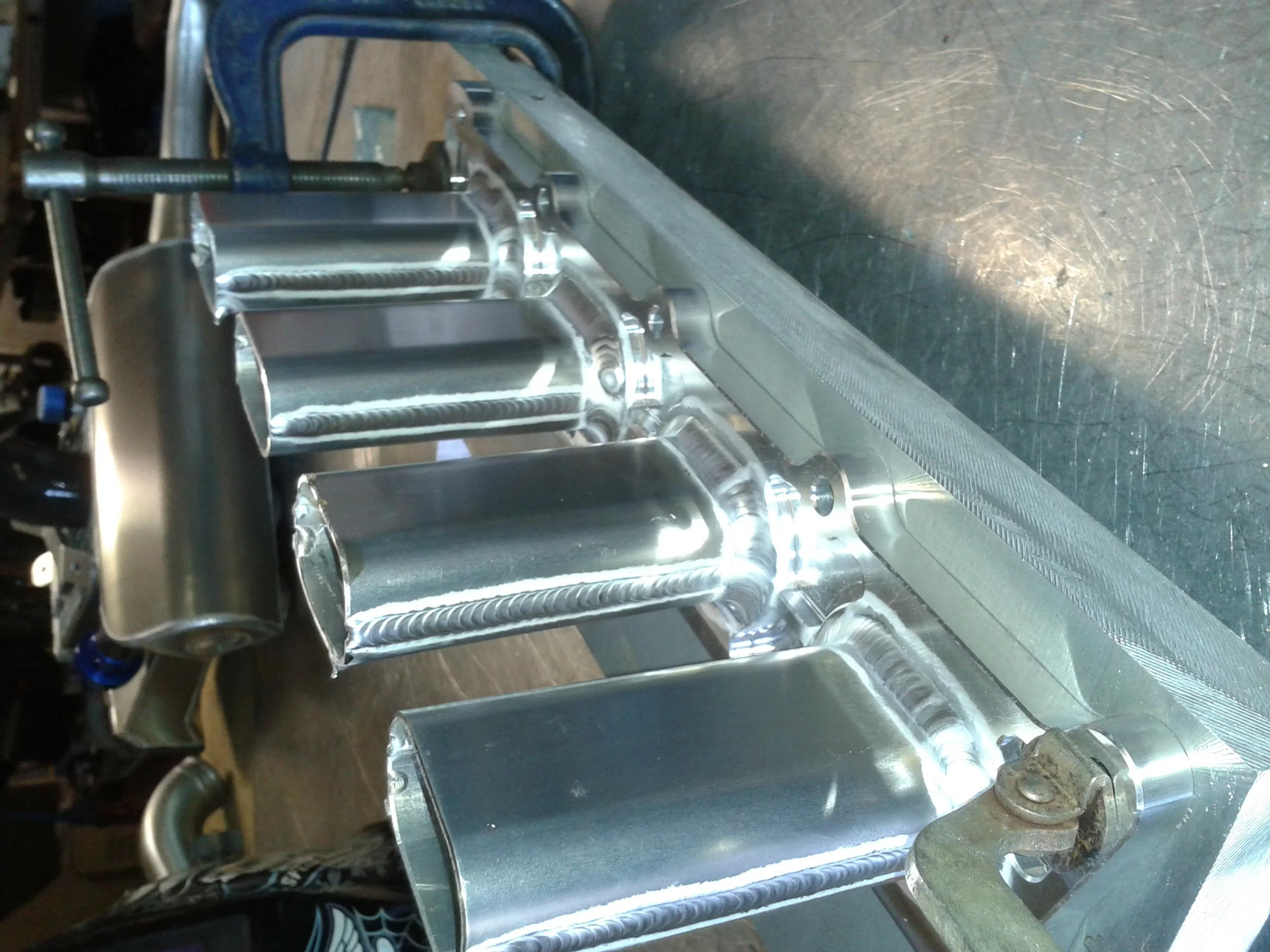

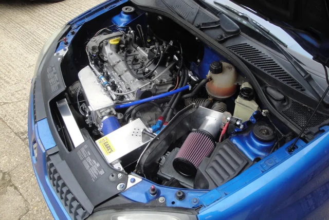

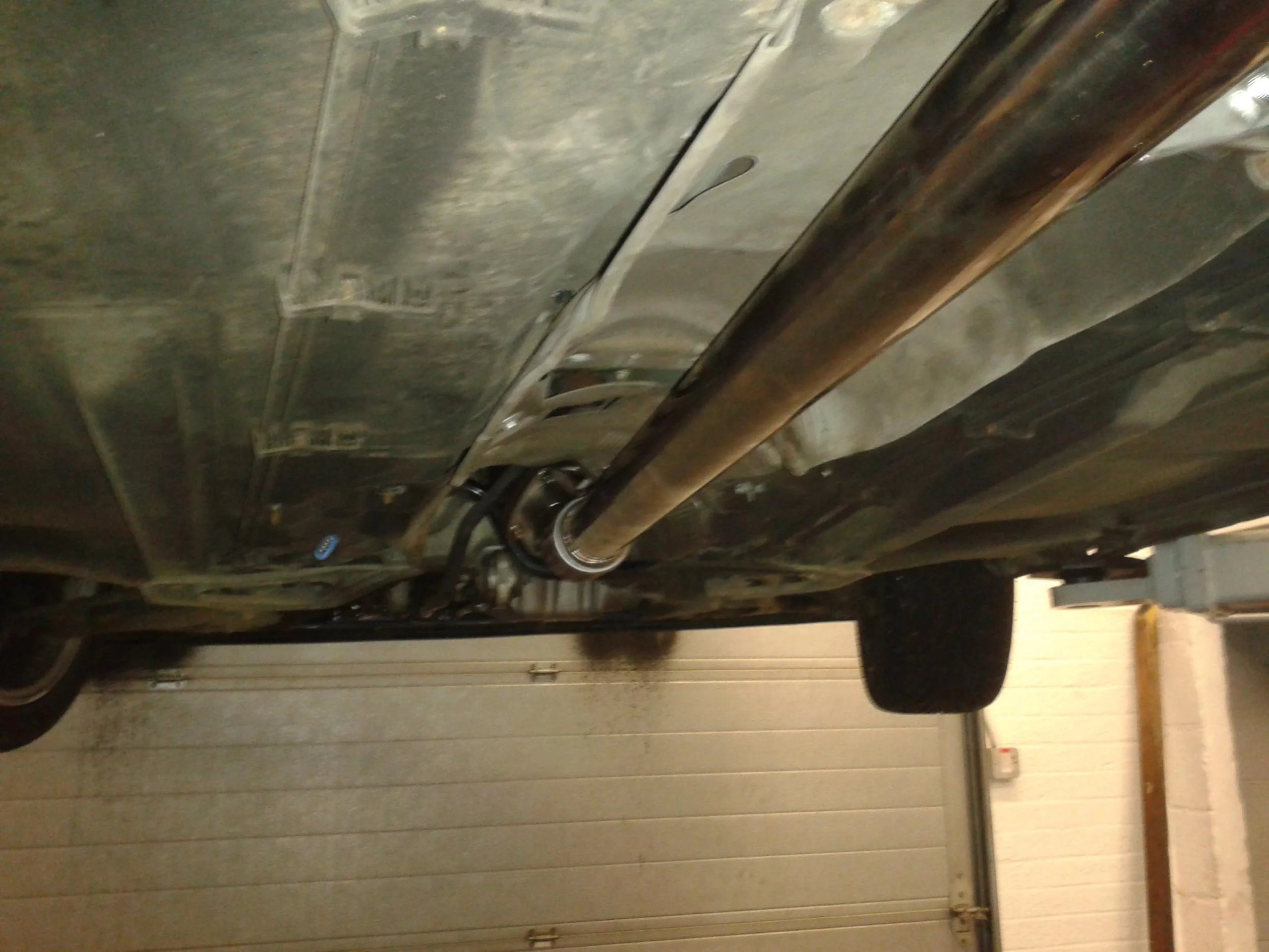

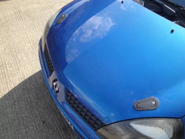

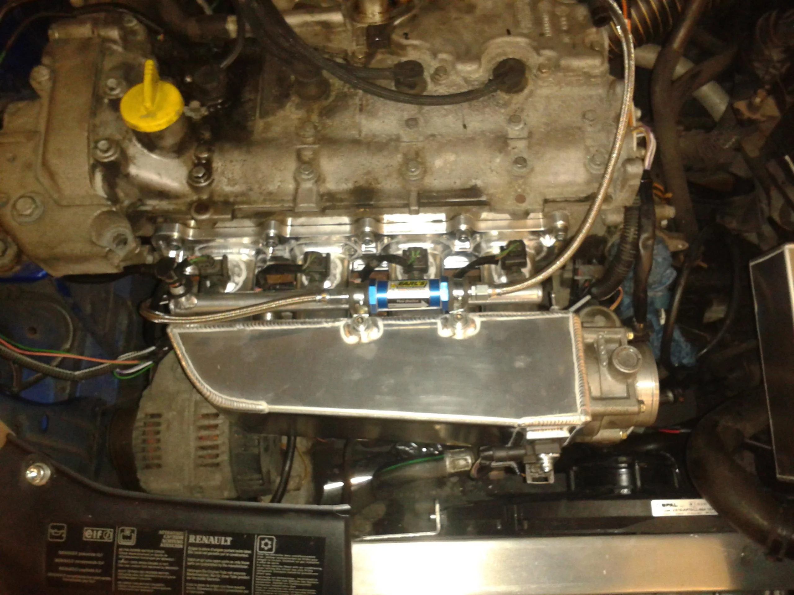

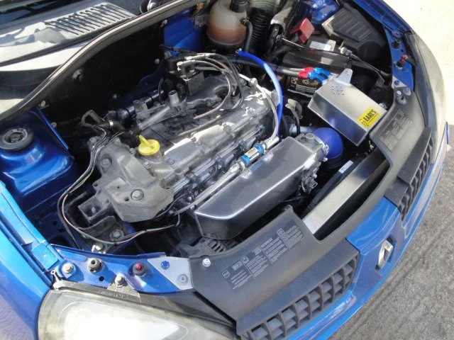

This is my Clio turbo project so far, i will update properly when i have worked out how to use the forum and have more time!
basically the spec is:
GT28 turbo
Log manifold
custom downpipe and 2 1/2" full stainless exhaust
Custom intercooler and boost pipes
Custom radiator with Spal fan
Custom inlet with at the moment standard injectors but RC 370 will go in shortly
Ktec coilovers
ktec solid topmounts
Solid dogbone
custom breather setup
AEM fuel ignition controller
im running a stock bottom end so boost will be very limited just to get the car running before a full strip and rebuild in the future, no power figures yet the cars up and running but just waiting to get it on the dyno.
