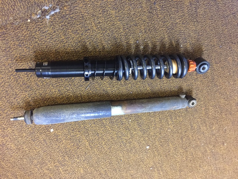

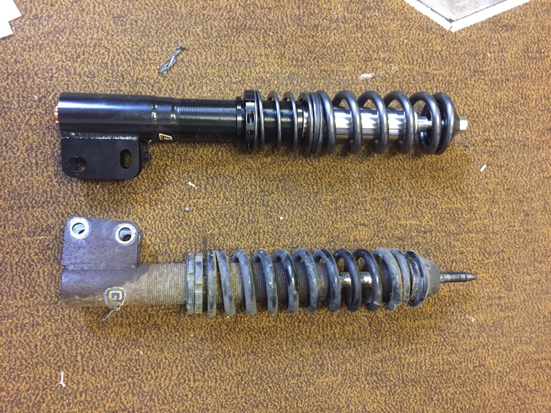

Problem 1: Suspension in 11+ years old, starting to leak very slightly and generally needing an upgrade.
Solution: AST 4100 have been ordered

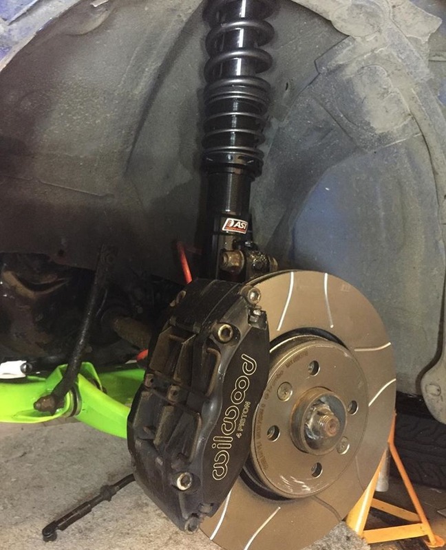

Solution: New OE rear discs and pads, brembo max front discs to go with my DS 1.11 pads for track

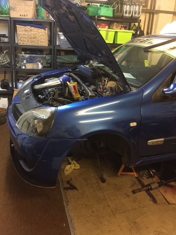

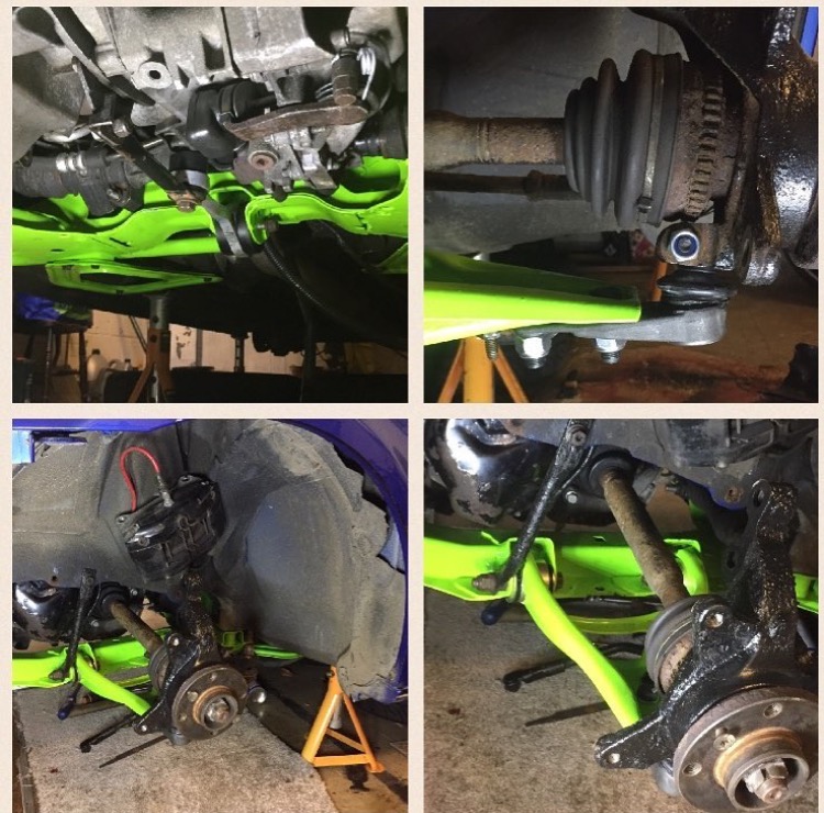

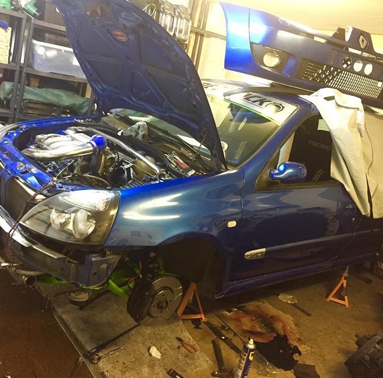

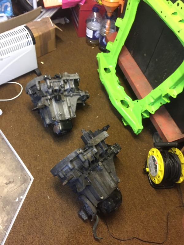

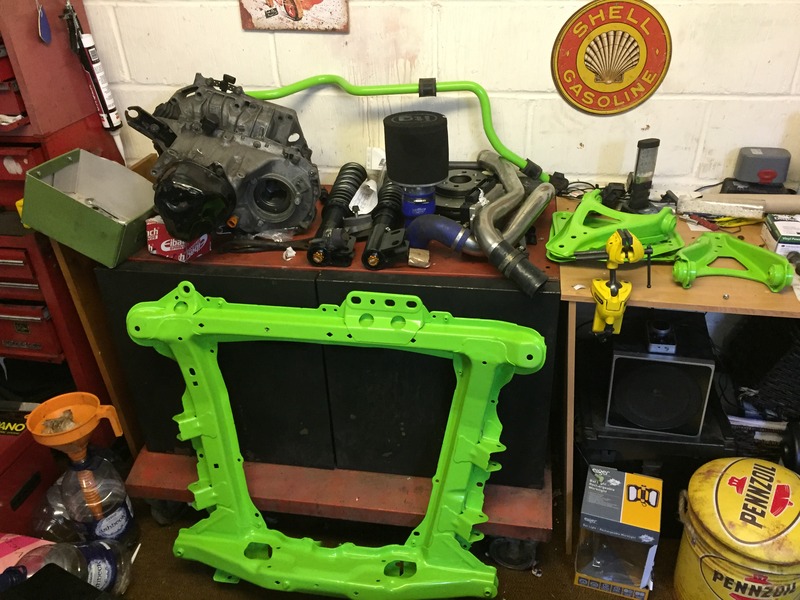

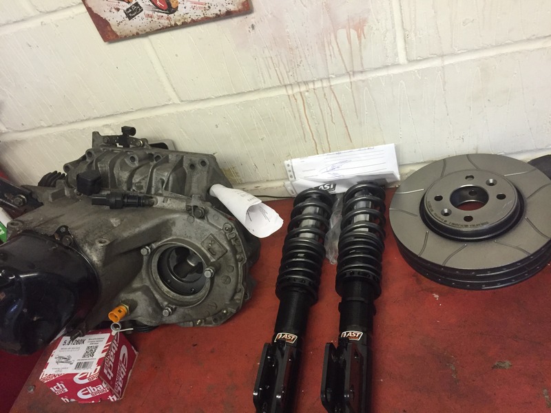

So in a nut shell. I had another baby May last year, which completely put a holt to all my plans of going racing last year. Probably for the best really! So over the last 8 months or so I've done and completed the following work...
  1. Sourced a Phase 1 gearbox (longer 5th gear) and fitted a Quaife diff

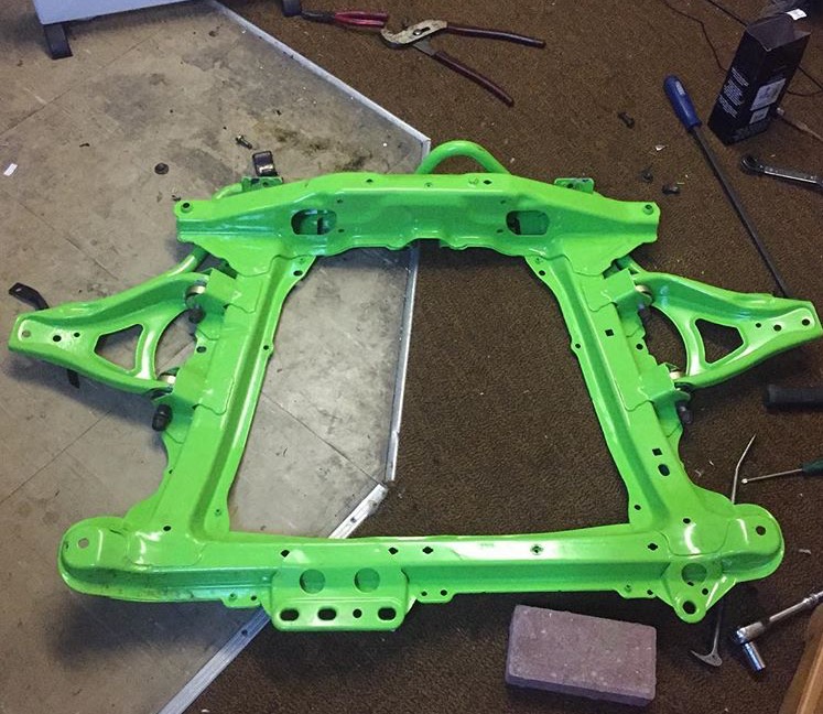

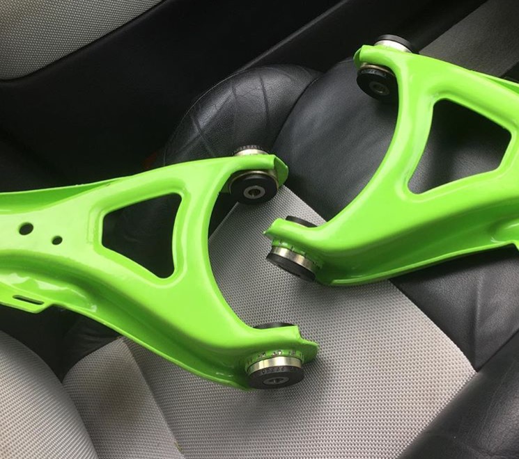

  2. Stripped the subframe, wishbone and ARB down and had them powder coated Kawasaki green
  3. Black Series wishbone bushes
  4. Black series ARB bushes inner and outer
  5. Black series dogbone mount
  6. Black series steeting rack mounts
  7. New ball joints
  8. New TRE's
  9. New AST 5100 series coilovers with race spec spring ratings
  10. new top mounts
  11. Gearbox oil
  12. Engine oil and filter
  13. Discs and pads all round
Now all of the above is done and fitted, I just need to source and build in the fuel swirl pot. I've also applied for the 1st bit of my national B race license which should come soon! The the plan will be to sign up to Time Attack and see what I can do!

You certainly won't lose those powder coated bits in the dark :cool: will be a proper weapon with all those tasty upgrades mate.
They're a bit brighter than what I was expecting haha! Hopefully so, I'm not expecting to be mega quick straight away, but a good place to start!
