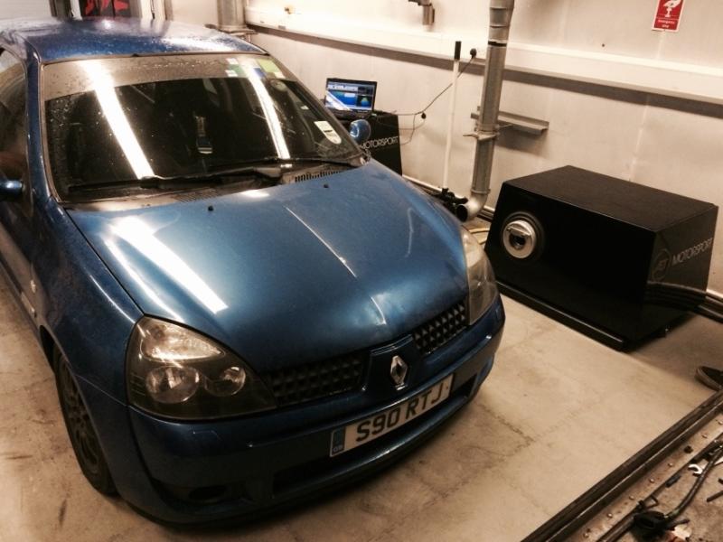

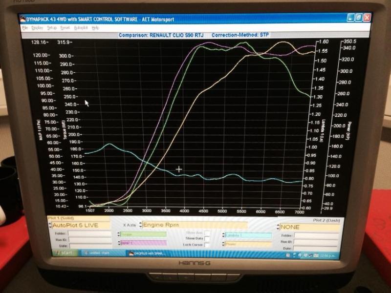

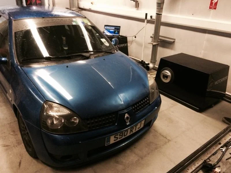

So after a very lengthy chat with GEMs and K-tec - Will finally got the boost solenoid working. God knows how everyone else has enabled the solenoid so easily as by the sounds of it, it was a complete ball ache! ECU seems to be functioning properly now, so onwards and upwards!

Cheers lads! Chuffed to have it back! Looking forward to giving it a wash!

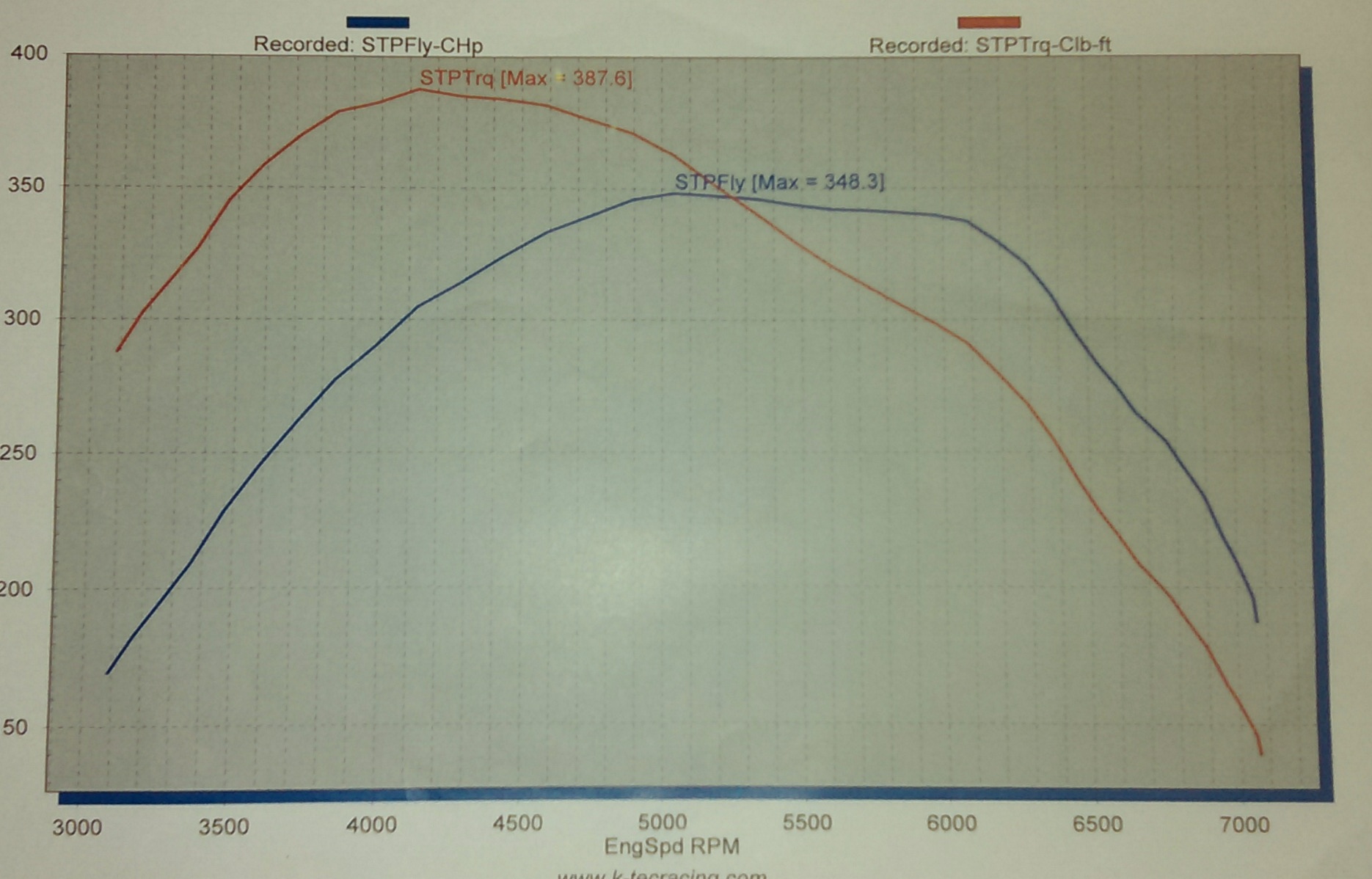

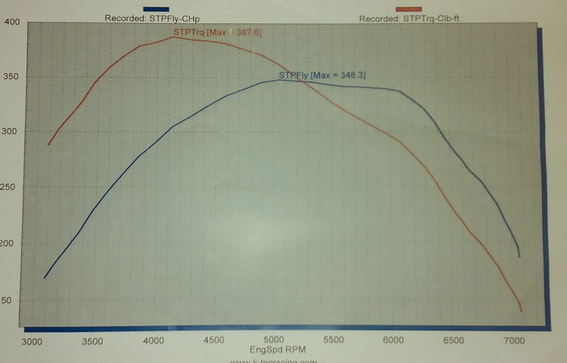

It's a bit too rapid! I need a diff so badly but I've been without the car for so long i just want to enjoy it. Wheels spin in 4th under full boost, luckily its very controllable by throttle
