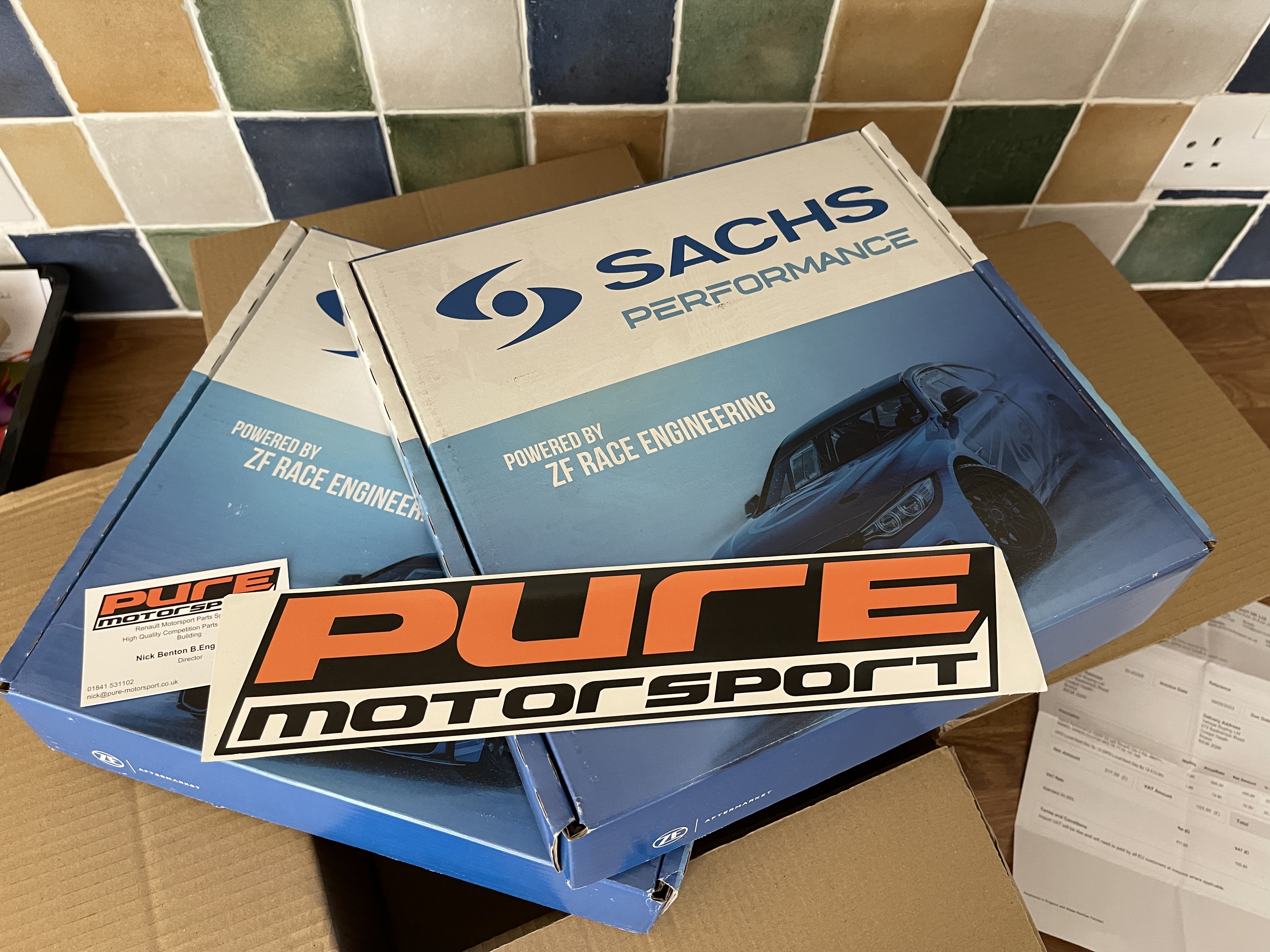

Then, if it’s having a shiney new box it needs a clutch… £600 later I have this;

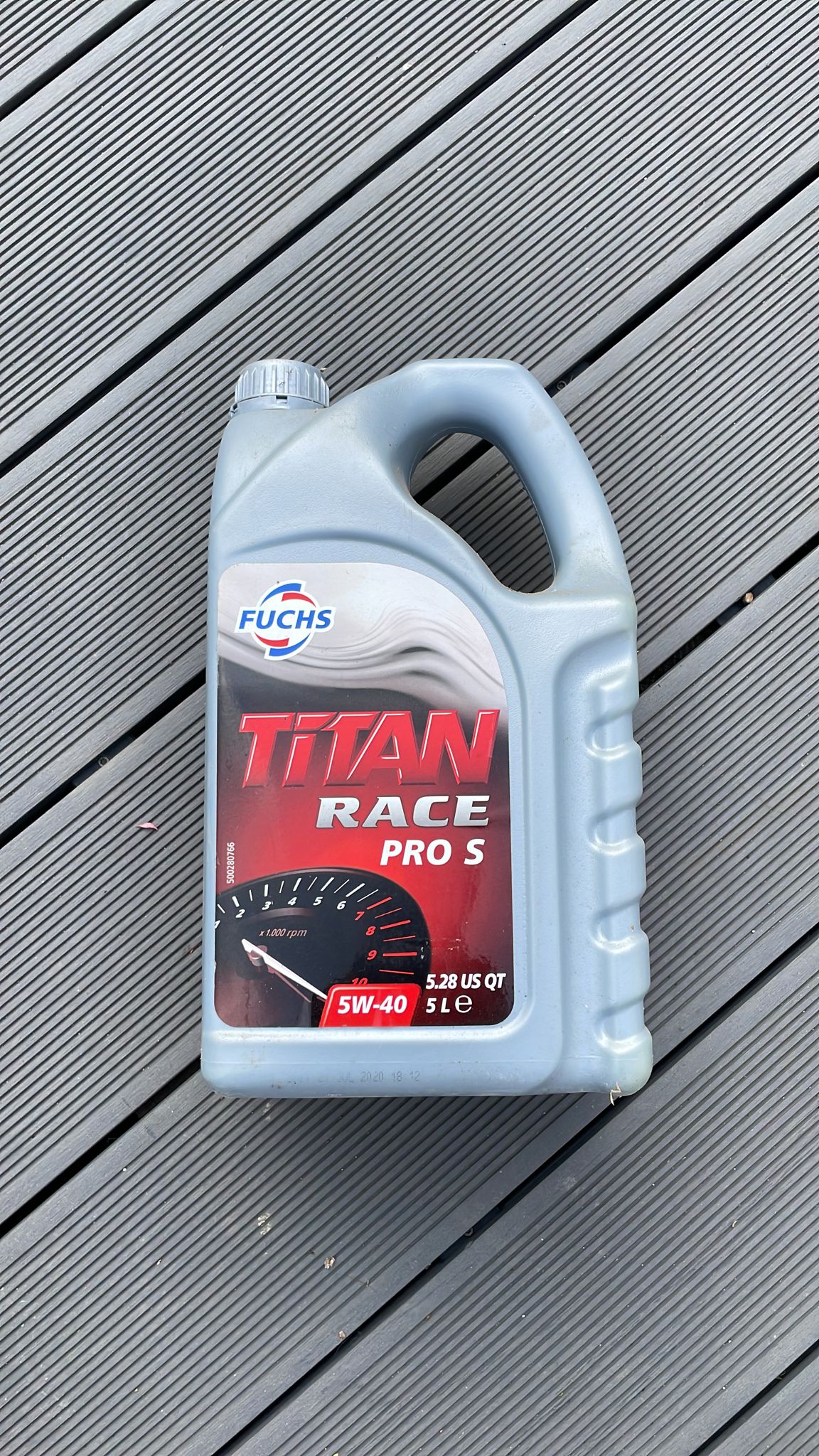

Oil and filter with this stuff (I normally only use genuine but @Hixle gave this time me FOC. What a lovely man)

So my long suffering g mechanic Paul ( @lemonnobby ) has very kindly taken on the task of fitting the new gripper’d box and a new Sachs racing clutch whilst I tan myself in Spain.
He’s having trouble because the OE clutch cable is not meant for a Mk1 and it’s not fitting with the Sachs clutch.
He assumed I ordered it from Kam Racing so contacted them. (But I ordered it from Pure)
Kev at Kam then rang Nick at Pure, Nick then emailed me and asked for Paul to call him.
It’s now in the process of being resolved.
Just wanted to give a shout to Kev and Nick, what awesome blokes. 💪🏽
