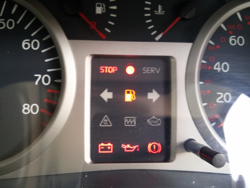

These are the dashboard lights I am presented with when I turn on the ignition.
After doing some research on the forum I noticed that the red Immobilizer light stays on solid when the ignition is turned on.

  Ph2 172 Iceberg
Quick update:
I just put my CAN OBDII reader into the 172's diagnostics port but it shows "No Codes Found"
I have also just realised that when I lock the car up and look in through the window I can see the red immobilizer light flashing away.
Very confused.

Immobiliser light is fine, it should flash when off and solid when you turn key.
I'd suggest battery but then it would still turn over. Can you check continuity between +vet battery terminal and about an inch down the wire past the big brass connector to make sure that hasn't blown?

I have just checked my car. It looks like you have an immobiliser fault. I'll put a video of mine up soon.
  Clio 172, Escort RST
Mine goes as follows (unless mine has a fault, although I guess the cars are French!)
No key or no.1 - flashing LED light
No.2 (Ignition) - all lights come on with most of them going off in a few seconds. LED goes solid in the process and then extinguishes out.
Running - No red light.

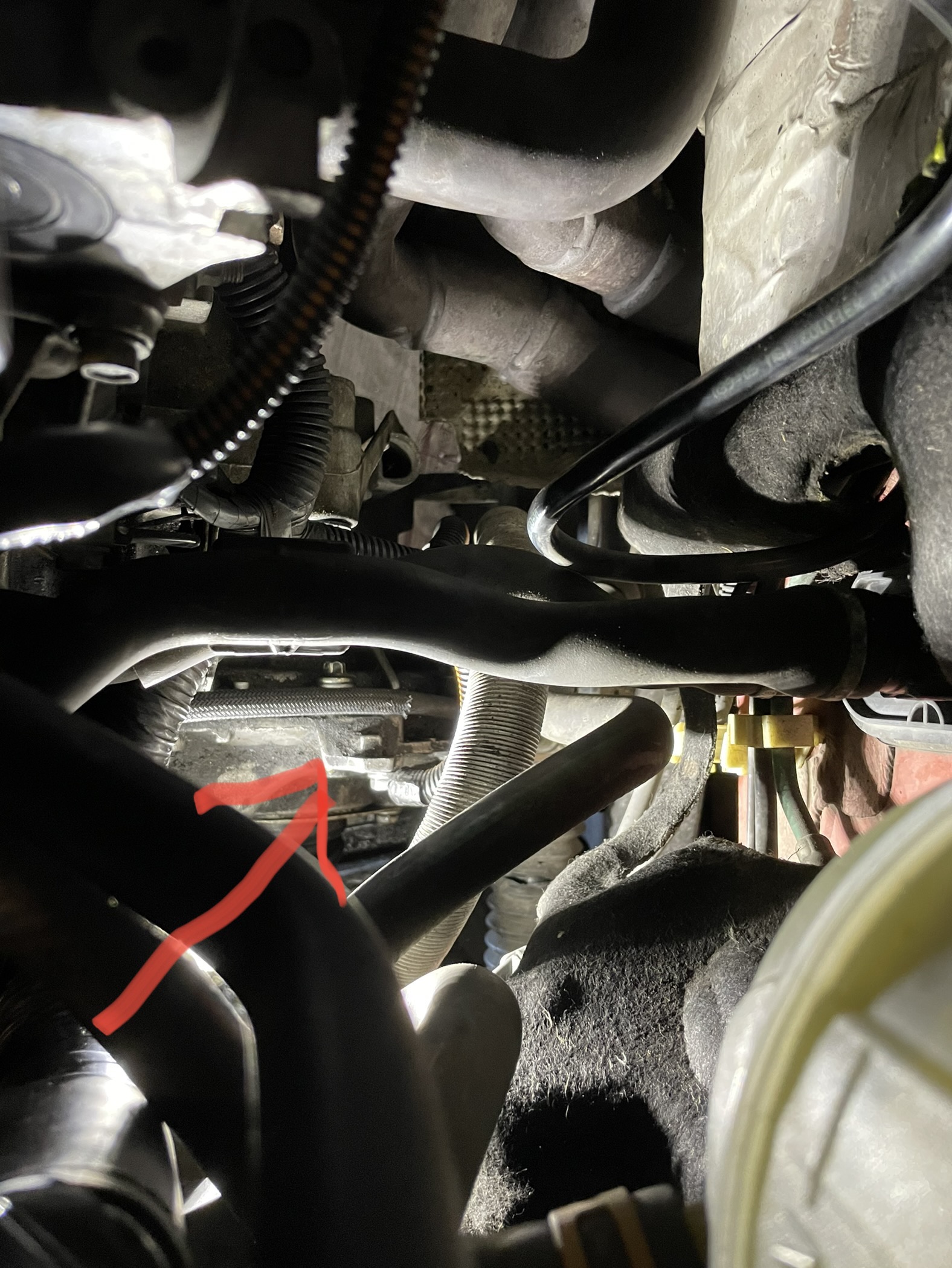

Hello all,
I have a somewhat similar "will not start" problem with my clio 182 from 2005. The pointers above have been tried to no benefit :( perhaps you have some more ideas....
The story in short:-
1. A week ago I had a clio 182 that ran fine and started first turn of key.... but I had been living with a slipping clutch for a year!!
2. Clutch job started and finished, included dropping the subframe and pulling off gearbox but not touching the engine proper
3. Only three electricals touched - BIG earth wire near bottom gearbox mount - sensor at bottom of gearbox wheel side (I assume reverse sensor) - top of gearbox near flywheel (maybe TDC sensor??)... they are all reconnected.
4. Now will not start ... what do I mean by that....
4.1 Switch key directly to start and the engine turns plenty fast enough for about 2 seconds then stops turning (not by the key)
4.2 If I do the two stage start, lights go out and the engine does not turn at all .... I assume some ECU failure mode prevents start and perhaps it's the same that stops the start-up after 2 seconds in above case 4.1
5. There is fuel, over half tank andI tried jump leads battery to engine (incase of earth issue)
6. OBD reader (very basic model) that I have used before (it worked) .... reports no communications same as when the ignition is off ... strange
7. one last point.... The fuse box has been knocked about a bit with all of the battery in/out ing .... ???
All comments/ tips will be very welcome .... even "sell it" .... but needs to run before going there ;)

Solution to my problem was - missing the second earth connection on the back of the engine ... engine running fine again
