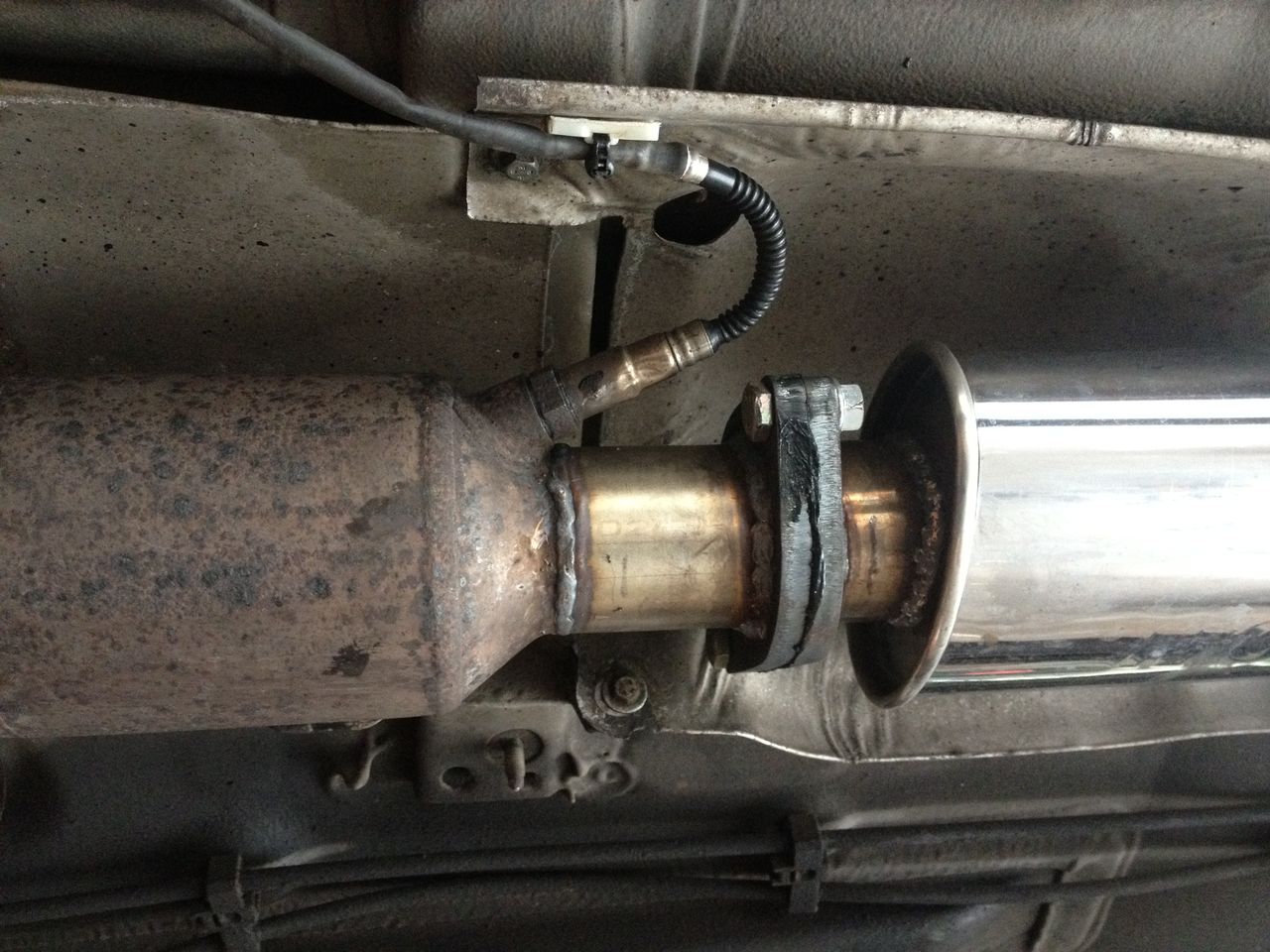

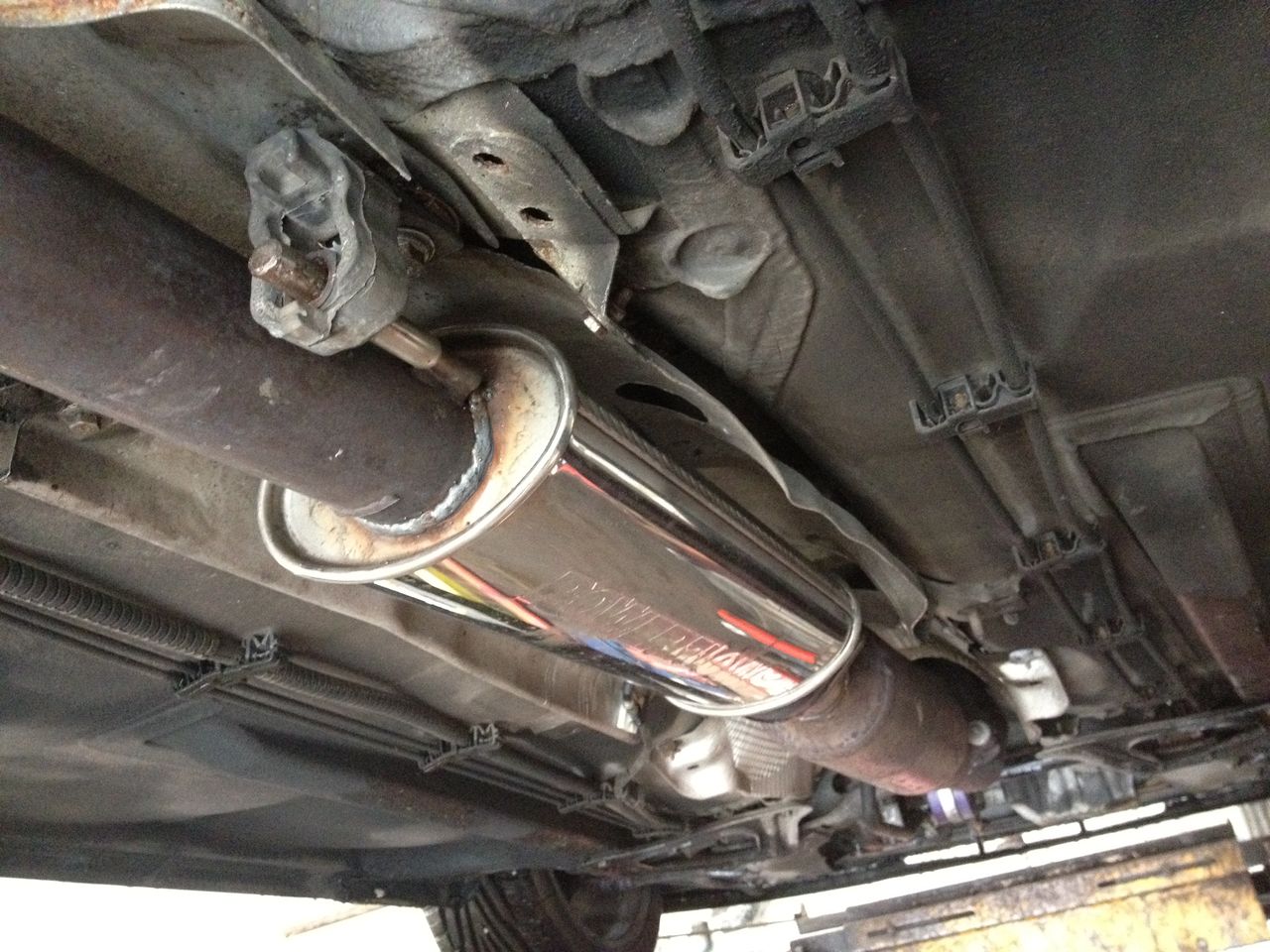

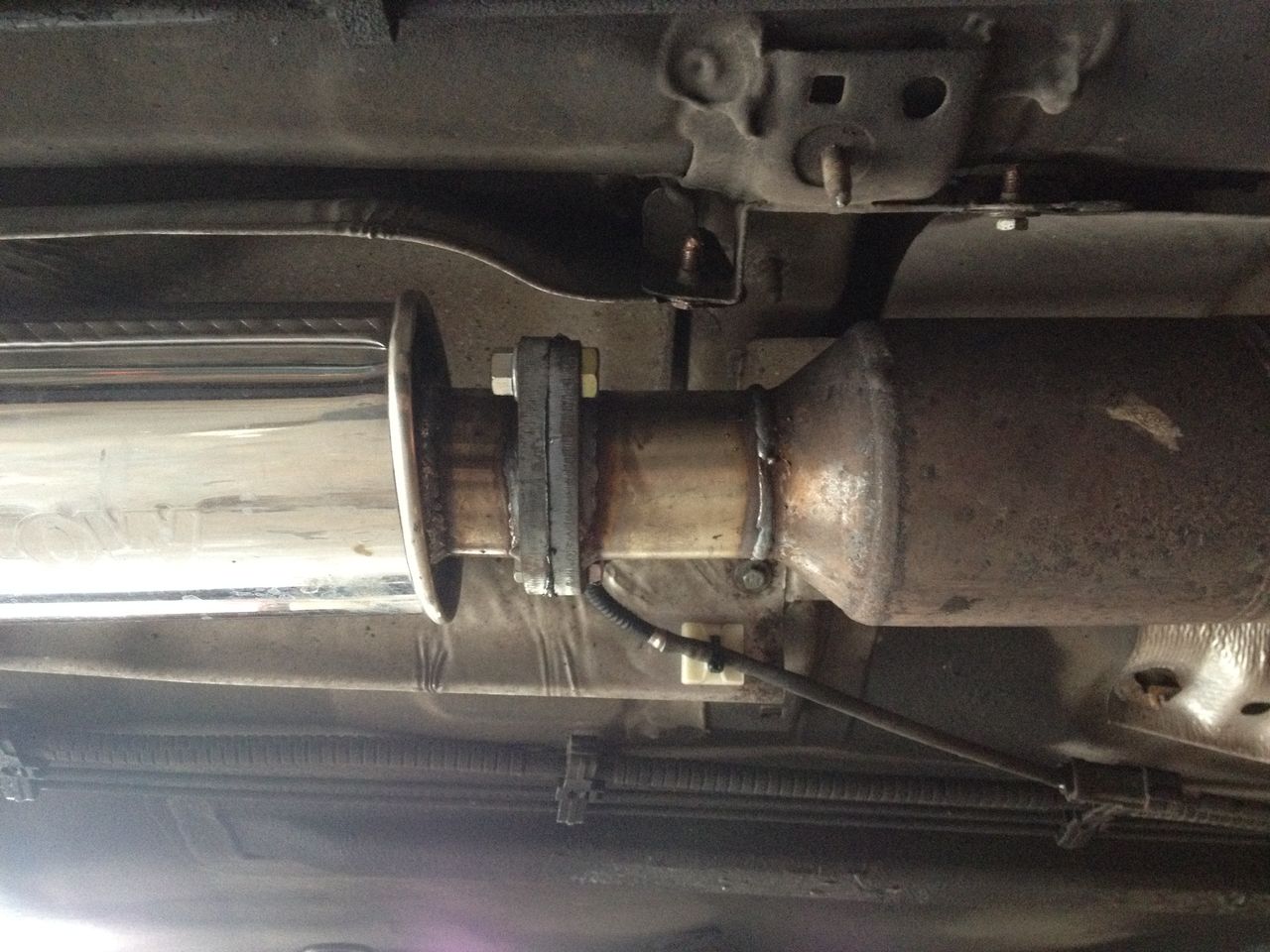

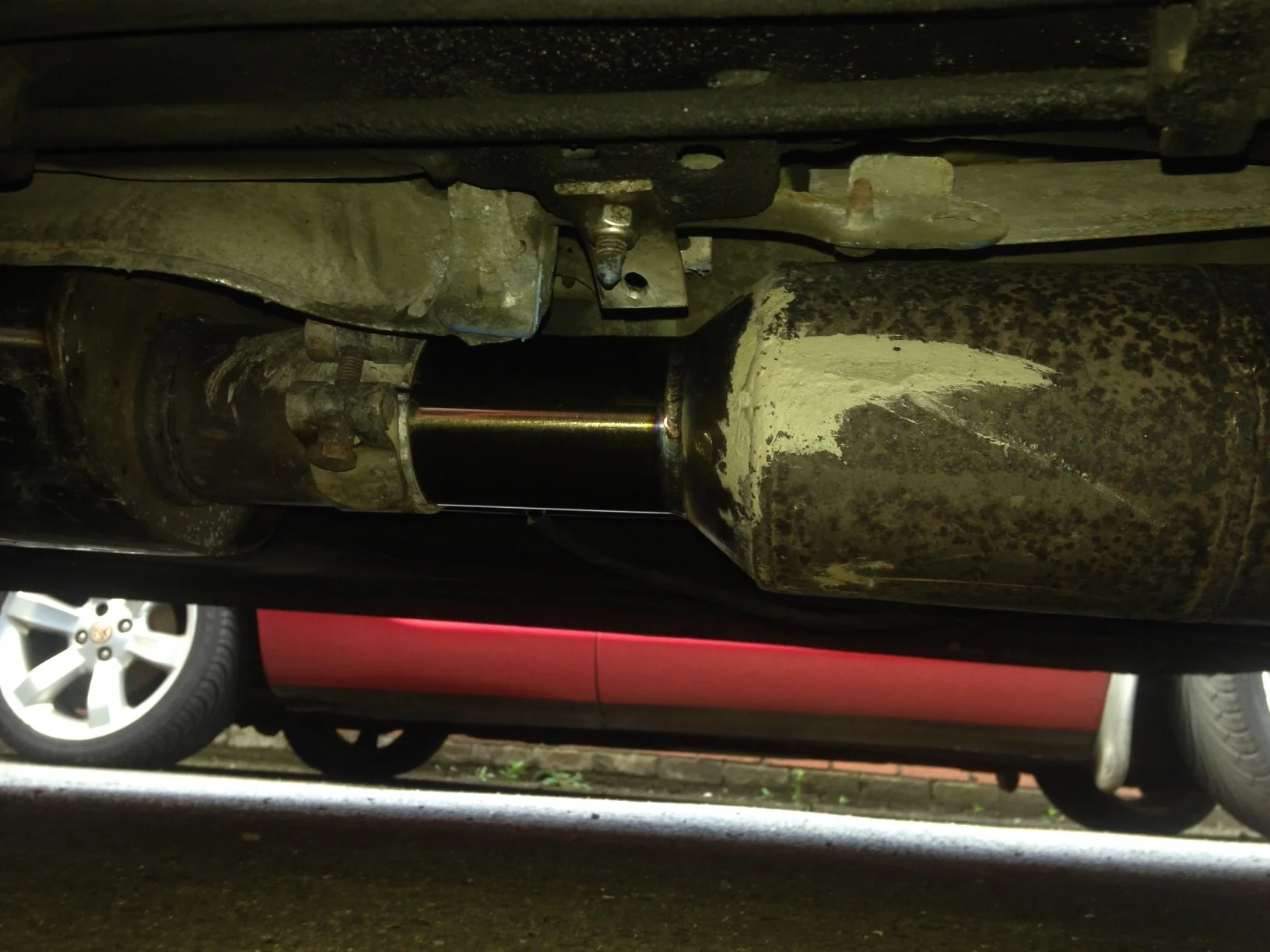

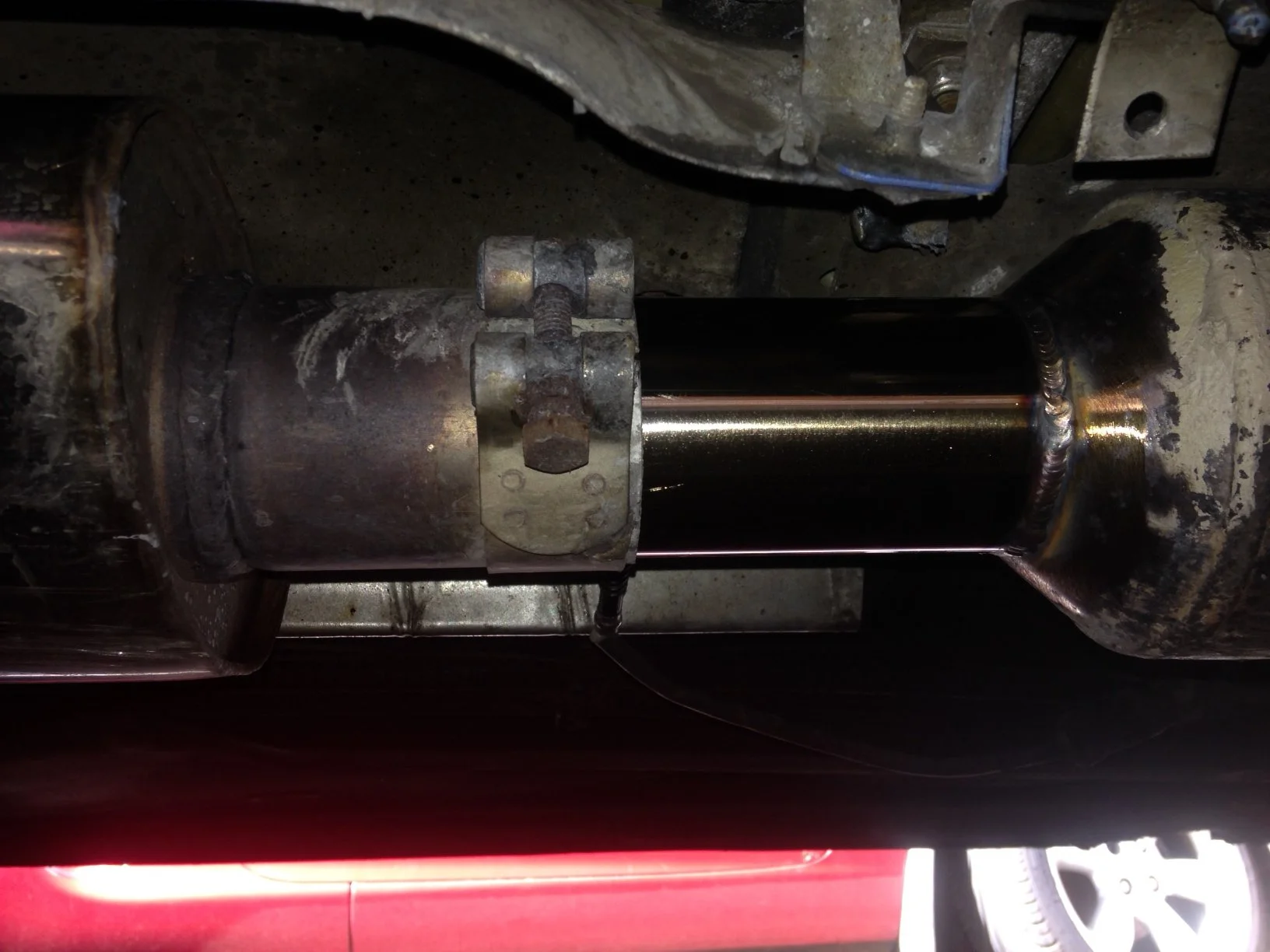

I got my standard cat sorted today too
up on the ramp
olive join cut off
and a lovely length of stainless welded onto the end.
that the nicest bit of welding i have on my whole exhaust system ( i have a milltek cat back! )
cost me £60
sounds like a different car and it has some more power now from the de-restriction of that joint

Haha! Very true! but these boys weld f1 stuff so alot of welding looks dire to theirs!
wish i didnt buy the milltek and got them to sort me out but oh well!
live and learn!
car feels and sounds soo good now!!

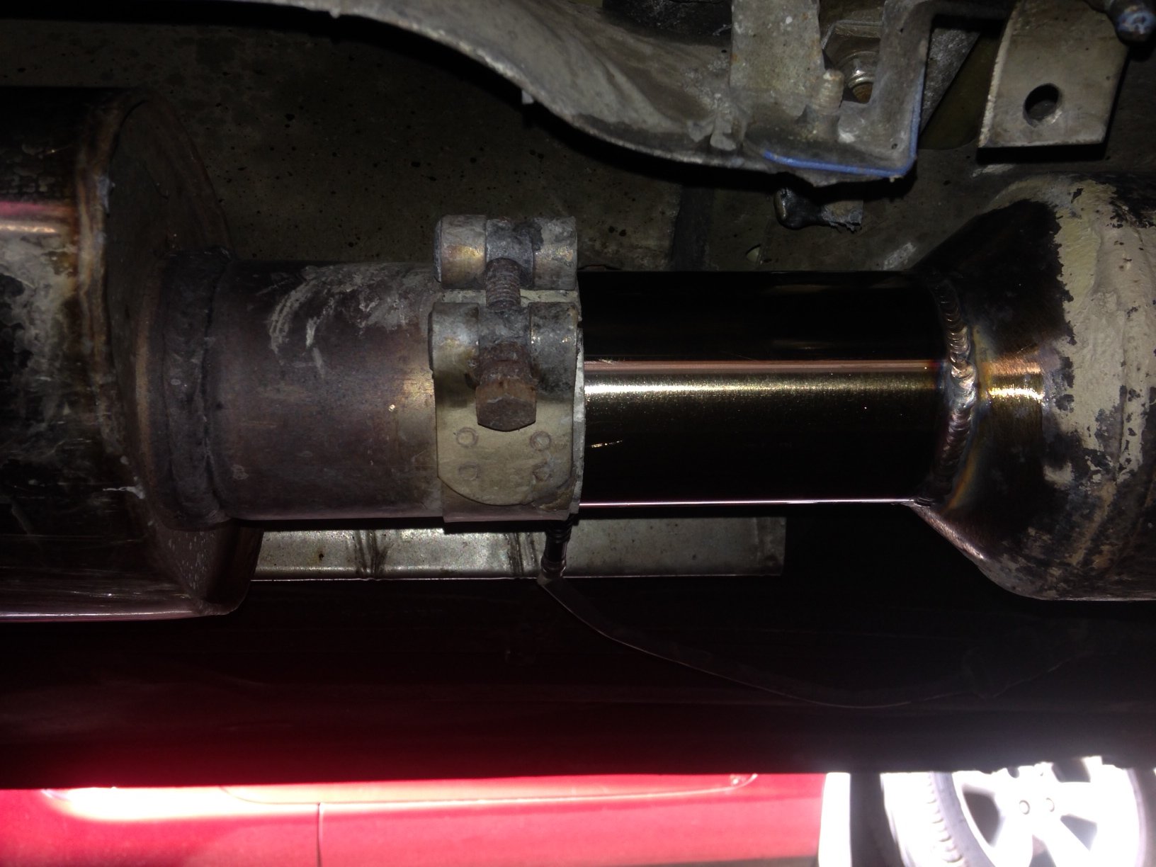

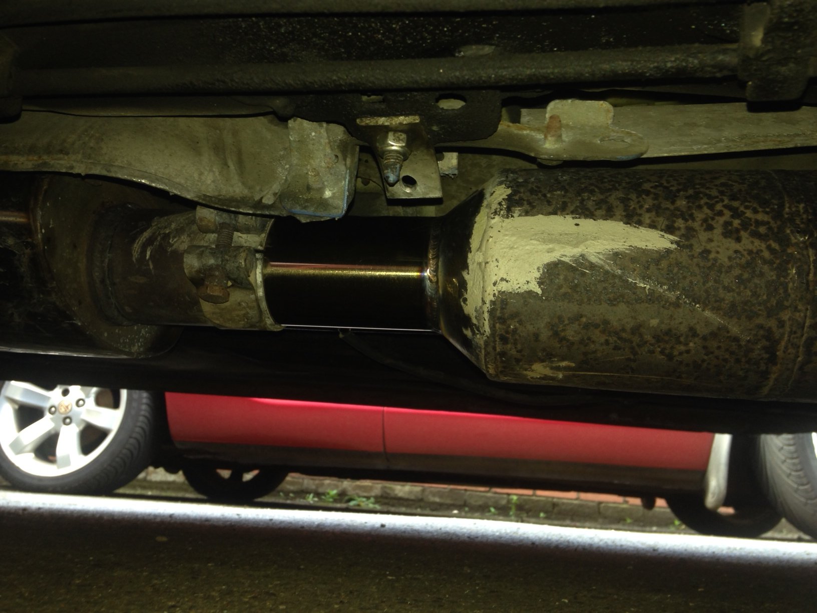

I think you are over complicating it a bit to be honest.
You need to get the olive joint chopped off, then have a piece of pipe approx 6-7 inches welded on to be used as a sleeve joint onto the centre section.
I can't remember if my but of pipe went over or under the centre pipe, I don't think it matters when the exhaust clamp tightens up into it anyway.

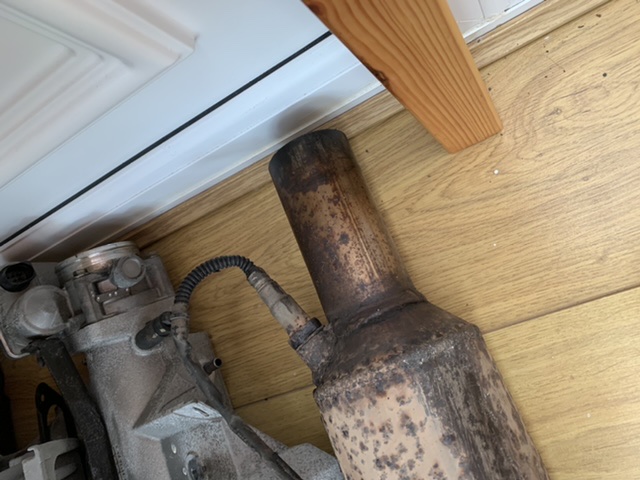

I welded a 2.5inch piece onto mine which slotted into a 2.5 ktec system fine with a clamp.
I’d also consider speaking to him about the manifold-cat connection as mine was heavily corroded and needed replacing with new steel.
