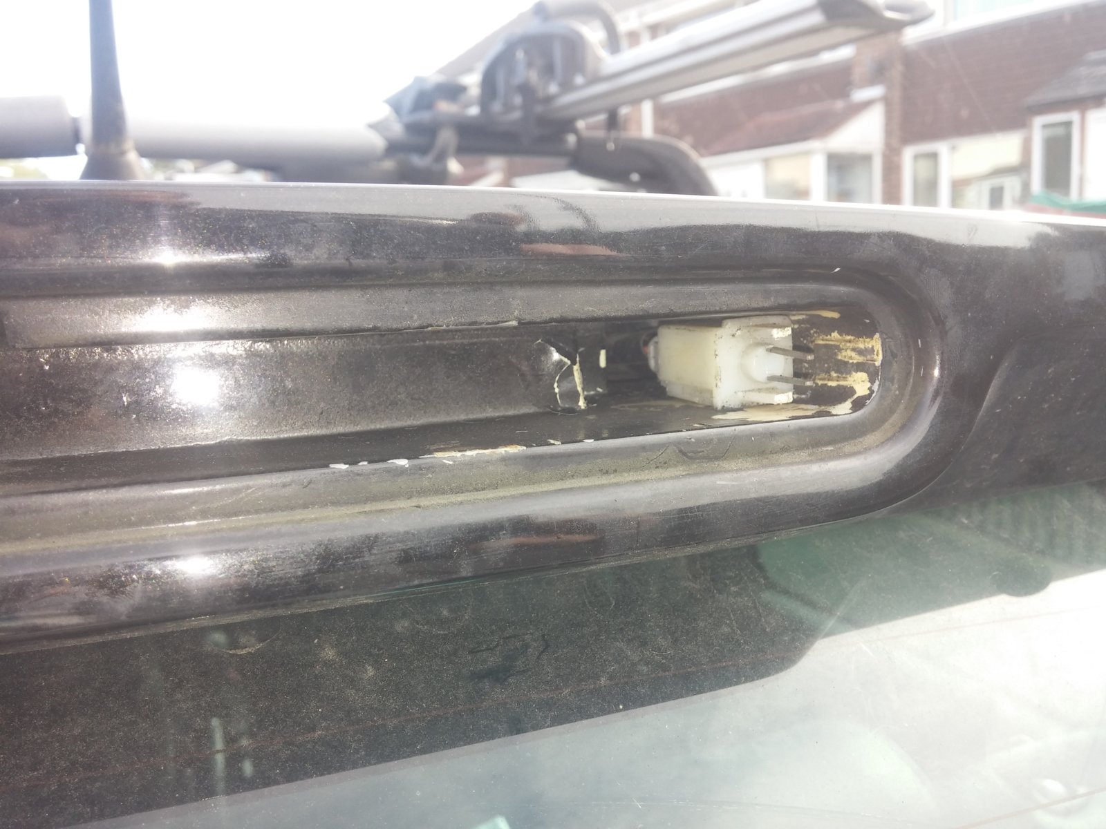

Anyone tell us how you fit one :blush:
Took my old one out ok but I can't seem to remove the white connector that the old one has left behind.

Do I have to take the spoiler off to get at it from the back??
Any help much appreciated.
Cheers.
Take spoiler off and use a thin screwdriver to push it out.
Cheers Pal, just what I wanted to hear I wasn't sure If it could be done without taking the spoiler off, I was hoping it could like (less work!)
I'm pretty sure that should have stayed in the light.. if you remove the spoiler you can push it out from behind
Yep, think your right as the new one I've got is sort of clipped in to the actual light.
I took the old one out and it left that behind!
