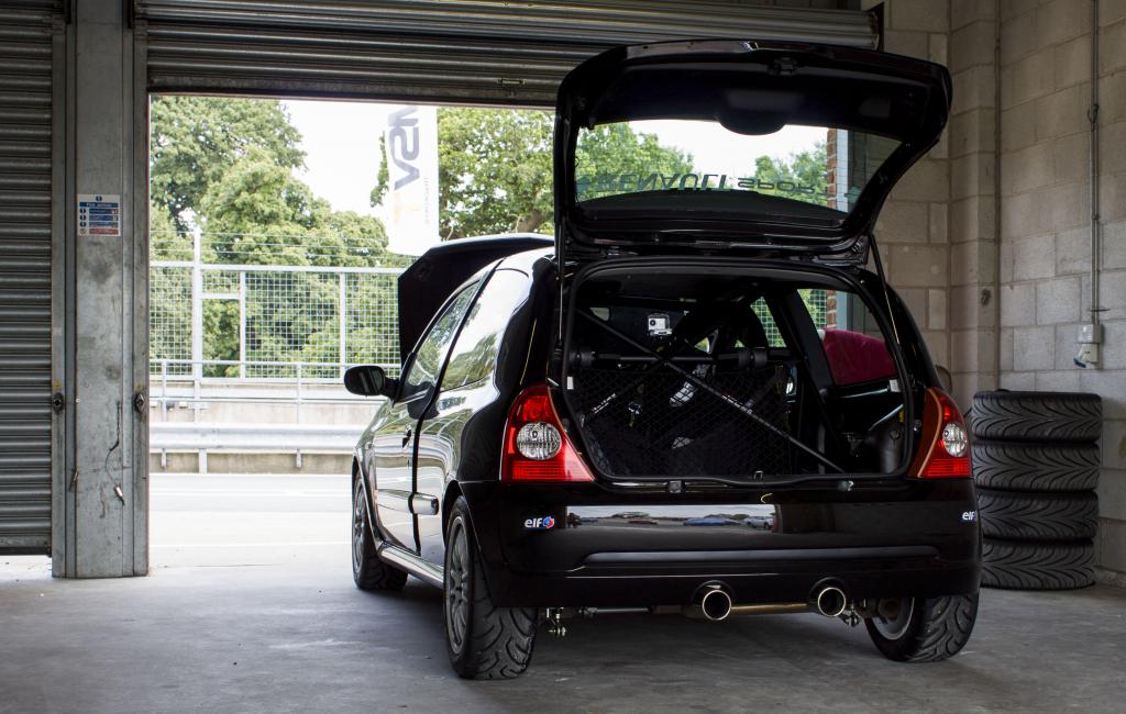

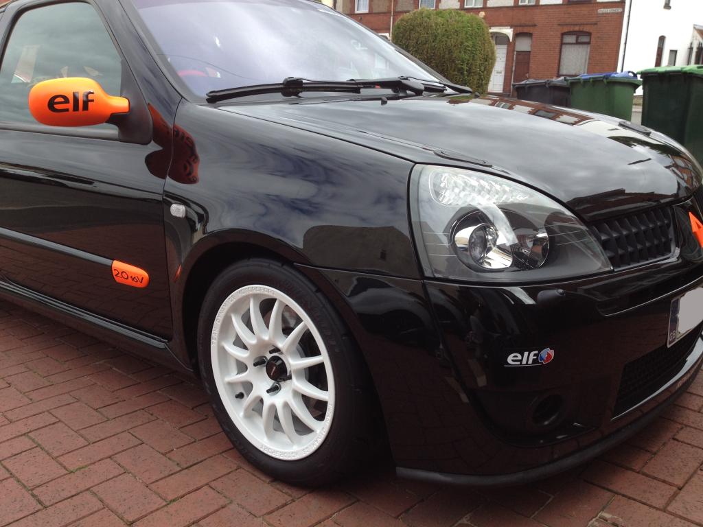

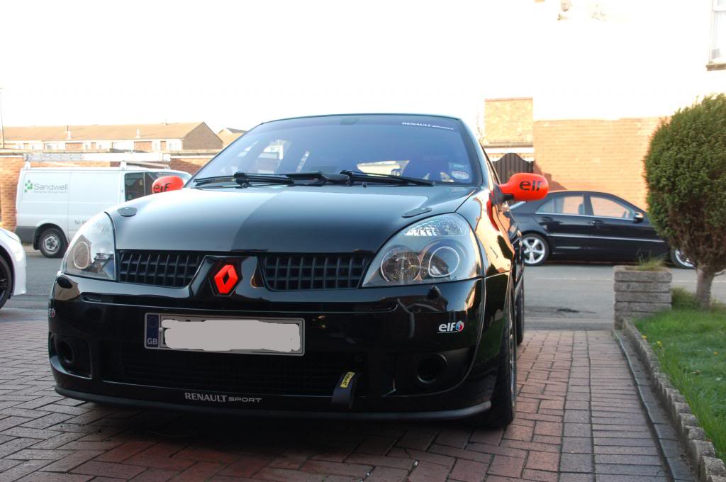

I have a set of 15" PR1.2 with ET43 and running 205 RSR tyres with 16mm spacers also a set of PR1.2 with ET35 no spacers with 195 Direzza tyres car is lowered on cooksports and got 2.25deg neg camber.
The ET43 without spacers looks wrong IMO the ET35 fit is perfect and it works well on track no rubbing etc, if I ordered them again I would have gone for ET35 on both sets.
Here is a few pictures to give you an idea the white wheels are ET35

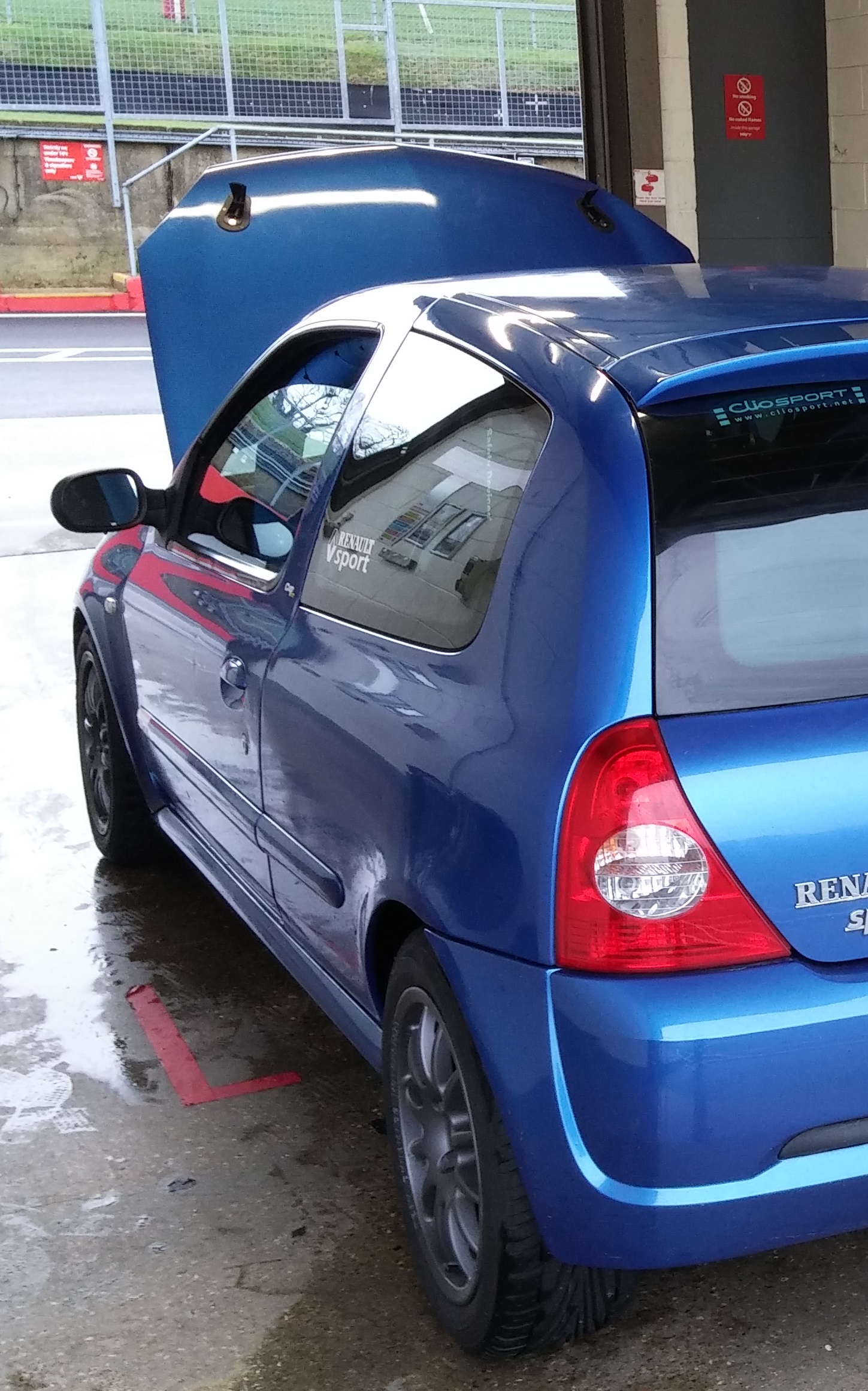

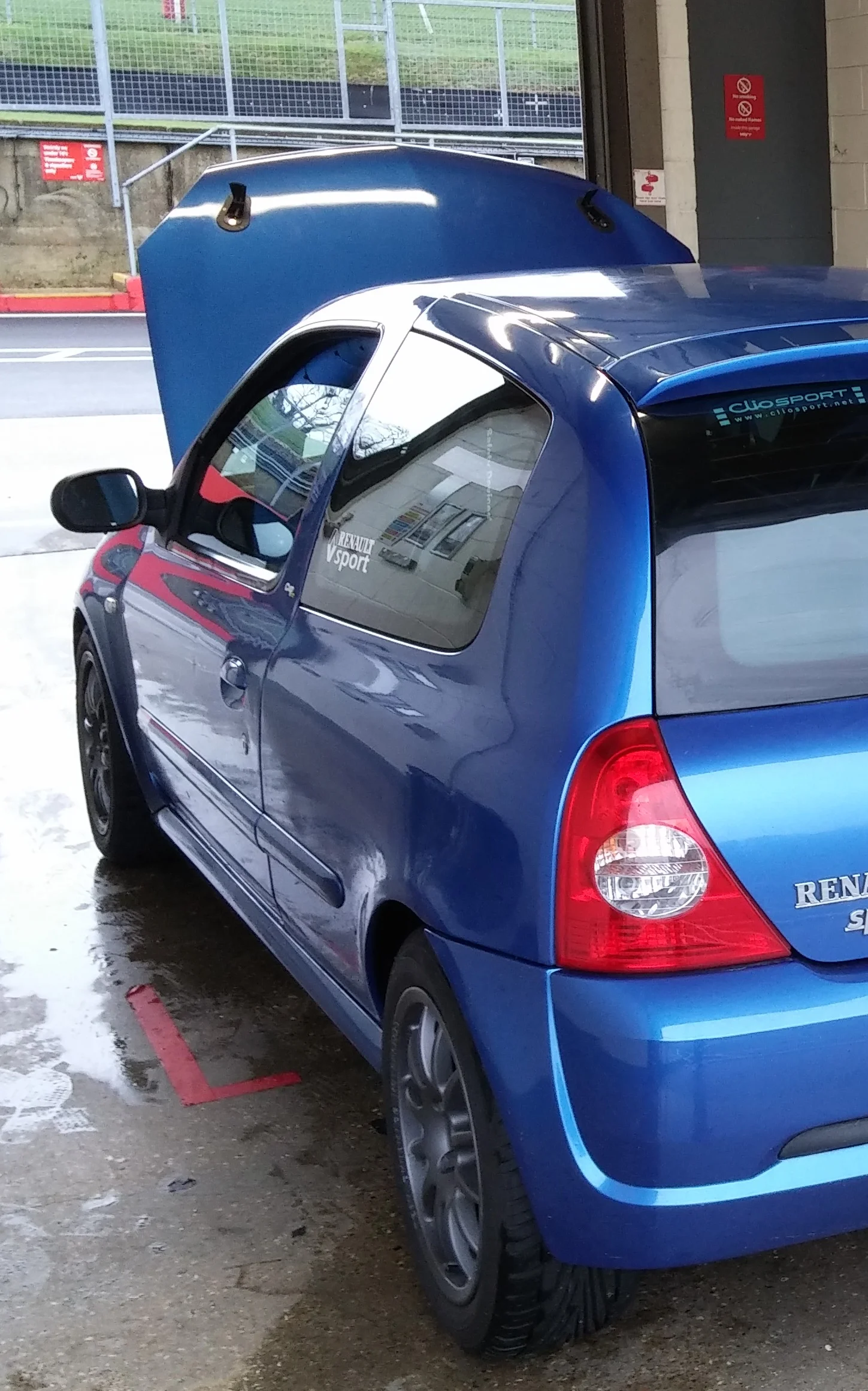

That offset might suit me. I'm got a small dilemma, I currently have a 172 cup running ET45 TD pro 1.2's with 25mm bolt-on front spacers and 10mm fixed shims on the rear, the stance looks good and felt good on track the other week (still a novice though!). I want to go with two sets of wheels for track and sprints etc (wet and dry-intermediate) so will potentially be swapping wheels on the day. I believe the standard 172 cup is ET38.5, the obvious approach to me is to buy the same ET45 and therefore leave the spacers alone and support a quick simple wheel change - is my logic right, I'm I missing something?
Any advice welcome. Thanks.
