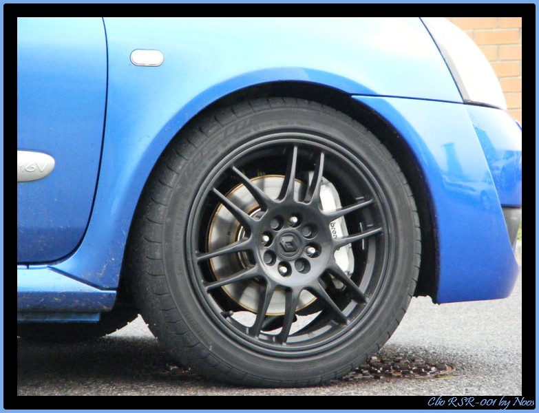

Yup - easily clear the callipers (have a look in my project thread)

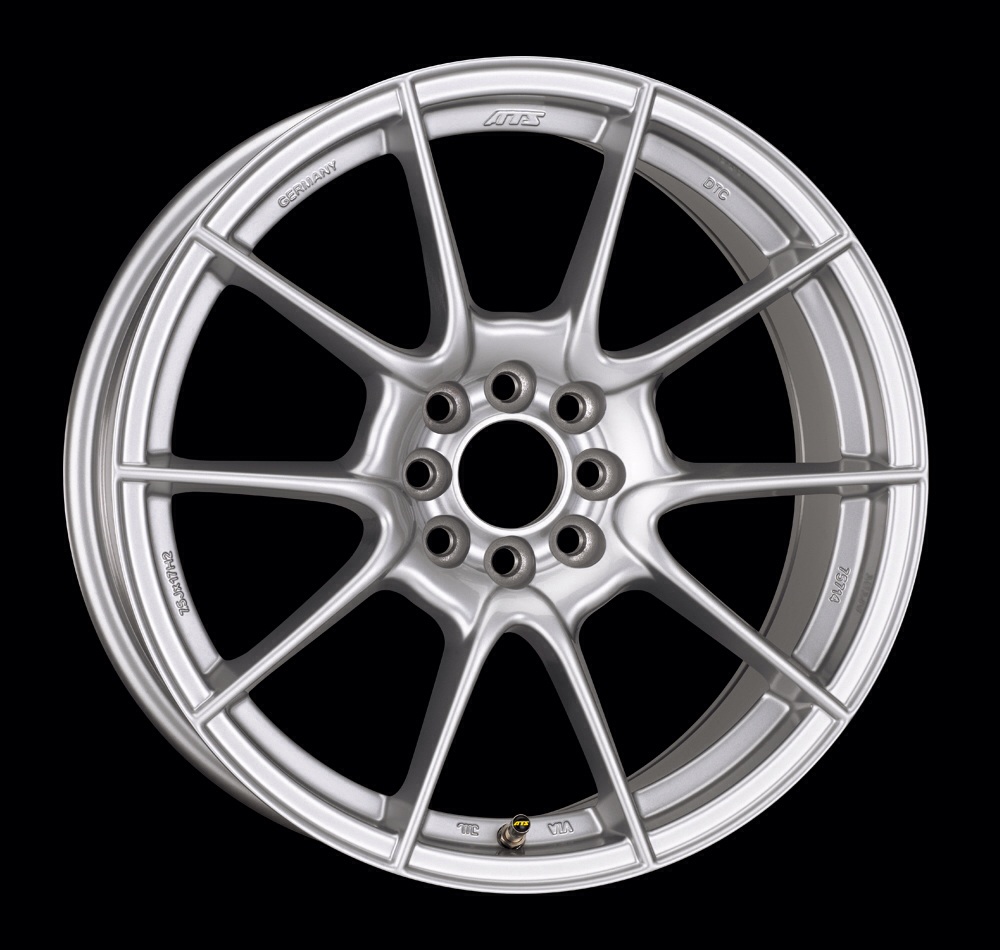

I meant to say ATS DTC's, used by a lot if the fiesta ST championships. Nice strong wheels supposedly despite the looks.
Those look promising!
Will have a bit of a look into that.
Best thing about those, is I could get some for the front and they dont look *that* different to the OZf1 so I could still run the f1 on the back, that way I would only need to buy about 8 wheels rather than 16.

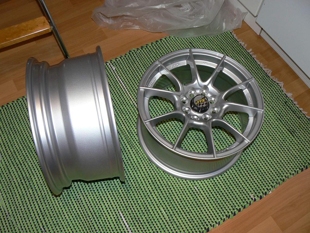

Hmm, looking from a different angle I might still struggle TBH
Really need a picture from the inside looking out not the other way around which is all I can find!
Yeah I can't help but they're spacious as said, a lot smaller step inside than F1's and 2118's have. The spoke bows out too to accommodate the calliper with big offsets.
