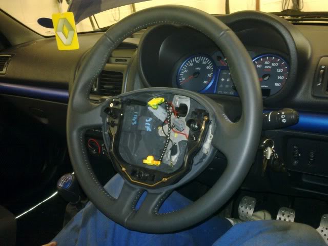

For all the doubters, we trial fitted kev steves MK3 steering wheel, it fits, same splines etc!! Smaller than a standard wheel, and 99% sure the airbag will wire up too (same resistors required as the MK2)
PROOF!!!
there?

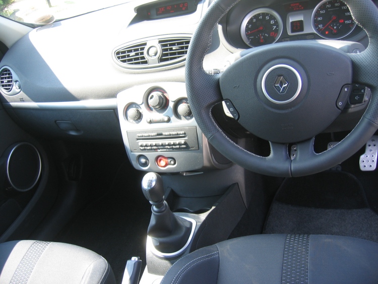

My 197 steering wheel doesn't look like that. There's no perforated leather on that one? Looks like the ones in a standard Mk3 to me.
  Mondeo TDCI 130
^ its my cup!
The SPLINES are the same in my 200 cup, as gas's 172 cup. Thaty was all we tried!
So in theory it can be done, cowls need modding i would say!
