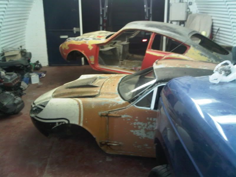

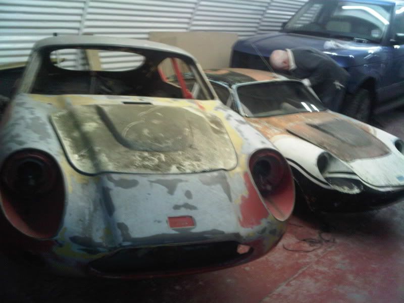

my forman at work has just bought a 1970s marcos which is in quite a state so i have taken it upon myself to help him restore it as i have a bit of a soft spot for them and they are rare as fcuk (only 100 made).
i dont really know much about them but this one has been to loads of car shows and won quite a few awards from what i have been told. it must also have been resprayed a different colour for each one too as the are a bouth 30 layers of pait to dig through :dead:.
it also has a 3.0 v6 essex engine too and has been stood for years so is in need of some major tlc so i was only too happy to hlp get it back to its beautiful original state.
heres some pics so far (ps they are crap phone pics with bits of dirt all over them lol).
body off the chassis
door
not sure on the red pearl for the running gear and chassis but its not seen anyway so not really important, just to say as well, it was all shot blasted before painting lol.
ive also tryyed my best to get the ripples out of the tail gate and doors but with them being fibre glass, it is near on immpossible to get them perfect so they are the best that they can be at this stage. next for them it some spray polyester which is like a spray filler. they will then be blocked (again) and primered (again) which should loose more of the ripples. on the shell, it is all bare fibre glass now so i need to go over the whole thing with a dremel and cut all of the cracks into a v shape so they can be filled before spray poly. and the front clam needs taking back to bare fibre glass and the same with all the cracks on that. there has already been loads that we have done but its too much to remember lol.
