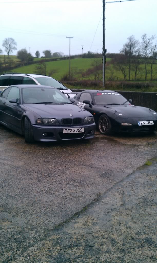

I understand the photos aren't of great quality but they are a bit of a rushed job with my phone, lol.
So, after pricing how much it would cost to get the Subaru track ready and at around 400bhp, I started to realise it would be better to purchase a track ready car and something a little different.
I've known the owner of the car for many years and I know how little the Rx7 has been used (busy family man with an upcoming wedding). It was originally built by a company called Re:Worx in Brighton I believe and has been very successful in competition racing.
The spec is as follows:
RX Motors half bridge ported 13B REW (circa 2000 miles)
T04Z Turbo (horsepowerinabox kit)
1.32AR exhaust housing
Turbosmart Pro-gate 48mm wastegate (plumbed into heat wrapped down pipe)
Re:Worx / PWR V-mount
1600cc secondary injectors
KGParts fuel rail
Aeromotive FPR
Coolingmist single stage water injection fed from UK spec washer bottle
Greddy elbow
FEED mid pipe
Racing Beat twin exit cat back (powerflex exhaust bushes throughout)
APEXi AVCR (setup to 0.8(a) / 0.95(b) bar)
APEXi Power FC
HKS Twin power spark amp
SARD 280lph in-tank fuel pump
Battery (optima red-top) Relocated to boot
Alloy battery cage bolted to rear cross member
Fuel pump totally rewired - fed from battery via fused relay, idle resistor eliminated
Magnecor 10mm ignition leads
NGK B10EGV plugs
Greddy catch tank
Tein Flex coilovers
Racing Beat uprated rear anti roll bar
Racing Beat uprated front anti roll bar
Rota Torque drift 17"/9 et35
Toyo R888s all round
OS Giken twin plate paddle clutch (alloy cover)
Solid diff mounts/engine mounts
Dragon Performance diff brace
Powerflex suspension bushes throughout
RE-amemiya 3 point strut brace/master cylinder stopper
AP Racing 4 pot brakes
Pagid RS-14 pads
Castrol RSF fluid
Braided rear brake hoses
Fully Stripped
Roll Cage
Air conditioning removed
Safety fire extinguisher installed (fed through to front seats and engine bay)
Mazda UK MPH Clocks
SPA Programmable water temperature gauge
Momo Race steering wheel/boss
Mazdaspeed Carbon gear knob
PZ rear bins (complete)
Rolled rear arches/flared front arches
High risk hoses upgraded to earls braided hoses: Waste gate/boost control hoses
Water injection hoses front to rear
Turbo Oil feed/return
Water feed/return
Various under bonnet heat shielding
Power - 470bhp on medium boost. 540bhp on high boost (aggressive)
Bad points - Erm, not too much really. Paintwork is tatty and it's sporting a couple of war scars, but nothing I'm worried nor bothered about, it's purely a track car.
Inside it gets very hot (Fixed polycarb windows) so I will look into getting a slider kit installed in the drivers window.
Paddle clutch can be quite difficult to get used to.
MPG…flol, can't describe how bad it is. Ridiculous.
That's about it really, I've had a soft spot for RX7's for years now so it's amazing to finally own one. The way it picks up speed is unbelievable, I've never experienced anything like it before.
C&C welcome as always,
cheers.

Nice.
But can you sort the dash out? It looks crap with all those wires all over it

Cheers for the comments. Yeah it does need a tidy up, inside and out. It will get a good scrub up soon.
