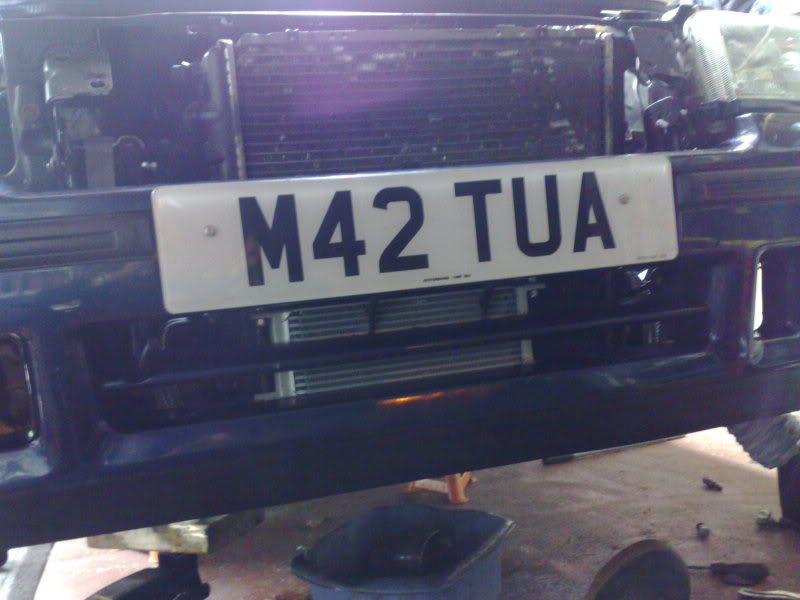

Got my oil cooler fitted last night, and some major hacking of the bumper was needed. Also picked up a brand new radiator tonight which should hopefully be the end of any cooling issues.
Phone pic of cooler for now:

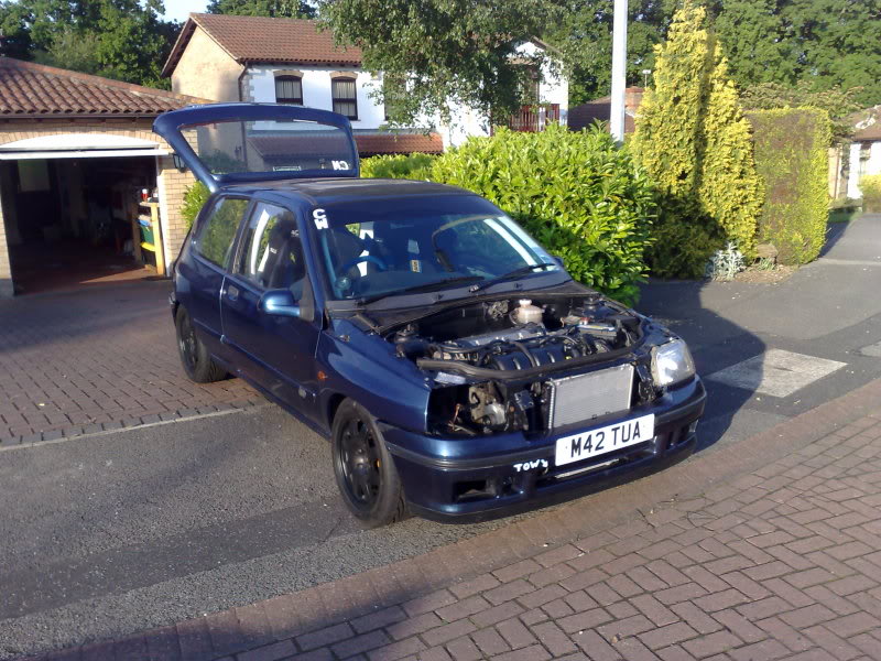

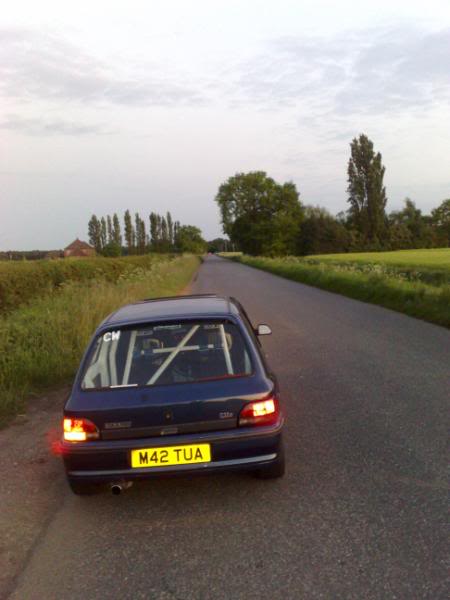

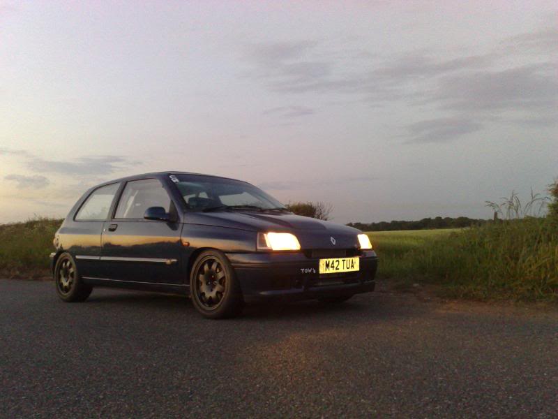

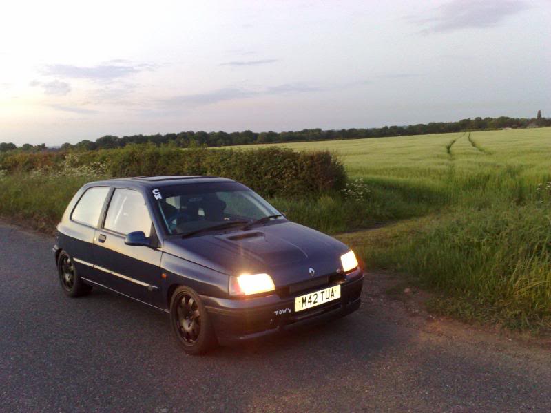

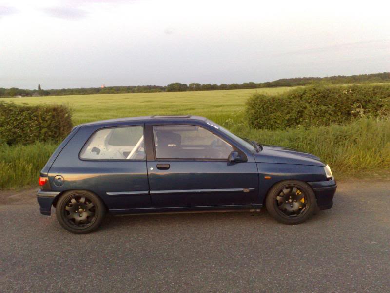

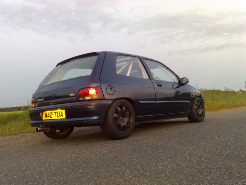

I've now got F7p V2.0 in and running as of today. It got home from it's first 30 miles successfully so I'm pleased so far :D
Stopped for a general check over the car and it looked a nice place for a photo or two, only had my N95 with me though I'm afraid.
Got a nice splattering of bugs on my shiny new radiator and oil cooler too :evil:

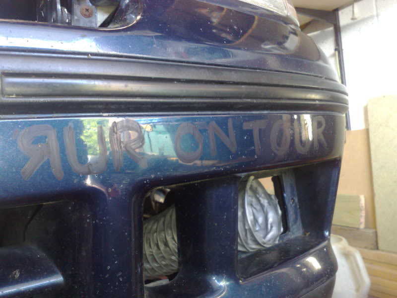

White pen aye, I've given up caring about that bumper!! I'll get some pics tomorrow of how I've had to butcher it for the cooler.
