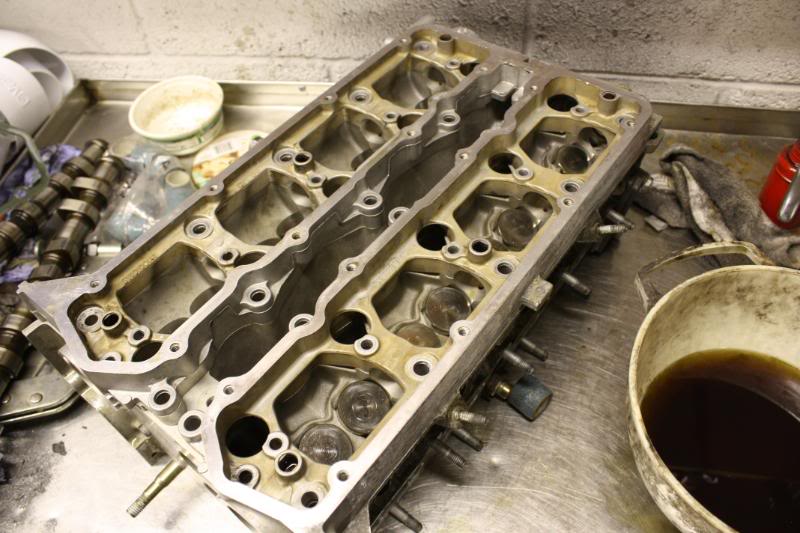

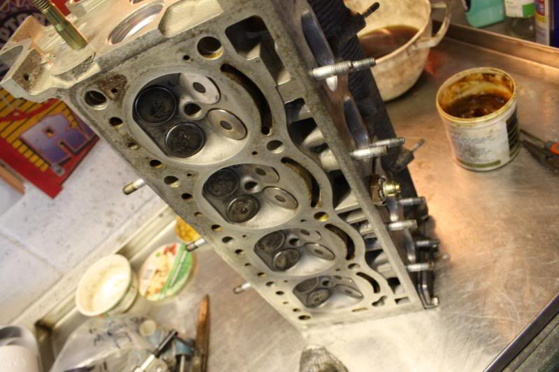

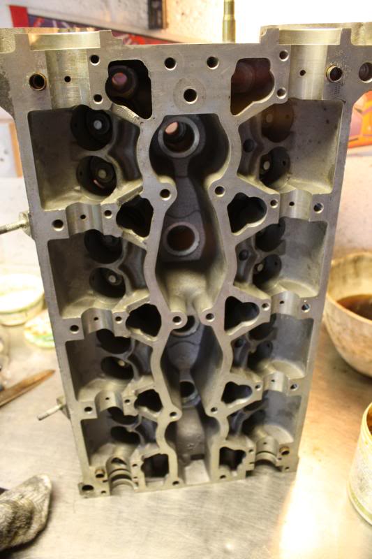

Get soaking them bits and the head in the cheapest of cheap vinegar! have em good as new in no time.
Re: Valver Track Car Project Thread
Is that likely to be more effective than a quick splash in petrol? Got some GUNK too, doesnt seem great.
Coke is also very good at cleaning stuff, but has the drawback of leaving stuff sticky! lol
put it in the dishwasher, comes up awesome! my mate did it with his calibra head an it was like brand new!
Got 10 bottles of Asda's finest vinegar to try. 13p for 568ml. Win!
Not sure the mother would approve of dishwasher technique tbh.
Get it in the dishwasher, NOW!! Thats a brilliant idea, worthy of RUR approval.

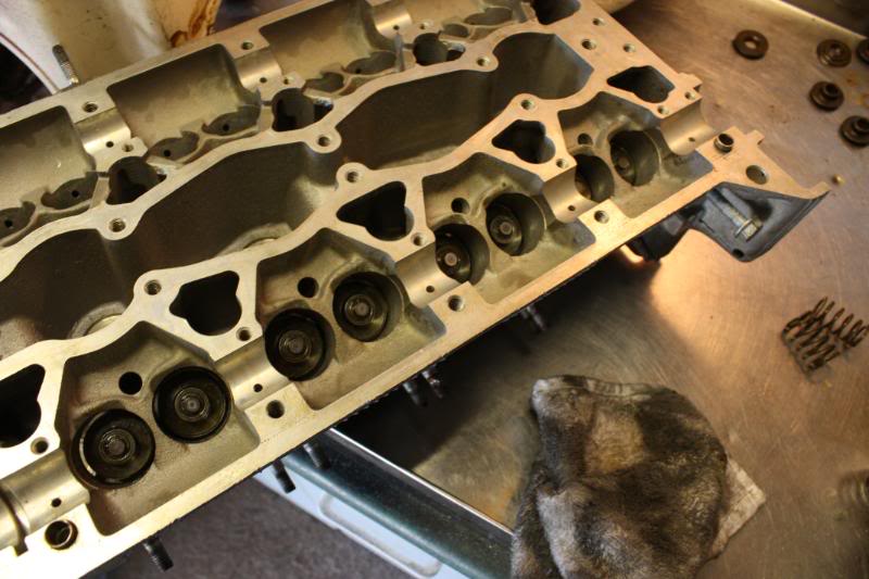

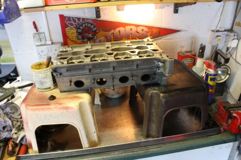

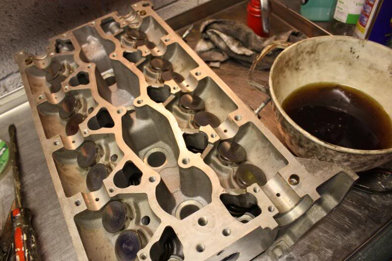

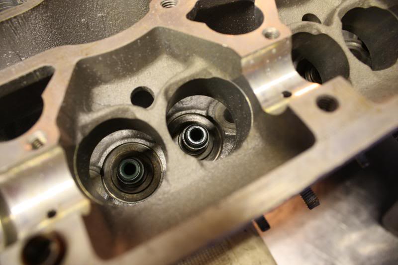

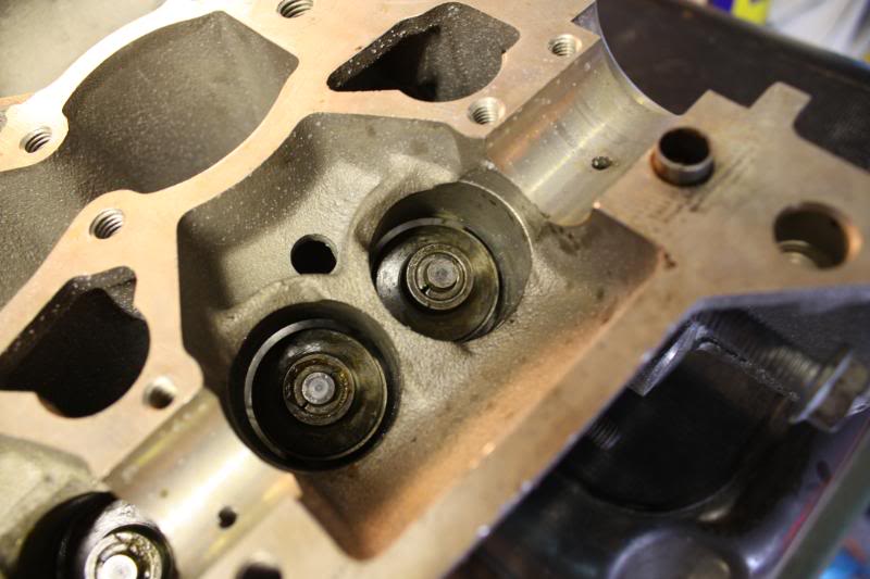

Finished lapping all the valves and dishwashed the head last night, came up quite well. Bottom spring retainer and new valve stem seals in
Gradually got the valves in. Bottom retainer > stem seal > 2 springs > top retainer > 2 b*stard collets!
Head bench
All exhaust valves in
And inlets
Put the lifters in having soaked them in some engine oil, move pretty freely now

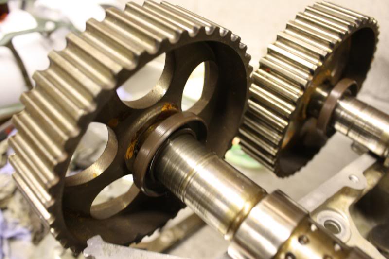

New cam oil seals

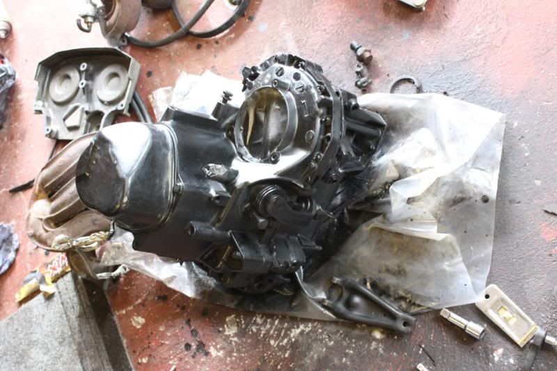

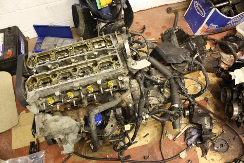

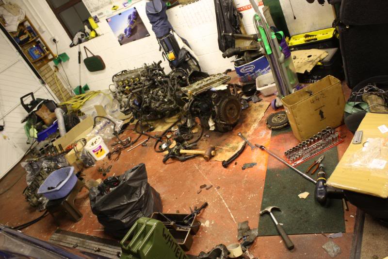

Started taking the old engine to bits to borrow a few bolts and see what goes where etc
Complete mess!

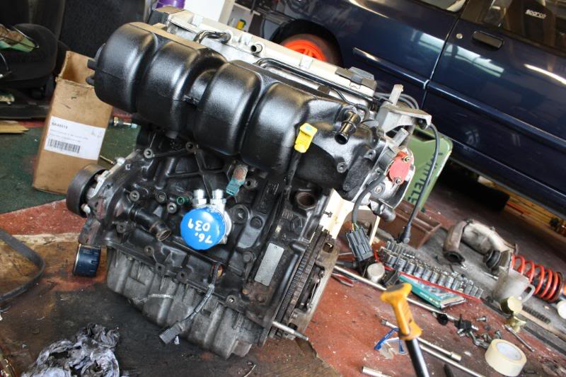

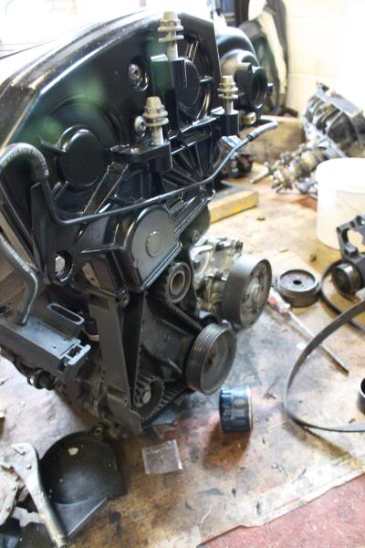

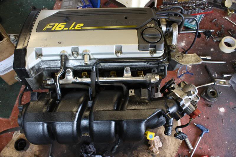

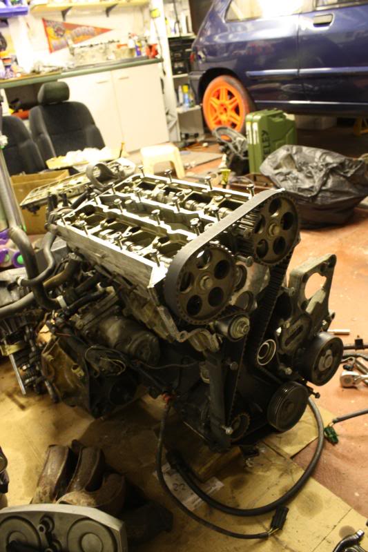

Swapped belt/idler/tensioner over from the other engine and got that fitted and timed up. Painted the cam pulley cover black too

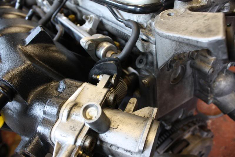

Fitted my newly painted inlet manifold, along with PTFE gasket. Polished the fuel rail a little bit too. Injectors in also.
PTFE throttle body gasket fitted

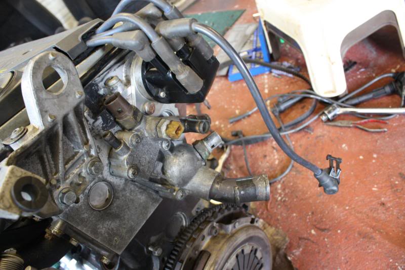

Thermostat housing and sensors sealed on, low temp 'stat swapped over from before.
Oil cooler sandwich plate and new filter. Need to decide on pipework routing for the cooler yet

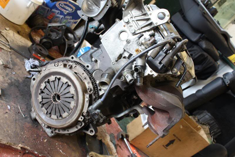

Clutch swapped over from the other engine, aligned using an old boot gas strut, perfect!
Degreased the gearbox and gave it a quick squirt of paint

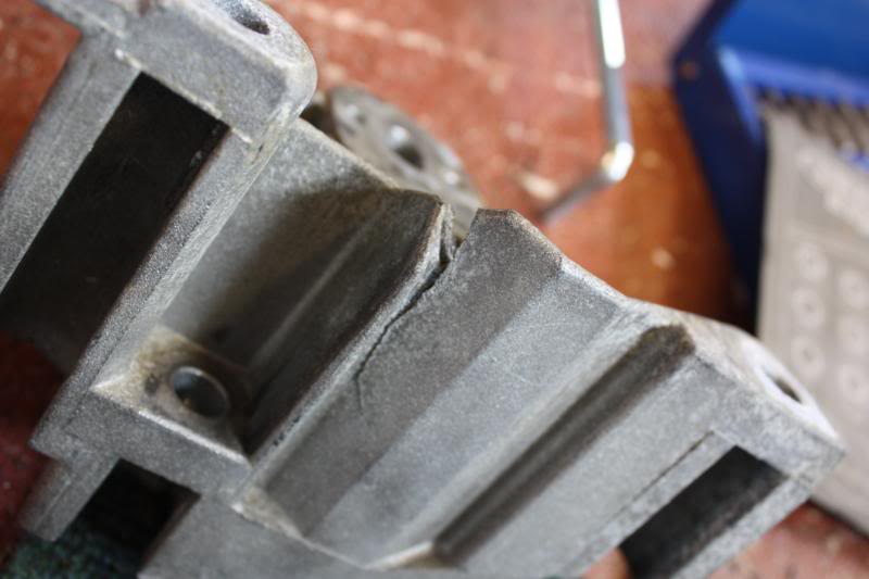

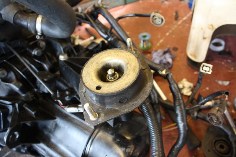

Found this nice crack in the top o/s engine mount, think I'll swap that!

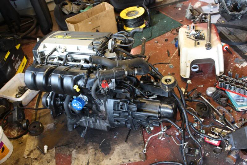

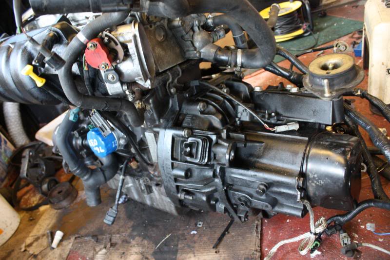

Gearbox on

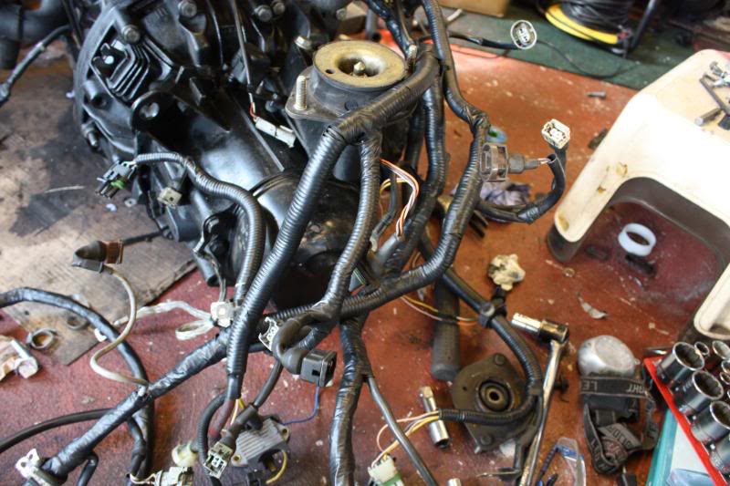

Re-wrapped all the engine loom as it was looking a bit tatty. 3 rolls of electrical tape later
Swapped gearbox mount to one in slightly better condition

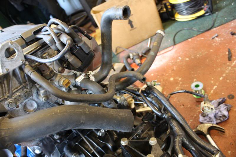

Cooling pipework on

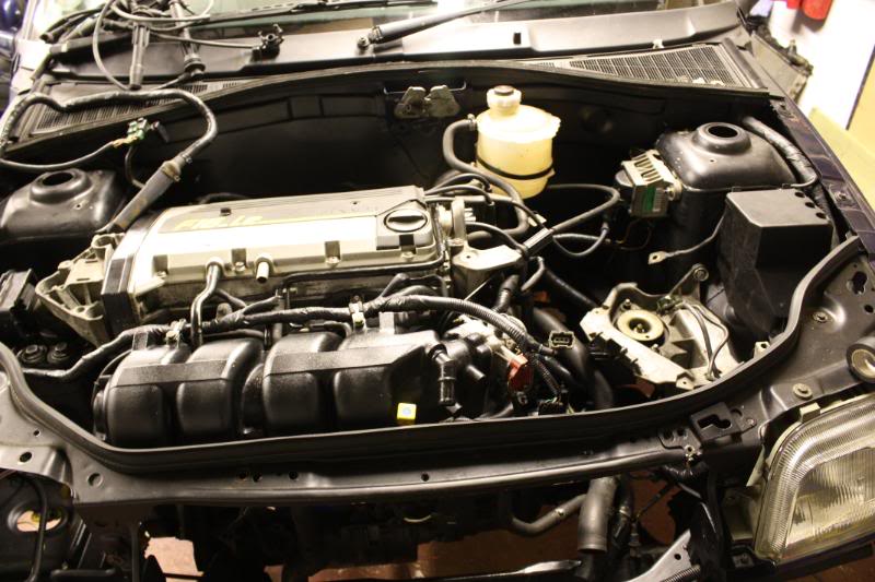

Started connecting the loom back up, almost ready to go in

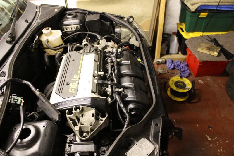

Engine in, just sat on its mounts for now but not plumbed up
