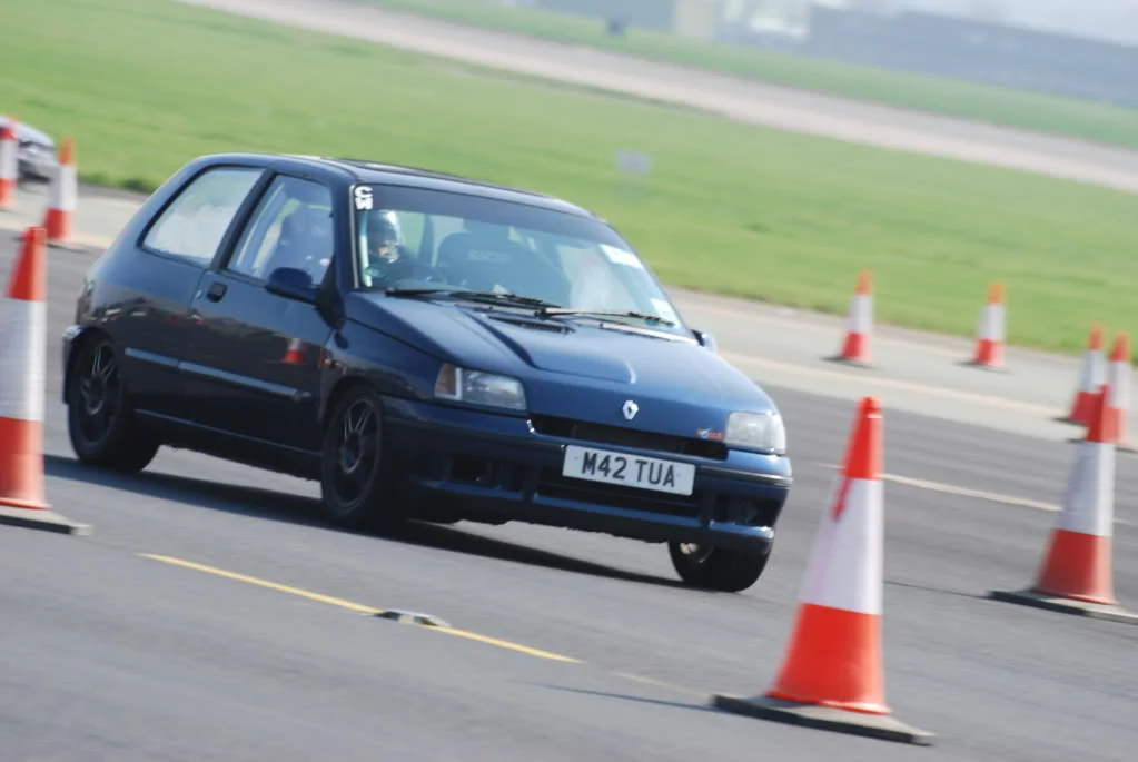

Right, we're back from page 3 with a long overdue update.

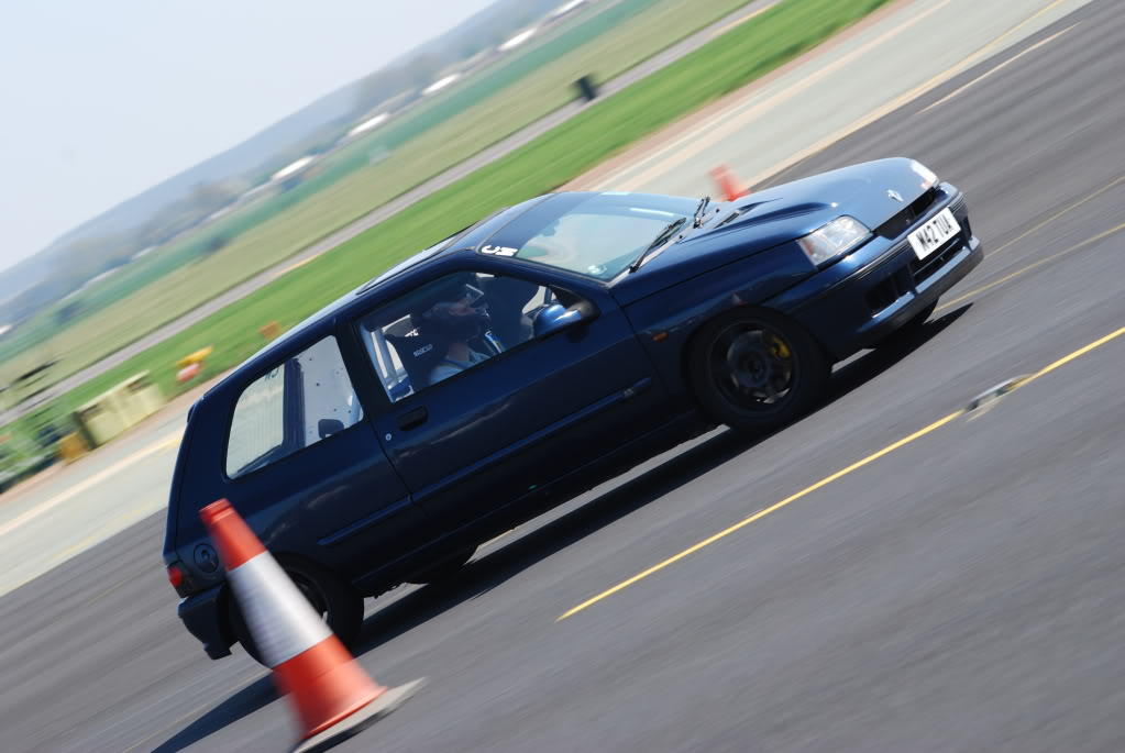

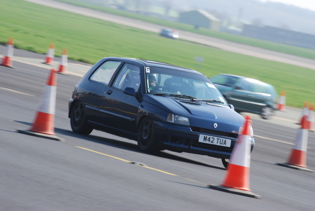

The Valver had its first trackday at Marham last month, just an airfield jobby to give the car a good shakedown. Things didnt start particularly well with my alternator giving up on the way down, so jump starting was in order for the weekend and putting my battery on charge when I wasnt driving.
Ignoring that hiccup, I was very chuffed with how the car behaved. Handled superbly, ran rings around most stuff in the corners (1*2's included ;)) and was pretty nippy too. All in all a very good laugh!
Some pictures:
Then things went downhill :(
It all got a bit warm, cut out as I came into the pits and then refused to turn over once it'd cooled down. Result = 1 seized F7p! :clown:
So, I called for recovery which was luckily included with my Flux insurance and got towed out to the gate, of course someone had to film my misfortune lol
[youtube]Yc9Dt0FXcLY[/youtube]
More later...

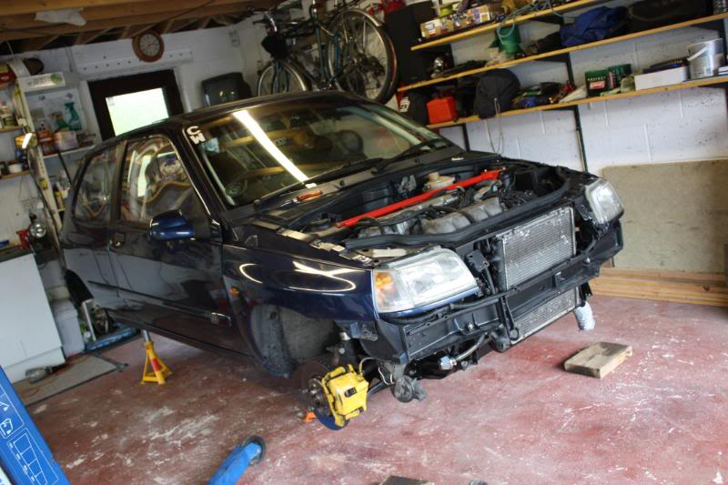

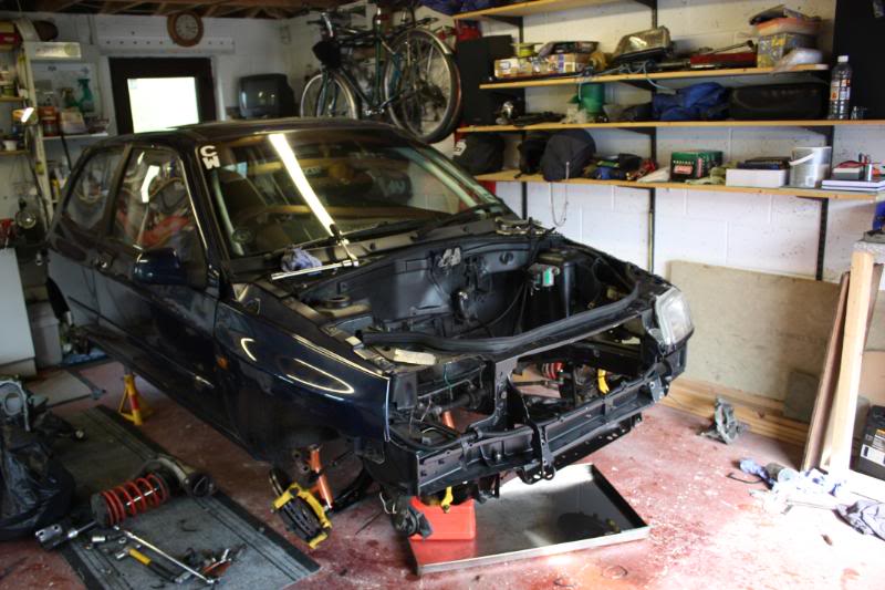

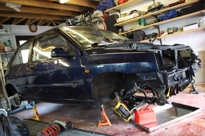

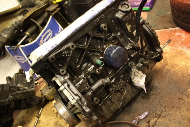

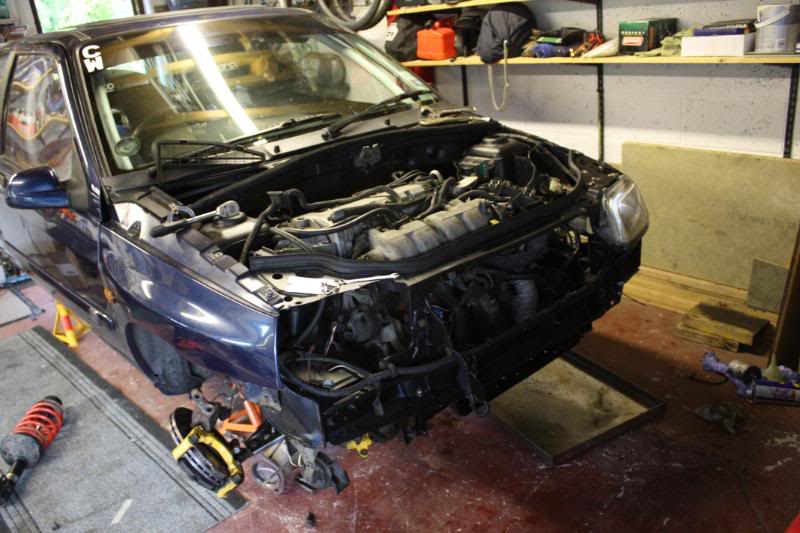

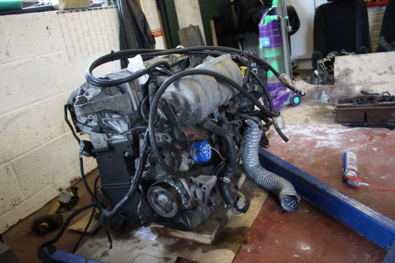

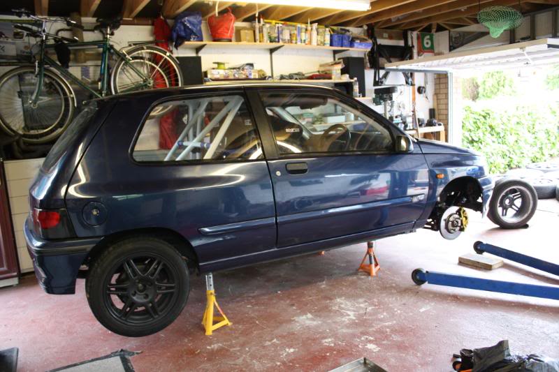

I set about taking the old engine out again. 3rd time now and it seems to be quicker each time.
Car up onto stands. Wrong way round in the garage really but thats how recovery man rolled me down, and I have no means of turning it round.
2.6 degrees of camber :cool:
Greedy, me? Nahhhh
A few panels off

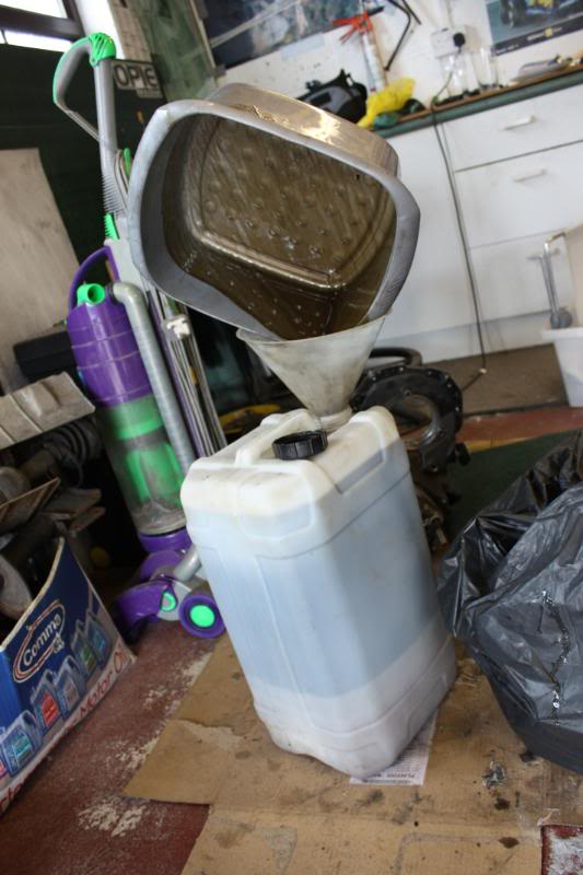

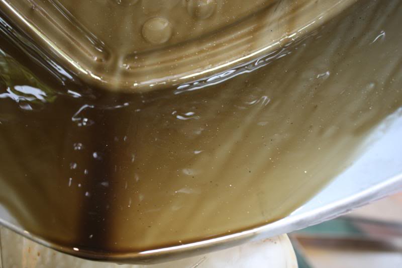

A few nice metallic flakes in the engine oil, lovely
Yep, thats 25l of oil I've wasted on this damn car! I also failed at saving the gearbox oil, as only 1.5l went into my tub :(
Rad/fan etc out. Also removed alternator as it makes it easier and it's f*cked anyway
Out

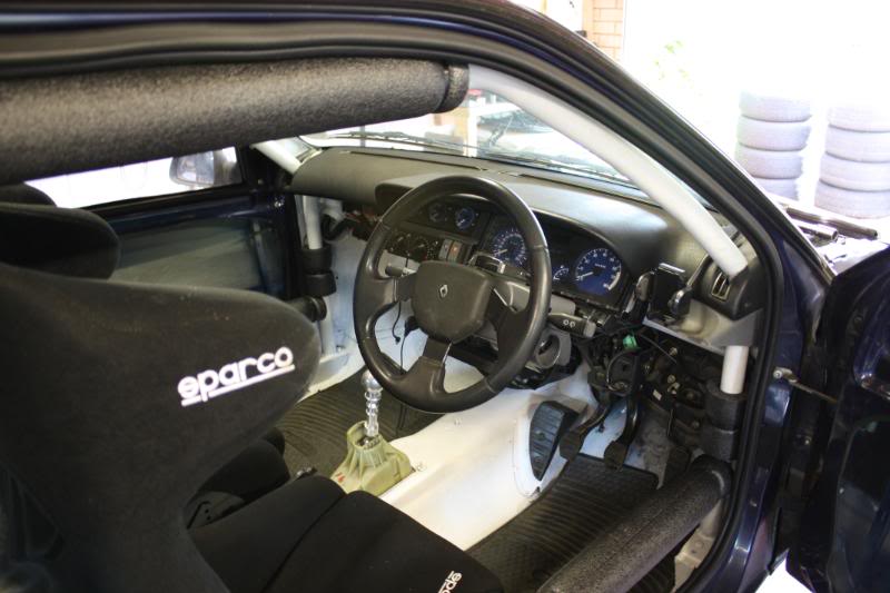

Interior shot

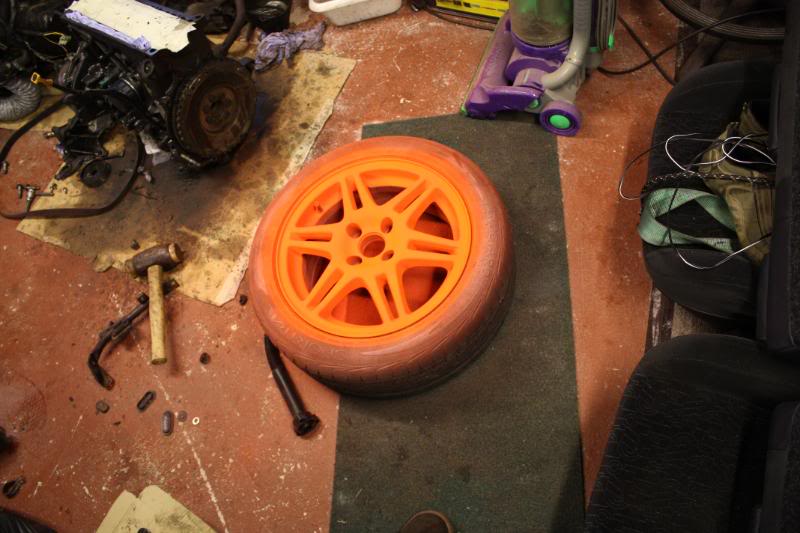

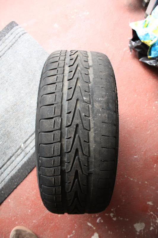

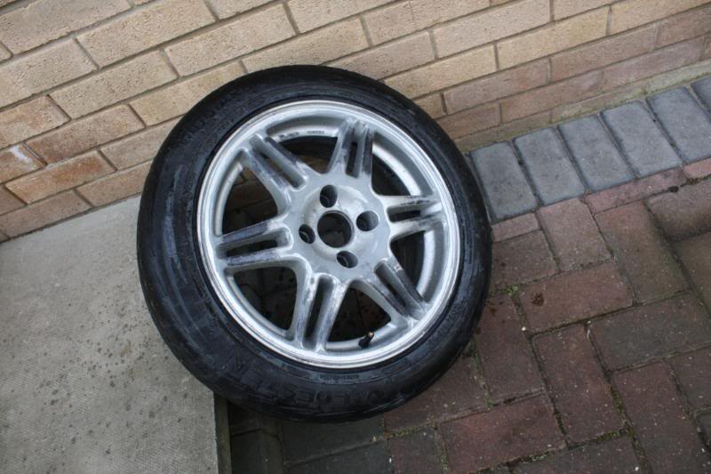

Also cleaned a wheel up with some petrol which took the paint off nicely. Weird/wonderful colour suggestions? 4 different colours? :clown:

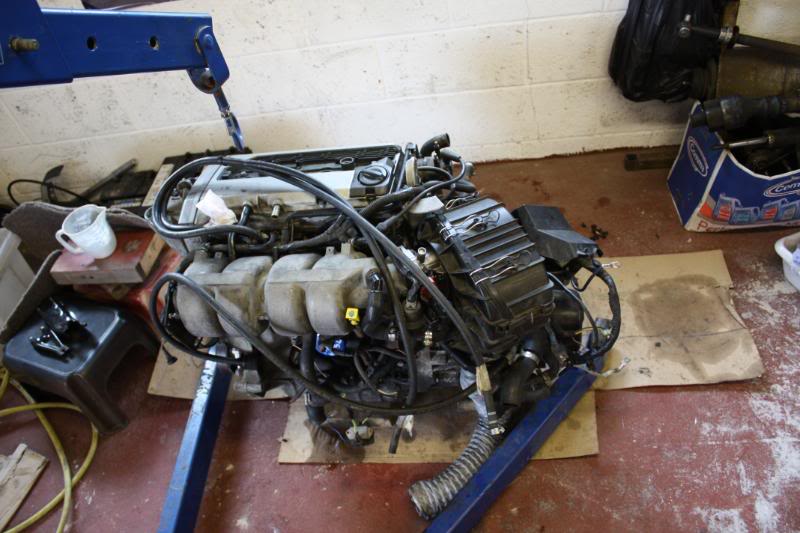

Picked a riggy F7p up from Foxy earlier today in a load of bits, along with about 19 exhaust manifolds too!
Head is off, so I'm going to re-lap the valves and fit new stem seals (cheers Winston) etc.

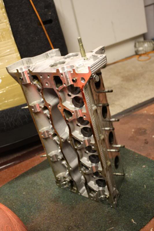

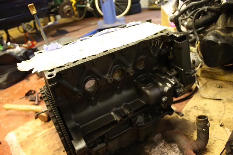

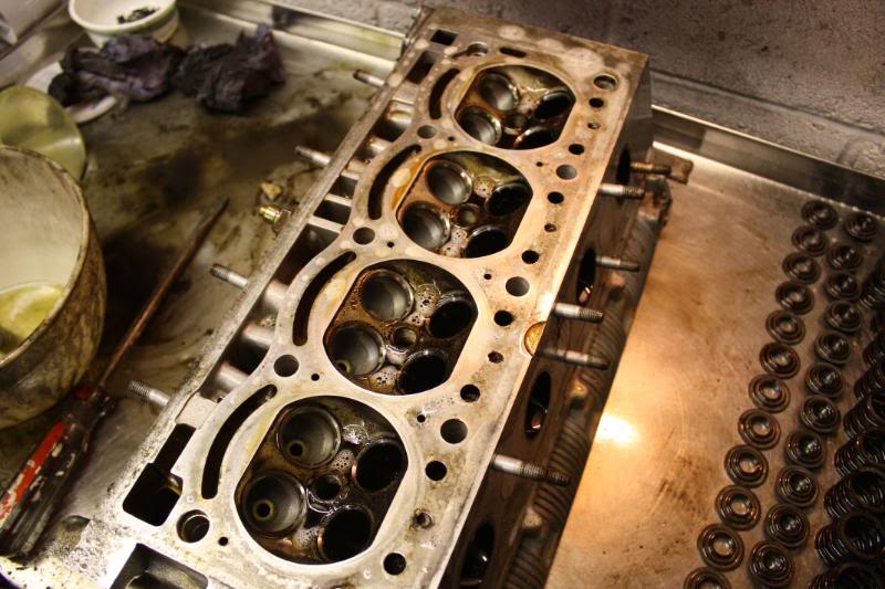

Made a start on the new engine/bits this evening.
Stripped most bits off the bottom end so that I could make an effort to clean it up and maybe paint it. Removed all the power steering pump assembly as i'm not using that.

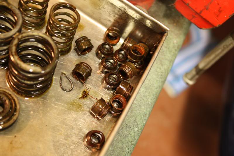

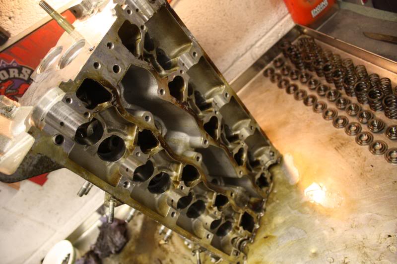

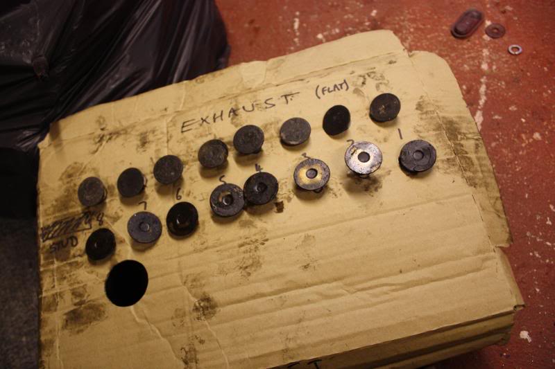

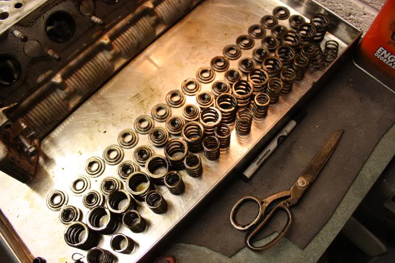

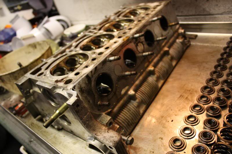

Then I started on the head. Took all the valves out and put them to one side, keeping them in order.
Springs/retainers lined up
Valves

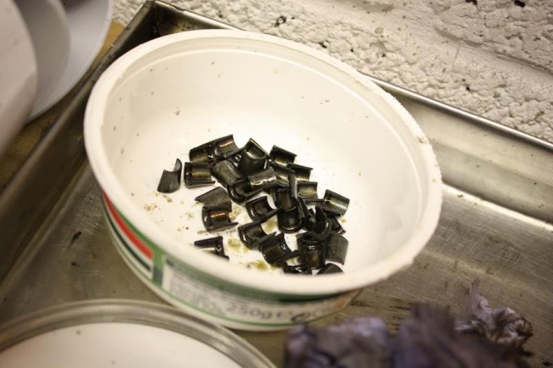

Collets, fiddly little buggers
Old valve stem seals, these will be replaced
Had a quick effort at cleaning the head up with petrol and all sorts of degreasers, some pretty stubborn marks on it though
Bit better
And we have wheel colour #1
