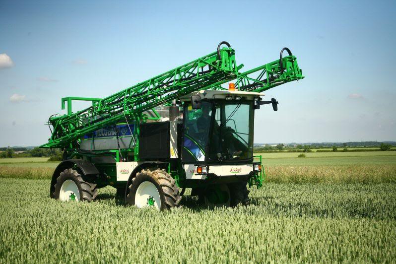

Were did you get thet pic of my dads trator lol
You been hiding in the crops again :rasp:
