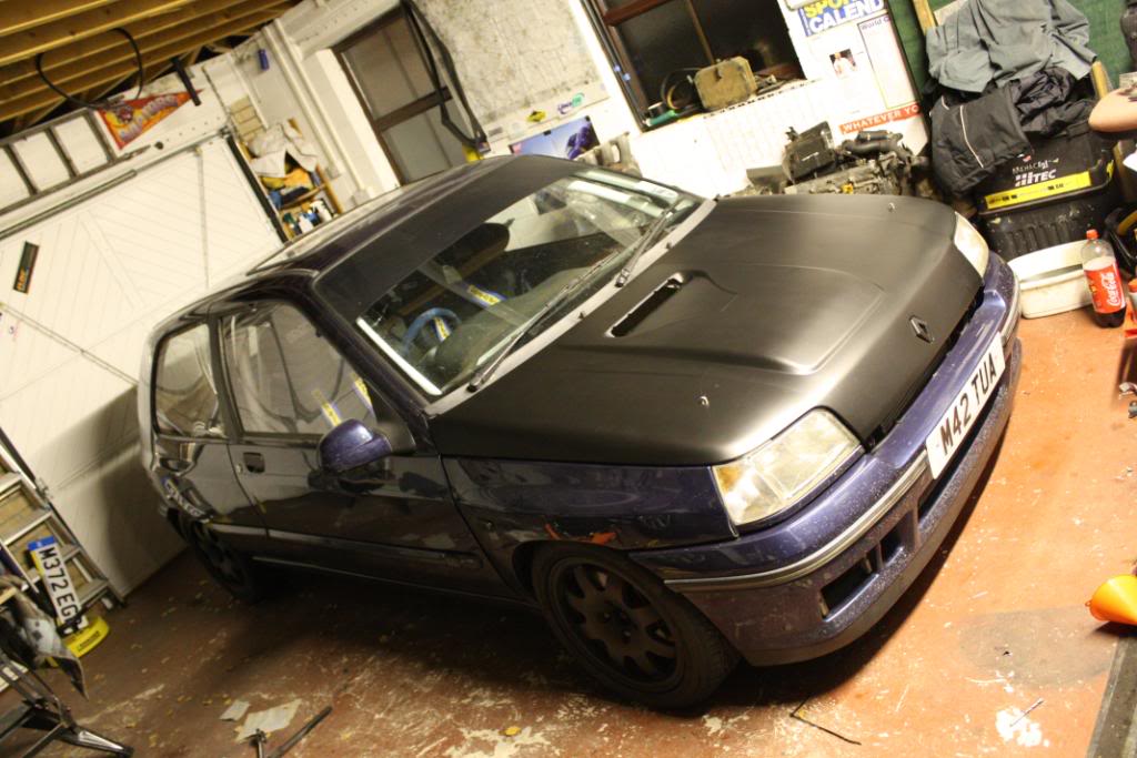

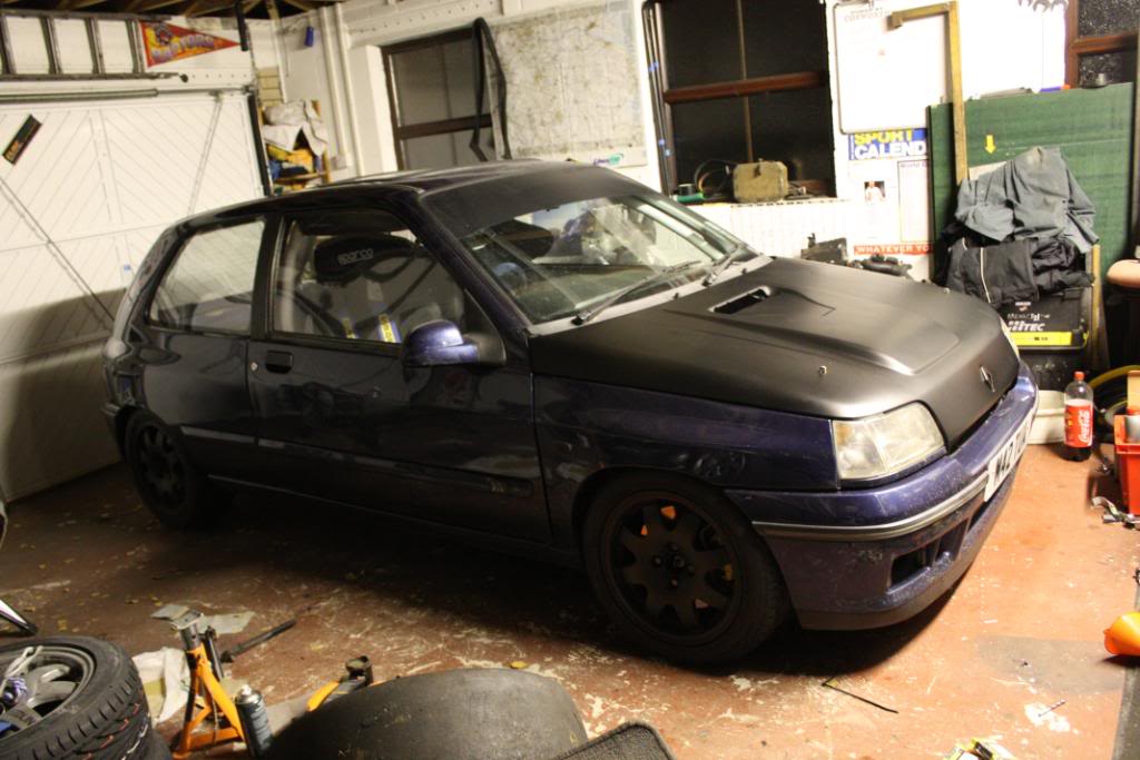

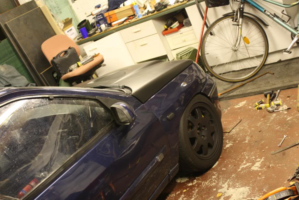

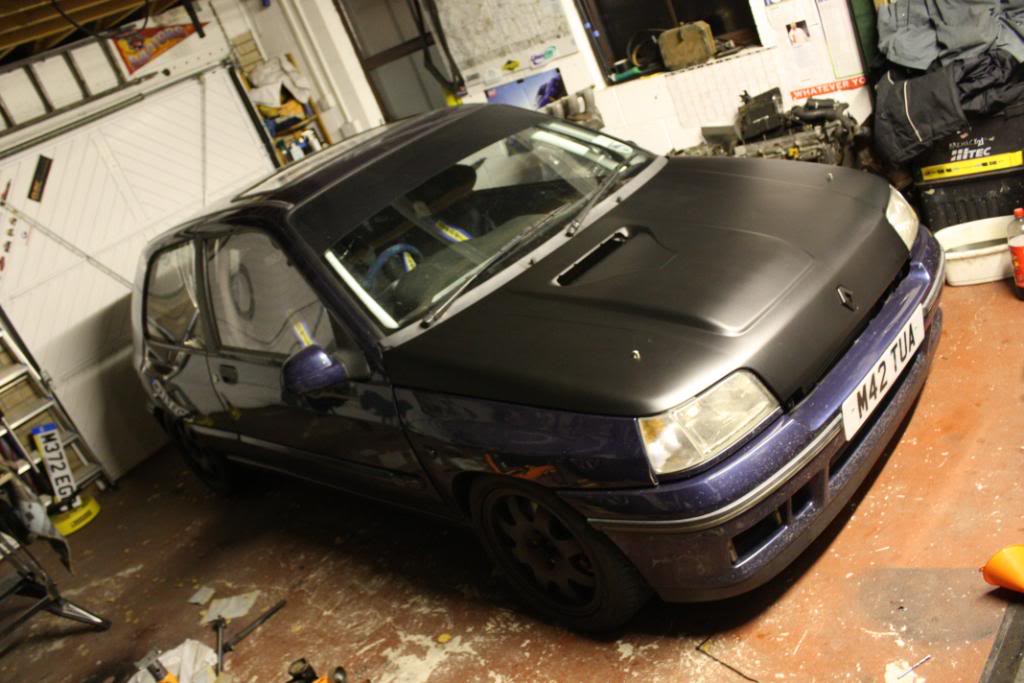

Well I'm not sure if this was a very good decision, but I painted the bonnet black tonight :cool:. Remains to be seen how it looks on the car as it's still drying at the moment, so I'll report back again tomorrow. It was in an absolute state before, so I'm not losing anything by having a go at least.
Feel free to take the piss, it is quite funny :star:. Track Rat™

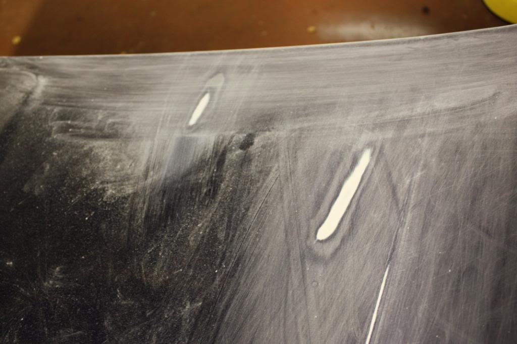

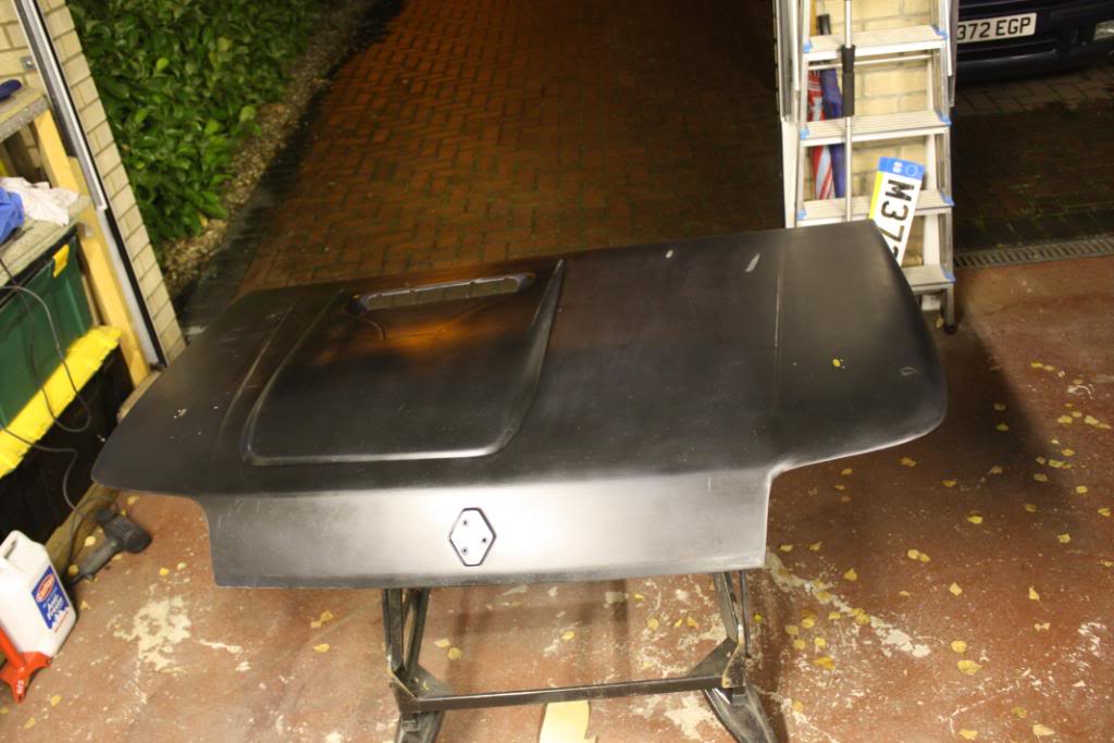

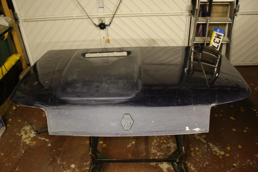

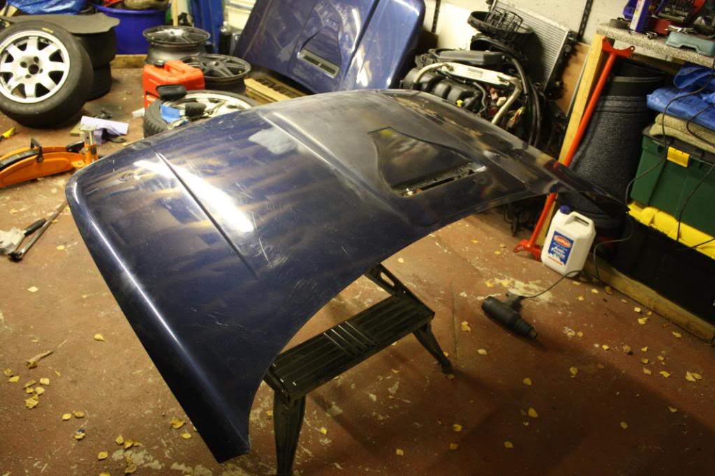

Anyway, bonnet off, badge off, pins off, vent off

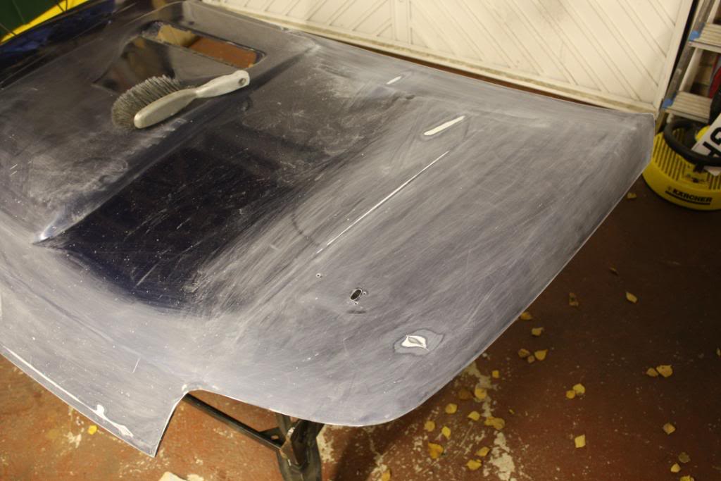

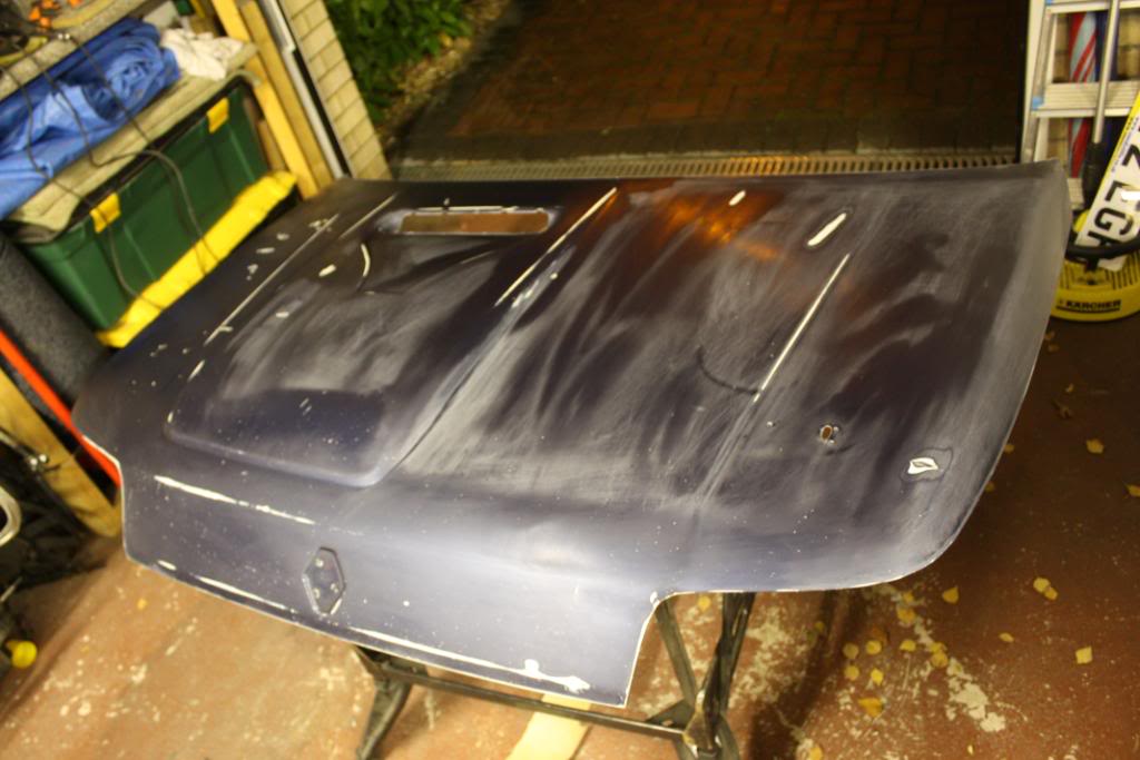

Started rubbing the front face down. 100grit sandpaper is where it's at :evil:
100grit all over, why not. Be reet.
This got quite a few heavy scratches out
All rubbed down and wiped over to lose the dust

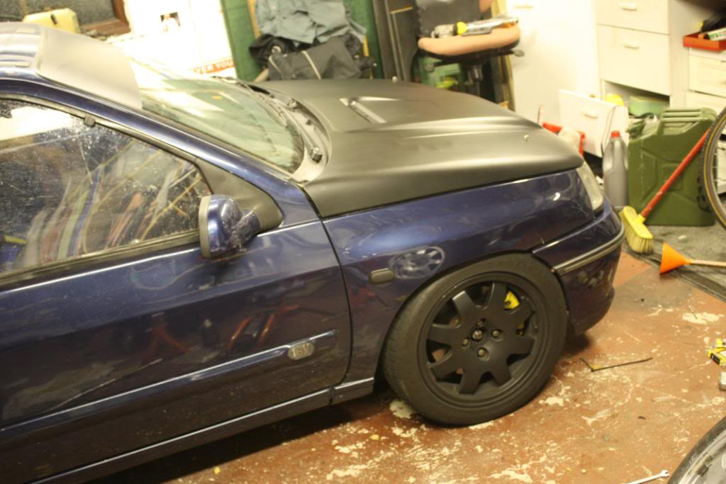

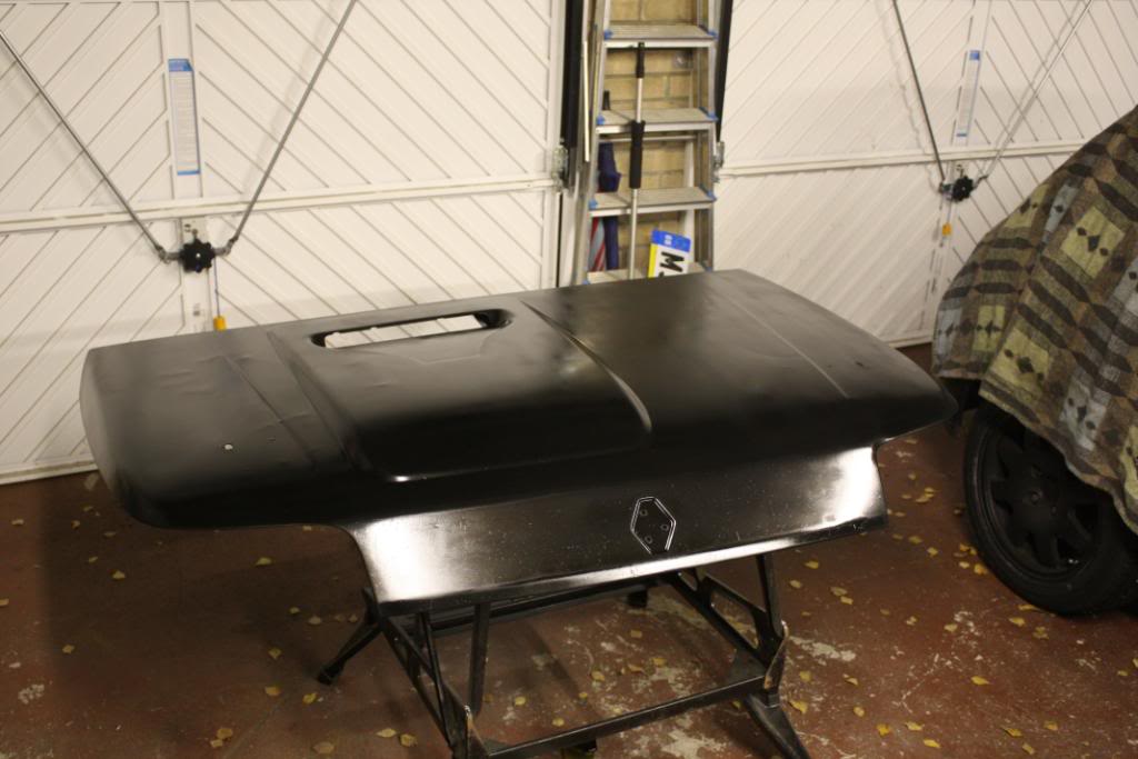

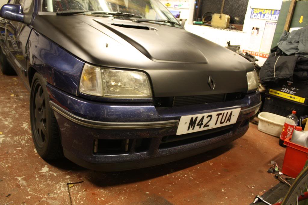

First light coat of satin black. Rattle can special
And a 2nd heavier coat. That'll do

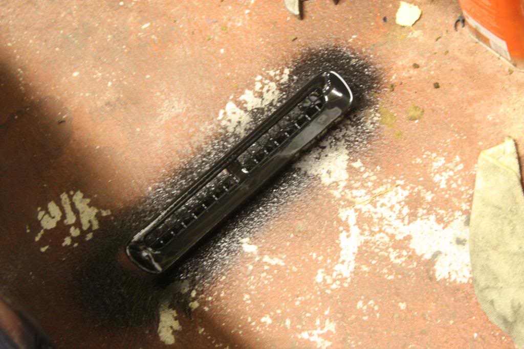

Vent painted too

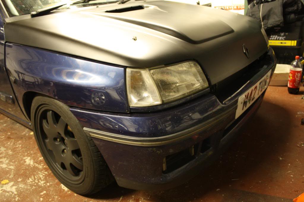

The paint didn't 'build' as much as I'd hoped as it's not a brand i'd used before, so I could have done with rubbing it down with a bit finer grade paper before paint ideally. Not to worry. Function>form. Go>show.
:S
You'd need to hang the bonnet up vertically to get a better finish mate.
But fuck it, a good paint job won't make you go quicker, so don't worry about it!

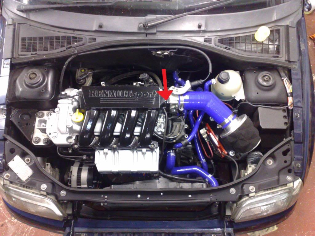

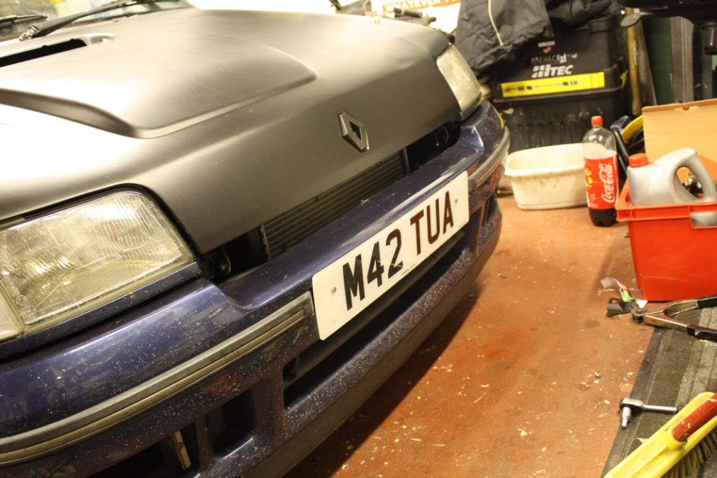

How much room have you got under the bonnet??
I've cut loads out the inside but I still think its catching on something. I'm worried that if it is, on the first drive if the engine rocks it will crease the bonnet from the inside out!
Haha nice, Ive currently got a set of alloys that Im rattle canning, need to finish them at some point :dapprove:
It's either resting on, or very very close to where I've arrowed here. I've cut the whole inner skin out my bonnet so there's no more I can lose directly above this area. You can get around it by loosening off the bonnet catch and moving it up slightly.

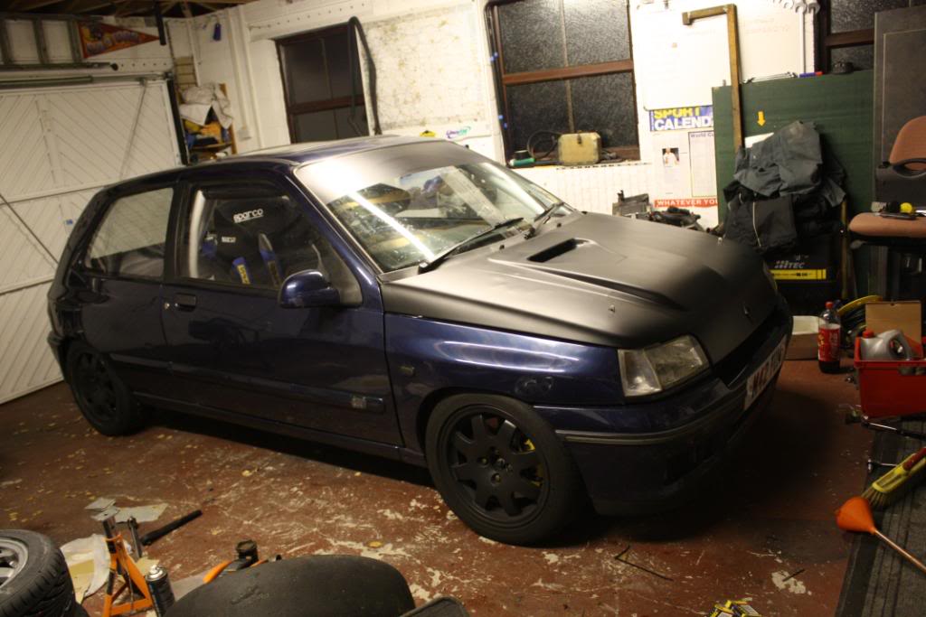

Love that!! I couldn't cope with those dirty windows. I detest dirty windows!
Bonnet and wheels/twatstrip look very good against the blue though.
Bonnet and wheels/tw*tstrip look very good against the blue though.
Cheers. I like it. Agree on windows though, they're a bit of a state. Quite scratched too though being plastic :(
