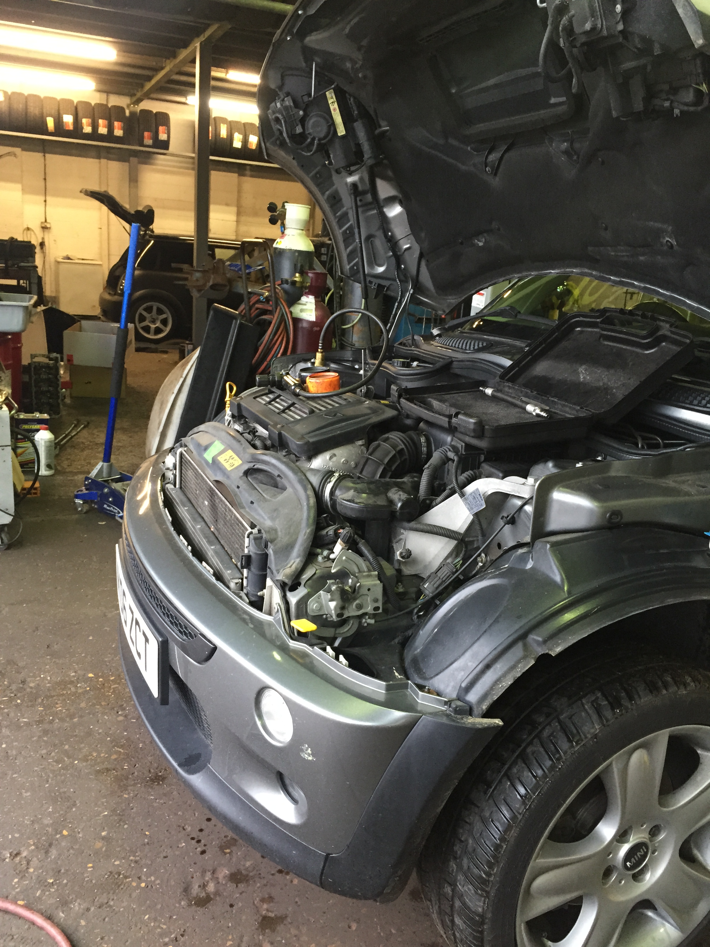

Engine Health Check in progress..

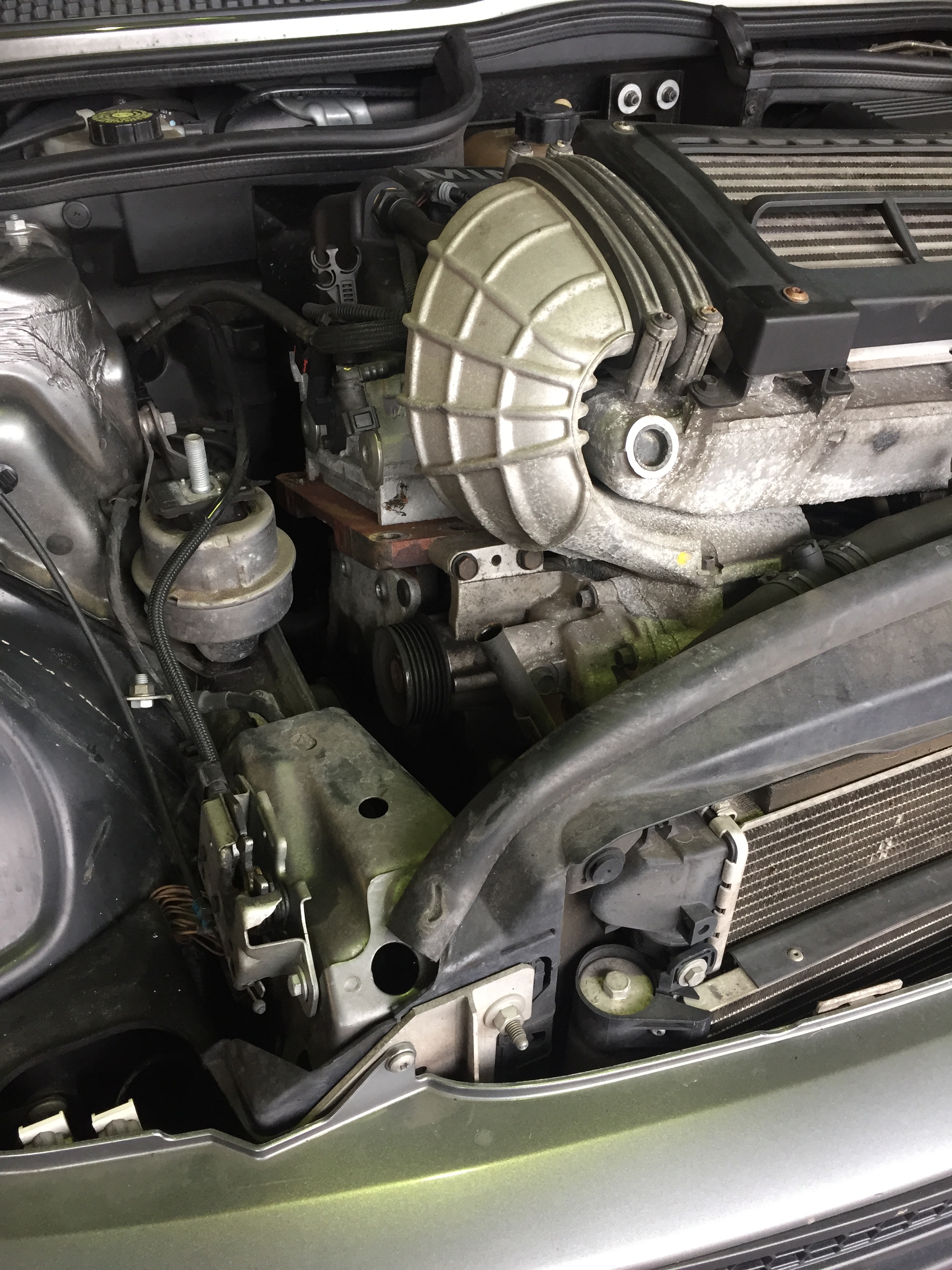

All good, Thomas carried on with servicing the car (Insp 2) and cracked on with fitting the 15% Kavs Pulley.
A few bits, mounts and bolts removed along with the lump lifted up a little... the old Pulley came into view.

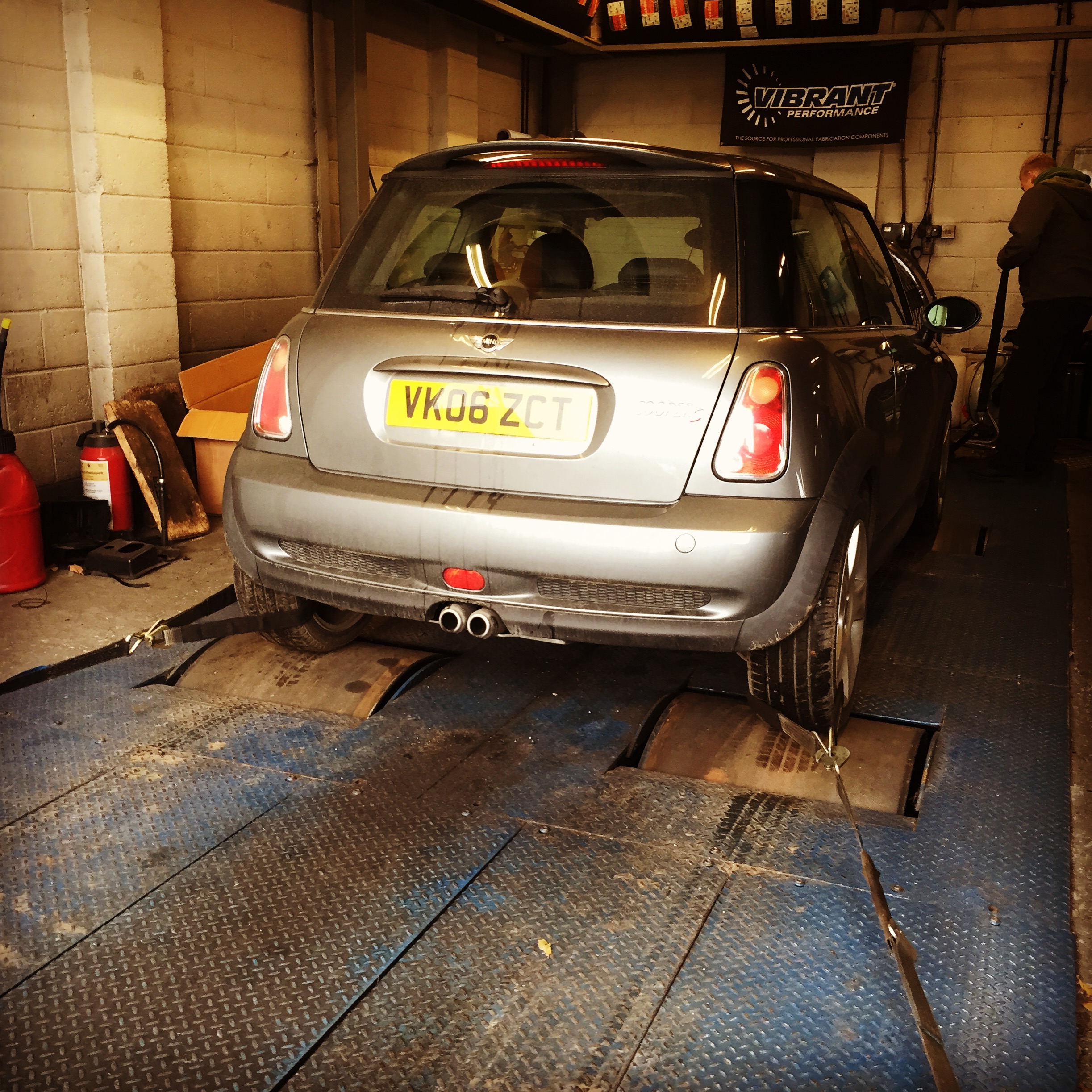

Strapped onto the rolling road.. (Insta filter, sorry!)
Quick Vid..

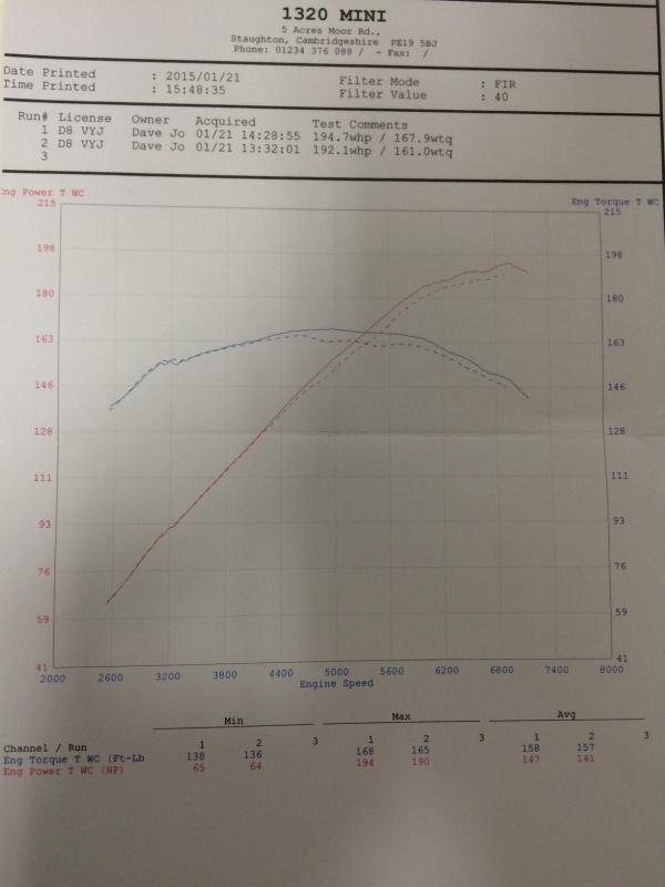

End result = 211 Flywheel Bhp and 165wtq.
Thomas overlayed a stock GP graph against mine for me to see. Needless to say, it was nice seeing my S having more BHP and torque throughout near 100% of the rev range in comparison.

What was the ATW figure for the bhp?
Dont think i've ever known 1320 to give a fly figure before, their dyno does everything at the wheels, ie:
Very surprised at your torque also, being that its higher than mine with cam/injectors/airbox/intercooler etc!!
  Peugeot 308
I'll take a look at the graph later and get back to you @Sir_Dave - I want to say 184.2 or 185.2 lol.
